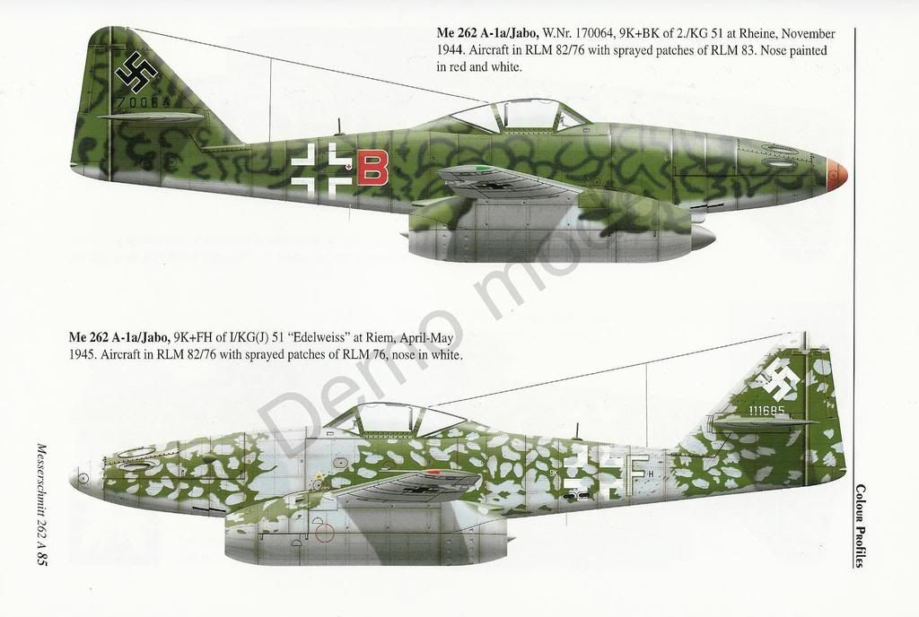

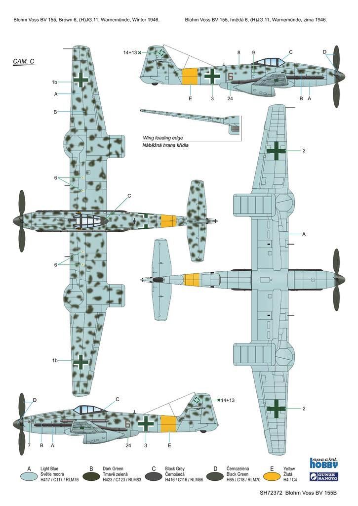

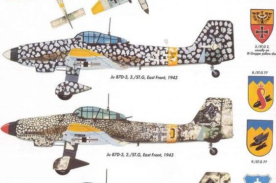

I'm thinking of doing the camo like the lower Stuka :
I'm open to suggestions .
That box-art scheme is too boring :D
No matter tank or aircraft, German camo patterns are fun and difficult to choose just one. However, I love me some Haunebu pattern

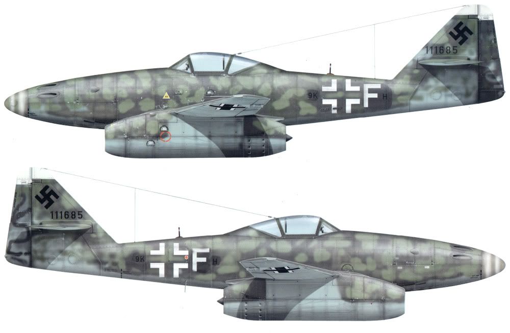

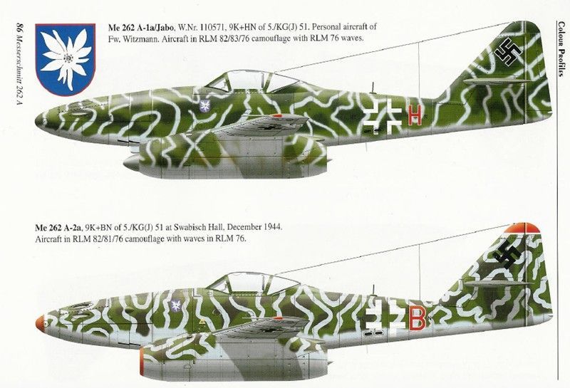

I decided to go with camo along these lines :
I've ordered paints specifically for it .

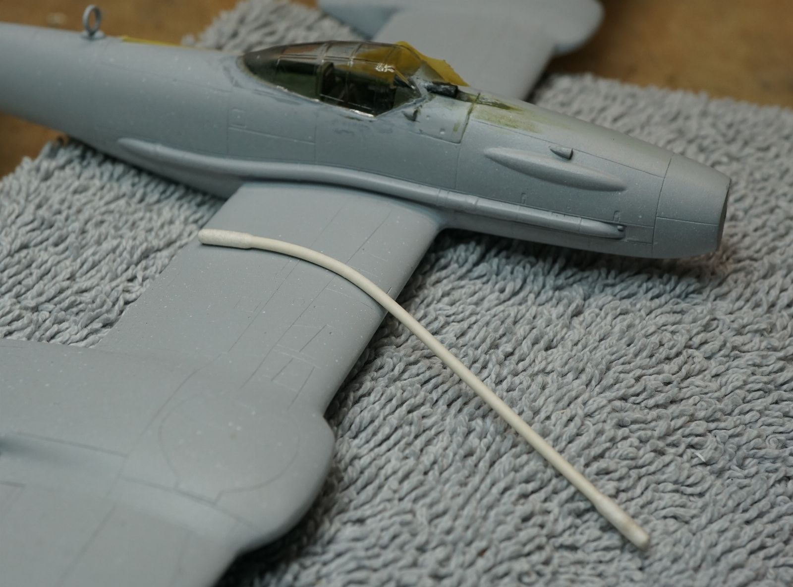

and the hole for mounting the prop is just big enough for a tiny swab ( Tamiya , extra small round )
As soon as I touched the contaminant it vanished . I don't know if it stuck to the swab or fell into the cockpit .
I drummed my fingers atop the engine cowling and tilted the nose down repeatedly so maybe whatever it was fell down into the nose or at least stuck to something else if it was still in there .

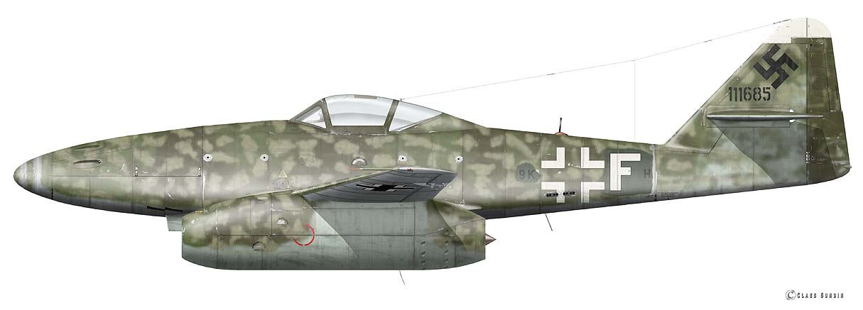

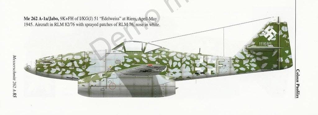

Don't temp me . It won't take much ; I've been considering something crazy but it will probably be some iteration of the examples on those Me 262 .

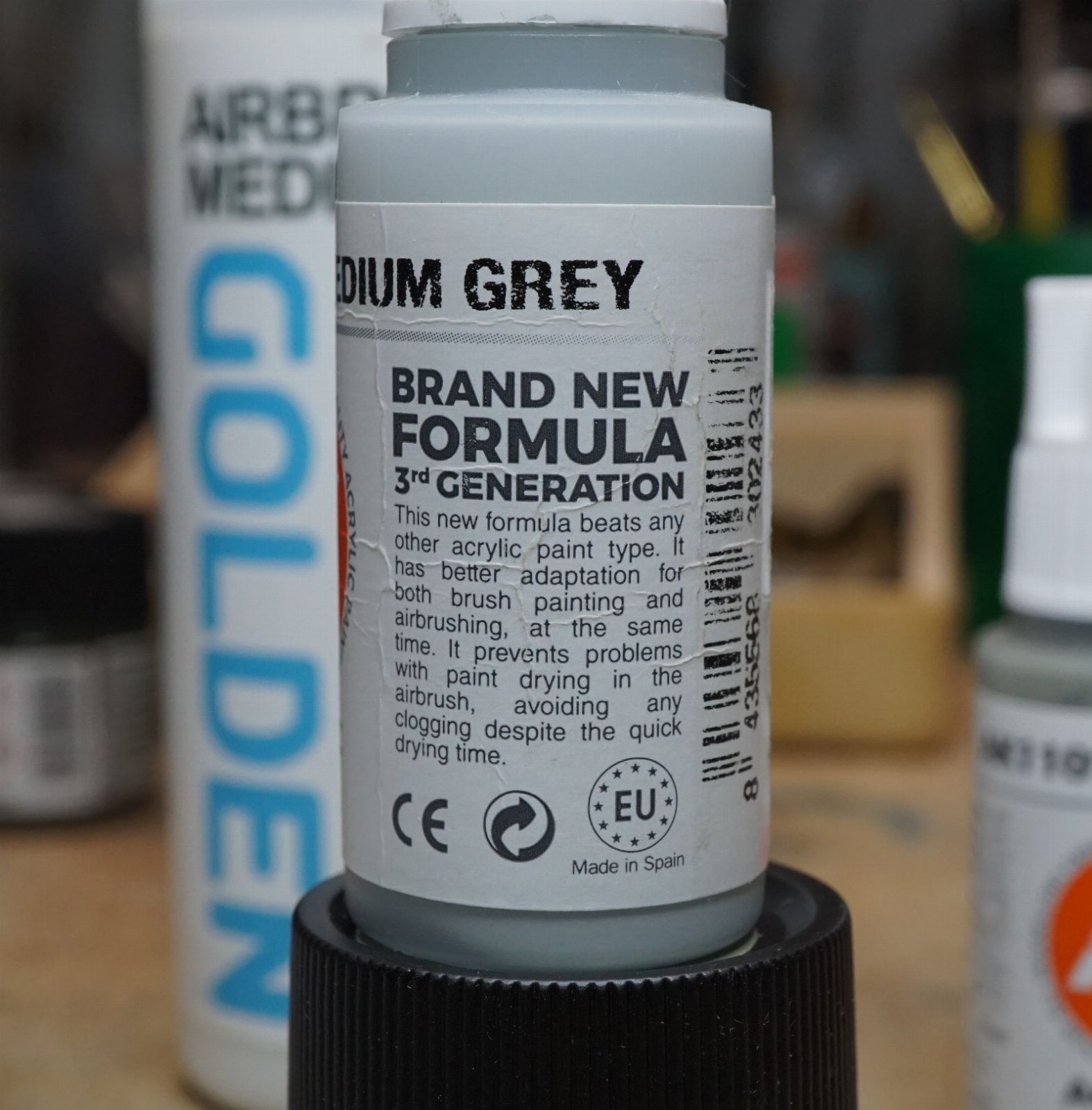

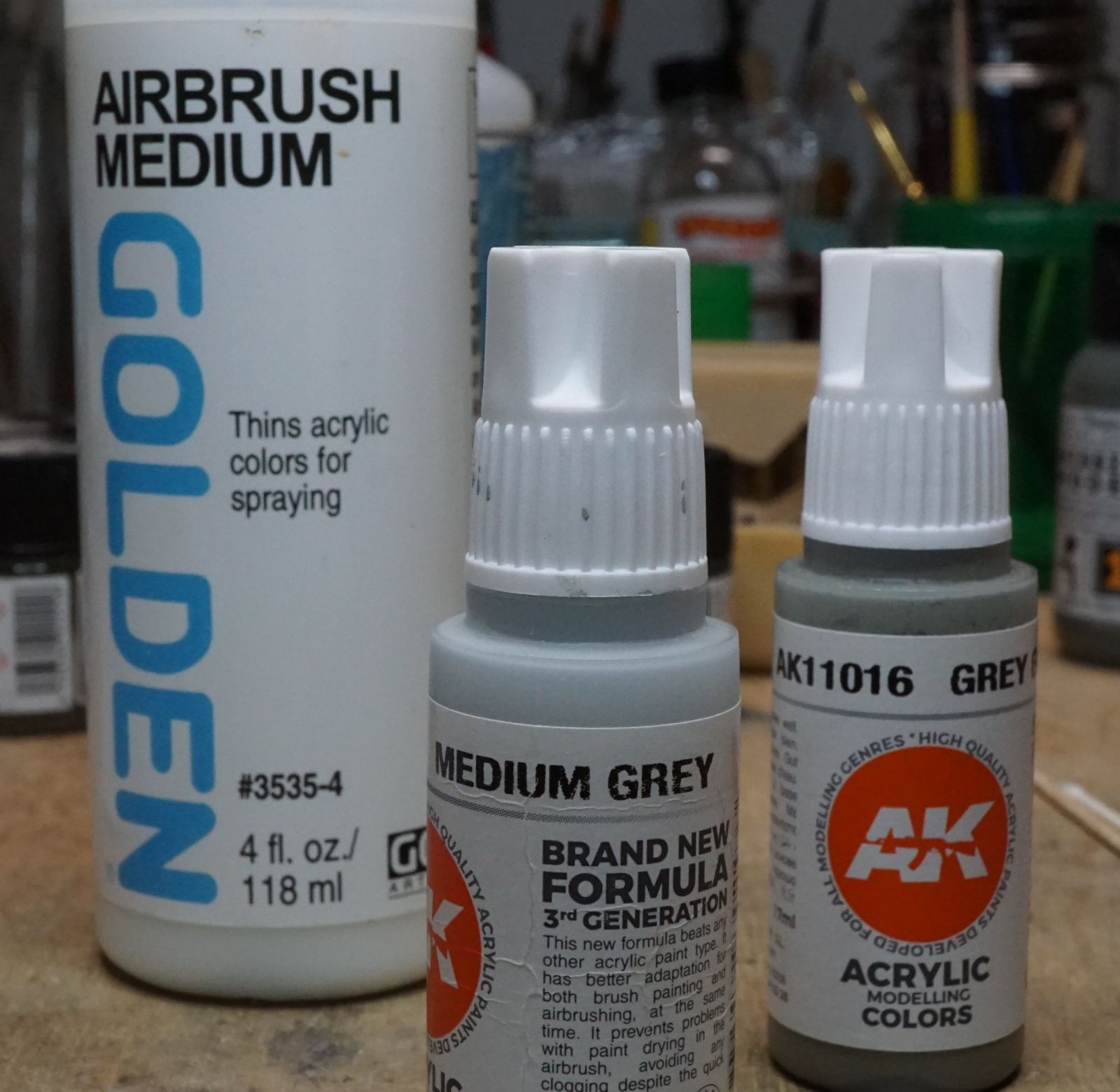

I painted the underside with this AK , Medium Grey , " Brand New Formula "
I forgot I had chosen that over the Hellblau .
First time using them .

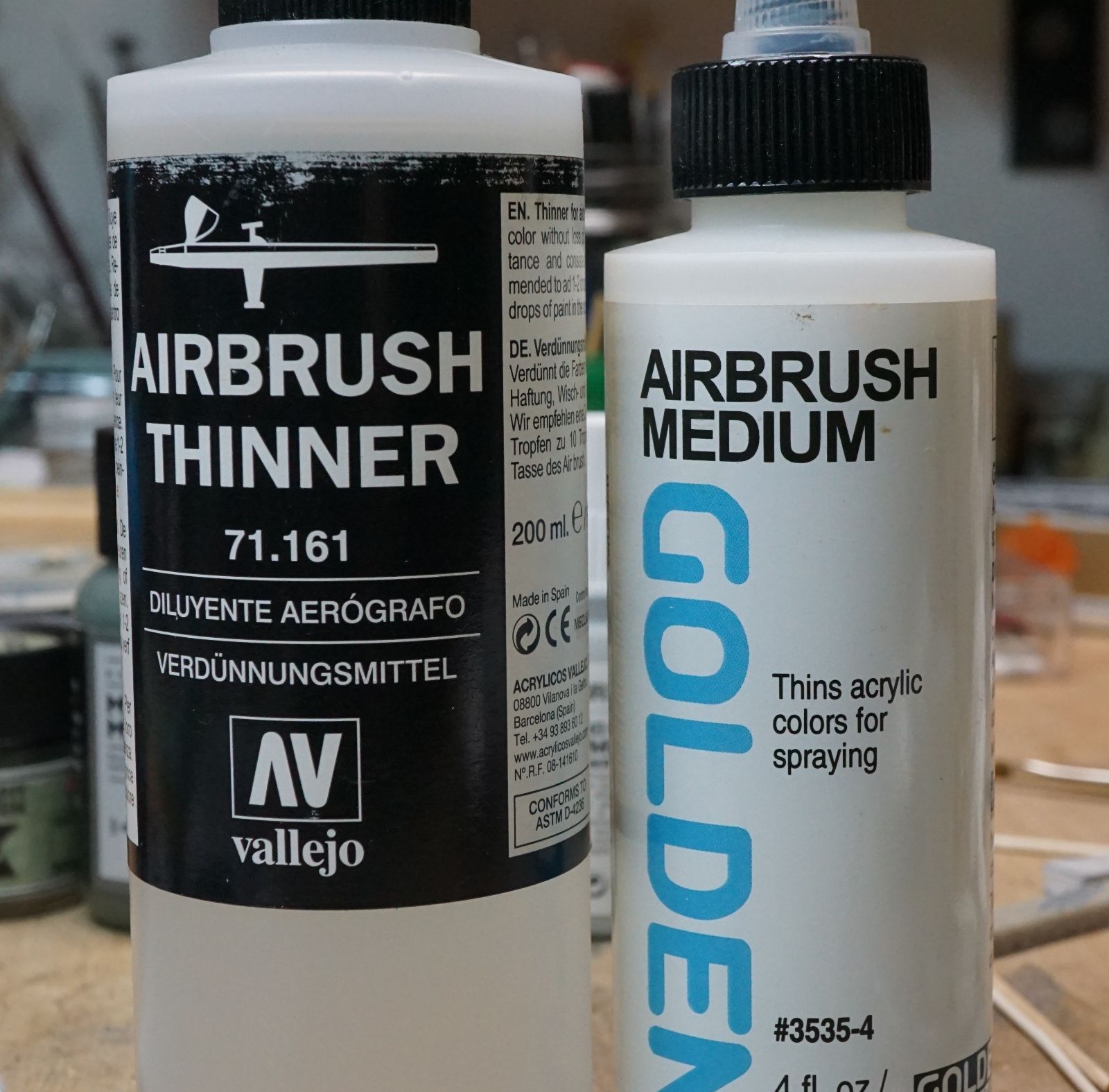

DO NOT use any alcohol with it ,, unless you want it gooey and chunky . It's one of those emulsions
Isopropyl , ethanol / methanol , butoxy ethanol etc etc . No .
I used that Golden airbrush medium , but the Vallejo works also .
I can't verify the contents of the Vallejo , but the Golden is 70% propylene glycol ( retarder ) with the rest water and a tiny amount of Ammonia ( ammonium hydroxide 26% ) , only .2 % .
I assume that's used as a surfactant .
When looking for info on the Vallejo thinner , I saw way too many saying it was mostly isopropyl alcohol .
Well , we know that can't be right .
Probably pretty close to what Golden has concocted .
Into the food dehydrator for a couple of hours @ about 100 F .
Speed up whatever crosslinking is happening , before I start masking atop it . Probably a pretty fast cure with these AK Real Colors .

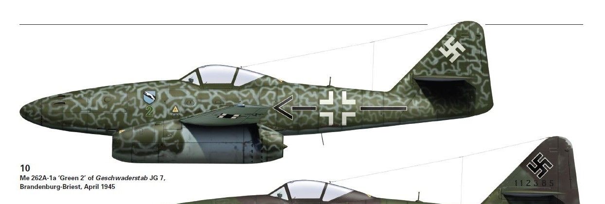

I'm obviously doing the other scheme . Kinda
Thinking of doing a hybrid with the lines .
Which AK ?
I chose all the paints for their color . I'm familiar with the AK Real Color , it's another " lacquer acrylic " , probably similar to Tamiya's , though I've never used Tamiya paints .
Which AK ?
The ones you showed in the previous reply. The Grey ones. I was just wondering, but if it's for no other reason than it's paint you know, it's good enough. I'm just asking cuz there're a lot different paints and I'm always interested in knowing why people chose this or that particular paint... I only know humbrol and Tamiya... And I just bought vallejo for figure painting.
But I did consider trying AK or was it mig, can't remember, purely cuz they have a ball inside for stirring the paint.
So I'm just curious as to your experience, that's all.
