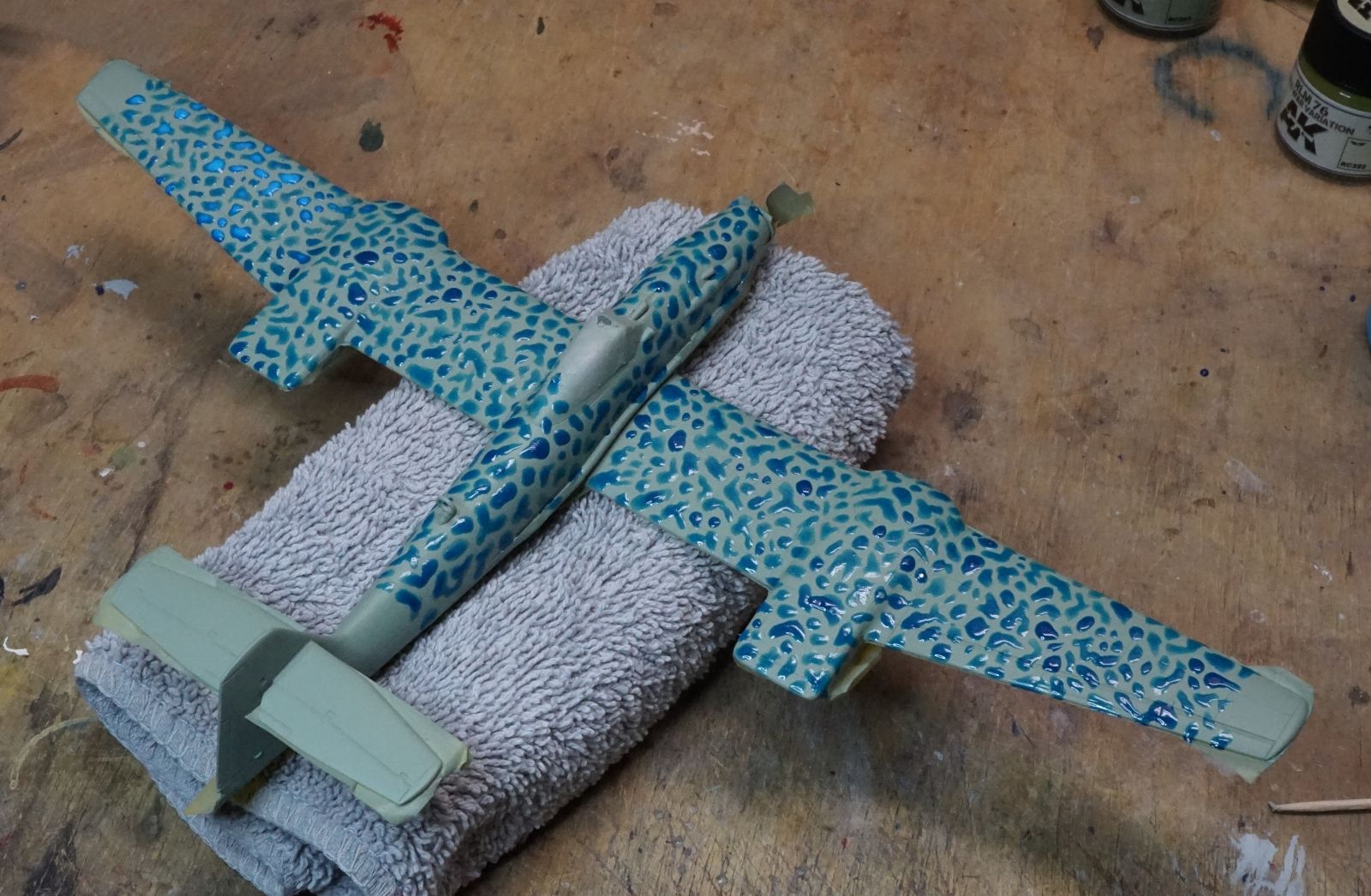

So the 155 spent around 6 hours in the dehydrator yesterday and is doing all day again today -- at 100 F .
I'm not taking any chances with lifting off the paint when I remove all the latex .
I removed the masking from the underside since I'm always afraid I'm going to weld the tape on ; it's never happened , but ....
Pix prior to insertion :
I mixed the olive with the red-brown to tone it down ,
I haven't finalized the plan for the empennage yet ,
Want to put some color fore and aft , but I want to see what this pattern looks like first .
I like 'em .
Sprays very well and easy to clean from the AB .
No problems yet :D
A guy over on Armorama recently posted that he had issues with the stuff bonding but I've never had a problem .
The people replying to him confirmed my experience .
They're pretty much AB ready but I do use their butoxy ethanol thinner ( I would definitely not use lacquer thinner in them ! )
Appears the owner of the company is quite helpful if you need him :
https://forums.kitmaker.net/t/mission-models-paint-does-not-play-well-with-others/11100

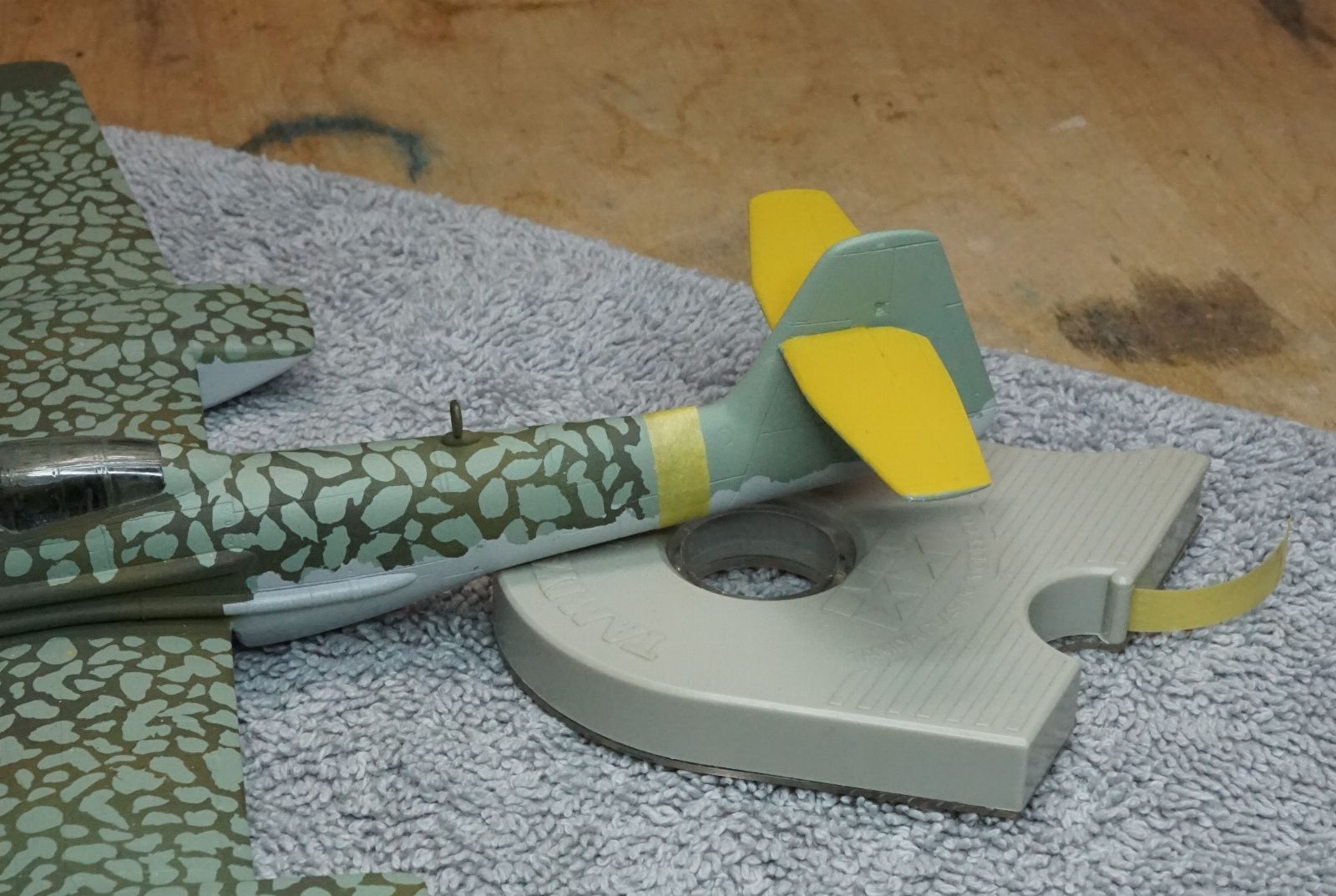

That Khaki Drab I sprayed on there last had a bunch of grit in it .
It is a few years old now but I was surprised .
I never mix paints and thinners in the paint cup of the AB , so I was able to add the paint to the AB while leaving the grit on the bottom of the mix container .
Maybe they have a shorter shelf life ? - or it was just dried paint from the lid / upper part of the container that got mixed in when I shook the heck out of it .
Thanks !
It didn't take all that long to remove the masking . Only a little longer than applying it .
I used a toothpick to roll the blobs up until they either just came off or I could grab the latex with tweezers .
It will darken up with the panel line wash .
I want to paint the spinner and the tops of the horizontals yellow .
Think I'll paint the engine plumbing and canopy frame first --- I keep changing my mind on the horizontals .

That grey-green base is a little too light for me but it will darken with the weathering .
hopefully :D

I love liquid latex masking .

Woa... That does look different... and a lot better I might add.
Color is such a complex thing... I had a talk with my 15 year old daughter over what Grey we should paint the Darth Vader Tie Fighter in, and she started with 'just any old grey' until I held the different greys up against browns, greens and blues...
Oh my... Her world of color got A LOT bigger that day.
Yes and the lighting is everything of course .
I need to keep an eye on it since just shooting from a different distance / angle is changing it . , and where I position the desk lamp .
That bottom photo is the most accurate .
But both photos are way way better than before .
Heh , if you scroll up to the photo that's last of the tail sitting on the scissors and compare it to the 2 pix immediately below it .
Same settings and effectively same lighting - totally different color . The scissor shot is actually pretty close .
The yellow is too bright .
:D That green rag was looking fluorescent . Hard for me to miss .
night before last I was staring at it on the monitor thinking what filter to remove the blue-tint ( orange ) .
That base does have some blue in it but not like what the photo was showing .
