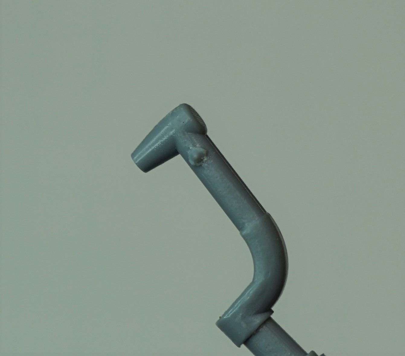

I had sliced off that tiny air scoop just forward the canopy to get it out of the way for the corrective work , and of course when I went to reattach it , it had evaporated from the container I had tossed it into .
So , I made a replacement from a tiny chunk of 1.5 mm aluminum tube and some lacquer putty .

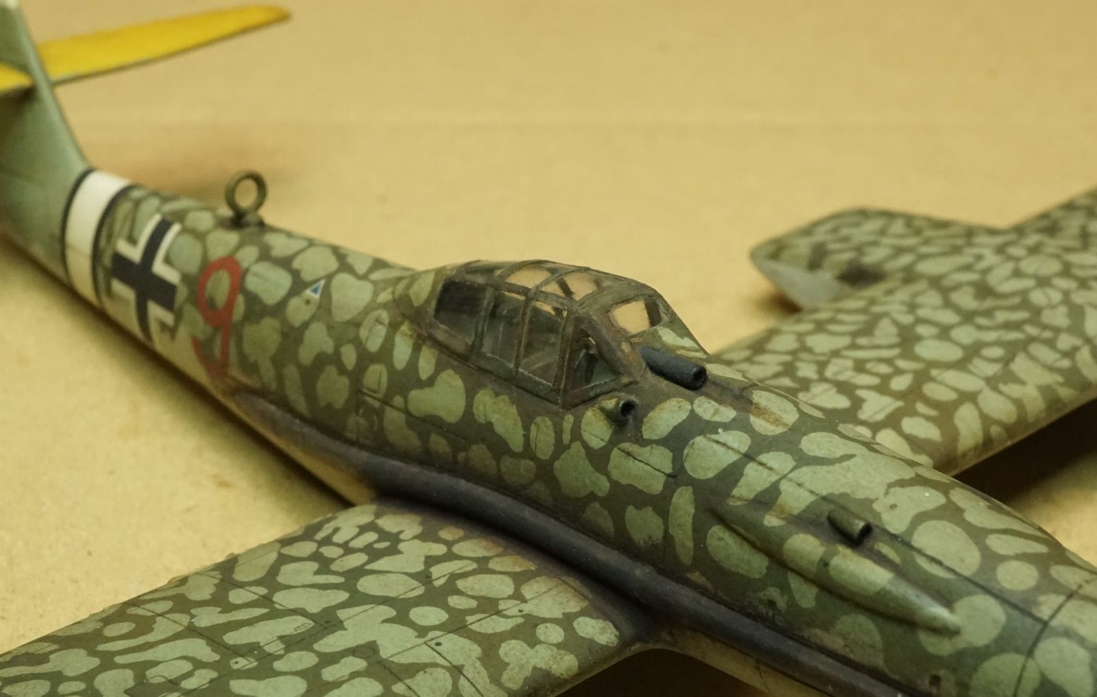

I'm obviously doing the other scheme . Kinda
Thinking of doing a hybrid with the lines .

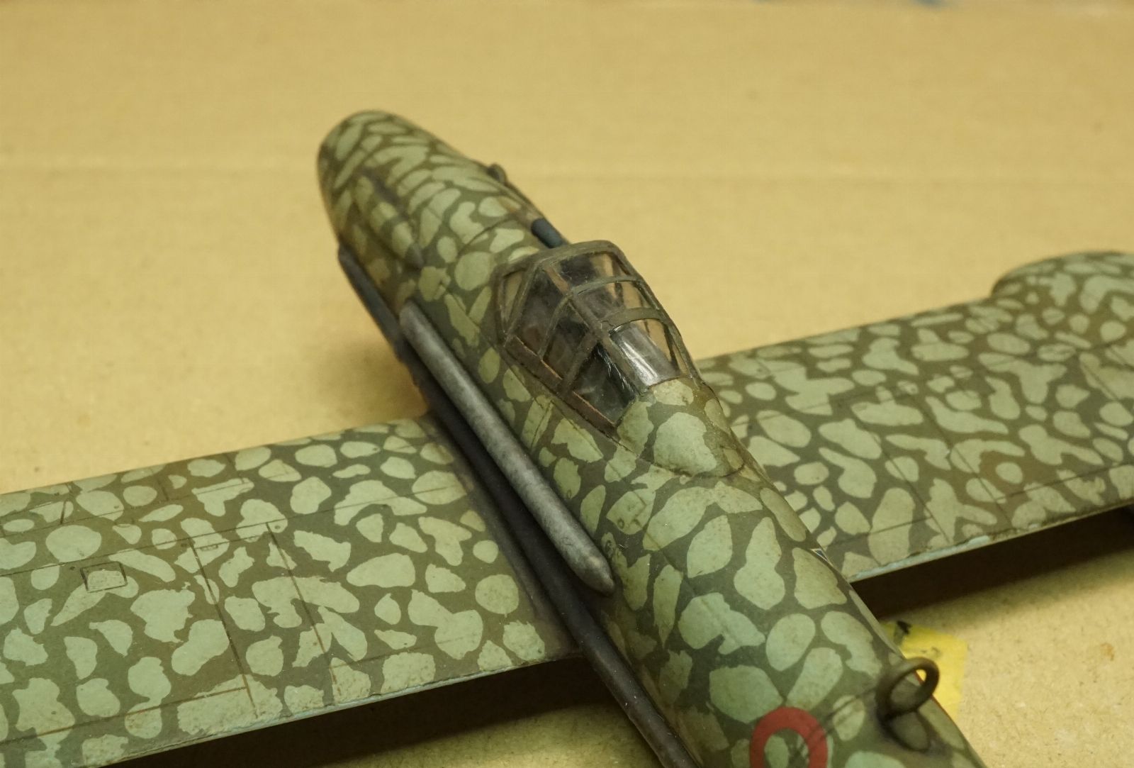

So the 155 spent around 6 hours in the dehydrator yesterday and is doing all day again today -- at 100 F .
I'm not taking any chances with lifting off the paint when I remove all the latex .
I removed the masking from the underside since I'm always afraid I'm going to weld the tape on ; it's never happened , but ....
Pix prior to insertion :

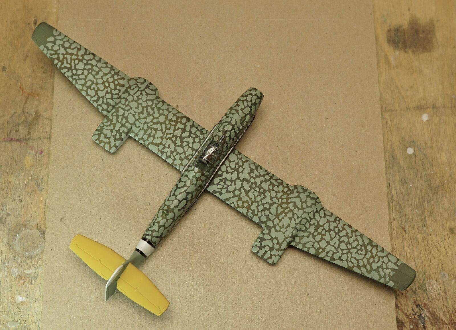

I mixed the olive with the red-brown to tone it down ,
I haven't finalized the plan for the empennage yet ,
Want to put some color fore and aft , but I want to see what this pattern looks like first .

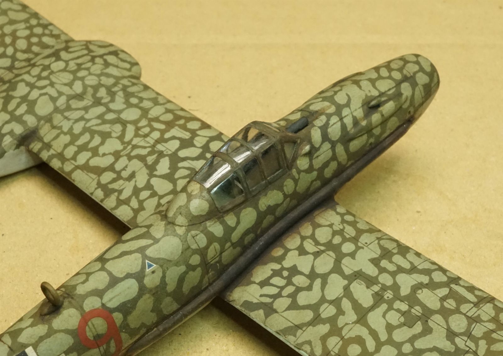

It didn't take all that long to remove the masking . Only a little longer than applying it .
I used a toothpick to roll the blobs up until they either just came off or I could grab the latex with tweezers .
It will darken up with the panel line wash .
I want to paint the spinner and the tops of the horizontals yellow .
Think I'll paint the engine plumbing and canopy frame first --- I keep changing my mind on the horizontals .
