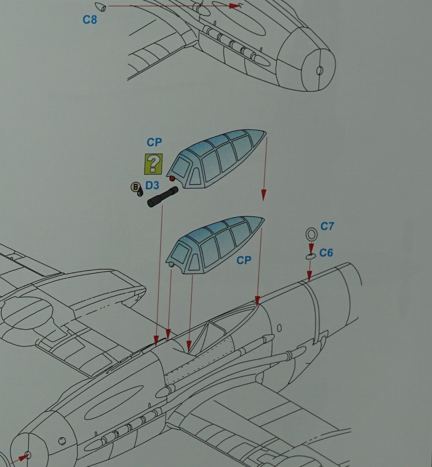

You're given the option of not installing the giant scope , but would the relief in the engine cowling be filled ?
I decided to include it since it's another oddity of this aircraft .
Anyone here seen another aircraft with a big-azz scope on the dash ?
You have to remove a fair amount of the clear plastic to accommodate it .
The fit is poor ( shock ! ) so the next step it to fill and re-scribe all the gaps .

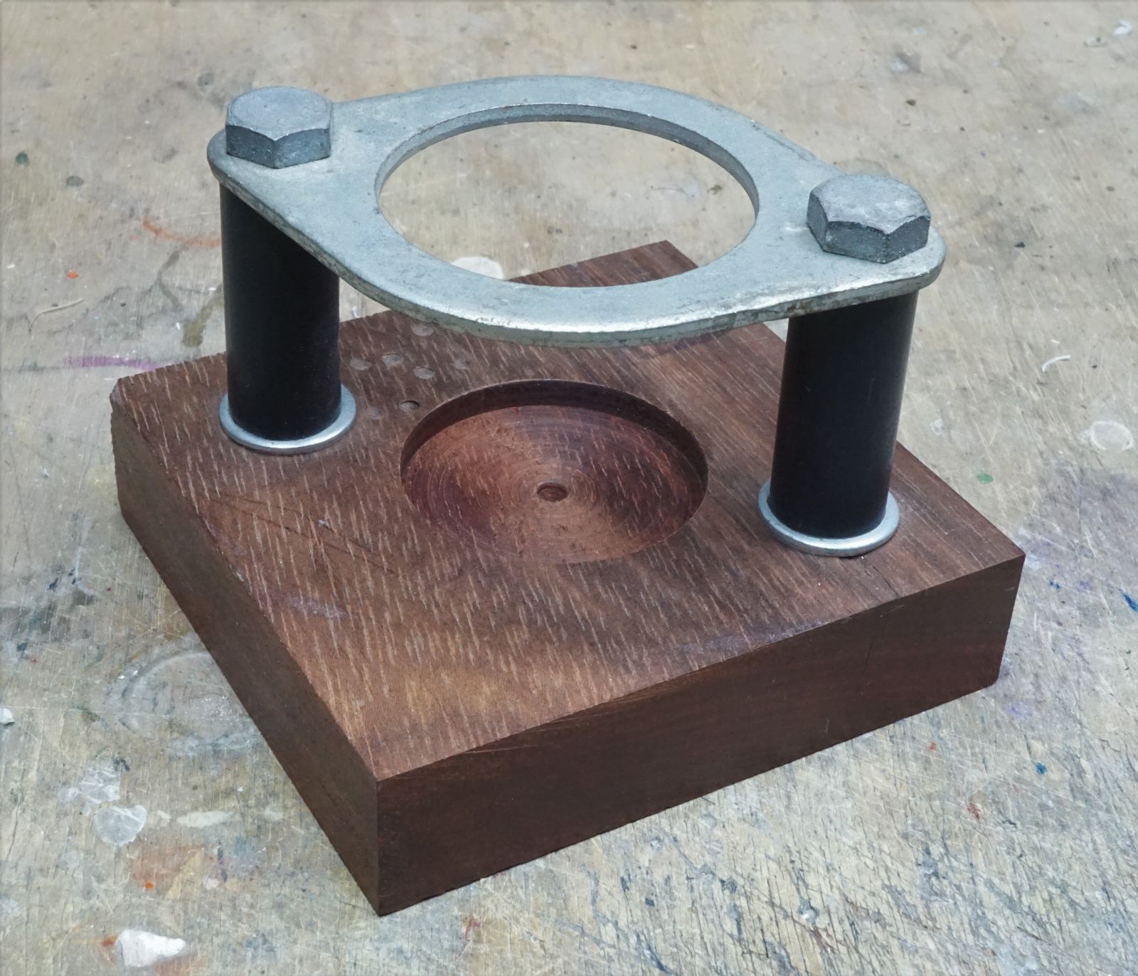

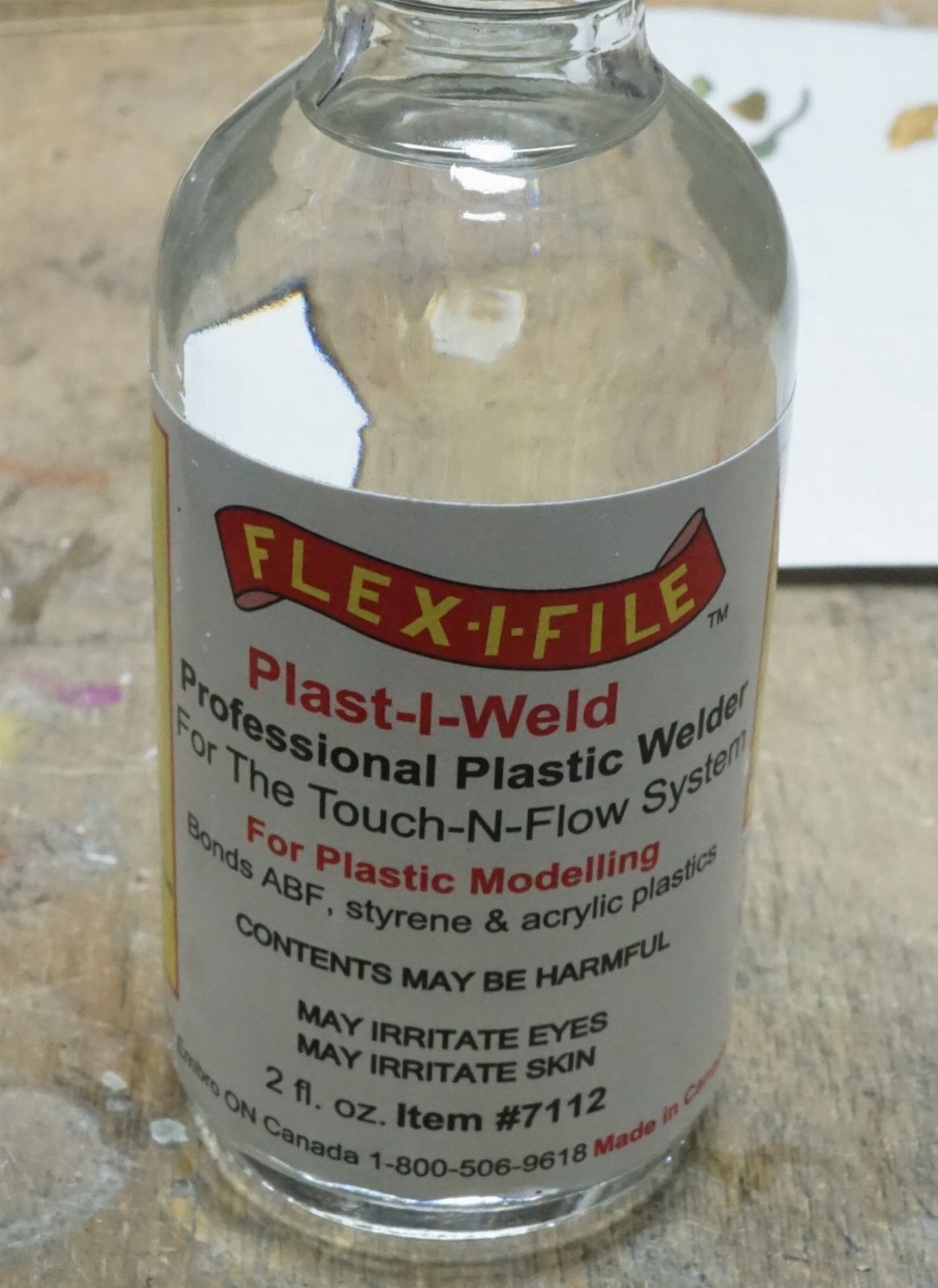

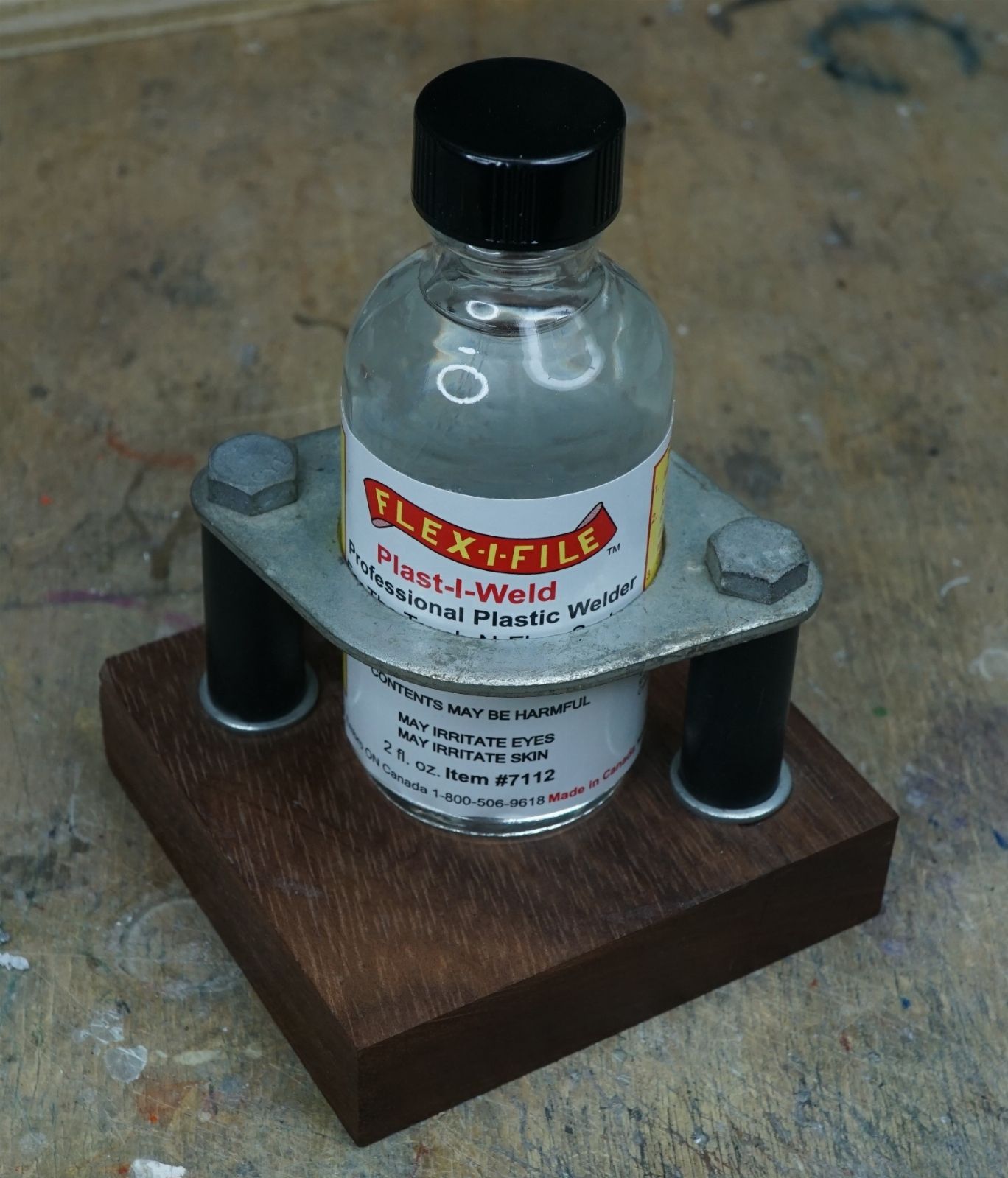

I ordered some supplies from Scale Hobbyist last week ,
They were out of the Tamiya Extra Thin so I got another bottle of the Plast-I-Weld ; hadn't had a bottle of it on the bench in years .
Easy bottle to knock over . :D very easy -- so easy it prompted me to dust off the little safety cage I made for those slender bottles .
I think I saw somebody selling something similar , but for the Tamiya bottles which are wider than they are tall so I don't see the point .

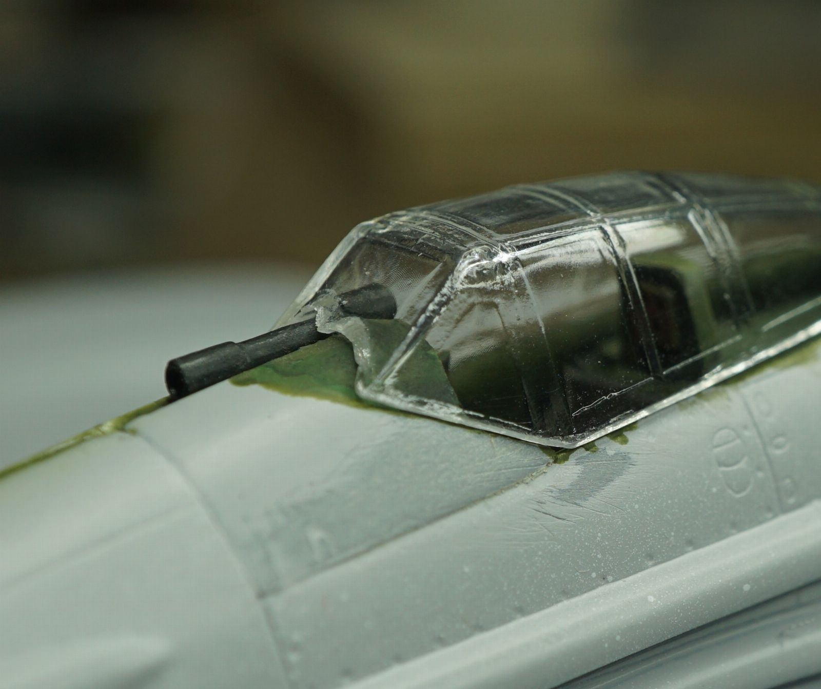

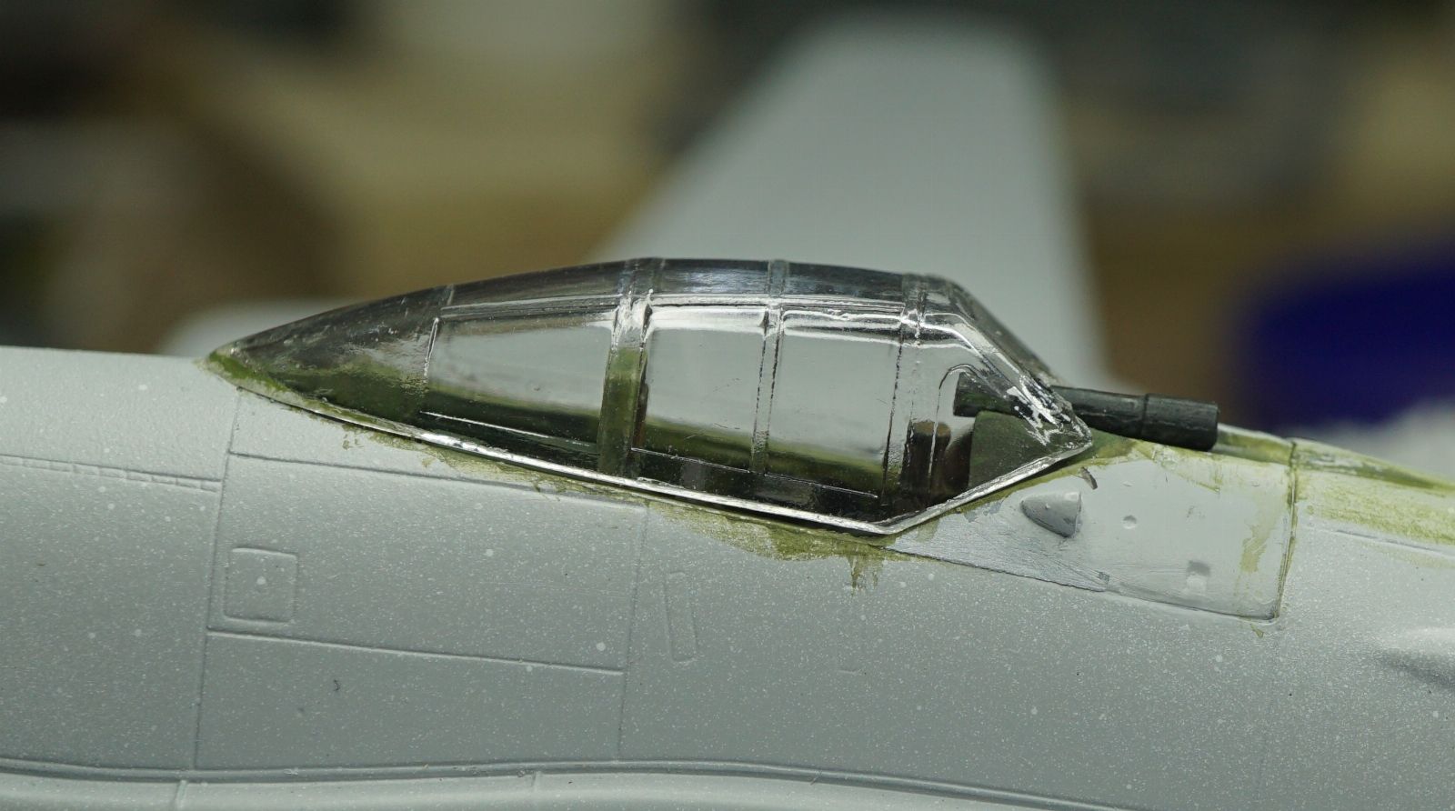

I popped the canopy off and removed some material from the fuselage to improve the fit ,,, well , the canopy no longer sits with the right side high but the fit is still awful .
Now to repaint and reattach the canopy .

I bonded the canopy down using acrylic medium .
I don't like any of the acrylic putties , so I was counting on the canopy being dipped in " Future " and the joint with the fuselage filled with more plastic protecting the clear poly from the lacquer putty .
I pulled the masking to check on things , now to re-mask and clean it up .
Heh :D , looking different-bad now .

Oh man... You literally sculpted some of the fuselage to fit the canopy! Oh well same on my ch53 I guess.
Is Tamiya putty ur favorite? I've only used the Vallejo one... Which is fine, but it doesn't harden as much as I'd like.
Yeah , the Vallejo acrylic putty , all the acrylic putties , can't harden like the lacquer putty .
I have a little bottle of the Vallejo and a tube of AK's - which is a polyurethane mix - for when I need to avoid the solvent in the Tamiya putty .
So far I prefer Tamiya's over all the ones I've used .
