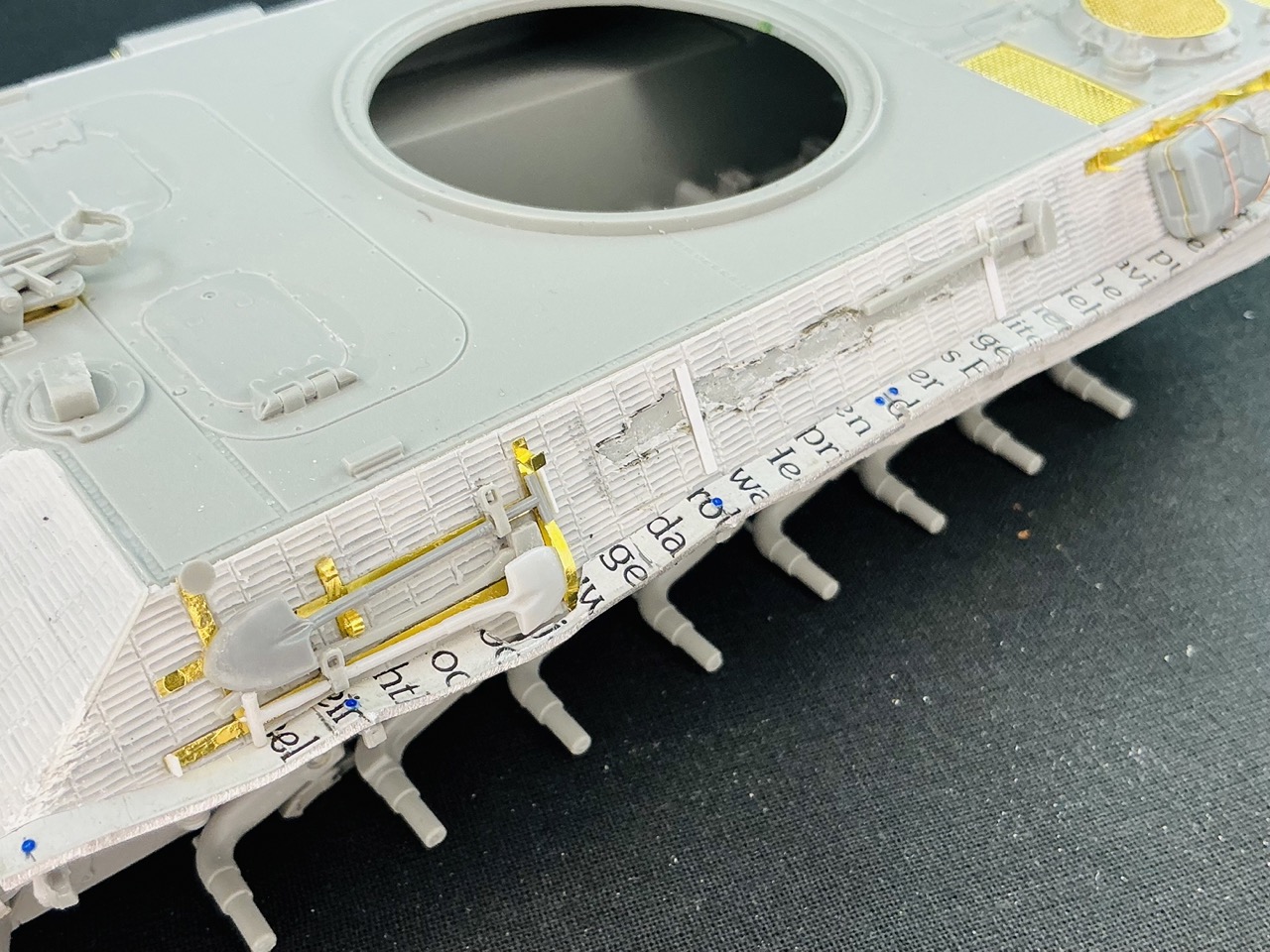

I noticed this when going back and forth through that footage to try and work out what stuff is tied onto the right-hand side of the tank. I made some progress with that stowage but I'm not there yet:

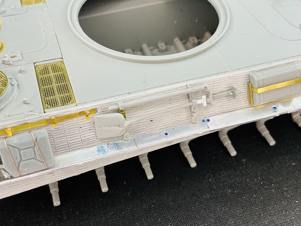

On the left, I added a second shovel (from the Tamiya set of British infantry on the move) and an axe (from a Sherman kit) because they're visible in the photo of Cuckoo driving down the forest road. That picture also shows the handle of something halfway down the left-hand side of the hull, and though I can't make out what it is, it was probably held in the rear clasp intended for the crowbar that sat above the tube for the gun cleaning rods (which was missing on Cuckoo). I decided to add the hammer from the kit, glued around a tool clasp from the crowbar, because it's plausible and sticks forward approximately far enough.
On the right, I converted a shovel I found in my 1:35 tools spares into something that can pass for a common Dutch shovel and glued it into the tool rack.

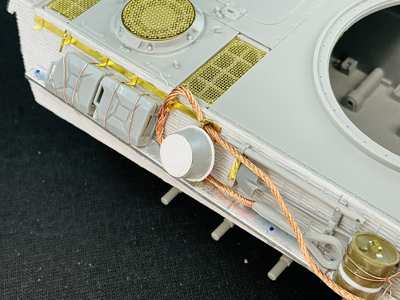

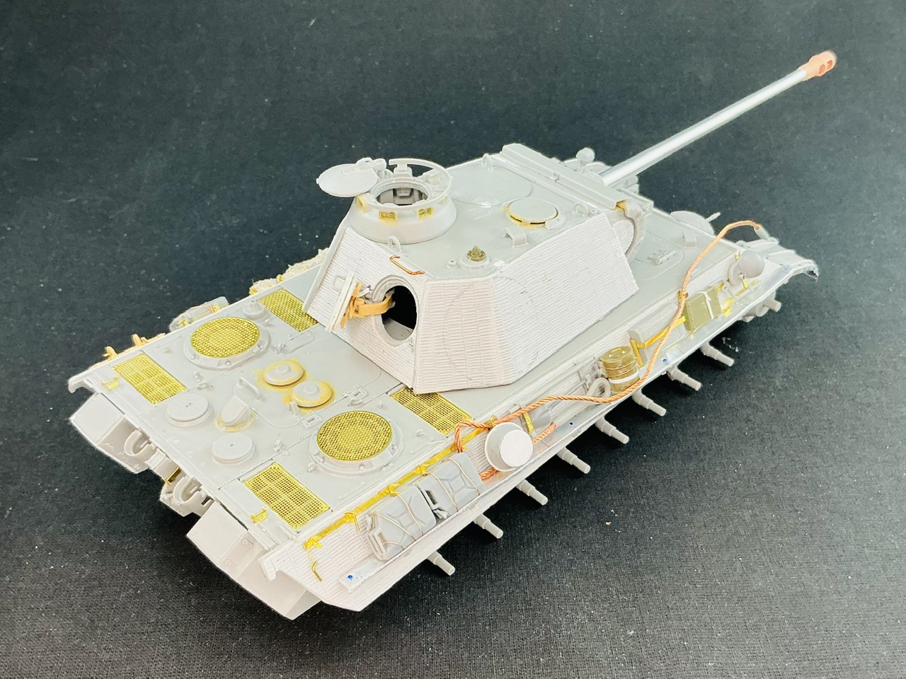

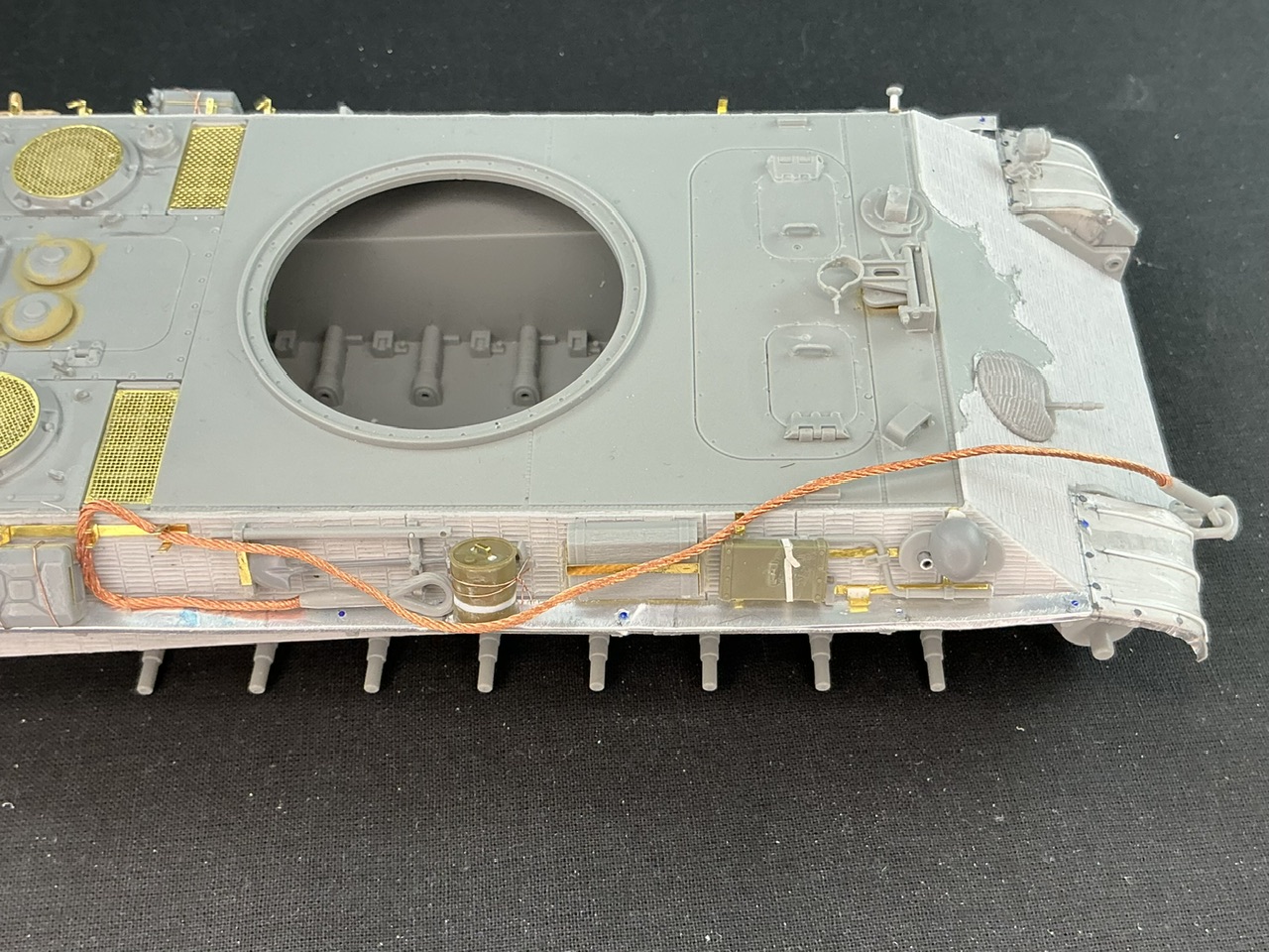

Finally, I've figured out the tow cable to my own satisfaction! :)
In the D-clasp at the front, then through the tow cable bracket at the top of the right-hand tool rack, down past the jack block, then in front of the thing stowed behind that (I'll get back to that in a bit), up in front of the shovel, through the frontmost spare track hanger, then around the second and back forward along the top of the side skirt rail.
I can't prove that the tow cable was stowed exactly like that when the film of Cuckoo was shot, but this is the most plausible way as far as I'm concerned, based on what is and isn't visible in those pictures.
I did have to scratchbuild a new front hanger, because during the various attempts to fit the cable, first the top and then the bottom bits of it broke off. That's what you get with small etched parts with folding lines :( The fix was to take a bit of leftover fret, drill two 0.55 mm holes near the ends (the ones in the Dragon parts are 0.5 mm) and bend it into shape before sticking it to the model.

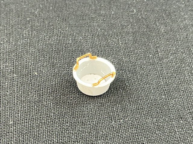

I also made the wash basin:
This started as a bucket in the Bronco set of British accessories, from which I sawed off the bottom half. I then made two discs from 0.25 mm plastic card using my oversized punch-and-die set, one for the bottom and a second for the top that stuck out a little along the bucket's rim. Once the glue was dry, I stuck a knife tip through its centre and cut away everything inside the bucket. Then all that remained was to add two handles from bent copper wire.
Here it is on the model, for which I stuck one handle behind the L-shaped pin through the bracket that also holds the tow cable:
I made that pin from 0.45 mm brass rod, just bending it with pliers to the dimensions of the plastic pins you get with the kit. I put a pin like this in just over half of all these brackets, but I still want to add the little chains you get for them in the etched parts.
Then we get to two two remaining items on the right-hand side of the tank, that I had a hard time figuring out, so I took an educated guess and made them things that have approximately the correct dimensions and which seem plausible:
At the back (left) an oil can, at the front a jack block from a Churchill tank. I'm not certain about the oil can, but the film does show that the item here sticks out beyond the side skirt rail, and it also gives me the impression that it may be circular. The can I used is from Tamiya, and at first turned out to be too tall: after I glued it in place, the turret couldn't rotate without sweeping it off the tank. So I sawed it in three pieces to remove a section, but I had taken out too much, which I solved with a piece of 1 mm plastic card that I trimmed to size once the glue had dried. A bit of copper wire ties it to the tank.
The Churchill jack block is because I had first measured the approximate size of this item in images of the real tank, and when digging through spares to find something of around that size, I found this block from an AFV Club Churchill kit. Its dimensions are very similar to whatever was on the real tank, and Cuckoo did belong to a unit equipped with Churchills — and though I can't think of a reason why they would take this when the Panther's jack block was still present, I think it's plausible enough.

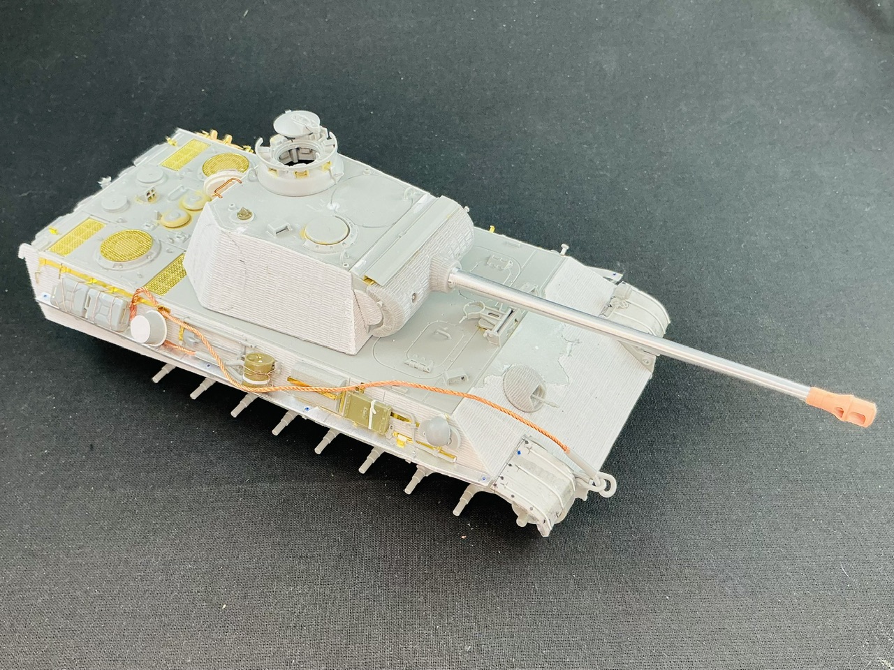

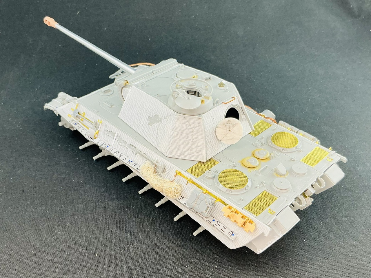

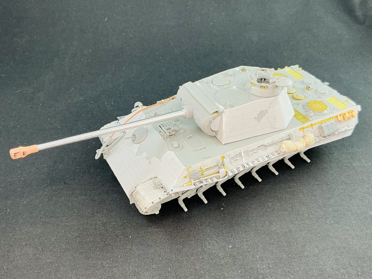

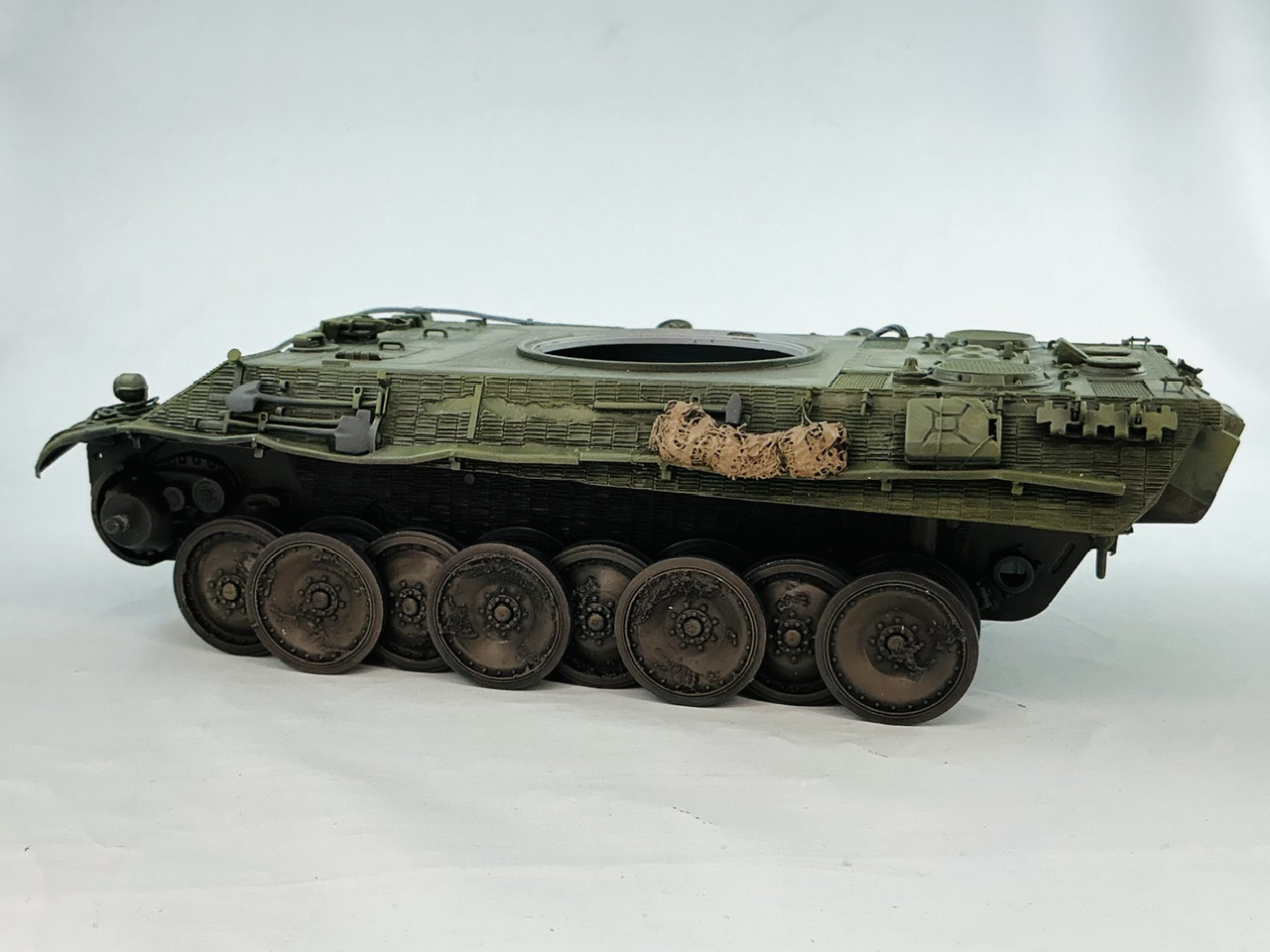

I think I'm done building the model now. Well, except for the wheels and exhaust pipes, which I'll only add after painting, and the tracks, that still aren't cooperating :(

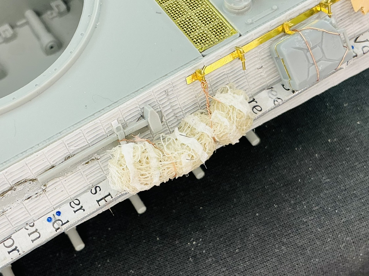

On the left-hand side, I added a rolled-up camouflage net, the old-fashioned way by soaking a bit of bandage in thin PVA glue, and while it was still wet, rolling it up and tying it in place on the tank with more copper wire. The jerrycan on that side is now further back than before, because when I looked closely at the film footage of Cuckoo from the left, I noticed that there appears to be the net, then a gap, and then an item. I can't tell if it's actually a jerrycan or the bag-like thing that's visible there in the photo taken in Tilburg, but as I already had the jerrycan but no bag, I took the easy way out :)

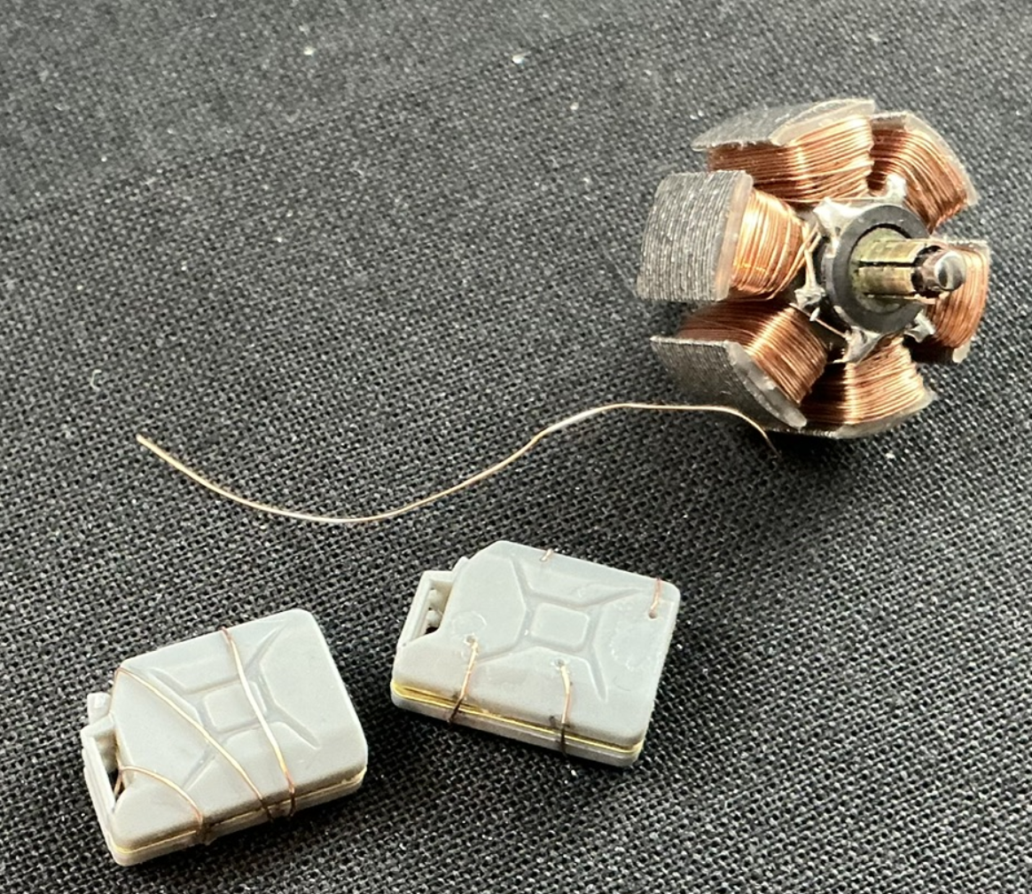

I did try to add etched chains to the pins in the track hangers, but I had a great deal of trouble doing that, and when I finally got one in place I could hardly see it anymore, so: too bad, but I'm not going to bother with them. There's just one on the right rear, because I put a loose-hanging pin there, which makes the chain a little more obvious.
The pencilled circles on the turret sides and roof, BTW, are where the white stars will go. I'll probably only add them after painting, but I drew them now to get an idea of where they will go. This mainly because I was checking if it's possible at all to put a white stars on the turret roof in such a way that both the left-hand Pilz and the left front lifting eye end up being painted white. And yes, it turns out to be exactly like that if you draw a ring as large as possible on the roof in front of the commander's cupola :)
After a comment elsewhere that a British camouflage net should have strips of hessian in it, which I had considered but decided against because of the difficulty in weaving it through the mesh of the gauze bandage, I took the advice anyway and glued some strips to the net:
I just cut a strip, maybe 2 mm wide, from a paper handkerchief, peeled the layers apart and then cut one of those into different lengths. I then put each piece into some thin PVA glue, placed it on the net and pressed it in place with a stiff brush. Roughly three minutes' work, I guess :)
These have been soaked in PVA, so even if the paper melts away, there should still be that left ;) OTOH, if they do disappear without a trace under the first coat of primer, I'll just try again — it's not like this is a part of the model that will be very hard to do some additional work on.

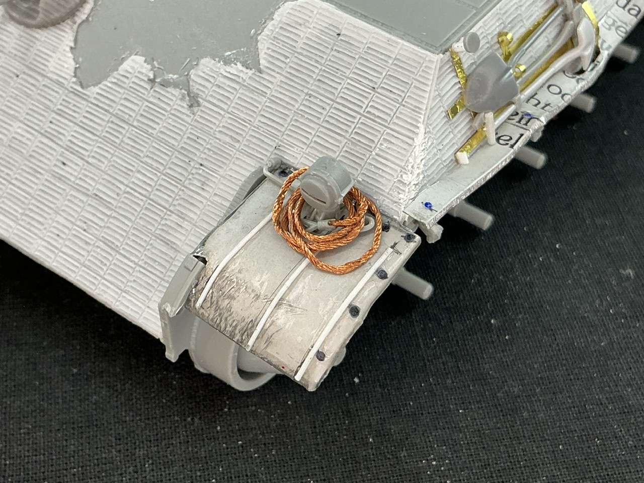

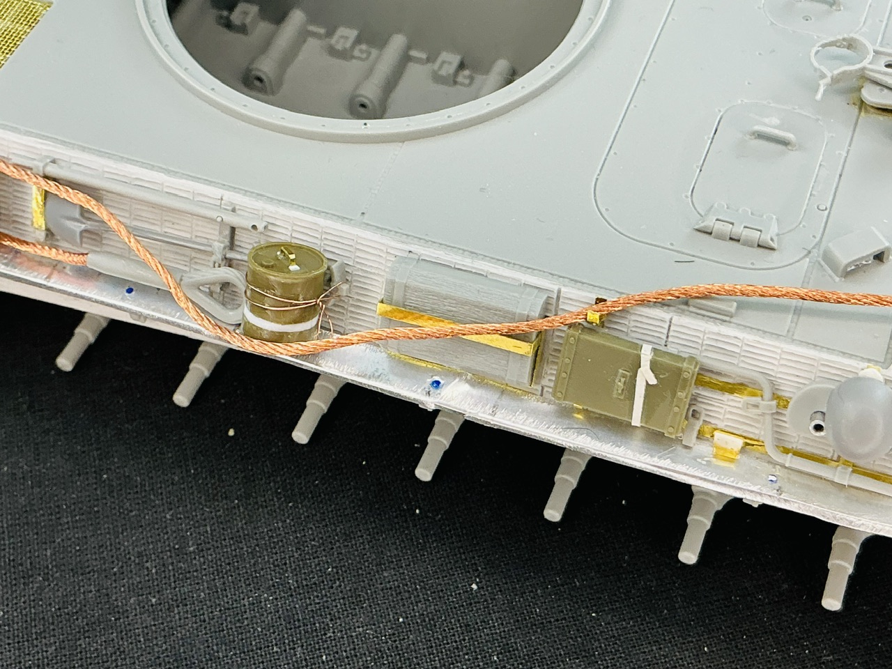

Tonight I had to quickly add the last thing I had forgotten:
This is the cable that should be fitted on the right-hand side, wound around the round brackets that I put the oil can in/against. In the picture of Cuckoo on the forest road there's a similar cable wound around the headlight, and this one seems to fit the bill quite nicely.

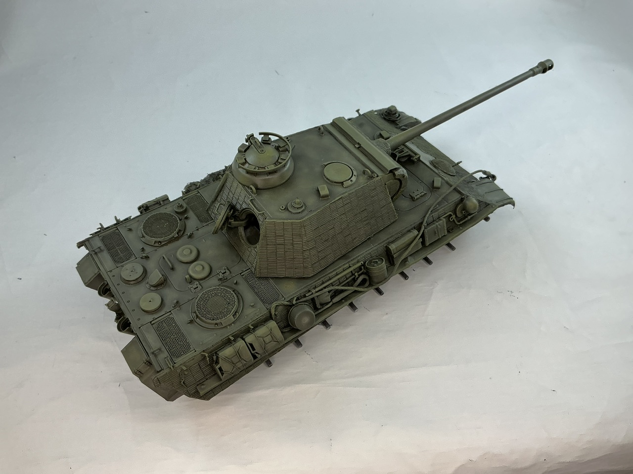

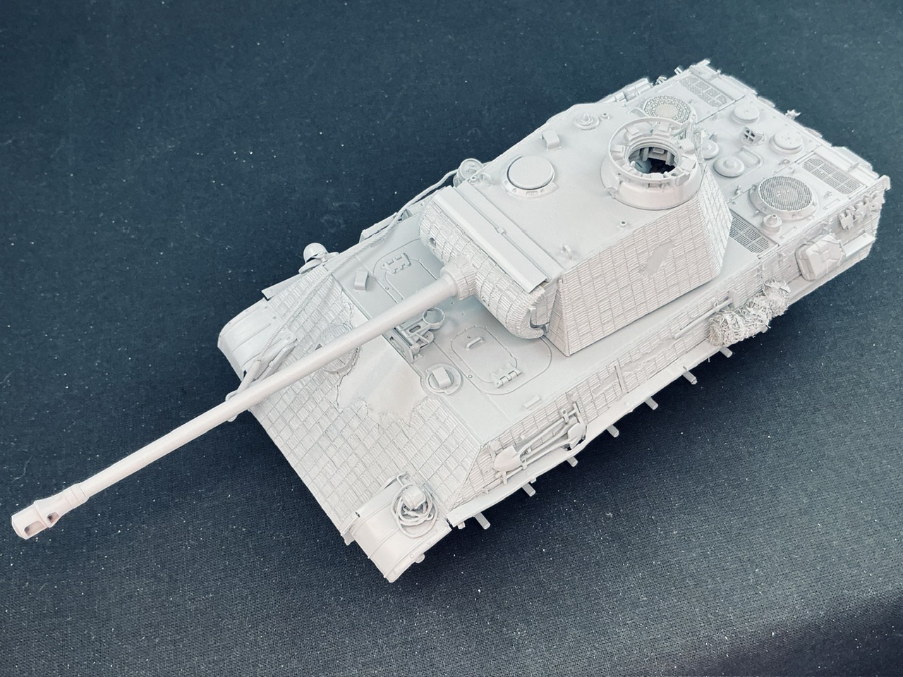

That is to say, I sprayed a couple of coats of grey primer over the whole model :) Nothing fancy, but "Spectrum" brand primer from an Action discount store, and that cost me all of, IIRC, €2.99 for a 400 ml aerosol can. But it covers well, and dries quickly and hard. However, when spraying it I realised I should have gone for white instead, as the grey was almost the same colour as the plastic so it was hard to see whether I had missed some spots.

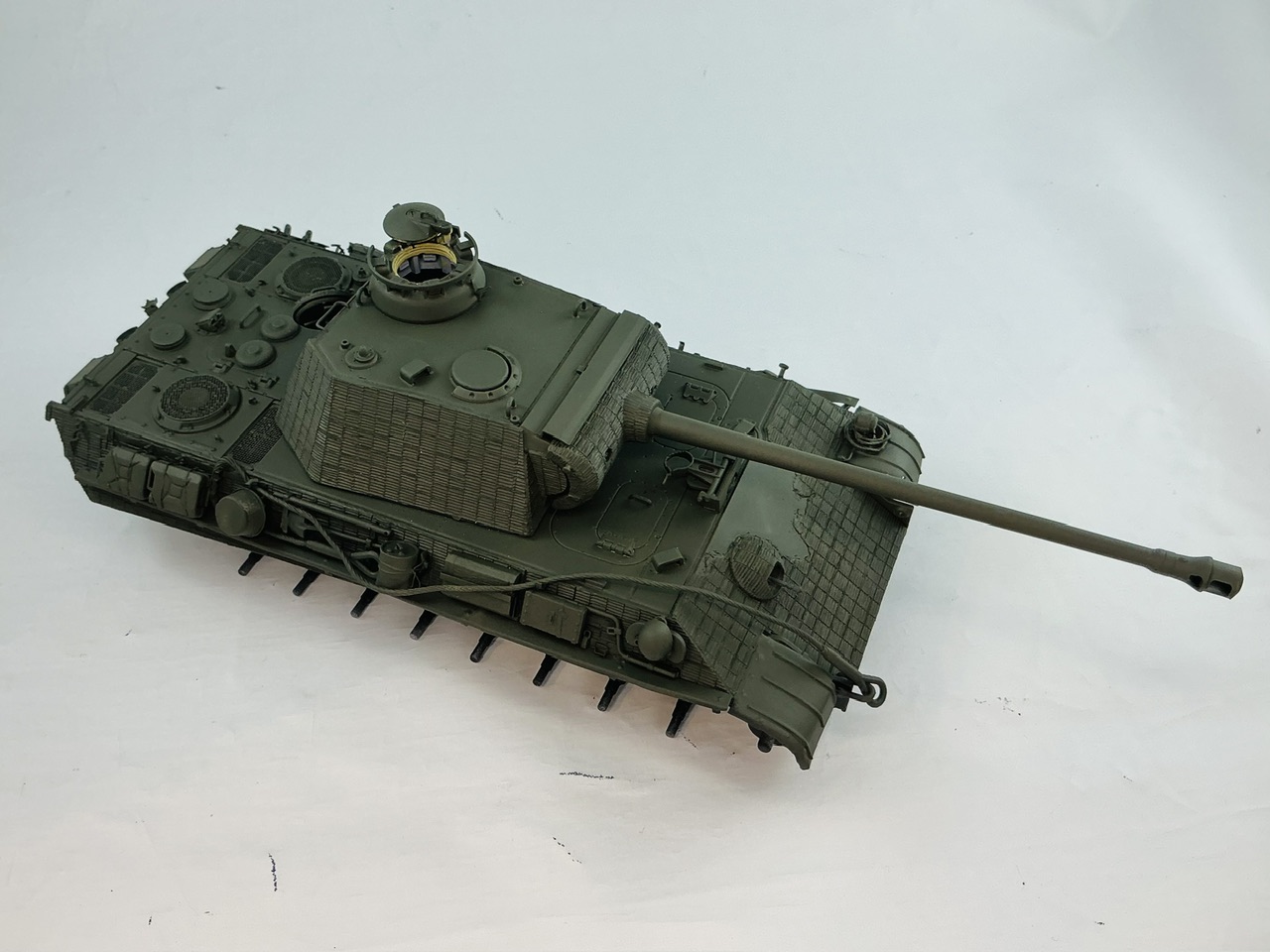

On to the real colour! I sprayed most of the tank with SCC 15 British olive drab from AK 3rd Gen:
This is why I got out the white background again, because with the black one I doubt the colours would be very good in the pictures. That Zimmerit, incidentally, doesn't make spraying any easier. You have to do it all from at least two sides to make sure there's paint everywhere. Before I sprayed the tank, I painted parts of the commander's hatch in Tamiya Dark Yellow 2, so that the bits that would be covered by the closed hatch would keep that colour. I don't know if the real tank was like that or if they touched it up after spraying it, but the model is more interesting this way.

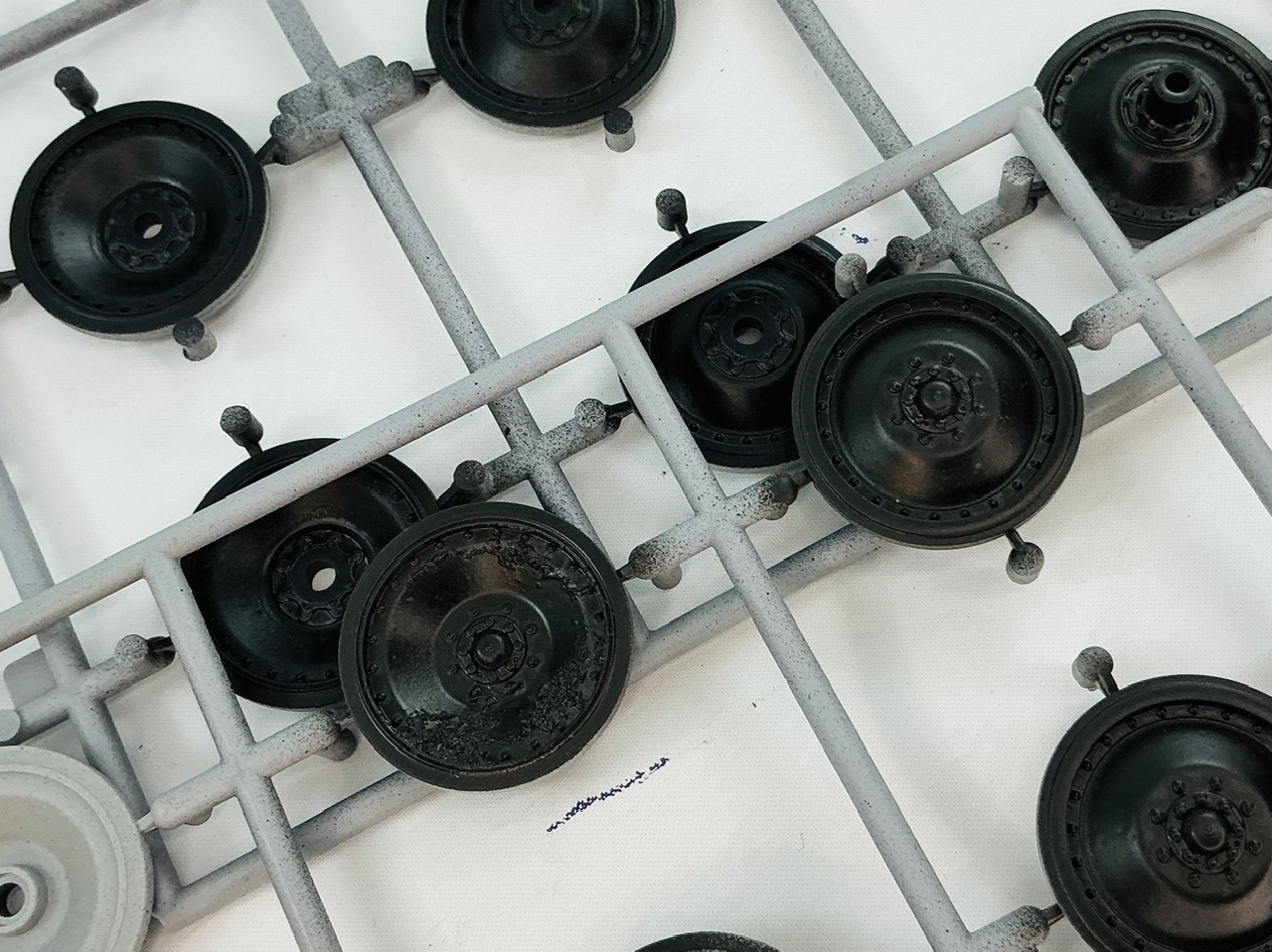

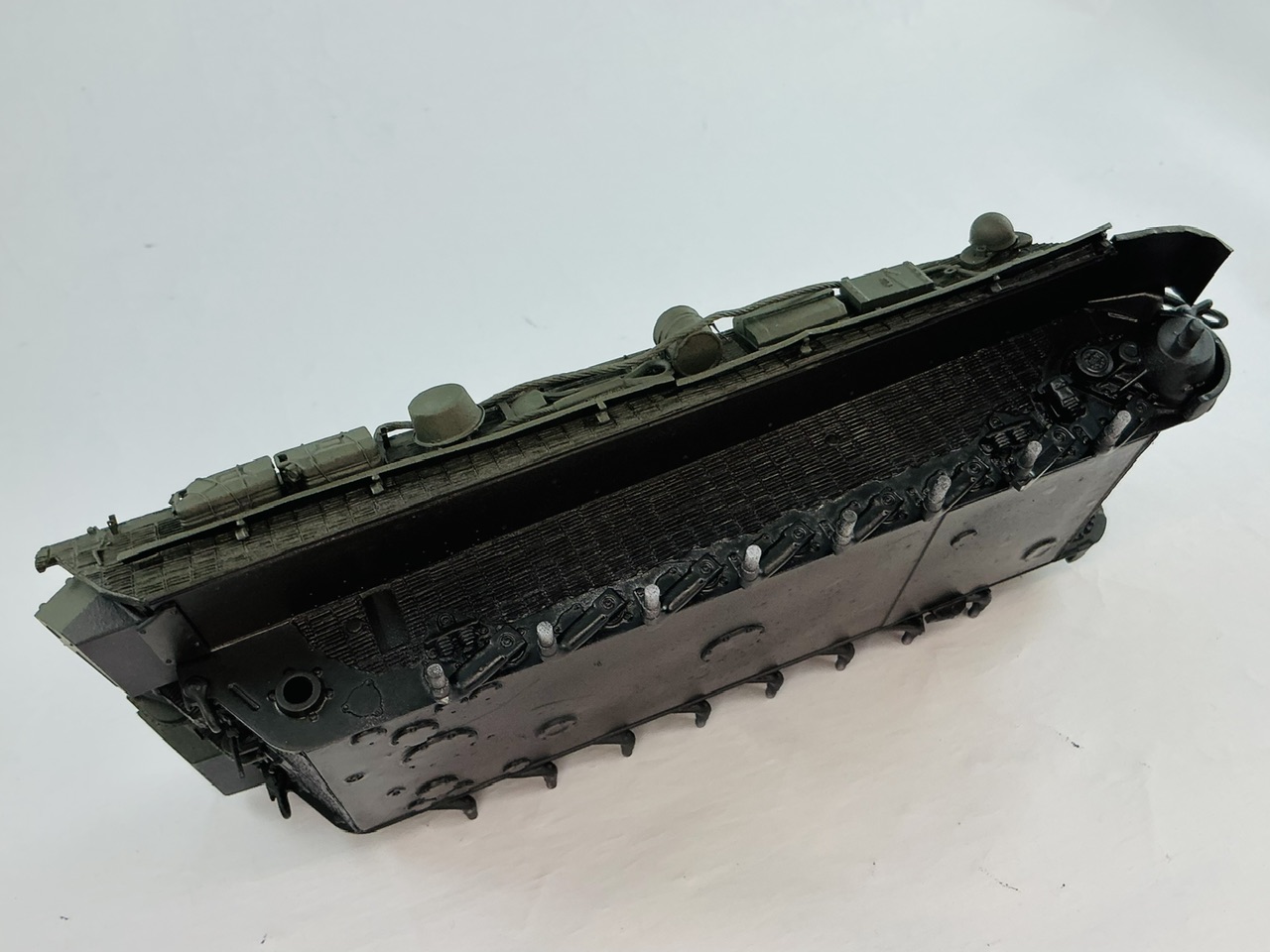

The bottom of the hull got a coat of black, after I got advice from a fellow modeller with a background in soil types about the colours of the soil in the area of the Netherlands in which Cuckoo operated. Some of the soil there is very dark, black-brown, and since photos of Cuckoo show its undercarriage to be darker than the upper parts, I figure it was probably covered in thin mud of that sort of colour. Thus, I sprayed it black:
Though slightly more involved than that :) The parts that will be behind the wheels are simply black airbrush-ready paint from AMMO, while the bits higher up and more in the light, I sprayed with that same paint with Field Drab from Vallejo Model Air mixed in. The proportions were more or less random as I did this by eye, but probably around 1:1, though it obviously varied every time I had to refill the paint cup.
The difference is very hard to see in the photo above, but I painted the wheels the same way, and it's clearer there by holding them side-by-side:
The inner two rows of roadwheels are simply black, while the outer two and the drive sprockets and idler wheels are the lighter mixture.
Thanks, though I think I will need to lighten the mud a little, to avoid it becoming completely black by the time I've shaded it. Hopefully later today …

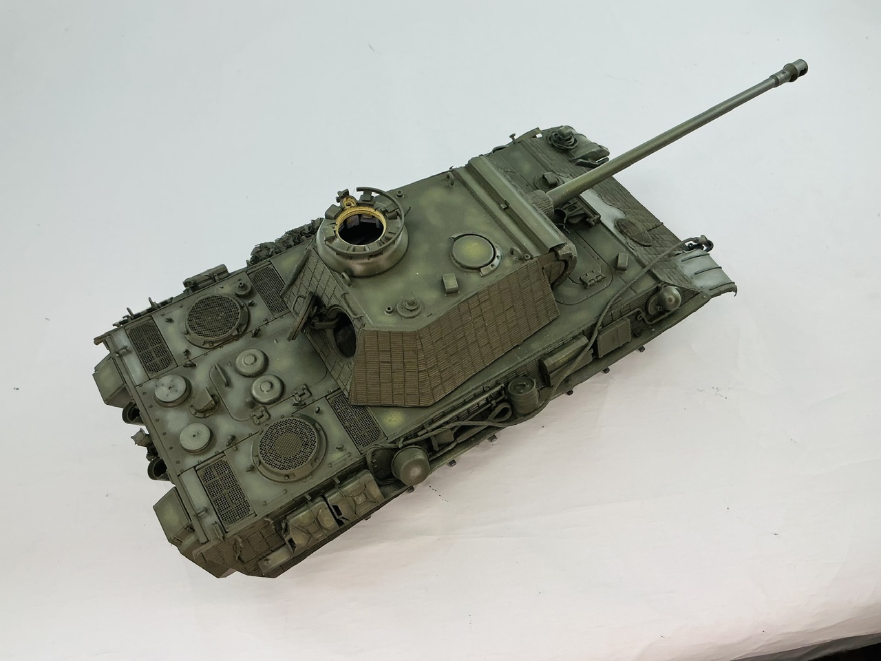

I wouldn't say "nearly" just yet myself :) The next step was to spray lighter patches onto as many surfaces as possible:
I used Mig IDF Green for this on the olive drab parts. On the wheels that were already lighter in colour, I did the same with Vallejo Armour Brown, but after looking at the result, then sprayed them entirely with that, as well as putting it in some areas on the lower hull, before adding lighter bits from the same colour mixed with Field Drab. This way, the wheels are still dark brown, but not as dark as before.

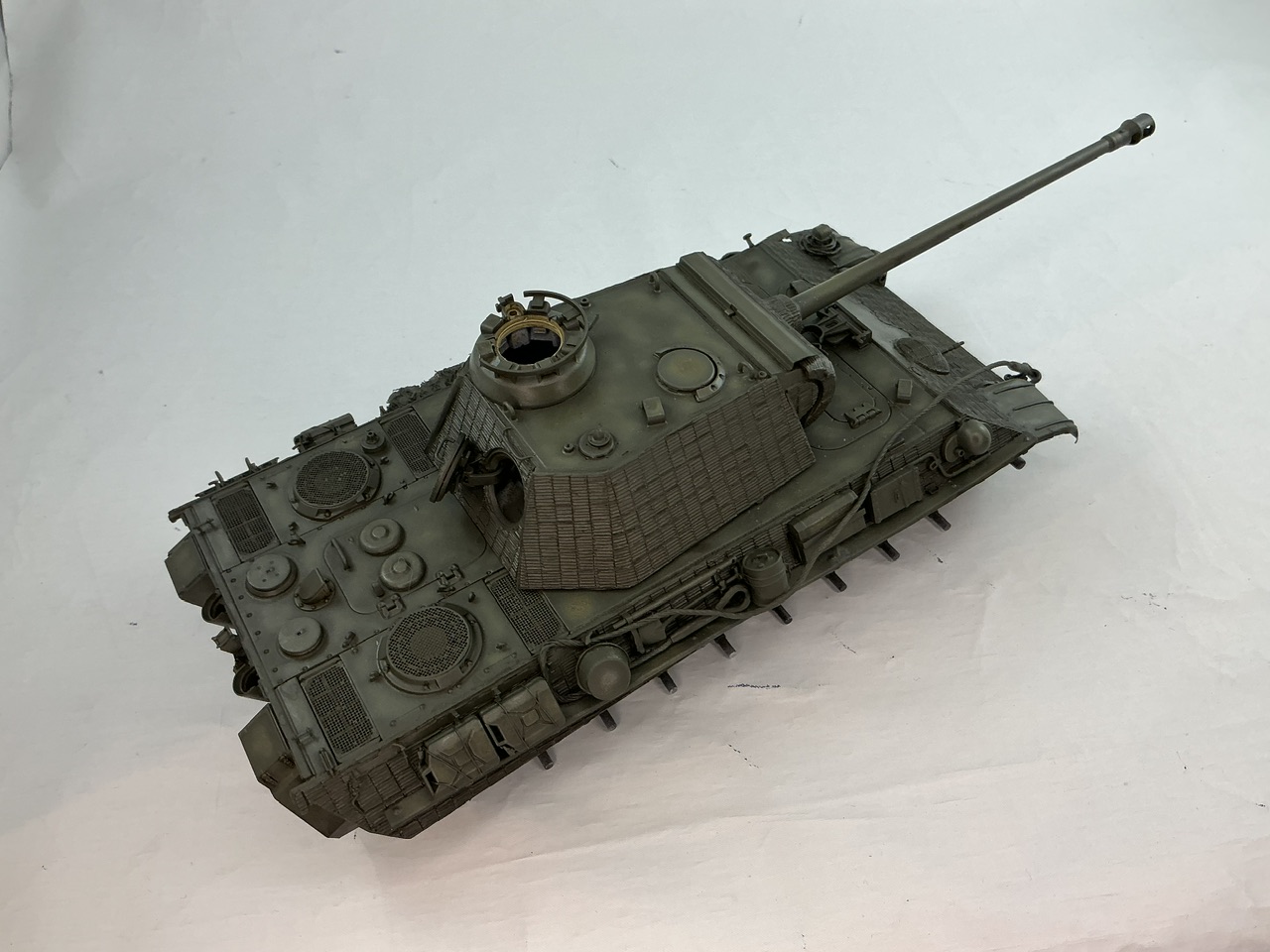

I seem to be on a roll with this one :) After the lighter sprayed patches were dry, I put some washes over the model. First Army Painter Strong Tone (a translucent dark grey, like Tamiya Smoke but not glossy) over the olive drab, and before that had dried, their Dark Tone (translucent very dark grey) over the mud. Both of these I thinned roughly 1:1 with water, because they're usually too strong if used straight from the bottle:
It's not really that apparent in the photo, but the whole model is now darker and there is shading around details and inside grooves etc., like all of the Zimmerit. The next step was to highlight it:
All of the OD was drybrushed with Humbrol 86 Olive Green first, followed by a lighter pass with 159 Khaki Drab. The undersides, on the other hand, got a coat of 98 Chocolate first and then very lightly with HB2 Dark Earth. Yes, HB2, not 29 — the 159 is a Super Enamel tin from maybr 25 years ago, all of the others are older still, if not a lot older :)

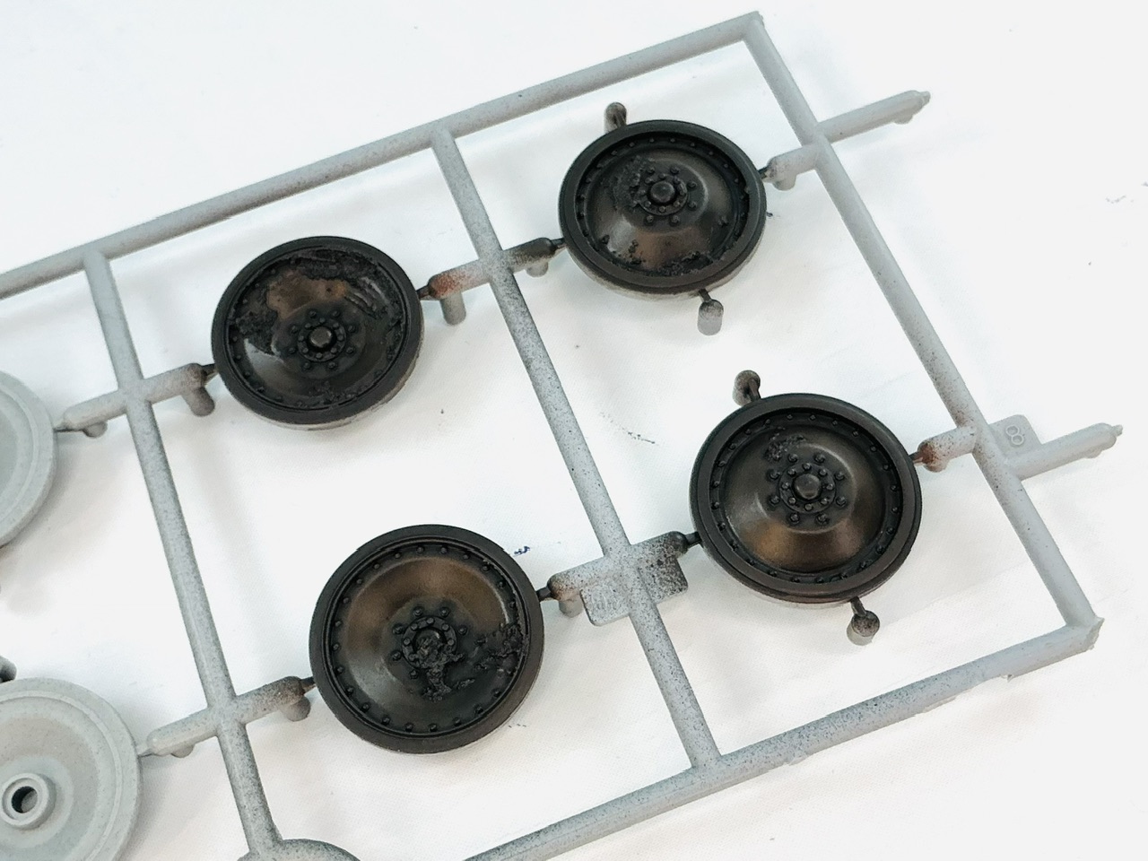

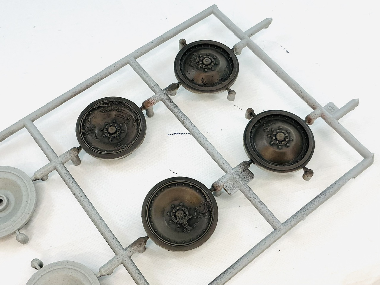

Here the wheels. I first put on a coat of Army Painter Dark Tone, but unthinned because it proved to be too light when I did a few wheels with the thinned version first:
And then I drybrushed them just like the mud on the hull:

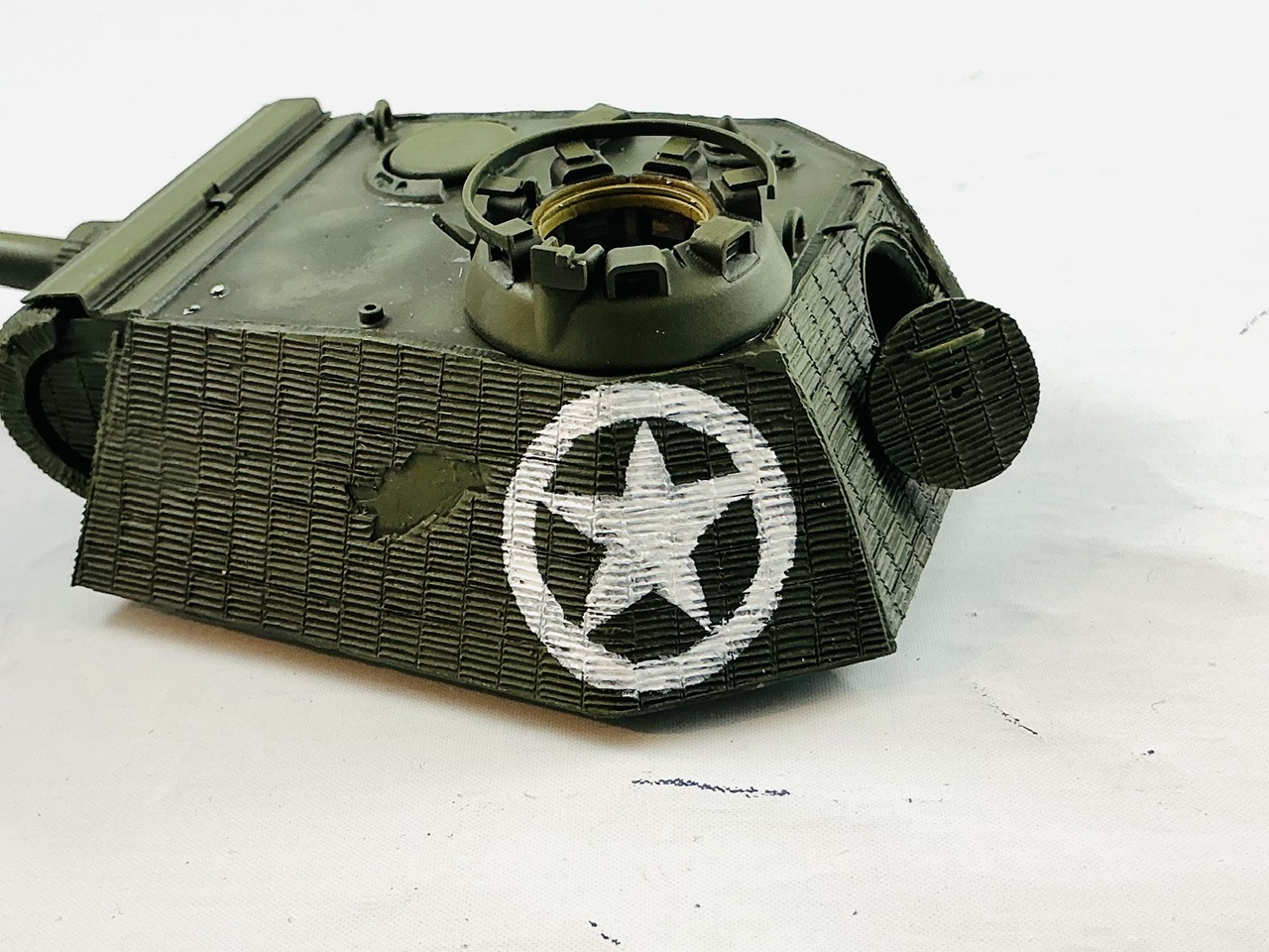

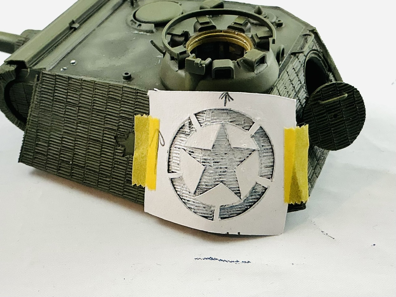

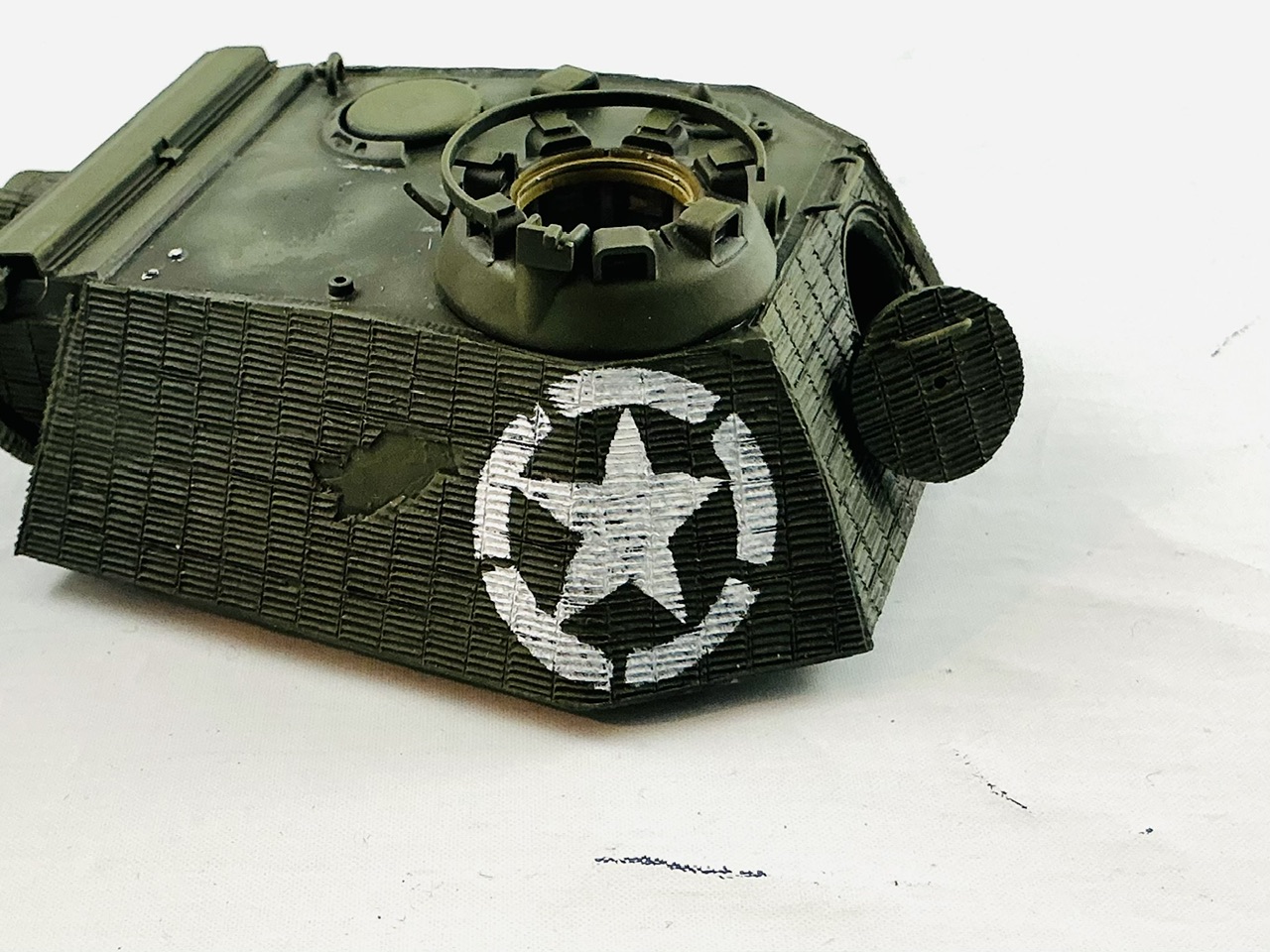

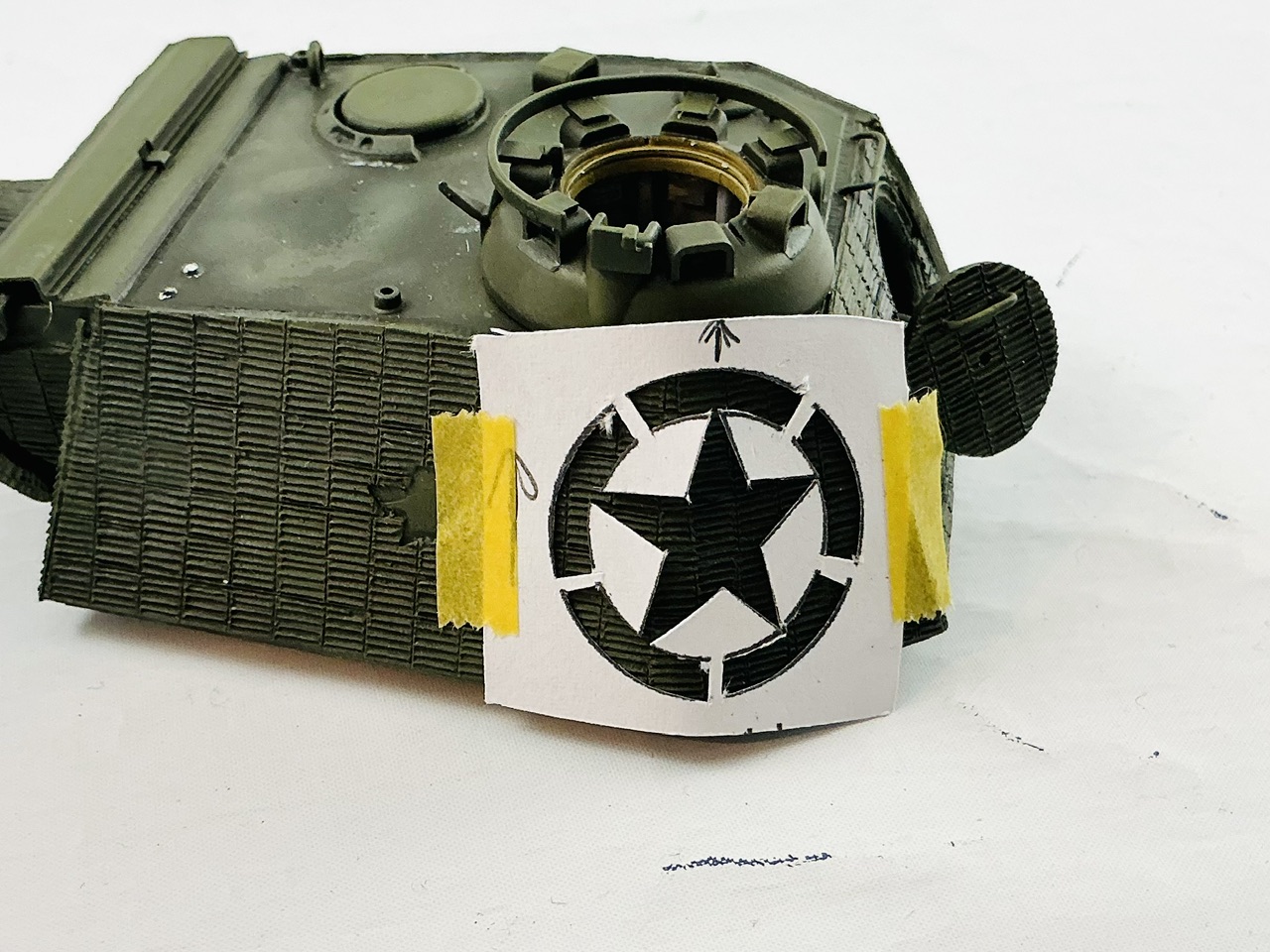

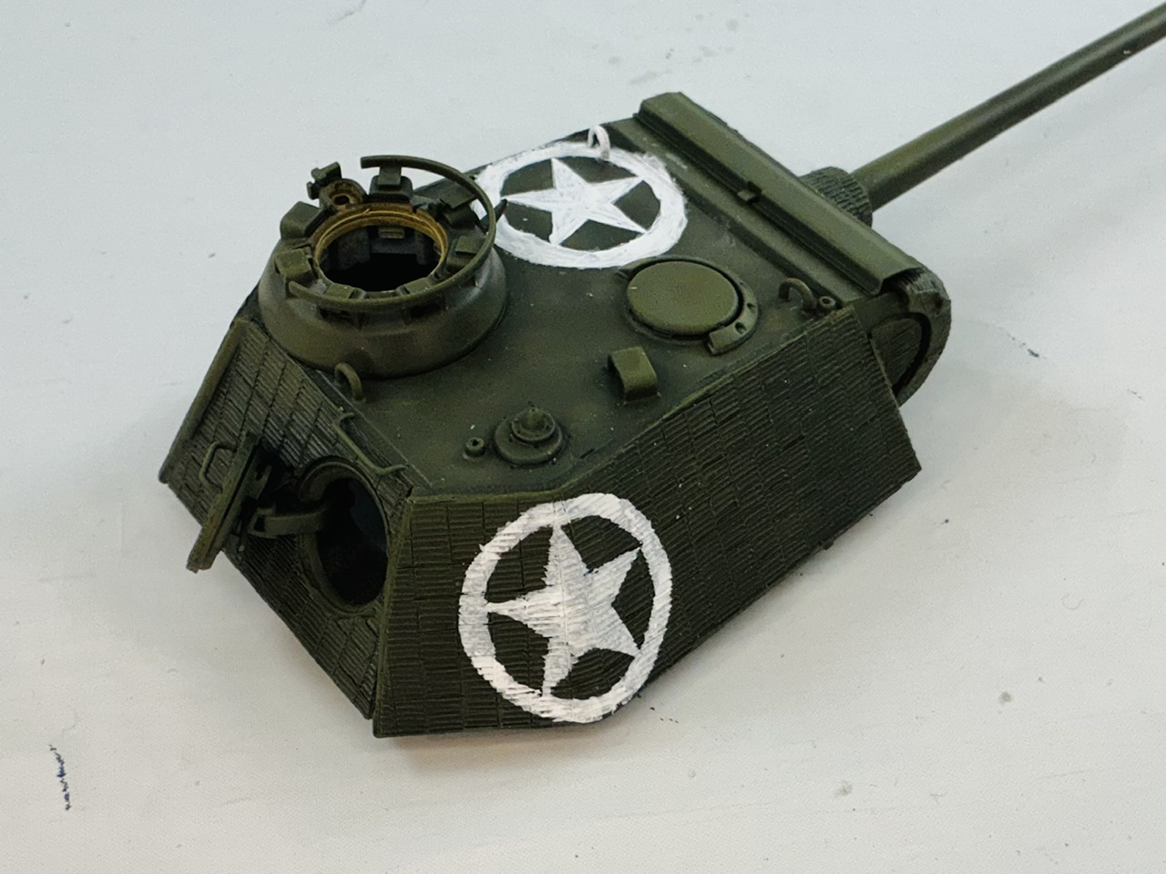

I've also been busy drawing the markings in Illustrator so that I could make them into stencils. Here the star on the left side of the turret:
You could spray it like this, but on this surface especially, that doesn't seem like a good plan to me: because of the curve in the armour plate, the stencil fits poorly while the Zimmerit doesn't give a smooth surface underneath — you'd get a lot of overspray. This is why I instead used a brush. White paint on a short-haired, broad brush (a drybrush-brush of about 6 mm diameter) and then dab paint on through the stencil:
Then just remove the stencil, and:
After that, all I had to do was use a fine brush to fill the gaps and repair minor defects, as well as increase the coverage a bit:
I then did the other side and the roof:
For the star on the roof, I first broke off the lifting eye at the left front, because it was very much in the way of the stencil. After painting on the star, I glued it back and painted it white (except the outboard bit, as can be seen in the photo of the real tank). That there are still brush marks showing is not a problem, chances are they were on the real thing, too.
This is why

I'm not sure they need to be toned down, but maybe I'll add a slightly darker wash over them to shade them better. I'll have to see how they look tomorrow :)

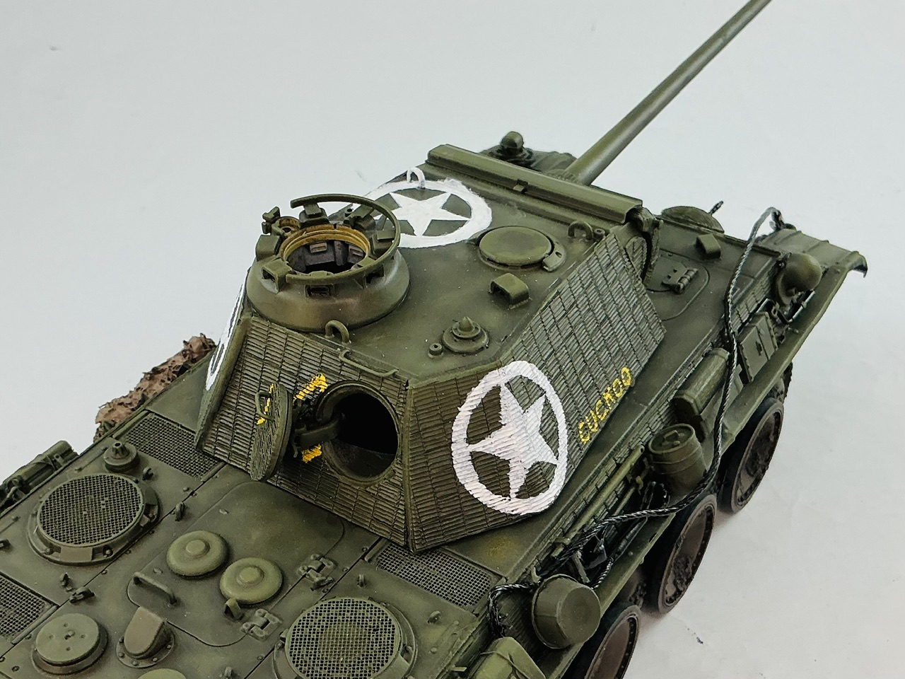

After some industrious painting in my attic hobby room:

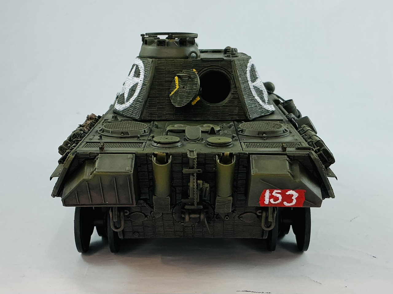

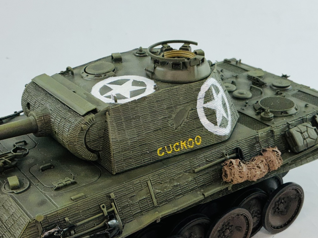

… I finished the markings:

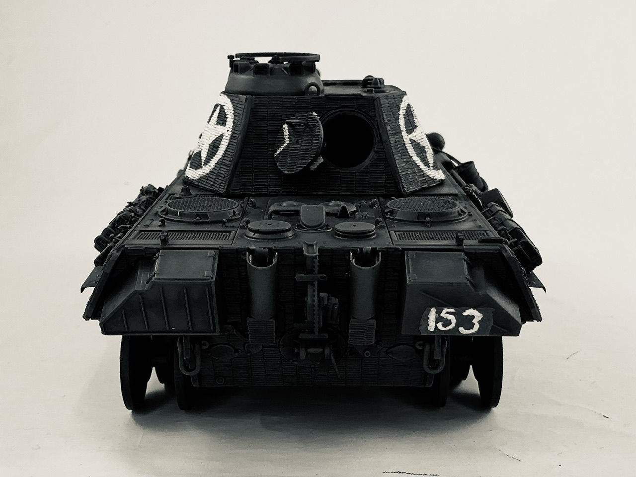

I had also made stencils for the name and the diamond on the rear of the turret, but ended up painting them by hand instead. The name is too small to cut out (at least with a hobby knife, though maybe a cutting plotter can do it) and if I had wanted to use a stencil for the diamond, I should have kept the rear hatch unglued.
For the arm-of-service number on the back, I first painted a red background. It's debatable whether Cuckoo had that, or only the number 153 in white, but my thoughts are that red would probably be hard to see in black-and-white film. To illustrate, here's a mock-up of that with the last picture above, but now with the standard silver-tint filter applied in my iPad's camera app:
