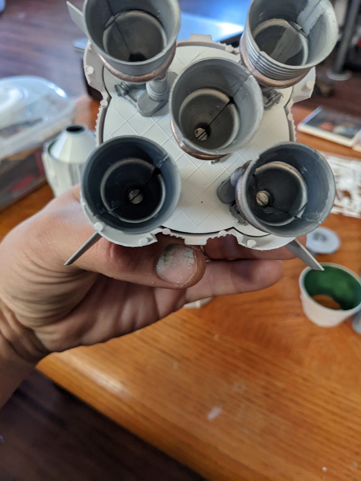

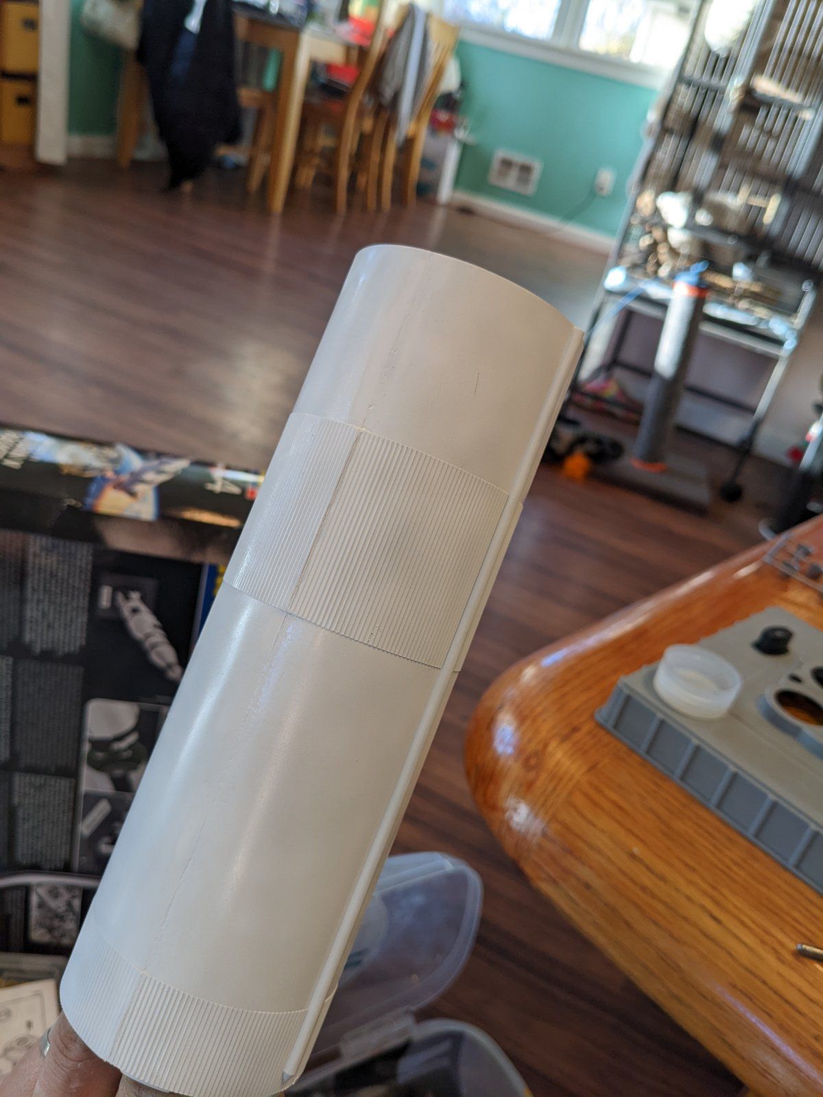

I wound up getting a Saturn V kit that I had been considering for some time PXL_20221107_201843970.jpg
The kit seemed to be a decent deal and above average quality from the reviews but three days into the build and I've made little progress.

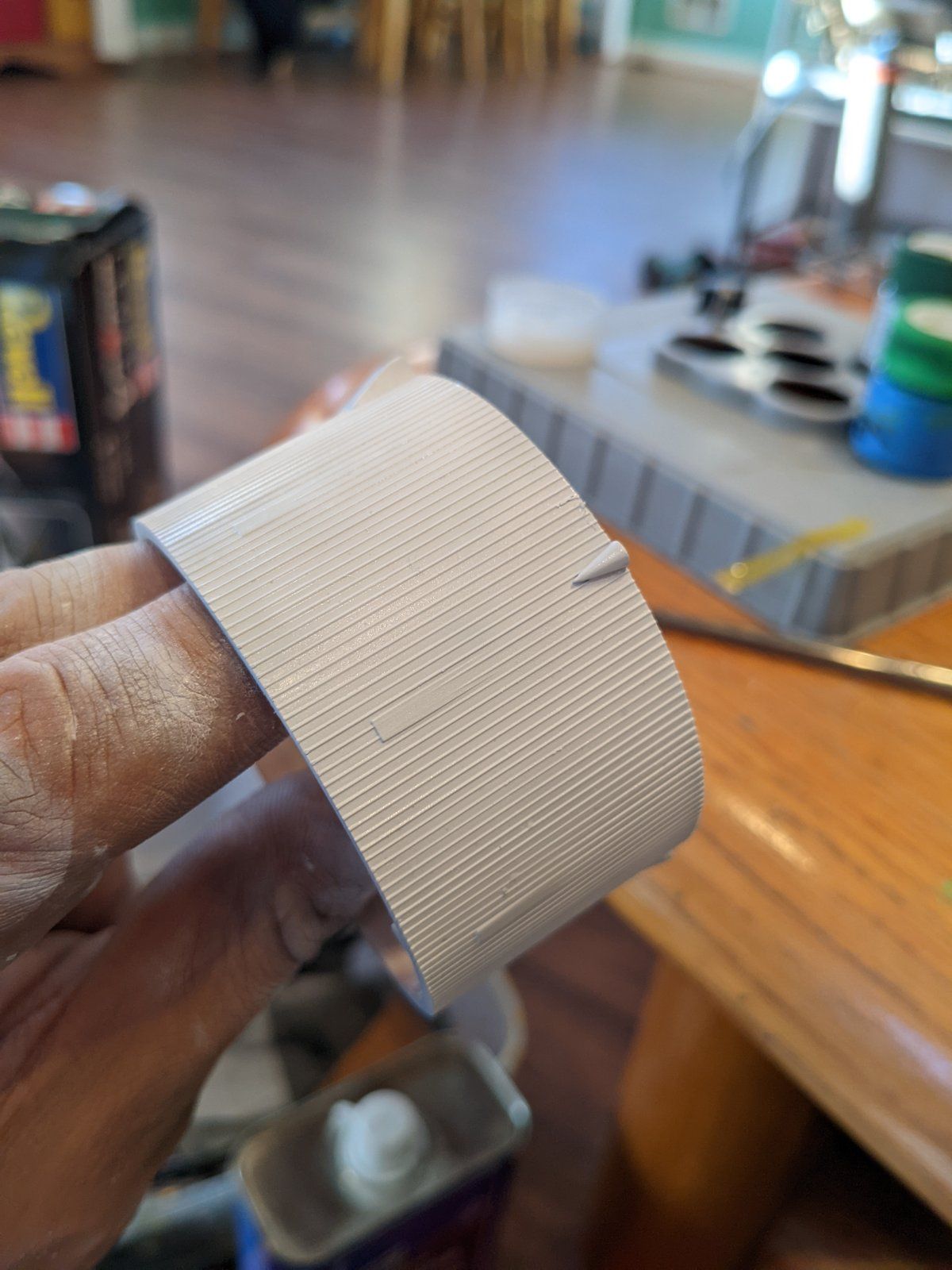

For starts the kit is very simple in that it doesn't have a lot of delicate or intricate parts, how ever it makes up for this in the over all size of the pieces which have a lot of surface area to cover with paint and like the A-10 have plenty of parts that should be painted prior so that's also fun times .
Some fun facts the kit has crazy seam lines that almost make it more toyish then model replica and also revell takes the liberty of going with a very very basic color scheme and not an accurate to the real world Saturn v so a little research on reference photos and for those looking for a realistic build you might want to consider buying some after market parts.
On a different note when it comes to painting White is not a privilege sorry for those that are gonna be offended but also not really sorry..
When I started painting I used a red brown primer I had laying about but quickly realized that was a bad idea cause white covers horribly .. so I switched to my Mr Surfacer 1000 grey which is better but again not perfect I originally was going with a Matt finish but didn't have enough flat white so I went with a gloss Tamiya white and again white sucks especially covering large surface areas my airbrush only covers a small width of the surface so painting White means every error or uneven coverage sticks out like a sore thumb..PXL_20221107_201501545.jpgPXL_20221107_201449563.jpgPXL_20221107_201433856.MP.jpgPXL_20221107_201423999.MP.jpgPXL_20221107_201459231.jpg
On top of white being a pain to cover large areas with my small compressor running for extended periods of time has started to heat up causing moisture build up past the filter and creating splatters so I have to take breaks and let it cool down so I'm not battleing my self

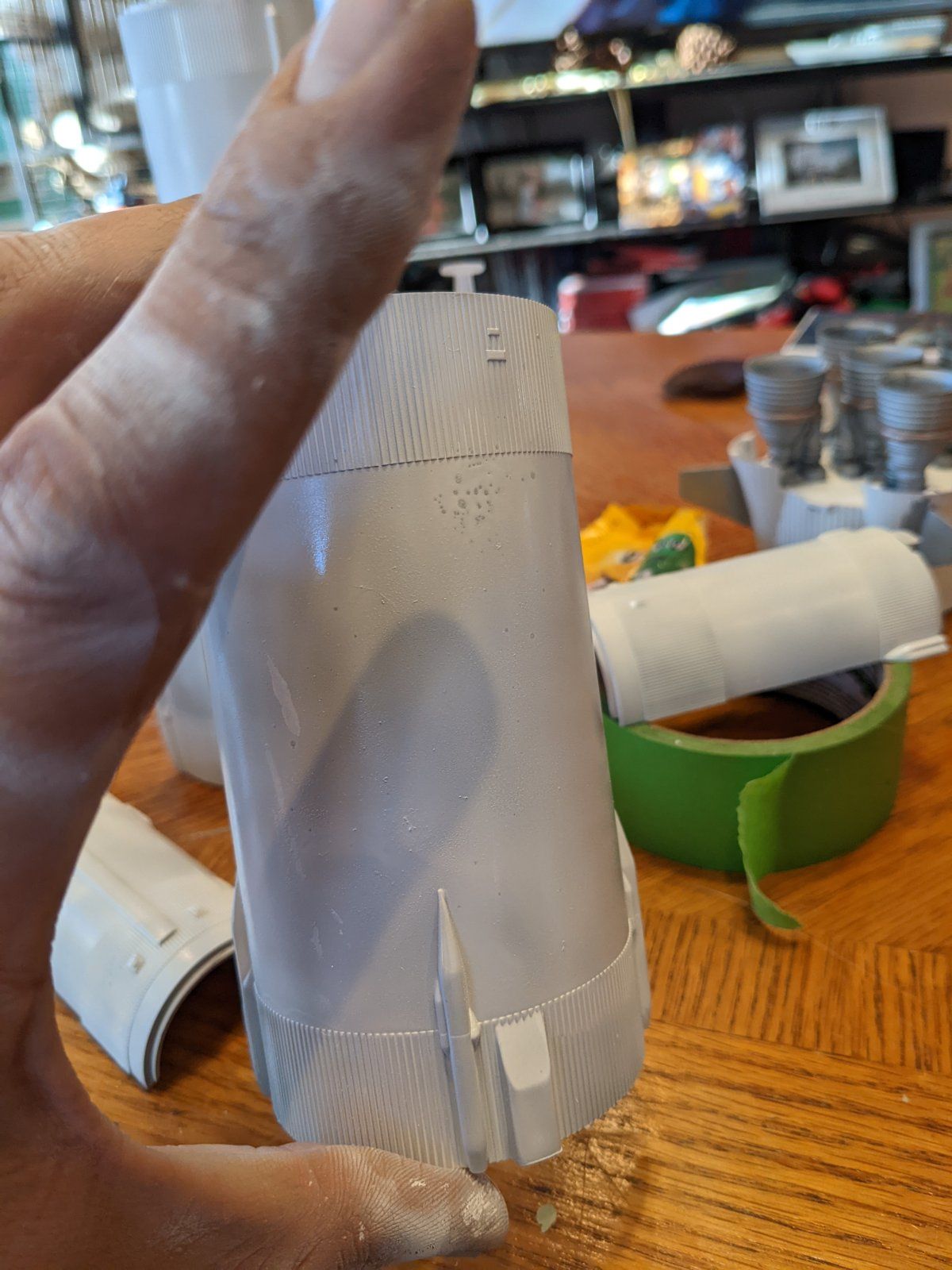

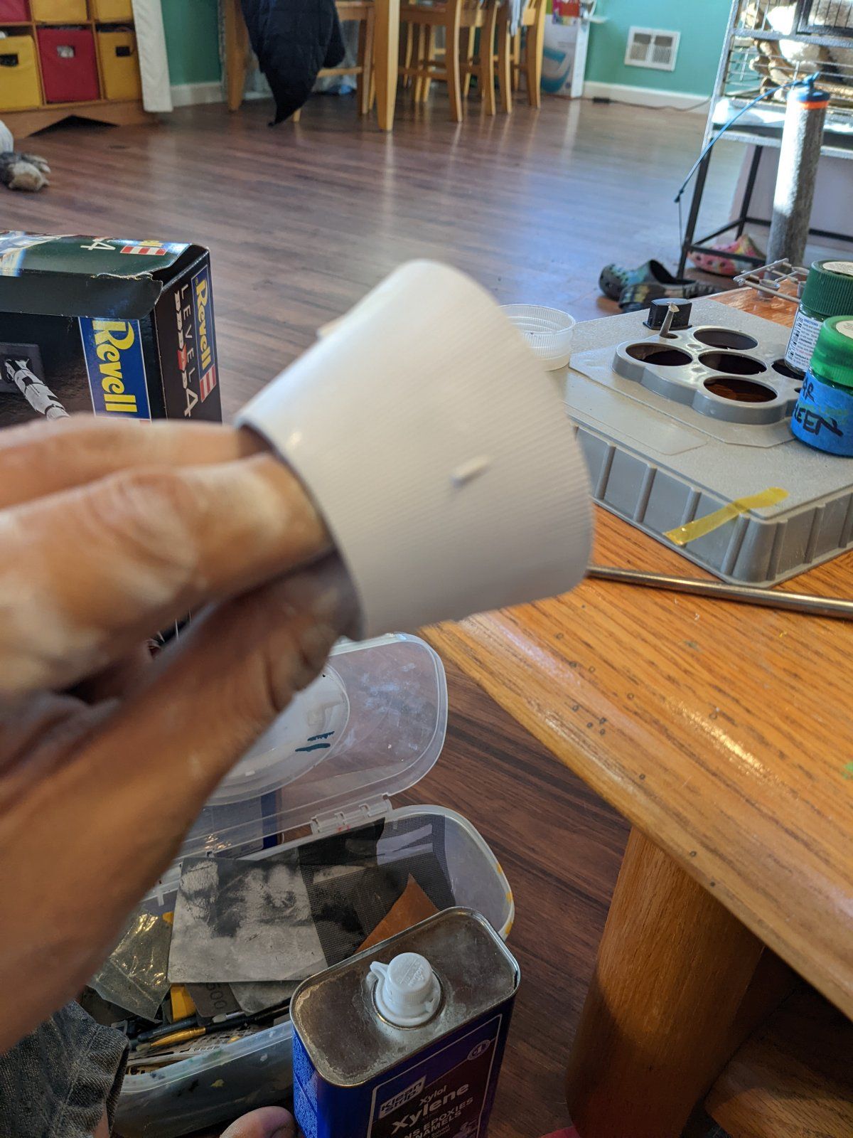

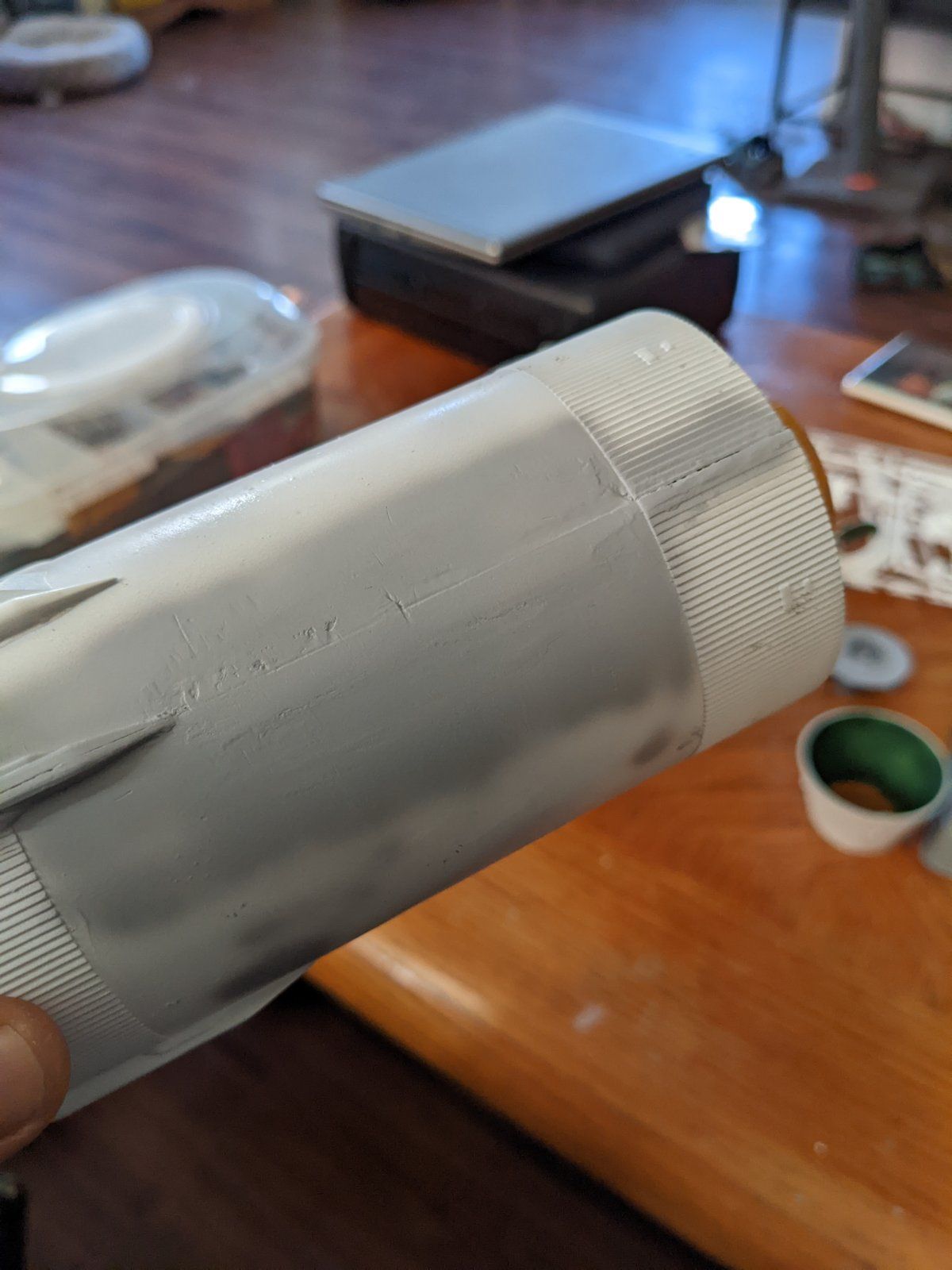

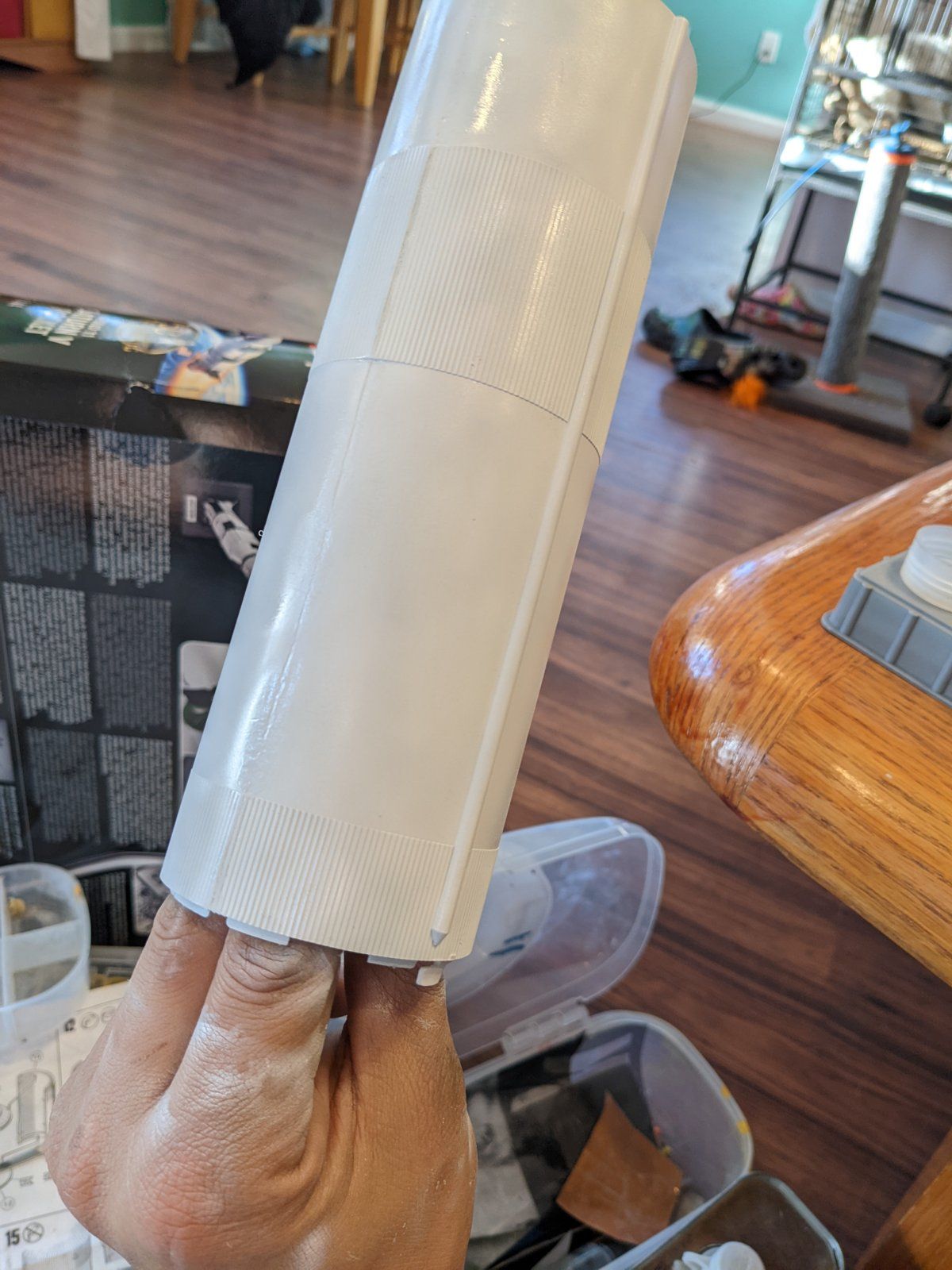

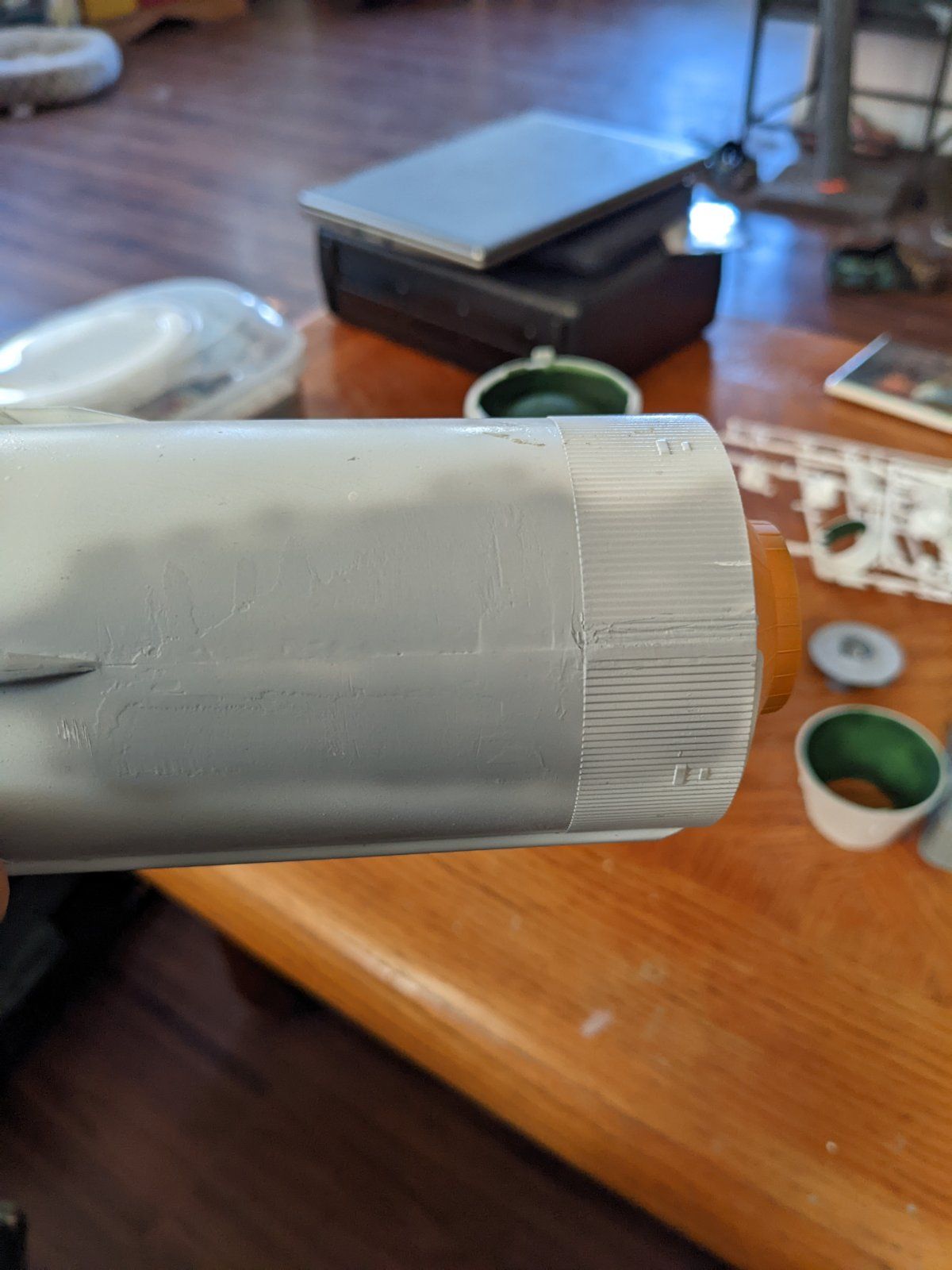

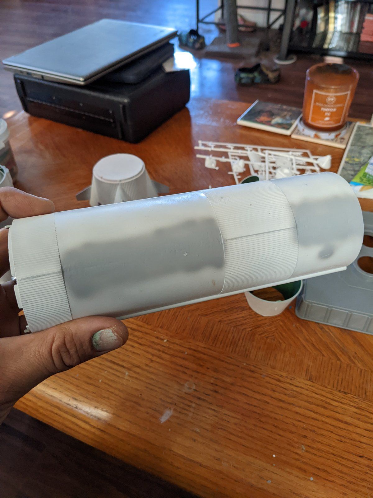

A few updates, so after several coats of white, alot of sanding filling, sanding, filling, and repainting I'm starting to get a smoother finish on these seam lines.PXL_20221110_141704043.jpgPXL_20221110_141700727.jpgPXL_20221110_141651815.jpg
I know they look rough but believe me they have come along way from when they were initially glued.
One of the main problems I have with this kit, is that revell must have designed it in a way were it could be quickly thrown together to teach with but they serious fell short on accuracy and quality.. for being advertised as a skill level 4 out of 5 and being boxed as a special anniversary edition you would figure this kit would be of a higher more detailed quality how ever the amount of extremely rough seam lines and pieces that have these horribly un realistic mold gaps and stamping imprints you would either need to spend a ton of time filling and sanding or just replace the parts with after market parts to get a high end kit..

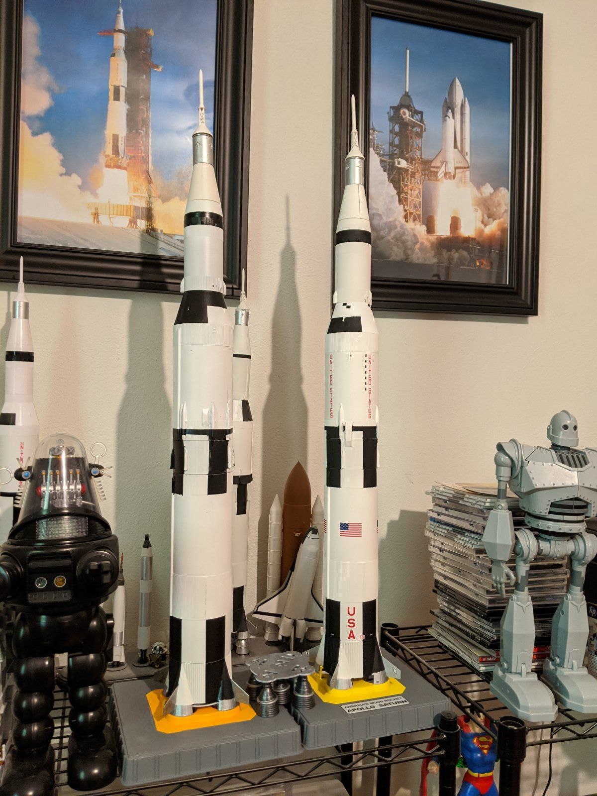

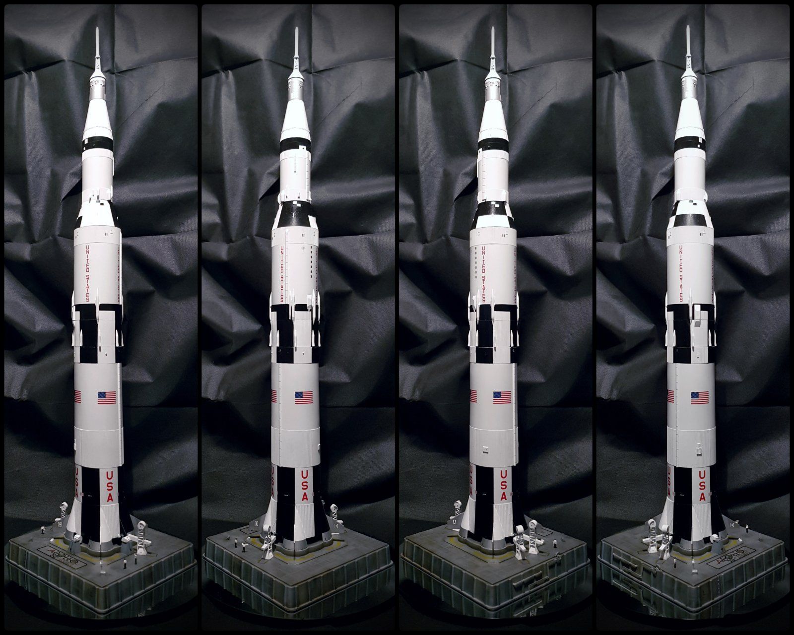

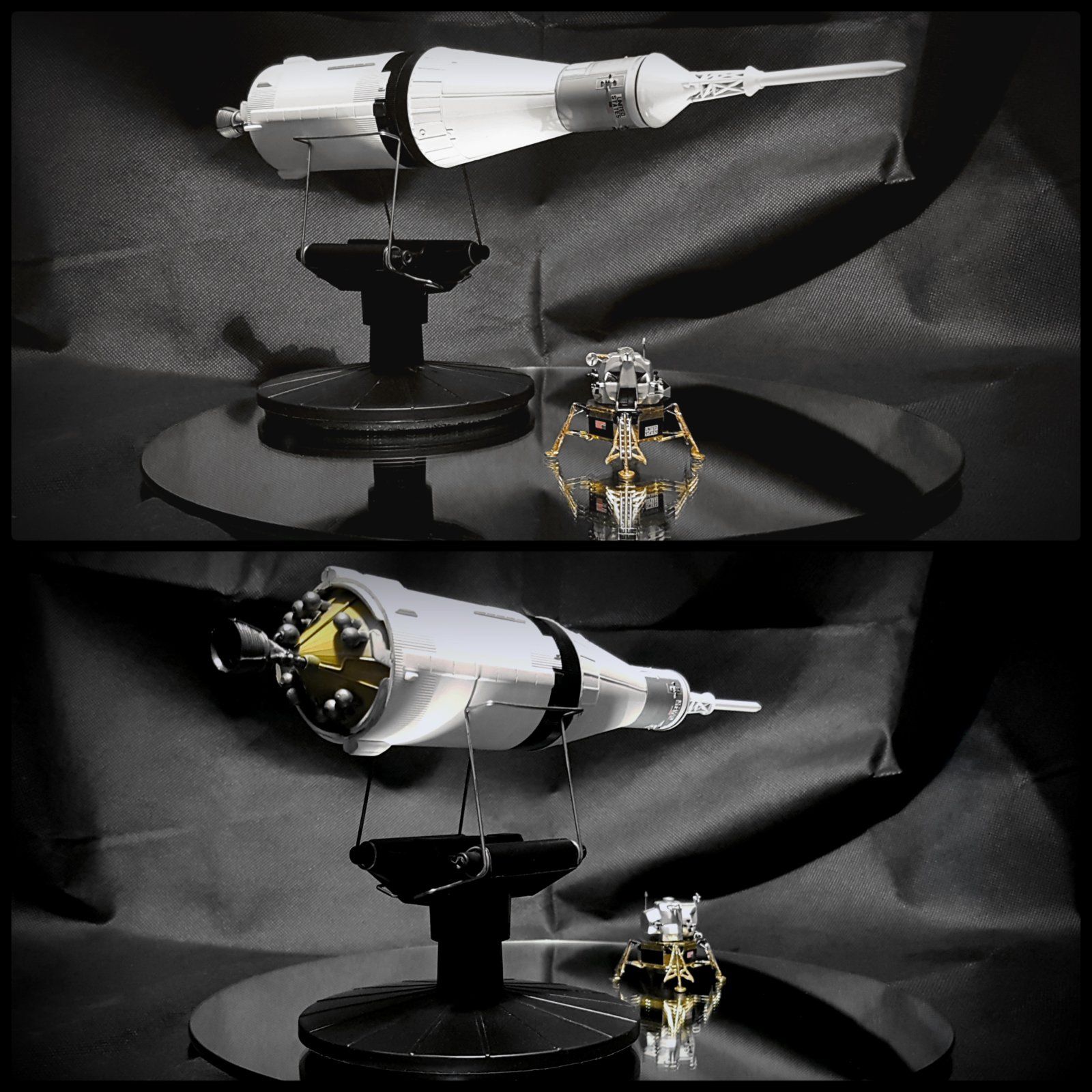

Good start on this monster of a kit, have fun with lots and lots of sanding :D

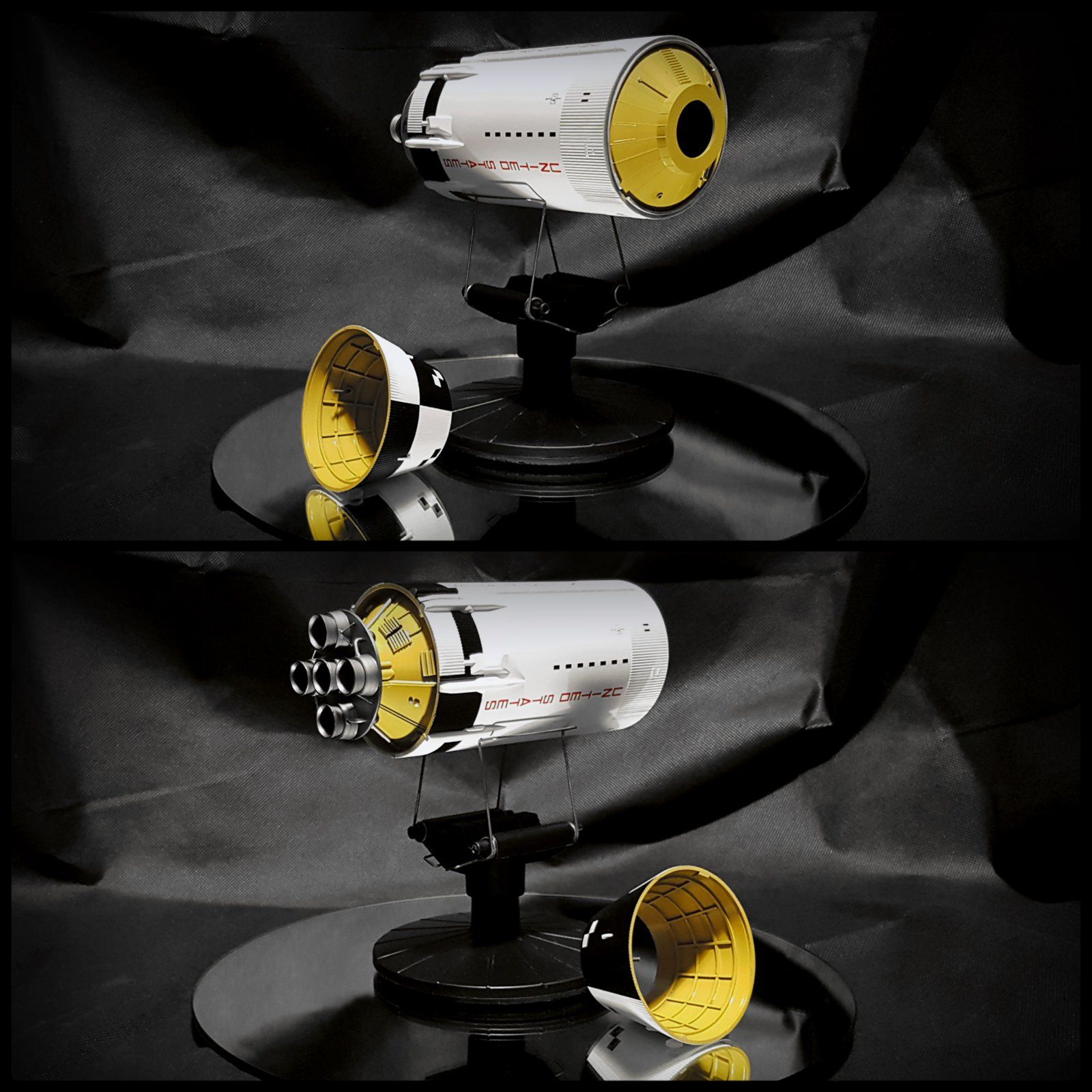

I've built this kit and did a whole heap of modifications to it, had a few minor fit issues that needed addressing otherwise she went together nicely, my only gripe was the lack of details so I did my best to fill in those details.
With a little patience and elbow grease this kit has the makings of a fine looking display model.

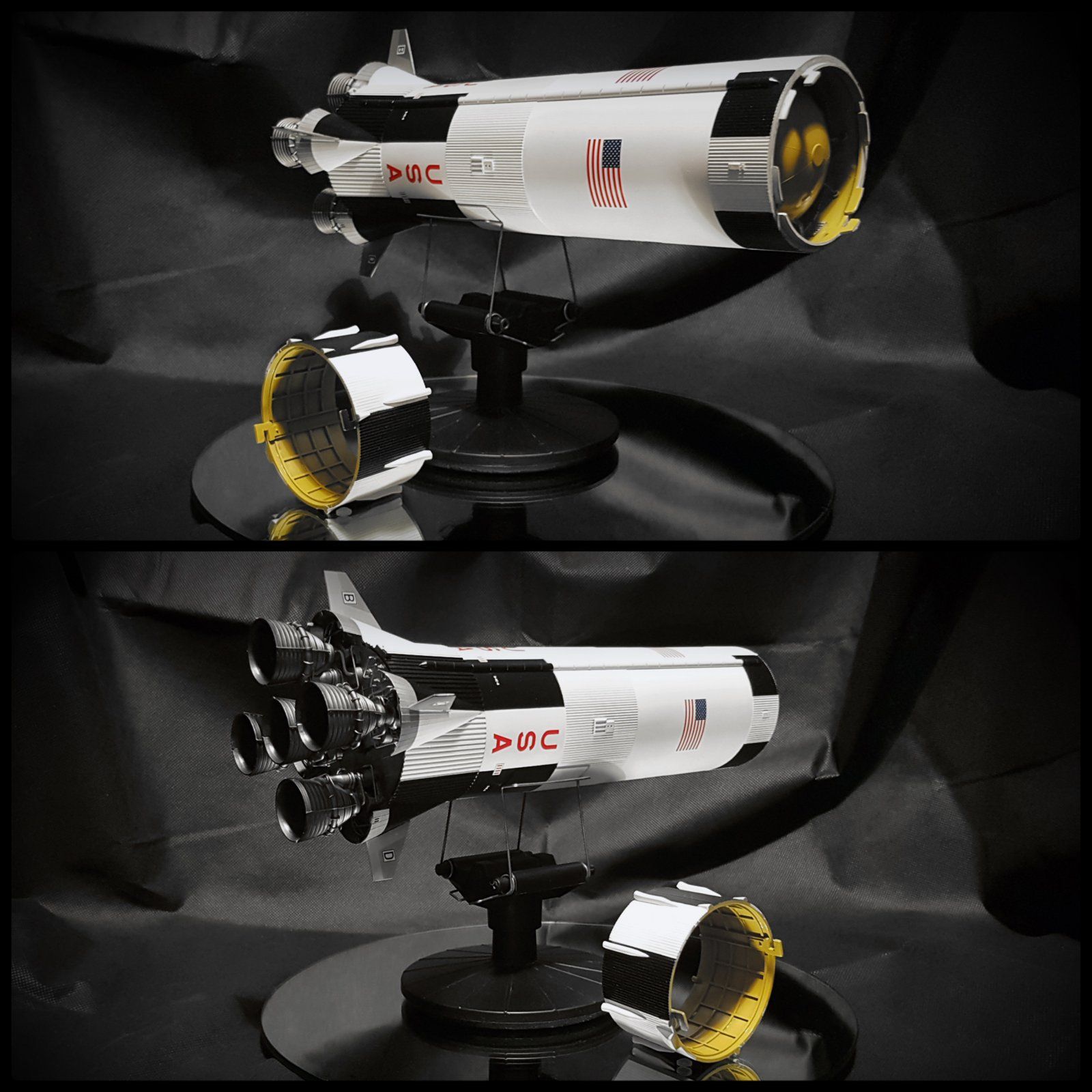

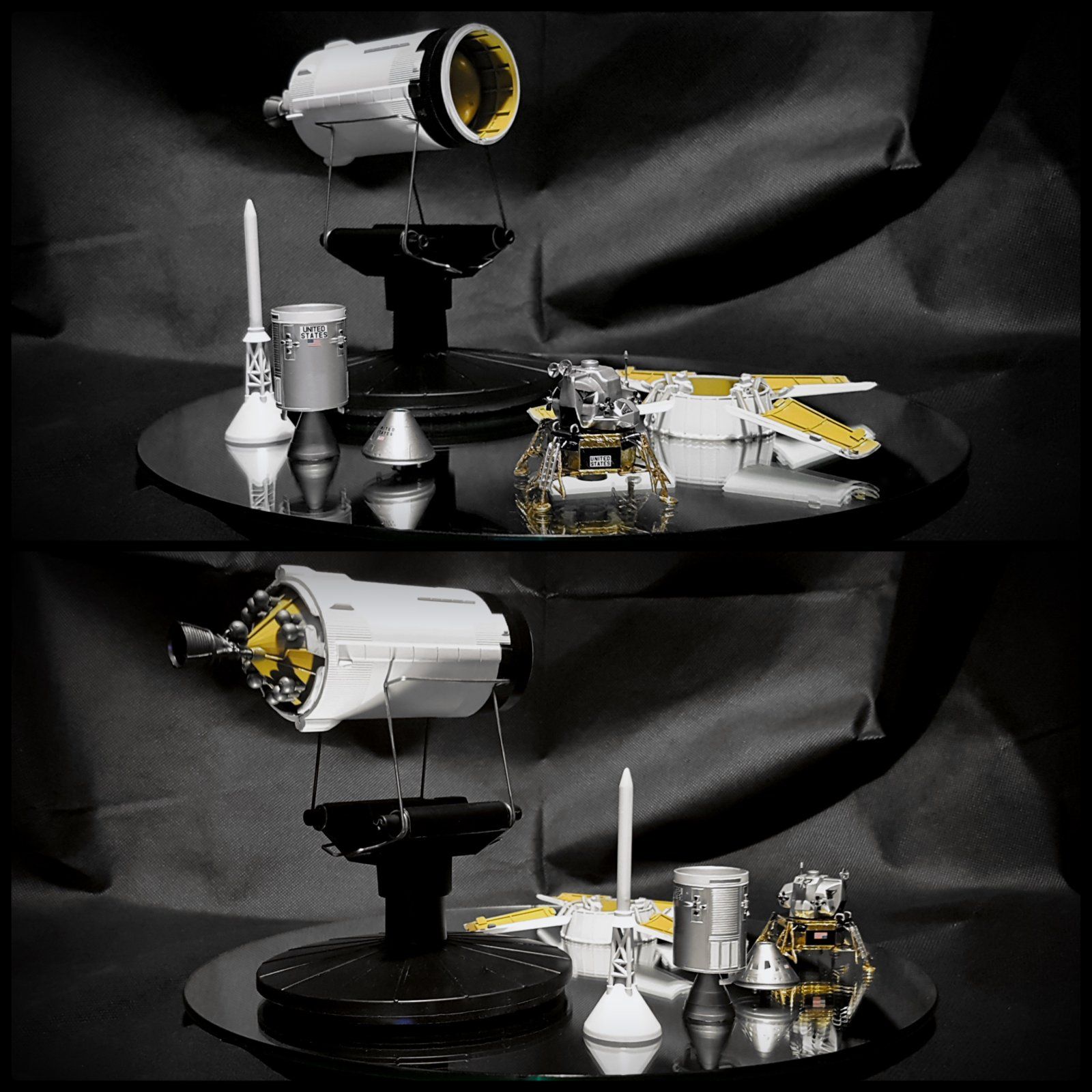

Are you able easily able to rake apart the separate stages for display and then assemble them back into the launch configuration, or do you need to have at least two kits and build one as launch and the other in the stages?
All of the Saturn V kits I've encountered can be separated into their separate stages, and the Apollo Command, Service, and Lunar Modules are removable as well. The Revell and Airfix kits use hooks to hold the stages together, while the AMT and Dragon models are friction-fit. (The flying models of the Saturn V do not separate, but have a point of separation to let the parachutes out at the top of each flight.)
Larry
You can break the entire model down into separate sections as shown in my photos, my version has the "hooks" as mentioned by Larry that hold each stage together. Be mindful when you paint the the lip area around the hooks not to layer it on too thick as it's a tight fit already connecting them without paint, may require minimal sanding around the area first before painting so each stage is easily connected and removable.
