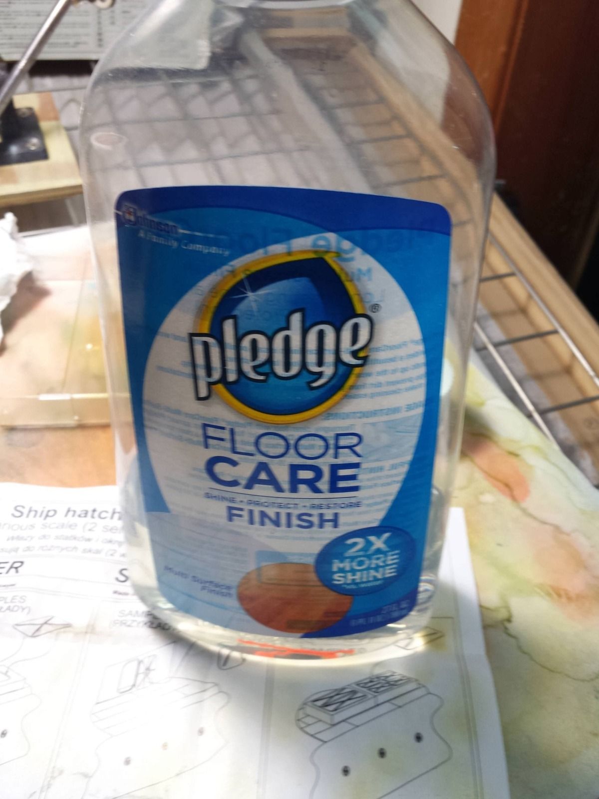

Those floor acrylics are dirt cheap when compared to hobby or artists acrylics .
Their proprietary surfactants make them very handy with more than floors .
" future " is one of the best mediums for mixing with inks and dyes IMO .

Actually, Future/Pledge (same product, just differently named over time) was much cheaper by volume than gloss media made by suppliers to the hobby. True, it is now unavailable, but some former Future users have switched to a product called Quick Shine, another clear acrylic gloss product.
I use Future (still have about half a bottle) for that reason, that it's cheaper than Tamiya's and other products, and it does the job, whether it's to finish my toy soldiers in gloss, or gloss-coating before decaling. It can be brushed by hand or airbrushed, and cleans up with a weak ammonia solution. But that's my preference. I can use it on my vinyl floors, too.
I use it over Tamiya acrylics, as well as over Andrea's, Vallejo's Model Color, Lifecolor, and craft store paints Americana, Folk Art, and Apple Barrel.

FYI, I have aircraft in my collection which are 20 years old. Most of them have canopies which were dunked in Future for clarity. I haven't noticed any yellowing on any of these models.
