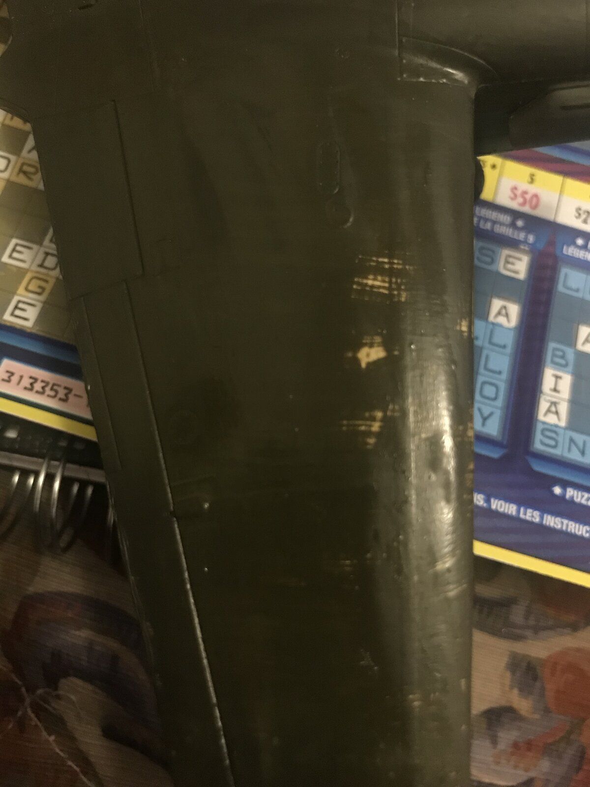

Im really stuck with brushing on clear coat right now, my model has been curing the paint for about 3-4 days. Im just asking to see if I brushed on the clear will it ruin the paint?

I used the Mr Hobby Mr white surfacer 1000, let that dry for 26 hours, then I did XF-62 (olive drab) mixed with a bit of XF-2 (flat white) and a touch of XF-60 (dark yellow) to make a custom Olive drab that I then brushed on in thin coats, let each coat dry for at least 24 hours. And one final coat to even out the whole thing and then let it fully cure for 4 days. And as for the X-22 clear coat. I put it on thin and spread and it still pulled off the paint down to the plastic. It even pulled off the surfacer primer
