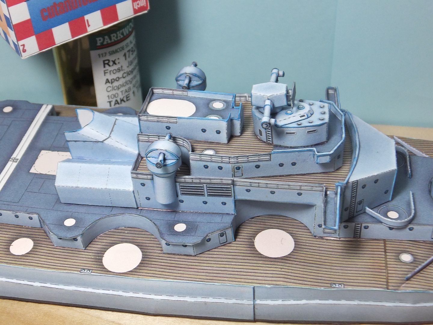

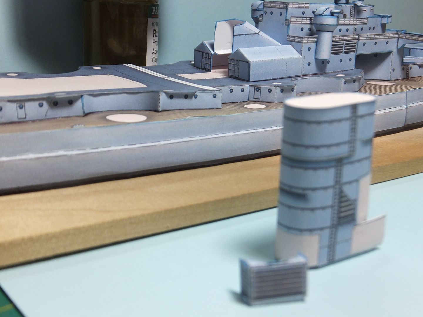

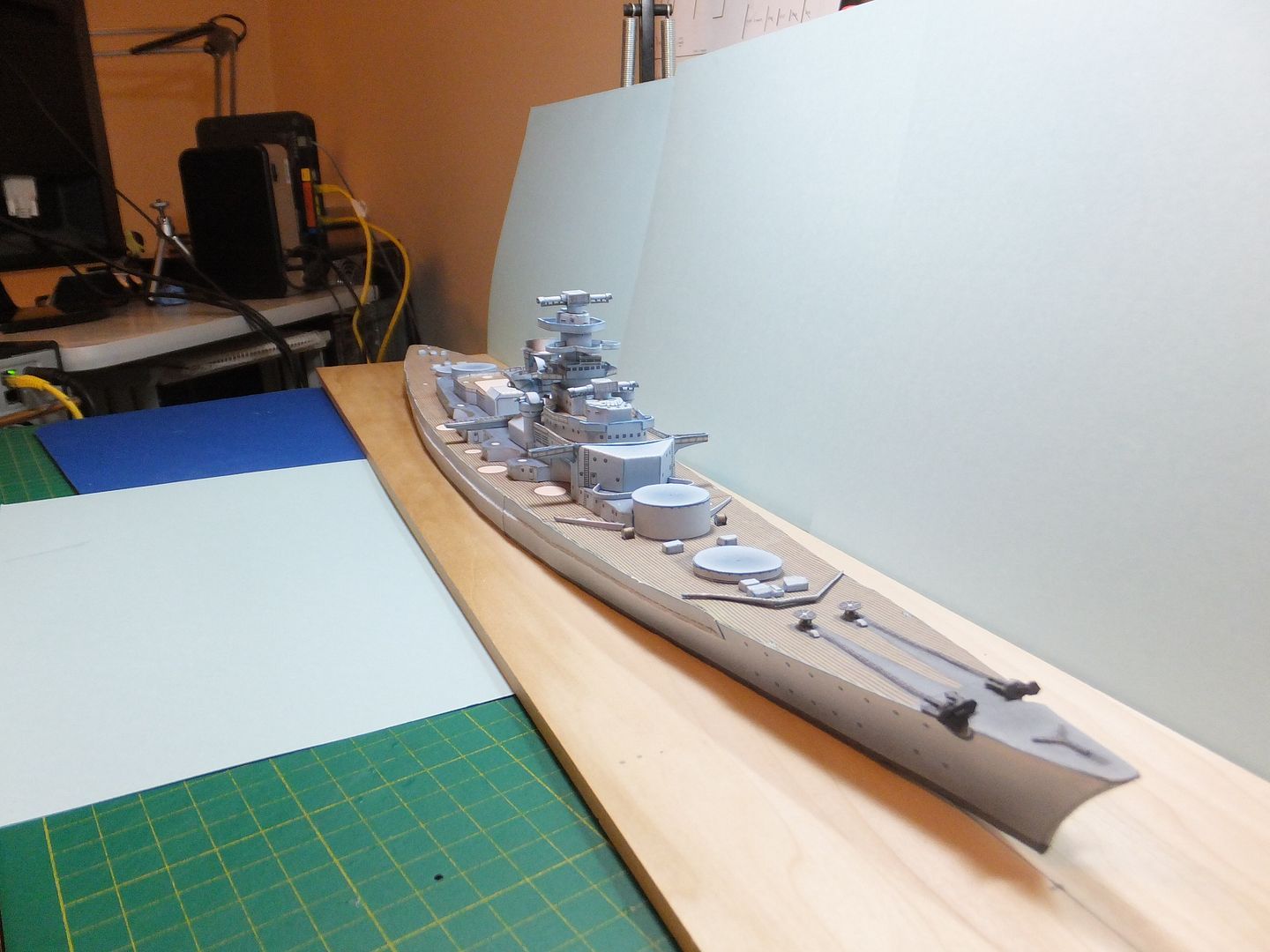

Good evening.

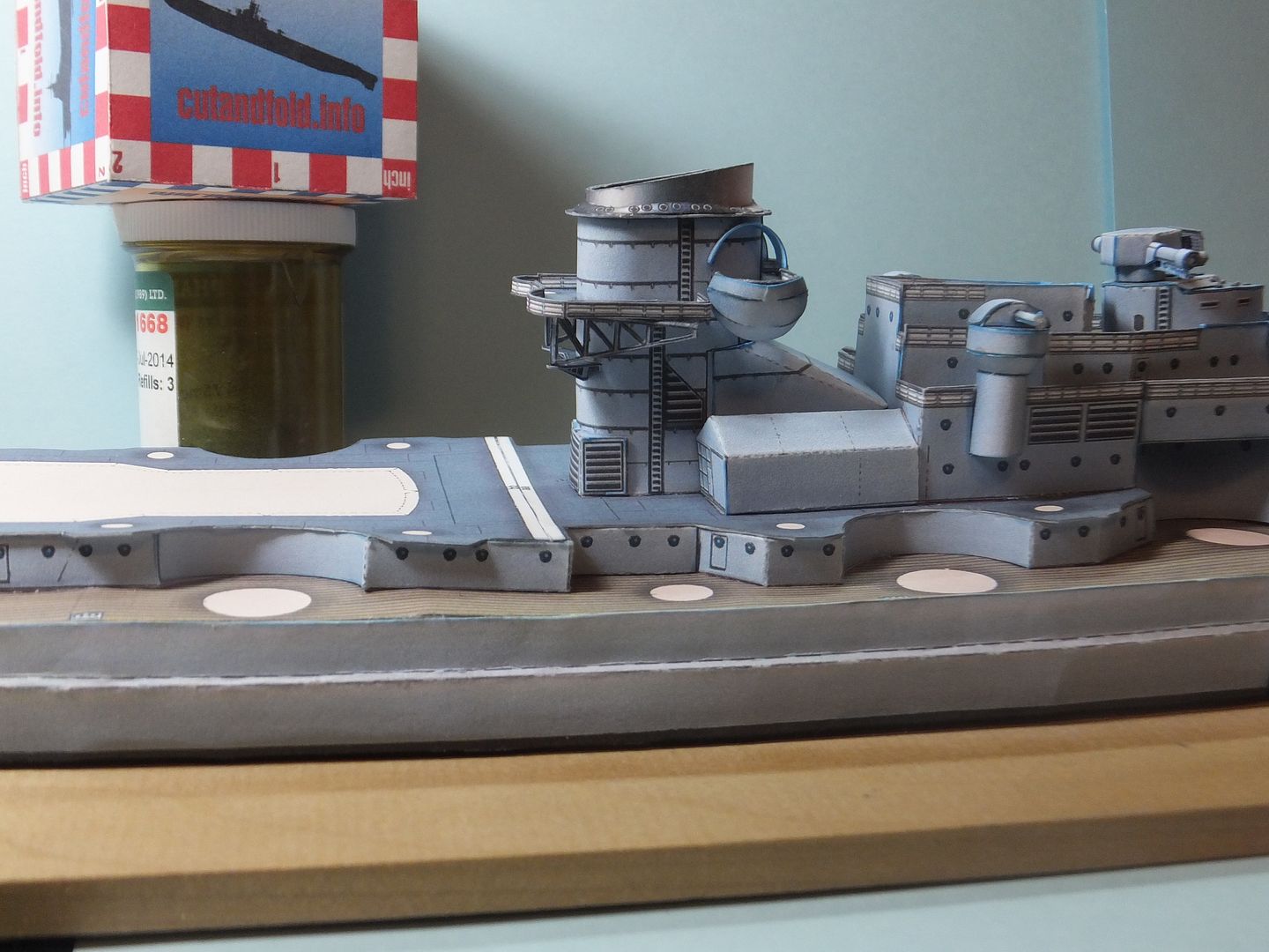

Update time.
The first level of the upper superstructure is shaped and installed.
It's just waiting for its decking.
It's nice to see all that white open area starting to disappear, as it's silhouette starts to rise.
Thank you for following.
Questions and comments are always welcome.
Jim

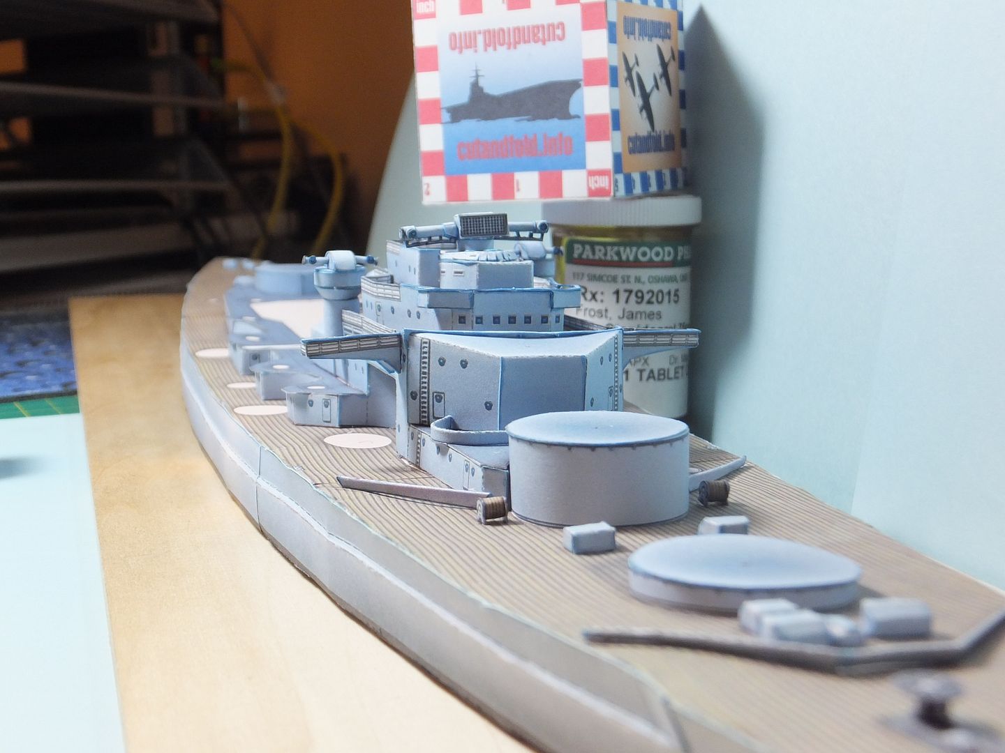

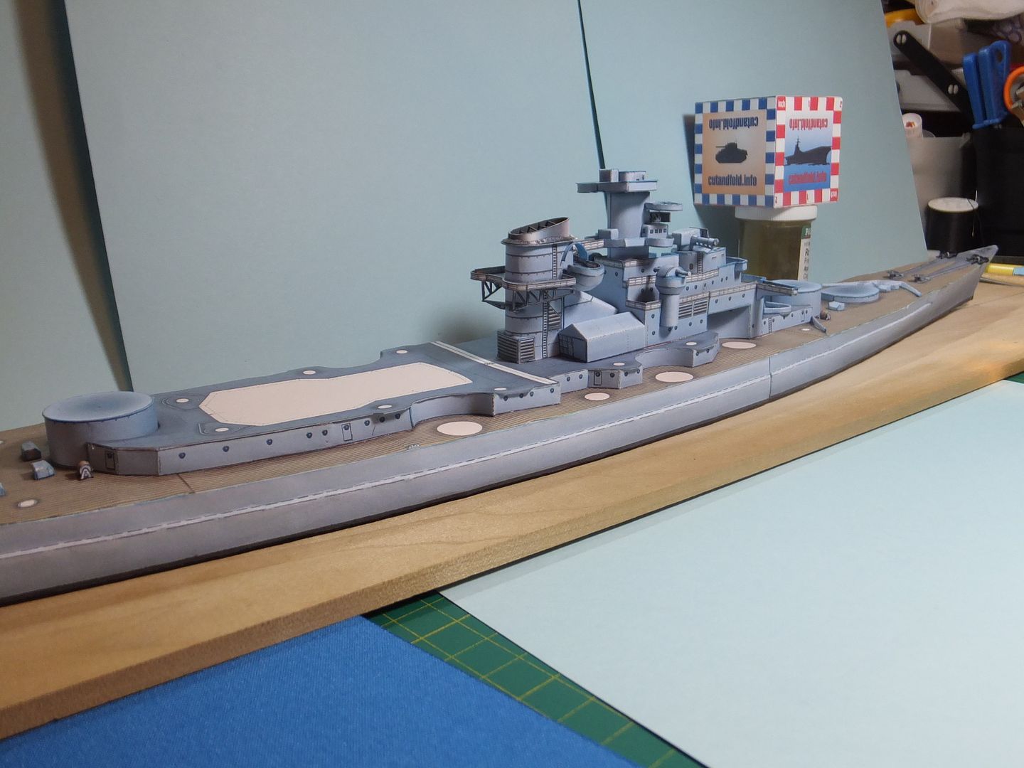

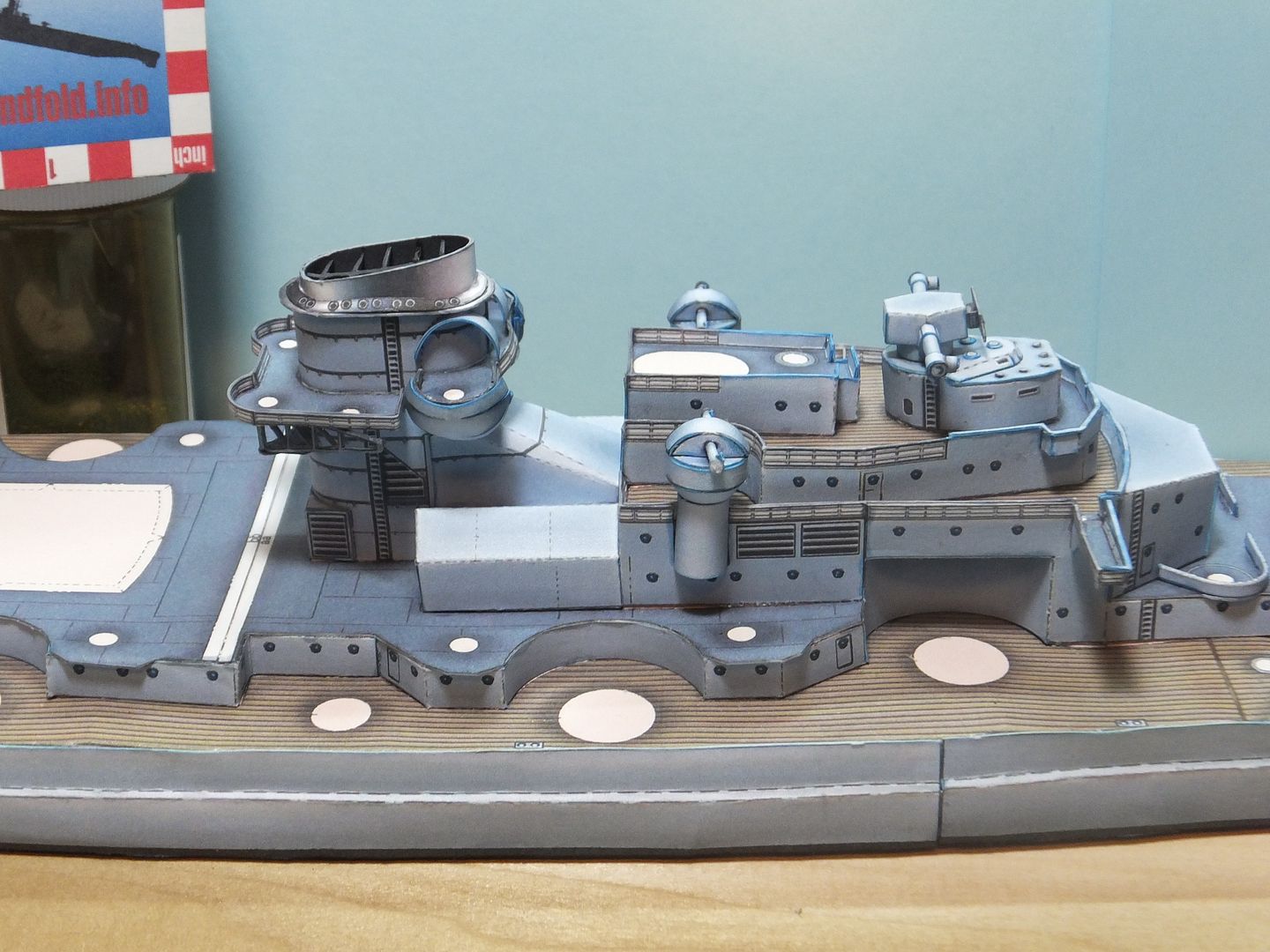

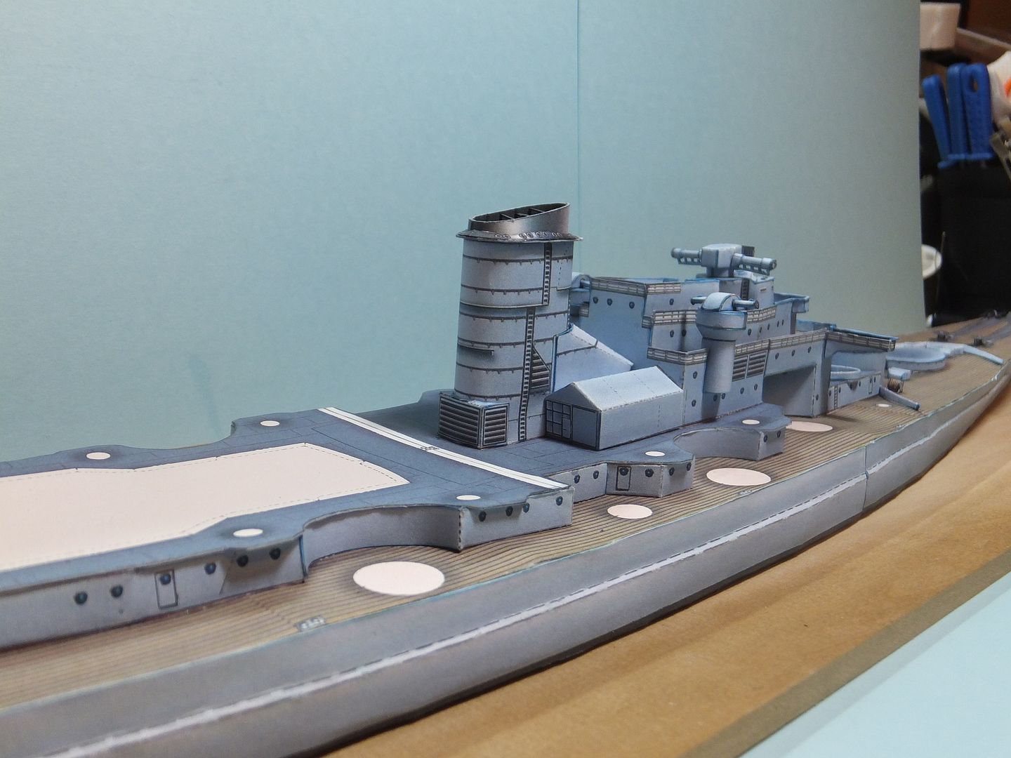

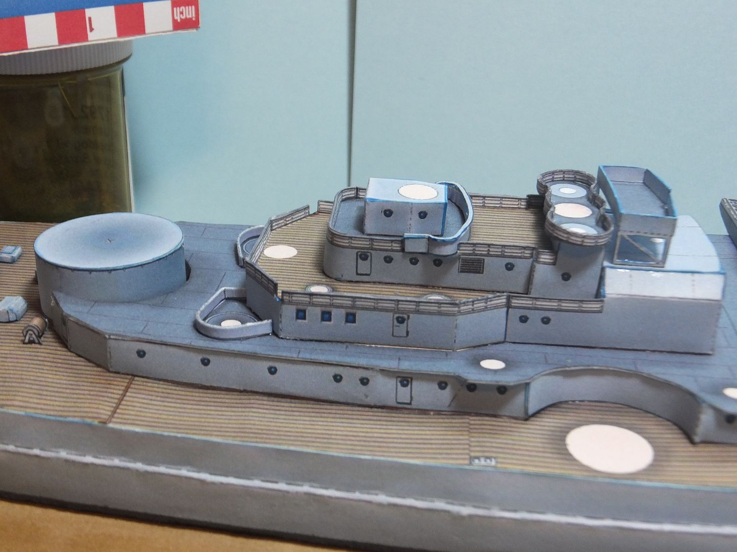

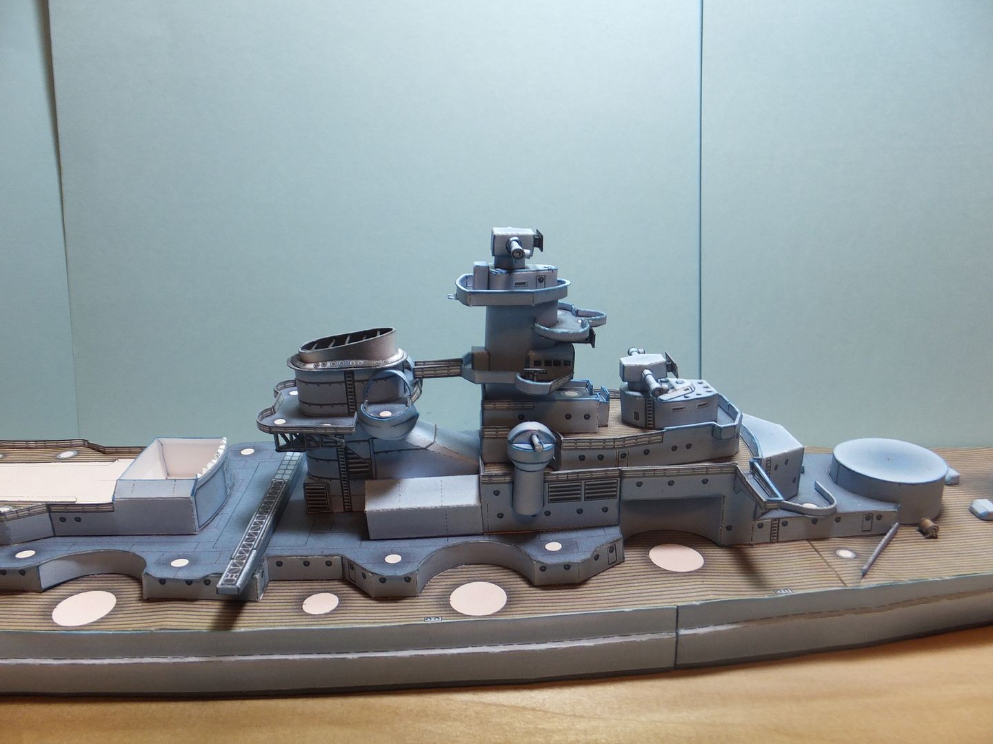

Good day.
The decking has been added to the first upper deck, and the forecastle is starting to grow.
Questions and comments welcome.
Jim

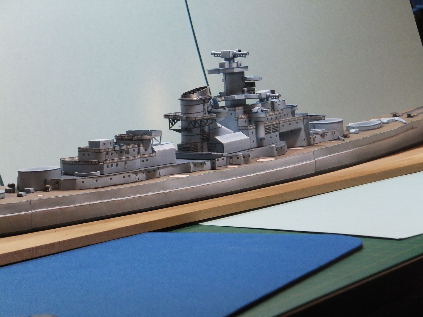

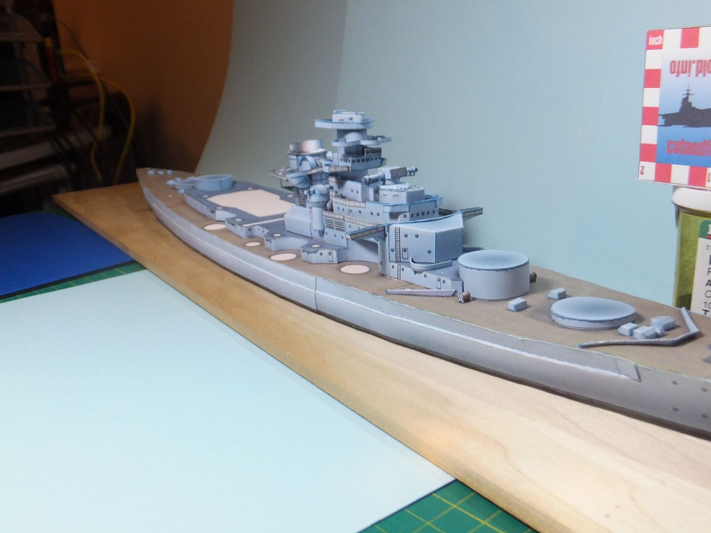

Thank you Patrick.
Working on the 2nd deck for the forecastle at the moment and had to add some support for the deck.
Will post some pics later.
Jim

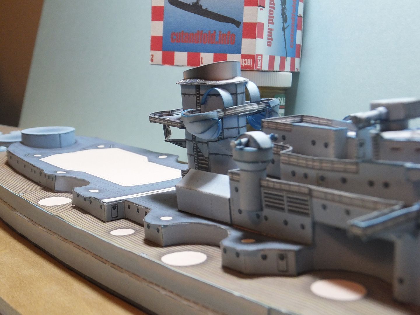

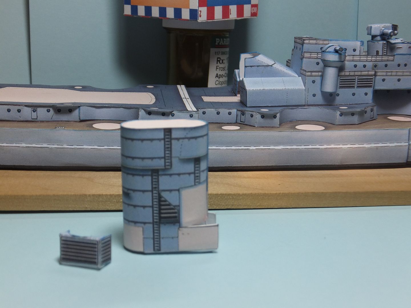

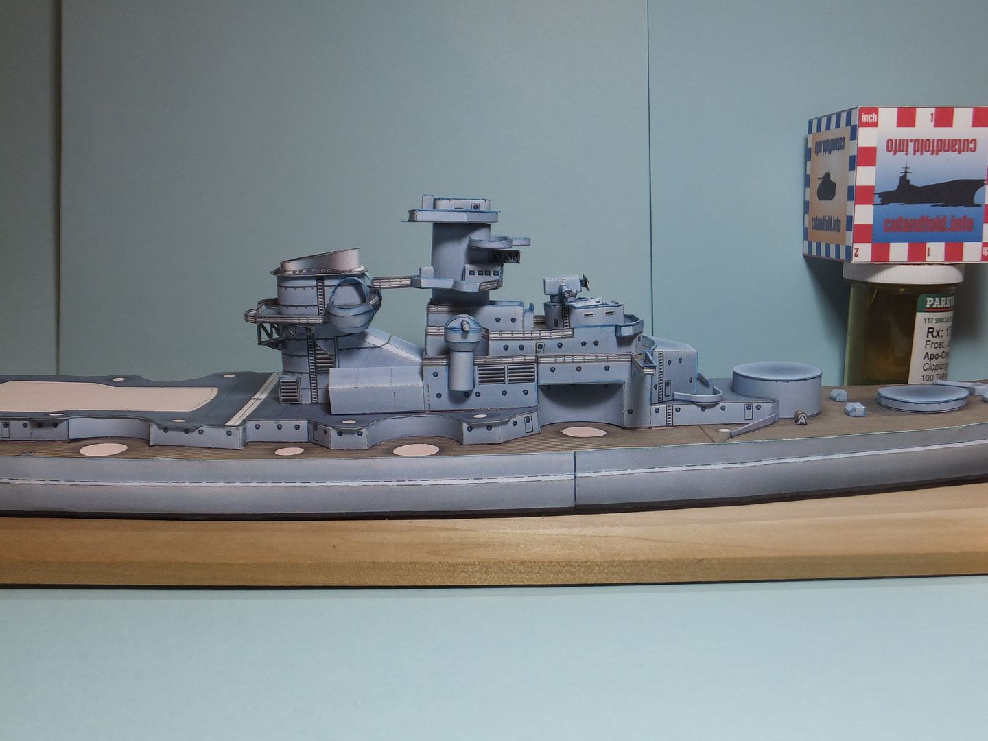

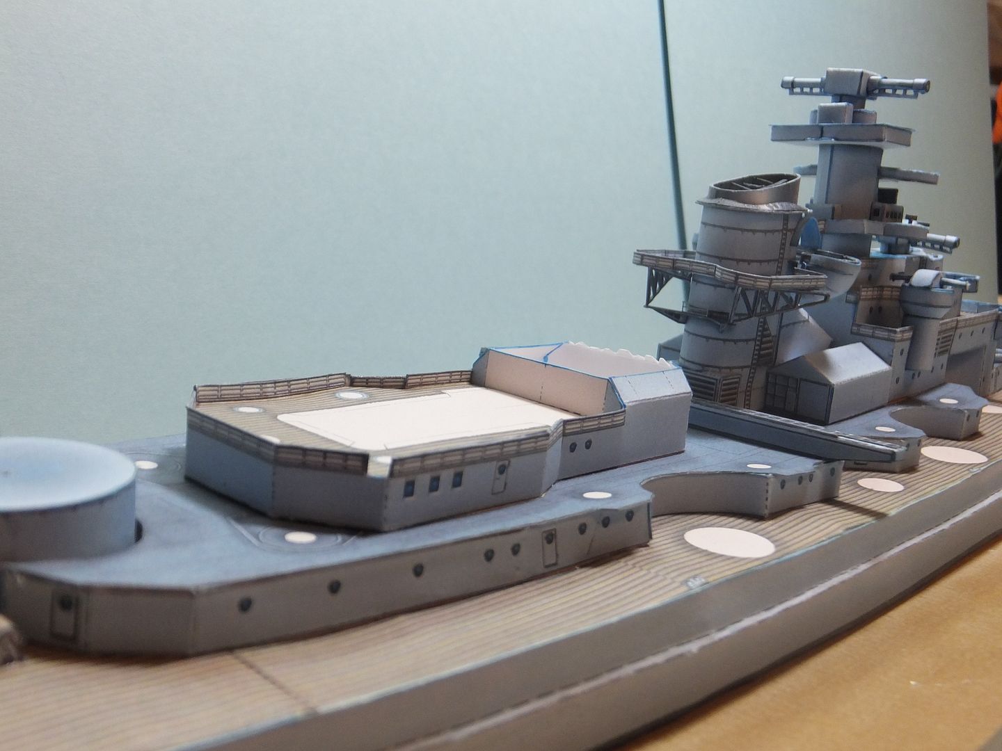

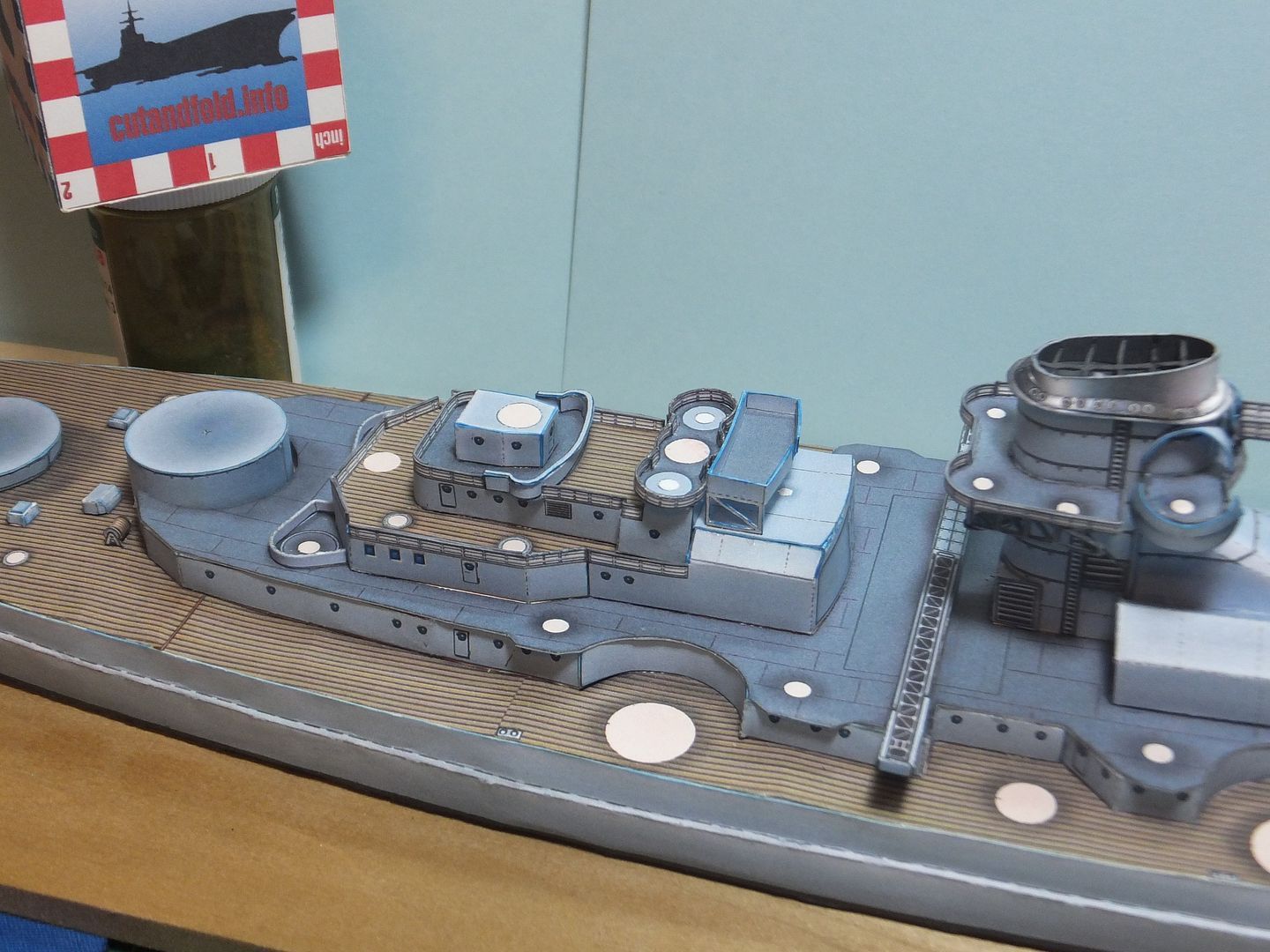

Good evening.
I did get that 2nd deck installed on the forecastle, but had to do some modification.
When it was test fitted, it just wanted to fold in, in the centre. There is no centre support for this deck, so I had to add some ribs of double thick card to keep it flat.
It was simple and worked quite fine.

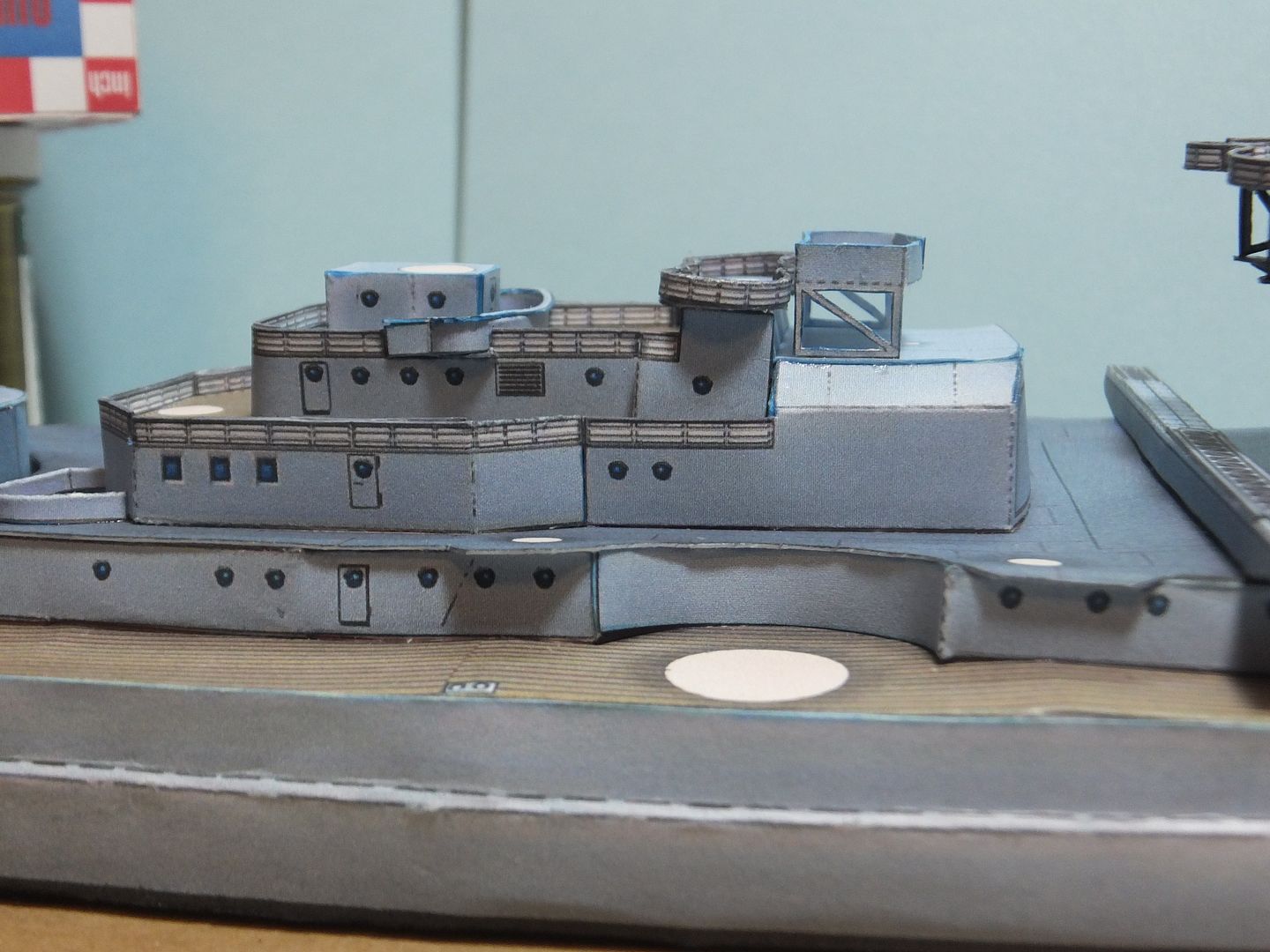

Added also were the lean rail to the forecastle bridge and the 2 side observation bridges. The mid breakwater and the protective wall around the 2 forward AA positions, have also been added.
So this is where I am at tonight.
Jim
Nice fix on that, Jim.
Learning to use that rib trick on my build, too. It definitely helps

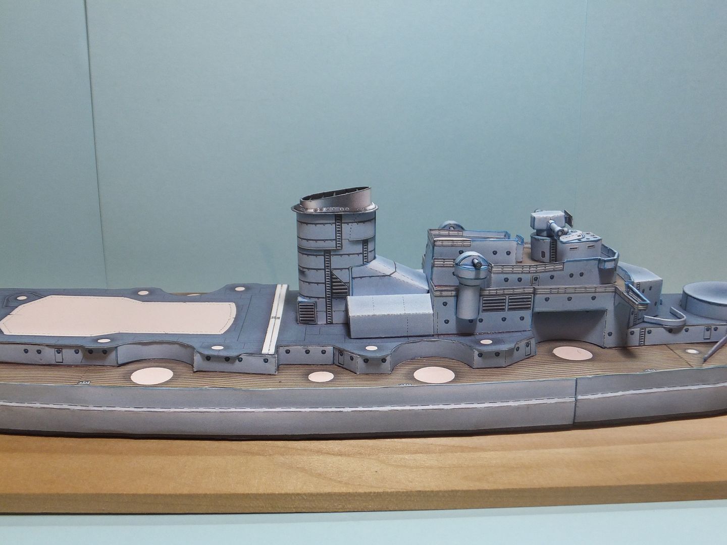

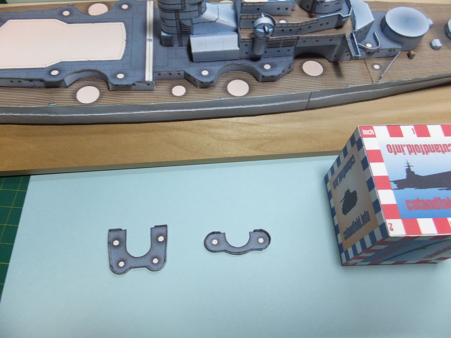

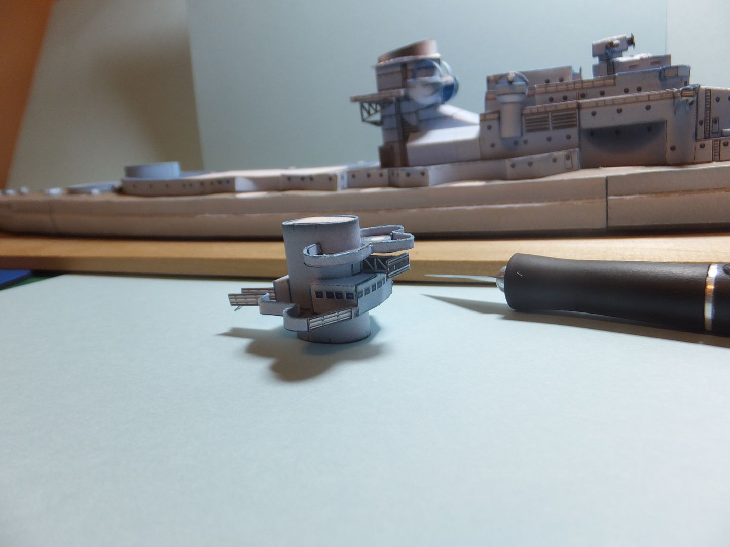

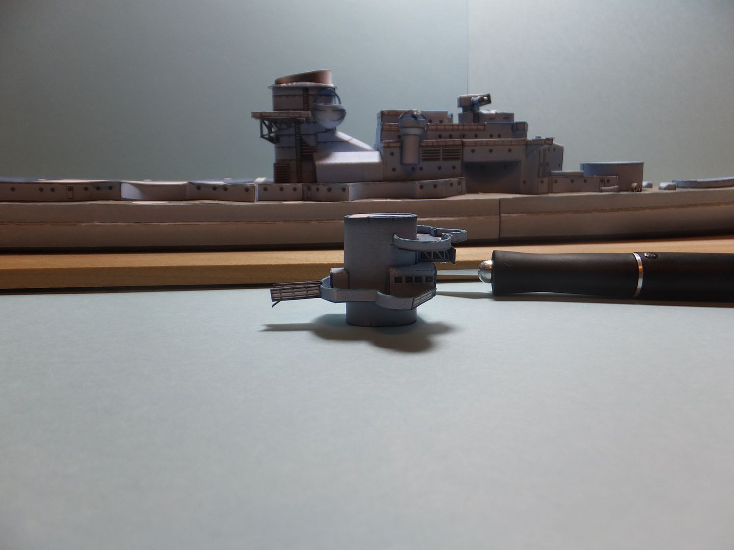

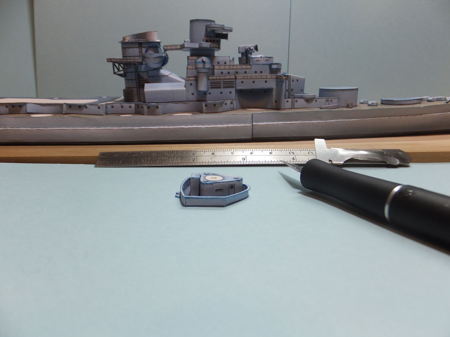

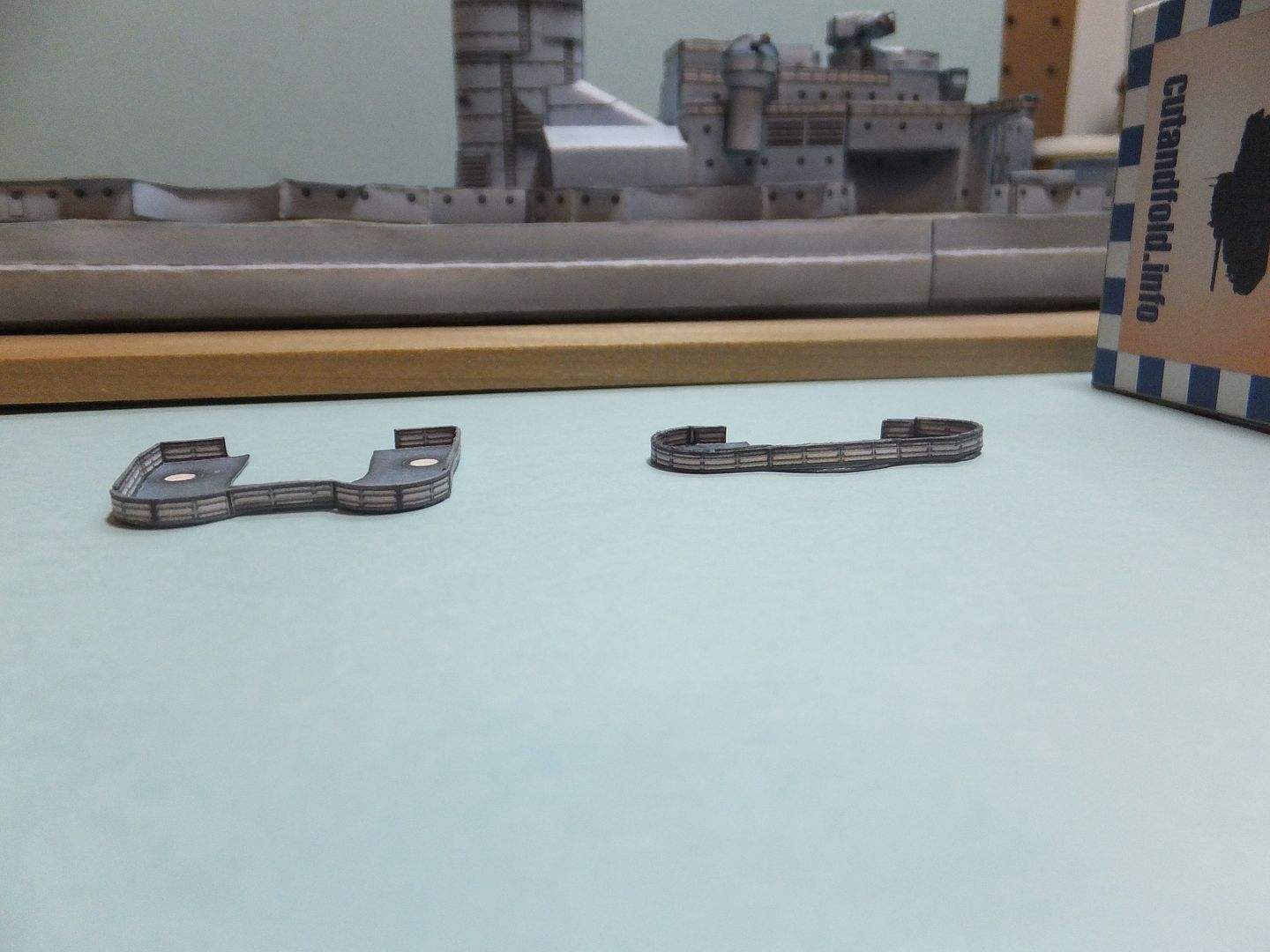

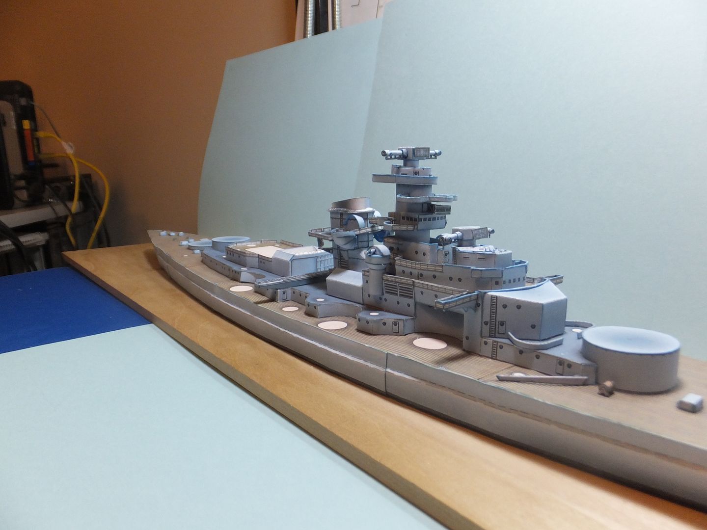

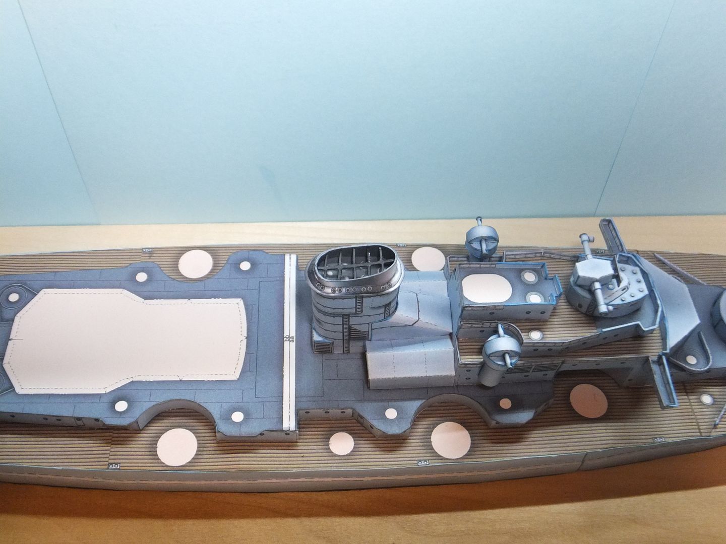

For tonight's update, the 3rd level of the forecastle has been added ( the bridge). The upper deck decking, I had the same problem as before, and had to add support for the deck.
Since the next level has an overhang near the rear of this deck. Before it can be installed, 2 optical range finders have to be installed first. I have started work on assembling these.
For those old enough to remember this.
