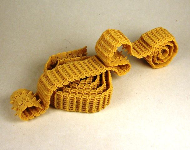

Got them tracks situated last night.....
I also began shooting down some color on the hull last night last night. (Pics a bit later). ::)

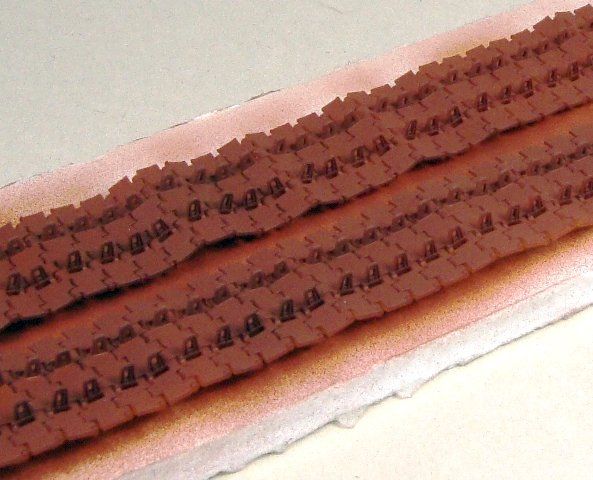

Hiya Norm!! Thank you buddy!! Why no, they are "Bronco..I'm gonna get these because they are only $15 at the AMPS Show" tracks ;). I had never used these before...but I like em, movable is definately a nice thing!! ;D

Took about 1/2 hour to remove the pieces from the tree and clean them up, probably another 1/2 hr to 45 min to snap em together ( Not rushing either) . Did them in small sections first, 4-6 and then snapped those together. Had around 5 or 6 out of 172 that the little nub (fake track pins) that locks the tracks together, removed itself as they snap together. A little Tamiya thin did the trick and 99.5% is working great. Next time I might have to stock pile some of these when I see them!! ;D

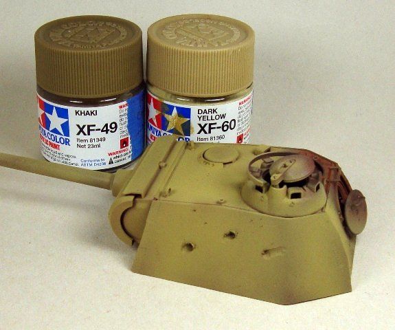

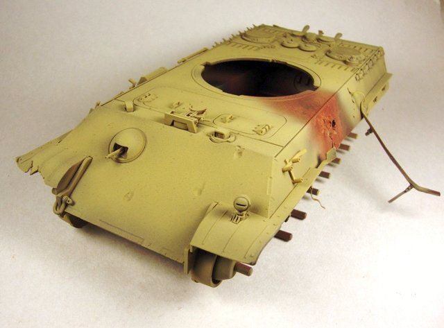

Back again!!! I think I mentioned earlier shooting some color on the kitty last night. Just the first of many stages, but some of the chipping from this part will invariably show through at some point.
With that out of the way and knowing I will be chipping for a while, I decided to get a start on them tracks. When I got home today, I shot down my Red Oxide/rust primer base.

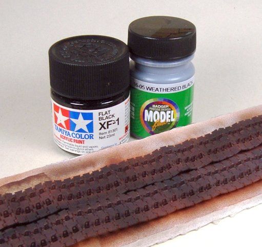

Then I applied something new here. I received a small Badger Weathering set from the SMA contest and I figured I would have a go at one of them. Thin enough to shoot straight, no cutting, and not smelly at all. I like it! I chose this Weathered black because it appeared to have a slight bluish quality to it similar to steel and then I dusted a bit with some flat black to bring up some tonal highlights.
I am thinking that a little filter and washes will blend this altogether nicely. ;D

Oooh we got some Yellar ;D,, looks good T , I like the tracks too ,you like the Badger stuff then ?...I've still to try it .
Chris.
Re: Bad Kitty!!
Thanks Chris! I do like the Badger Paint! Pretty smooth and ready to go, right out the bottle and it lays down decent! Still have a few others to break into! ;)

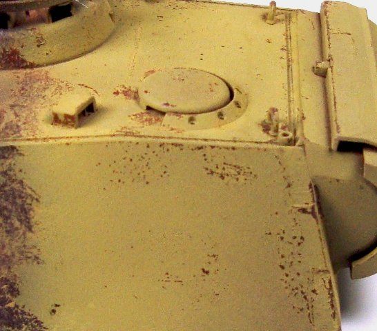

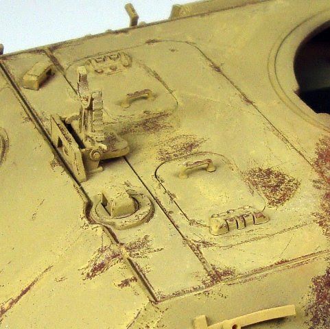

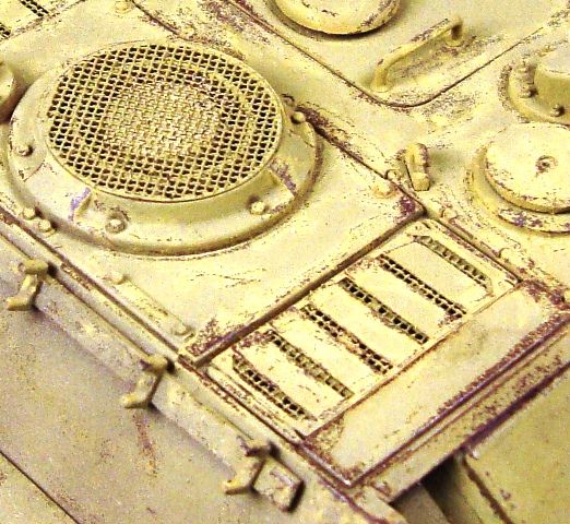

Hello gents!!
Here is a bit of an update. I finished…preliminary…chipping. So to bring things up to speed, step #8 hair spray, #9 base color, #10 was chipping and now 11..more clear coat. Tomorrow I will begin stages to shift some color and possibly add some camo (not a huge camo guy, so stick around for me to F something up). Blah Blah Blah…
Here is some of that preliminary chipping. As I go through some of the other paint stages, this will be better, hopefully, explained to why I am going this root
The chipping seems a bit erratic, heavy and choppy at the moment. After the next few coats go on, I will be able to bring back some of this chipping, but it will be more controlled.
I had one little set back, not too big of a deal. I noticed a bit of the barrel seam. I sanded it down already and base coated it again. With any luck the barrel will catch up with the rest of this tomorrow.
