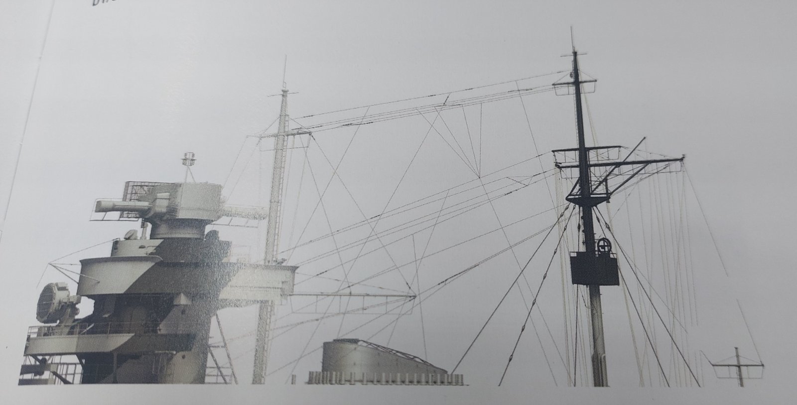

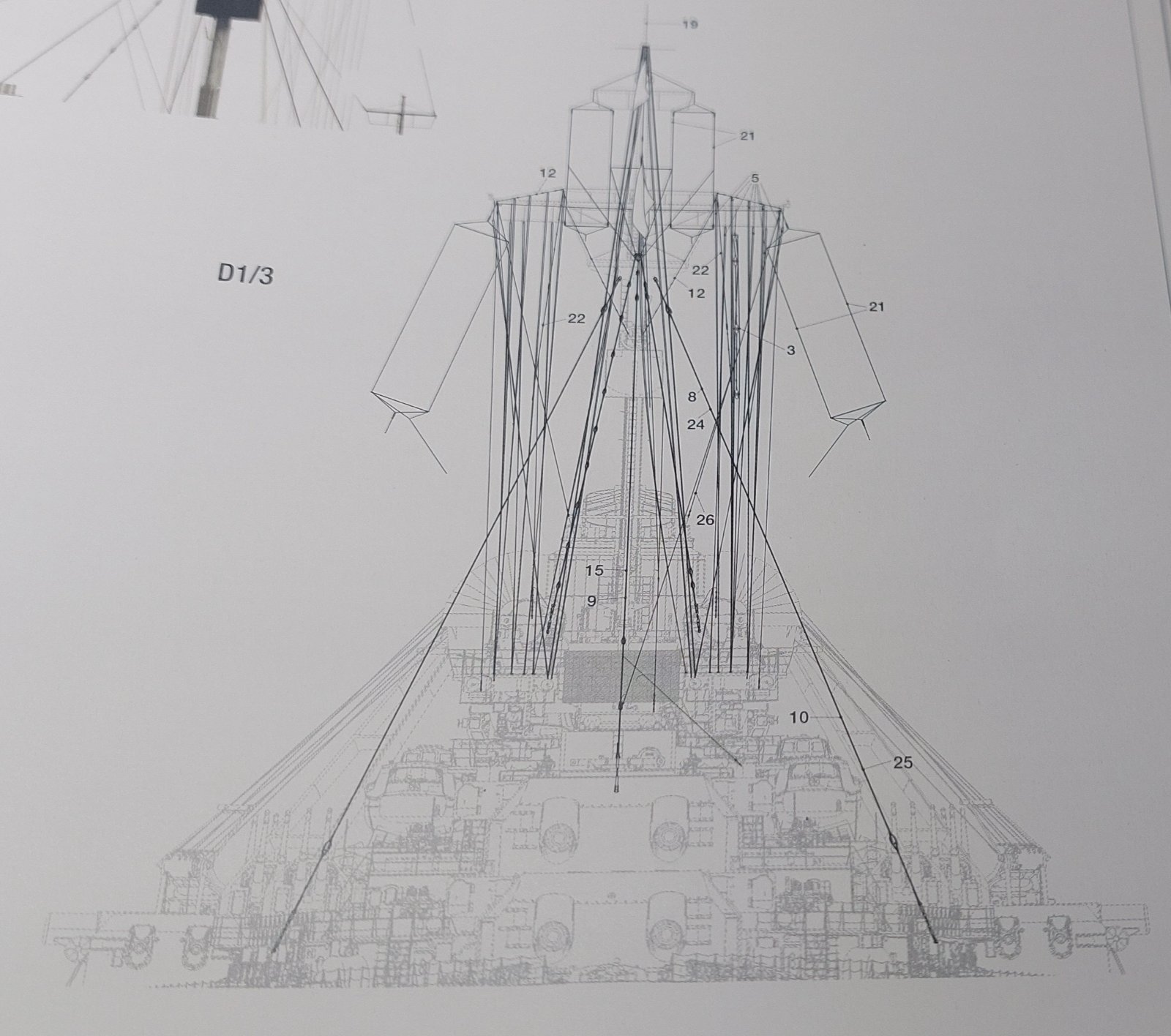

Thanks Kevin. Now starting to think about the rigging. That's gonna be fun....... Pantherman
I really don't know why I was worried about doing the rigging, seems easy enough...........!!!! Pantherman

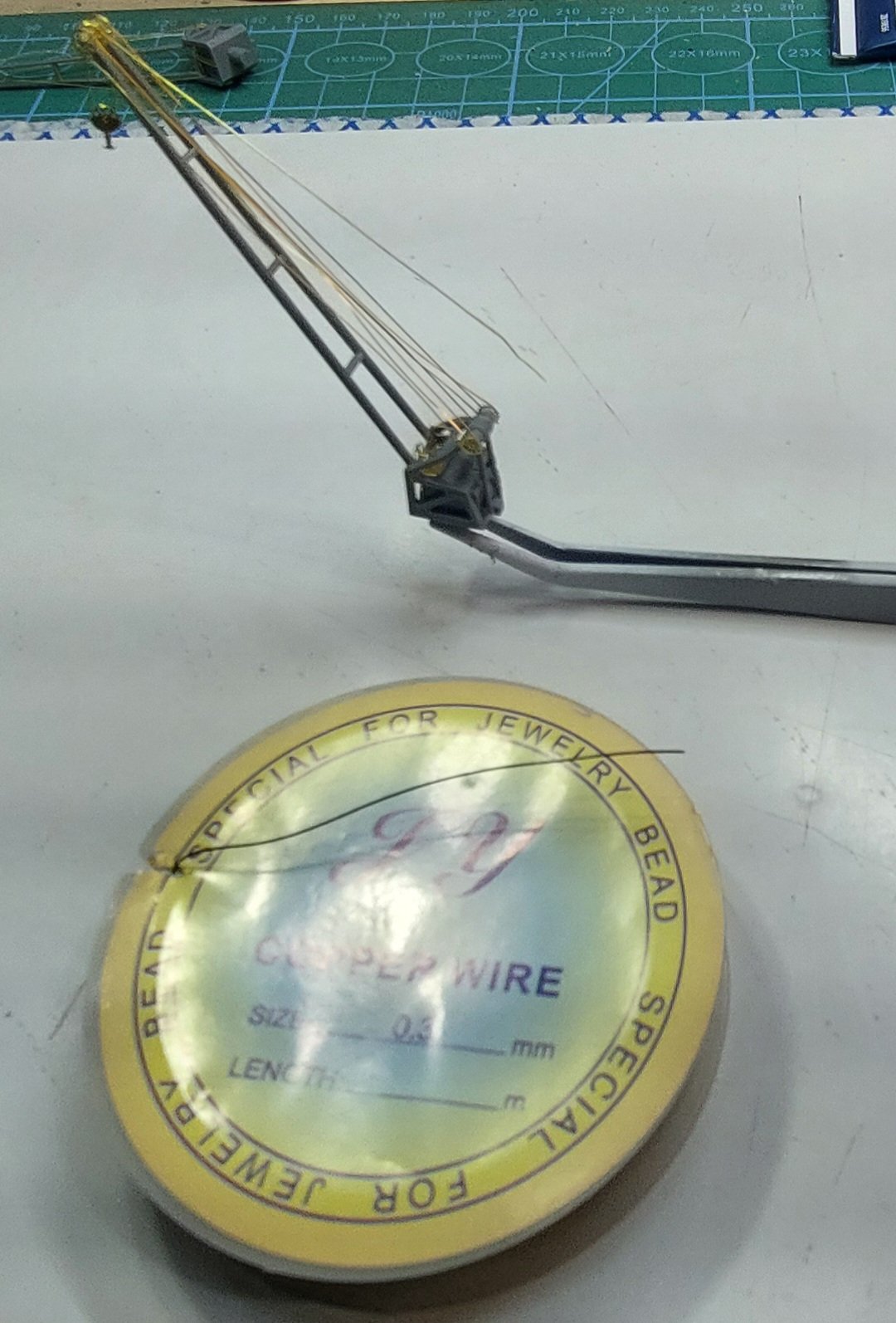

Good luck. Hope to see you pull it off. What kind of line do you use for that? Like sewing thread or is there a modeling product? Do you glue it in place or tie knots? More importantly why the hell does a battleship need rigging? There's no sails.

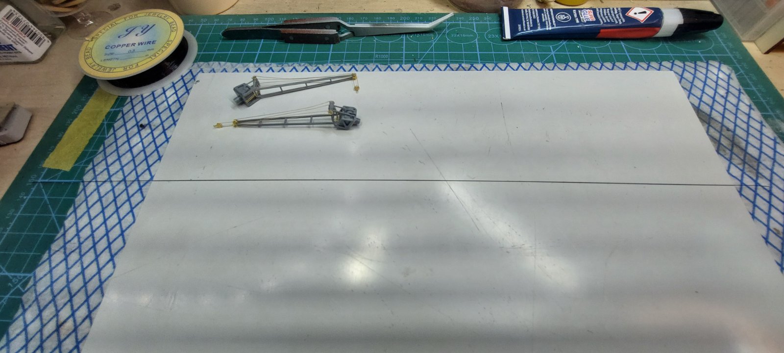

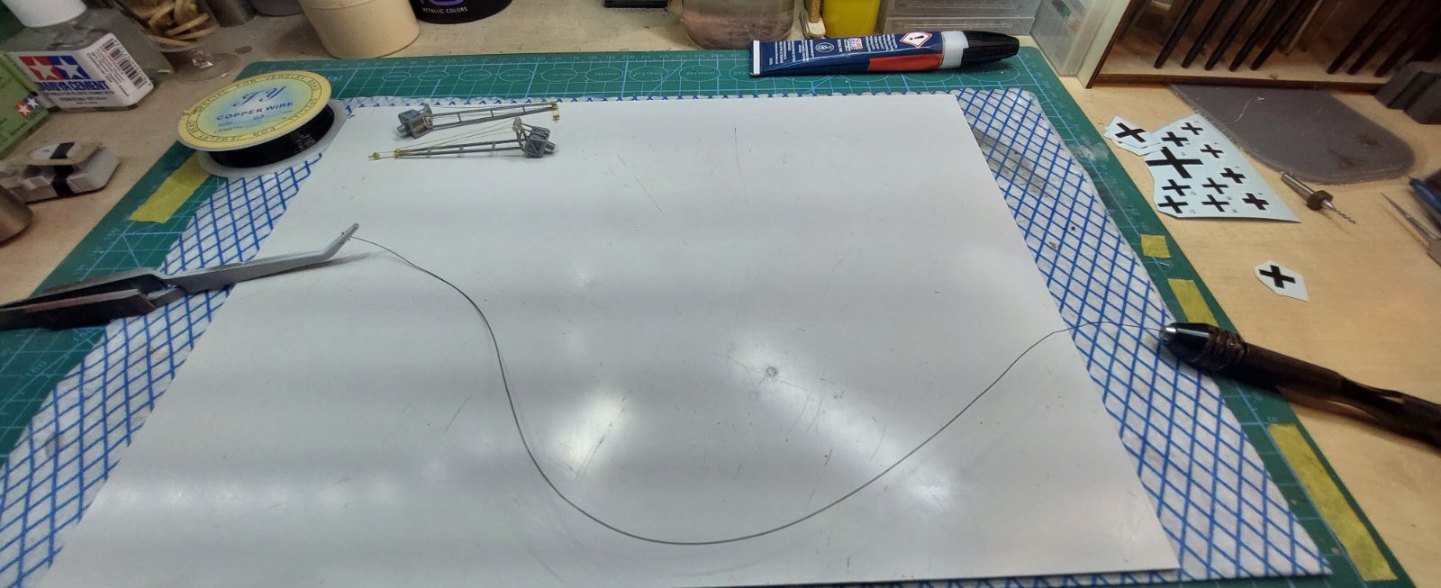

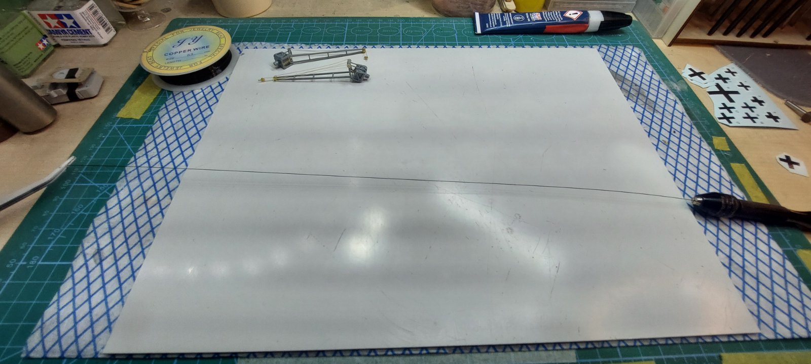

I use black jewellery wire. If you take a length of it, secure one end and put the other in a pin vice or drill, then twist the wire until you feel it trying to turn the vice backwards. You should have a perfectly straight wire which is easier to fit as it needs no tension to keep it straight. Hope that helps. Pantherman
