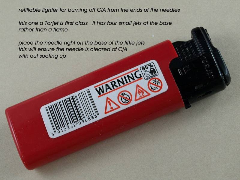

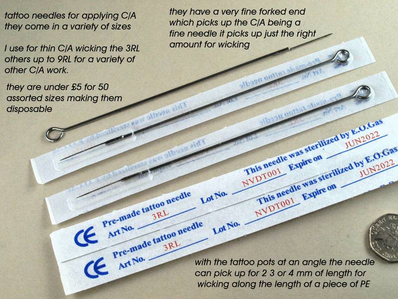

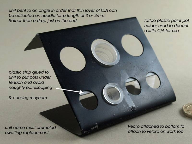

The best thin applicator I have found. Tattoo needles. .3RL size.
Burn of with a lighter. Made up of about 5 fine needles.
Cheep way of doing it about £7:50 for 50 units.
Laurie
What is that, is there any photo or video?

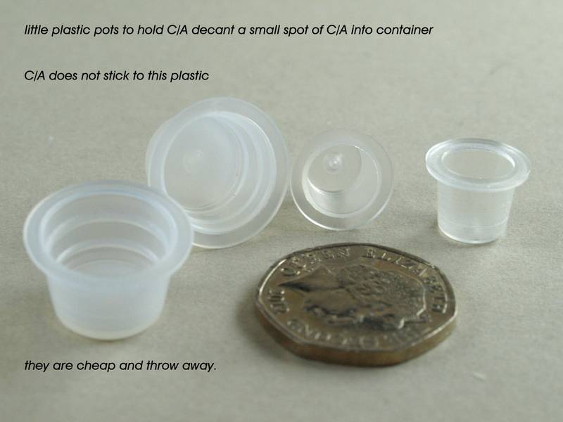

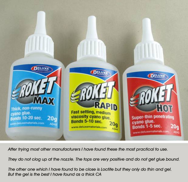

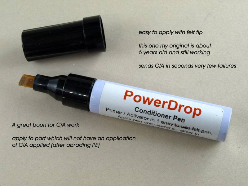

Produced this some time ago. Just how I go about C/A.
Laurie of Jersey
Just one item. Power Drop only now take orders for 50 .
But Loctite market same thing called Activator.
