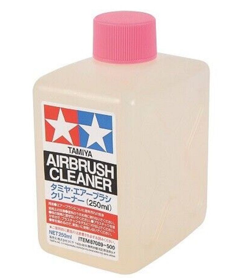

6 times the 40ML bottle, same price, same ingredients.
No mixing required.
Rob.View attachment 100047
Hi Rob, i also know it, but in my country mixing is so much profitable, i don't know US prices for airbrush cleaner.
İ'm also wondering if this airbrush cleaner harms the teflon seals or o-rings of airbrushes, it's the exact same material of cement?

İ'm also wondering if this airbrush cleaner harms the teflon seals or o-rings of airbrushes, it's the exact same material of cement? Have you ever tried to ise it for airbrush cleaning?

No sir, never personally cleaned an air brush with it, as silly as that sounds, but I have used it in place of TAMIYA Extra Thin for a long time. I would tend to think that it would be very good for cleaning an air brush, since TAMIYA doesn't usually let us down and I certainly wouldn't think people wouldn't have had problems and reported it to everybody as we're all on pretty much the same forums and groups? I just don't think they ever figured we would find out it's basically the same product as Extra Thin.
There is no doubt in my mind that bulk mixing would be cost effective, but over here, that 40ML bottle of TAMIYA Extra Thin is about $$5-$6 US and that bottle of 250ML TAMIYA Air Brush Cleaner is $7-$8 US, it doesn't work out all that bad.
Rob.

No, we don't brew our own thinner to clean airbrushes. Only one way to find out is test it on your own airbrush. Be forewarned, it may go badly.
