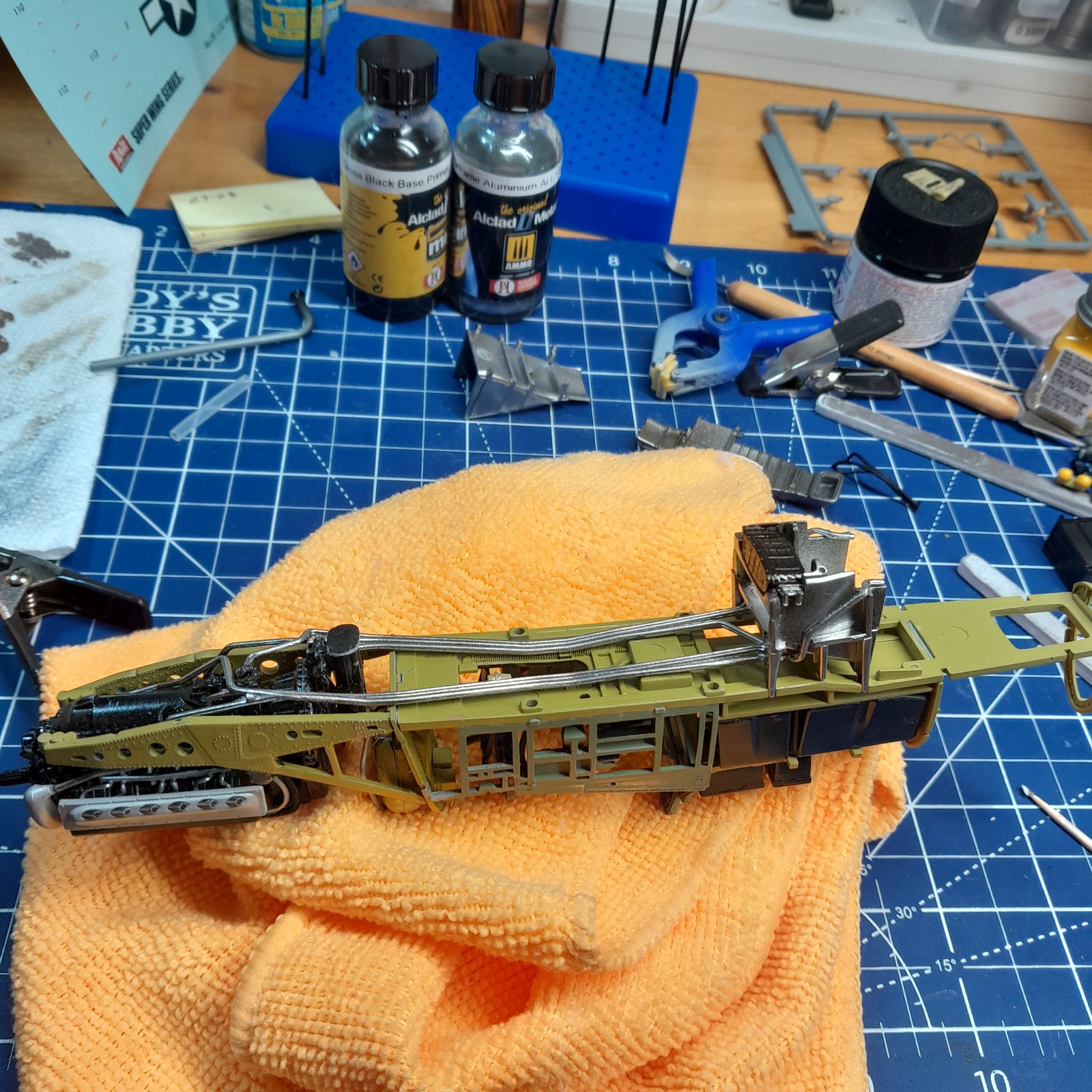

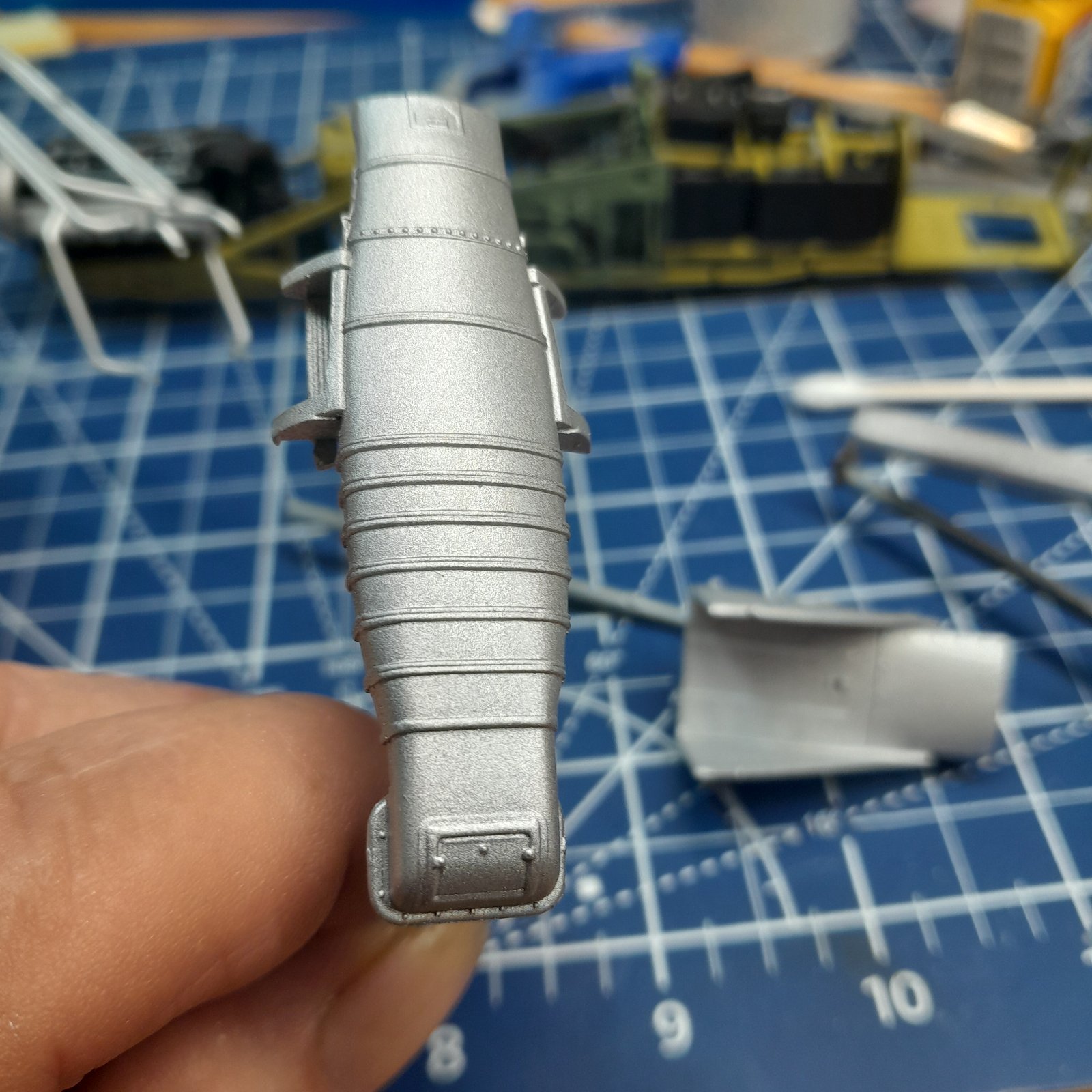

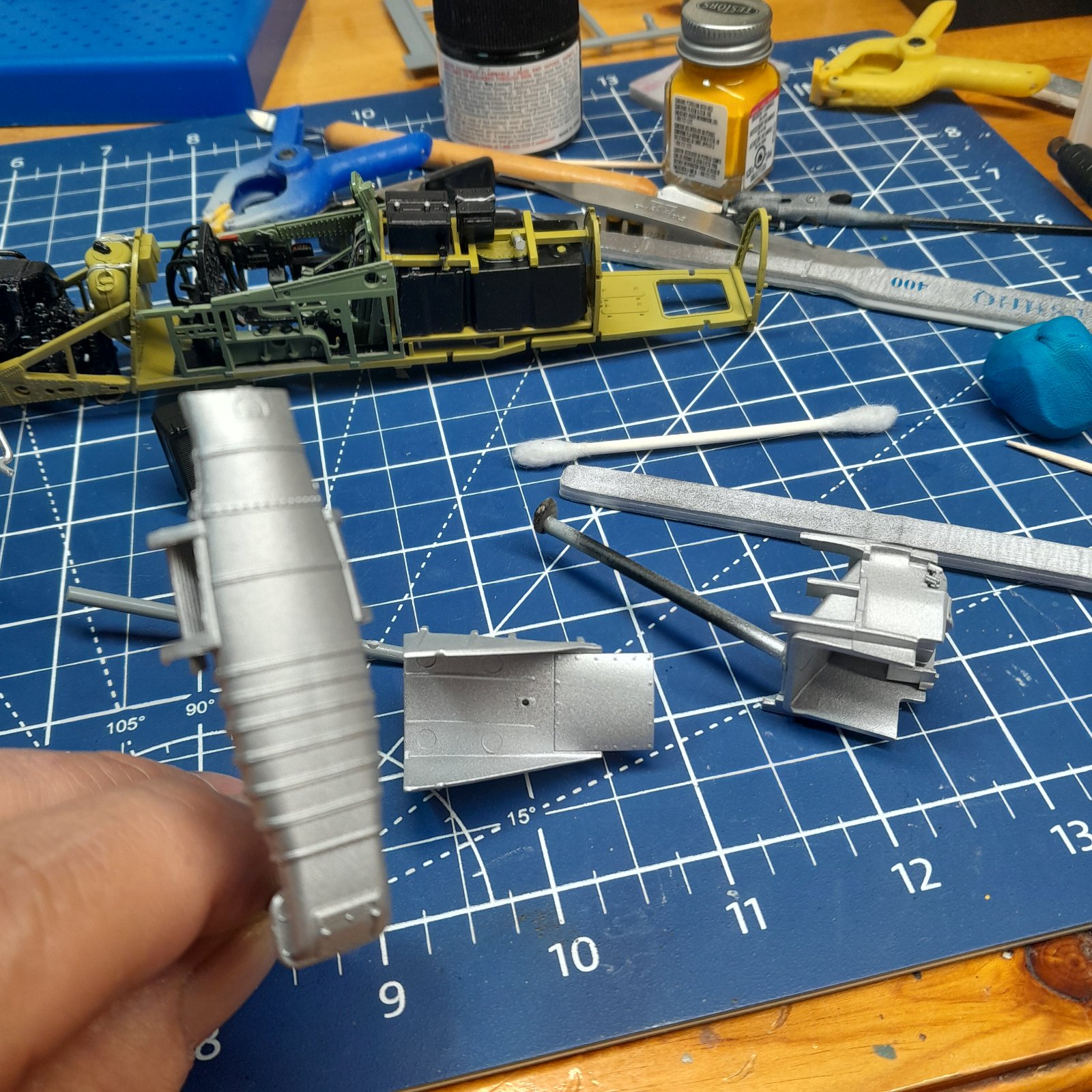

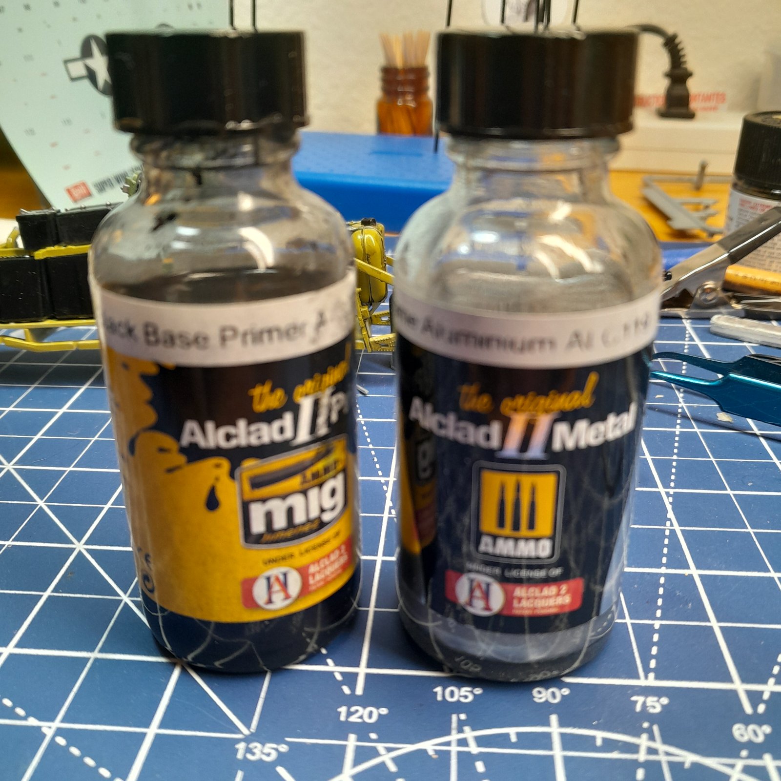

I sprayed this P-47 on Friday with gloss black primer (alclad) and let it dry for about 48 hours in my closet. Before leaving on a 2-day business trip I hit it with two thin coats of silver, and I think it is too shiny!
I'm not too worried (yet) I have other silvers that I'll try to tone it down with. Just supporting what you say about how smooth that stuff is.

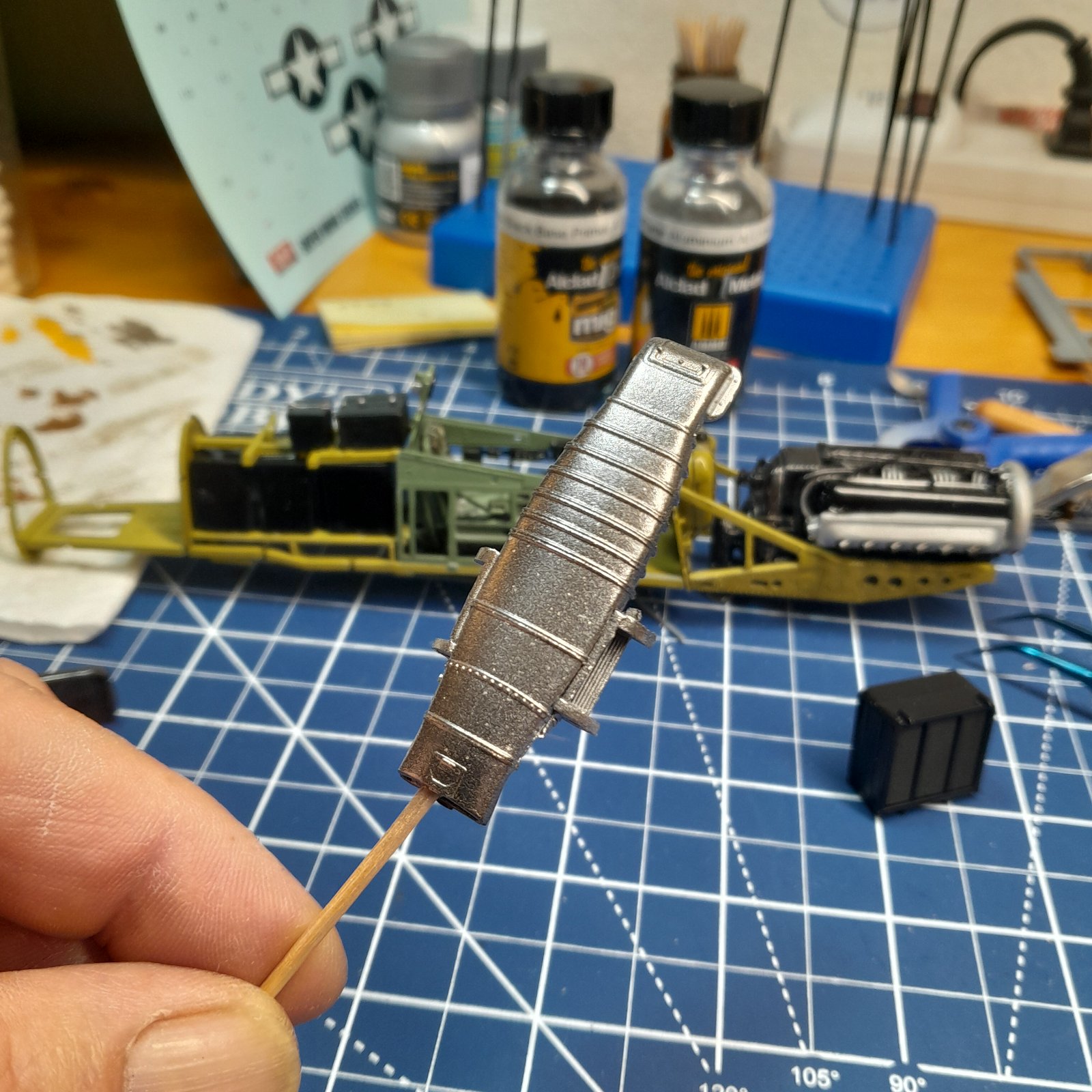

Yeah that's looking great. And when you add other colors and tonal variations that's when it starts coming together. Have you found that that gloss black base primer does not dry quick? I sprayed on a medium coat and waited 30 minutes and sprayed another layer of paint until it looked really good and that was this morning. Right now it's 7:00 at night and I can still smell it gassing off. Maybe I put on too thick of a second coat but I figured that lacquer paint would have dried by now
The Alclad gloss black for sure! The first time I used it I added about 20% thinner, their brand, and I'm willing to say it never dried, or hardened. It felt dry to the touch, but when working with it and sanding, I found dust and fingerprints embedded into it.
Did a little reading up on the interwebs and some people claim it never fully hardens. So in the example above I did not thin it at all, then waited ~48 hours and sprayed the color, all while handling it with cotton gloves not my usual plastic ones.
Sprayed the polished aluminum. Wow? At least for me. Why didn't I have the stuff when I was 8 years old? It felt hard you know the gloss black? It still smelled a little but I went ahead and sprayed cuz I'm a rebel.

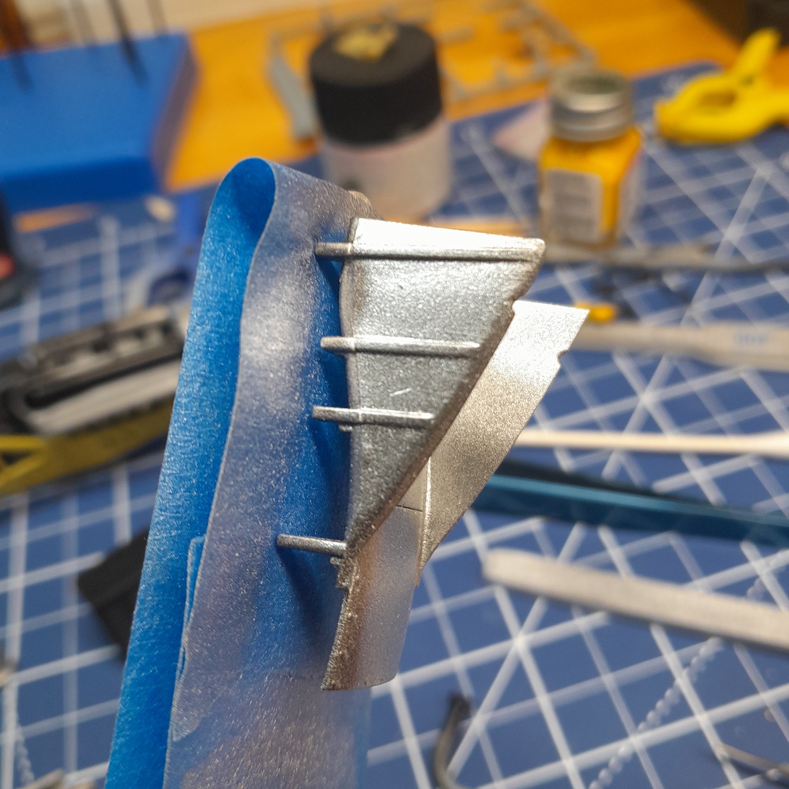

Okay here's a couple teasers. I was worried when I was taking the masking tape off the wings but all is well. Threw a little bit more masking on the wings and painted the flaps and alaron's. I can't stand it. My phone is an idiot. Speak into the microphone and it doesn't even know how to spell pilot lingo. Annoying. You get the gist of it. I'll have to fix a couple panels one where that piece of hair landed and one where my stupid ass finger got on it. Sometimes you just want to take the Flack Hammer to yourself

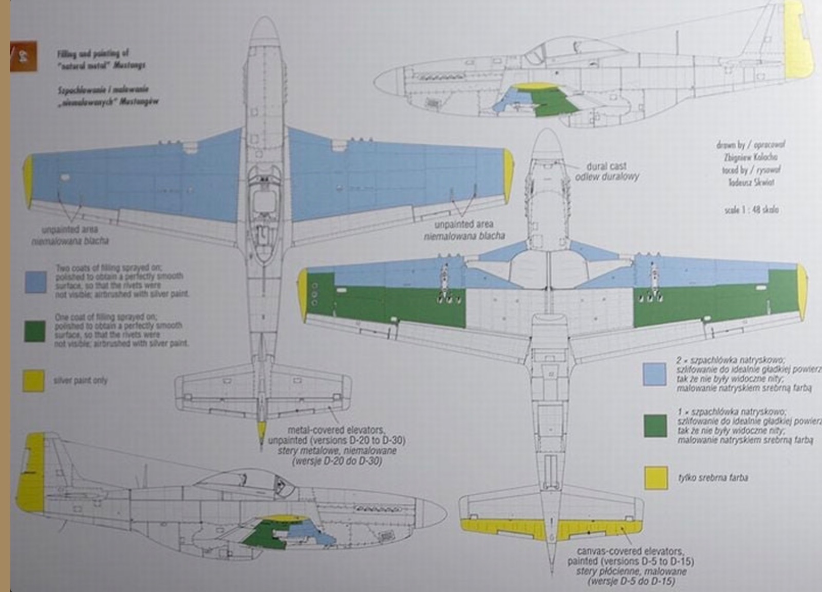

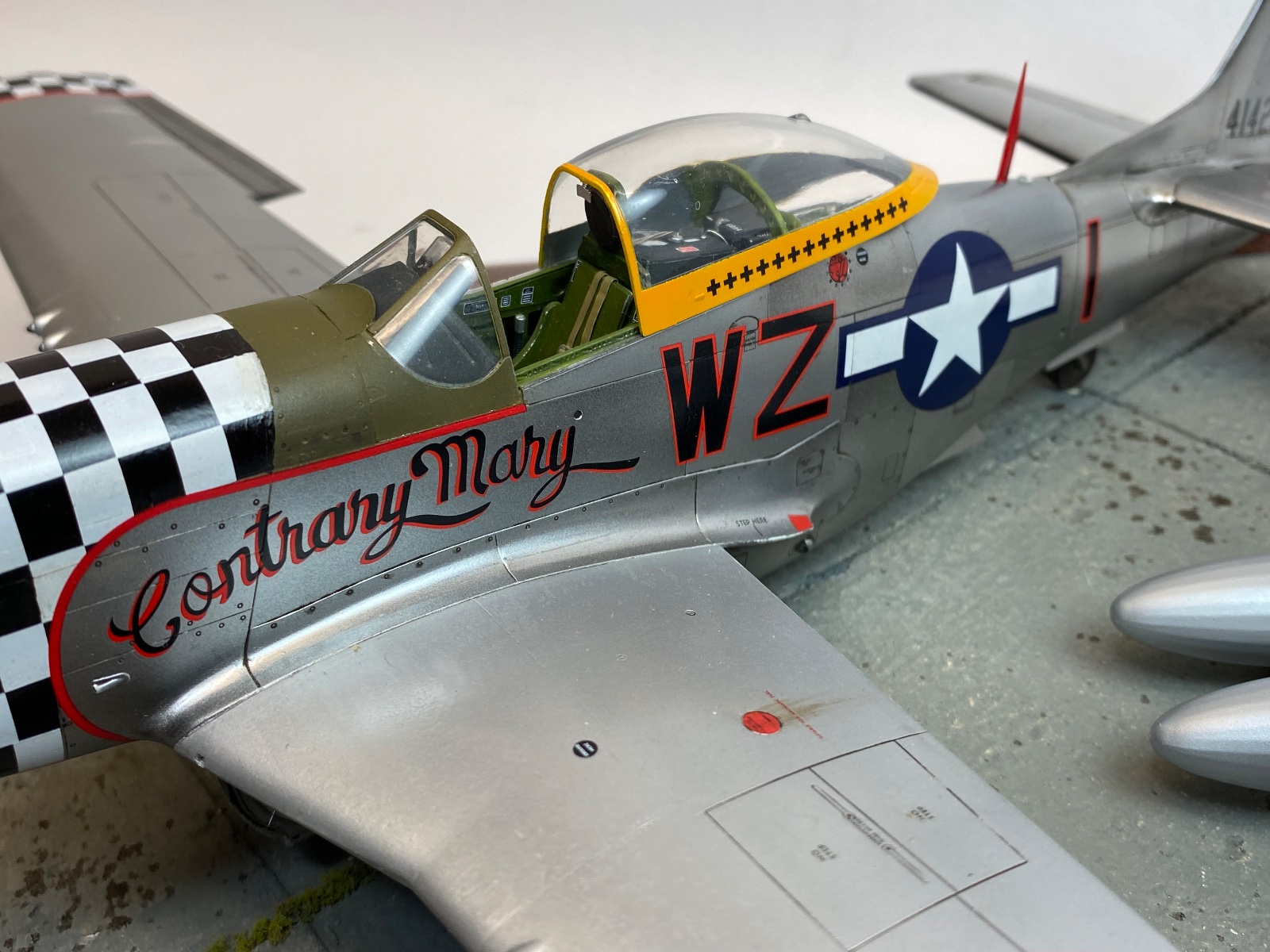

Not the best pics, they are taken by my phone from a computer screen, but silver P51s have been some of my favorites at the airshows over the years.
I know the finishes aren't WWII correct, but just wanted to share some cool (I think ) pics for motivational purposes:)
Cool pictures. And I see Red Dog. That's the one I'm depicting. Maybe it's the air scoop or could be the shape of the wing but it's just a cool looking warbird. Maybe not the greatest dog fighter but it made up for that in other areas.
I know full well that high-res photography did not exist in 1944-1945, but if it did...
Does anyone think front line fighters would look this clean and polished?
In my opinion no, but I still want to build one to look like this. Is that wrong?

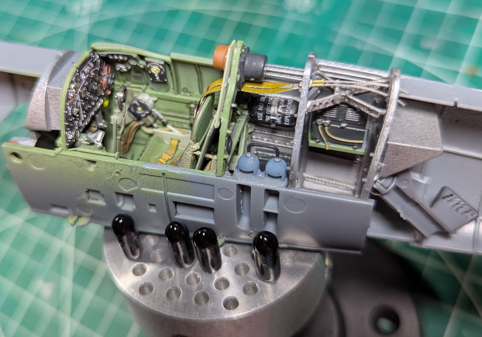

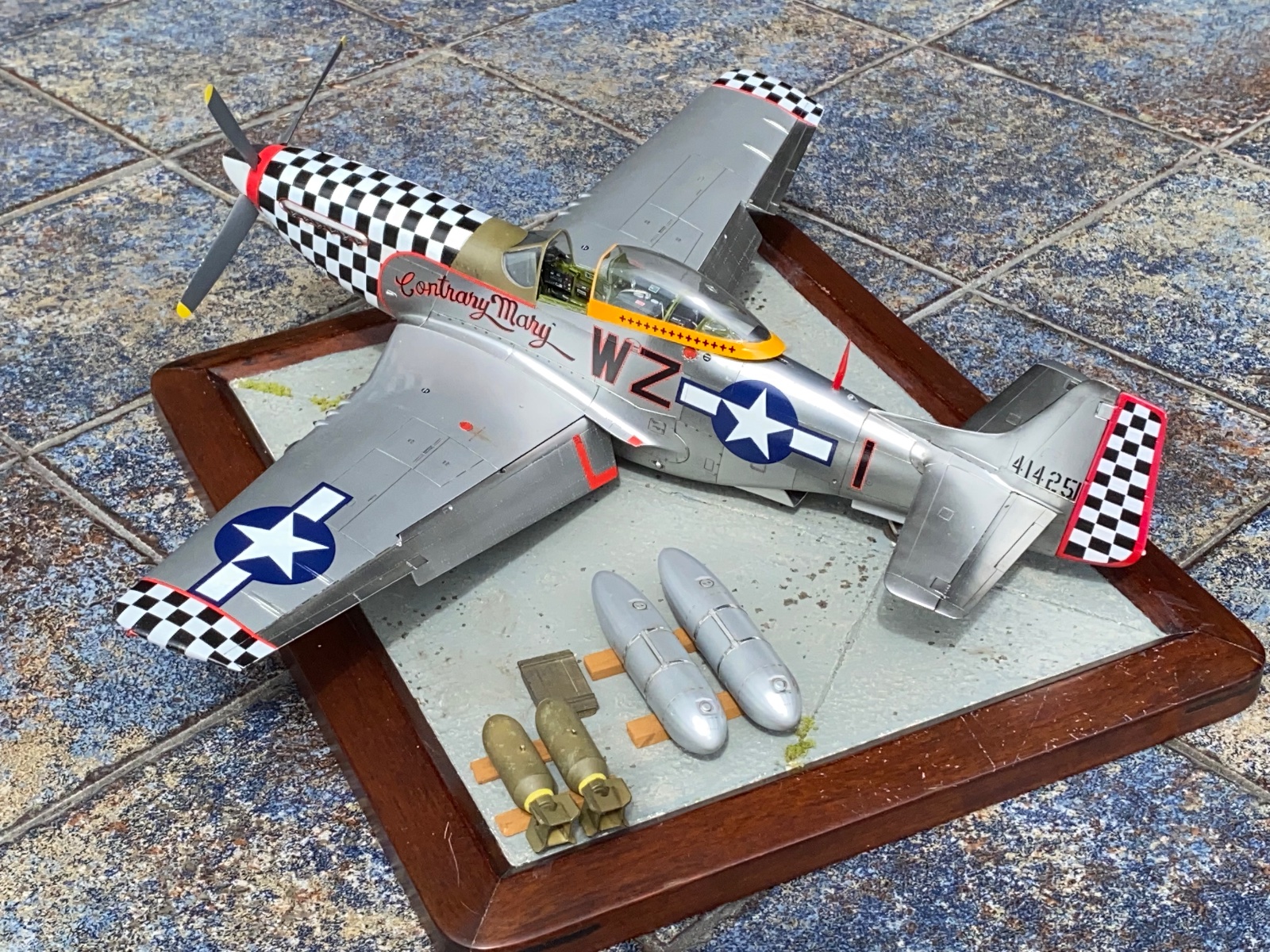

It's almost finished. Waiting on easy line. And this is what happens when you don't go through and just read everything before you start building. I get in the instructions and boom there's Red Dog. I like that. That's pretty cool. Lots of aluminum showing. Sold. So I did not look in the packet of decals. I just preceded to build the airplane like it was going to be red dog. Except the instructions yes, we're for Red Dog, but that was the previous outlay by ZM. So in this kit they just took the instructions for Red Dog and added a couple things to make it a k model and a British model and an American model but it's painted. Mine's all aluminum. So I just went through all the decals and put on what I wanted. It doesn't match no known plane in the universe but it looks decent I think.

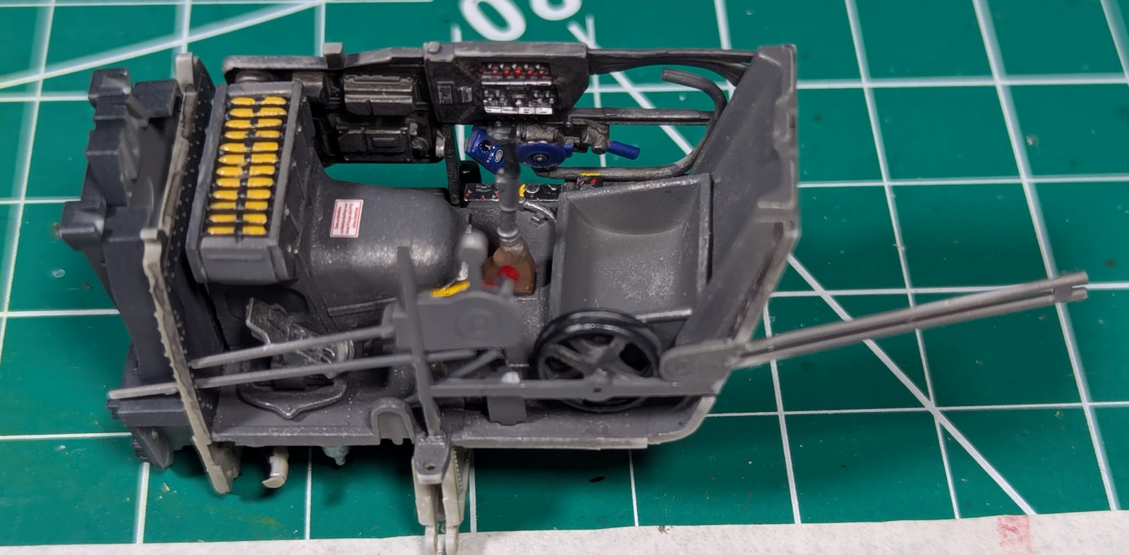

First time I see ammo belt feed opened up; nicely done! And that bubble canopy, beauty.
With a machine gun access doors? I might have taken liberties with the way they're positioned. I ran across the picture of a guy loading them and the two long doors he had taken off and laying on the wing where they are in the picture and the door at the top of the wing is like it is in the picture I saw but I did not see the bottom door anywhere so he must have taken it off and set it somewhere. I didn't want it to get lost so I just glued it in the open position. Cuz I'm pretty sure he had to take that bottom door off to slide in the machine gun itself, but would they take off that bottom door just to load up ammo? I'm afraid that is a question for my more learned fellow modelers
