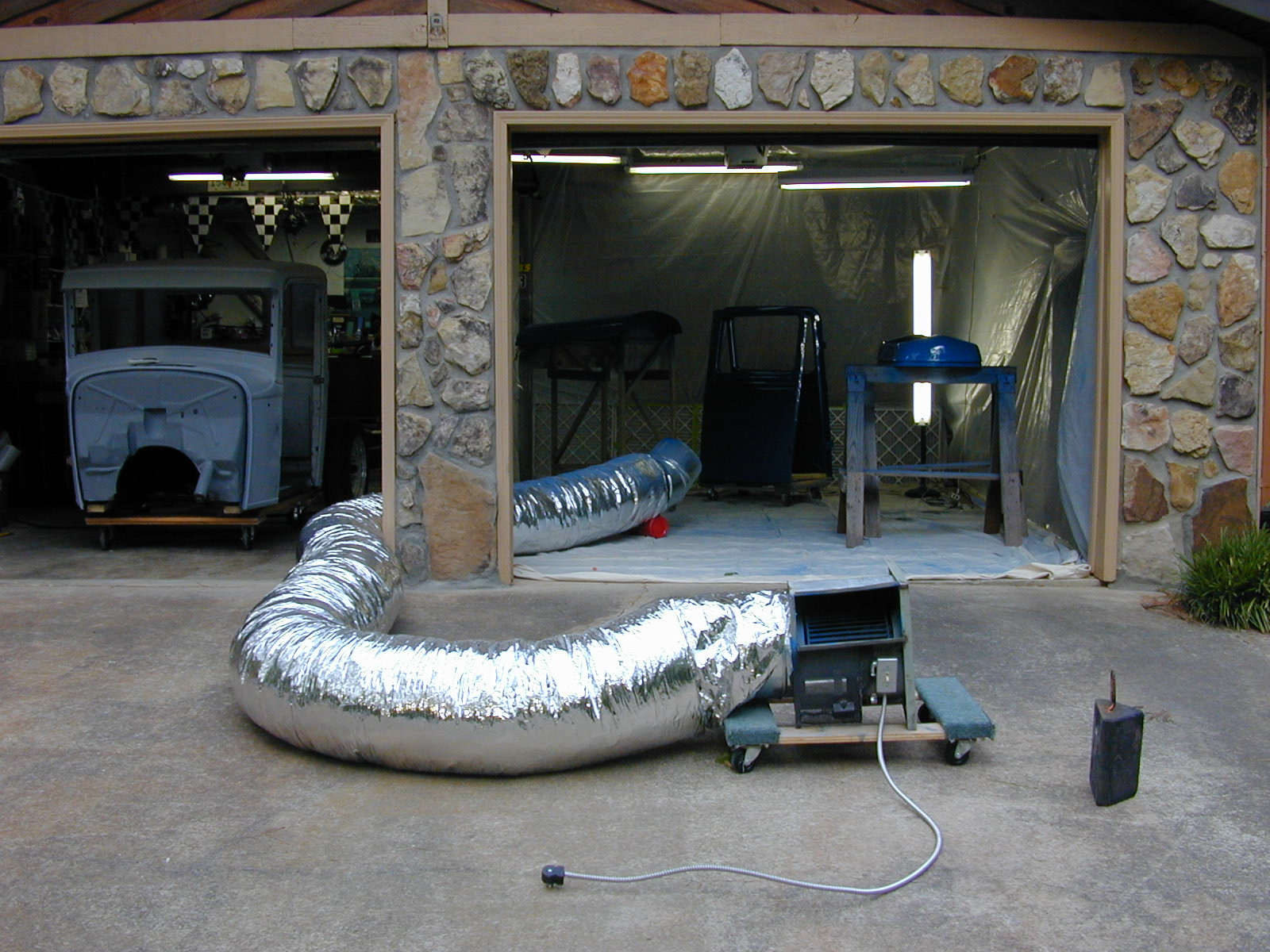

"spray booth with outdoor venting" An air brush & 10 - 20 min painting, in a garage. I don't think it needs all that.
Painting a HotRod truck, yes, a spray booth with outdoor venting is a necessity.

Garage painting will be fine. My spray booth is in the basement, so no overhead doors to vent out.

Get a good, outside vented spray booth, and keep building longer.
