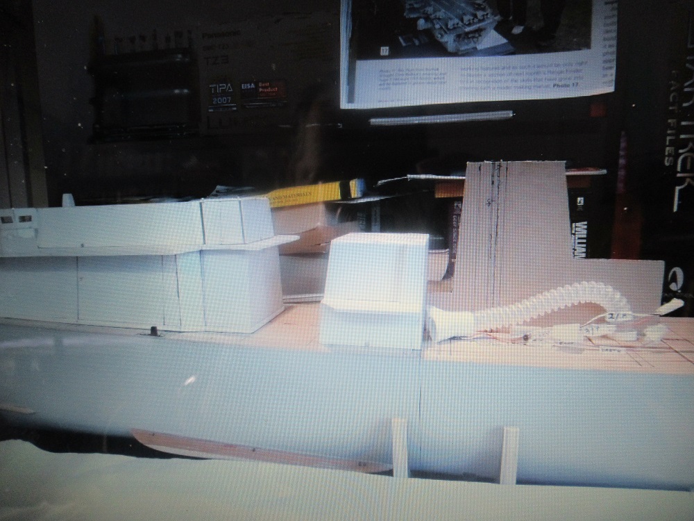

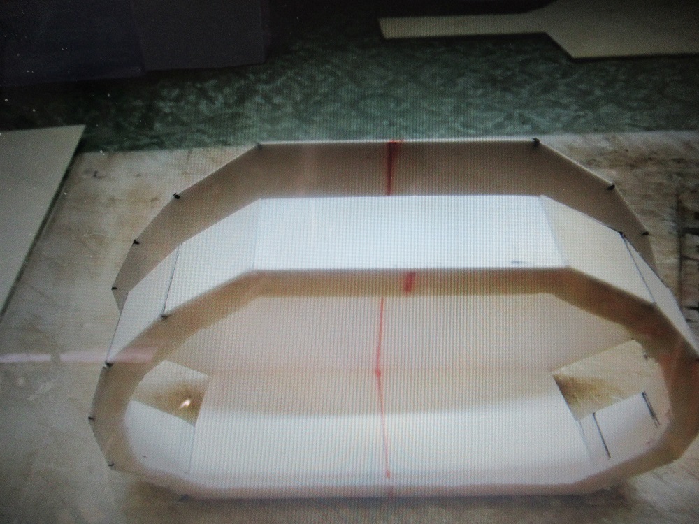

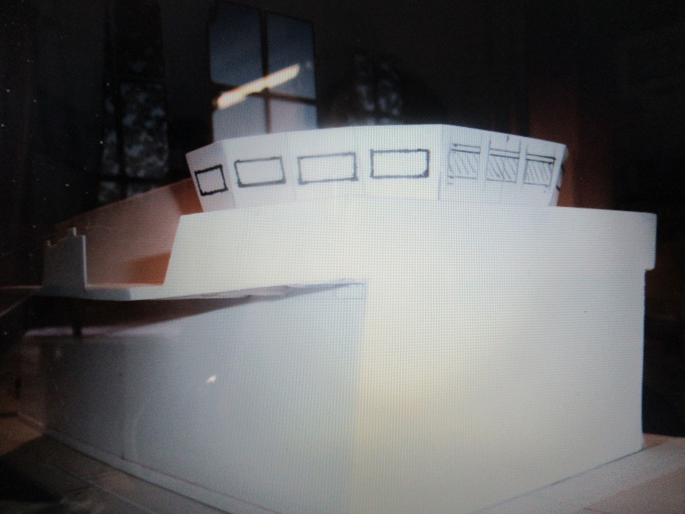

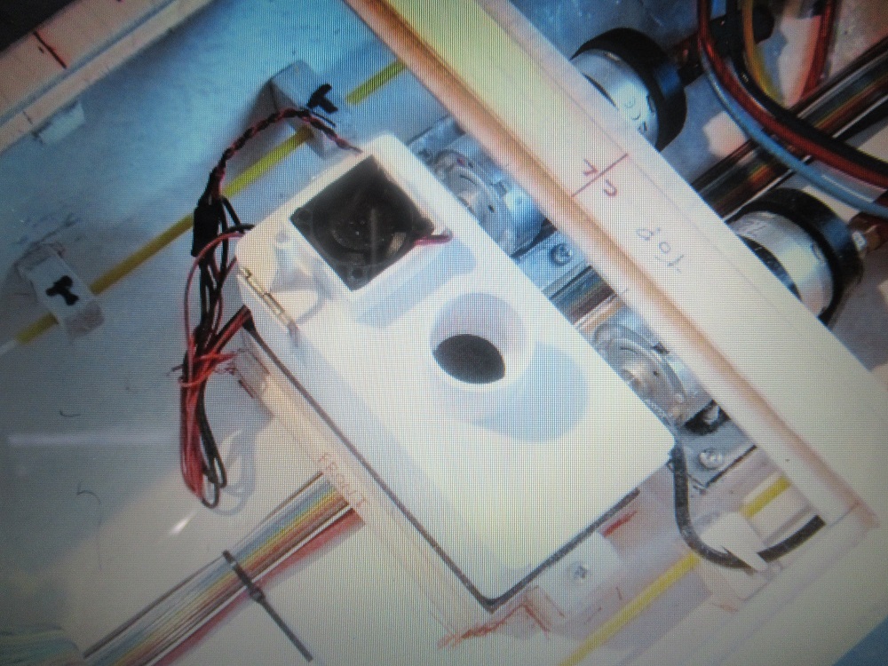

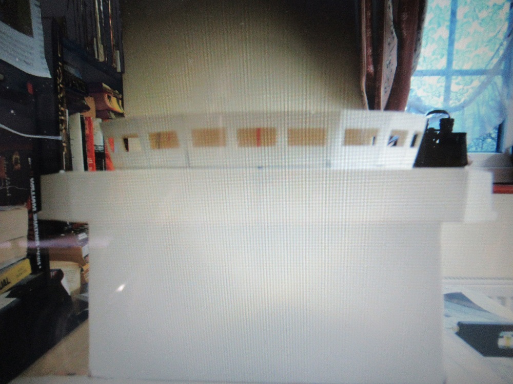

still buildin that bridge as i left off the bottom so i could fit in light green acetate for the bridge windows an fitting in the lights white for day an red lite for night

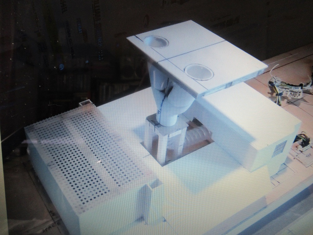

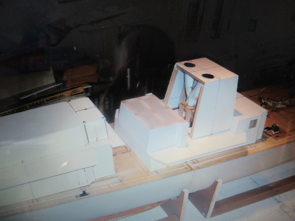

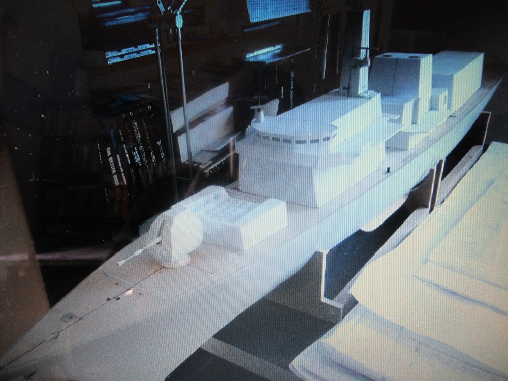

AN HERE a underside shot of the main bridge S/S an ive fitted a steel rod accross to connect up from the main radar shaft gearin to a small 90 degress gearin to drive the shaft that power the big radar on the bridge roof

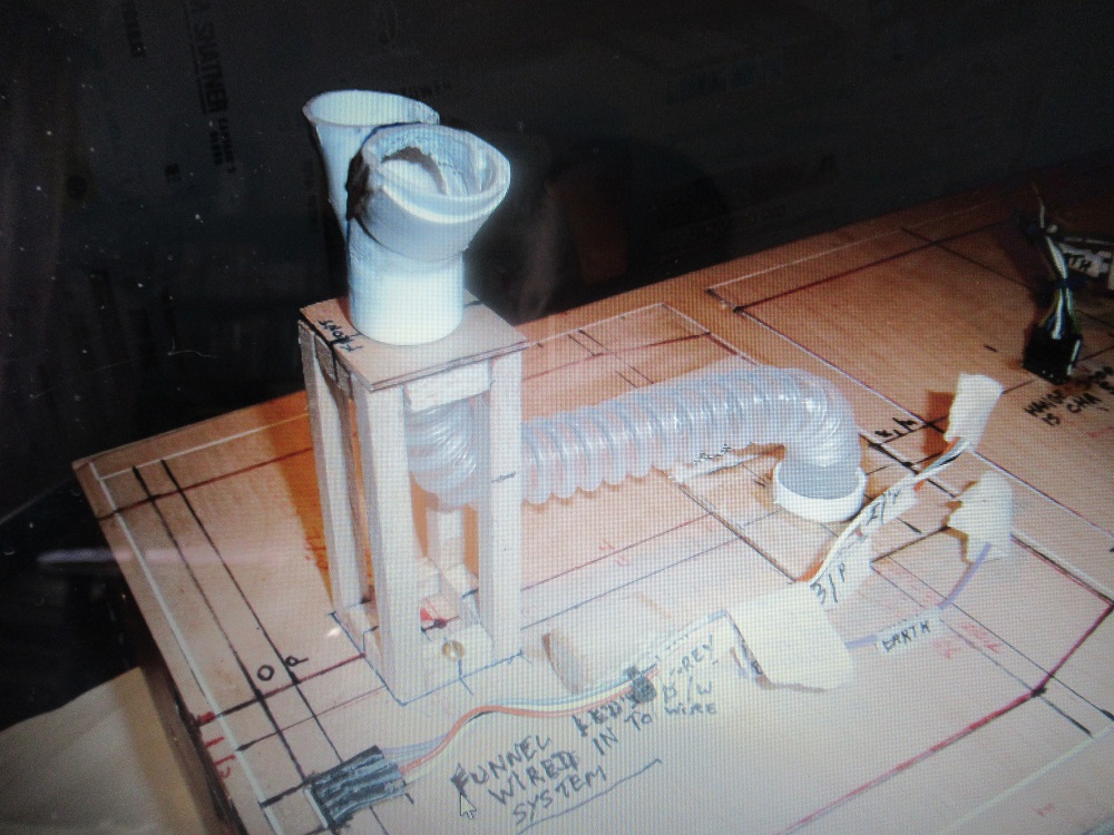

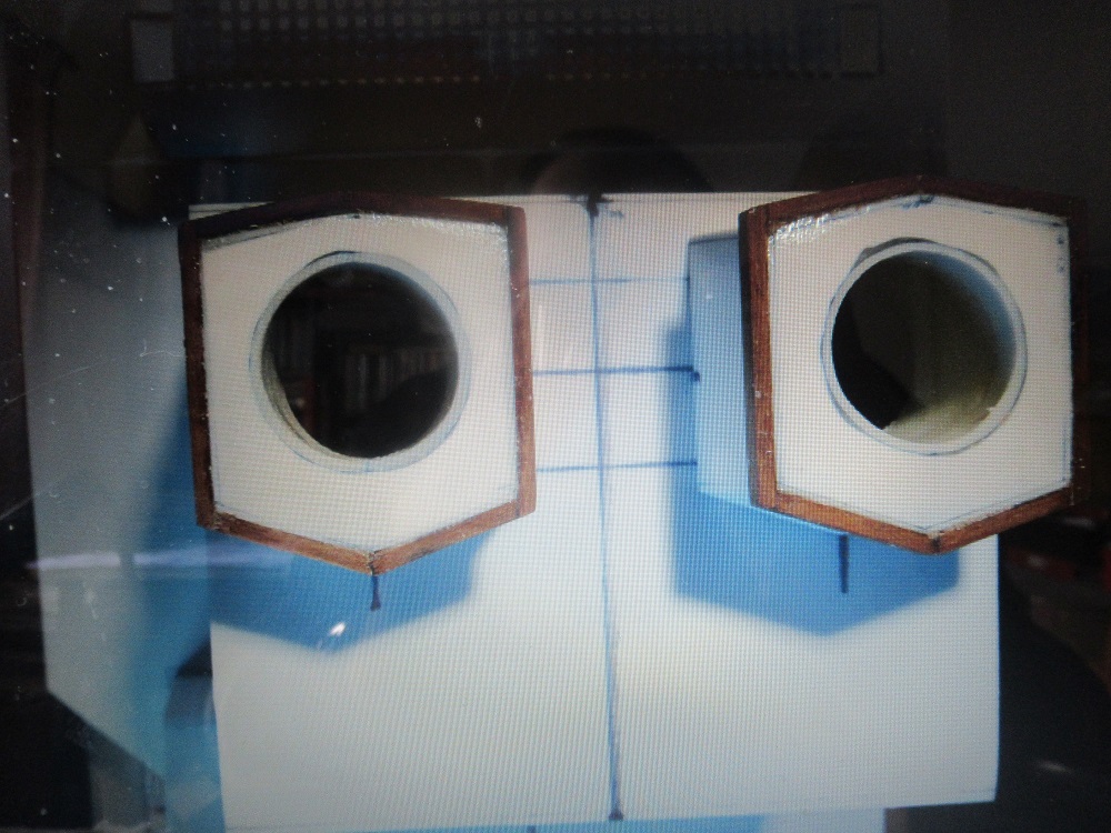

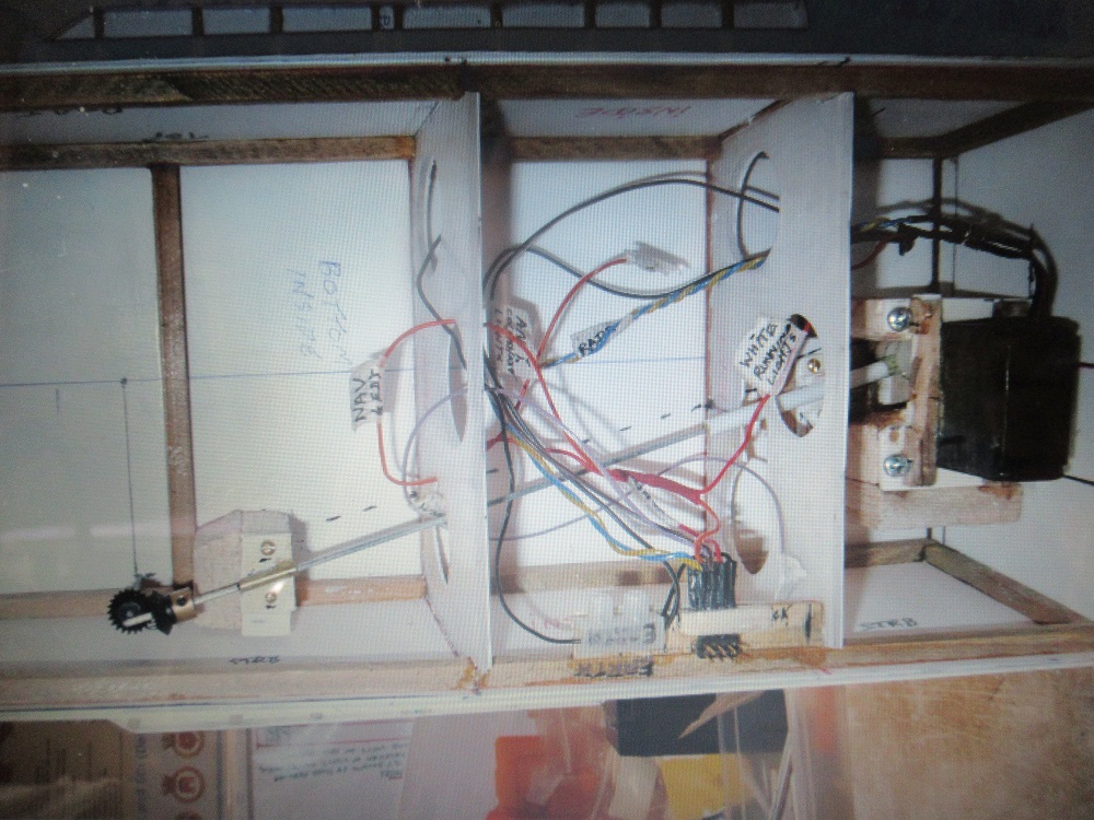

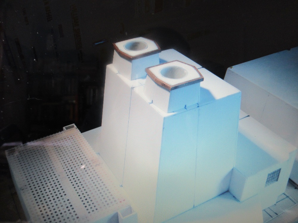

AN HERE the smoke tube bein made ready to accept the sqaure stelth funnel to be built around it

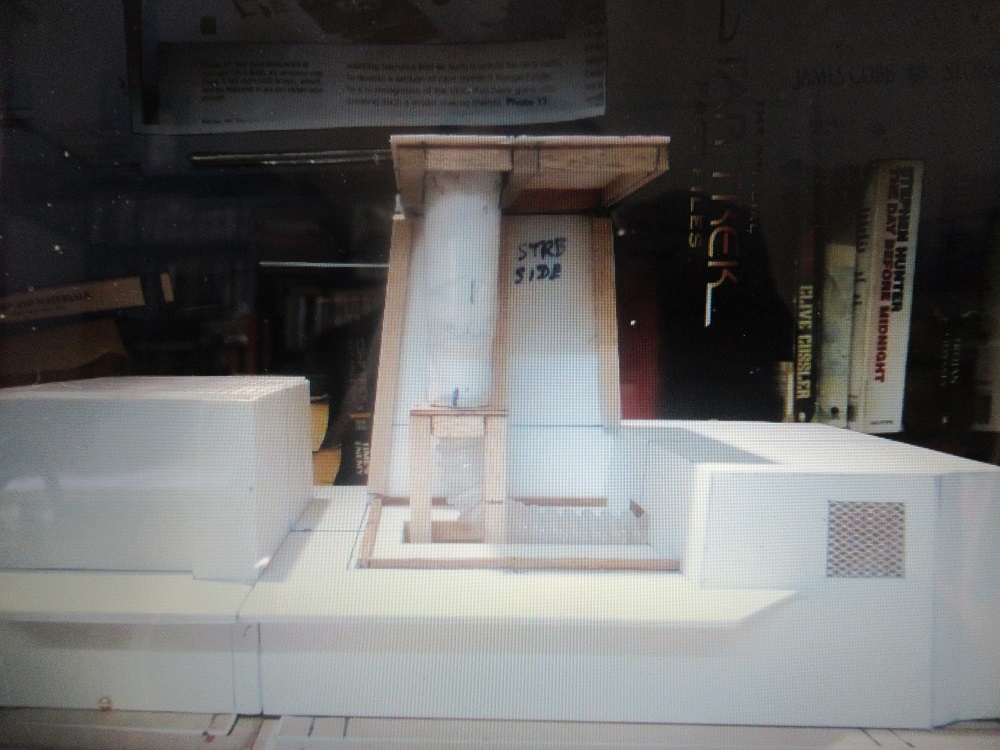

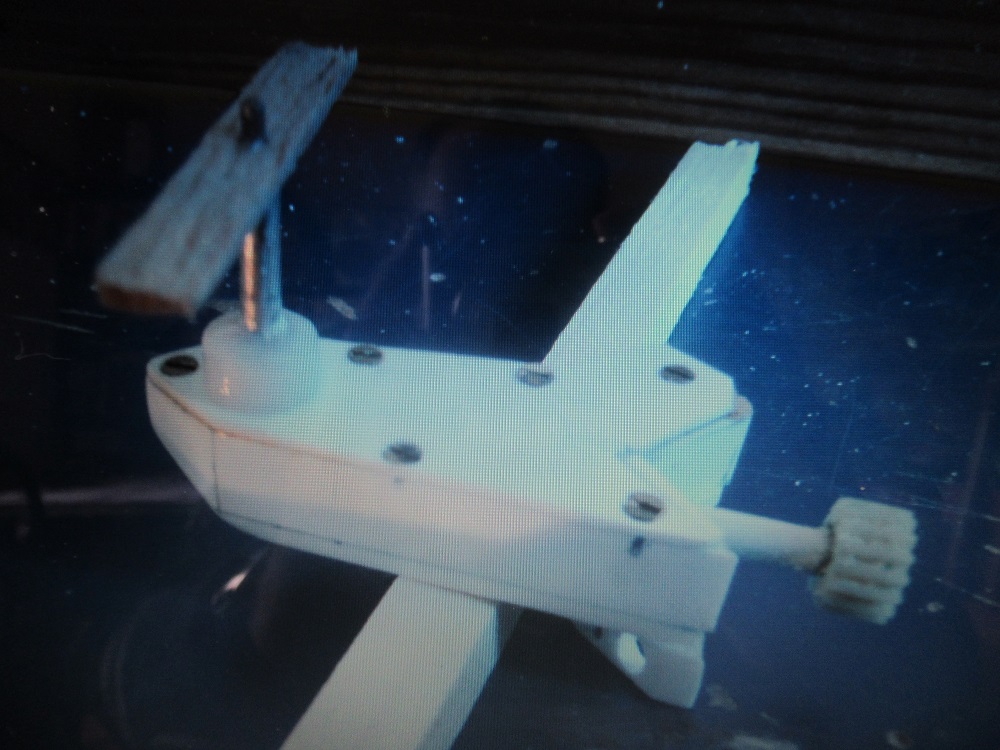

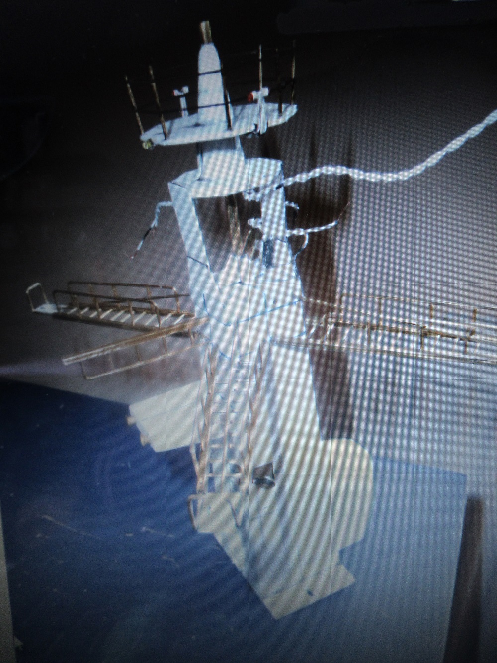

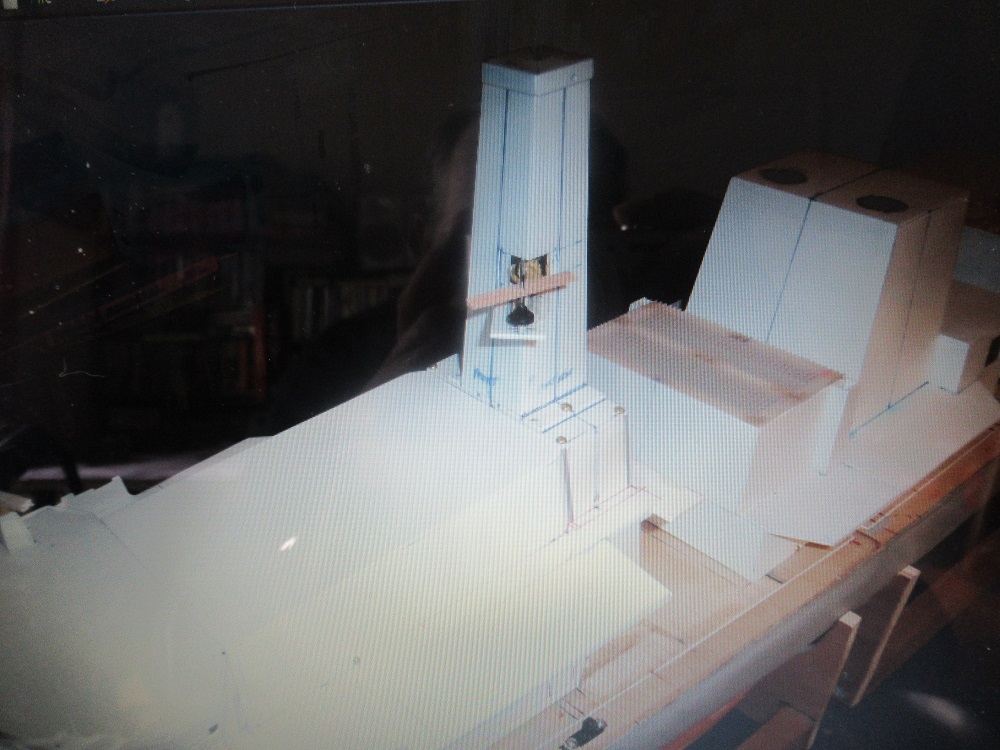

Here the front fore mast is bein built an a slot hatch cover has been cut in the mast for the small working navigation radar workin from a crown gear fitted onto the main drive shaft that drive the main search radar on the mast top
an this nav radar screws onto the fore mast to have a gearing set into the main crown gear in the mast hope you can understand how this was accomplished

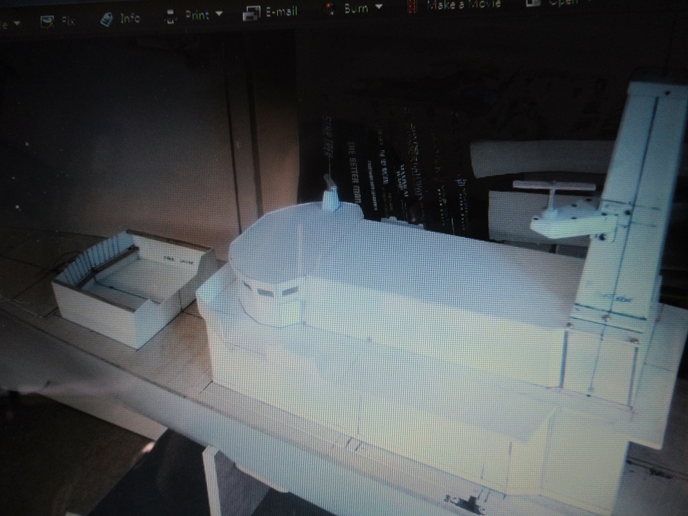

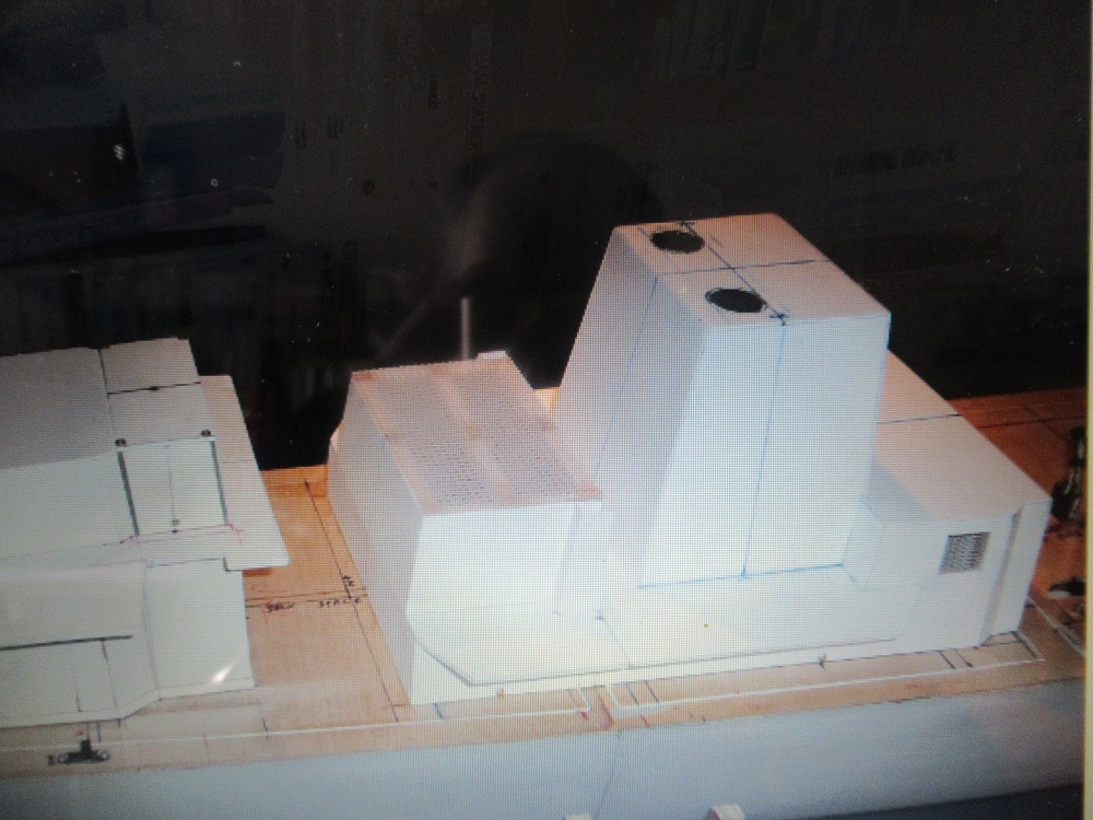

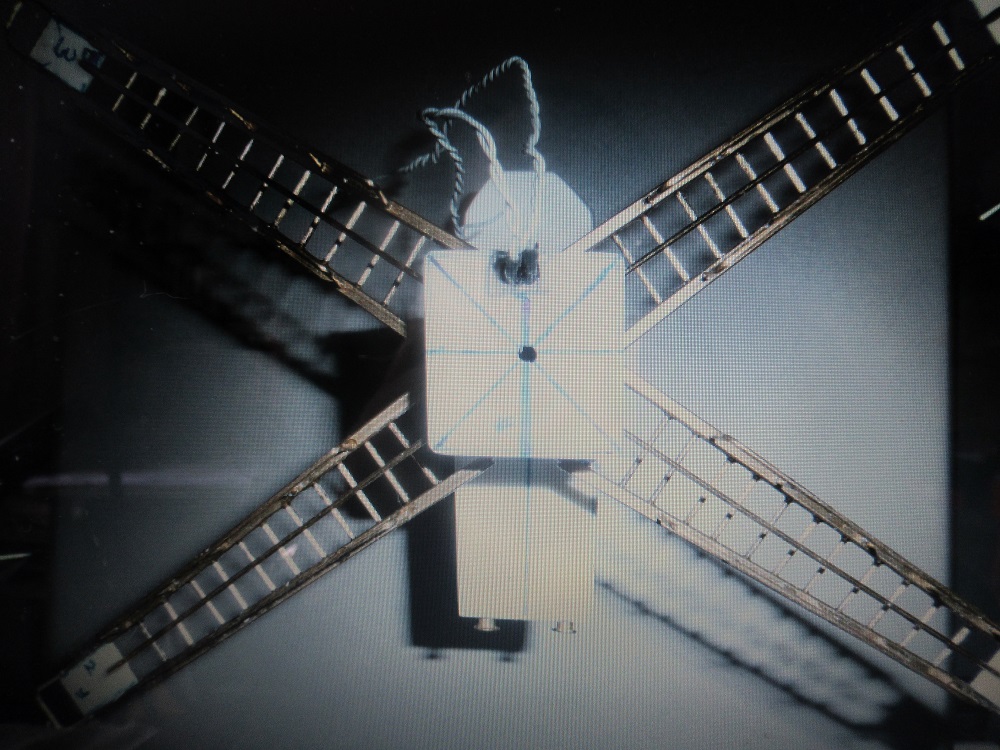

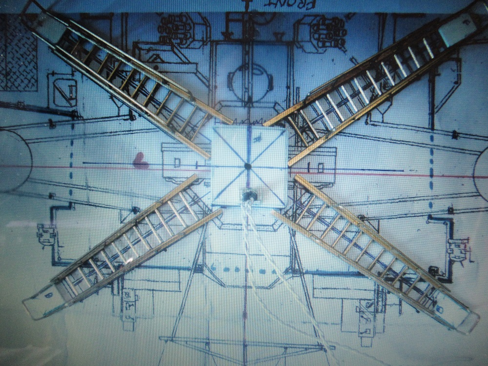

main bridge an mounting for the bigger radar on the top of the bridge but havnt fitted on the radat yet as they are made fron brass box section but on the one ont the fore mast it was just a bit of balsa to test if the radar speed is right

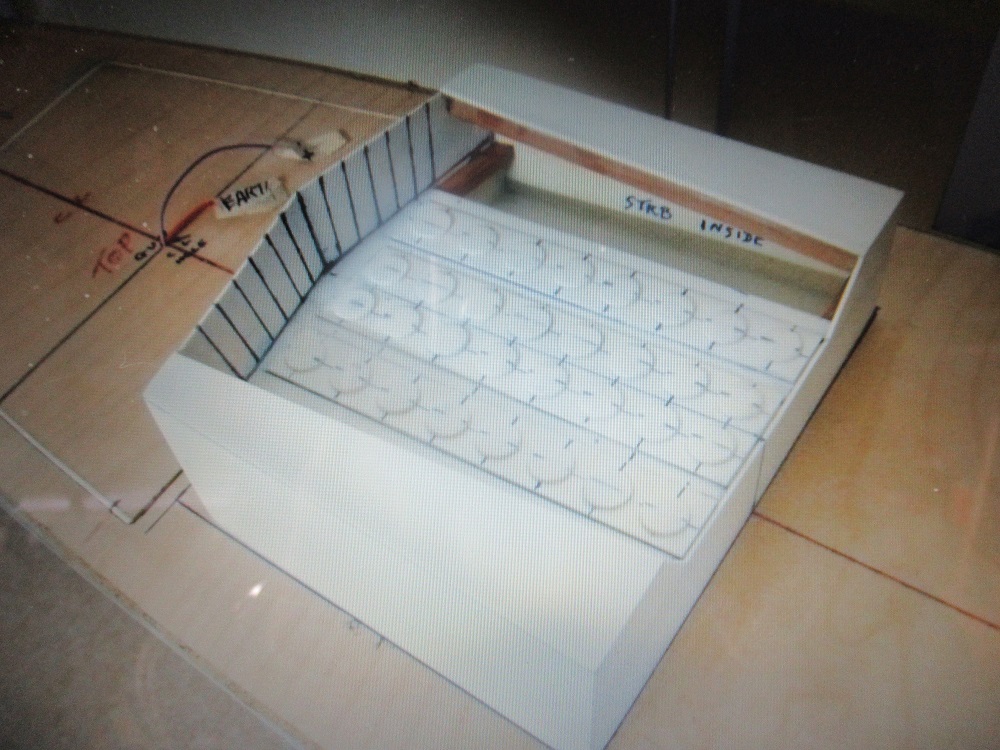

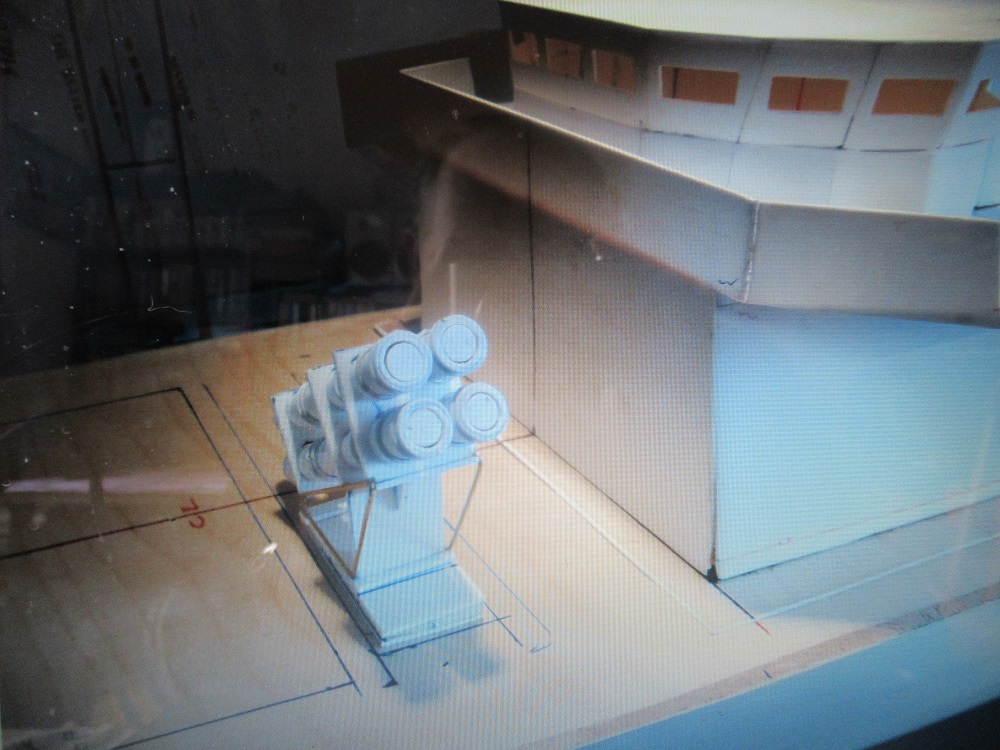

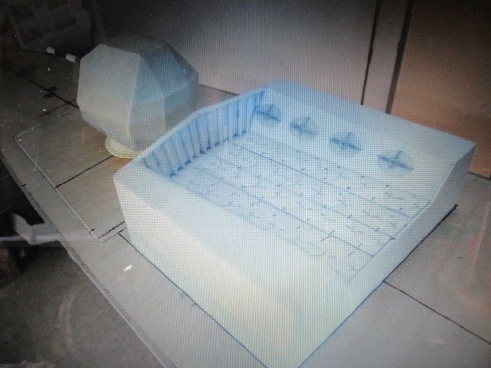

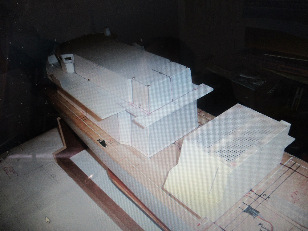

SEAWOLF missle module bein built an its like every thing it can be all unscrewed an removed fot maintanice
