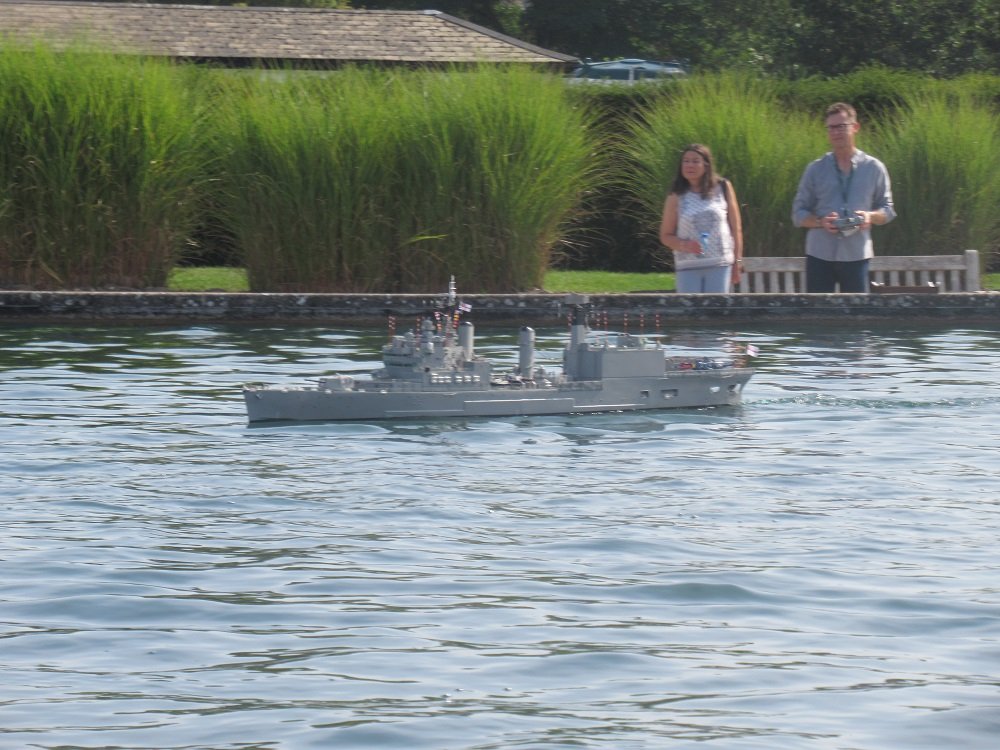

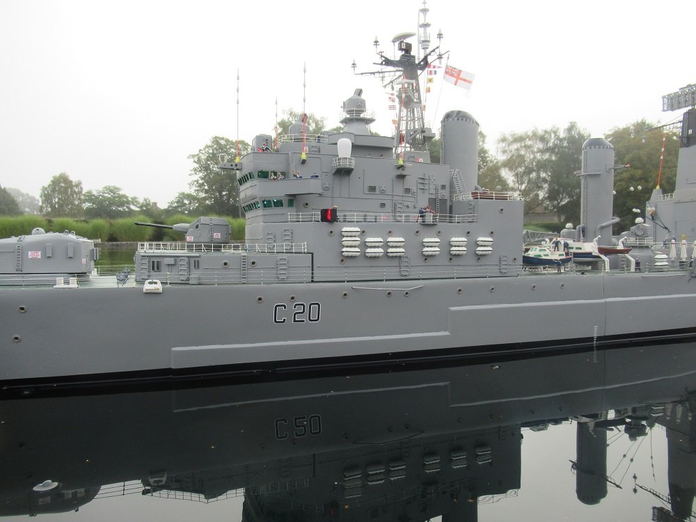

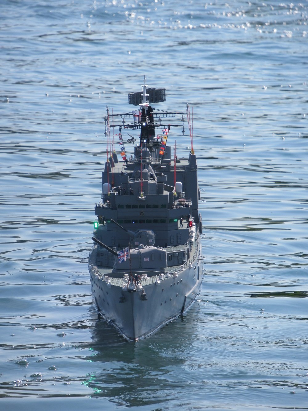

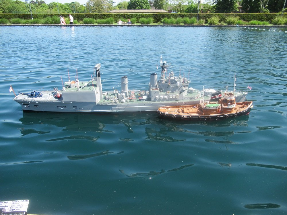

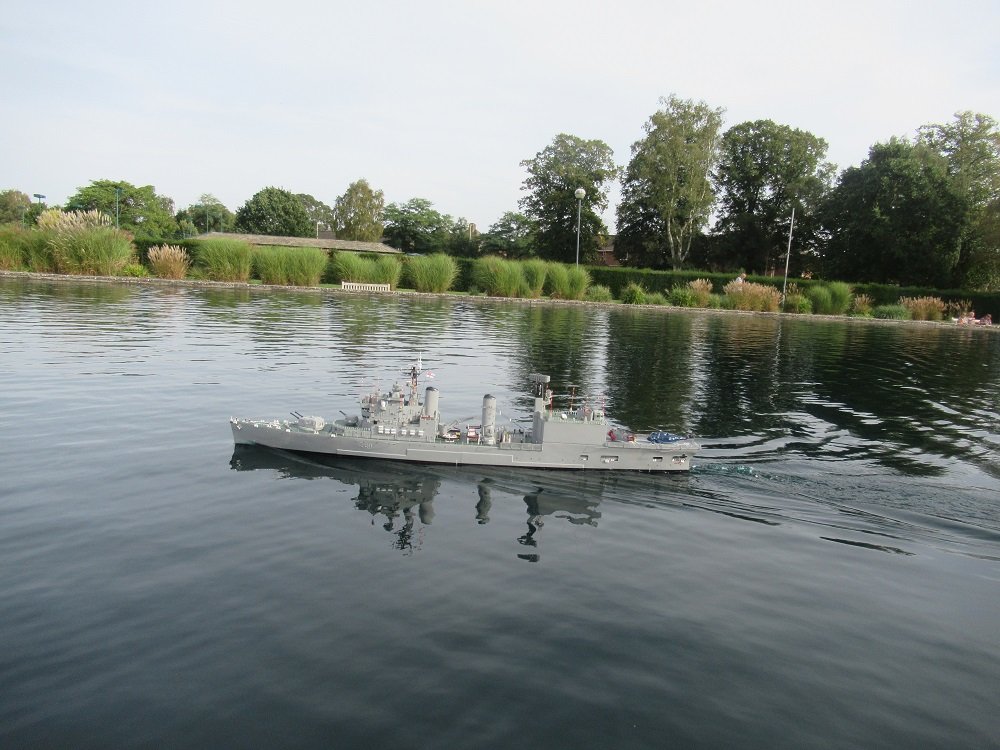

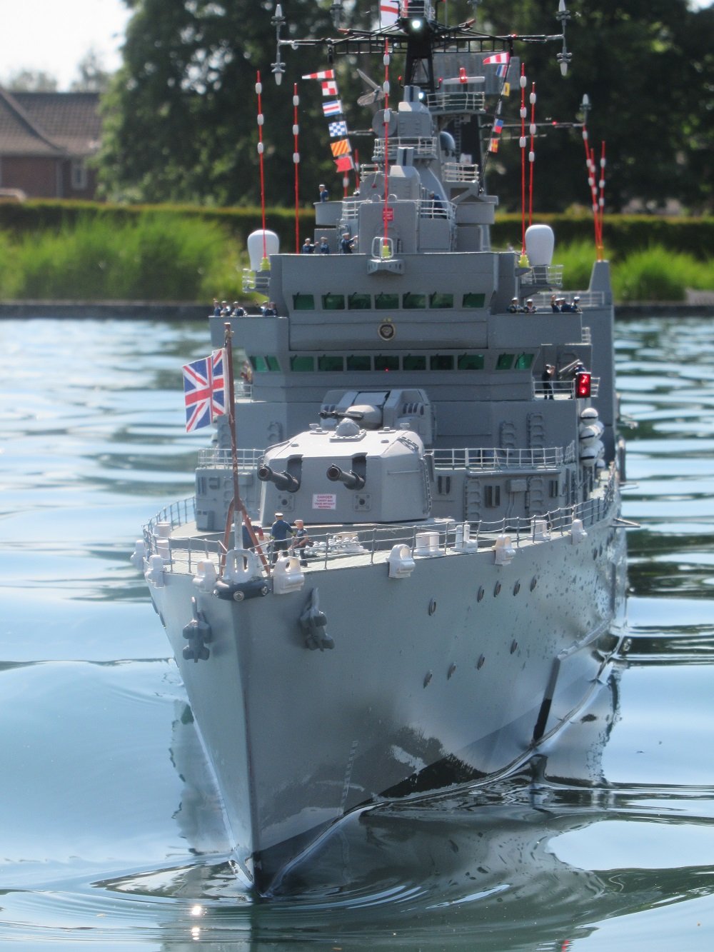

AN here she is on her maiden voyage on norwich pond an she performed great apart from a lousy turning circle but will work out how to make that better an her guns trained ready to fire

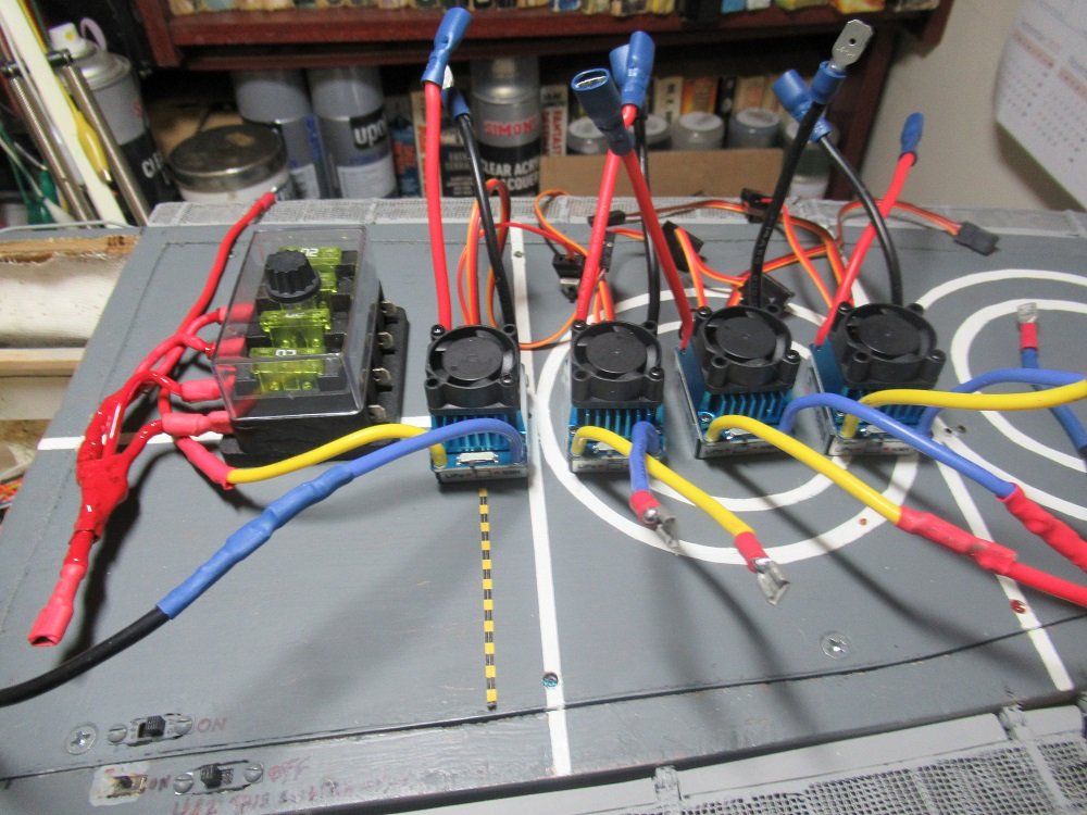

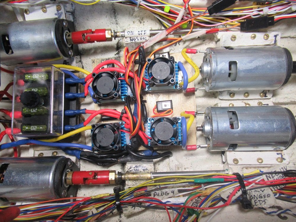

AN HER internal eletric were not really up to the job so it was a case of strip the 30 amp eletrics OUT
an fit in her some 40 amps eletrics an that made a heck of a difference an here ive fitted in one fan cooled 40 AMP ESC PER MOTOR AN BIGGER MOTORS AN FUSES ONE FOR EACH MOTOR

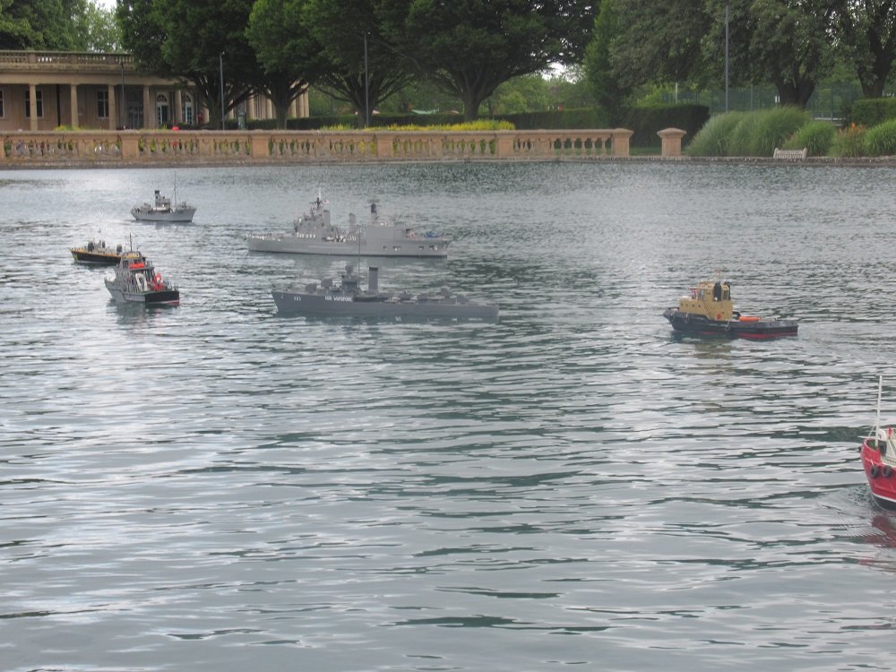

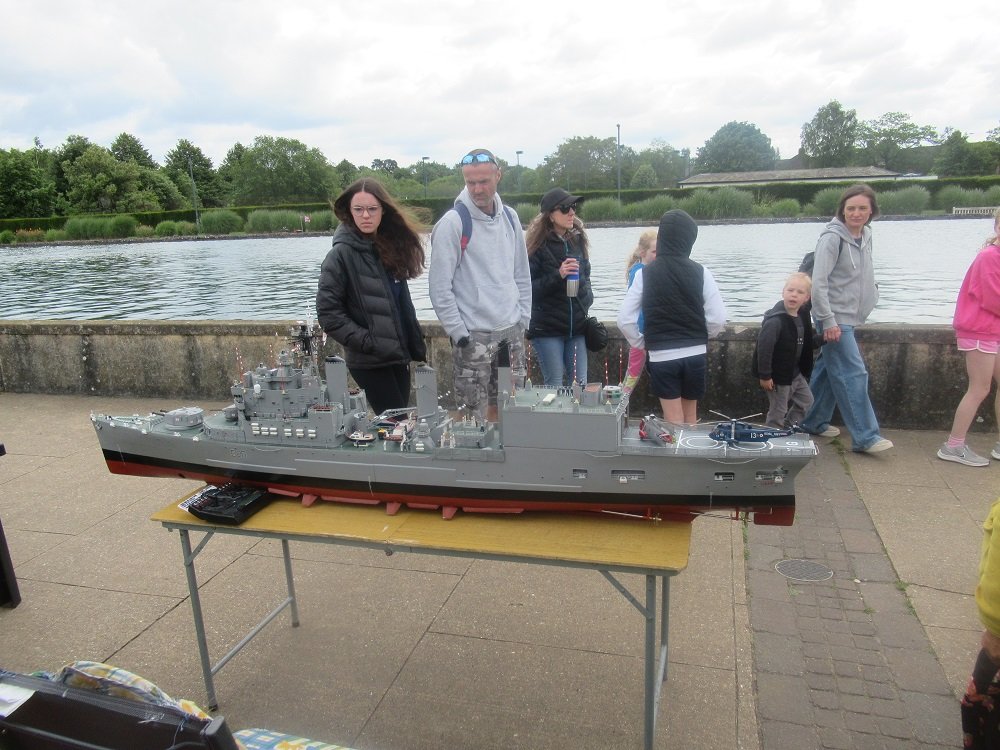

here just some of the members of the public takeing an intstrest in tiger an i was asked if they can see inside her an a small talk about how the ship was built as they thought i bought it from a shop but there wont be any shops what would sell a ship this size an the price would be dear to say the least as in some model shops ive seen just a small boat goin for 500 quid so lord knows how much they would charge for a big model like tiger

HI GCB Thanks for your nice comments an the wheight well this is just a guess im afraid but tiger wheighs in at at about between 60 an 90 pounds as that big hull was ever so boughant an it took quite a wheight to get her to sit down in the water hows that

Whaou! So, do you have a mini crane to drop and pick up from the water?
NO just three able bodyeid guys from the boat club to lift her in an out of the water as there are always people all wanting to help so no probs as i cant lift her as i have back probs
