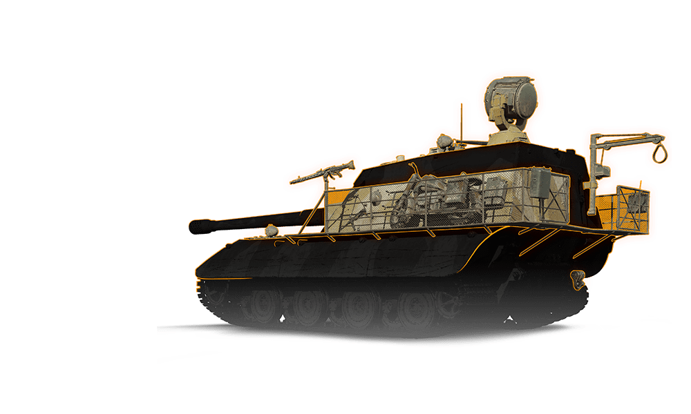

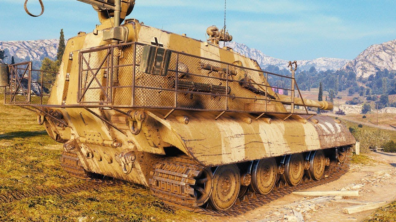

I am currently building a Jagdpanzer E-100 1/35 scale model and I wish to "kitbash" it into having a look similar to a skin from World of Tanks.
Unfortunately I was not able to find any industrial walkway or any industrial handrails that are 1/35 scale to put them around the casemate. I will leave some screenshots of what I would require.
Can anyone help me with some suggestions?

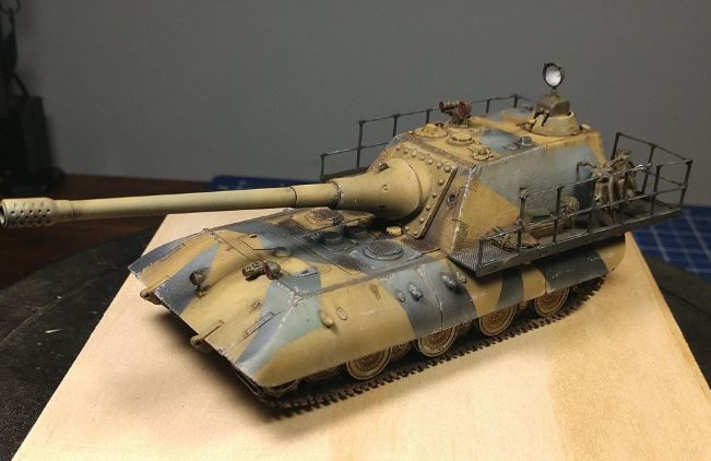

Build the frame out of styrene rod .
Easiest way is to draw it out and lay that under some translucent parchment paper , wax paper or tracing paper held taught so you can see the drawing ( tape / thumbtacks ), then glue it up over that layout using thin solvent cement .
Add one of those PE mesh to the inside , bonded with super glue .
Easiest way is to draw it out and lay that under some translucent parchment , paper wax paper or tracing paper held taught so you can see the drawing ( tape / thumbtacks ), then glue it up over that layout using thin solvent cement .
