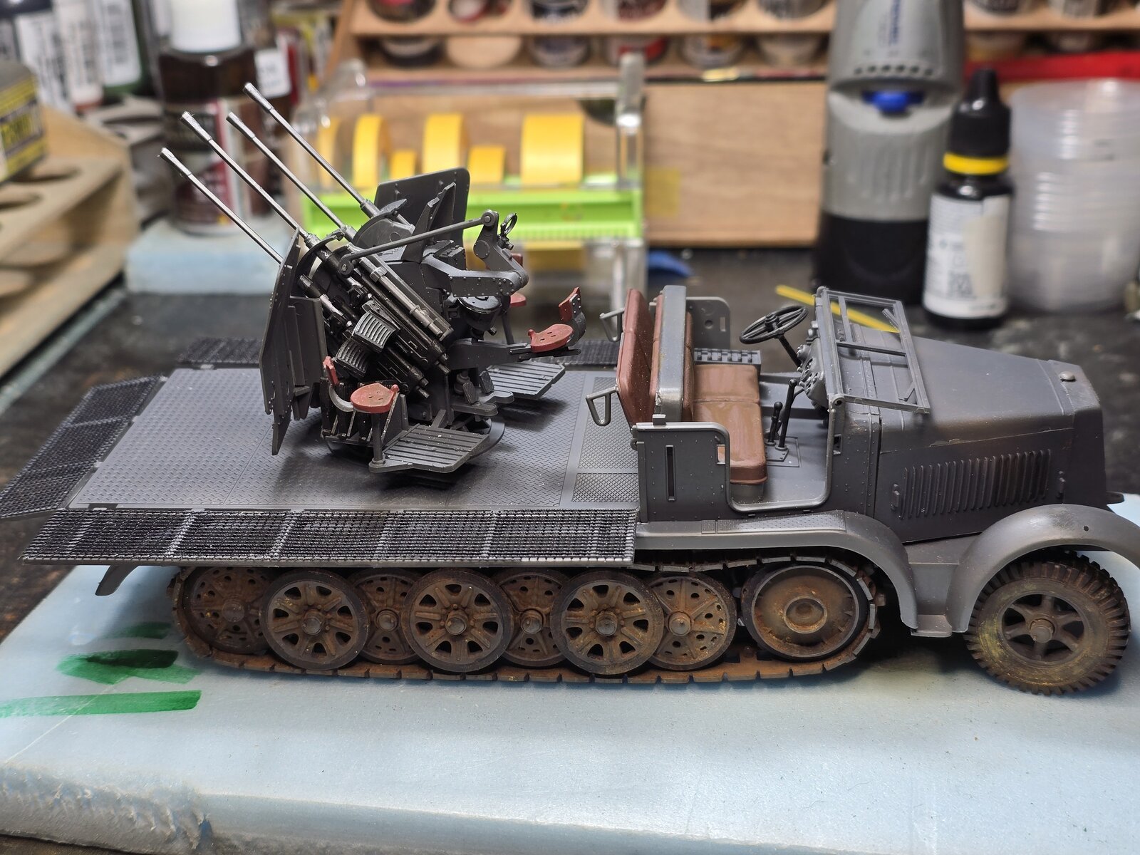

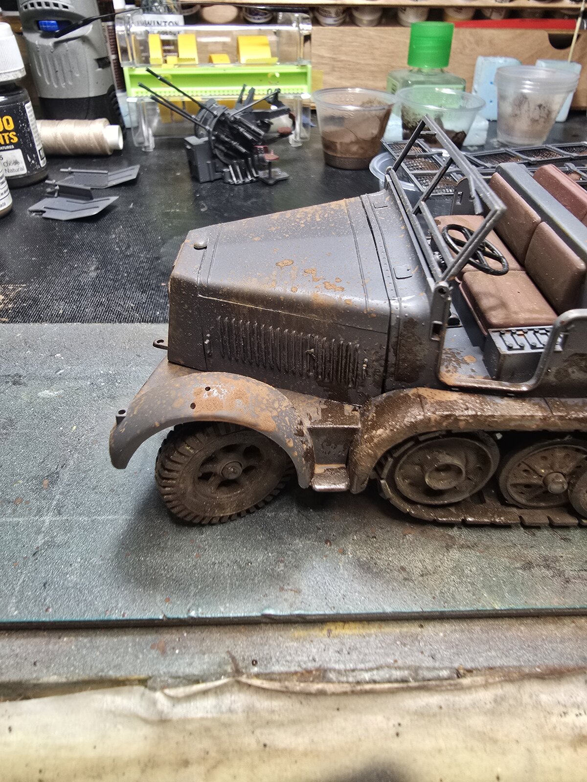

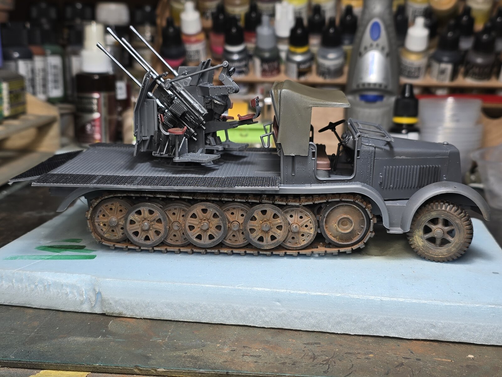

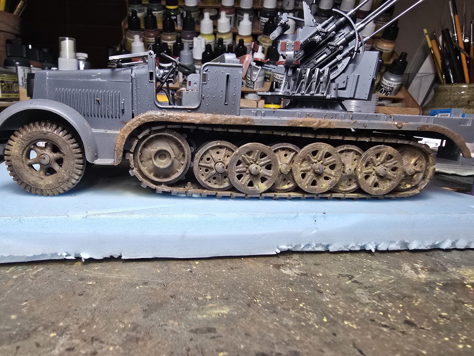

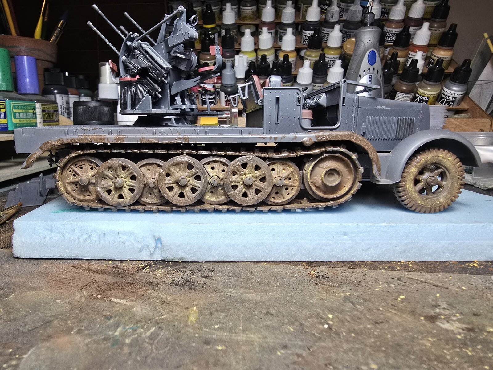

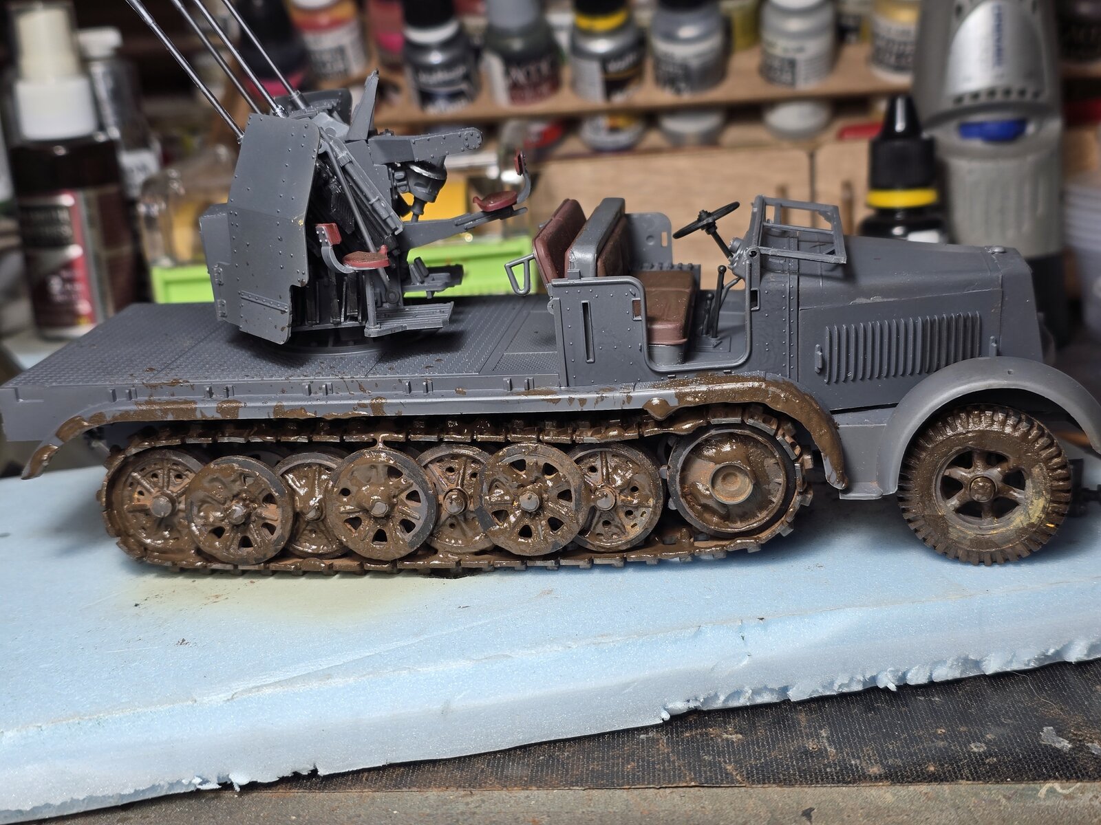

I used Vallejo Pigments and a fluffy #4 brush. Dipped the tip of the brush into the powder and applied to the wheels.
I tapped off the remaining powder and left it alone.
I don't have pigment fixer, yet, and I know that could help. For now I minimize touching the pigments.
I believe fluffy is a technical term. :p

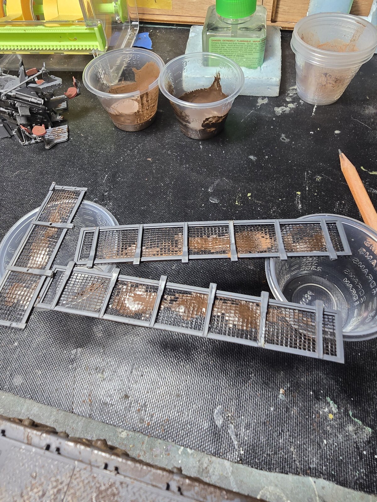

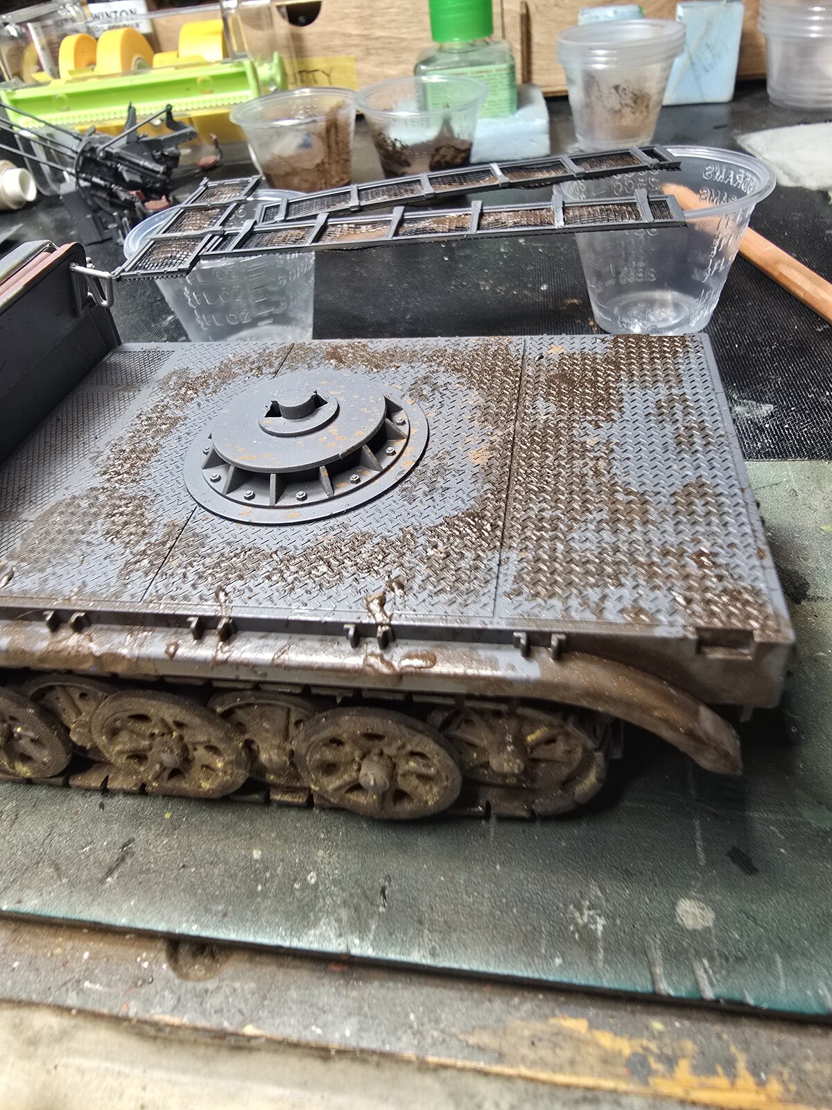

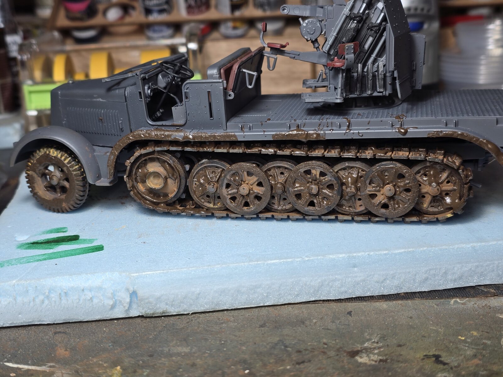

Now, it's time for "mud." I used some Mod Podge and pigment powders to achieve a slurry of sorts. (Im constantly learning).
tomorrow when dry I'll add some powders to try and resemble dry mud.
I've decided to not whitewash and leave it grey.
...mud!

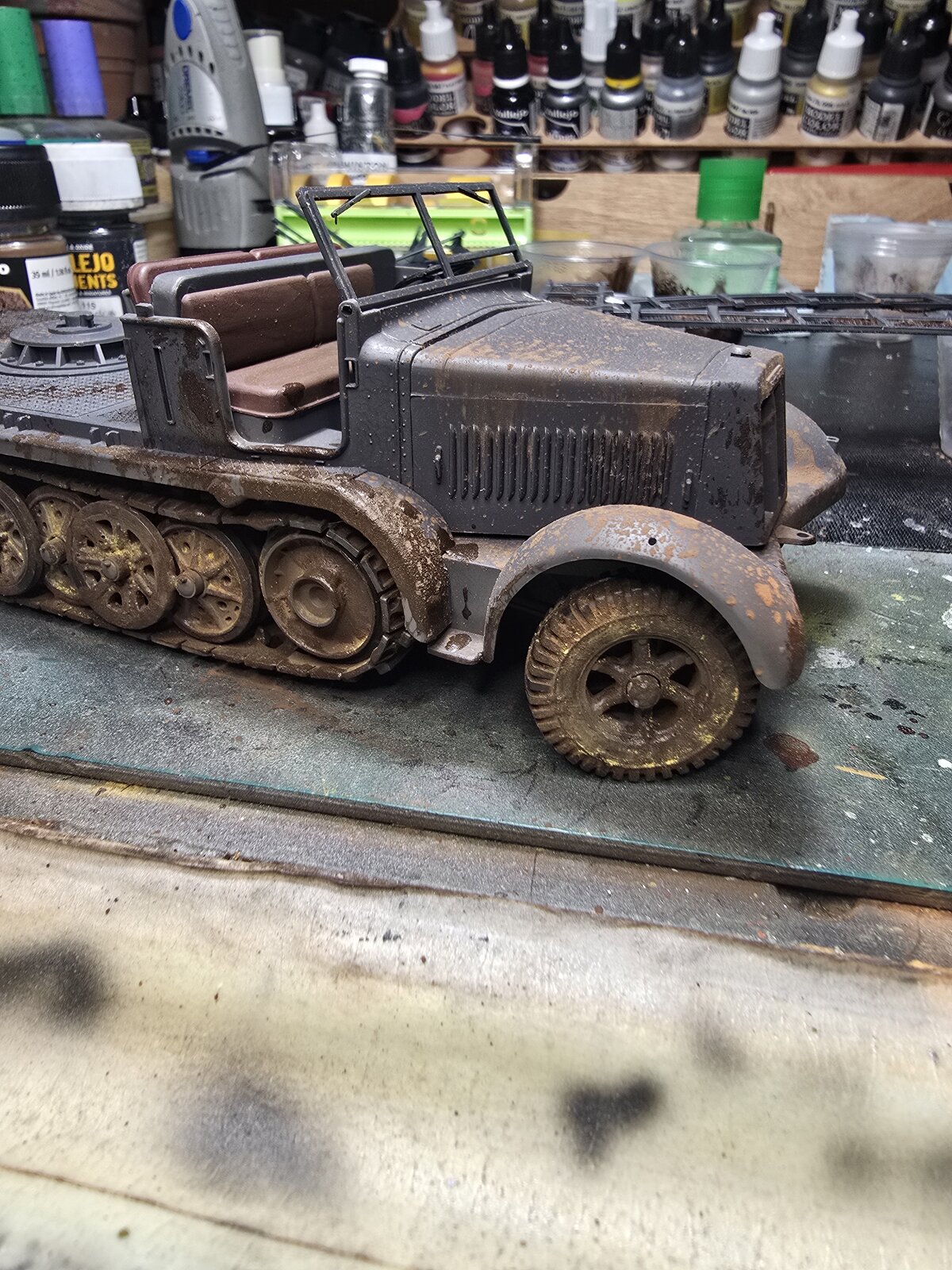

For the mud and weathering i usually just dive right in. If it turns out fine, then good. If not then, oh, well. Learn from it and move on. :p

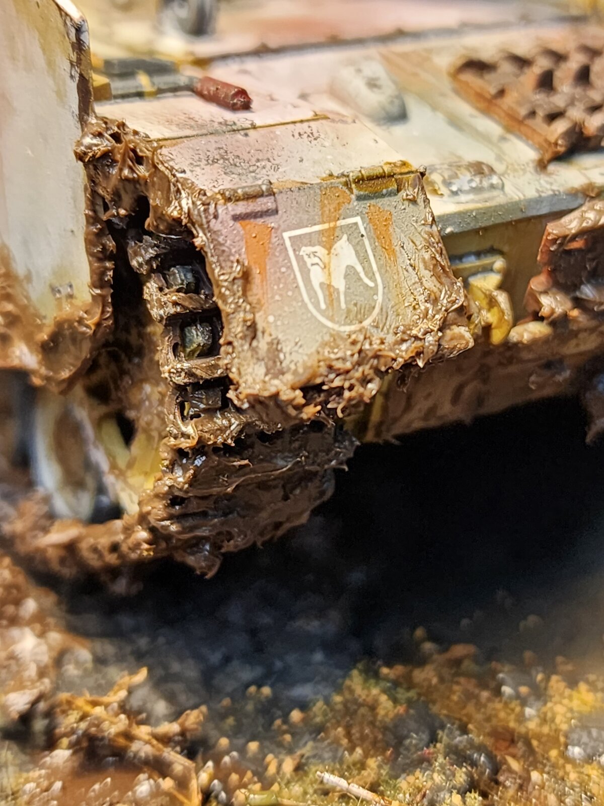

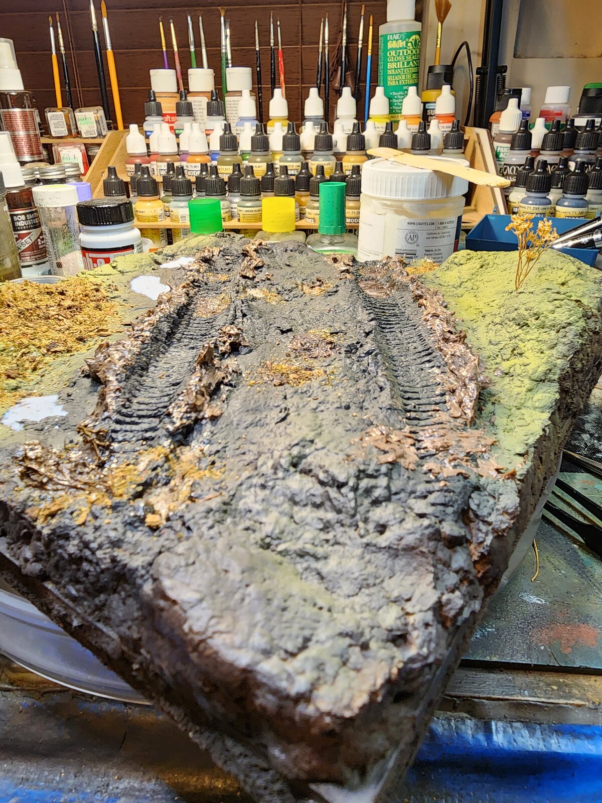

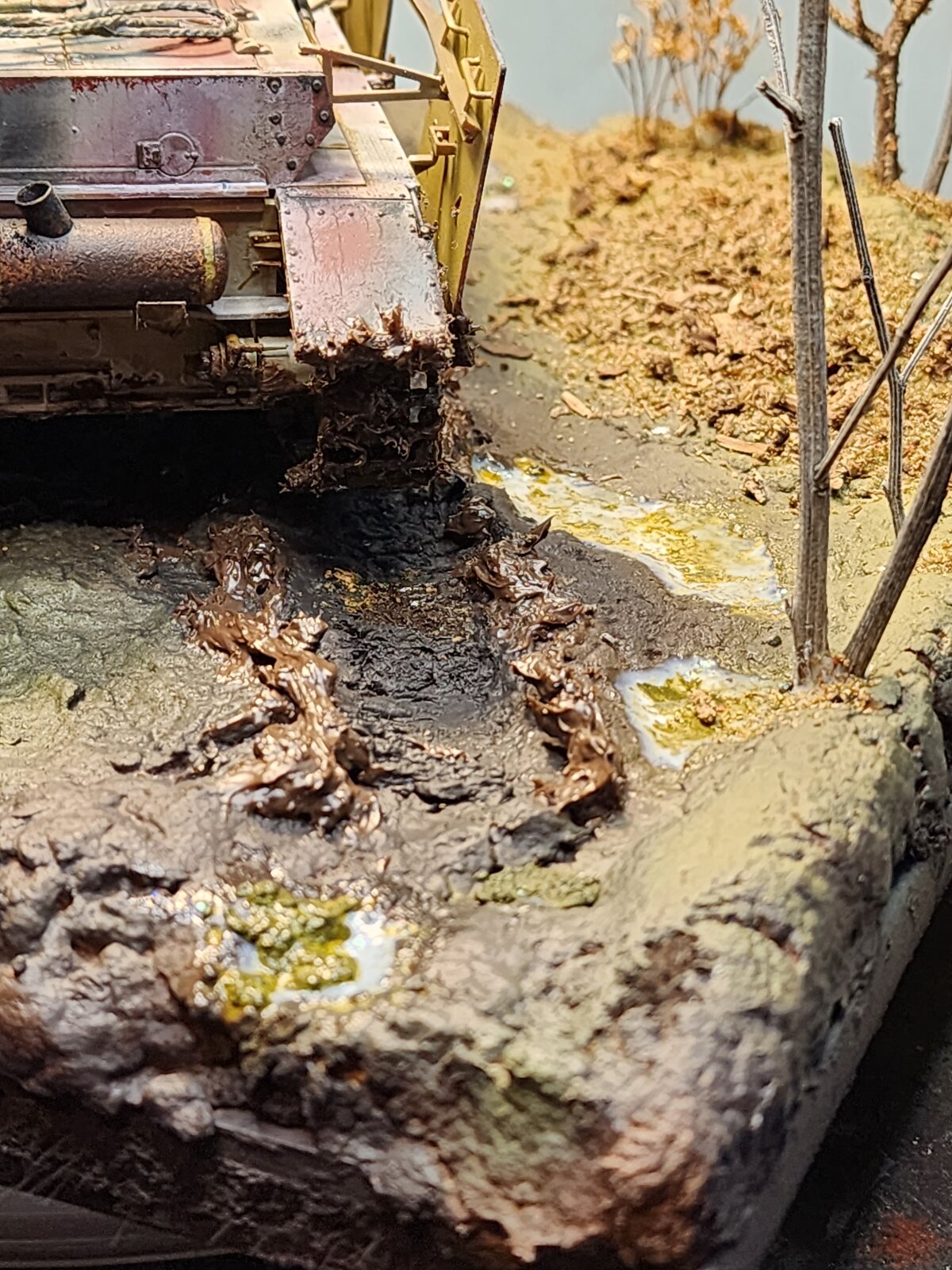

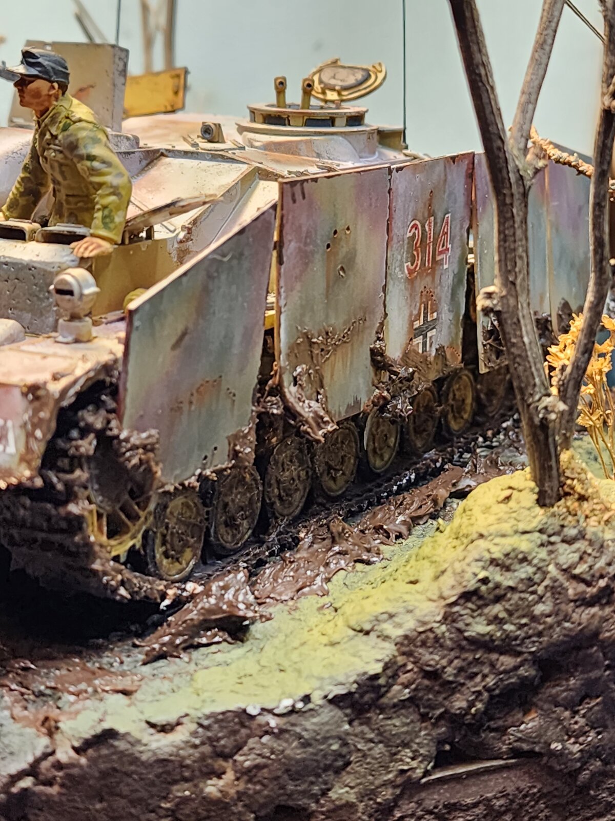

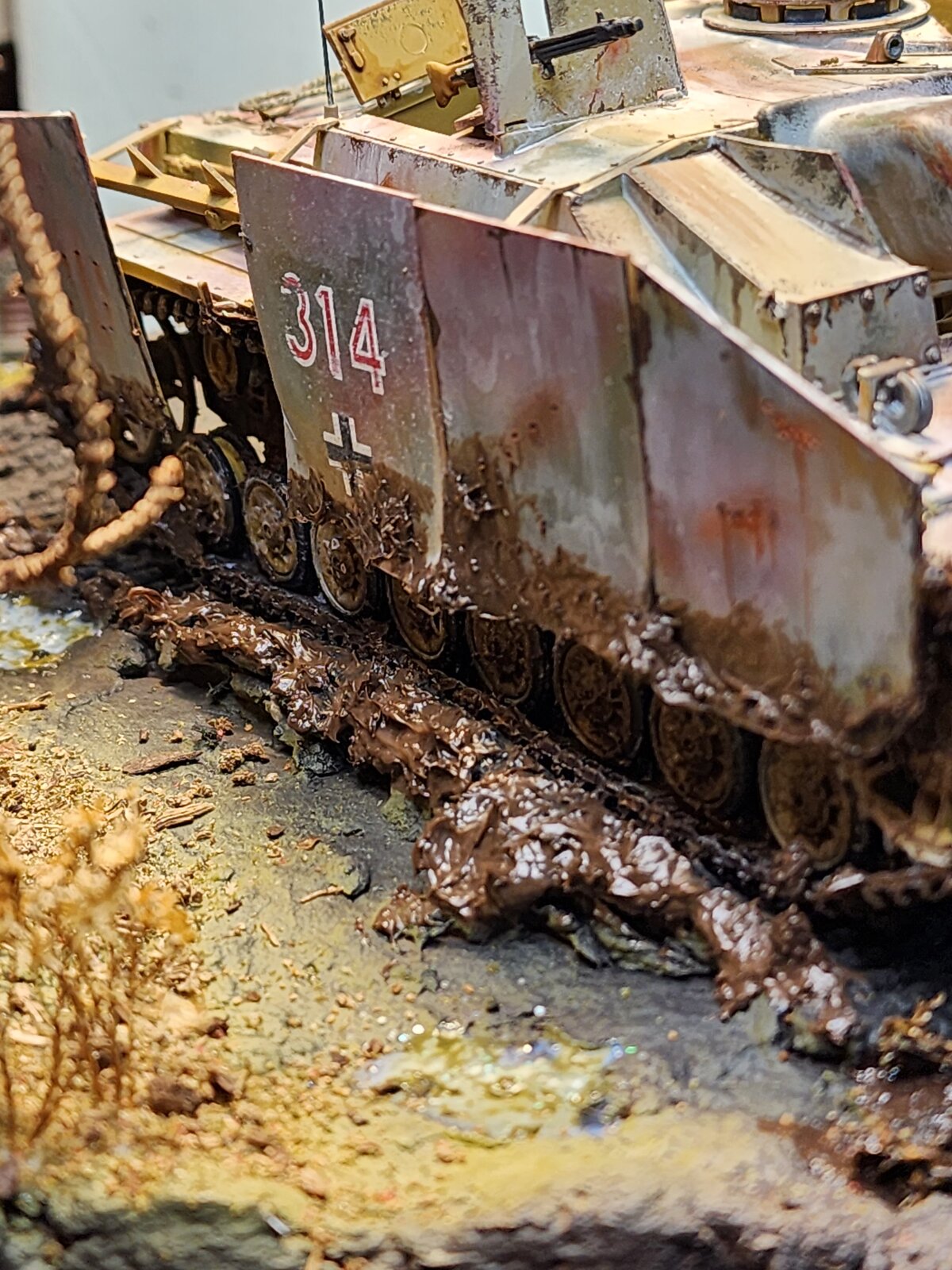

This is only my 2nd attempt for a muddy look.
I use Mod Podge as the base and add paints or powders to achieve the color I like. Mix it up real well and dab on, messily.

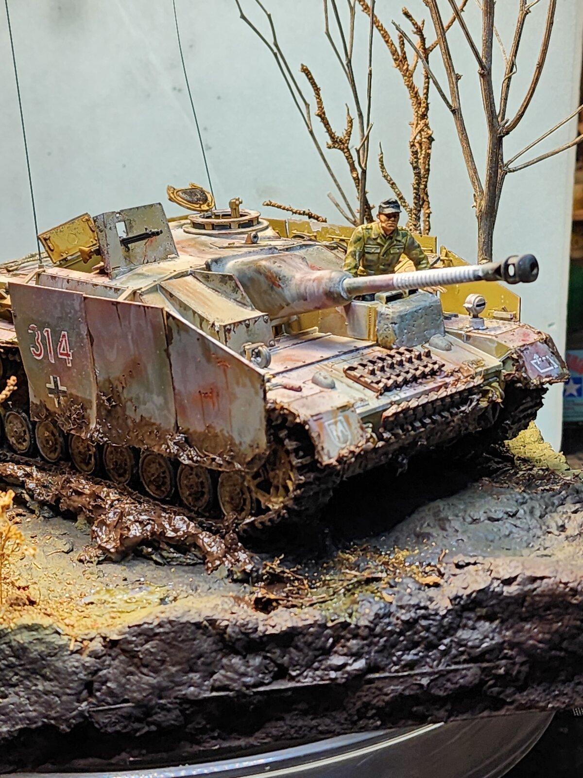

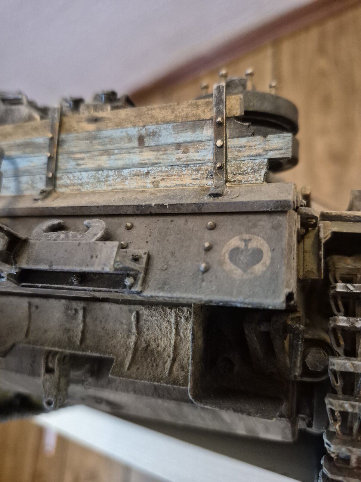

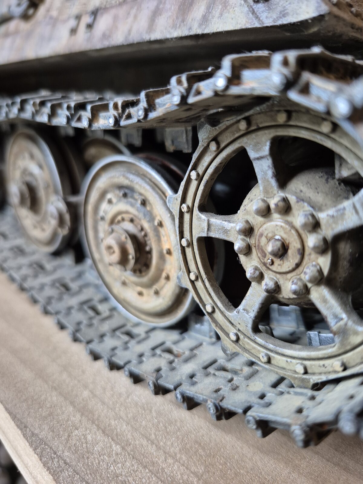

I attached several from my first attempt for mud.
Dive in and have fun with it!

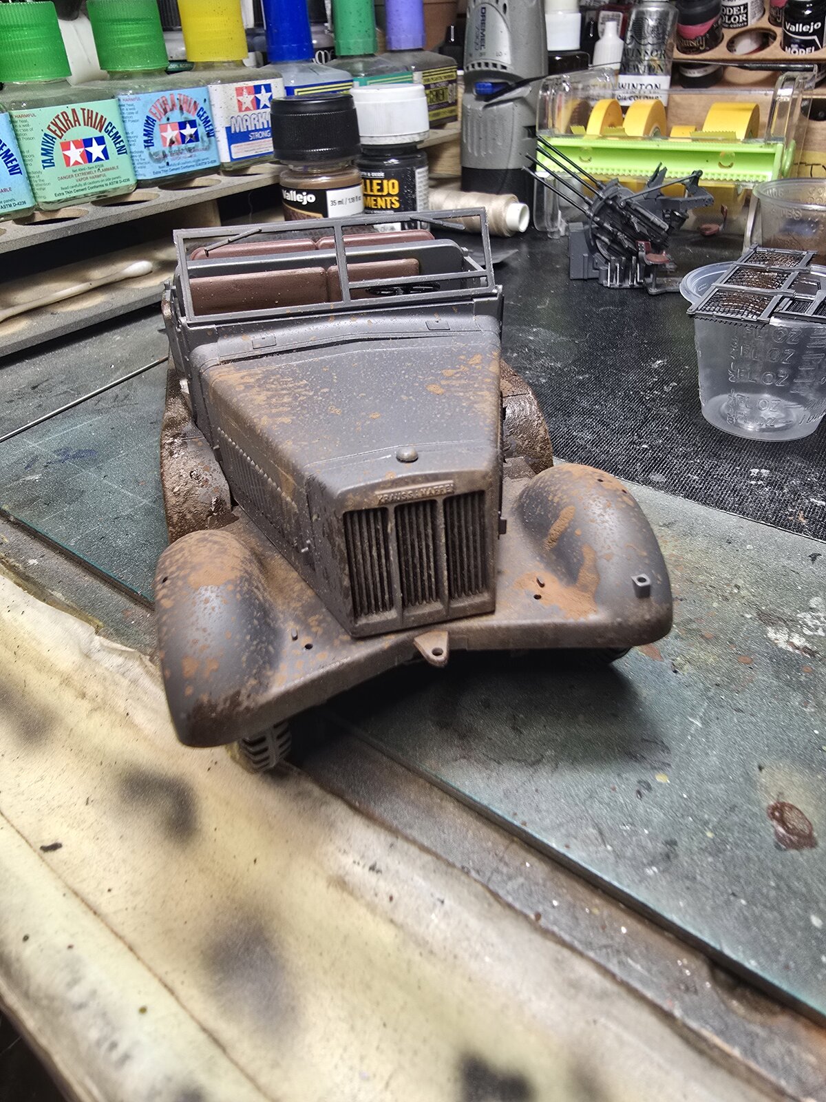

Comming along great, excellent work on the weathering. Trying to recreate mud and dust effects is something I would like to improve on. That is on a very long list in my case though. Looking forward to the finished model.
Join the club my brotha!

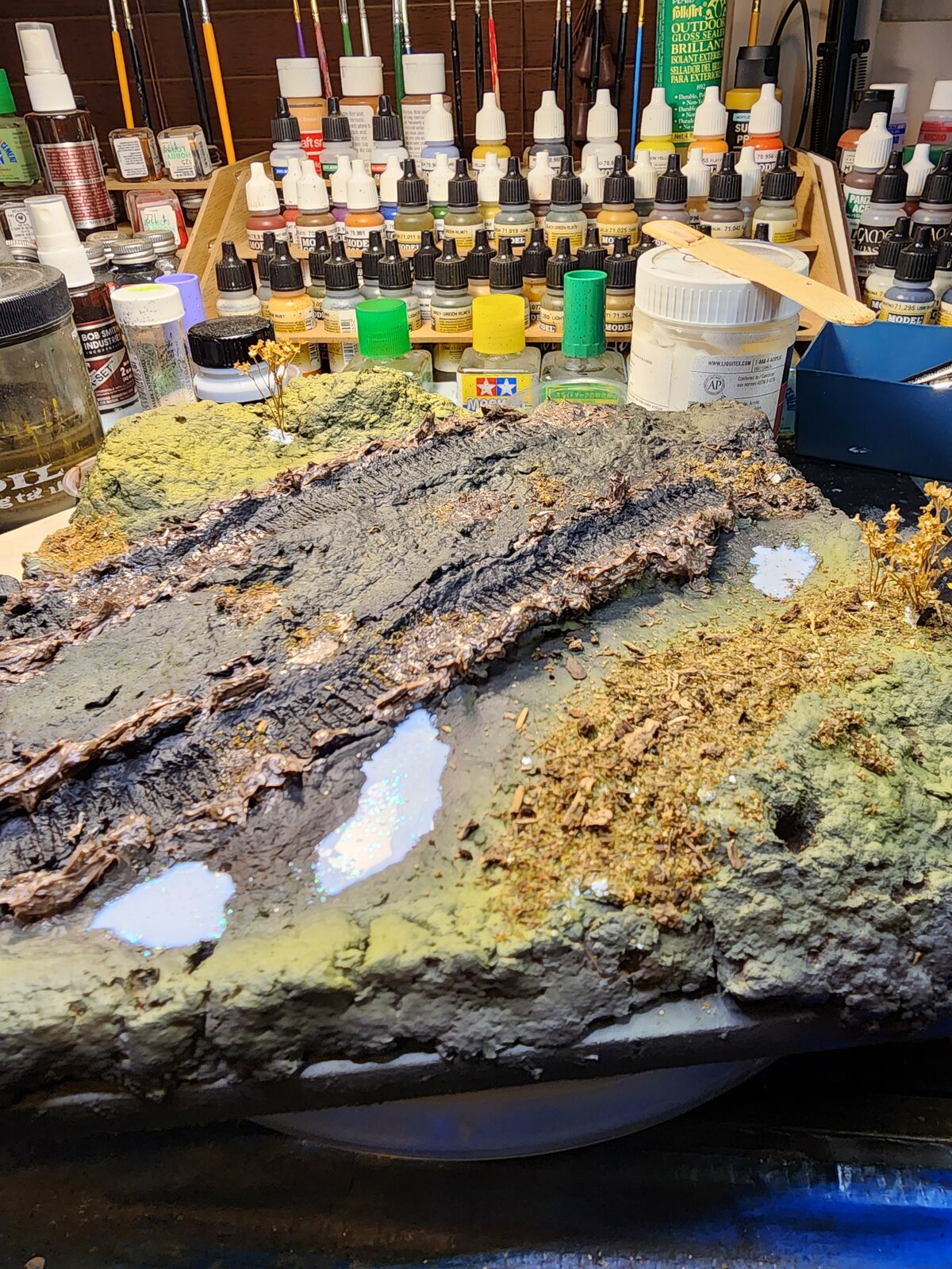

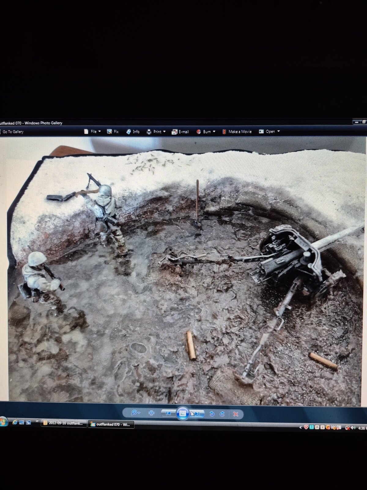

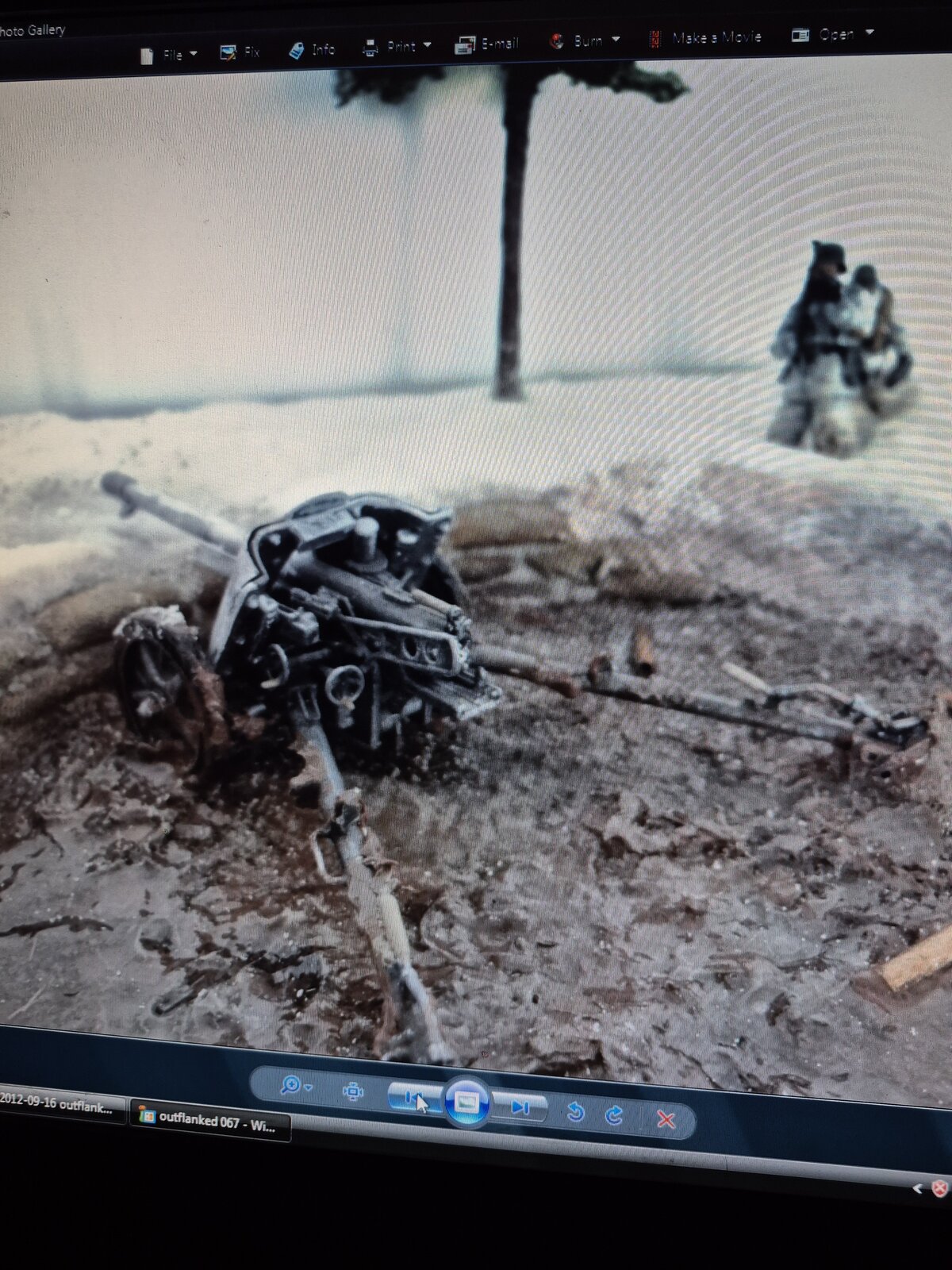

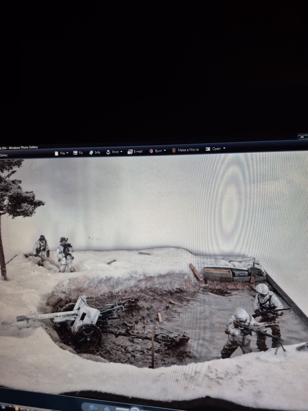

I've postponed my 1st "diorama" in 35 years due to fear of making mud and tracks in it. I have a historical image I want to emulate, but am stymied.
I've built the kit and most of the base, but the mud, so much mud, the Eastern front and all that.
