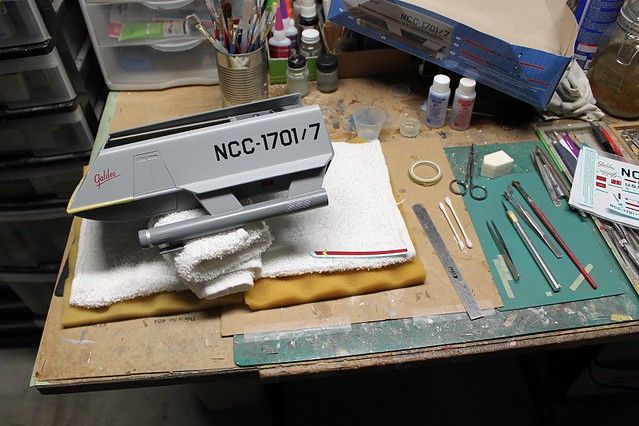

Tools for scribing lines into the exterior surface of the roof. The kit instructions included a paper template for use in creating these panels atop the shuttle. Here I have taped it to the plastic roof piece.
I will use two pieces of Dymo label tape laid down close together on each side of each line, after I pencil it on, so the scribing tool stays in the gap and doesn't wander off the straight and narrow while I press down:
The Galileo 7 - WIP 061 by Steve J, on Flickr
Roof panel line scribing almost done. I left about a miillimeter at the ends of each panel line unscribed as the panels have rounded corners. Just need to decide how I want to approach scribing them. Freehand could get messy if I slip. Think I need to make up a template to guide the tool:
The Galileo 7 - WIP 062 by Steve J, on Flickr

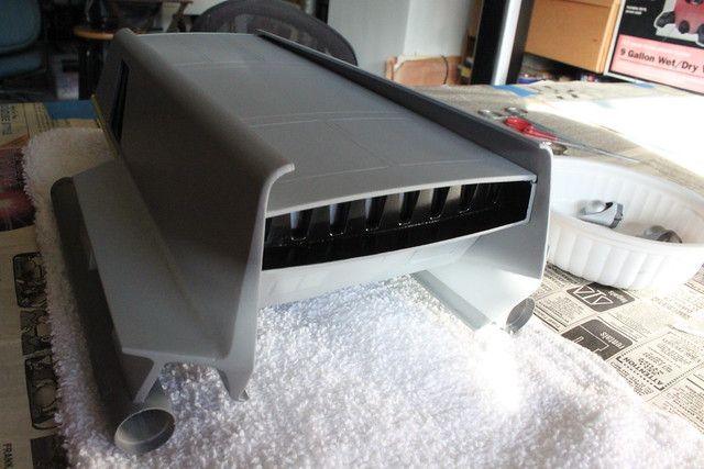

I finally hit on the best solution to scribing the curved corners and having them be uniform. I punched a hole in some black dymo label tape and used the disc cut from the tape and the hole left in the tape to make scribing guides for each corner:
The Galileo 7 - WIP 063 by Steve J, on Flickr
Galileo roof is now scribed. Probably took me about 4 hours to do. The dymo label tape sure does the trick for scribing straight lines. And my trick with the hole punch makes rounded corners a snap too. Still, you can see spots where I did stray outside the tape and had to fill in some minor scratches with white PPP putty. After another coat of primer and final coats the panels should look just fine:
The Galileo 7 - WIP 064 by Steve J, on Flickr

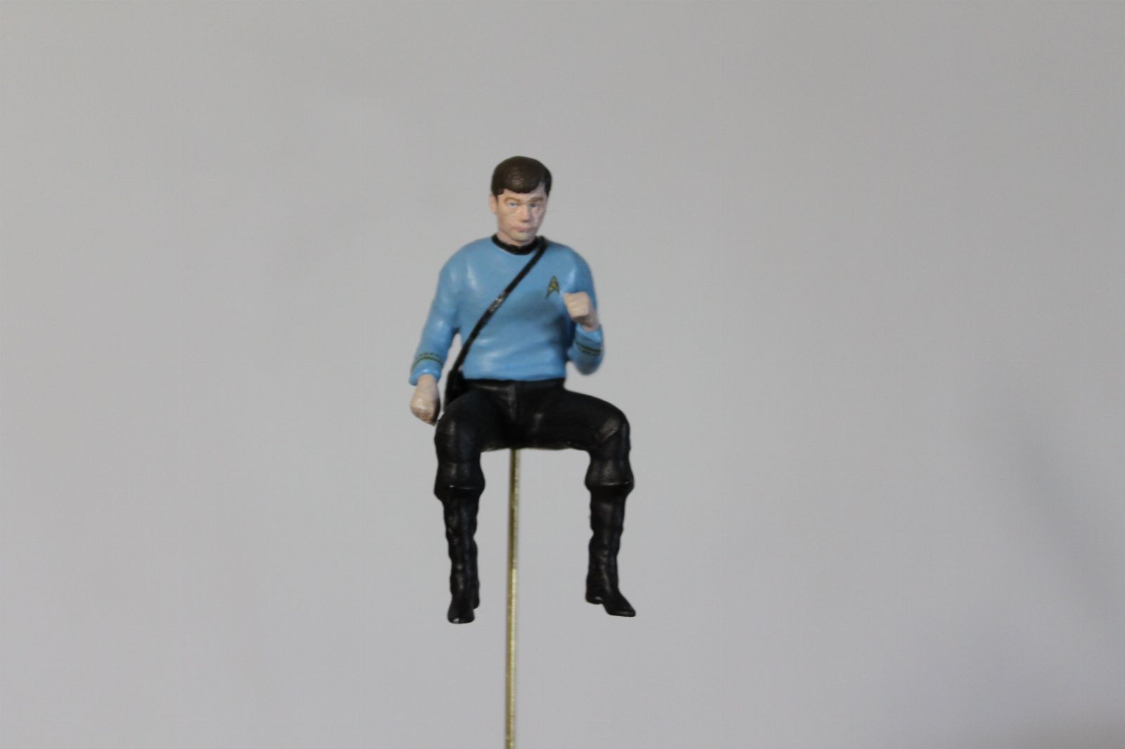

Still touching up the crew but, when not obsessed with Mears' hair or Guetano's ears,

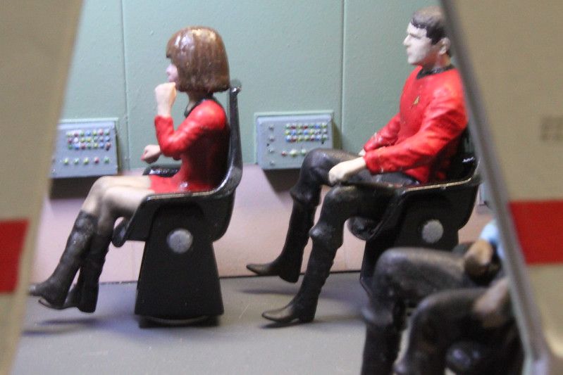

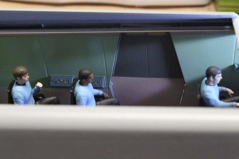

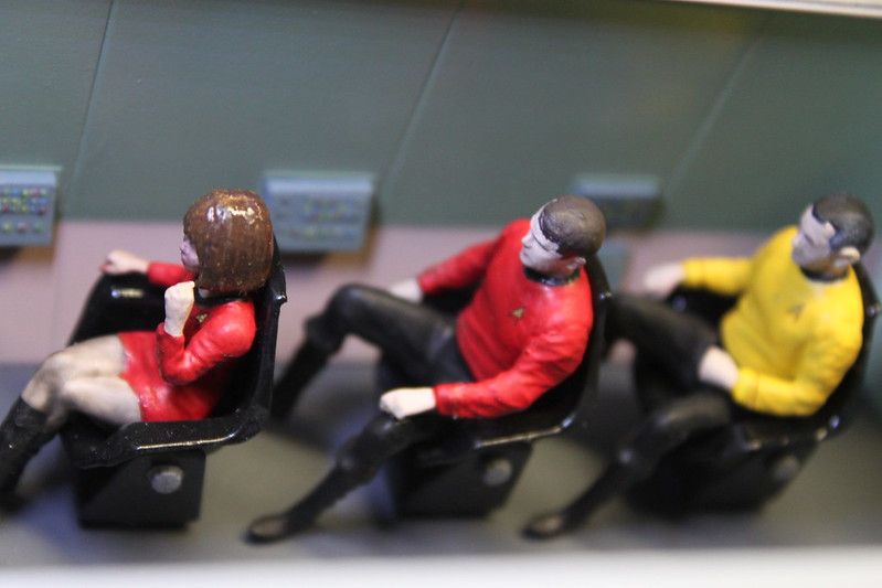

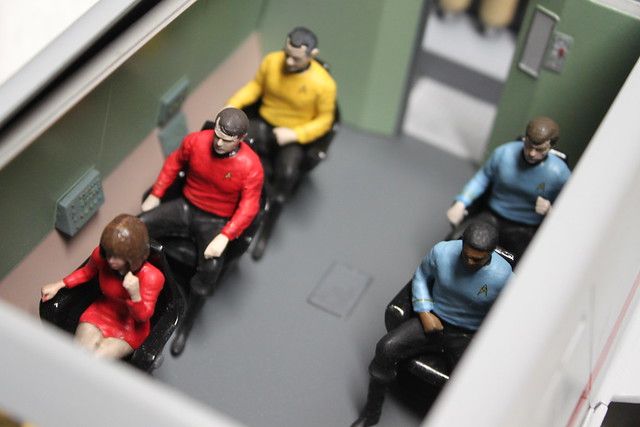

Starboard cabin wall was glued to floor. Decided to take some pics of the crew in their seats while the epoxy cured and the port wall was not in the way of my camera lens. The figures are not glued into the seats at this stage as I still need to give their uniforms a matte coat. They also still need their badge and sleeve braid decals:
The Galileo 7 - WIP 101 by Steve J, on Flickr
Seats were glued in with 5 minute epoxy. Figures were temporarily positioned in the seats while the glue dried so I could be sure their feet would touch the floor. The seats all rotate so I can pose the crew members in various directions. Funny, in this one, four of the crew members appear to be looking in Mister Boma's general direction probably having an argument. Yeoman Mears appears to be interested more in what McCoy is up to as she is looking almost directly at him. McCoy is looking sidelong to his right roughly in Mears's direction as if to say "Can you believe this..."
The Galileo 7 - WIP 102 by Steve J, on Flickr

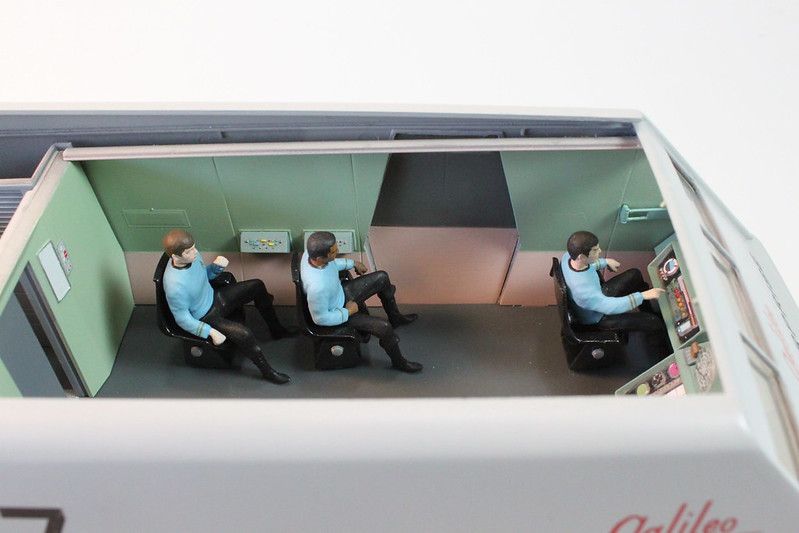

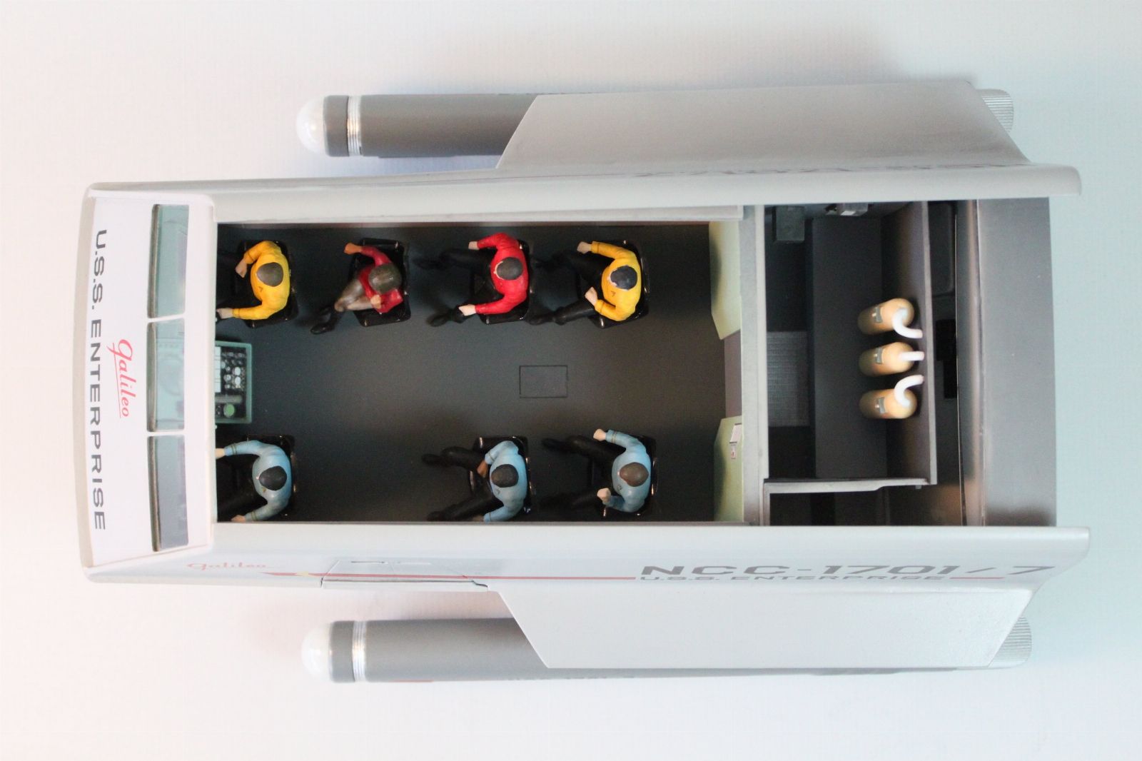

Cabin assembled. I'll need to finish the crew and place them in their seats before attaching the roof:
The Galileo 7 - WIP 104 by Steve J, on Flickr

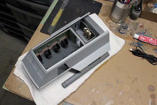

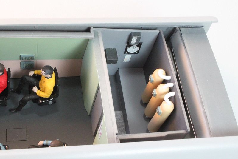

After some tricky maneuvering, I finished installing the passenger cabin into the outer fuselage using Testors tube/brush glue and slow cure CA:
The Galileo 7 - WIP 111 by Steve J, on Flickr
Aft compartment rear wall tanks are snapped into place - no need for glue:
The Galileo 7 - WIP 112 by Steve J, on Flickr

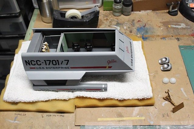

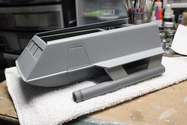

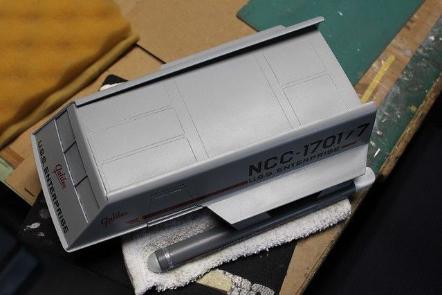

The Galileo after the final priming coat:
The Galileo 7 - WIP 115 by Steve J, on Flickr
Next up... masking and airbrushing of final coats followed by gloss coats before decaling.

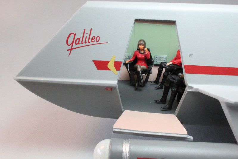

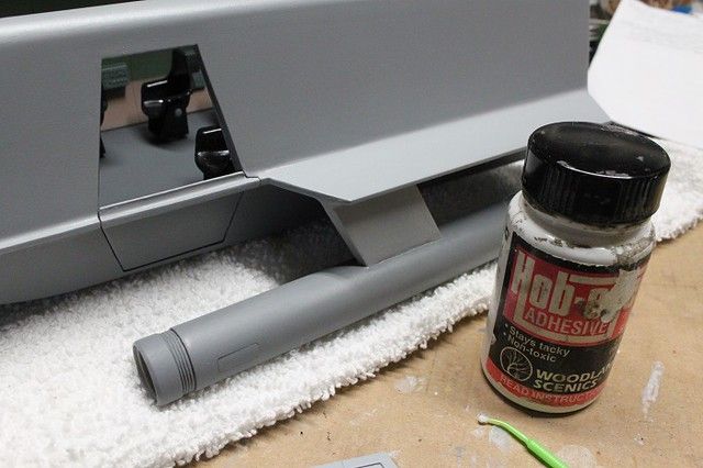

Woodland Scenics sticky tack glue was carefully brushed onto the upper inside lip of the door frame so as not to make a mess on the outer hull. This is enough to hold the upper door piece in place once the lower door piece is up:
The Galileo 7 - WIP 127 by Steve J, on Flickr
Door top piece held in with sticky tac glue. Bottom panel overlaps to hold bottom of upper "split" panel:
The Galileo 7 - WIP 128 by Steve J, on Flickr

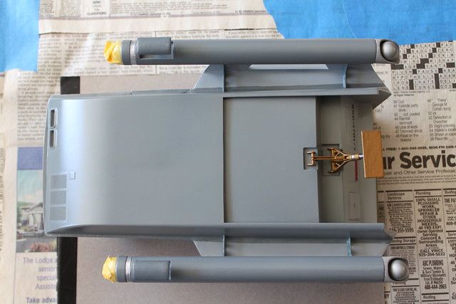

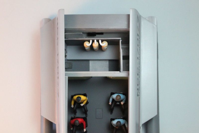

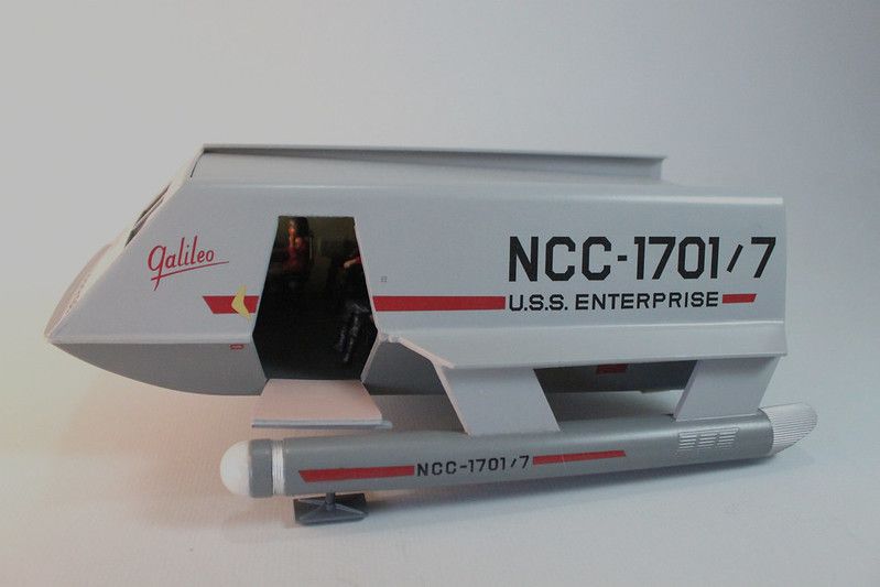

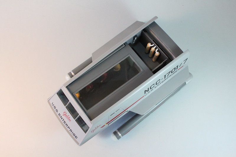

Vanity shot:
The Galileo 7 - WIP 129 by Steve J, on Flickr

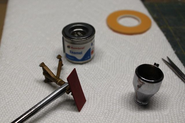

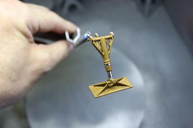

Rear Landing Strut was brush painted with Humbrol brass enamel, which is a challenging paint to work with using a brush. I finally gave up trying to get a brushless coat on the bottom of the pad without using a ton of goopy brass enamel so I decided to airbrush the final coat. First though I brushed a fresh coat of insignia red on the bottom of the pad and let it dry overnight:
The Galileo 7 - WIP 131 by Steve J, on Flickr
Looks alright don't it!
Thanks! Considering what I've put this model thru it's a miracle she looks this good.

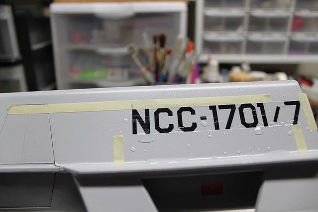

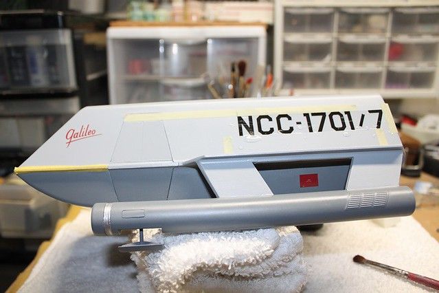

Starting the decal process...
Strips of Tamiya tape will aid in the positioning of each decal to match the pictures on the sides of the kit box:
The Galileo 7 - WIP 133 by Steve J, on Flickr
I like a lot of water on these larger decals. I trapped little or no bubbles under the decals so no major worries about silvering:
The Galileo 7 - WIP 132 by Steve J, on Flickr
Now that the big shuttle registry decal is on, tamped down and partly dry, I can use it to help me position the red stripe:
The Galileo 7 - WIP 134 by Steve J, on Flickr

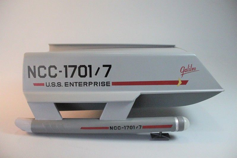

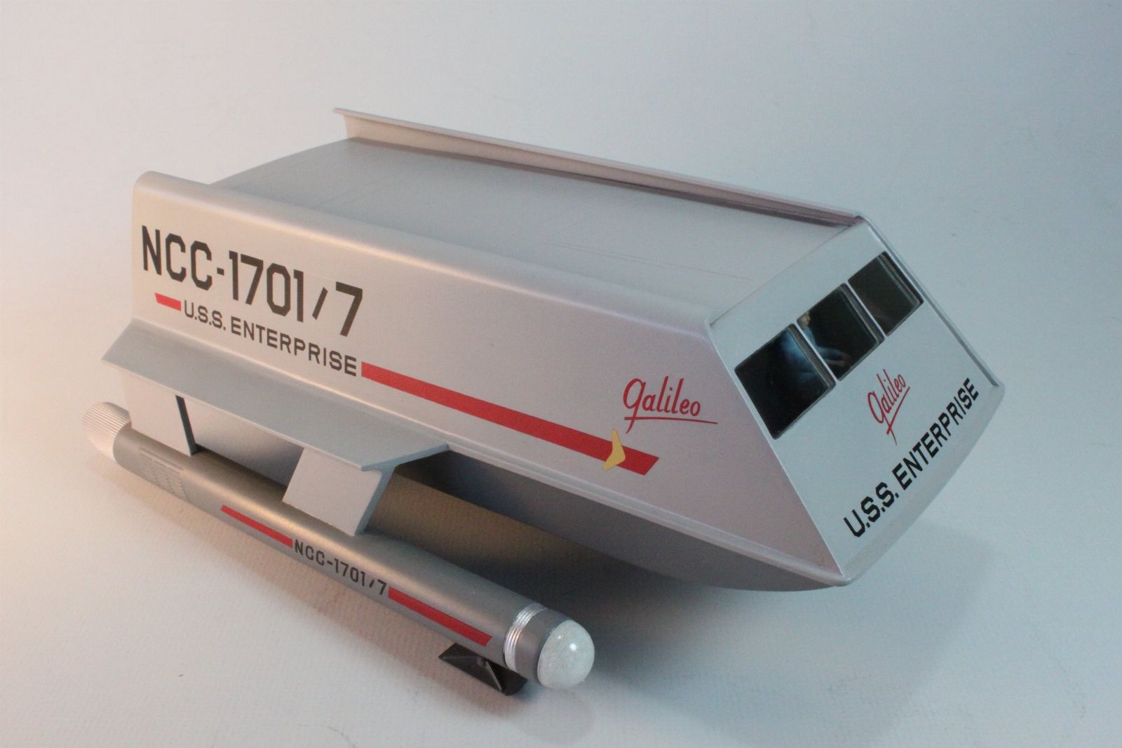

All decals are on. I'll wait a day to spray with a clear gloss sealing coat:
The Galileo 7 - WIP 135 by Steve J, on Flickr

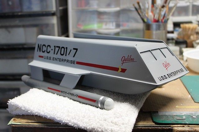

Bussards and endcaps were glued to the nacelles:
The Galileo 7 - WIP 137 by Steve J, on Flickr

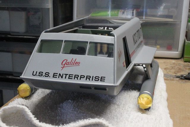

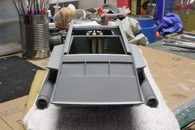

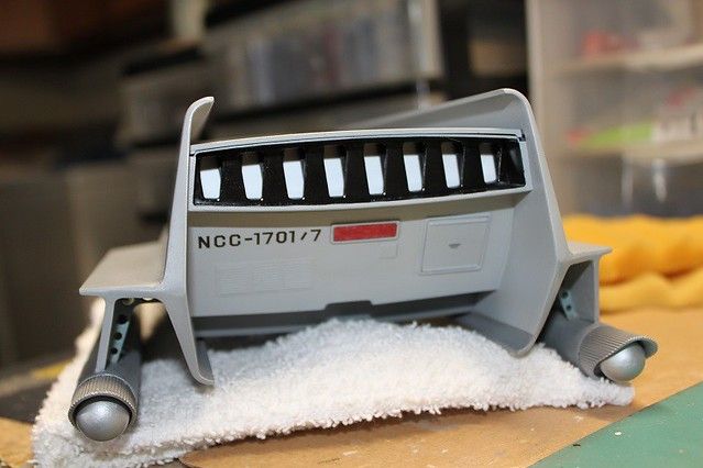

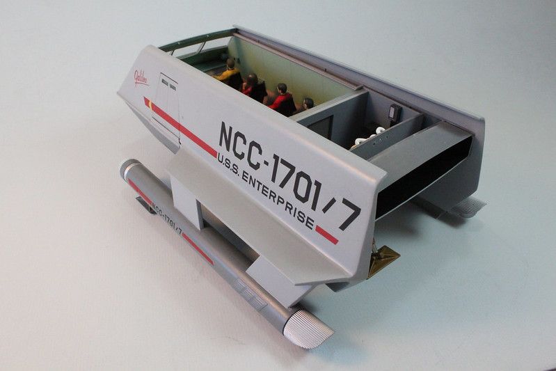

Decals were added to the stern.
I like how my flash makes the impulse engine vents light up:
The Galileo 7 - WIP 138 by Steve J, on Flickr

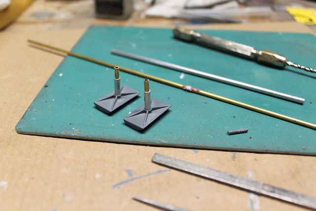

Still need to re-attach the front landing pads to the nacelles and attach the rear strut.
First, I'm going to see if i can substitute metal tubing for the easily bent plastic shafts the front pads attach to.
So I gave in and decided the spindly landing pad support pegs needed strengthening when they bent at odd angles while I was applying decals.
They didn't break off thankfully but I thought this was not the place to have a weak point.
To that end, I trimmed most of the plastic shaft down to about 3 mm and sheathed the stub in aluminum tubing.
A short length of brass tubing is glued inside the aluminum tube to slide into the mounting hole in the nacelle.

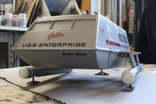

I always wondered at Federation engineers placing a shaft for the landing pad right aft of the bussard but ... I guess it works for Star Trek.
The Galileo 7 - WIP 140 by Steve J, on Flickr

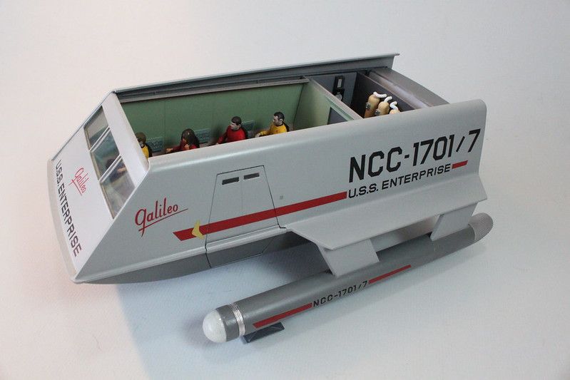

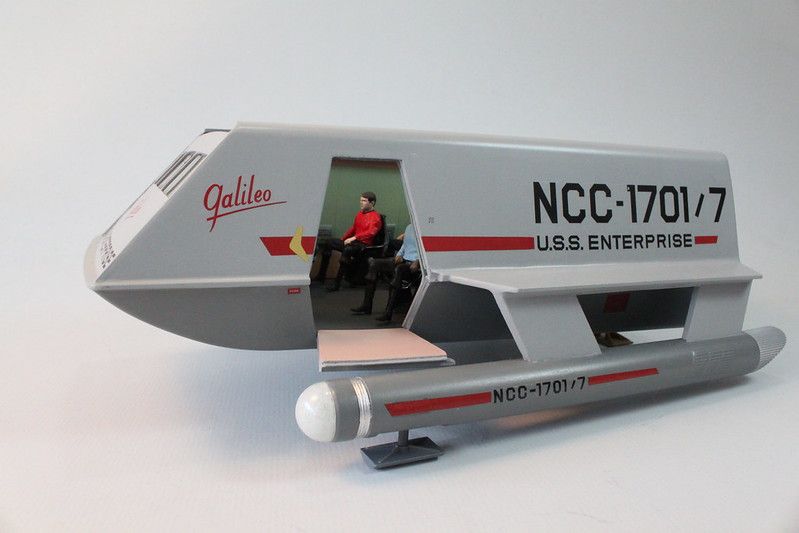

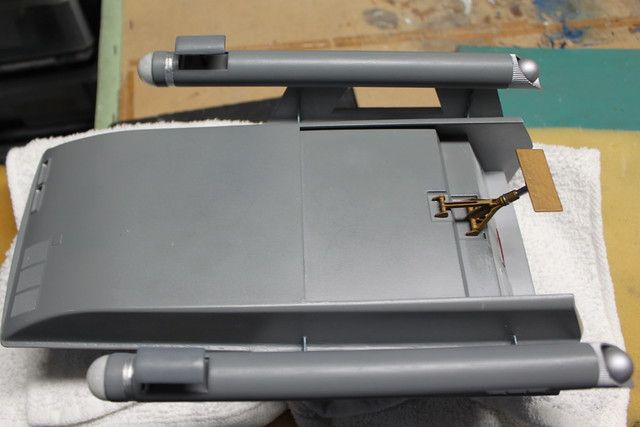

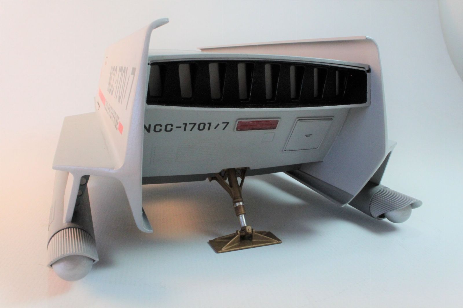

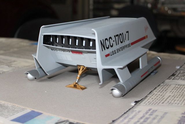

Landing pads and rear landing strut installed.
I used 25 second CA on the forward pads into the nacelle and they cured like iron.
You can literally support the weight of the model just holding onto one pad.
Much improved over the plastic kit shaft alone:
The Galileo 7 - WIP 141 by Steve J, on Flickr

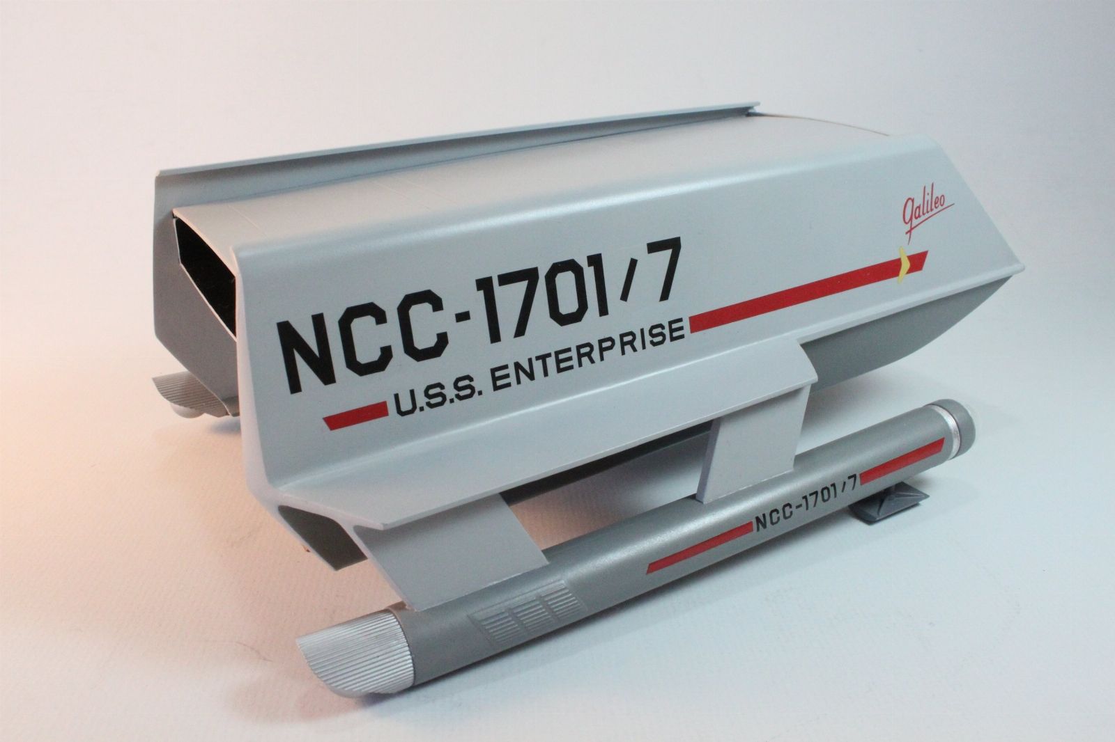

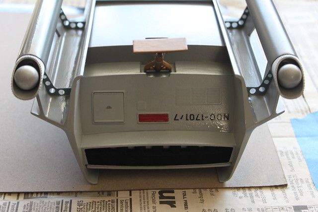

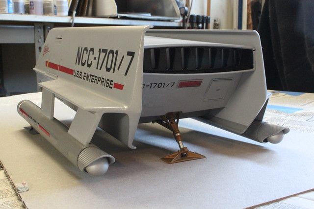

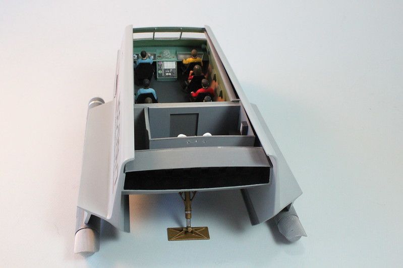

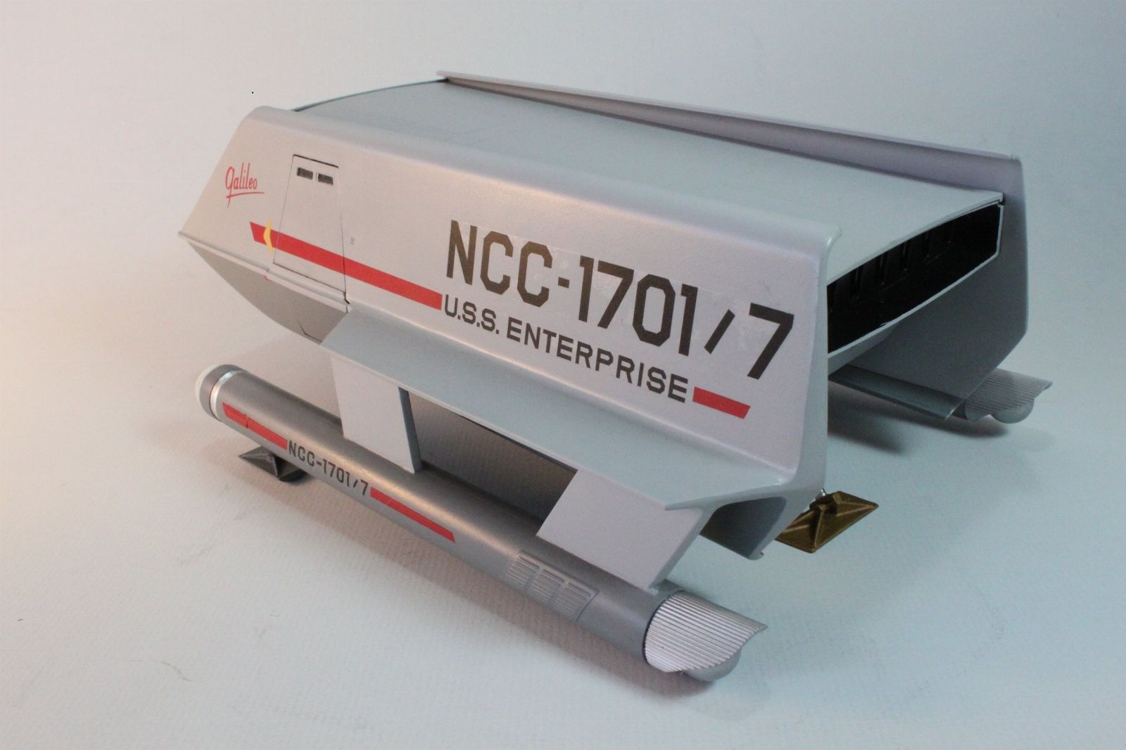

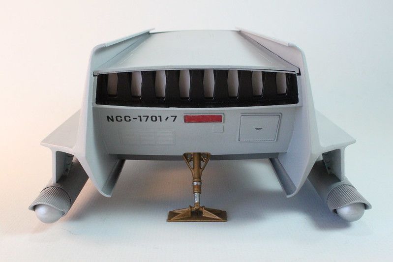

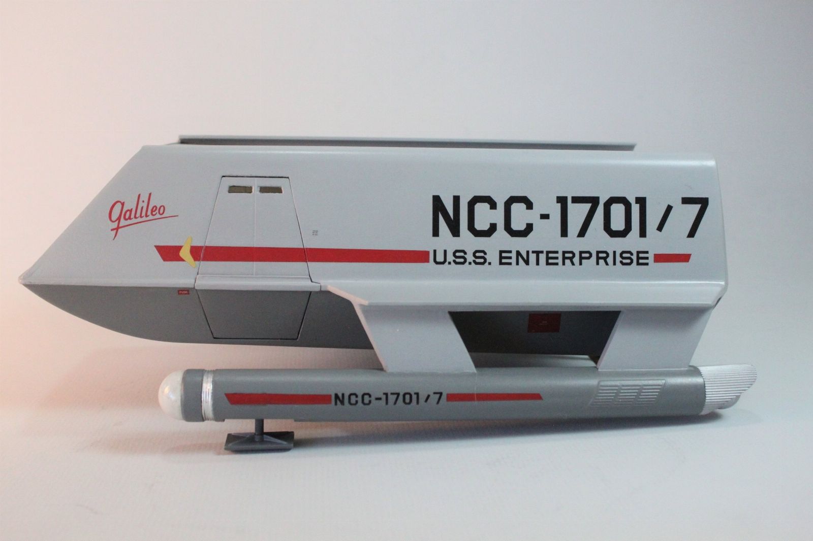

Teaser showing rear landing strut...
I was delighted to see there was enough clearance for the nacelles not to touch the surface.
When I watched the show as a kid, I just assumed the shuttle sat on its balls.
Never knew it had a landing pad at the stern till later:
The Galileo 7 - WIP 142 by Steve J, on Flickr

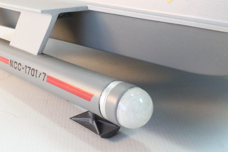

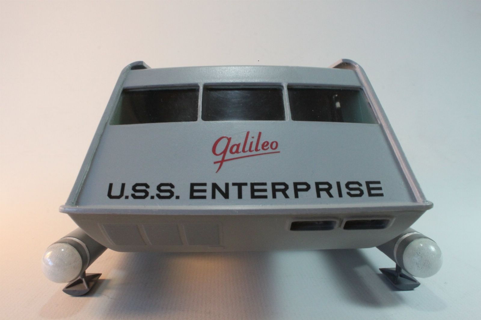

Good look at the forward landing pads whose support shafts run up thru the middle of the warp nacelle.
Really strange engineering to have that built into the nacelle.
Must be a way for starfleet engineering to make it work though:
The Galileo 7 - WIP 143 by Steve J, on Flickr

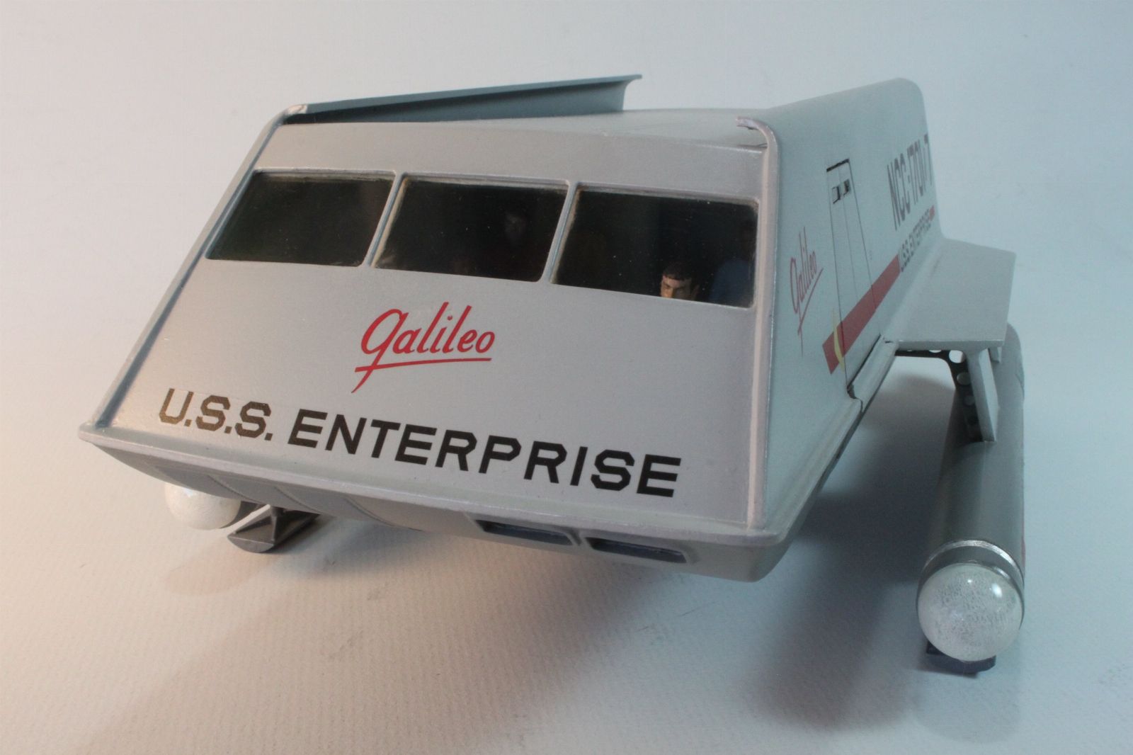

I like the way the engines light up using my flash:
The Galileo 7 - WIP 144 by Steve J, on Flickr

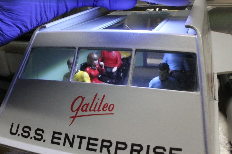

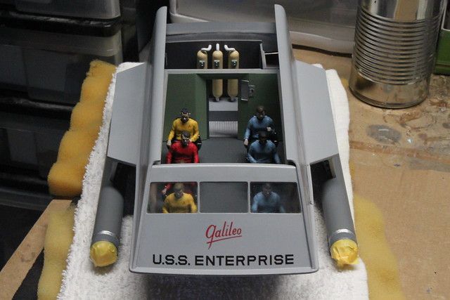

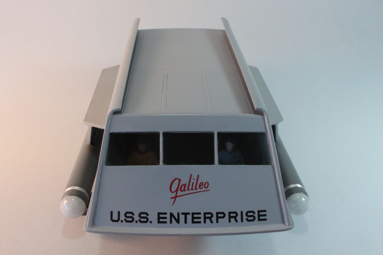

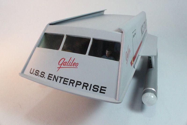

I went ahead and unmasked the forward windows so I could clean out any stubborn bits of dried liquid mask before the next clearcoat to seal the decals.
Glad I did! That stuff is tough. I had to resort to isopropyl alcohol on a microbrush to get some of it out of the frames.
That and my dental picks and an old scrubby brush, though, did the job:
The Galileo 7 - WIP 145 by Steve J, on Flickr

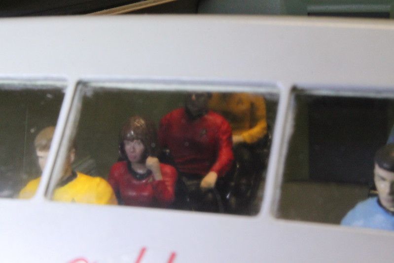

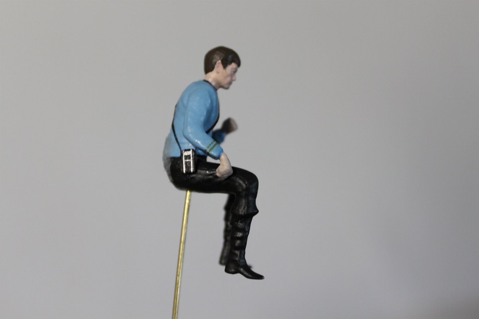

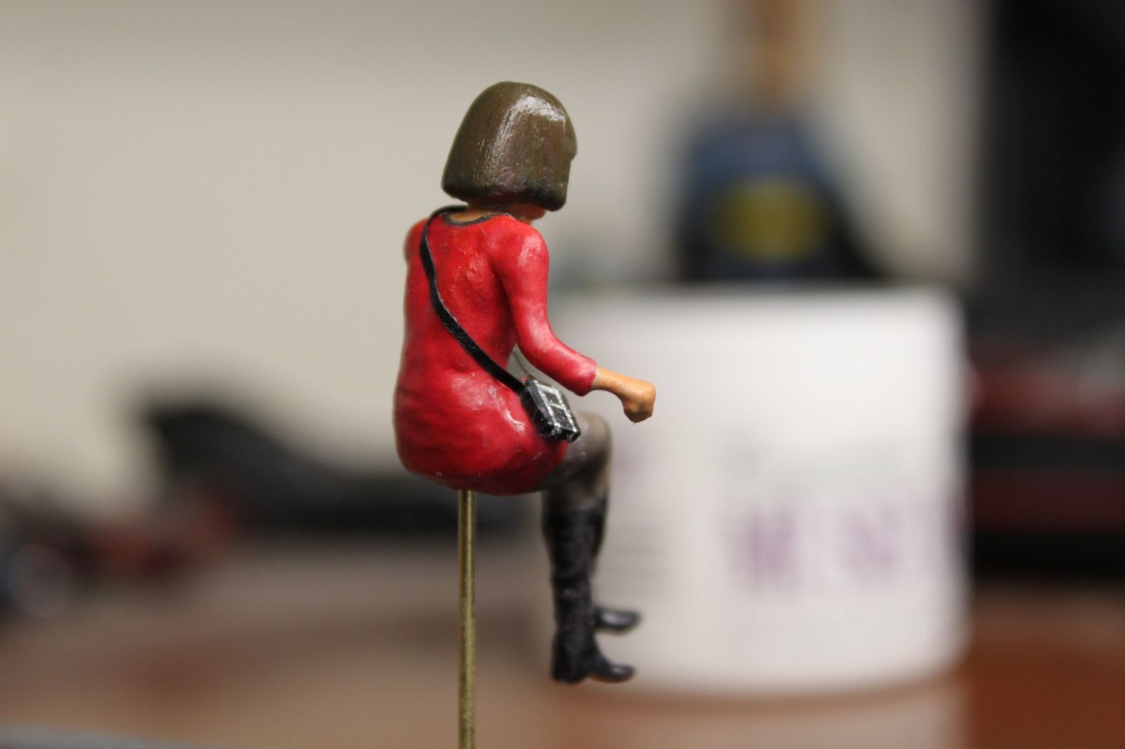

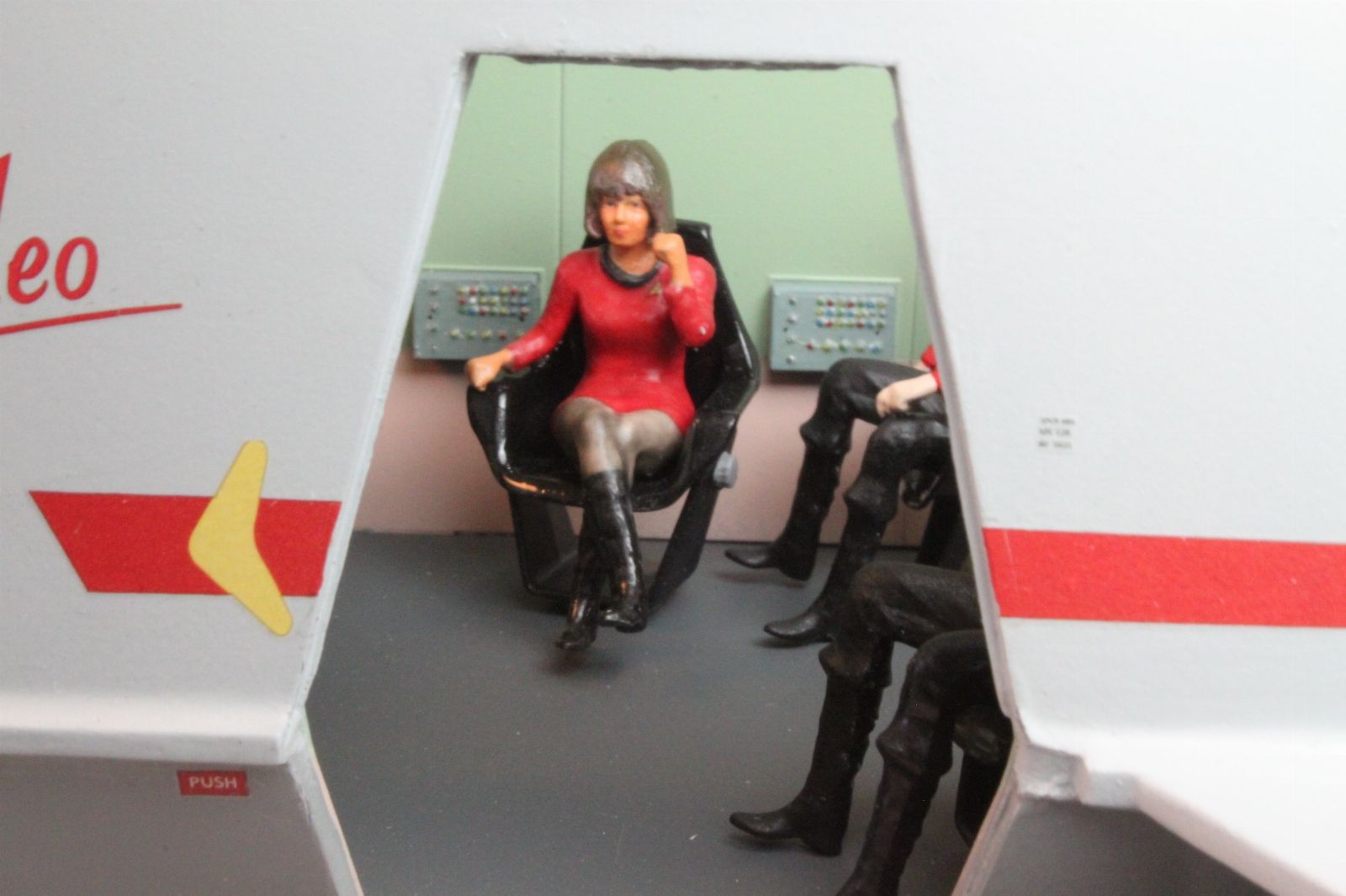

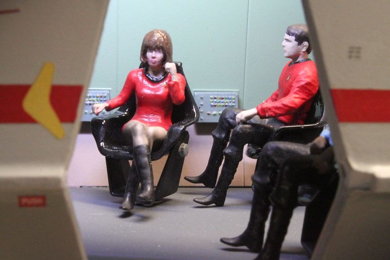

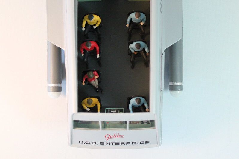

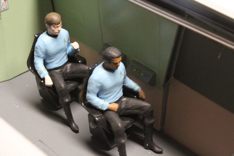

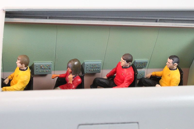

The crew were installed using Museum Wax. So if I ever want to remove a crewman I can do so easily.
The wax comes off with warm water or mineral spirits.
I also masked off the bussards to keep the next clearcoats off them:
The Galileo 7 - WIP 147 by Steve J, on Flickr
Teaser of the crew in their seats:
The Galileo 7 - WIP 148 by Steve J, on Flickr
Underside detailed and wiped clean with water before spraying with Testors Glosscote.
Went on smooth as silk with no wind today so little to no risk of my wet gloss catching threads in the air:
The Galileo 7 - WIP 149 by Steve J, on Flickr
Still wet from her final gloss coat.
Her final coat will be one spray with Testors Dullcote to give the Galileo a satin finish:
The Galileo 7 - WIP 150 by Steve J, on Flickr
I like your tip of using Tamiya tape as a straight edge to line up the decals! I never would have thought of that. I'm so used to just eyeballing it. That tip is so simple, it's perfect!

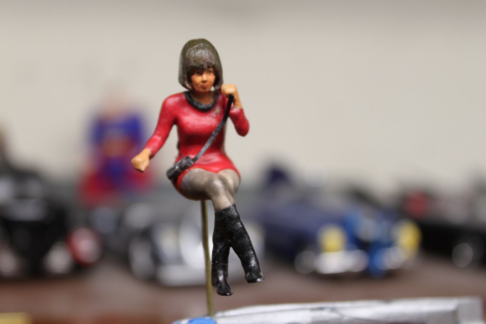

Here are some more teasers of the crew with the roof off leading up to taking the final shots.
The model is finished except for some small touches on Mears that these images revealed need to be done.
She's a little shiny on her face and uniform and my Liquitex matte varnish went bad on me so need to get me some.
I used a cheap Harbour Freight flashlight to take these pics...

I'll have better ones once I get my photo booth set up with better lighting.
