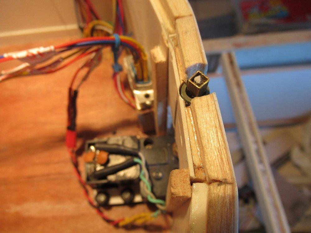

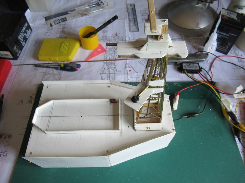

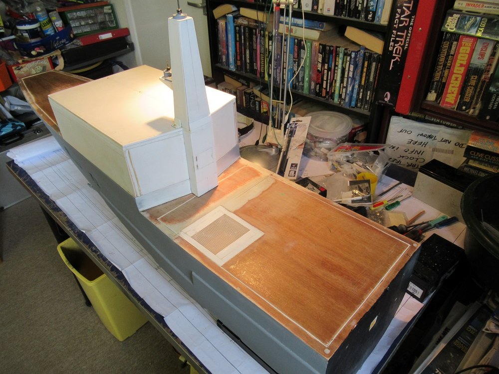

an here is a shot of the radar shaft fitted with its sqaure brass box section fot the main mast to drop onto so it wont slip when turnig the big search radar

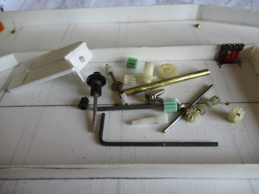

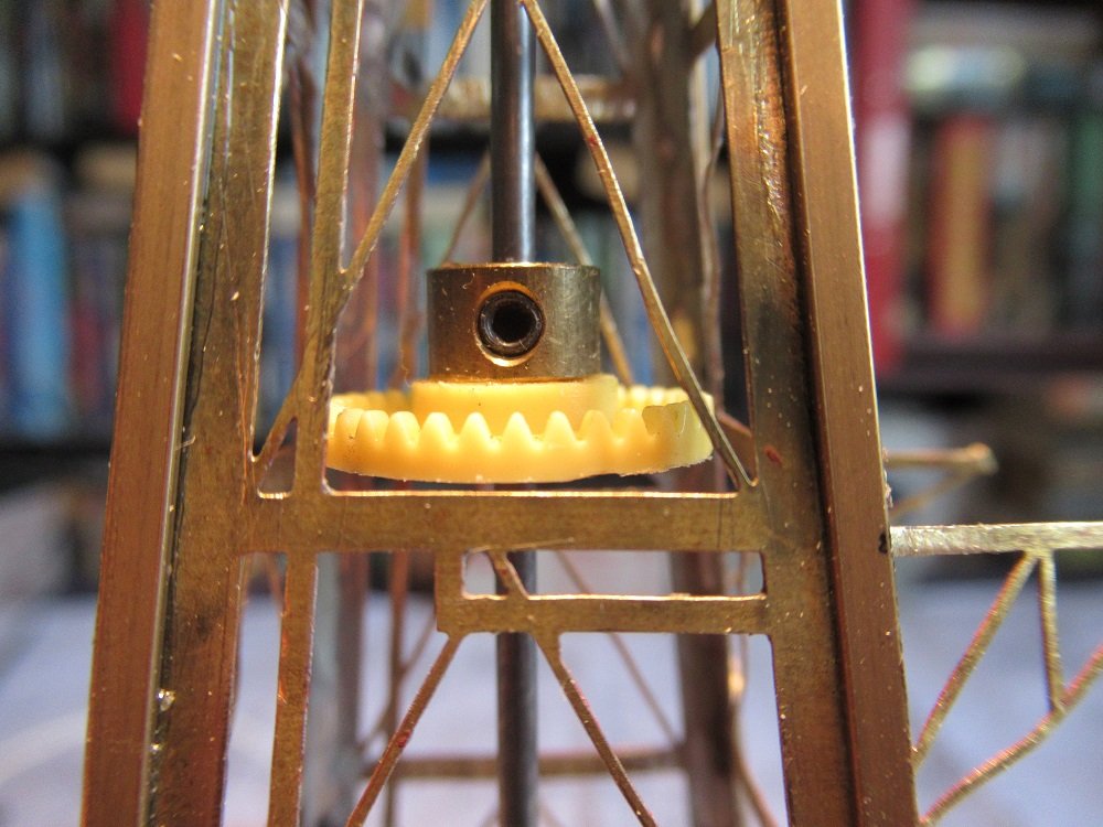

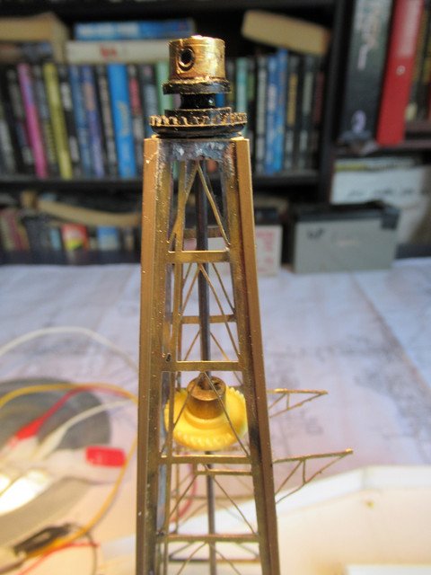

an here can be seen the tiny gears to be ffited on the top of the mast for small serfuse search radar but it was just a case of flitting through them till i found the right gears an for the radars speed so what fun i had doin this an plus these gears also will work the small navigaion radar that will work off that yellow crown gear half way up the mast when i work it all out an it did

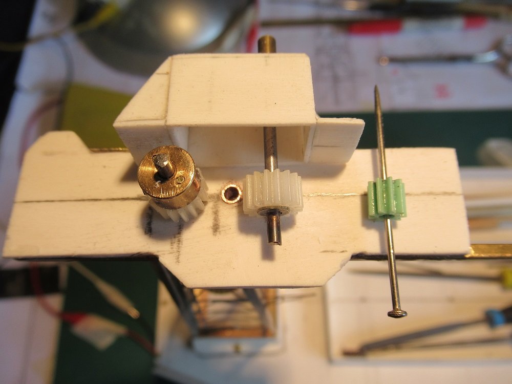

an here the main gears an the gear box all now ready to be fitted togeather as had severall tries at this till i got the right speed an the radar turning clockwize as when i first fitted it all togeather the radar was goin anti clockwize which is wrong
here the finished gearbox now as had to add another gear to get the search radar goin the right way clockwize

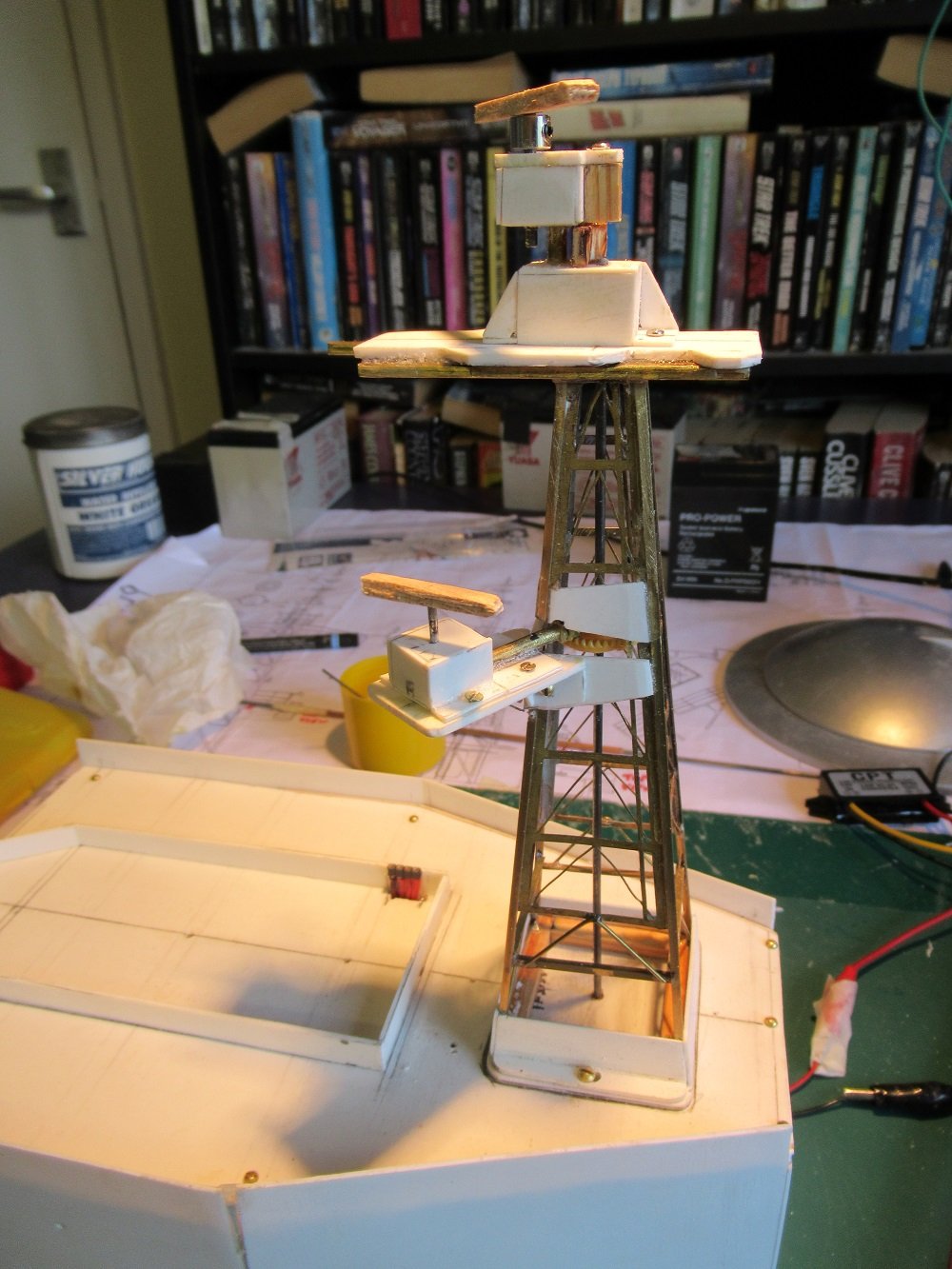

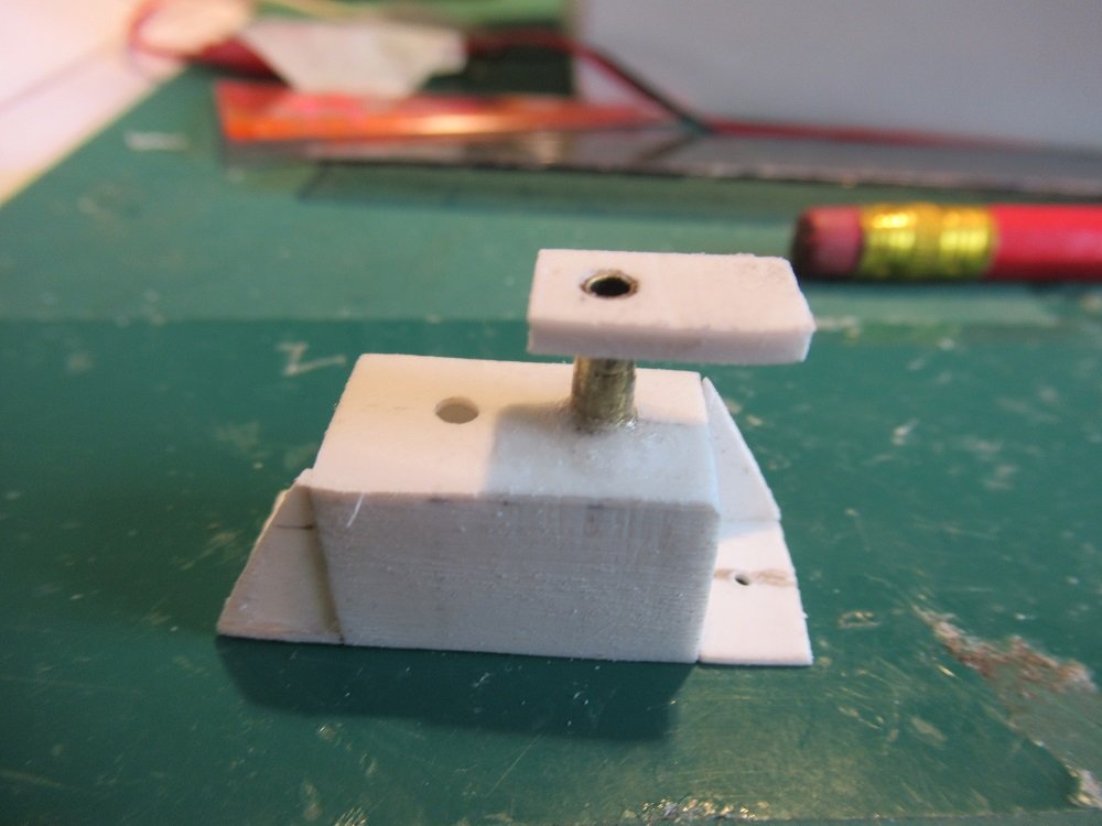

an the bits of balsa wood are to represent the radar so i can see if they turn at the correct speed
an more pics tomorrow an with this mast it had to have all the wires goin up it for nav lights an runnin lights an red anti collion lights an that took some doin but you all will see them lights all goin tomorrow as i think im over the pic level allowance
