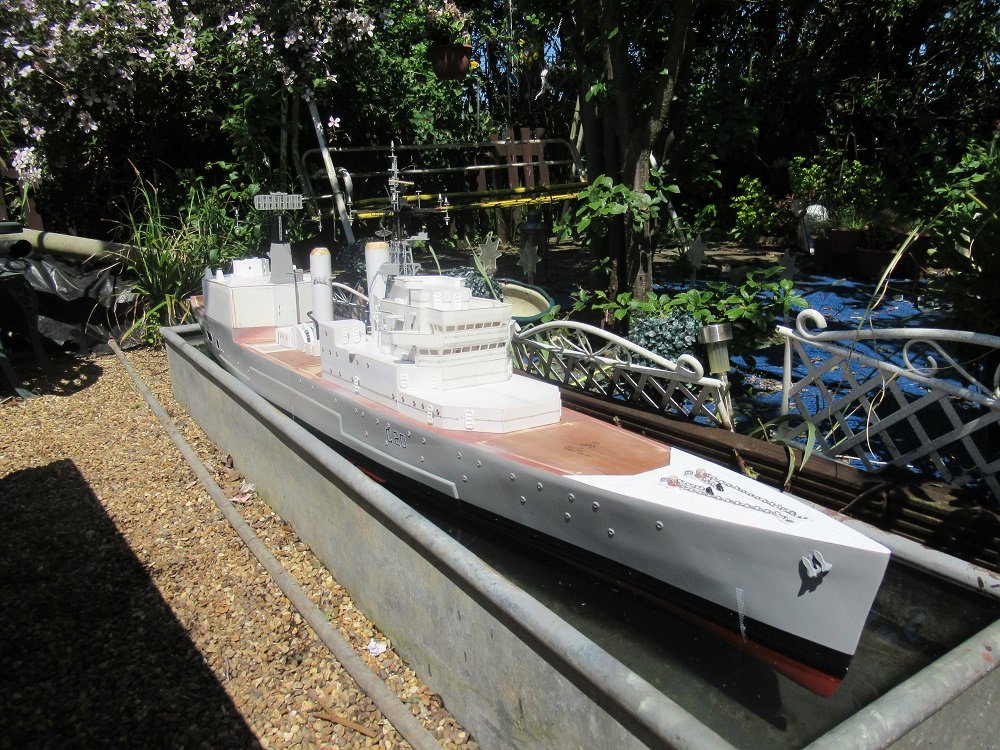

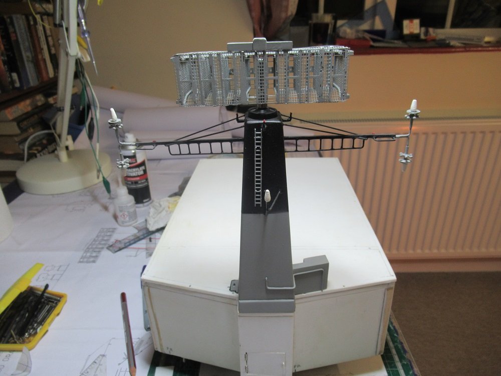

rear funnel with them cooling fan units

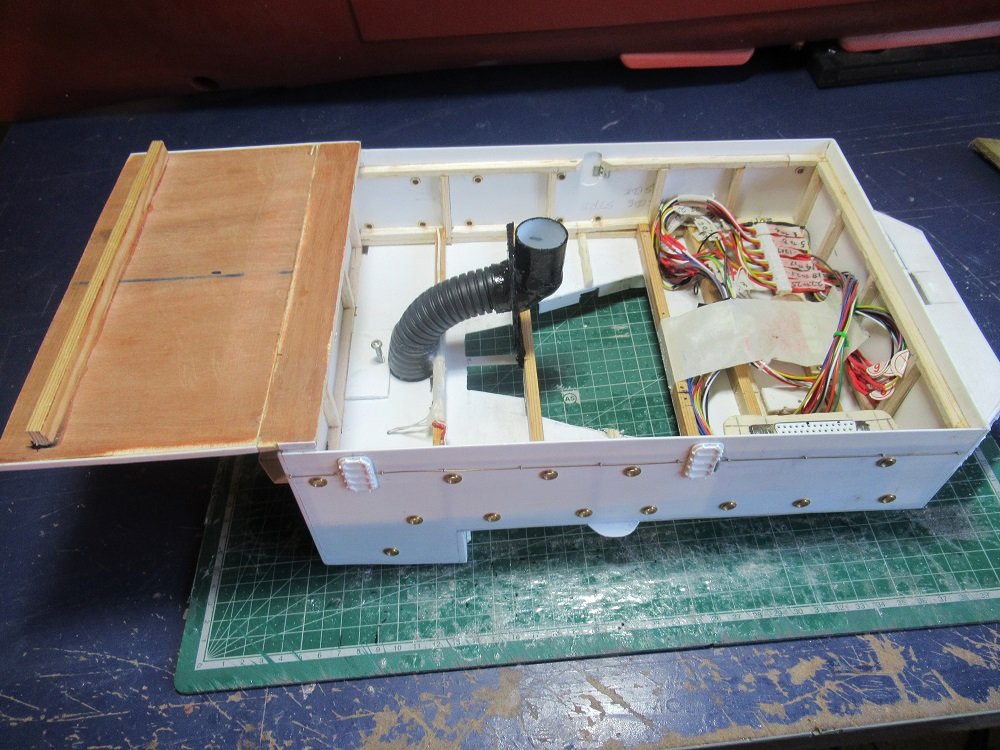

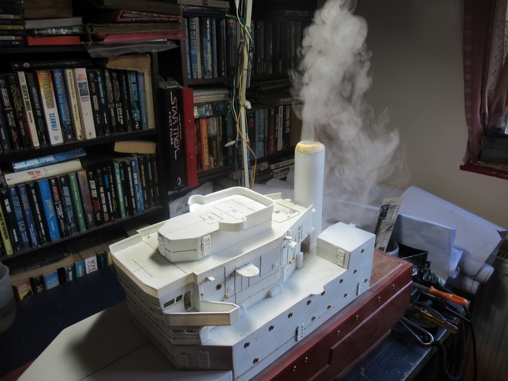

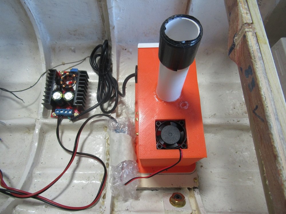

off again with some pics all an here ive just fitted in the water smoke unit an its 24 voltage power fitted with a fan to blow out the steam up the pipe then up the funnel
AN THE STEAM unit wont fit directly under the front funnel so had to fit a bendy bit of inch size pipe an here its fetted in place an it also helps hold on the big bridge S/S AGAINST THE WIND BLOWIN AGAINST IT

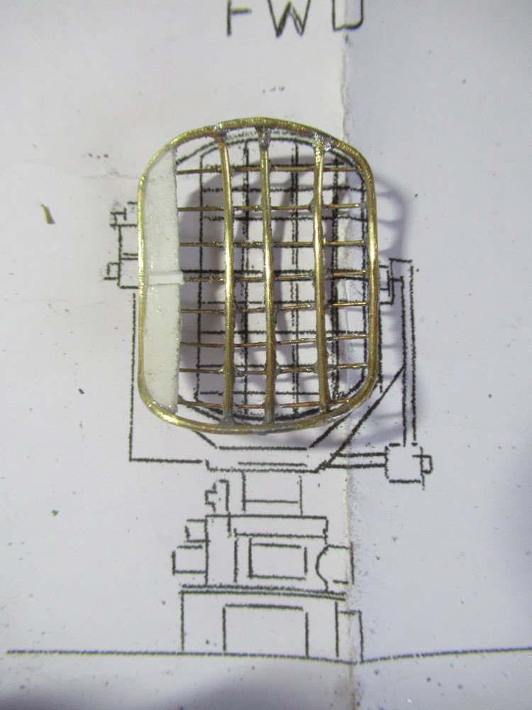

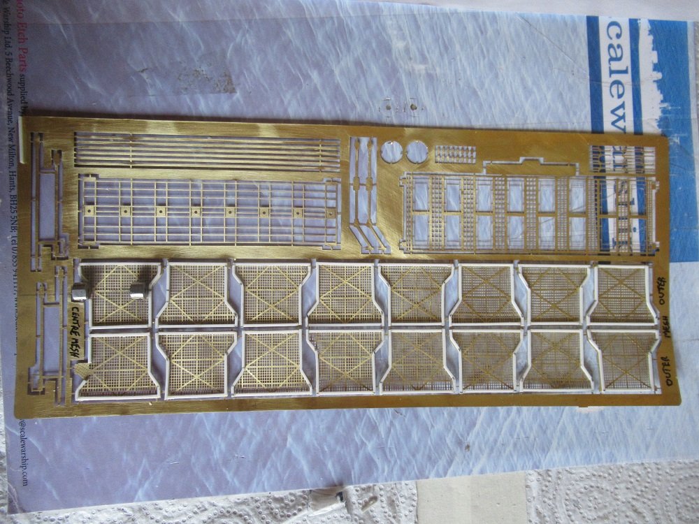

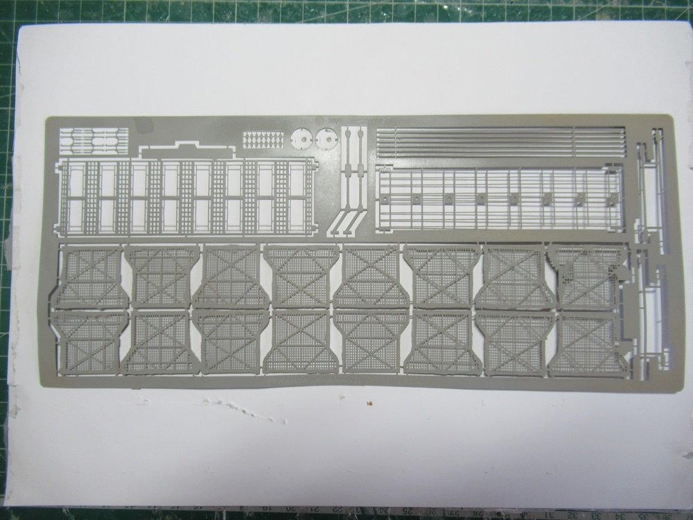

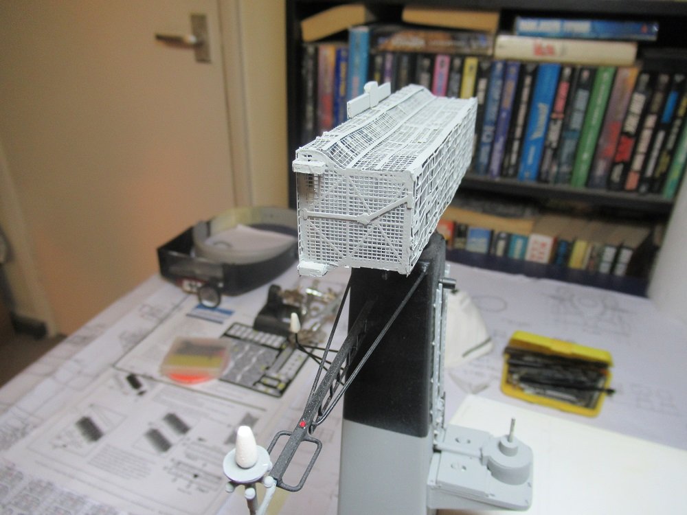

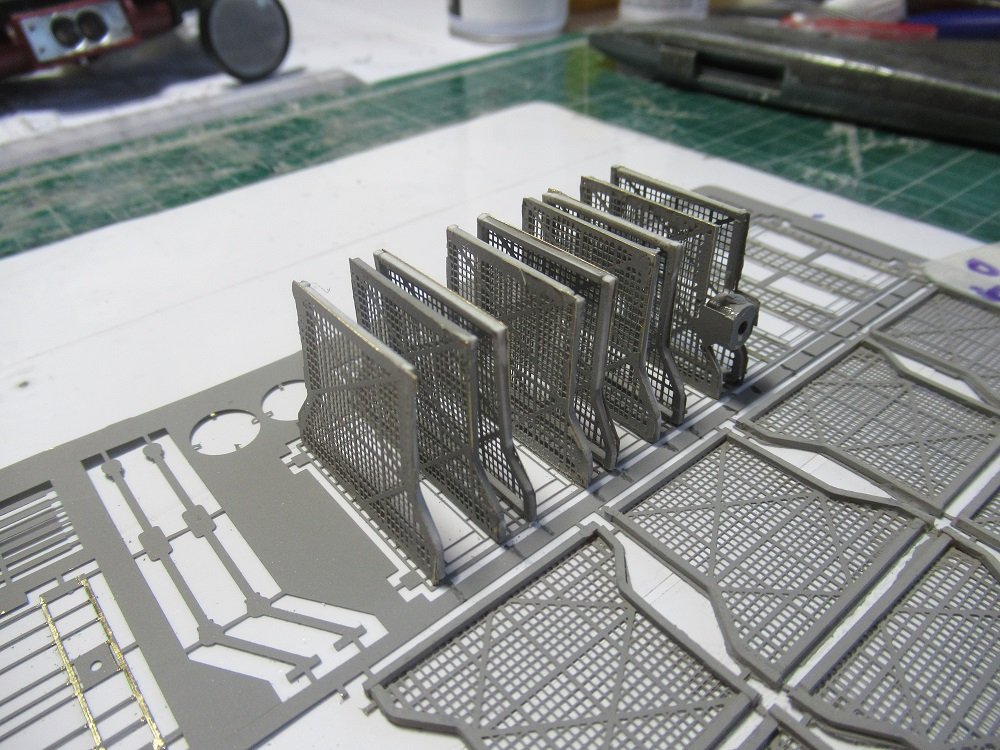

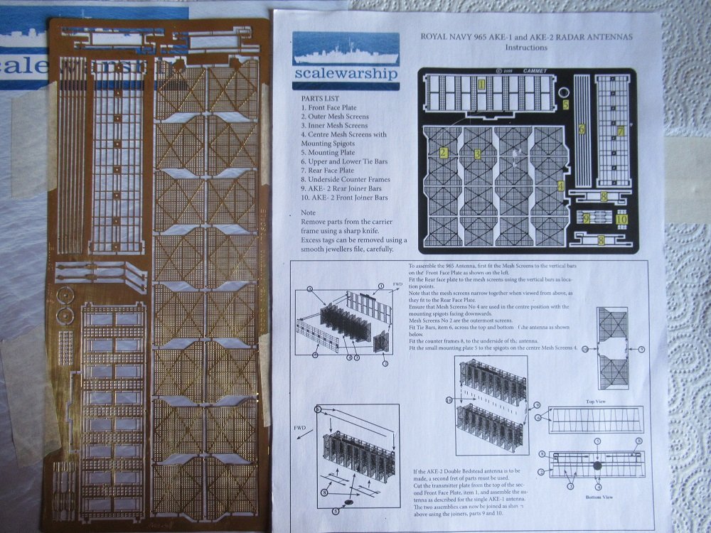

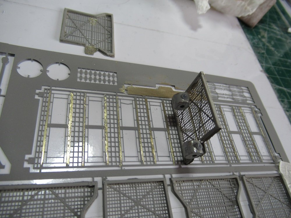

NEXT UP is not my fav as its A P/E big search radar that fit on the rear main mast an it went togeather easy to my surprise but thats because its big the radar is over 4 inches wide an its a box radar that the R/N used at that time
as can be seen it P/E an at that time i did not have the fear of it goin wrong or the shakes an it was made by CAMMET company an i cheated a bit by fittin on some plastic sprues to help glue it togeather but it worked ok
an here i sprayed it all light matt grey as when its bein built wont be able to spray in side the boxes so had to be done before bein built
AN IN THE CENTRE of it i fitted two steel collets with allen screws in so when it slides on the main shaft i can then tighen up the allen screws so it wont be lose

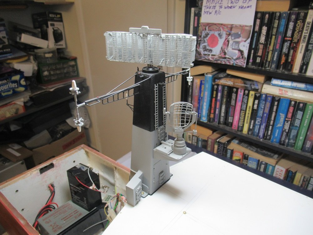

an the first one here im building the height finding radar that fits on the back of the rear main mast an it also revoled but not now as it got used a lot an the crown gear onthe main shaft wore its teth off so now it just stuck in place

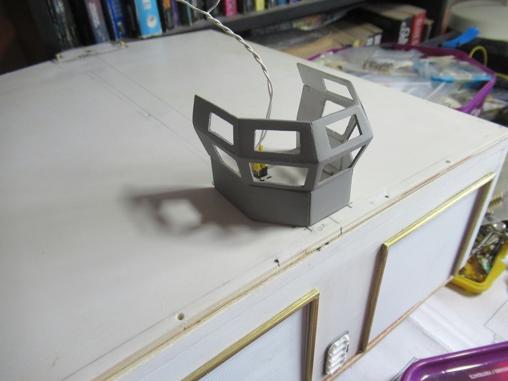

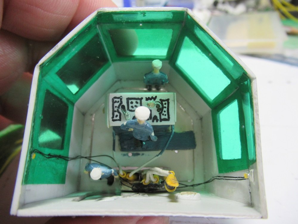

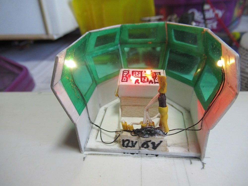

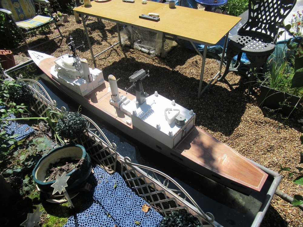

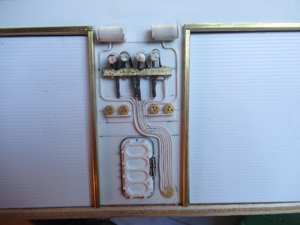

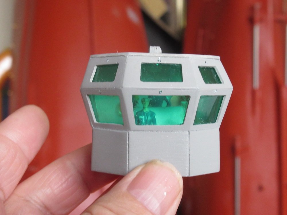

here im building the helicopter controll bubble thats was fitted on the back end of the hangar bay

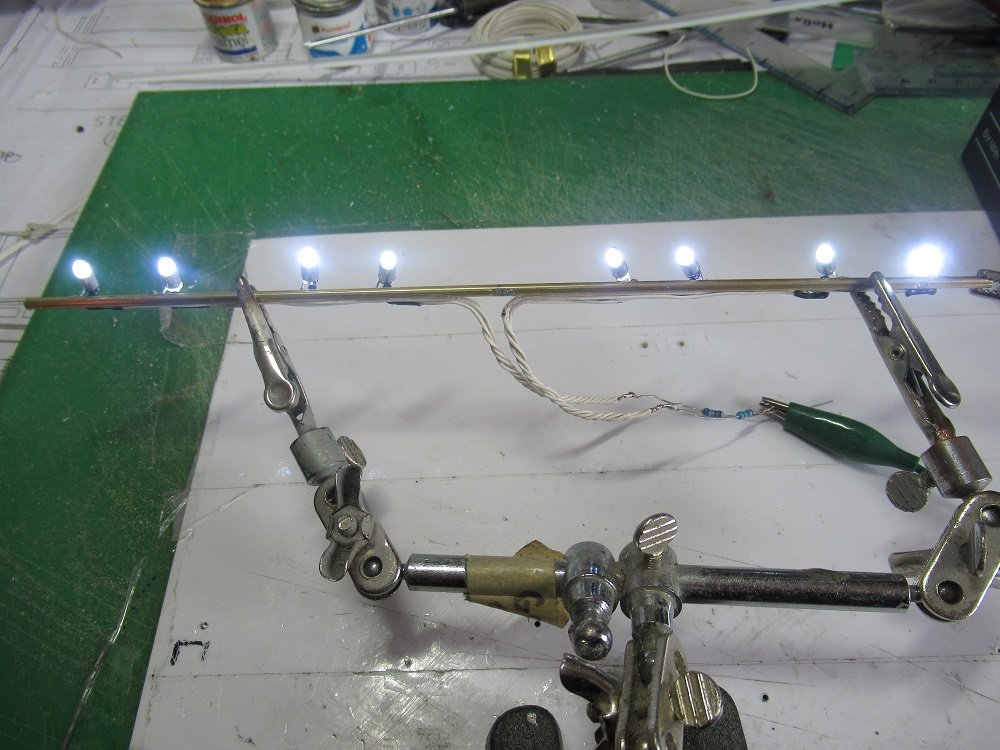

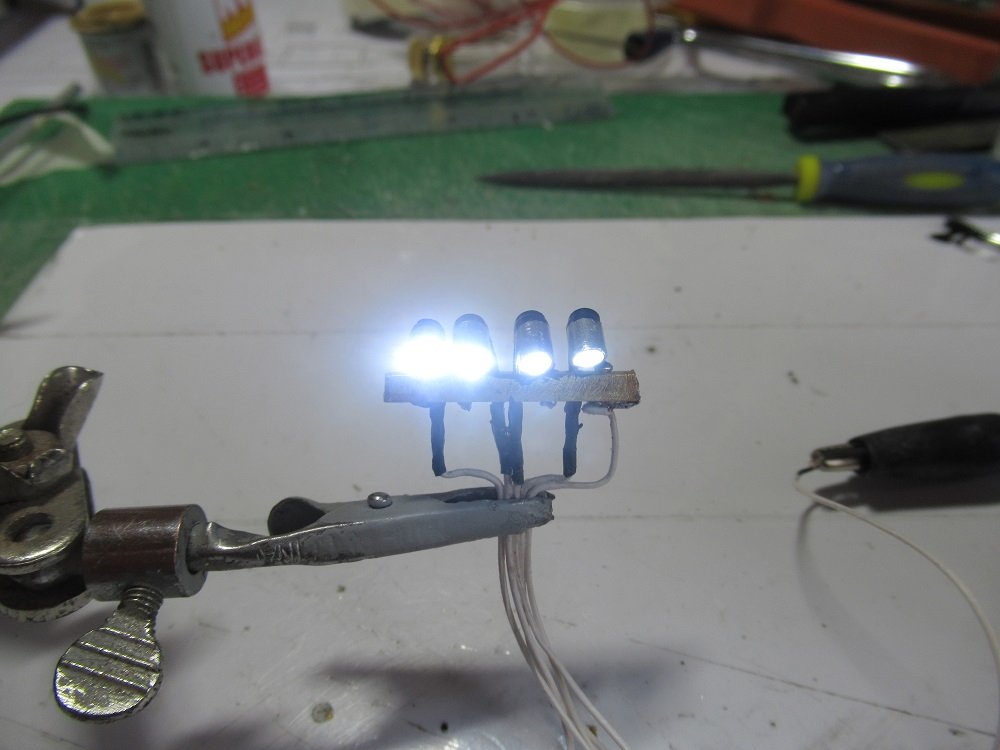

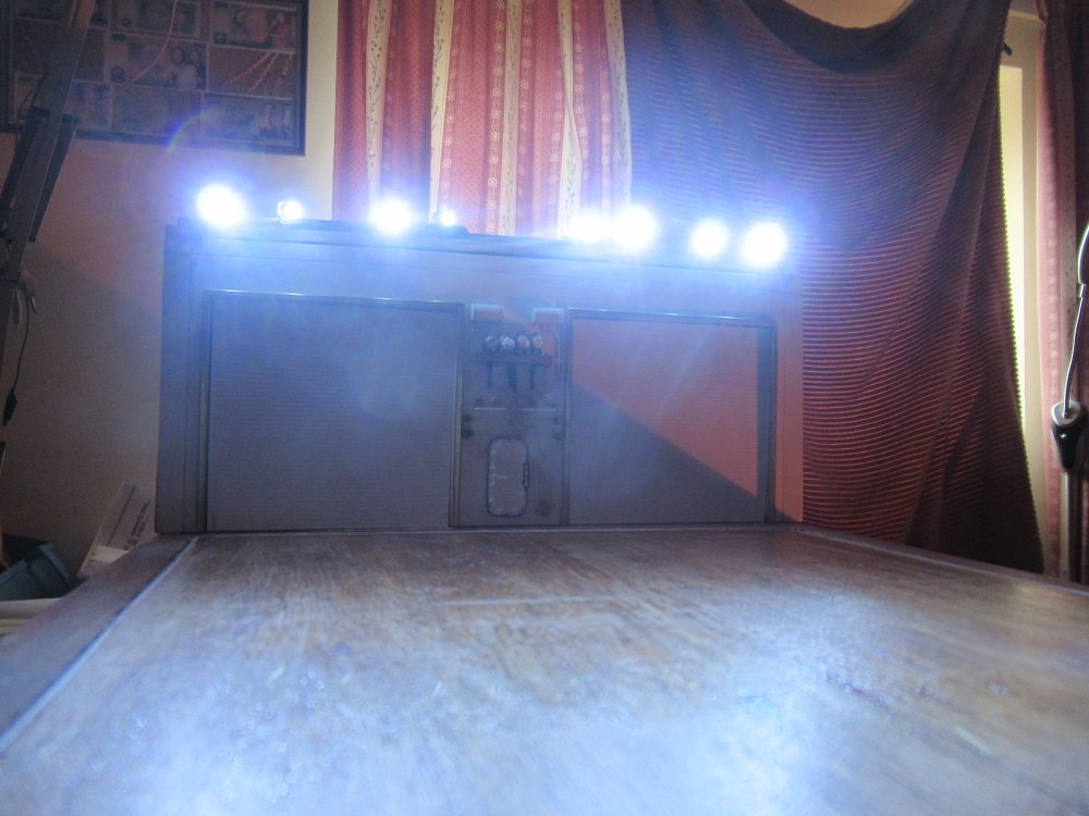

AN Wireing up the main flight deck leds to again shine up the flight deck an seaking chopper on the deck an the brass bar is the negative to save on how many wires i had to get fitted in side the 2mm brass box section

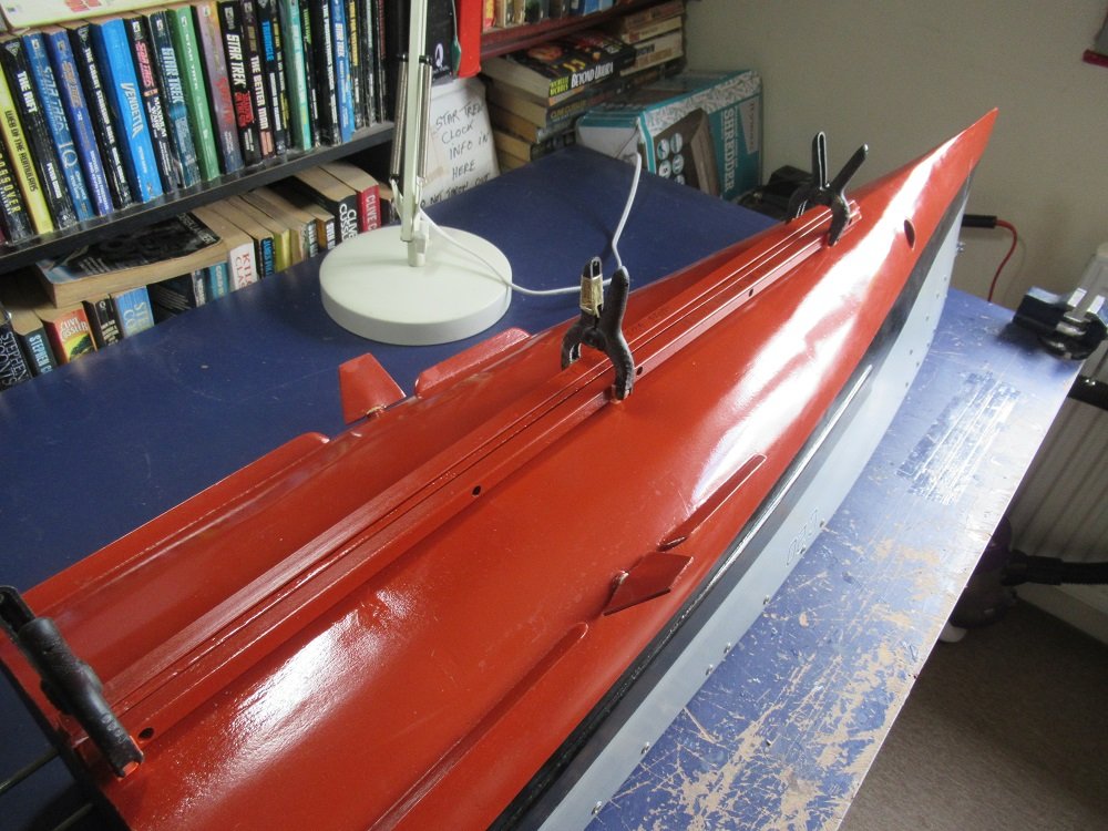

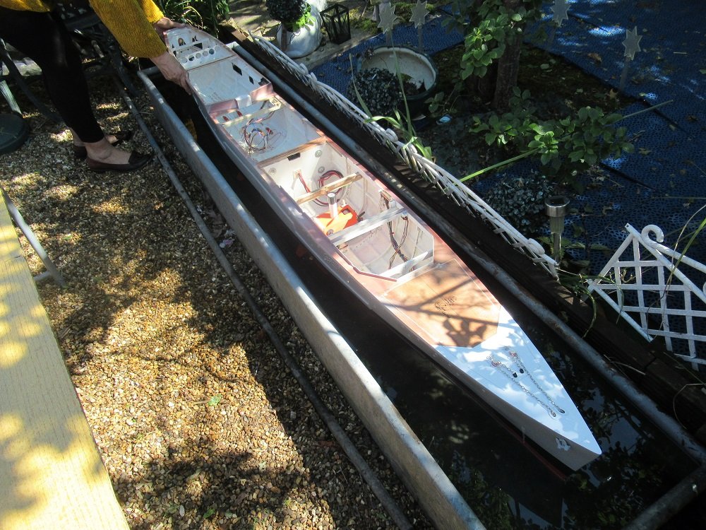

so yes she had to have a counter balance wheight fitted to her keel an its two bits of half an inch steel bars bolted on an it dont look out of place an neat an does the job an the hull has been spryed in a clear coat lacquer about 10 coats to help with water proffing
