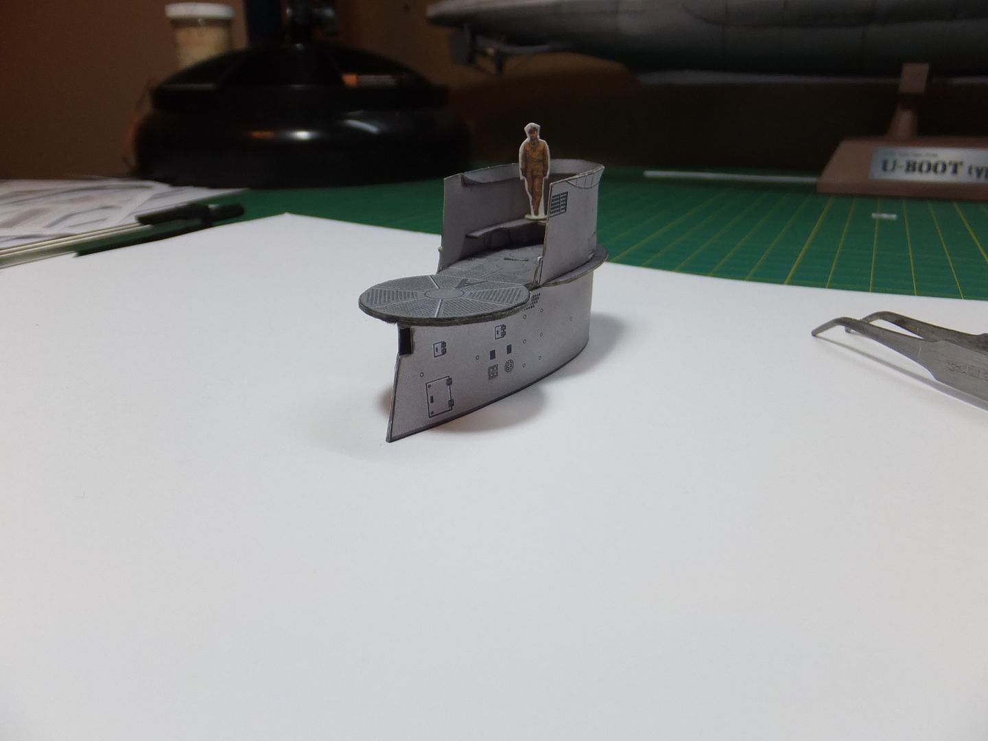

Hello again. Time for another update on my sub.

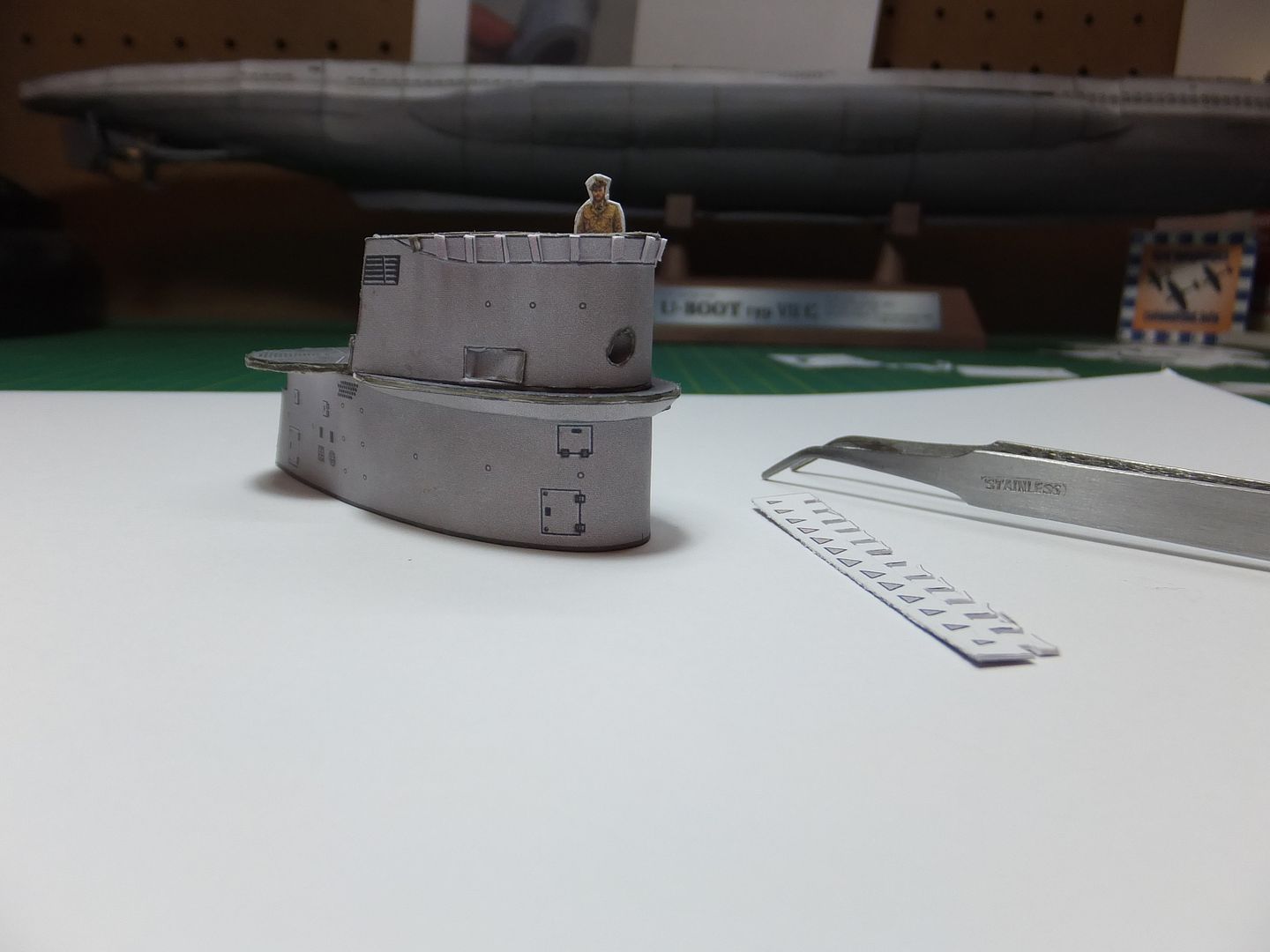

Spent today working more on the conning tower.
The step rail and the inside top railing has been added.
The instrument panel was assembled and installed along with two ventilator shafts near the rear.
This is all for tonight. Lots more detail to add yet.
Lots of tiny bits to try my patience tomorrow. ::)
Jim

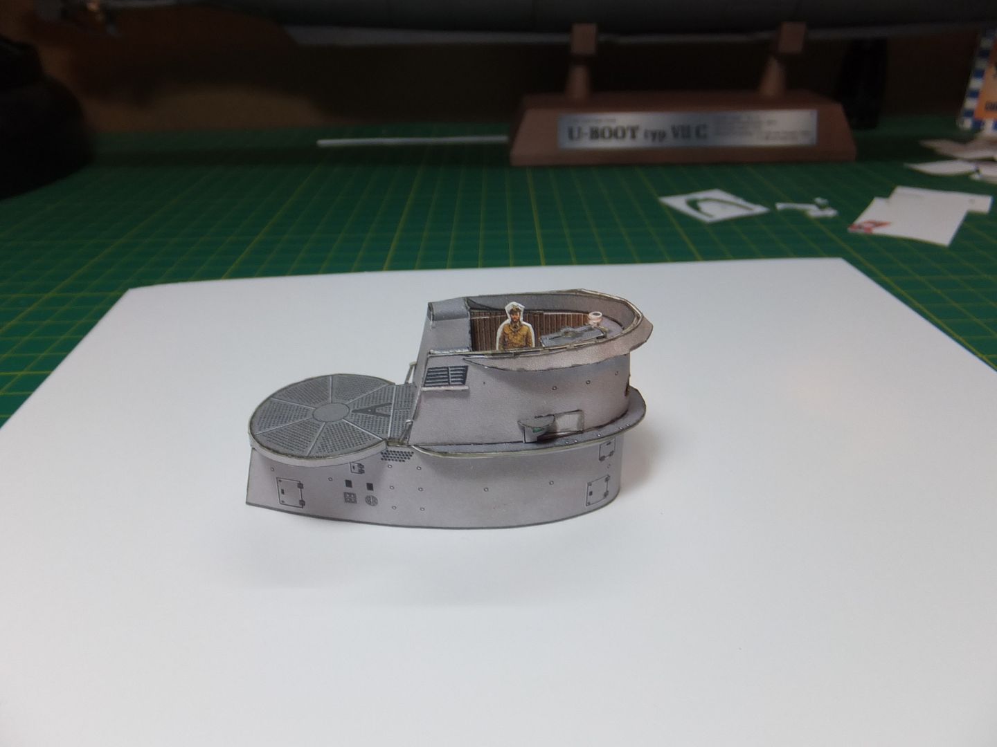

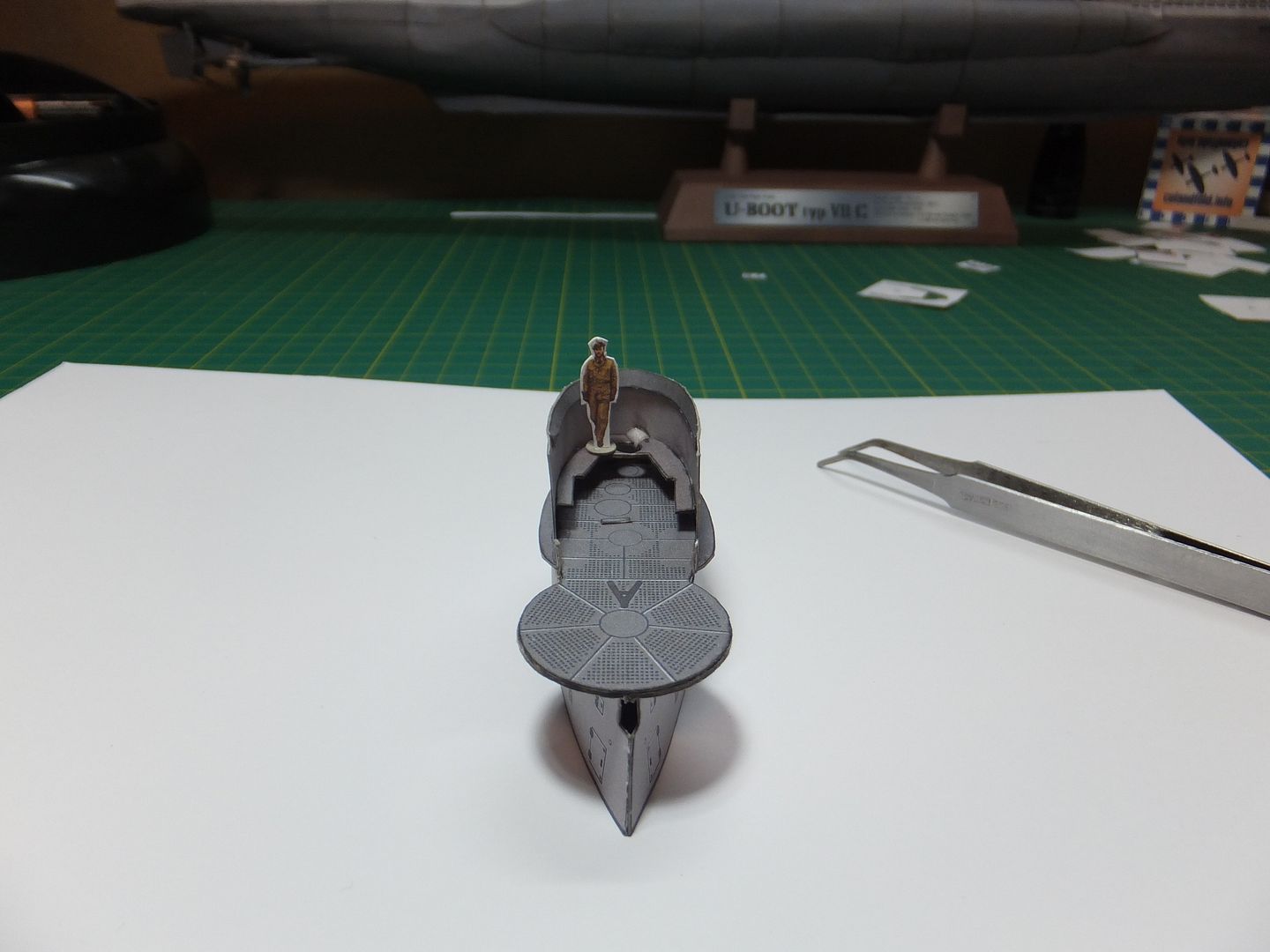

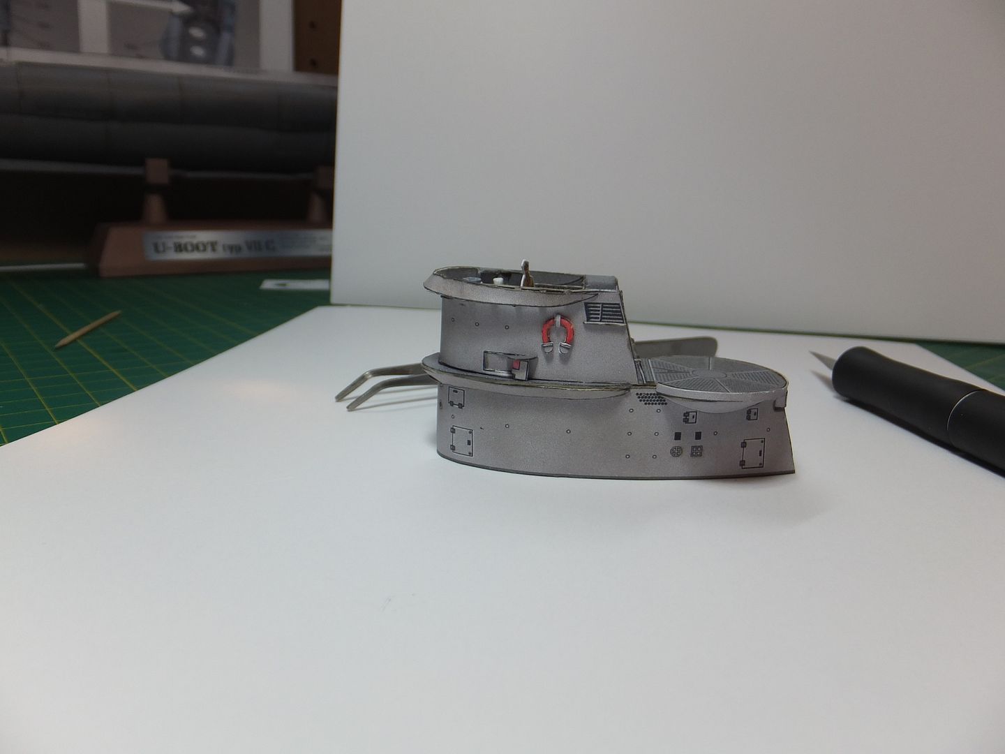

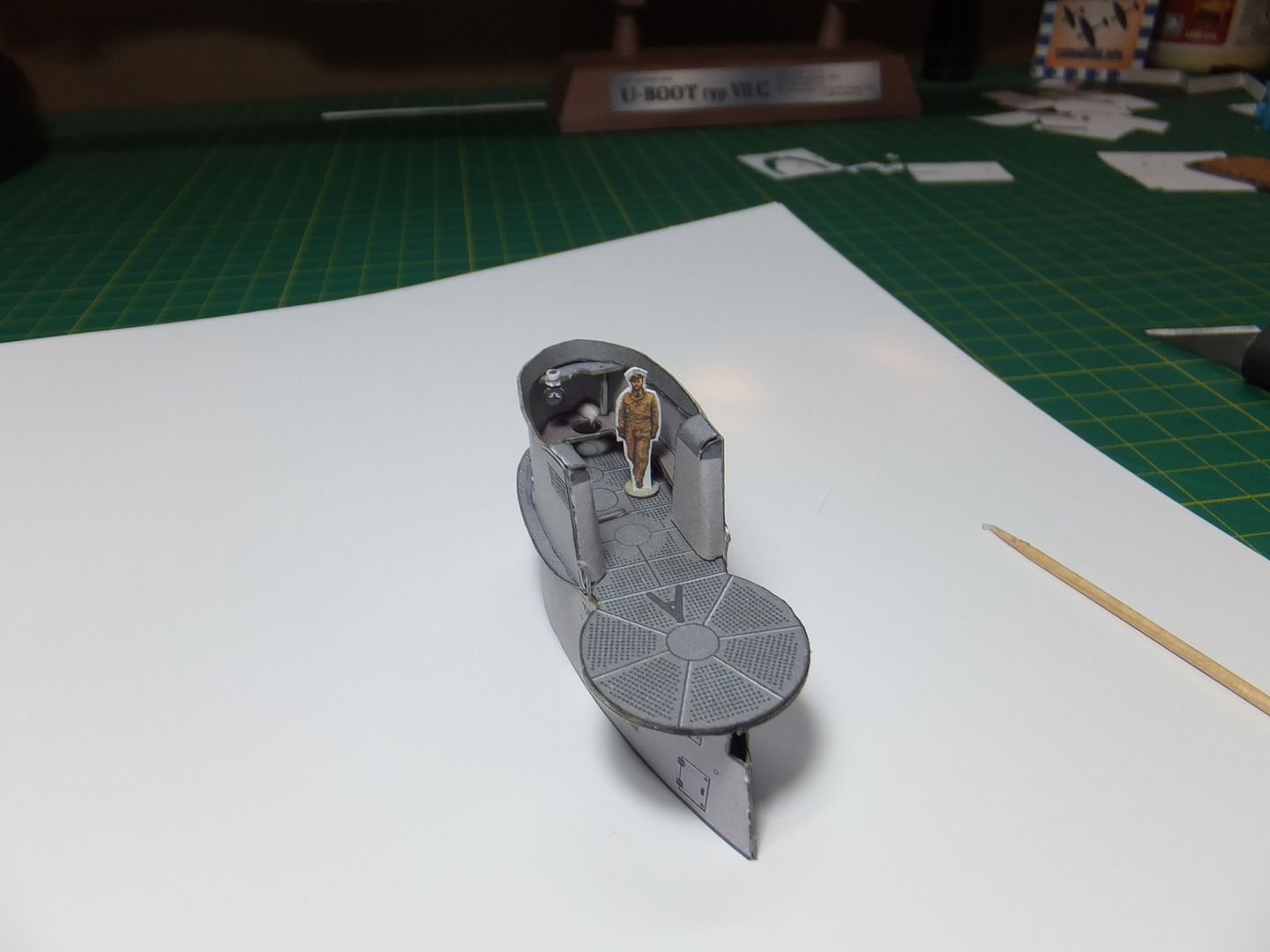

Good evening.

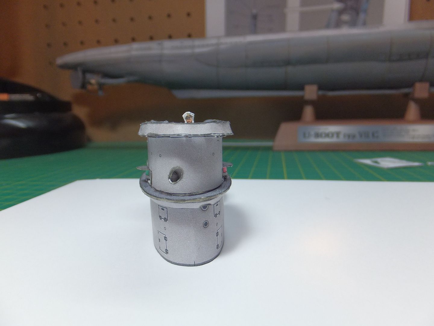

Added more detail to the interior and exterior of the conning tower.
Those wooden walls in the interior took a bit of trimming to make them fit.
Back at it again tomorrow. Some complicated pieces to be assembled for the interior. It's starting to get full in there.
Jim

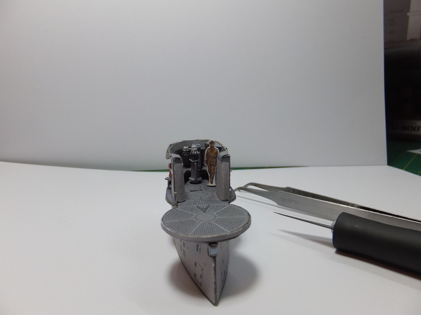

Short update tonight.

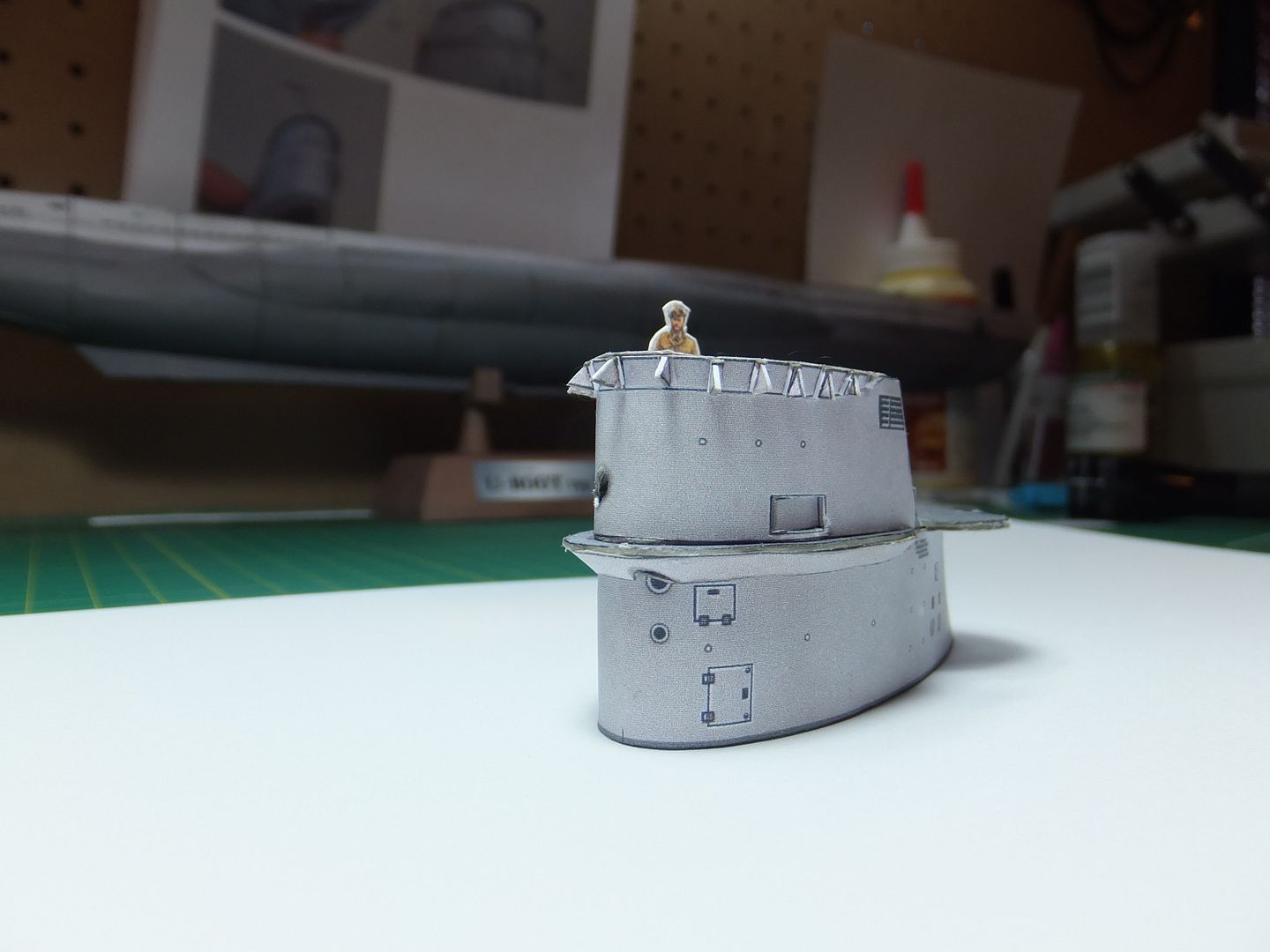

Added some more detail to the outside of the conning tower.
The hull detail under the gun platform and the life ring.

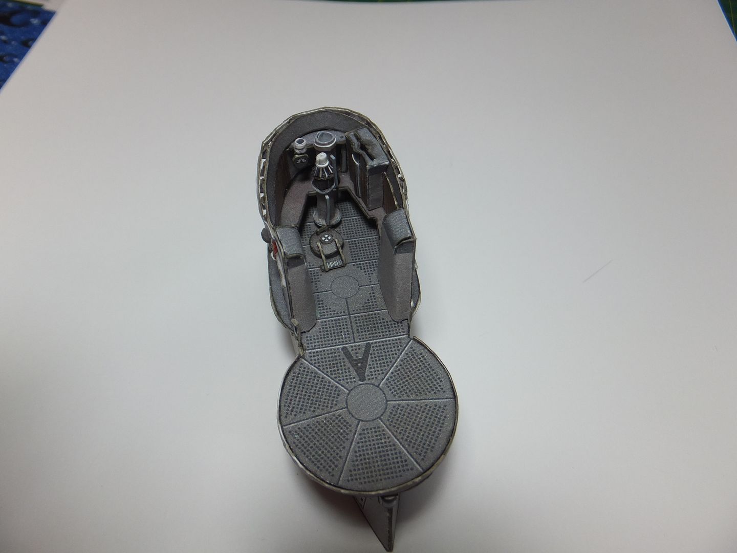

Inside the conning tower the forward periscope shaft was added as well was the quadrant.
This quadrant took time to construct, 16 pieces and most microscopic. Without my lit suspended magnifier, this project would be dead it the water, so to speak. ;D
That is all for tonight. We'll see what can be done tomorrow.
Remember, your build should not be a chore, this is a hobby.
Jim

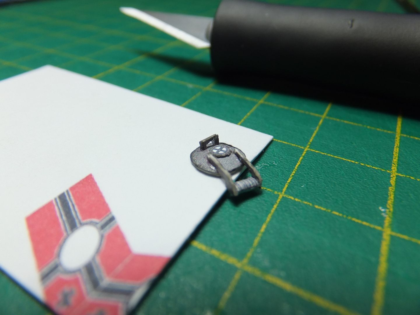

I have been out with family , so did not get much done with the build today.

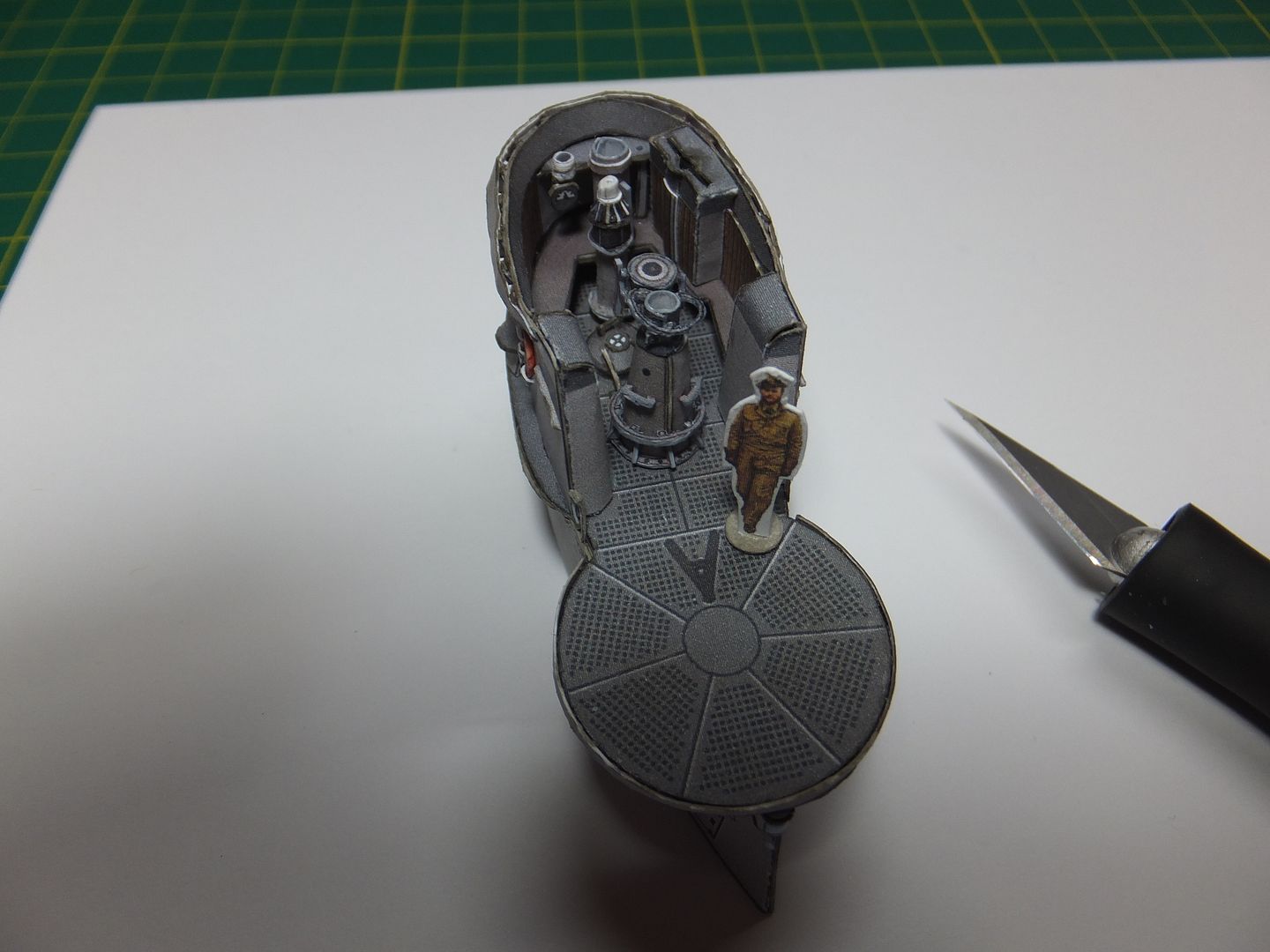

This morning did spend a couple of hours, built and installed the hatch inside the conning tower.
That latch wheel on the hatch, I tried to cut out the spokes 3 times and failed miserably. Ended up leaving them uncut. Would need more magnification and a finer blade, not worth it. Even in the instructions they did not have them cut out. It just would have been nice. :(
So here is where we are at.
Hope to have a more productive day tomorrow. ::)
Jim

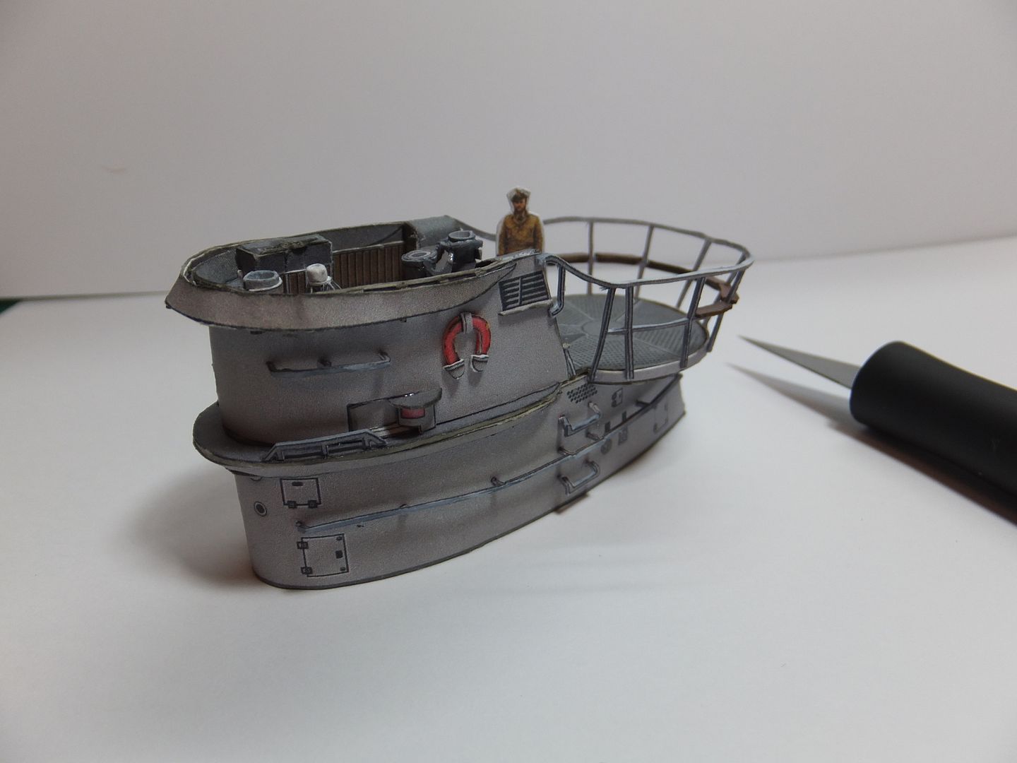

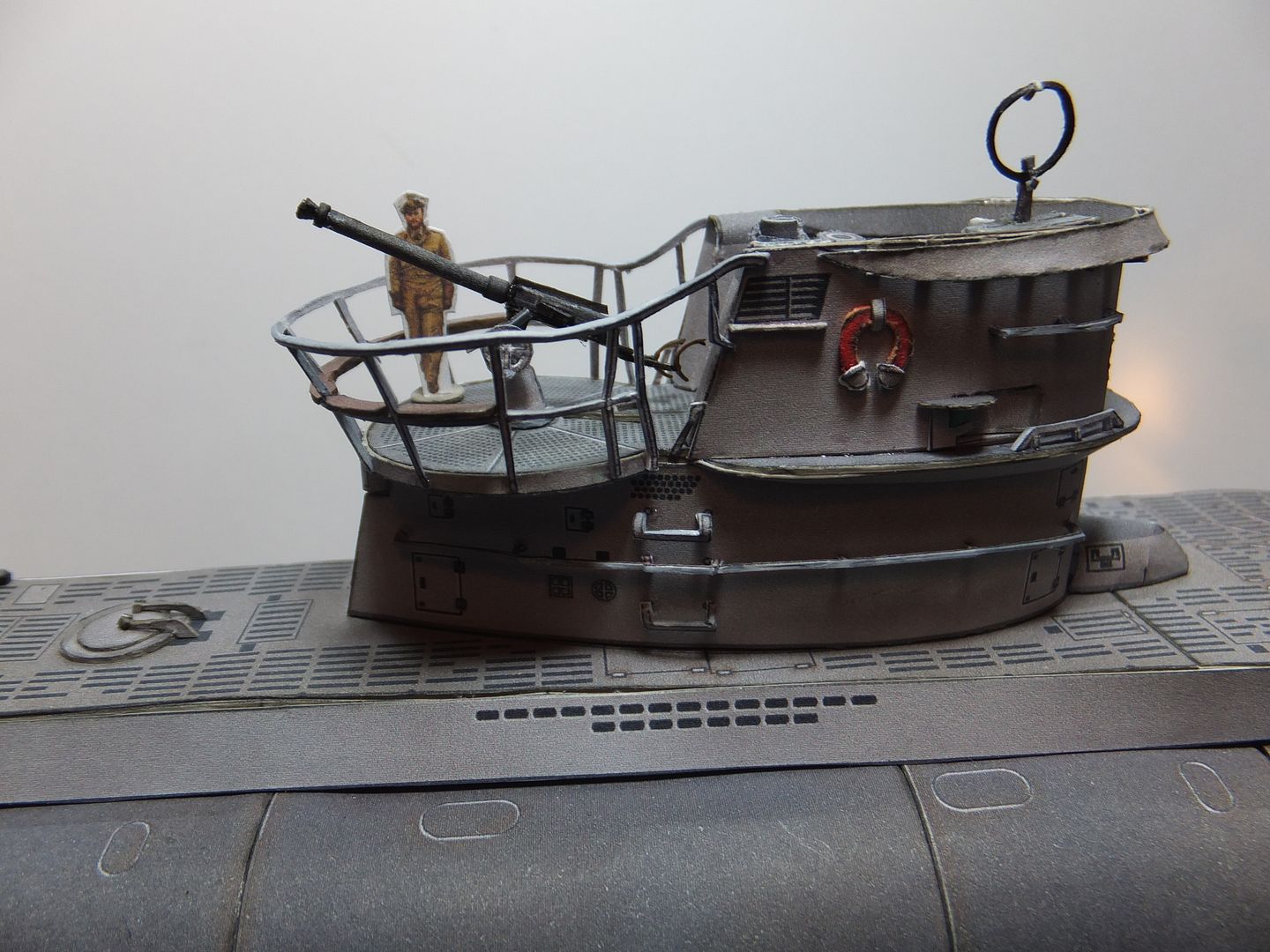

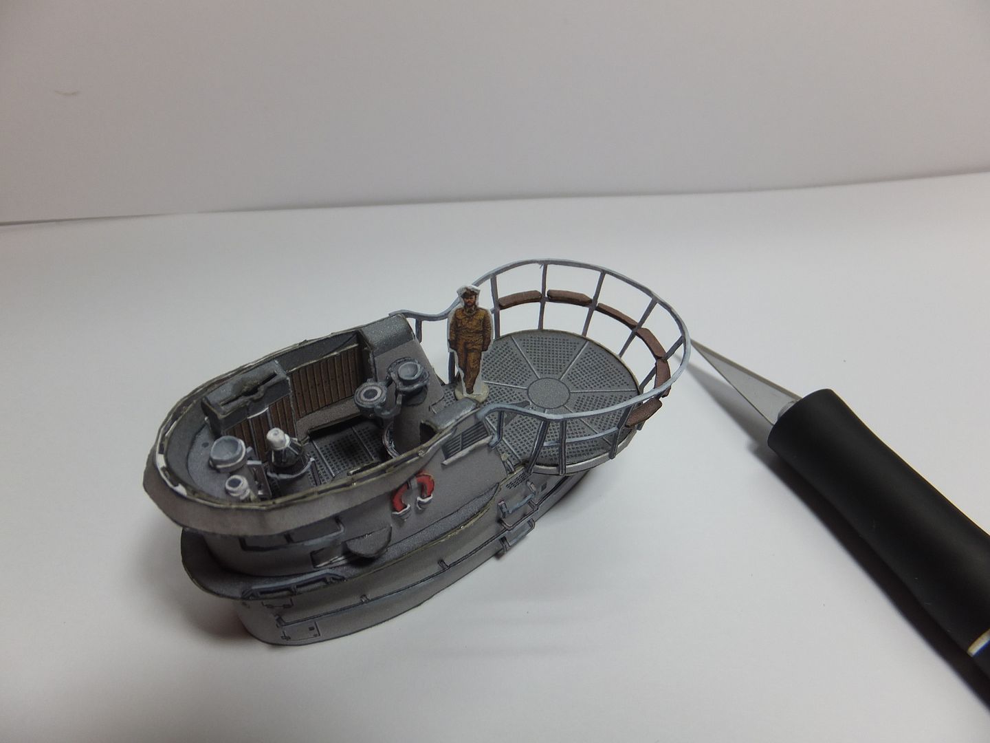

Today's Update.
It has been a long but fruitful day. Constructed and installed a lot of external detail to the conning tower.

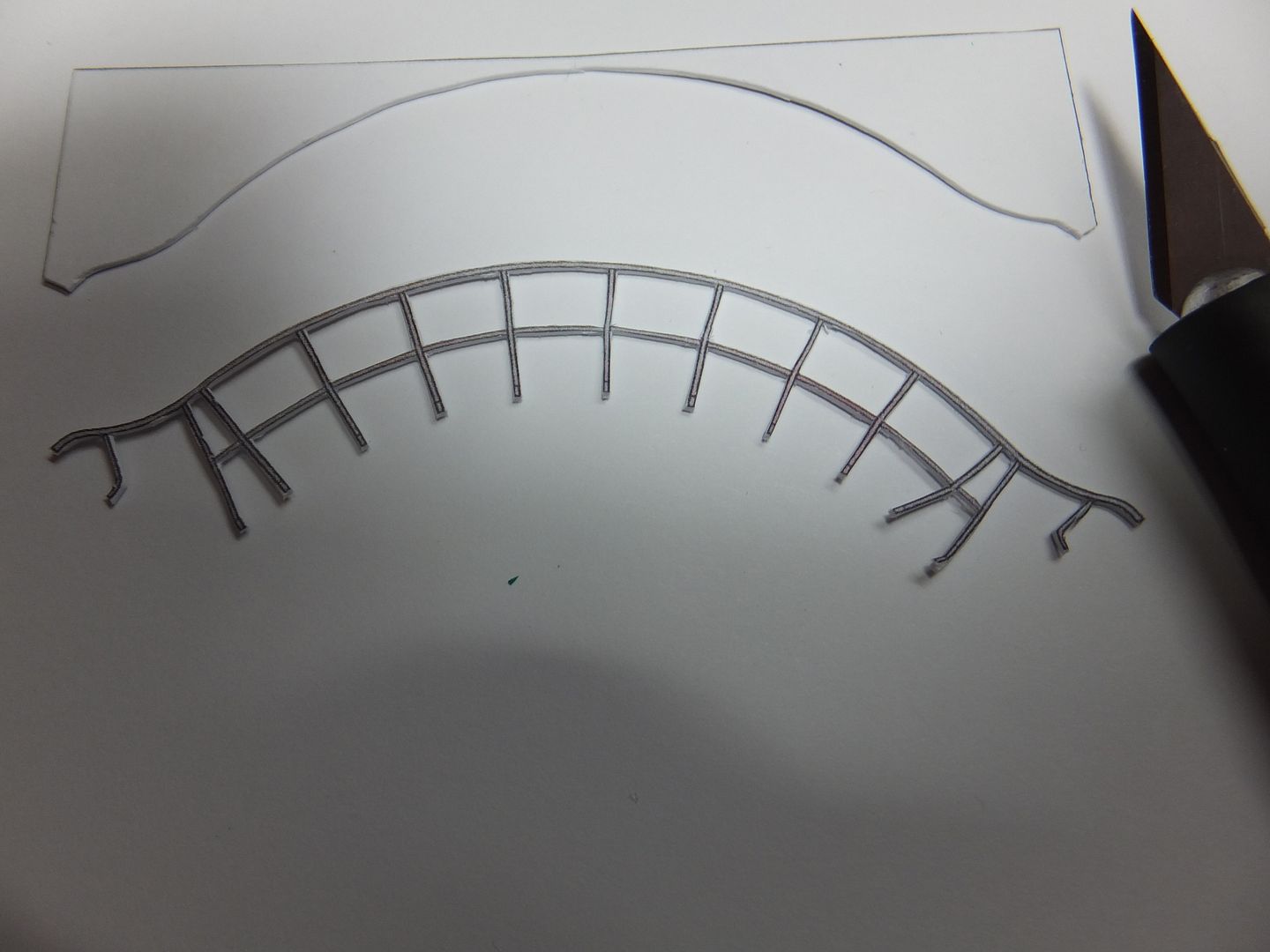

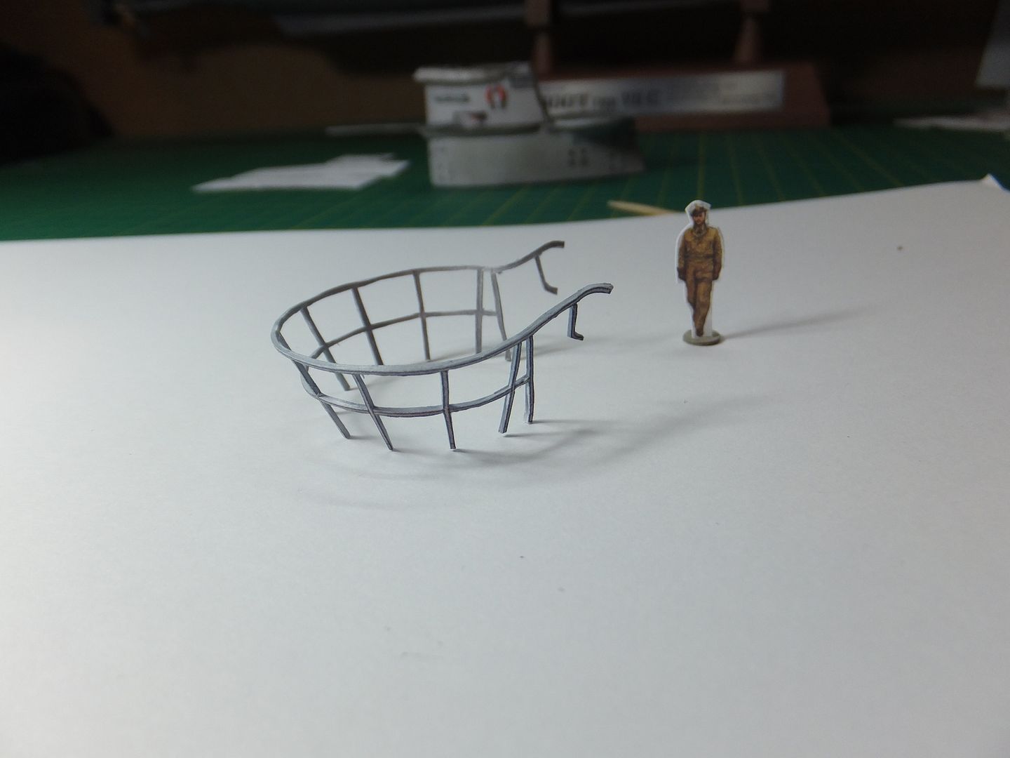

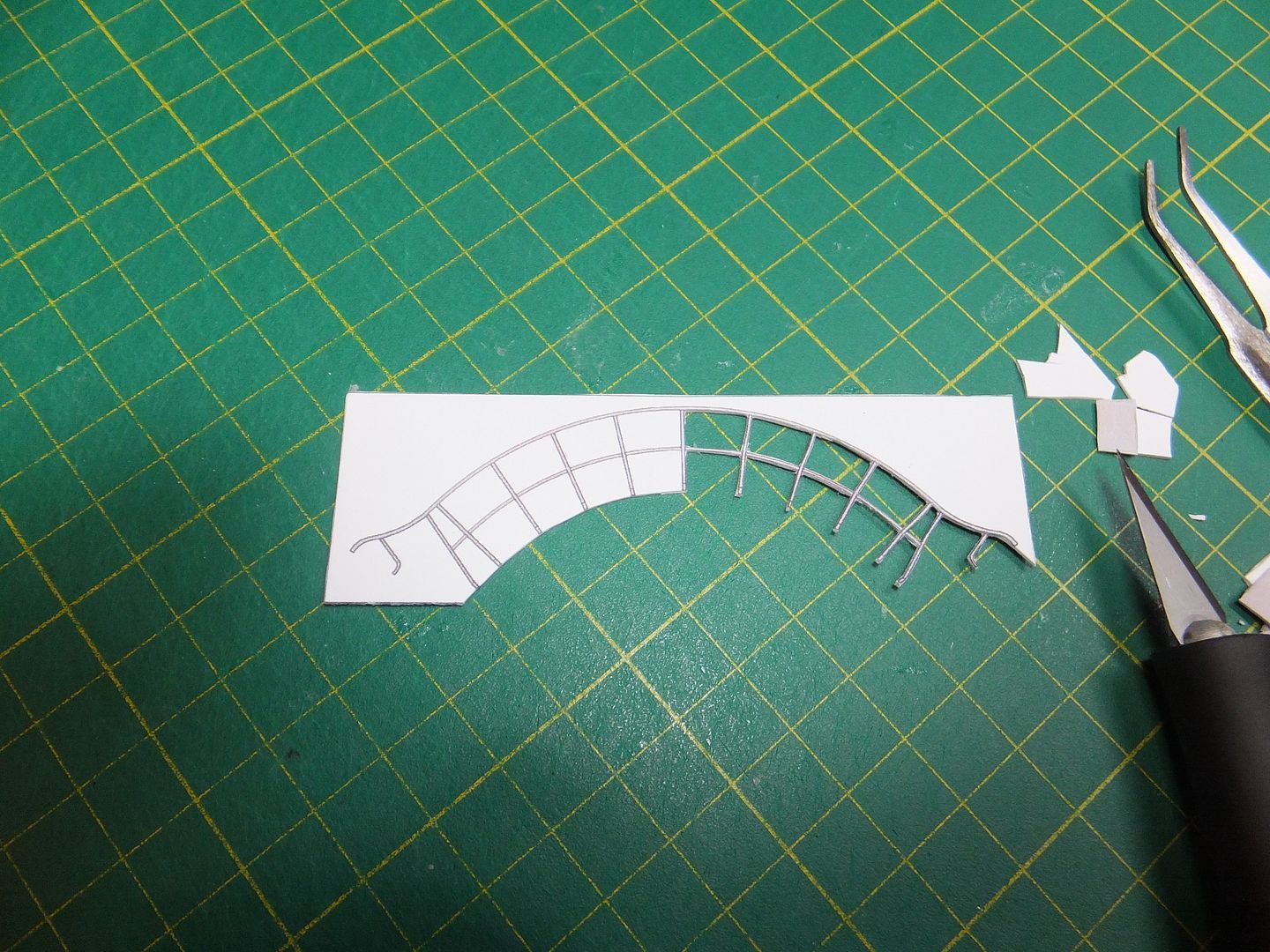

At the beginning of this build I was not sure if I was going to be able to use the paper railing for the gun deck. I thought that it may be just too fine to be able to cut out properly, and was prepared to use wire or styrene and scratch it. Took a gamble and started to cut that thing out. Expecting any moment to slip and destroy it, but I took my time and only cut a bit at a time. Then rested before going on, so as not to get fatigued.
I surprised myself. I was sure it would have to be restarted a couple of times, but got through it with a pretty clean cut the first go through.
Pre-shaped it to it's required curves fairly easily before install.
Strategically glued the centre leg of the rail to the gun deck then the ends to the conning tower. After that dried, then attached the other legs. After that was dry then cut out and installed the wooden seats to the rail.
It was now time to cut out and install all the hand rails for the conning tower, as well as the foot stirrups.
This is how she looks tonight.
Yes there are things that could have been done better," each build is a learning experience ", but I am happy with the result.
Must move on, still lots more to build before this one is done. ;)
Have a good evening.
Jim

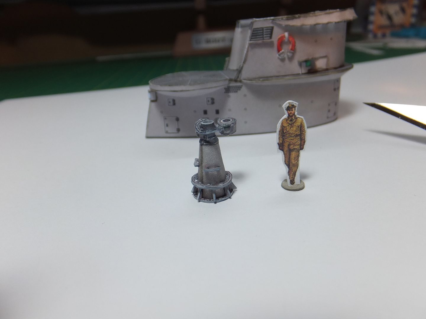

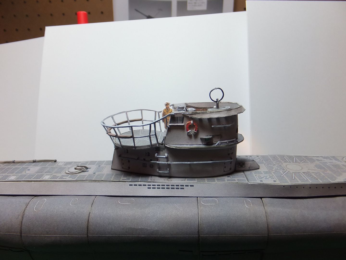

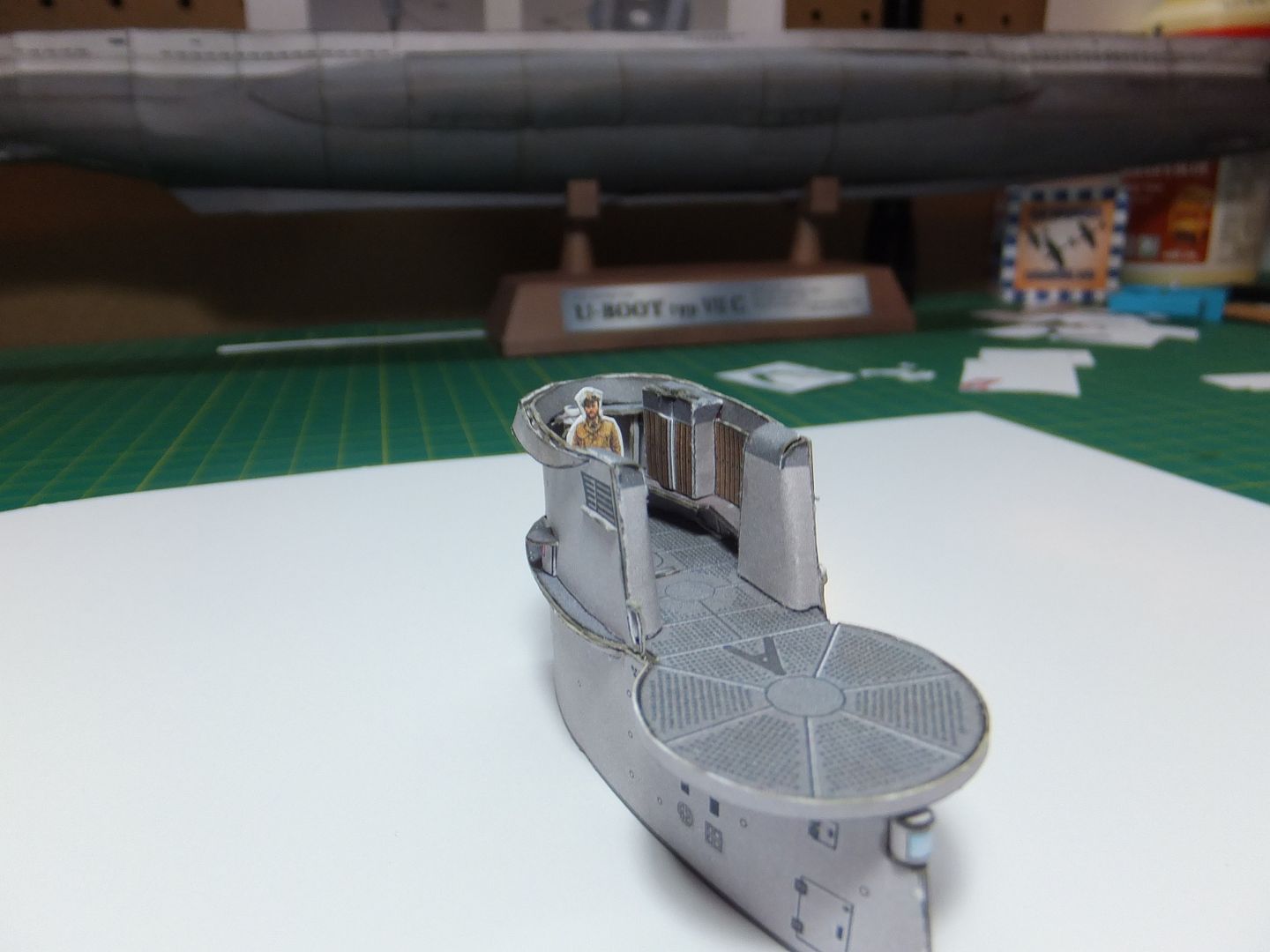

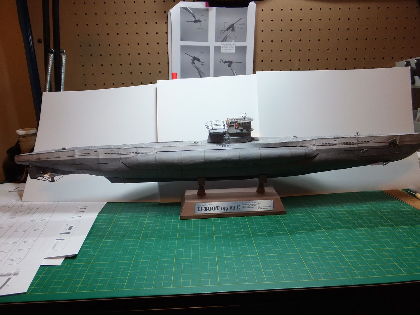

Good evening everyone.
The sub now has a conning tower. ;D
Was at the stage to mount the conning tower to the hull. Another milestone in the build.

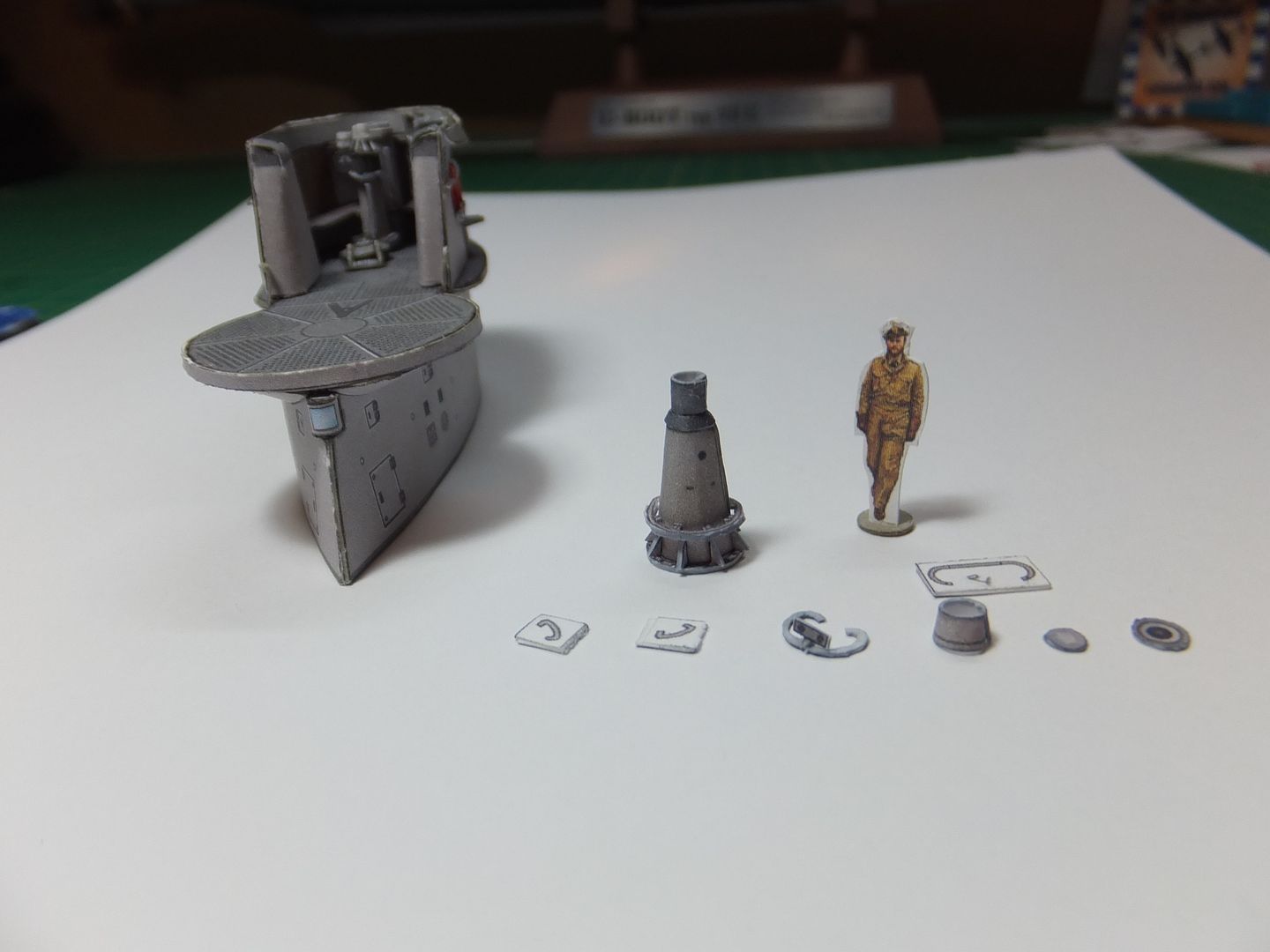

As well the RDF antenna was constructed and installed. I had the DF loop constructed, then abruptly lost it to the carpet monster. Ended up having to scratching a replacement. ::) Never did find the original.
Also a nose piece for the conning tower was installed.
This afternoon started on the MG for the gun deck on the conning tower. the pedestal is built and am working on the gun itself. First time building something like this. We will see how it turns out.
That's it for tonight, lots of tiny bits for tomorrow.
Thanks for watching.
Jim

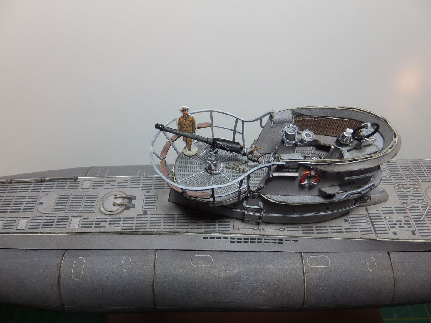

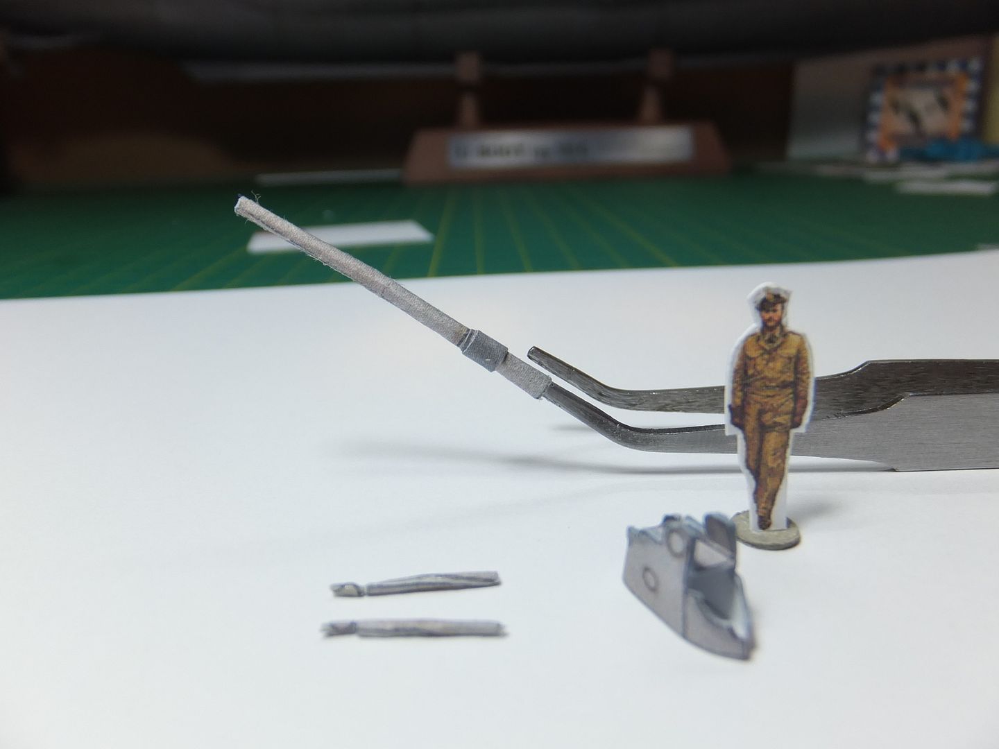

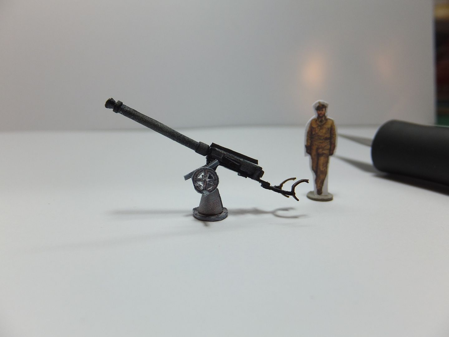

Today's update.
Today has been spent on the construction of that MG. Lots of tiny pieces and trying to interpret the very dark images in the instructions and comparing to the real thing. Sometimes it's just making the best guess.
I don't think it can out too bad.
The original shoulder rests were too big and had to cut them back to be more in scale.
The gun was then installed on the gun deck along with the gun support lock, that was mounted to the deck.
If the gun looks low, in real life this pedestal elevates and the one supplied is at the bottom of the mount.
Top down view.
Next up the main deck gun.
Jim

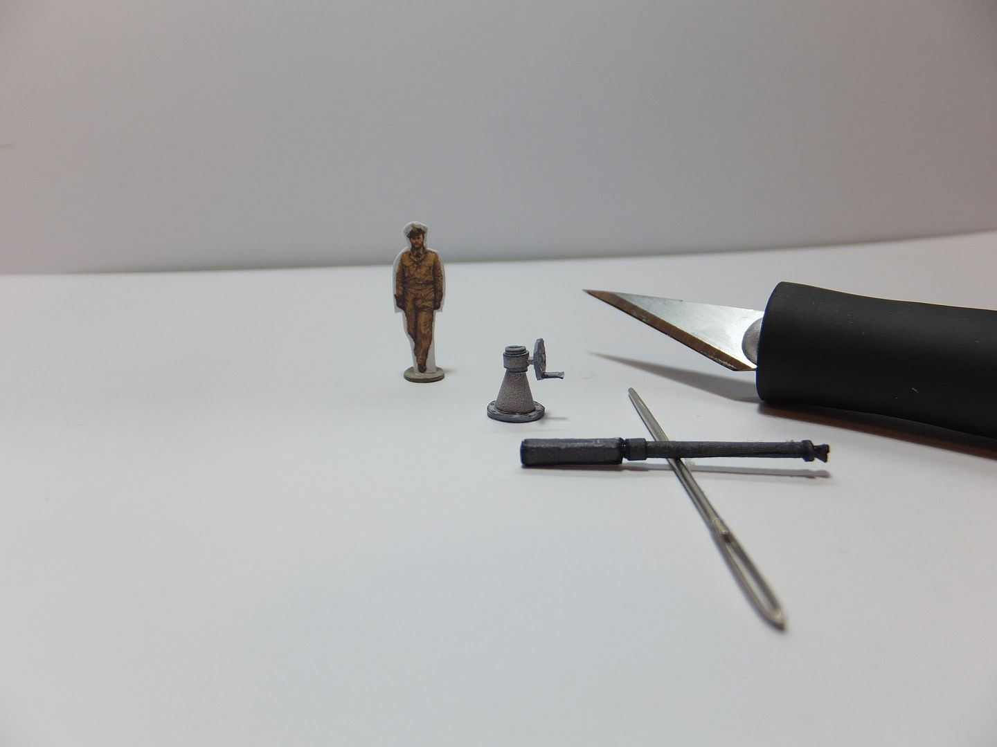

Not much for today.
Did get started on the main deck gun.
Rolling these little tubes is fun. ::)
Should get a lot more done tomorrow, hopefully. 8)
Keep on building.
Jim
