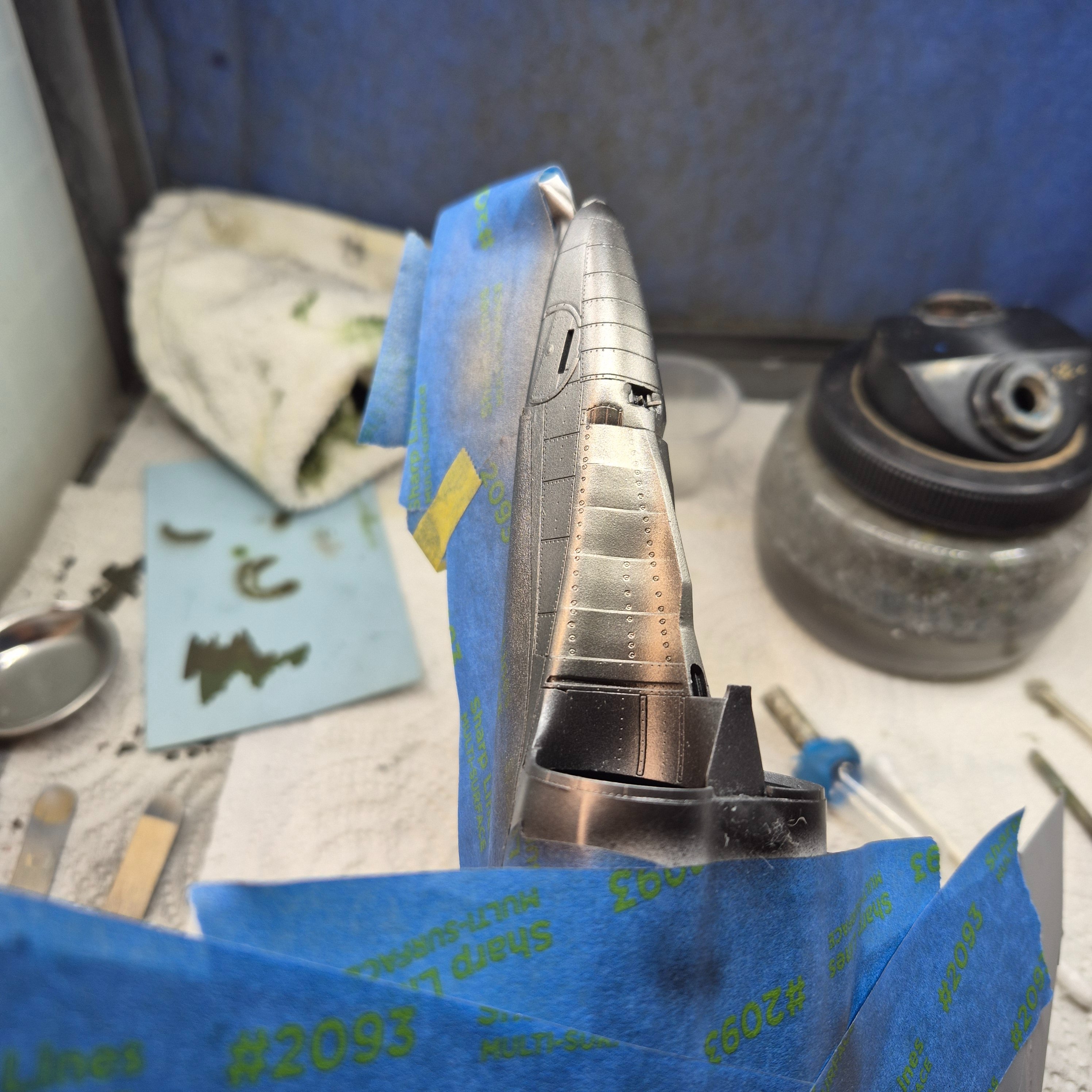

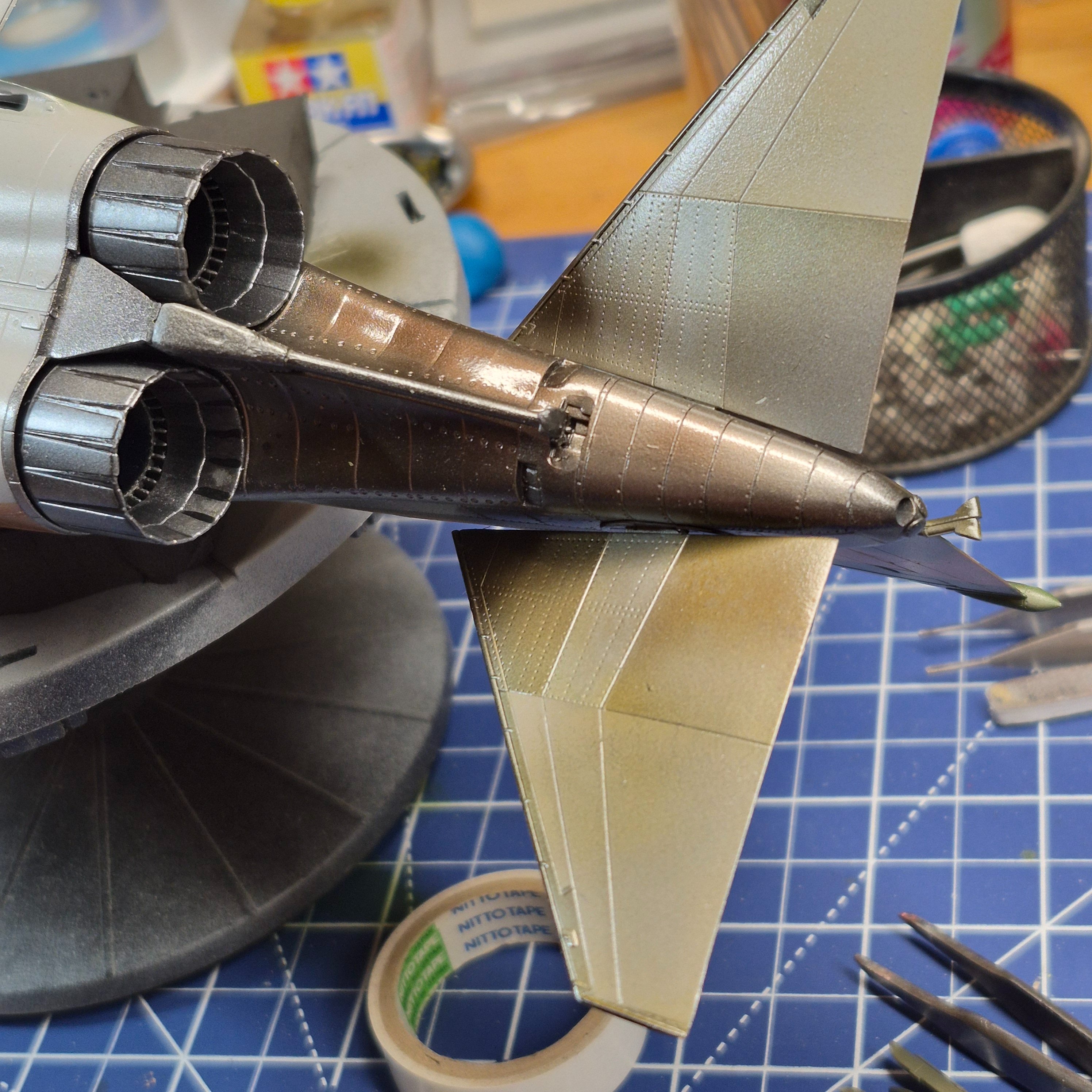

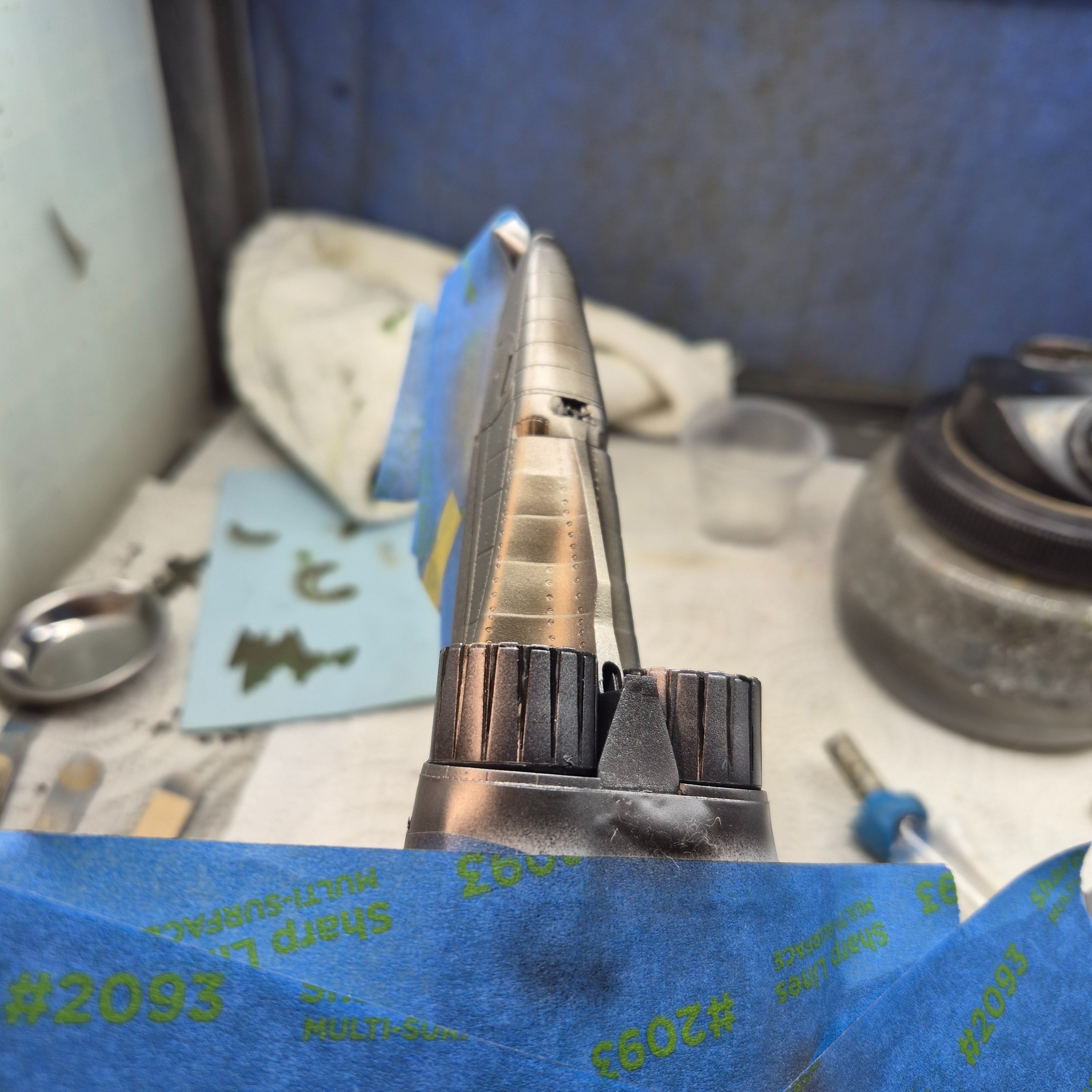

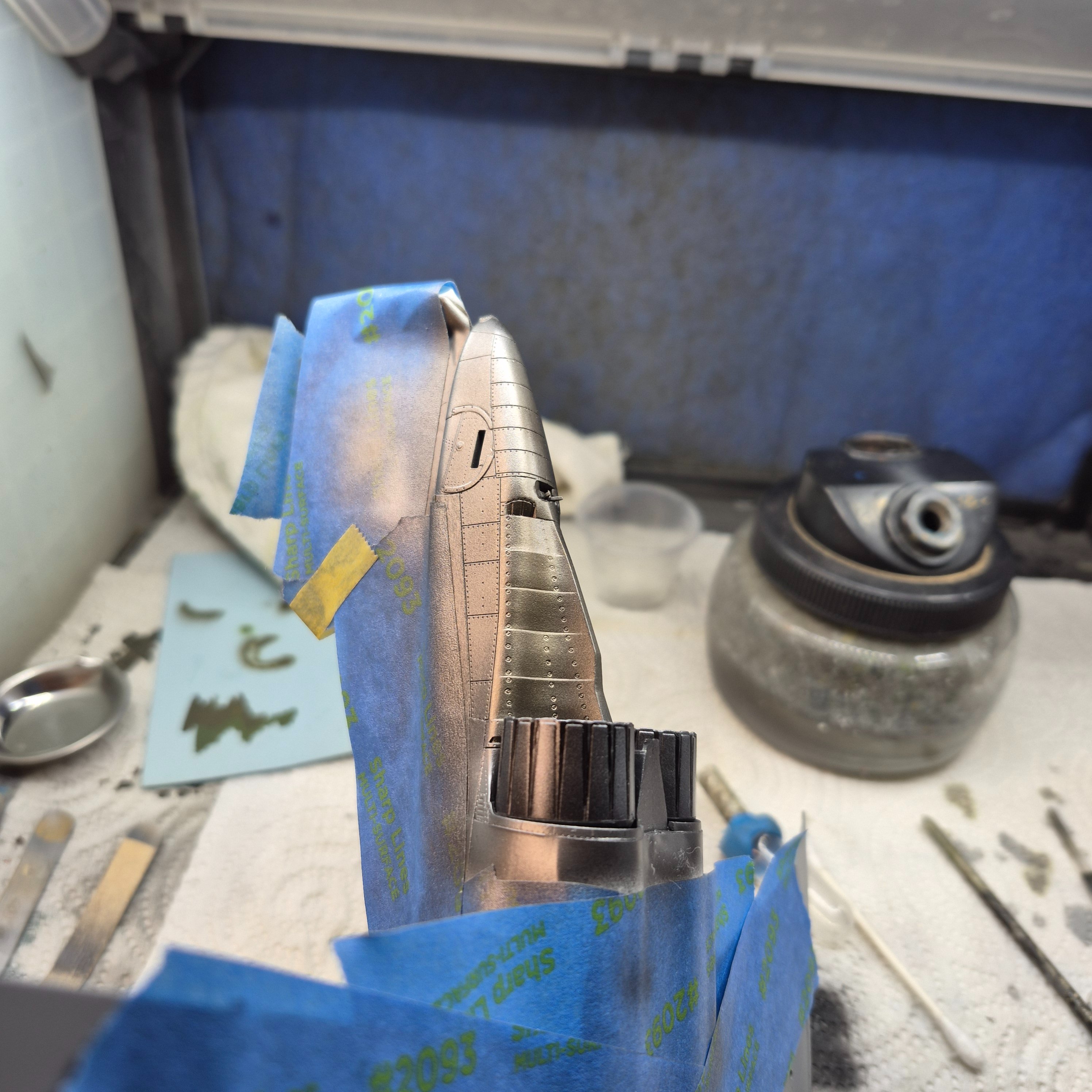

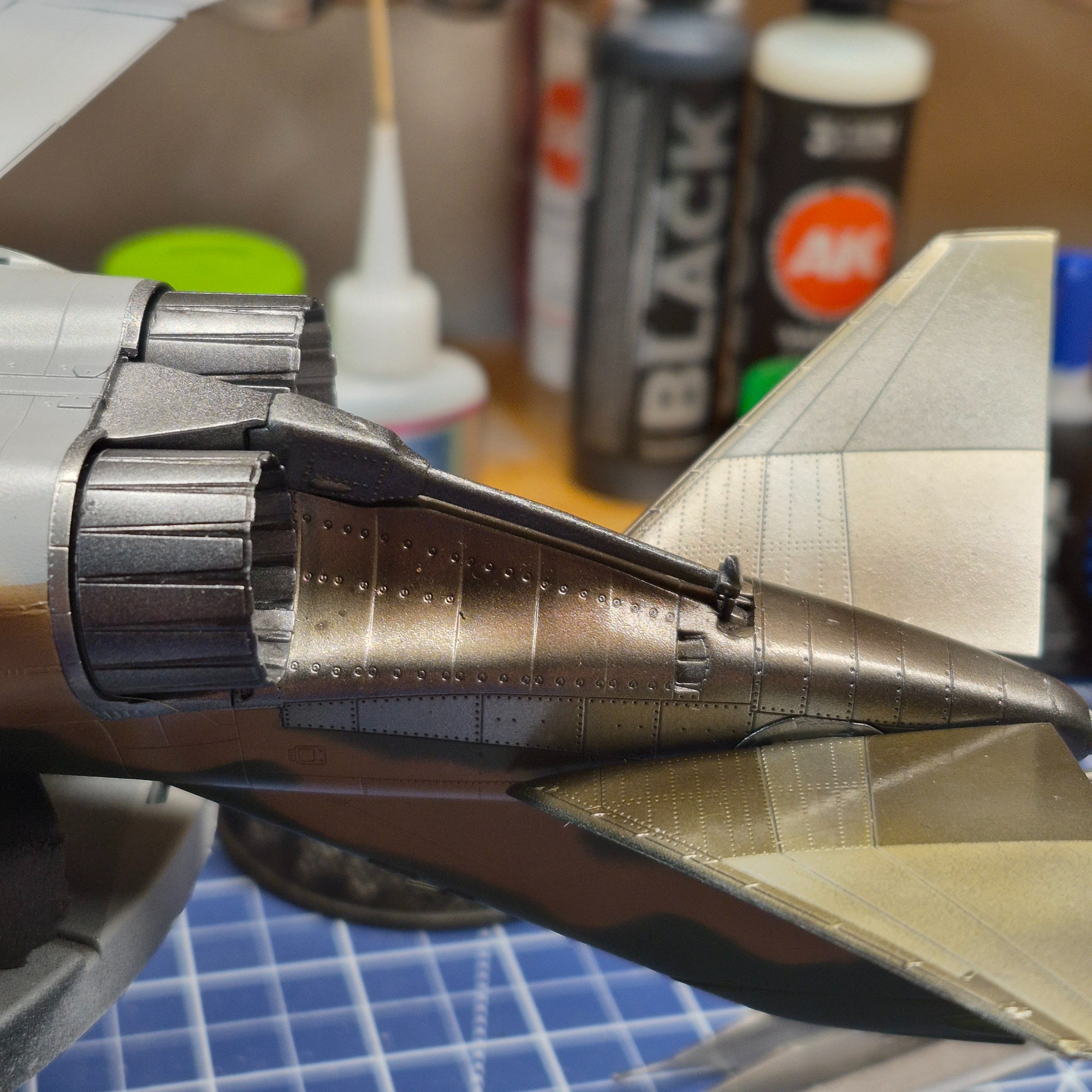

@Rockin' Rob — modeler, alchemist!all clad Steel followed by different stuff like dark aluminum and pale burnt metal and jet engine smoke.

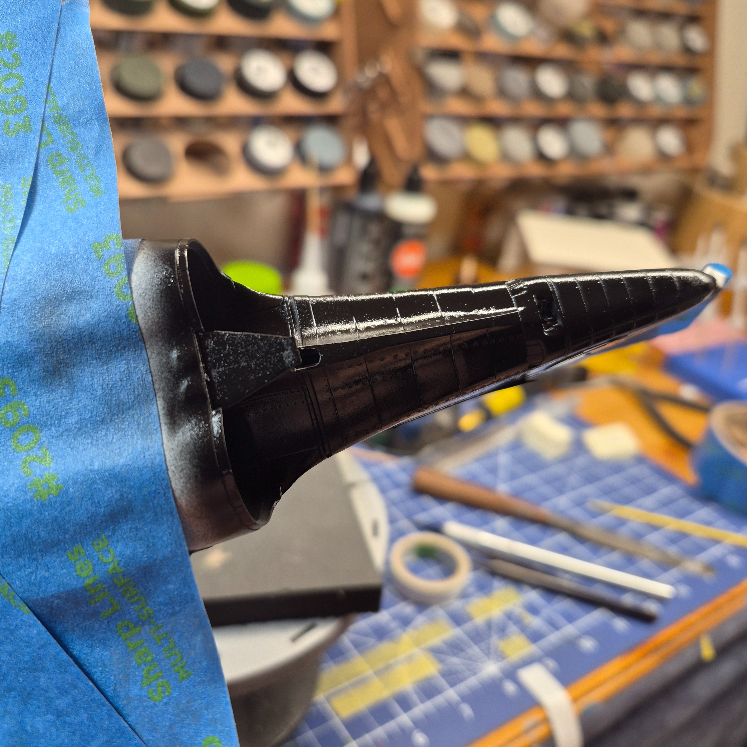

What does Alclad recommend for cleaning it?But that gloss black primer does not like playing fairly on the playground.
ThanksThat's looking good.
Probably their proprietary. But it's a lacquer thinner so I clean it with lacquer thinner. Lacquer thinner does clean it but it's like a little tiny portion of whatever they put in the glossy black primer congeals. Not all of it. It doesn't turn into a Gloppy mess like Snot. But it's like a tiny portion of it turns into snot or something like that that kind of smears on The metal. Weird. And only the glossy black primer does itWhat does Alclad recommend for cleaning it?

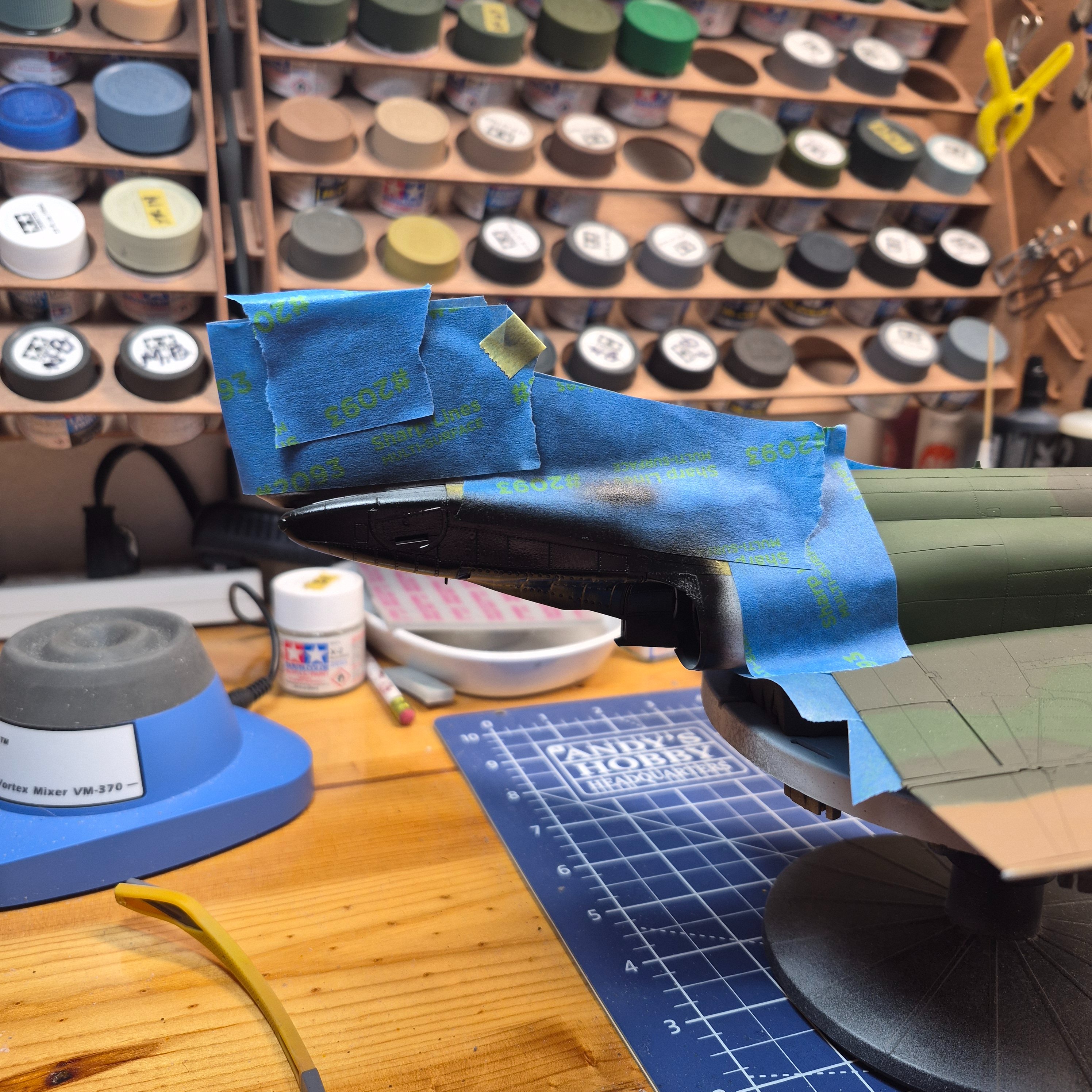

Thank you. It's fun messing with these metallic paints. I was just thinking is that too much before I even start weathering it? Or too little? Because I'll probably add more smoke down the roadMan that looks fantastic. I just started masking that section of my F-4 build. It won't be looking as great as yours though!
I think you've hit the sweet spot.Thank you. It's fun messing with these metallic paints. I was just thinking is that too much before I even start weathering it? Or too little? Because I'll probably add more smoke down the road
Great job! Did you use Xtreme Metal?I kind of stuck on the elevans and the tail hook. Just to see what it looks like. That isn't weathered yet that's all airbrush. Does it look okay?
I was saying a few months ago that the Alclad gloss black primer can take weeks to fully harden. That was my experience having thinned it slightly using Alclad thinner.And you got to let that gloss black dry at least a day or two
Thanks, I used Allclad ll.Great job! Did you use Xtreme Metal?

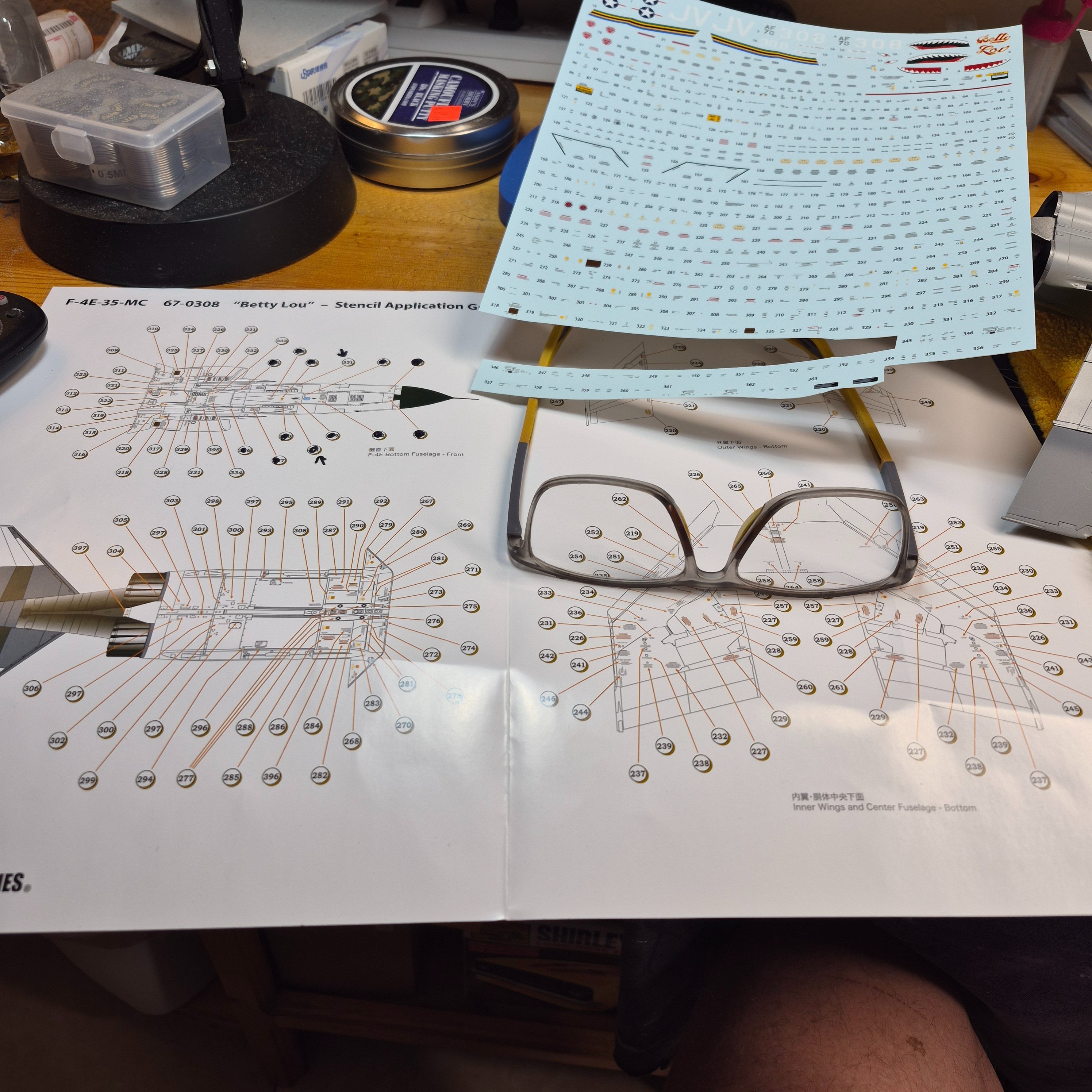

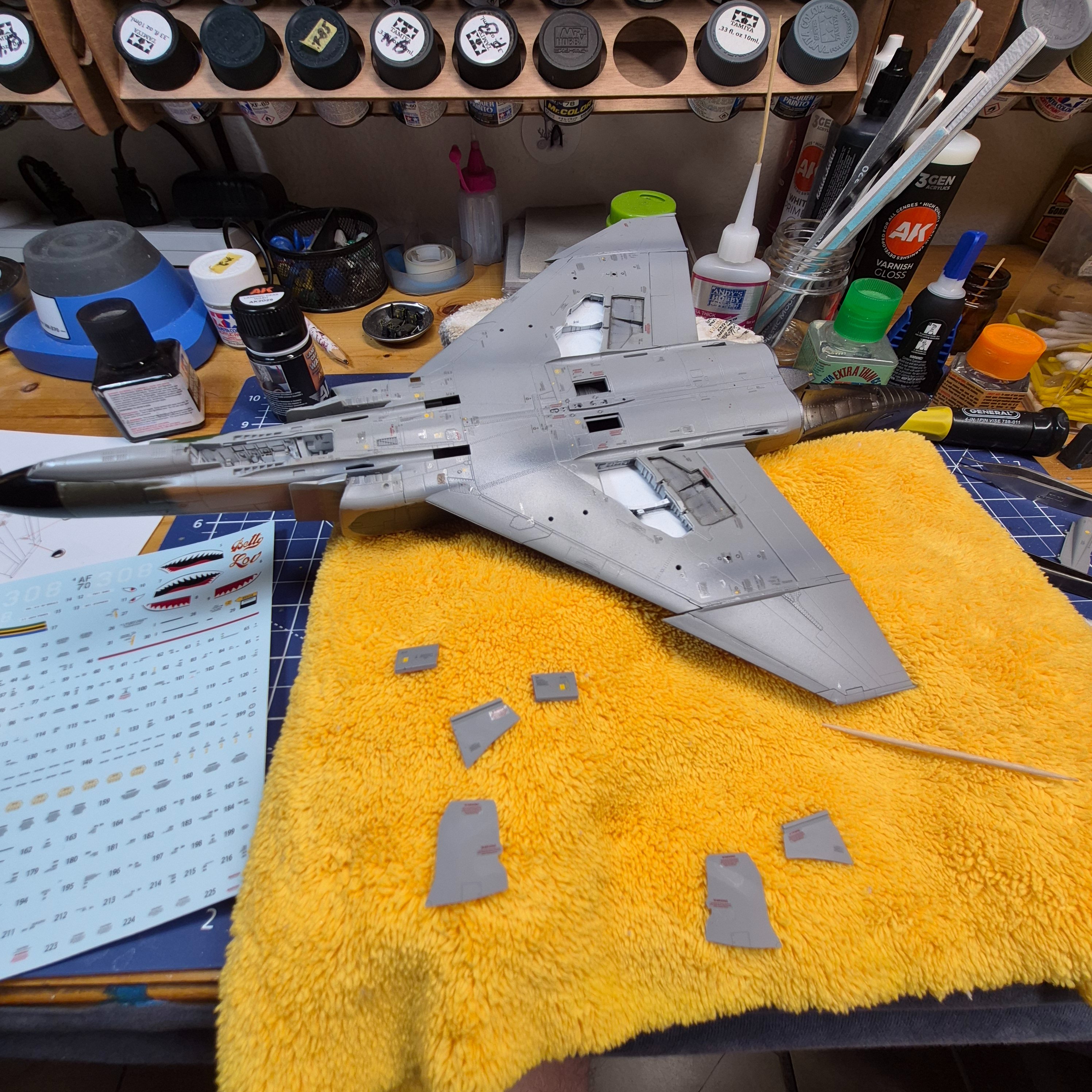

There are some other subjects that rival it, but I agree the Phantom is the worst!Aye yi yi Papi, 445 to go
You're hard core. I plan to put about 10 of the supplied 200 stencils on my F-4 build.Obviously there is a love hate relationship with the F4. Aye yi yi Papi, 445 to go
I didn't say ALL of them would make it onto the plane. I mean, I'm going to try, but towards the end frustration might set in and some of them might mysteriously disappearYou're hard core. I plan to put about 10 of the supplied 200 stencils on my F-4 build.![]()

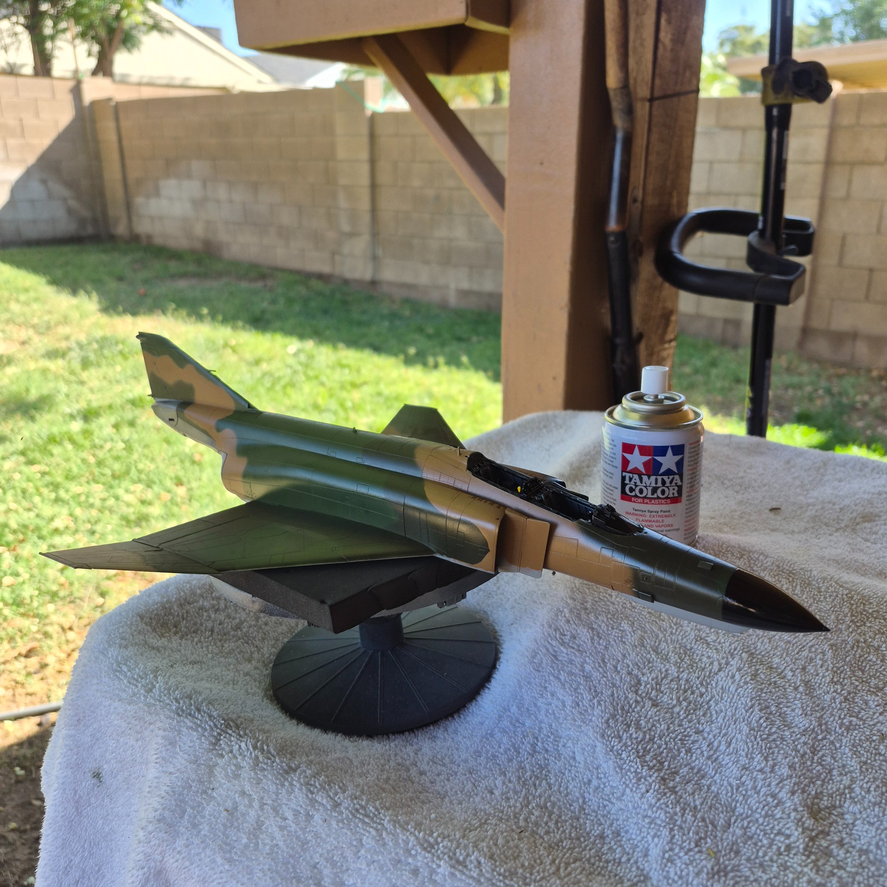

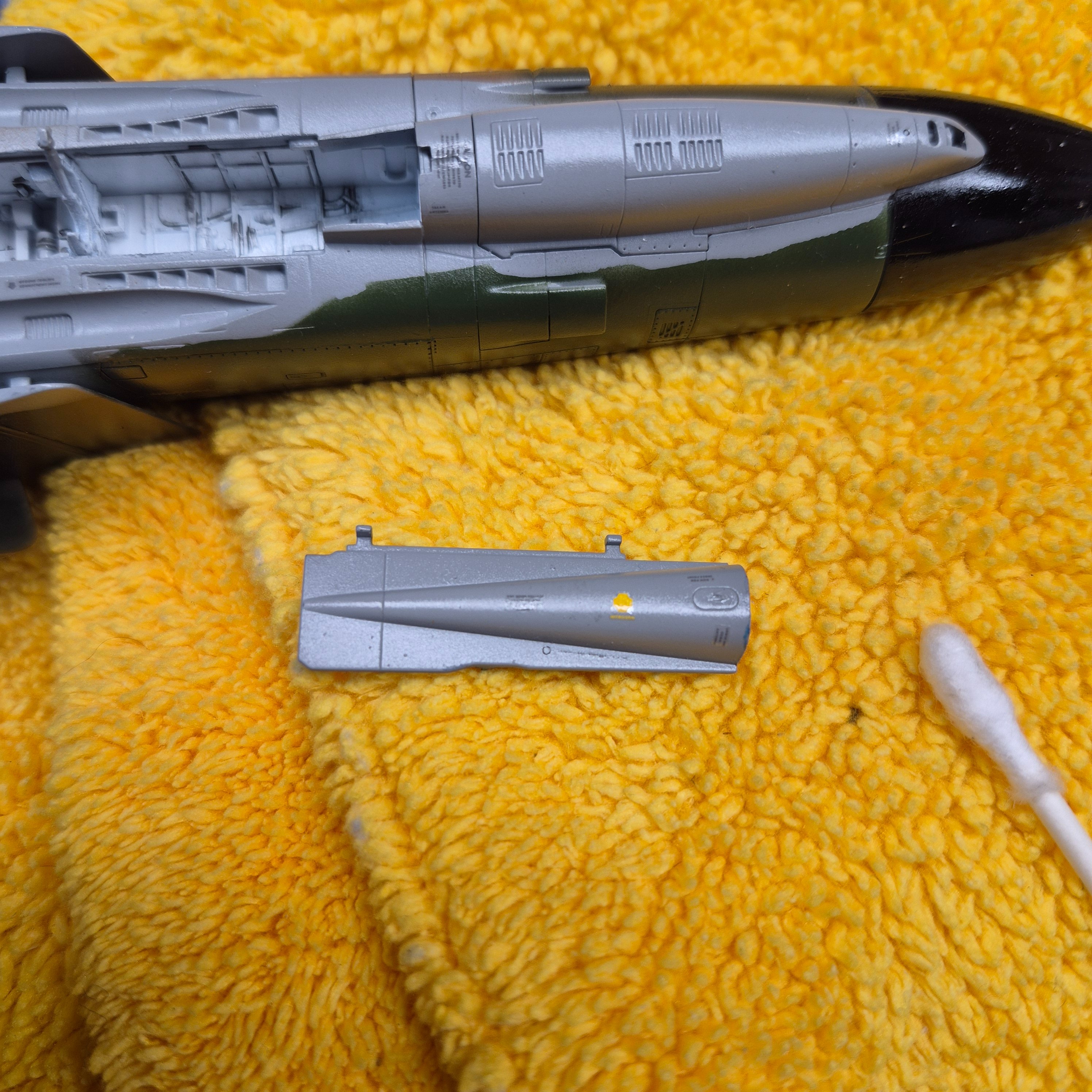

What gloss coat are you using under them? I use Quick Shine™ (the replacement for the old Future). Then I use the technique pioneered by Paul Boyer of putting the same thing over the decal, blotting the excess (paper towel leaves less lint), and letting it dry a few minutes. Once it turns clear it generally isn't possible to move the decal. Also, work on one end, then switch to the other end to give things a better chance to set before you have to handle them again.Taking my time. I can only work on it about an hour and then I just got to go do something else. I can see why some people don't put them on. It can get frustrating. You get the tiny decal on just right and you roll the Q-tip on it and it comes out perfect! Woohoo.! And then 3 minutes go by as you put on another decal and you go look at the one you just put on and it's crooked. Ah man. What the hell? Then frustration sets in and you have to take a break. 225 to go on the plane alone. I haven't even done the missiles. Union break is over
I generally use Tamia ts-13 out of a can. Gloss clear. So I gloss over the paint job then I add decals one whole side at a time. I'm almost done with the bottom wing tips probably about 20 more details to put on and then I'll wait a little bit and gloss clear with ts-13 again. A nice good coat so I can basically use anything I want to paint stuff up or weather or panel line. After I get all that done then I give it a spray of either semi-gloss or flat clear. All my paints are basically lacquer based so I really don't know about using something like future.What gloss coat are you using under them? I use Quick Shine™ (the replacement for the old Future). Then I use the technique pioneered by Paul Boyer of putting the same thing over the decal, blotting the excess (paper towel leaves less lint), and letting it dry a few minutes. Once it turns clear it generally isn't possible to move the decal. Also, work on one end, then switch to the other end to give things a better chance to set before you have to handle them again.
Should be okay, as Quick Shine is alcohol soluble, but appears impervious once dry. If you want to try it, check for compatibility with a paint hulk.All my paints are basically lacquer based
