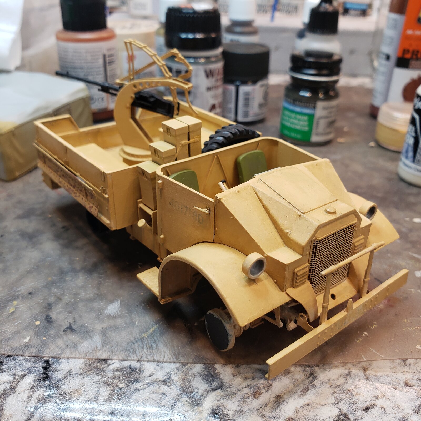

Wheel wells inside and in the cab, treadplate and brakes for frames over the box. Also some hinges, but I figured out my own improvement earlier.
Before priming, I'll use some burnishing liquid on the sand channels
The channels are off for a base coat. I've tried lightly sanding before, this is quick, and works well on larger surfaces.

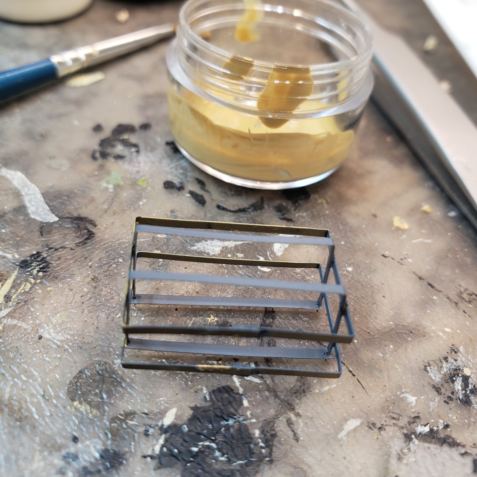

One of the issues I have with PE, on top of bending and gluing, is painting.
For example, on the grid protecting the exhaust, I brushed some primer and then painted, however, when manipulating it, even with caution, paint goes off. Obviously will do some touch up, but how to prevent this..??
I have only used it once but to good effect: Mr.Hobby B504 Metal Primer Spray (100ml) Modeling
It actually dries with a sticky finish.
Regardless I would do all the bending necessary before priming and painting.
A very light sanding (like 1000grit) to give a bit of tooth for the primer, or paint to adhere. PE often seems to have film to prevent discoloration...
I try to touch as little as possible with fingers as that leaves grease that repels paint.
