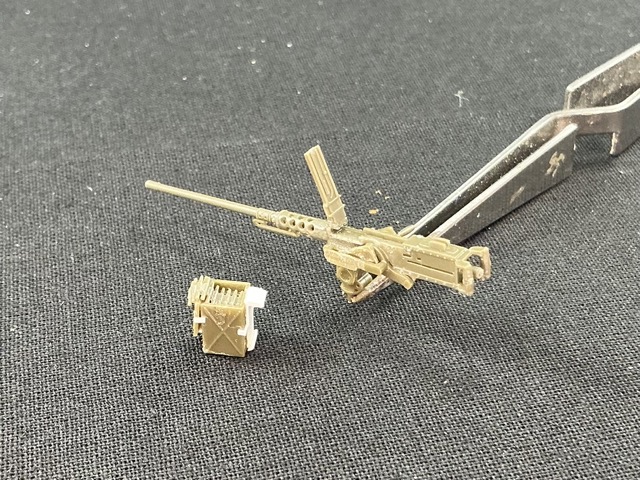

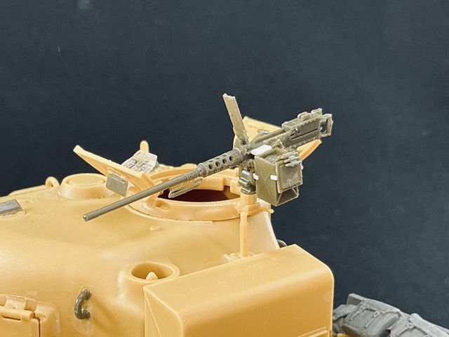

Anyway, on with Churchill :) The sprue with the .50-calibre machine gun was also missing in my kit … I almost feel cheated, if I'm honest, but I've got something like five of those sprues lying around so it's not as if I can't put a machine gun on this tank :) On the real Churchill, there was a cover over the machine gun when it came ashore, but I don't want to build it as it was at that particular time, so I'll add the machine gun as ready for use. And because the top cover is a separate part, I thought it'll be nice to show it open for once:
I added some details to the ammo box, as well as a correct holder for it, which it clipped into to fix it to the mounting. That is to say: all the white stuff on the right side of the ammo box is actually part of the mounting, but was easier to build onto the box, while I filed off the holder for the later (larger) type of ammo box from the mounting. All these details come from a thread on the Maple Leaf Up forum.
Annoyingly, I broke the spade grips in half when I was cleaning it up, and glueing it back on was not easy. And then it broke off again the next day when I was filing the ammo box holder off the mounting :(
On the tank (but still loose):

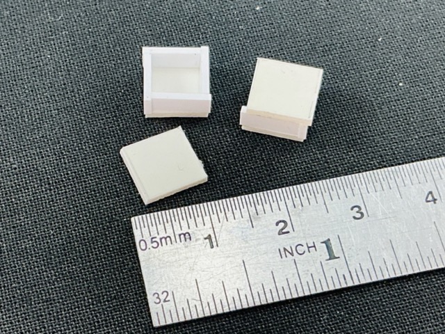

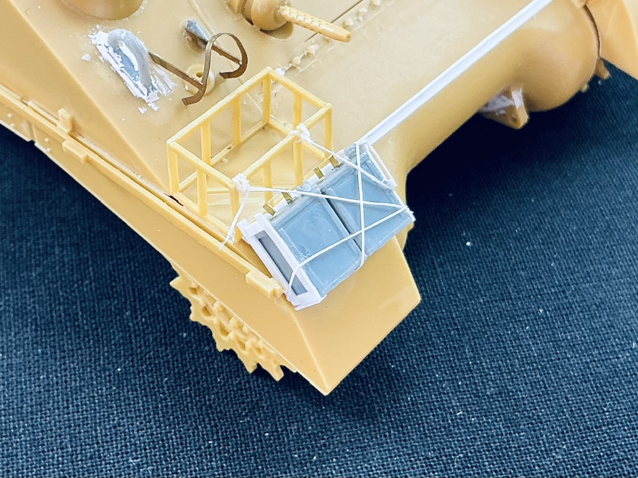

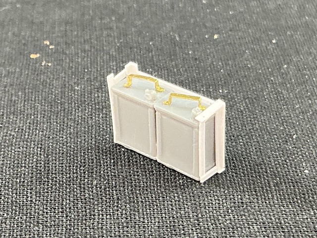

Now the cans to go on the front. On the glacis, next to the spare track links, are four-gallon water cans — which I didn't know even existed until someone told me that's what the things in the photos of the real tank are. I made them from plastic card and strip after he supplied measurements from 3D-printed ones he has:
It's four squares of 1 mm plastic card, 8.5 mm on a side, and eight pieces of 1.0 × 3.2 mm strip. As a modeller, you don't need to be a joiner: by glueing those pieces of strip as in the photo, you can avoid having to make neatly bevelled corners :) Once the glue is properly dry, it's just a matter of cutting off the protruding bits and then filing everything flat, possibly applying a little putty as well. Then I'll still need to round all of the corners for the shape of the can.
On the right mudguard was an odd rack hold two, two-gallon POL cans (Petrol, Oil, Lubricants). That rack looks like it was cut from another one, which happened to hold two cans nicely. The front/top is open, as if this is really only half of a larger rack. I made it by first making two Bronco cans and glueing them together, then adding the rack from plastic strip around them:
Those Bronco cans are very good for this, because the bottom is also replicated faithfully, with corrugations rather than flat like most of these cans in plastic or resin. After taking the photo, I did discover that I had missed a small piece of strip that should stick out from the one that's frontmost in the picture.

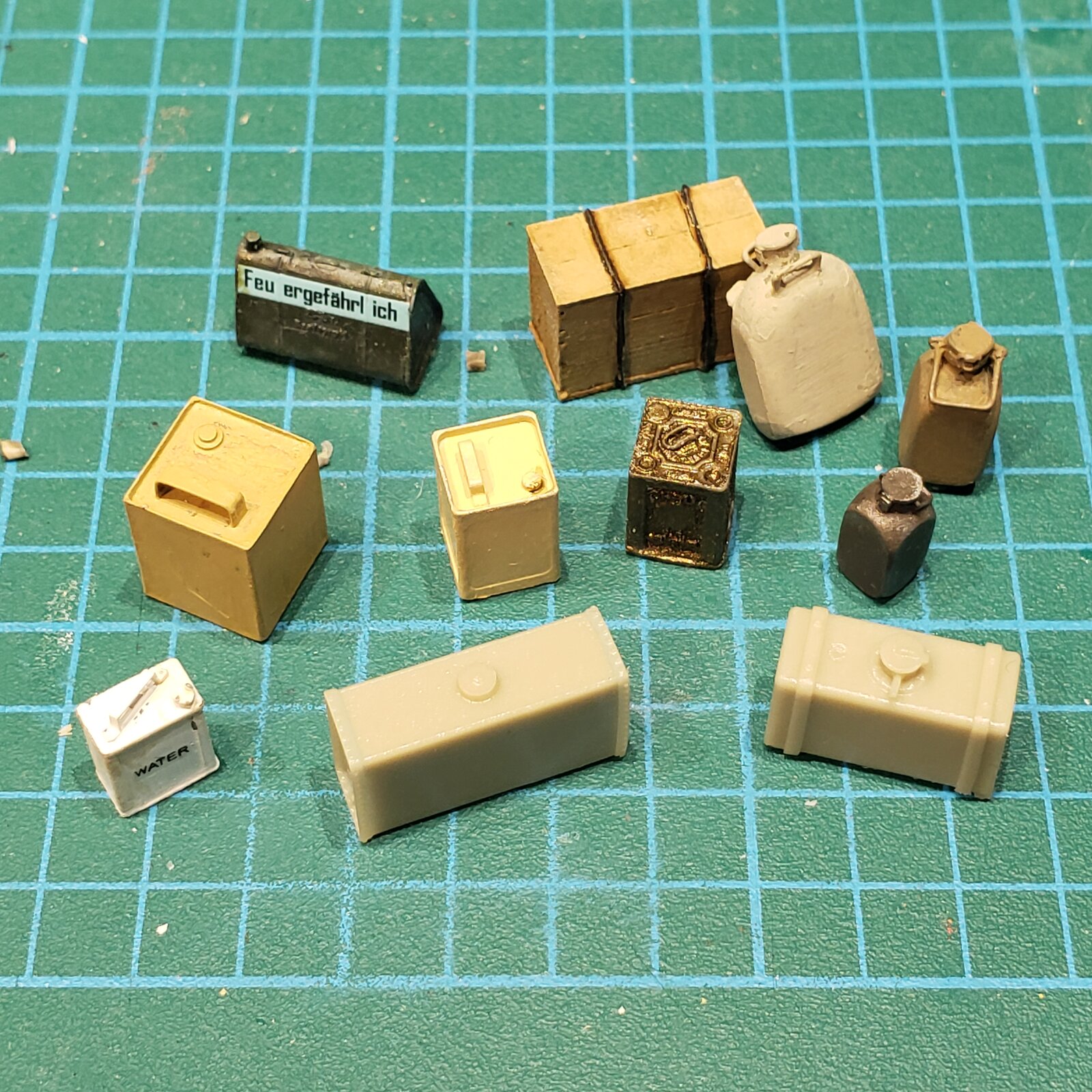

Nice, if you moved down the street, I could give you some! Working on North Africa vehicles, I quickly got familiarized with assorted flimsies, ealy German water flasks and assorted fuel/oil cans, and the British ww1 and ww2 camel cans...
Thanks for the offer, but it's a bit far to travel :) Also, none of the cans in your photo is a British four-gallon water can …

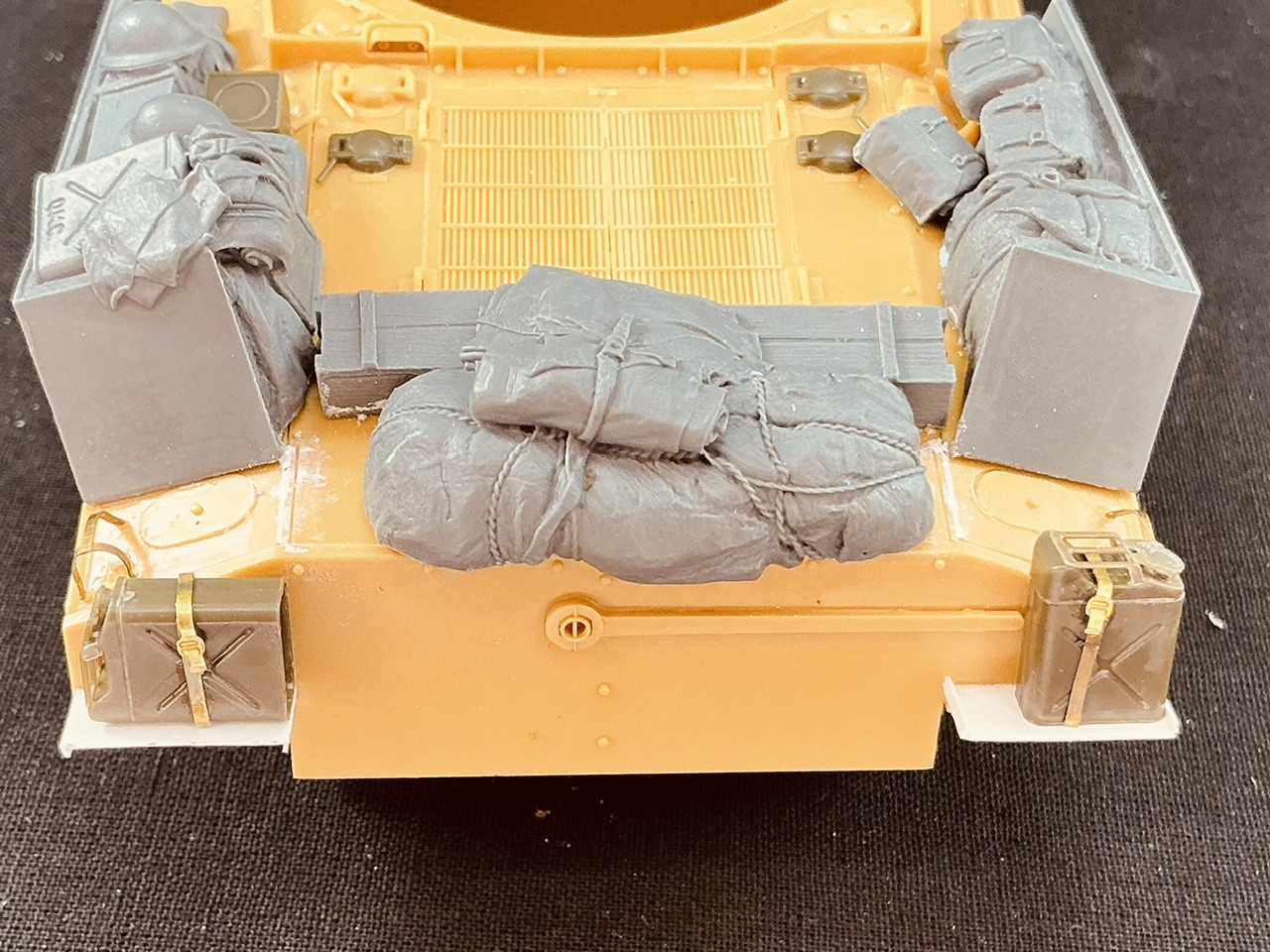

On the back, I added straps to the jerrycans:
These are from an ancient Accurate Armour set of American jerrycan holders.

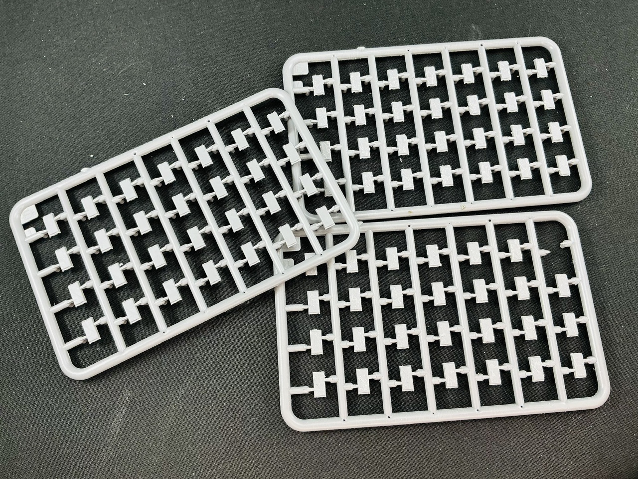

Using a motor tool, I distressed two sprues worth of track blocks:
First, I went over them with one of those ceramic sanding drum type bits, then with two different routing bits. The important thing is not to make the effect this too regular, so for instance, don't be tempted to add more texture only in places where there isn't any yet. Once I was done, I scrubbed all the loose material off with a fine steel-wire brush, and then I could cut them out and put them in a storage box.
I don't think I'll need to do more than two sprues. I counted how many outer blocks will be visible on another model, and got to under thirty per side. Since there are 28 block halves in a sprue, two should be enough. However, one is missing because I slipped and cut through the hole for the end connector, so I took that block out of the sprue immediately to avoid coming across it later when I'm building the tracks.
