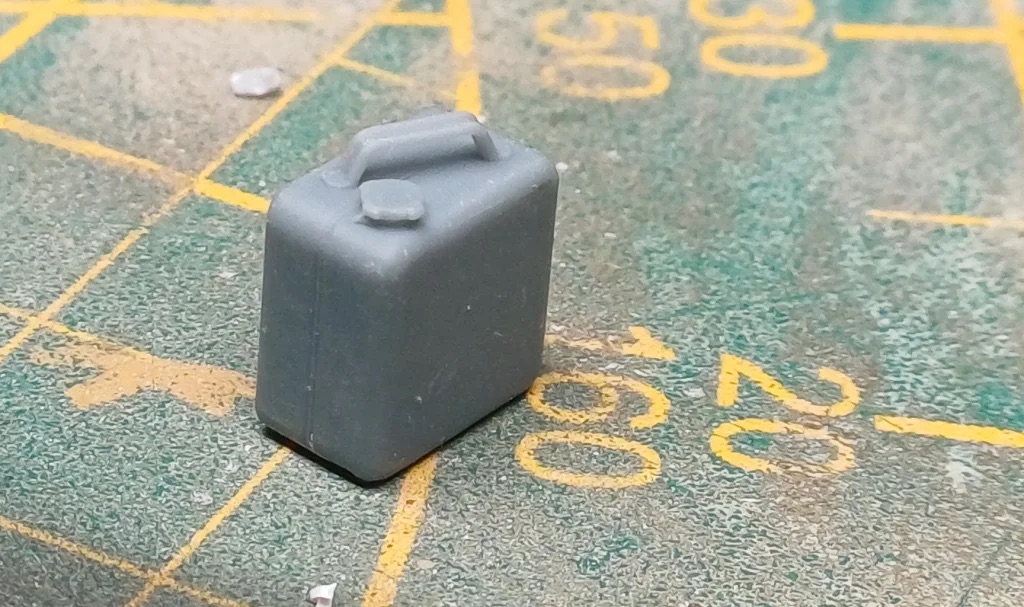

Those are only for fuel, AFAIK. They're easy to find by a wide range of manufacturers, in both resin and plastic, but the cans I need are these:
(With thanks to Jan van Harn for the photo :) )
This Sherman III (slightly later than Churchill, as it doesn't have direct vision flaps) has a six or eight of them on the hull front:
Though I'm starting to doubt they were four-gallon cans now, as they seem to be quite a bit smaller than the jerrycan. That held 20 litres, and 4 Imperial gallons is 18 litres. Anyway, it doesn't really matter, as long as I make something that looks convincing for my model :)

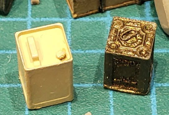

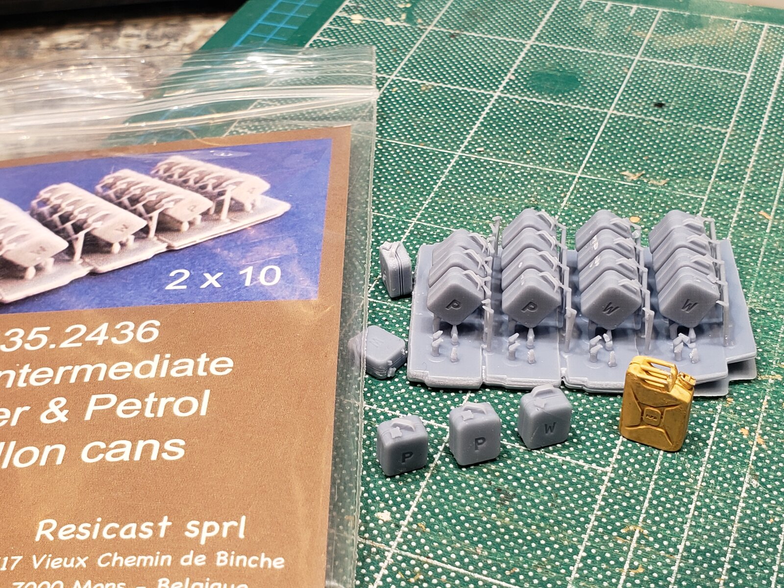

...well, if that's the case, then Resicast has 2 gallon cans that look a lot like your examples...
Only, their Intermediate (also called 'simplified') water cans have straight handles, and their petrol cans have angled handles.
Included a British gerrycan for reference.
Seems their resin handles are pretty delicate...
The rounded edges seem to match your photos.

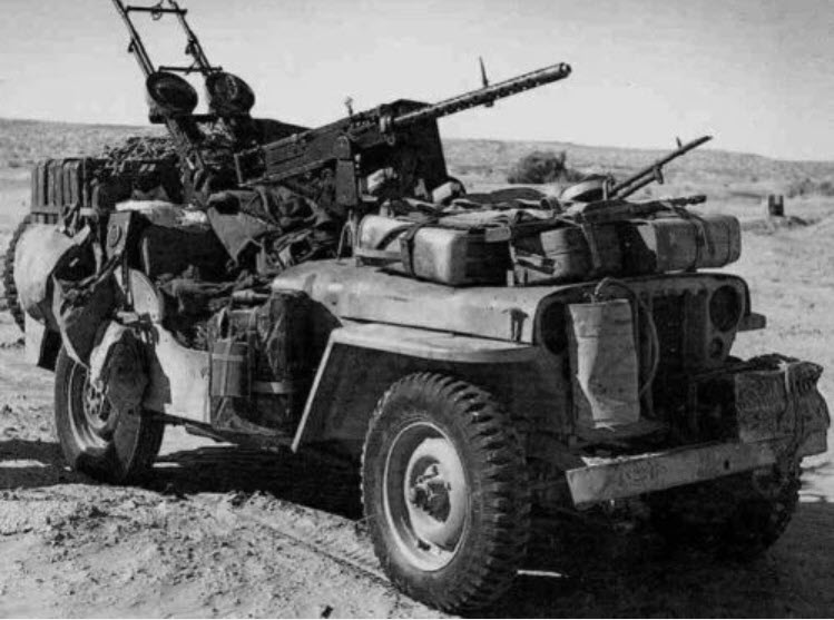

Also found one on a SAS jeep in NA... can see the diff in size with regular gerrycan:
(thanks for the discussion, I hadn't noticed until now!)
I suspect now that the can in the photo I posted, is from that Resicast set, then. Too much trouble and expense to go and order, though, for something with a shape as simple as this :)

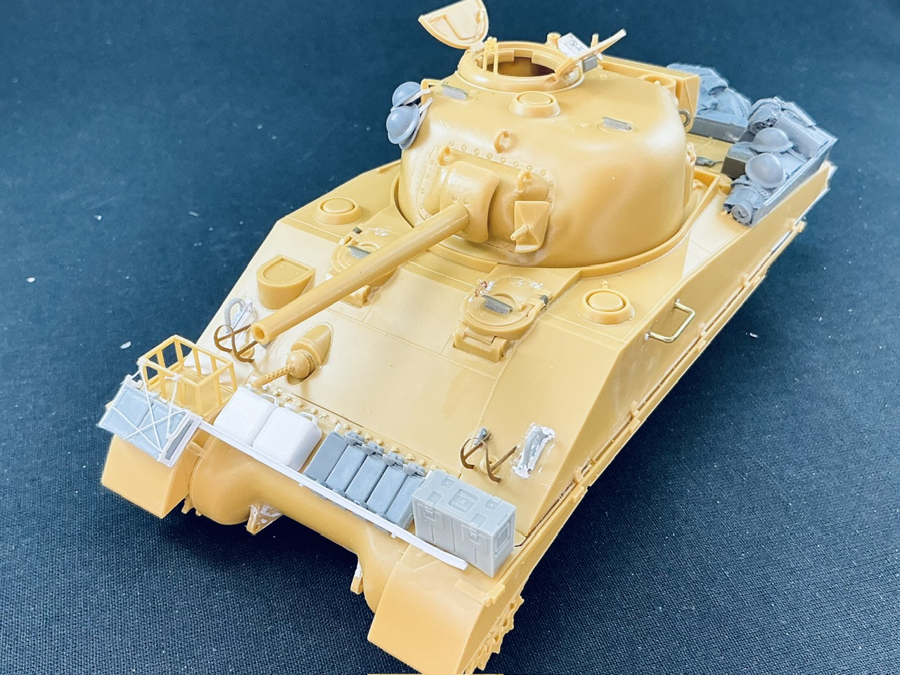

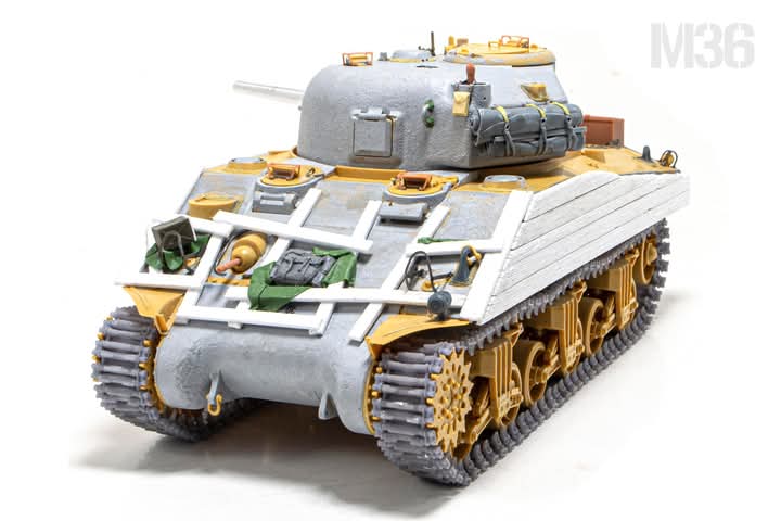

With the water cans made, I also added the bracket (whatever that may be for) on the side of the hull and hung three helmets on the turret. Oh, and I finally added the handles to the drivers' hatches:
The cans and track aren't glued on yet, I'll only do that after painting. The photos of the real tank also show something on top of the ammo box, but I can't figure out what that was. I want to say it's a saw, but that seems rather unlikely.
There are plenty of reasons for a tank to carry a saw, but why would you stow it like that? Which is why I think it isn't one, but I can't (yet?) work out what it is.

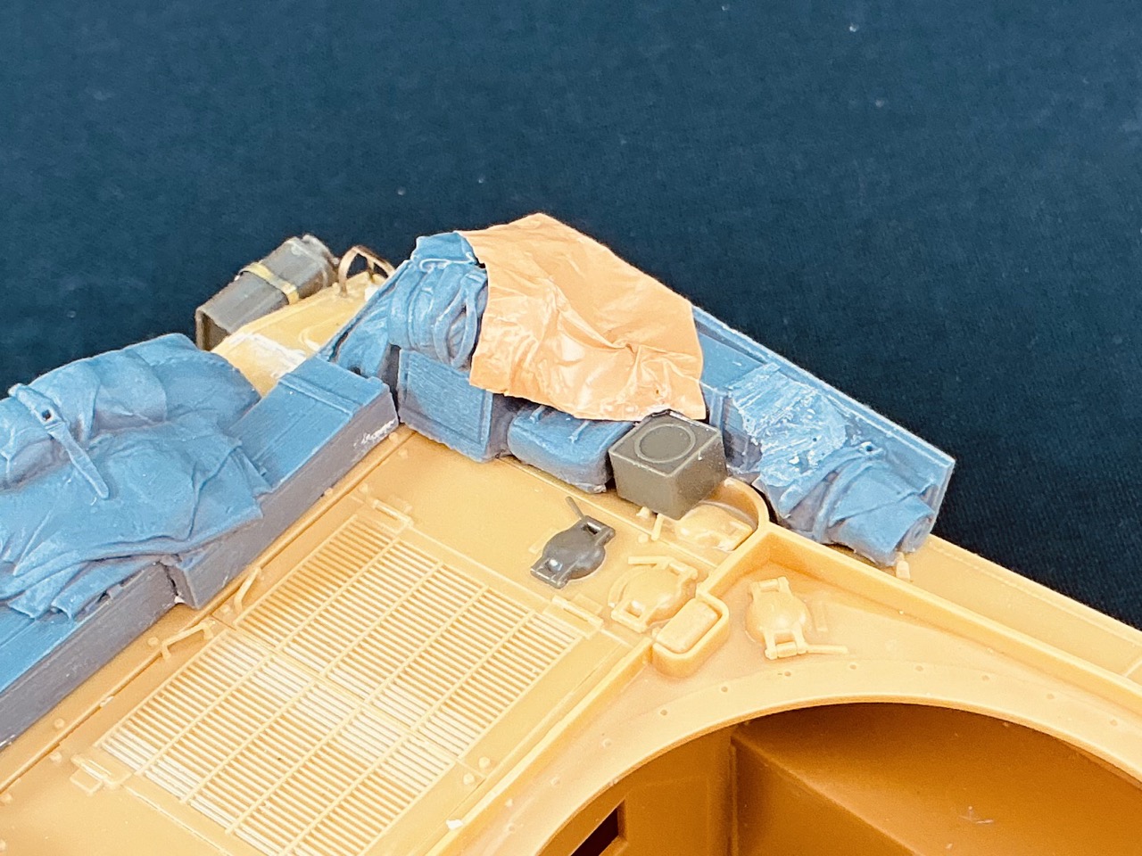

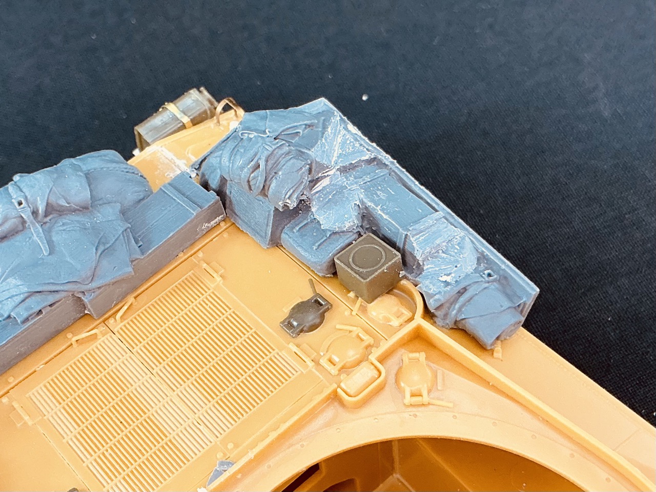

For a while now I had been unhappy with the left rear stowage rack. It held two helmets and a jerrycan. Who puts helmets and a jerrycan into a stowage rack? My modelling saw made short work of them:
When I took this photo, I had already carved what remained of the front helmet into something that can pass for folded cloth or similar, but the rest is harder to transform into more plausible items, and also to remove completely to allow other items to be glued in their place. But this afternoon I got an idea when I was eating a biscuit-chocolate-bar-thing:
These Aldi bars are in a wrapper of aluminium foil that's clearly thicker than the kitchen kind, so:

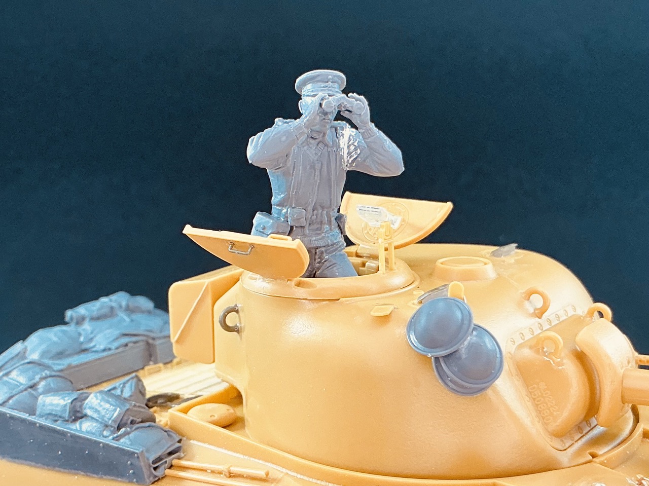

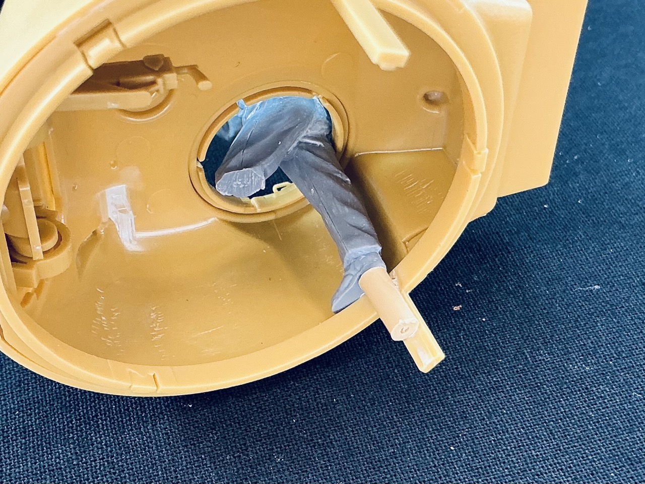

Also, I built a commander to go in the turret:
He's from the MiniArt set of British armoured car crew, and picked because the real Churchill's commander was also wearing an officer's cap :) He has a pin in his foot, that goes into a piece of drilled-out sprue glued to the support for the seat:
As you can see, I did have to amputate one of his legs before he fit. Because he stands with his feet apart, they wouldn't fit through the hatch, and as he also has his arms wide, he couldn't go through from underneath either.

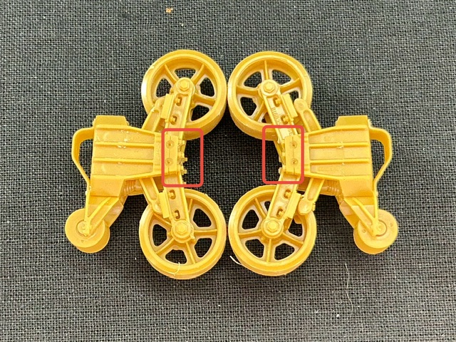

"Can't you ever do something right the first time?" If I looked more closely at photos, perhaps … I noticed that Churchill had bogies with "short" bolts on the underside, which is normal for relatively early ones, so I cut them down on the kit parts. Before on the left, after on the right:

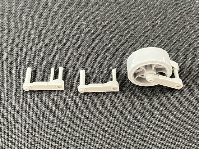

And then I noticed something else: Churchill also had early roadwheel arms, without holes in them for the bolts that hold the rubbing plates on top of the arms — on M3 mediums and early Shermans, those were attached by screws through the top rather than with bolts from underneath, as they were later on, OK, so how to solve that? One option is to cut away the bolts and putty the holes closed, but is a lot of work because it's all in a hard to reach spot.

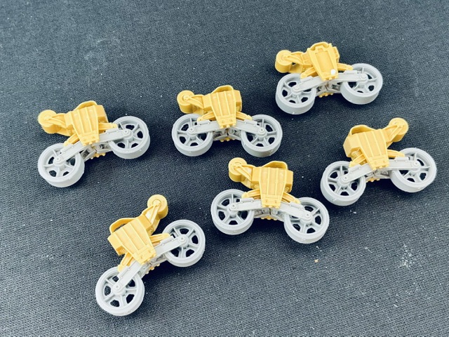

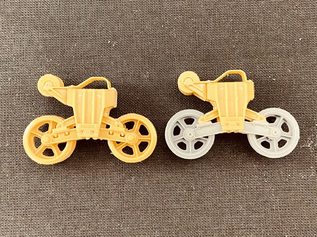

I then recalled that I have a full set of bogies from a Takom M3 mediums, which someone gave me because the whole undercarriage of the Vargas M2A1 medium resembles nothing from reality. And because the M2A1's wheels were narrower than those of the M3, I won't need the wheel arms for that once I get round to building it. And what do you know? The Takom arms fit the Asuka bogies, although you need to shorten the axle pins slightly because the holes for them are slightly less deep in the Takom parts.
On the left a Takom wheel arm, in the middle one with the central rod cut away, because Churchill didn't have those: if it had, there would have been a bolt head visible on the outside, and those aren't in the photos of Churchill except on the spare wheel — compare them to see what I mean. On the right, both sides of the wheel arm with a wheel glued between them. The wheel is from MiniArt because it's better than the Takom ones:

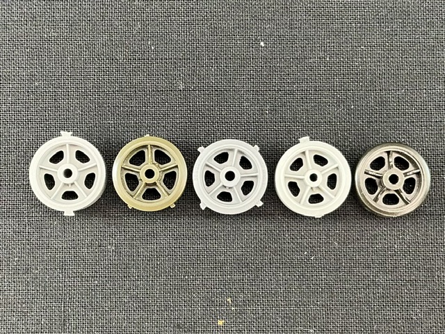

Left to right Takom, Asuka, Miniart, Dragon and Italeri. The holes in the Takom wheels are clearly too small, if you ask me, and the sides of the tyre are vertical instead of sloping inward slightly. Vertical sides are correct for early wheels, but I don't think Churchill had those.
Before and after:
Happily, I only glue the wheel arms into place on Shermans once the bogies are on the tank :) The only snag is that I couldn't keep the wheels as revolving here, because MiniArt's are a fraction wider than Takom's, because of which the inner arm didn't quite reach the axle. Only by glueing the three parts together do they stay in position as they should.
All together now:
And in the spirit of "Also show your mistakes": the bogie at top right. I had cut the axle down too far by accident, allowing the wheel arm to just slip out. By drilling a hole in the bogie and enlarging that in the bogie, I could just a bit of plastic rod in as a replacement axle. I do still need to cut it down because the bogie doesn't fit against the hull like this.
