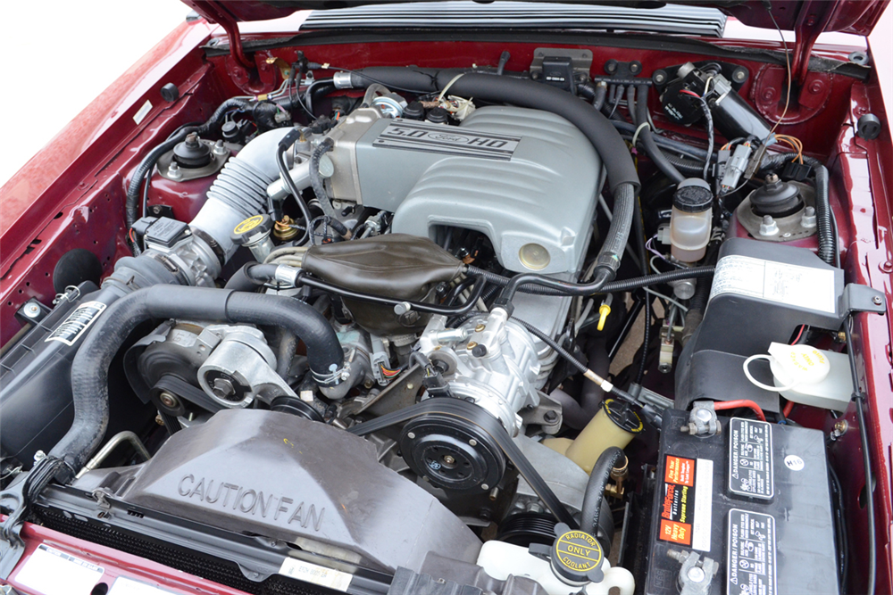

Ok so I was looking closer and noticed the engine in the pics is carbed…. Dude swapped out the 5.0, this isn't the stock 5.0 engine…. I was focused on the wiring and not the engine its self.

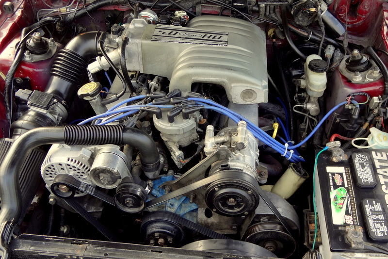

The ignition coils in these cars were located on the drivers side shock tower on the front as in this photo here bub.
The distributors usually had a rubberized cover over the cap and upper body of them and the coils had a hard plastic cover over them usually. I made sure that I retained both of these items on mine for appearance purposes.

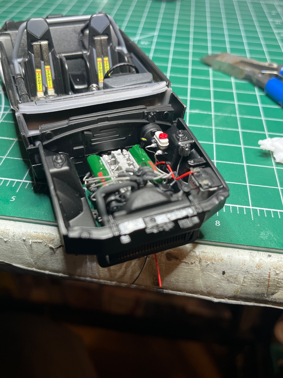

Thanks for the pictures, a rubber cover over the distributor would have been so much easier than sanding, drilling, making 90° boots and wires lol. I got a good idea now of some basic wiring I want to do. But as per usual what's in my head and what happens are two totally different things….

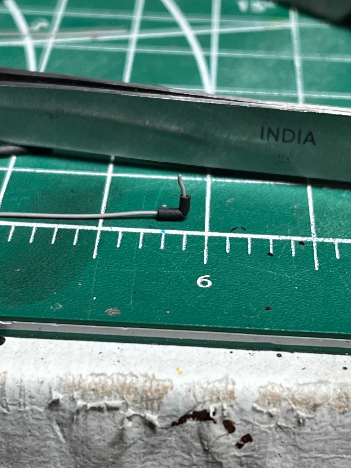

How did you make the 90 deg boots? I thought of doing that and was like nah.
First time doing it, but just cut a wedge out of the boot, ran the wire through and bent it over. Pretty easy actually, if you look close you can see where I cut the 45° out of the side of the boot. Mcv products 3d prints 90° boots as well but I've never used them so I have no idea how they are.

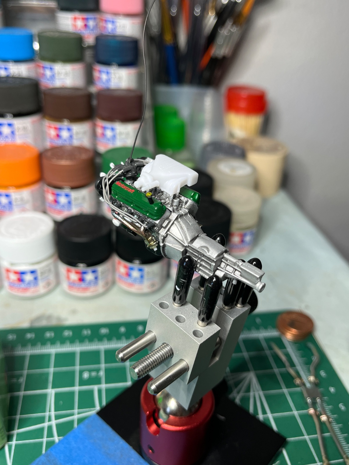

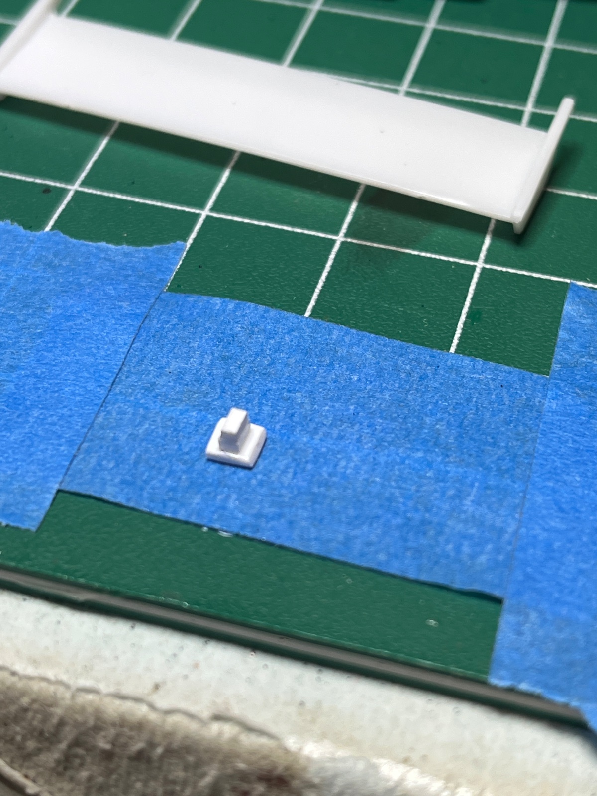

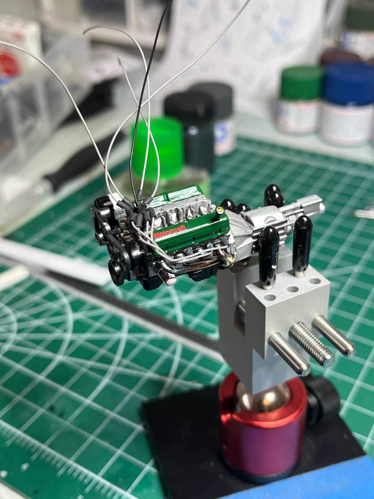

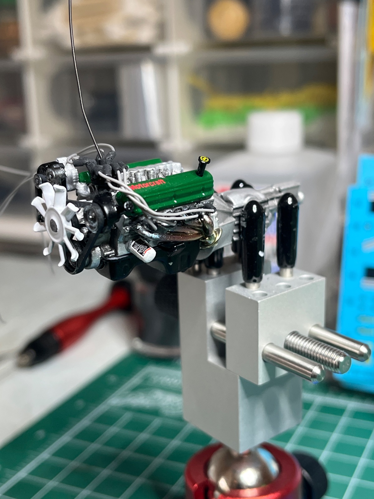

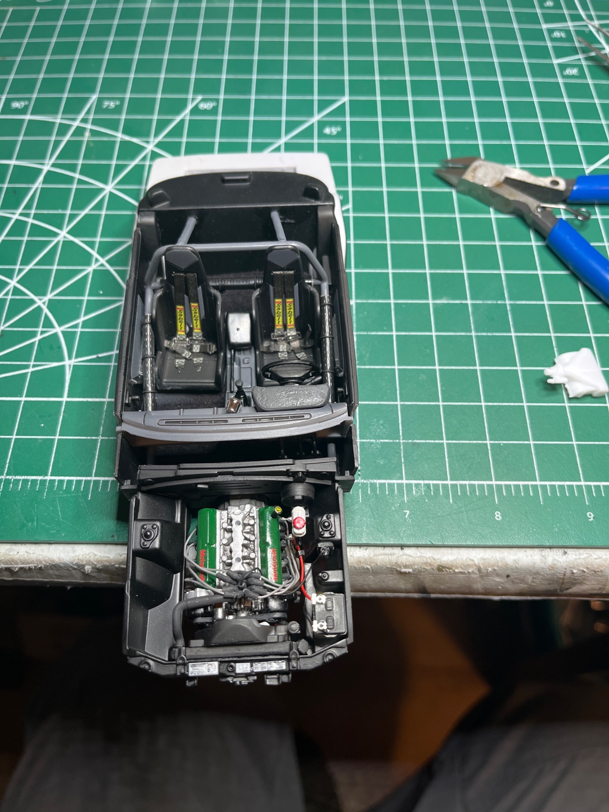

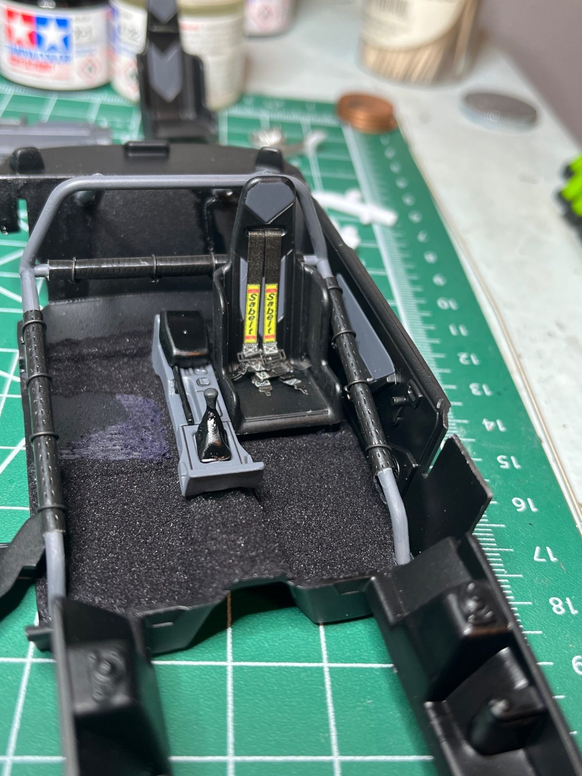

Had the day off so took care of some things around the house and sat down for a bit. Got the drivers side plug wires in place, although I broke two bits drilling the holes ( that's a first for me) and the loom I was making didn't turn out how I wanted so I scrapped it, finished the 4 point harness on the drivers seat and put that into place with the inner door, touched up some paint here and there and decided to make a ignition coil, once the glue dries all trim and sand the coil and drill it, hopefully not breaking another bit. I will say the bits I have are relatively new and were a "upgrade" but I'm not a fan, I ordered a set of my old ones that I had never broke. Anyone else use these DSPIAE bits?
Engine looking great!
Small bits are fragile, I notice .3mm and below especially prone to breaking.
I'll give the first one, probably wasn't paying attention, second one was looking like just a bad product, then one rolled off the bench I picked it up off the floor and it broke as well. No body has time for these issues…..:p

Nope high speed steel only, most anything we are drilling dosnt need anything tougher. Tungsten will stay sharp a long time because it is very hard, but that kind of hard equals brittle. Save the cash for parts and use the HSS drills, and dont bother with the coated ones its no help in this kind of material.
Its why I'm thinking of the mini drill presses..trying to hold a tiny drill bit without excerting any lateral stress is almost impossible..
Plus its just another cool tool to add to collection.
Can't have too many tools...
Good info, the rest of them got trashed and yesterday morning I picked up hss bits.
Home depo and lowes make good cheep 12 inch drill press, i have an enco 12 inch bench top that is about 2 ft tall. The really small ones for hobby use and claim to be precision are crap dont waste the money. Spend a few more bucks on the bench top unit you will get more than hobby use out of it.
I have a bench top one..have to measure the run out on it..a slight wobble with a .3mm bit..would be bad.
Checked out the real nice small ones jewelers use..too expensive..

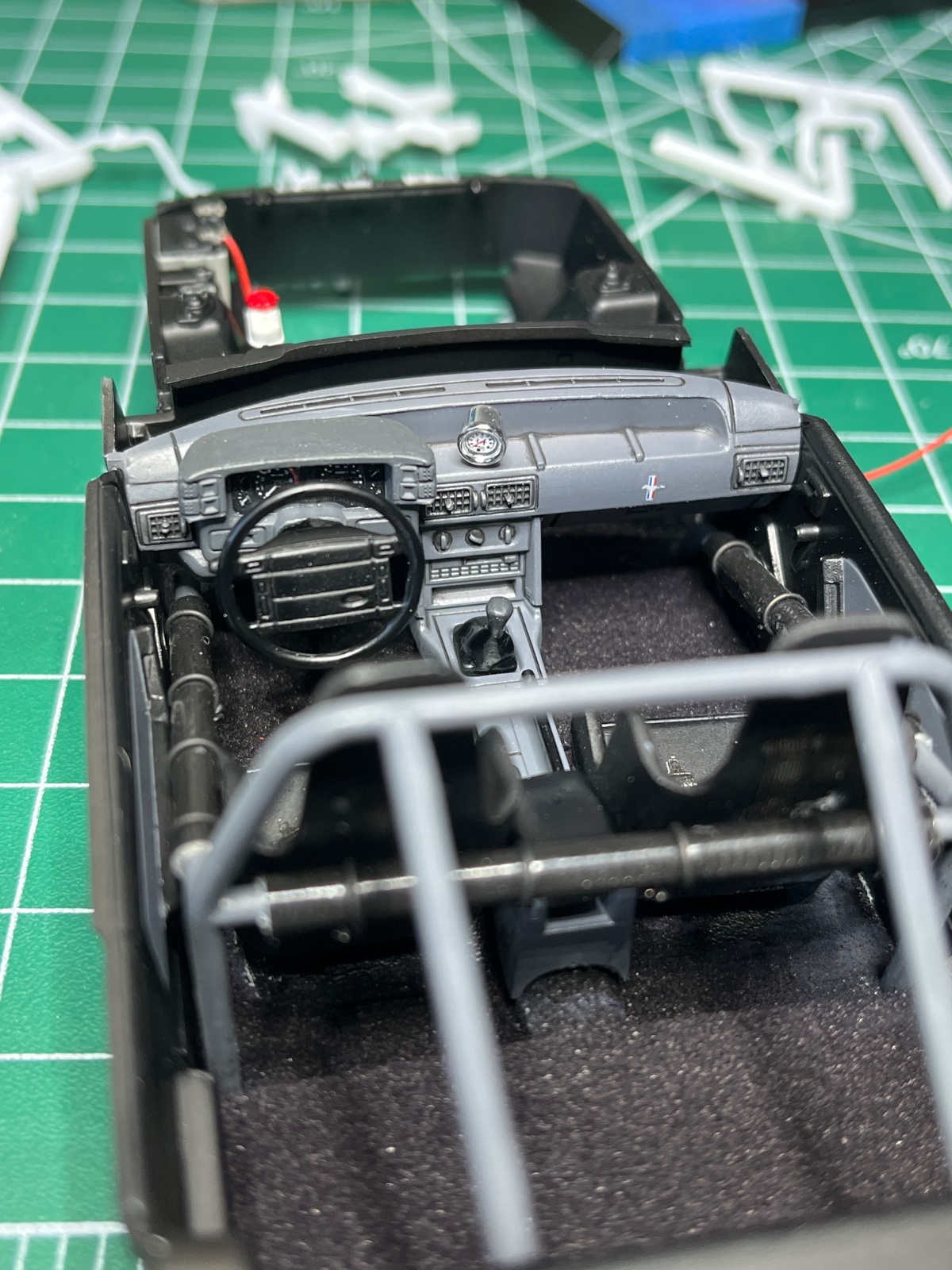

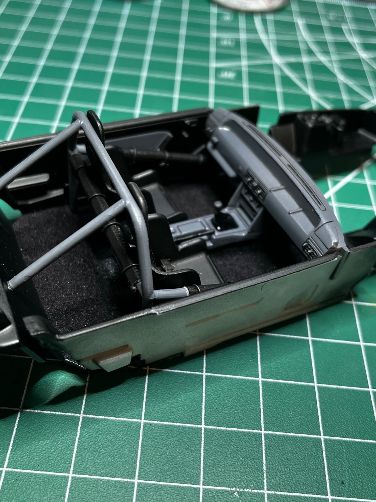

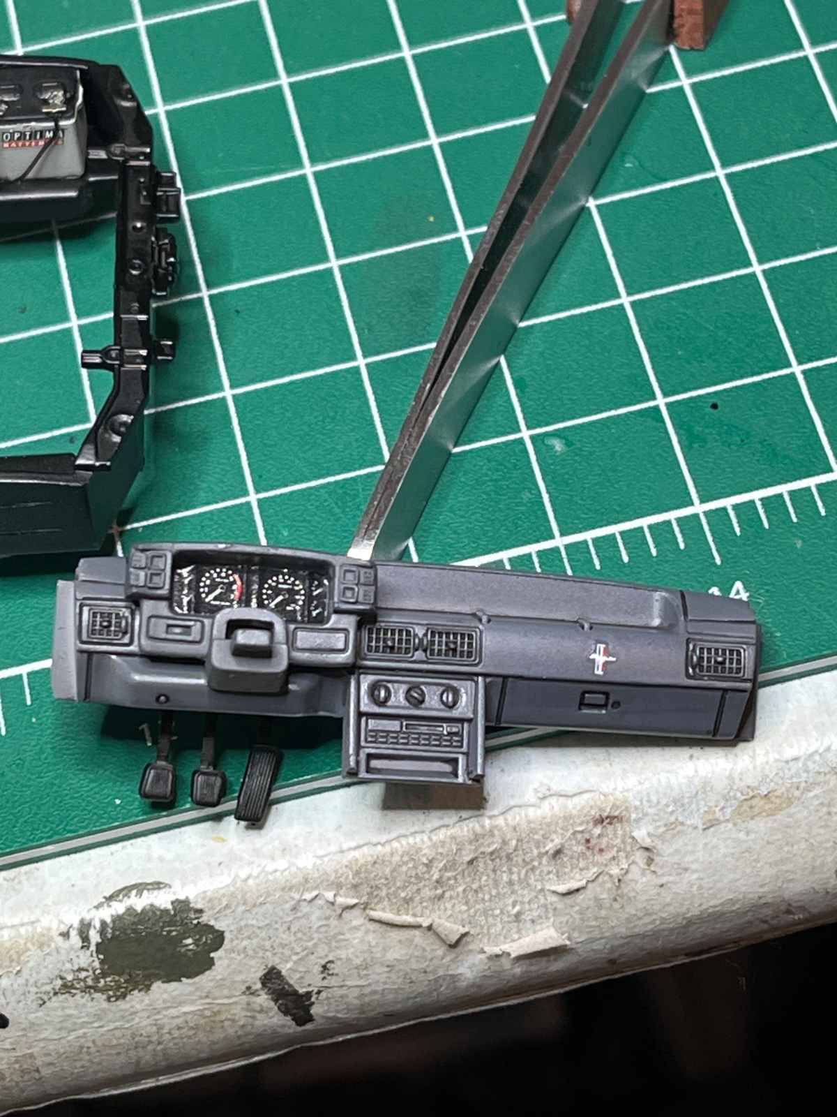

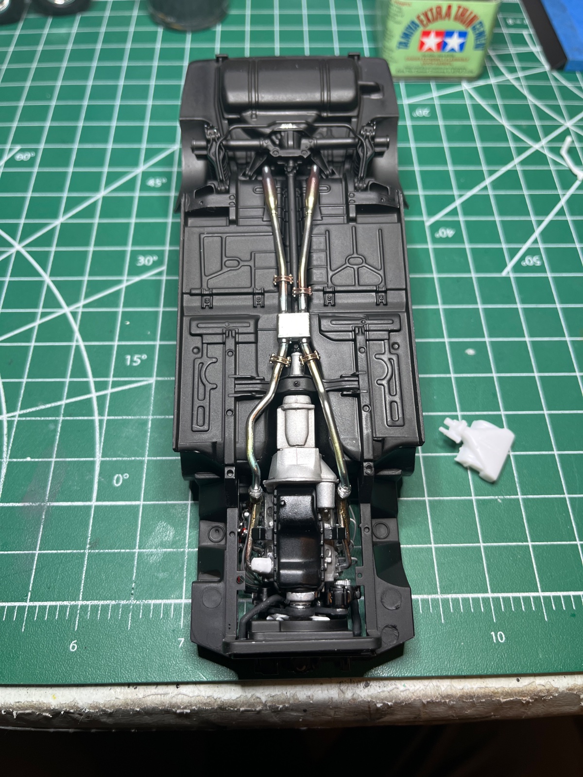

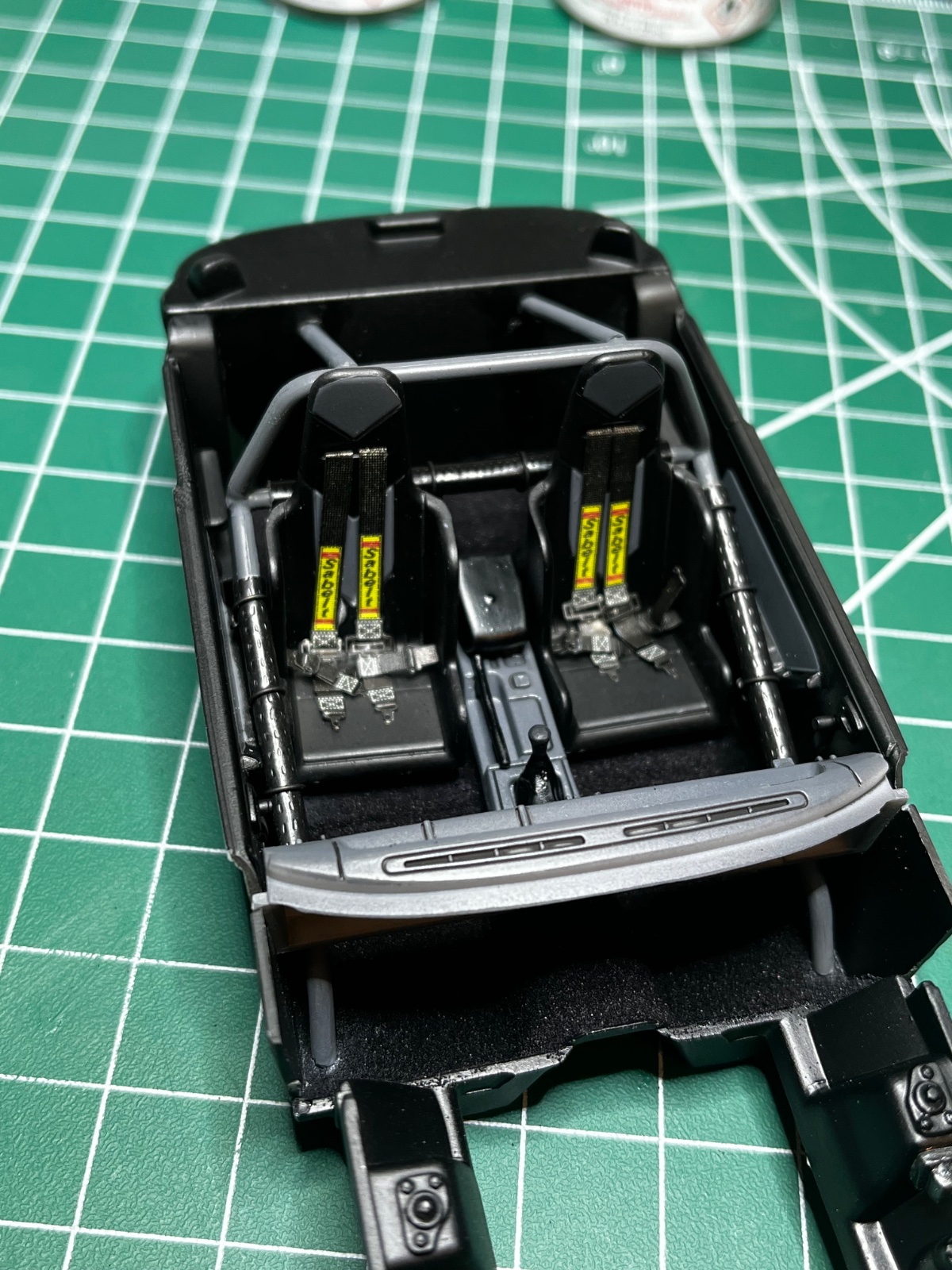

Finished the dash and put it in place, finished the engine minus the air filter assembly which it have set in place just to make sure the wiring isn't in the way. Started on the chassis assembly, dry fitting and glueing segments together as much as I can so after painting I can just drop it in.
