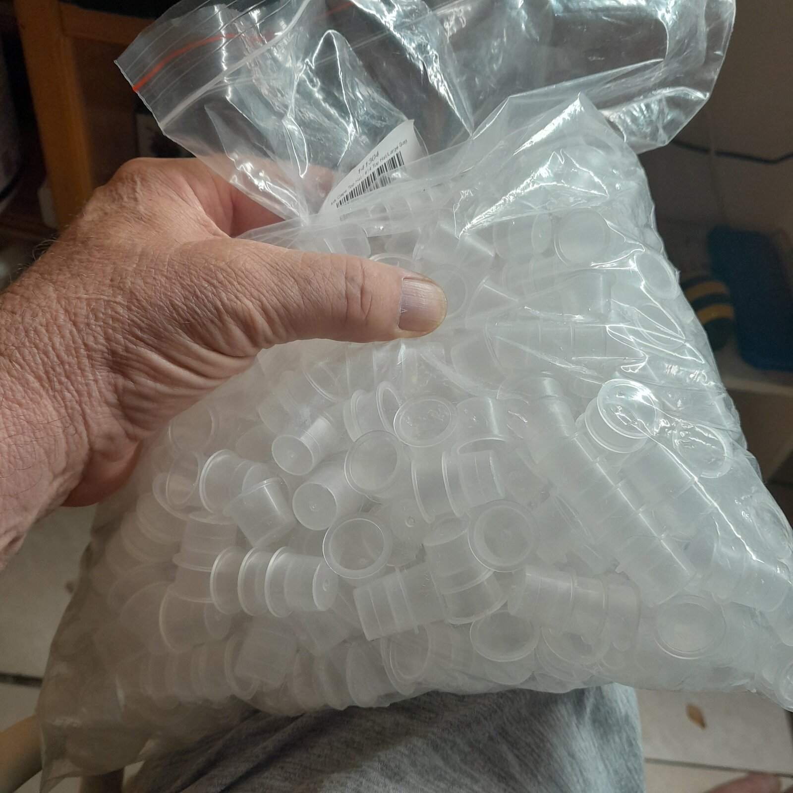

Yes, you lose a little bit of paint on the 1-in of the brush you let the paint run down on but it's better than getting paint on the lip of your bottle. Cuz that's sucks. And if you have access to a tattoo Supply shop? Go in there and they have about five different sizes of plastic disposable ink Wells. Just mix your paint and thinner up in it and throw it away.

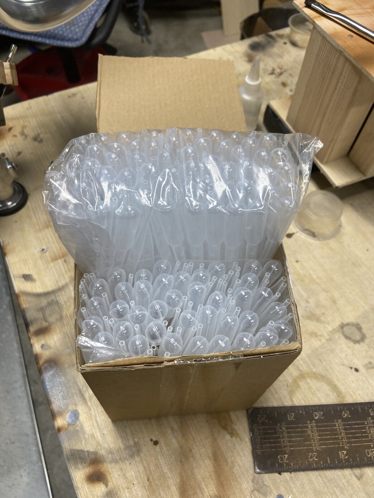

I got a set of small glass cups from a Chinese shop to do the mixing of the paint with the thinner, and a set of 6 glass pipettes with bottles to transfer the paint and thinner in controllable amounts to the little glass cups.
I went for all glass because I was afraid that the paint thinner would dissolve the plastic in the pipettes and cups.
Nope , they are polyethylene and completely resistant to solvents , including butyl acetate , ethyl acetate , acetone etc .
Enamels use mineral spirits / paint thinner anyways and that will not attack any any plastics , much less polyethylene .

Pipettes work well and have a lined paint measurement reference. What type of airbrush, single or double action?

Hi and welcome to the forum. Pipettes are the way to go. Pantherman

No idea .
Did you figure out what was up with the alcohol separating from that Tamiya paint you mixed ?
I wouldn't expect such an extreme stratification like you described since the resin was already in solution out of the bottle .
I don't use Tamiya paints - with the exception of the rattlecan primers .
You can reuse them forever , depending .
The only caveat is avoiding a layer of dried paint building up and contaminating future paint used .
Nothing really sticks to PE ( polyethylene ) so it's not really an issue --- they are so cheap too , so just trash it if unsure .
You can flush them with solvent , mineral spirit for enamels , after use to extend usage .
Not even dichloromethane , used for solvent welding ABS , will damage them .
Sometimes they will eventually split along the seam , but that will be obvious .
