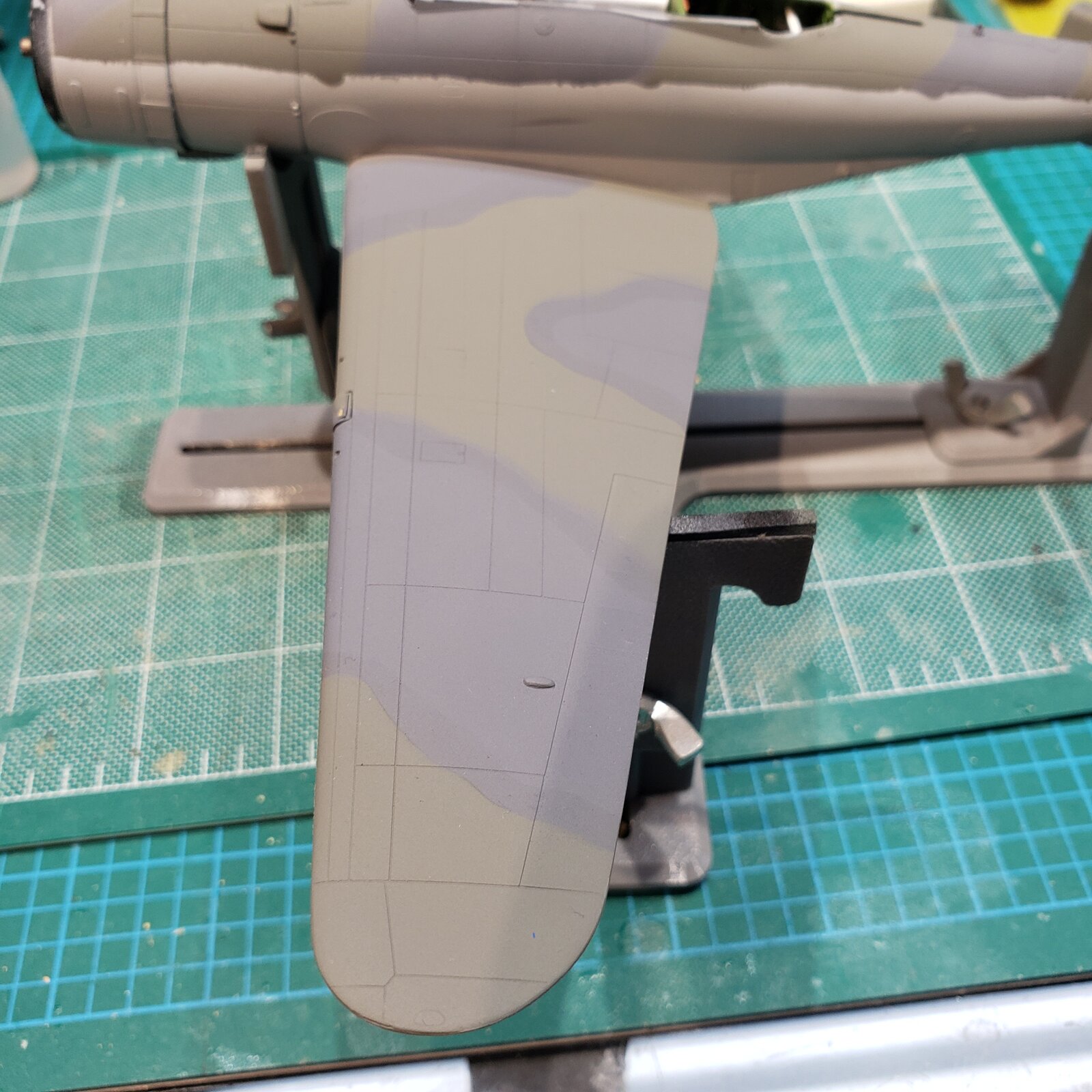

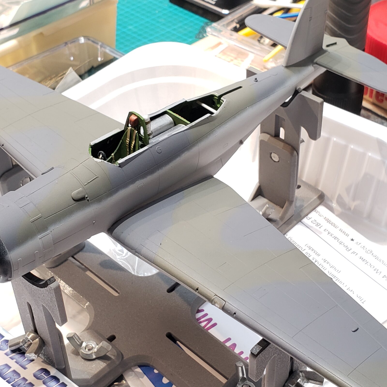

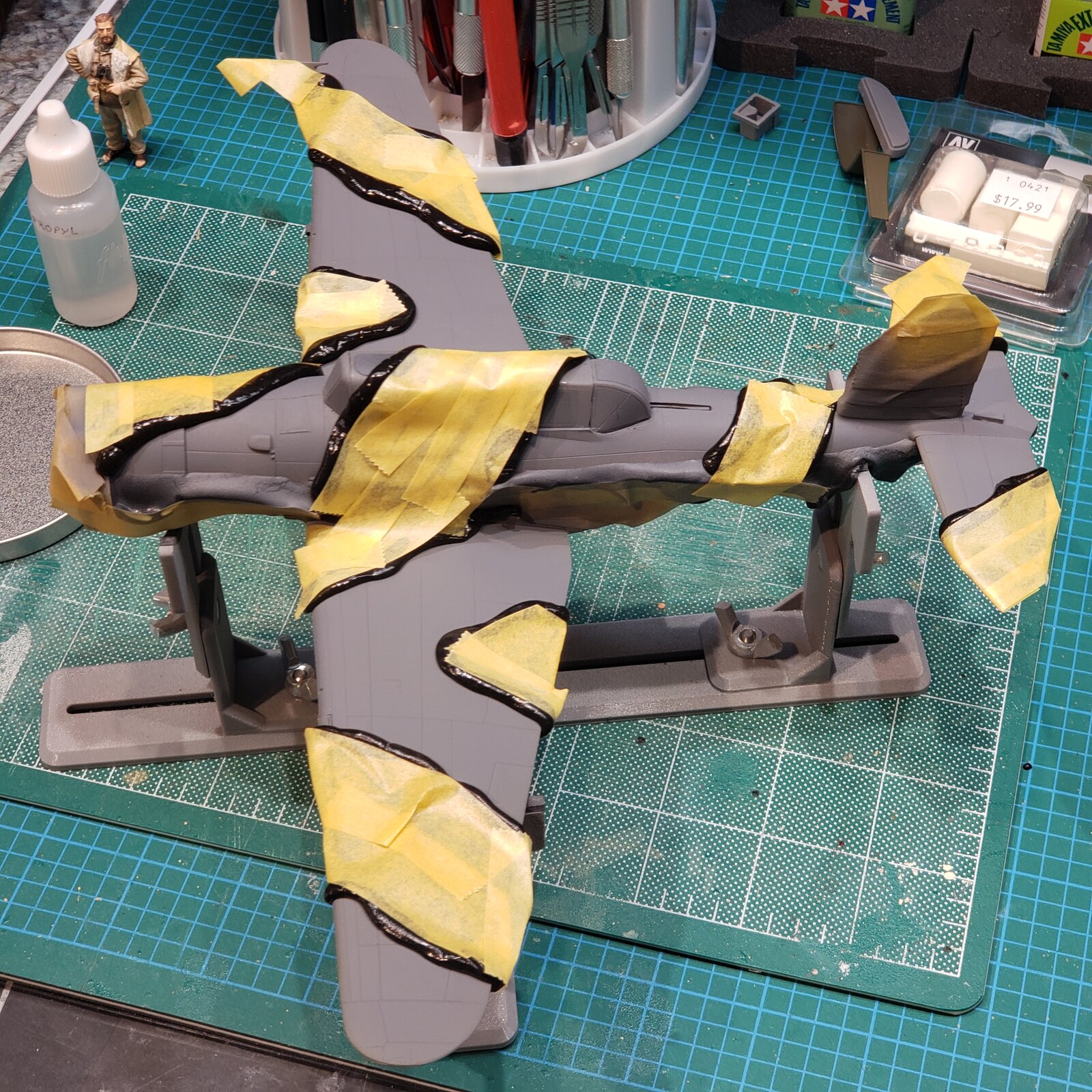

Well, I have to speculate, then. Acrylic paints cure slowly, and those with aqueous solvent systems cure more slowly than alcohol systems because the water evaporates more slowly than alcohol. If the mask is applied before evaporation (and thus curing) is complete, that could lead to the problem you experienced. It is also possible that the flat paint surface, even if fully cured, absorbed something from the masking putty. Had you used the putty mask to cover the entire area being masked off, the darkening would affect the whole area and might not be noticeable.

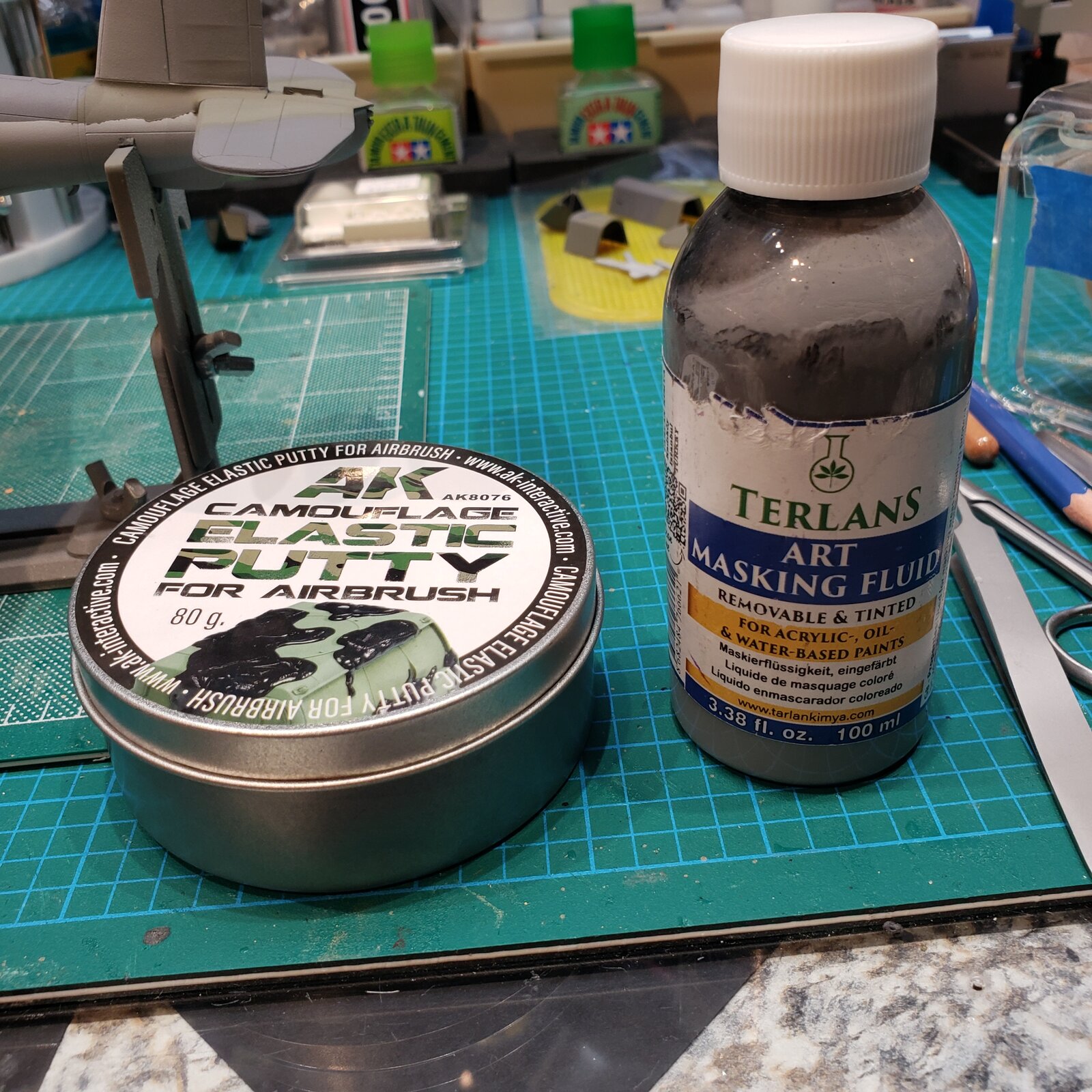

Everything I read about that AK putty makes me a Hard Pass .
None of the masking materials I use have any of its negatives .
from some AI somewhere :
Key Tips for Using AK Putty & Avoiding Issues:
  • Prevent Darkening/Residue: The oily, dark residue is common if the putty sits too long on matte paint. Apply it only when necessary and remove promptly after spraying.
  • Surface Preparation: Ensure your base coat is fully cured before applying putty to avoid it lifting the paint. Using a gloss or satin varnish under the putty can prevent oily marks.
  • Dealing with Sagging: AK putty can sag or flow due to gravity, especially over time. Use it for quick, immediate masking sessions rather than leaving it on overnight.
The majority of the complaints I read were of it welding itself to the model .

In my case it was hours, not days. I can say that I did experience 2 of those 3 issues: darkening/staining and sag (especially with gravity working against it).
In future, if I use it again, I will definitely put something between it and the surface ... or cover the whole area to be masked, not just the edges.

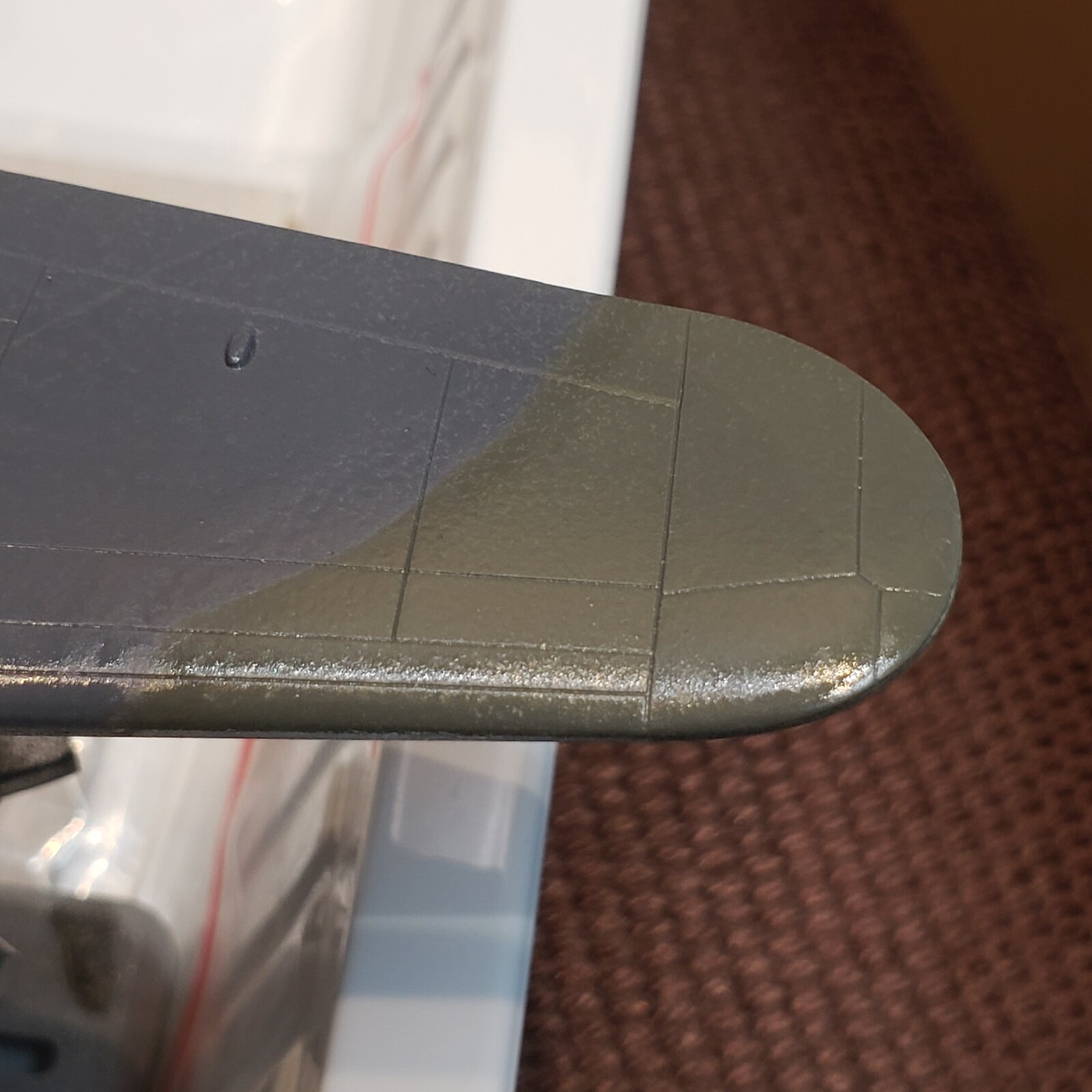

I've used Silly Putty quite often for camouflage masking and sometimes it would leave the different color like you have in your photos. I don't know why it happens, but it was always evened out when I put on a clear coat prior to decals. I've never used the AK brand putty.

One thing with what you saw, I had the EXACT SAME result with different paints.
The one thing we had in common was brand new masking material.
While the masking "worms" were a different product, they were both fresh from their packaging, I suspect there was some sort of preservative on them that did this. I used the same sticky-tack several times later with no ill effect.
That makes sense—there may be a volatile component in the compound, left over from the manufacturing process, that causes this. The solution would then be to take the new material out of its container, spread it out on an impervious surface, wait an hour, flip it over, wait another hour, then use it on a paint hulk and see if the problem recurs. The 1 hour wait time is entirely arbitrary.

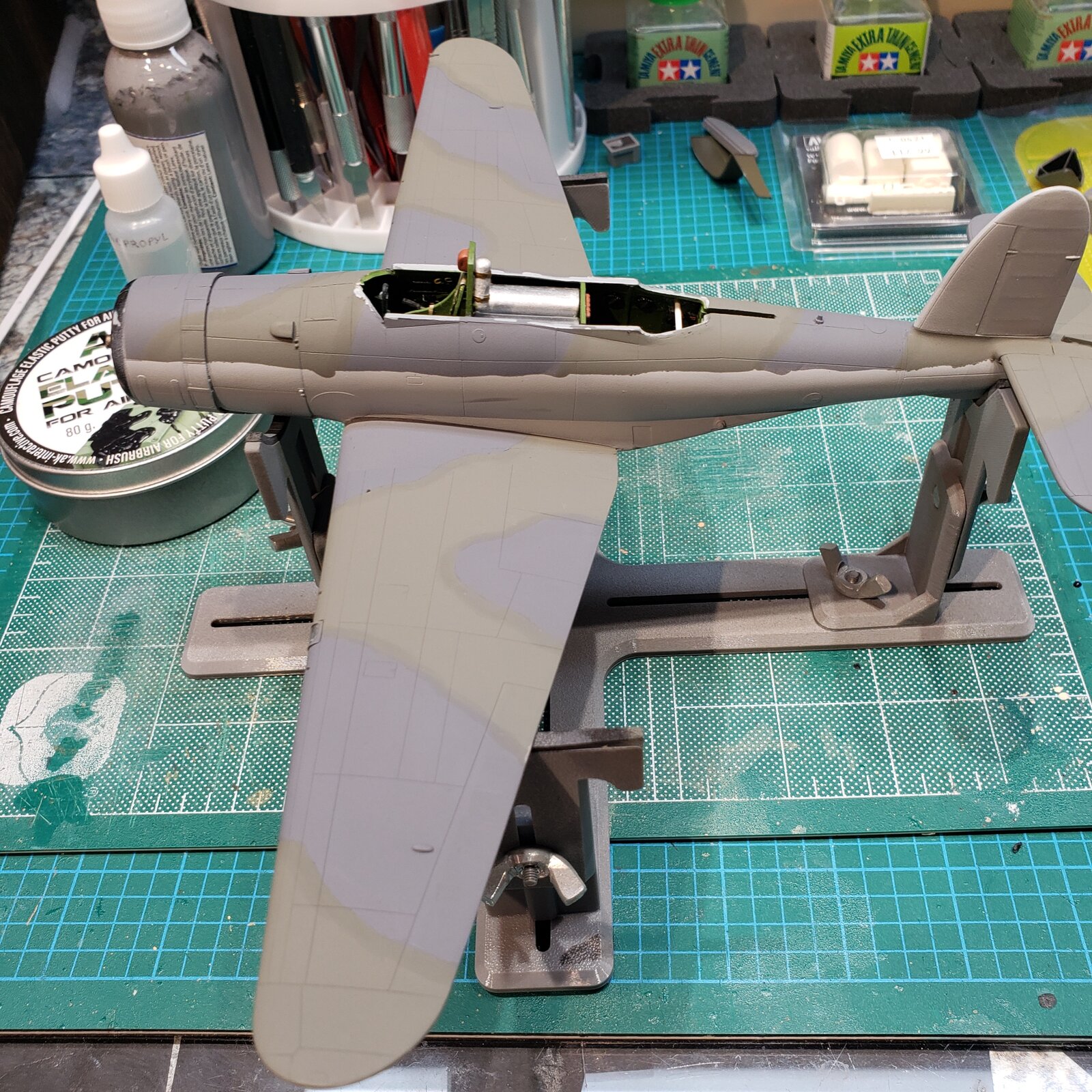

So I waited the week, and went back in FREEHAND 🫣 to try and touch it up, as well as soften the upper/lower fuselage line.
Not gonna claim perfection, but happy with the results.

The application and demarcation look great, and it could be the lighting but...is there enough contrast?
Funny you should mention that. The light at my bench is pretty bright, and the relative contrast of the two colours is low, straight out of the bottle. I feel like there was more before I went back in to correct the discoloration; freehand spraying, though low pressure and narrow fan, took any crispness in the border between the colours out.
On the other hand, in the colour illustrations I've worked from, the tonal values are also quite similar and difficult to differentiate.
