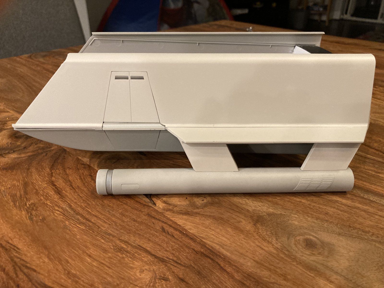

I don't want to wet sand at all actually; I'm more afraid of regretting it if I don't
It doesn't sound like you need to wet sand but can you share a few pics to show what you're concerned with ?
Mmm,
I downloaded the image so I could magnify it .
Yeah , the paint looks uneven . Mottled .
Wet sand and respray it ?
You're using rattlecans ? It looks like you're spraying from too far away .
( and I can see a couple of gate marks , from the sprue , on that door )
Oh here it is
Ya what Uru said,,If the paint is pebbley you need to wet sand before clear for your decals
