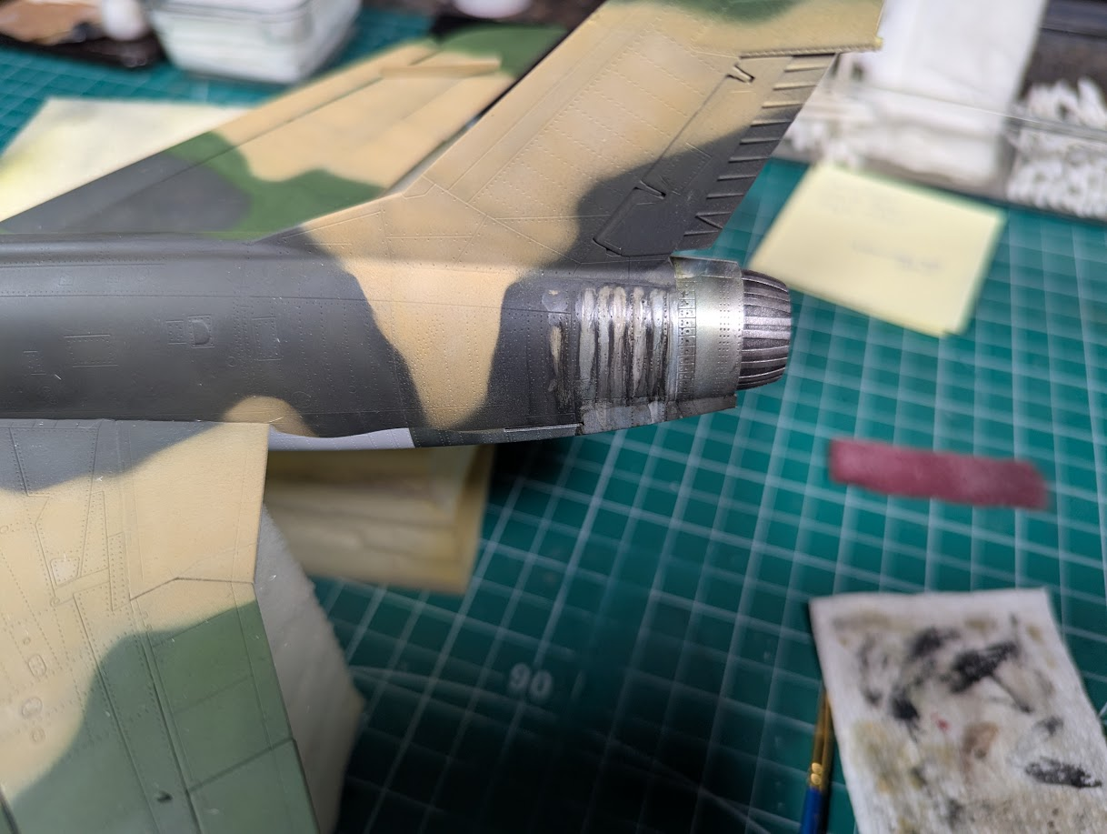

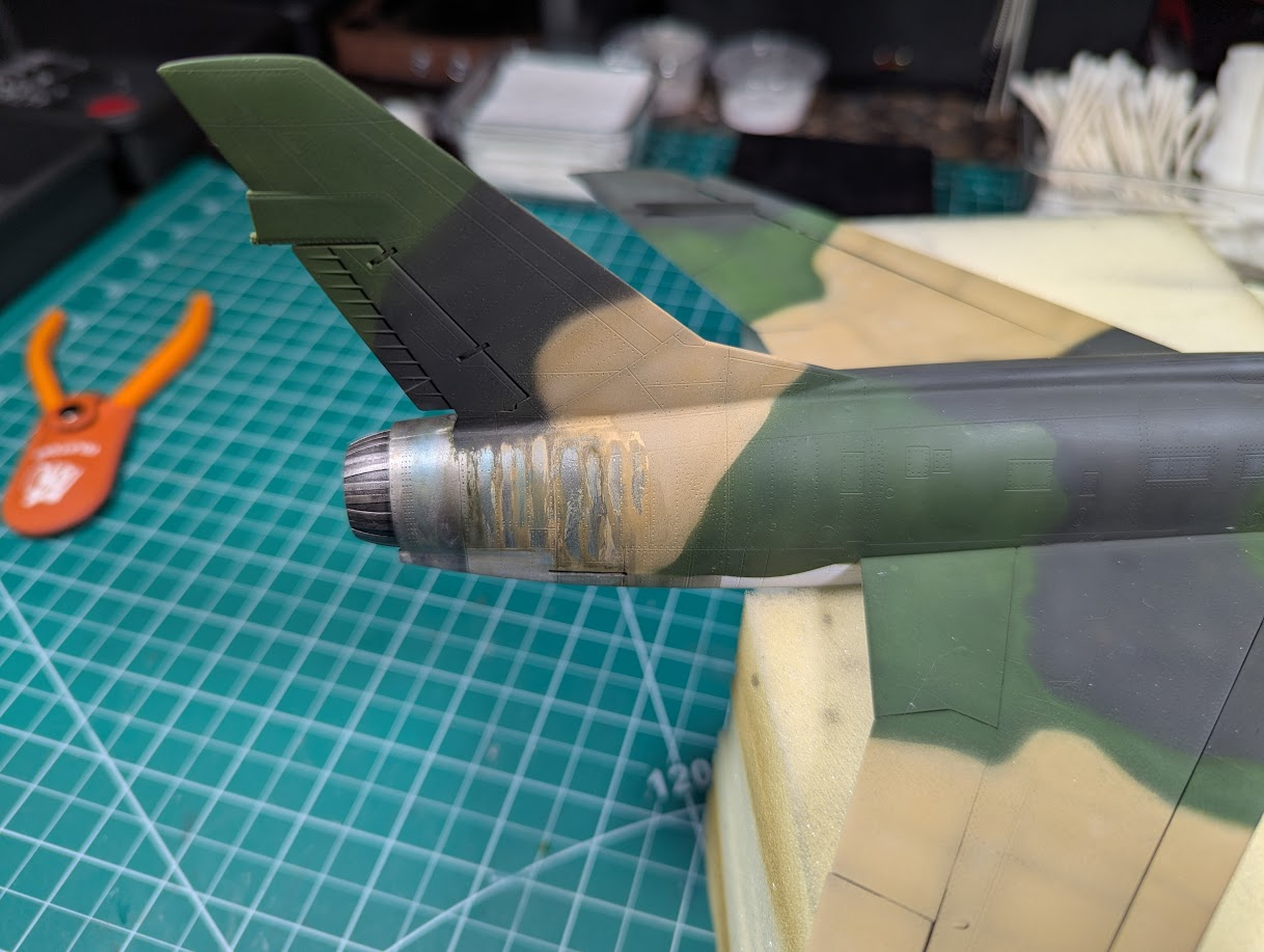

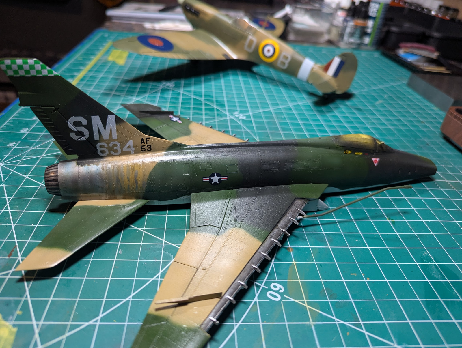

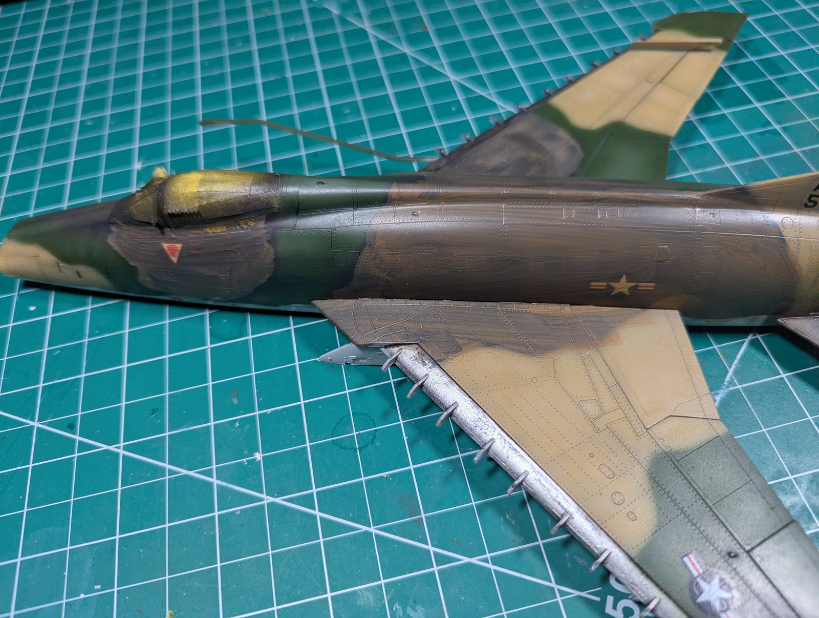

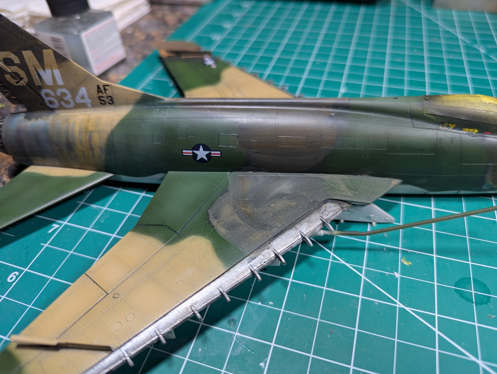

Just showing some updates of my tests with "weathering" the paint off of the rear fuselage due to heat.
I am playing around with this technique using parts that will end up with little paint left. As I gain confidence those marks will advance forward.
HI Edbert i think you need a tad more blue in the fusealage where the burnts section is as when i see the real plane back in the early 70s it was nearly all blues an blacks but just my opinion
chrisb

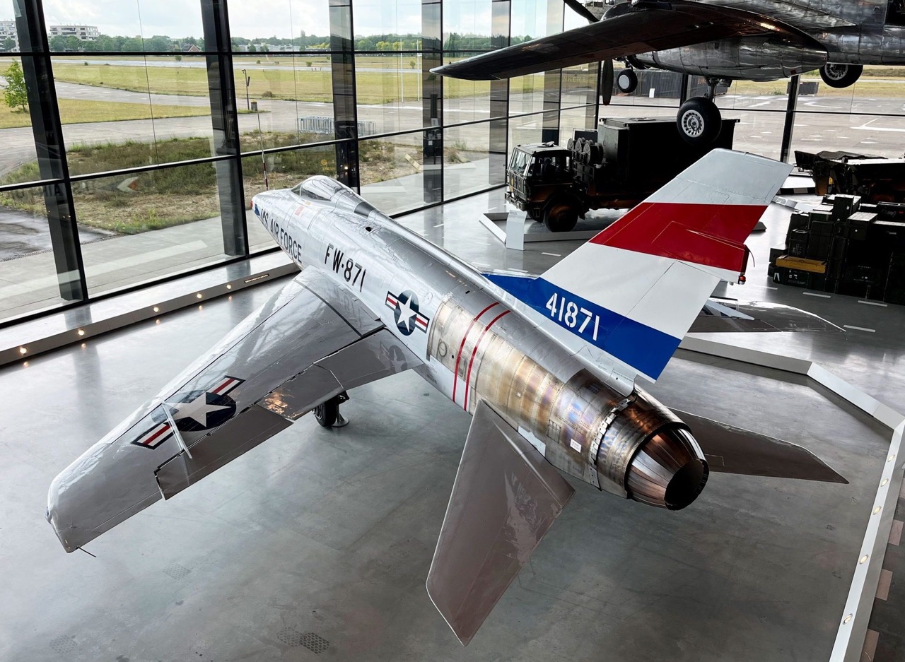

If you look at the pictures of the F-100 in Viet Nam, the burned areas near the exhaust have had camouflage paint applied over the areas previously discolored by heat. When that paint gets hot enough (and the discolored metal is proof that it was hot enough) the paint burns, leaving white, black, and brownish residue, which is what burnt paints leave. Note that in Jakko's second and third pictures, there is no paint on that part of the fuselage.
When that paint gets hot enough (and the discolored metal is proof that it was hot enough) the paint burns...
One reason I left all the danger/caution stickers off of that section. I looked at tons of photos and there's no sign of the red walk-lines on the wings, or the red stripes where the rear fuselage separates for maintenance. The last picture (above) that Jakko posted shows them clearly, and most of the bare-metal Huns had them. I'm guessing they applied the SEA camo on top of nearly everything.

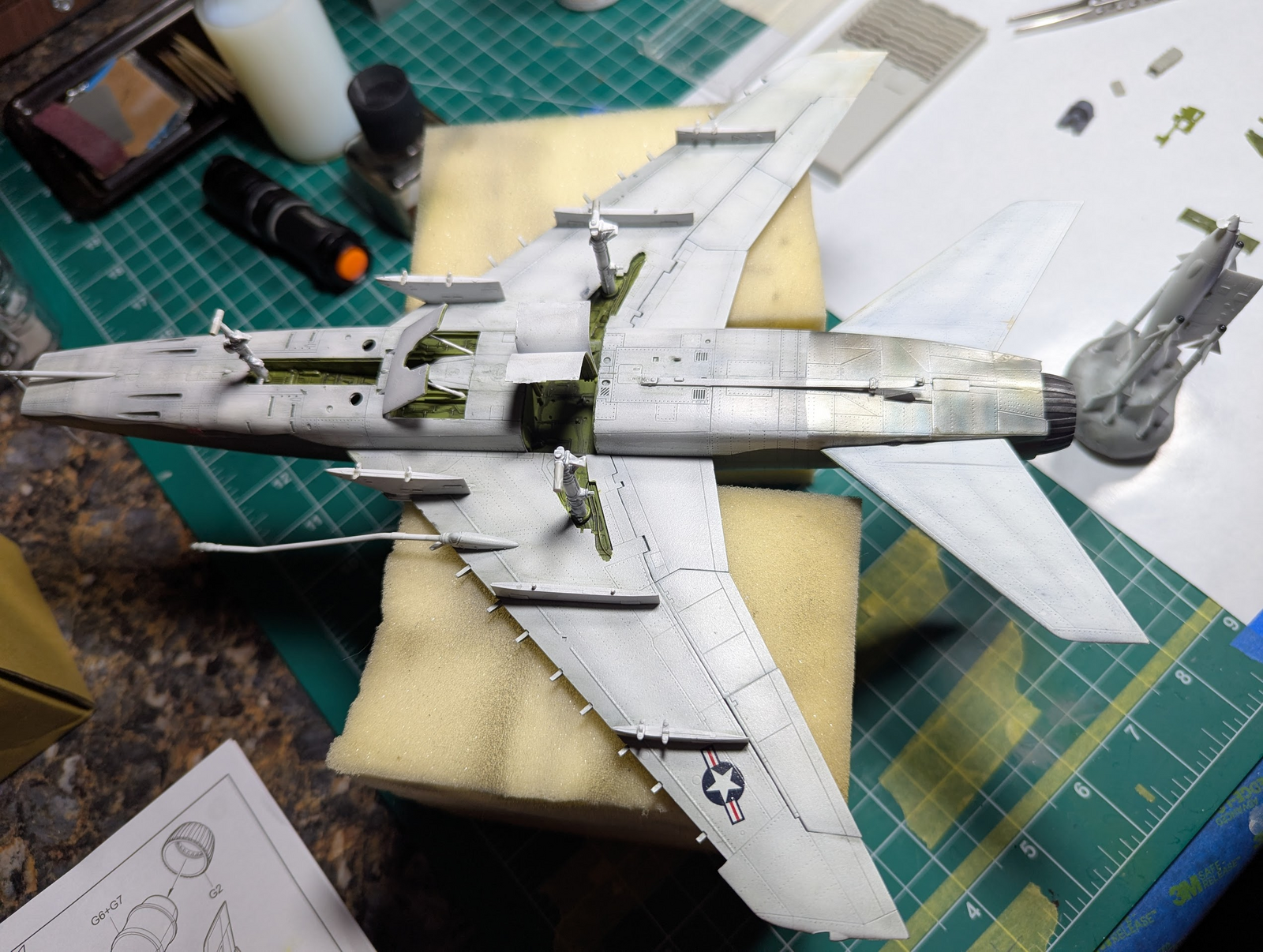

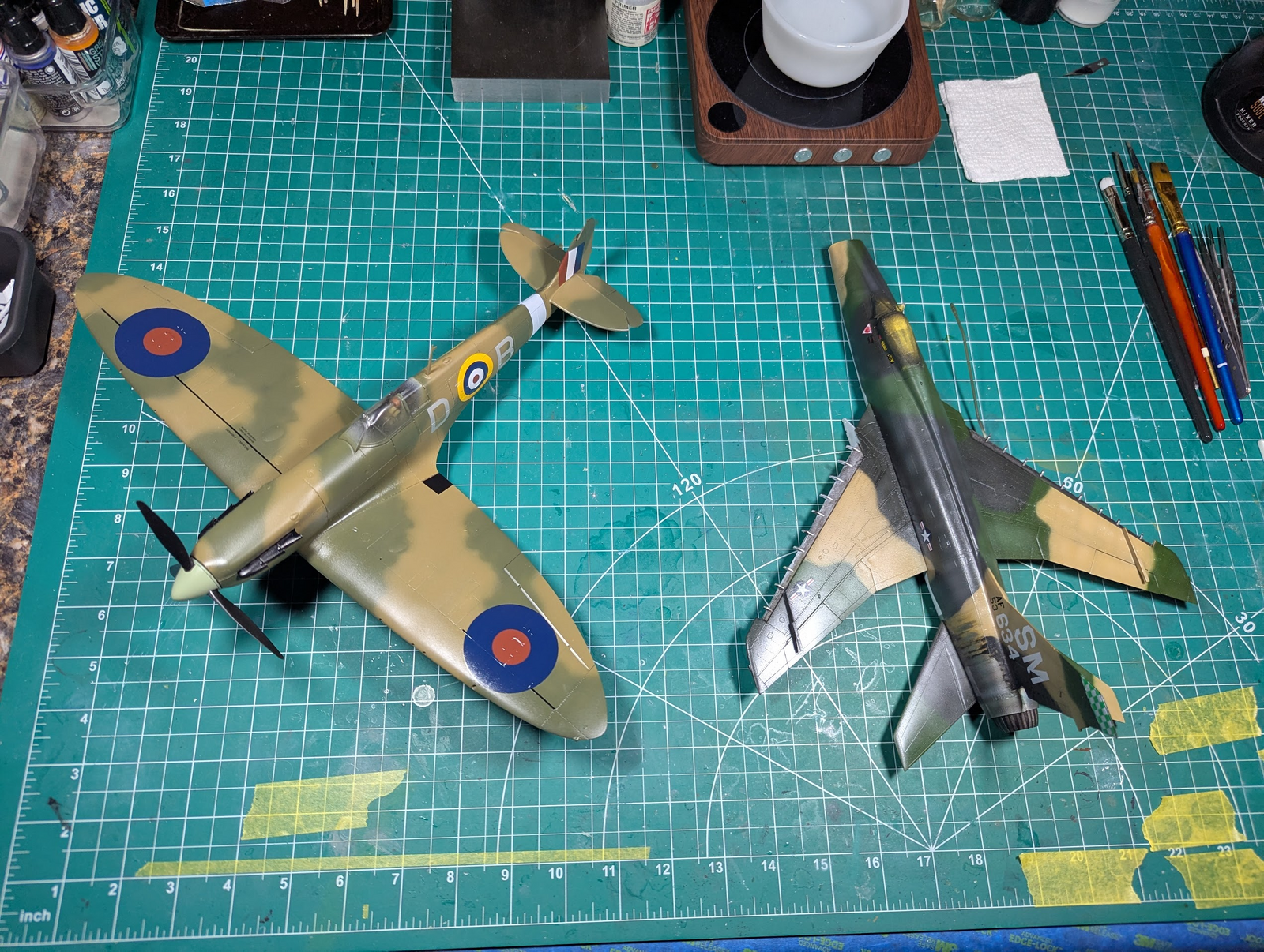

I figured that if I am going to sit there and do stickers, I might as well work two kits at once.
Getting to the end. Had a delay of several days as I had misplaced some itty bits including the dang wheels. I assumed I had them mixed in with another kit, would not be the first time, but I found them in the garage where I spray. They were all on a stick together, just fell behind some clutter. No big deal, now I can finish this one up.

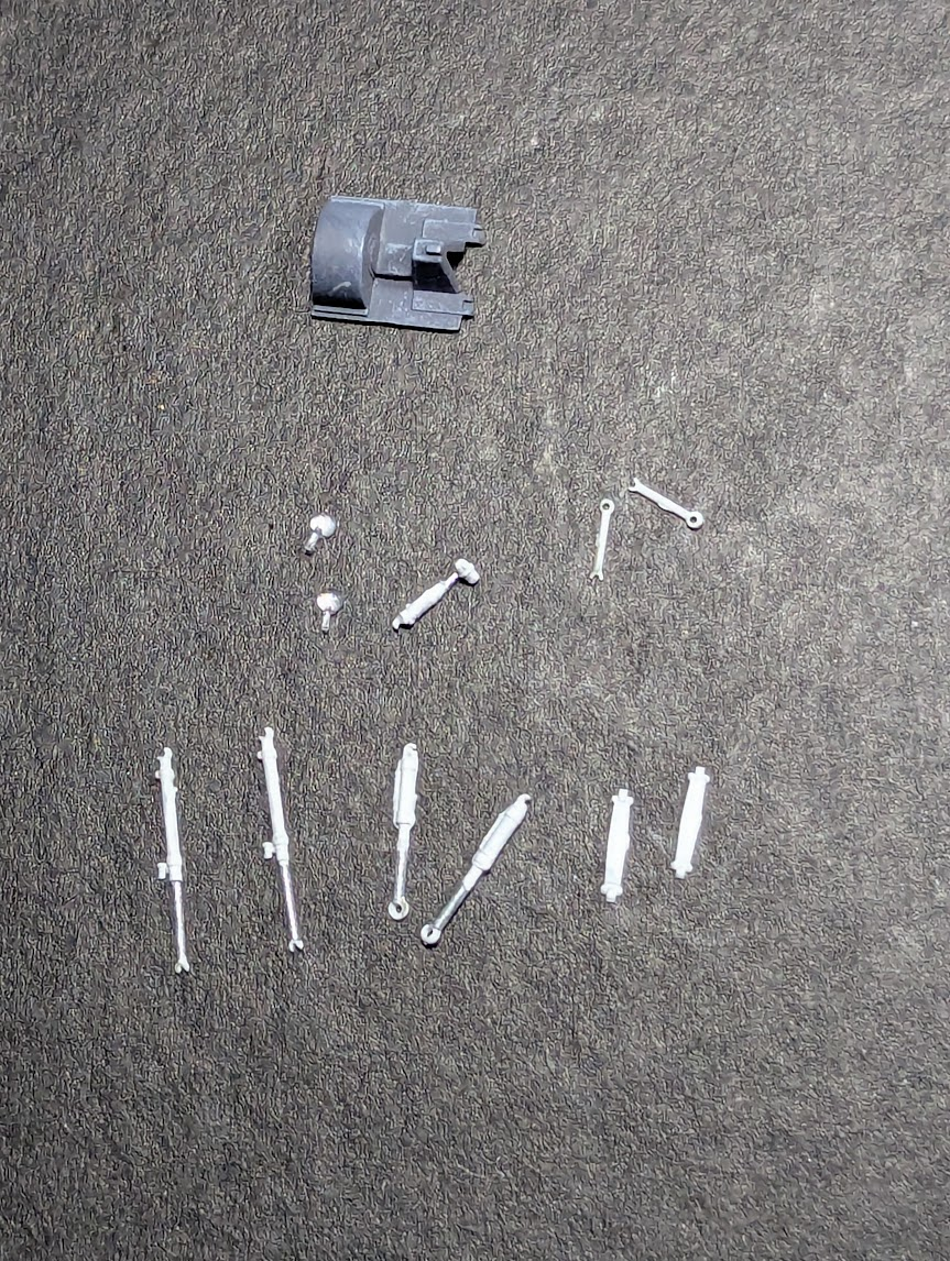

Mostly landing gear bits, four cover-panels not shown. The two round items with a pin are forward facing lights, the large part goes behind the pilot's head. I should have put a dime in there for scale.
Despite appearances, that is not flash or sprue gate leftovers, those are either part of the struts or attachment points for the panels.
