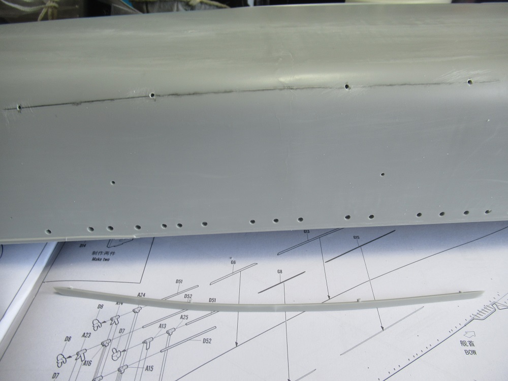

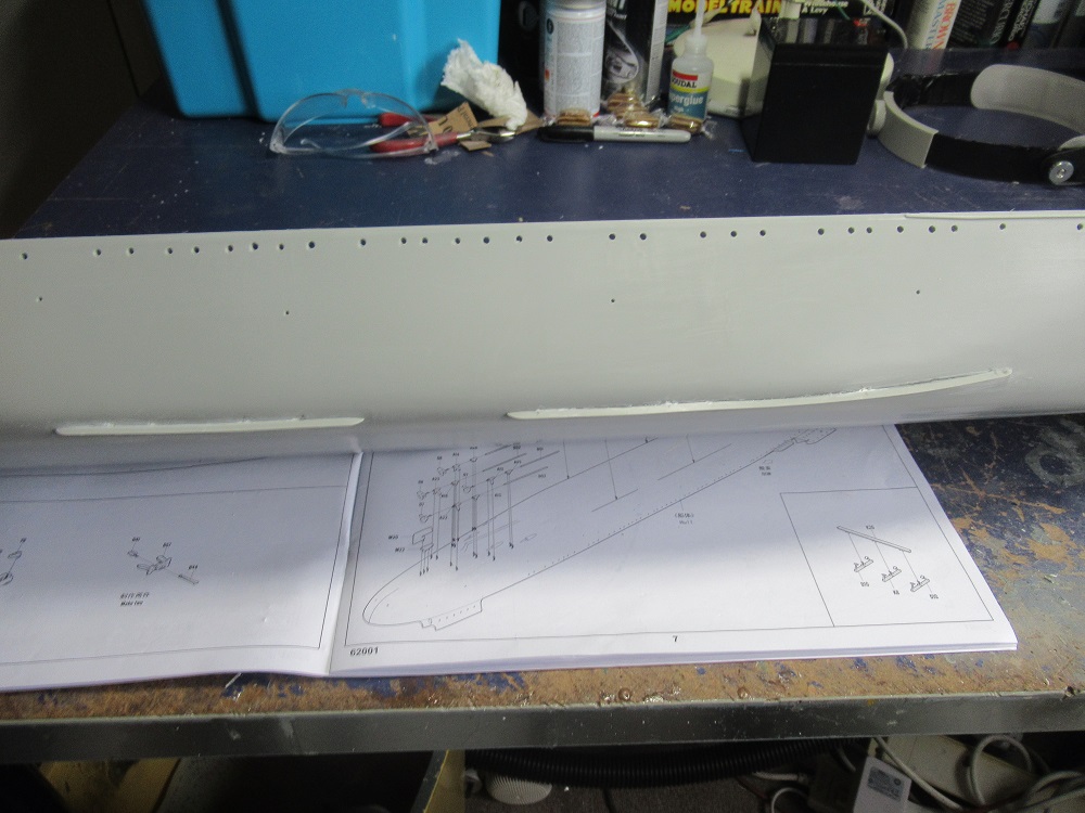

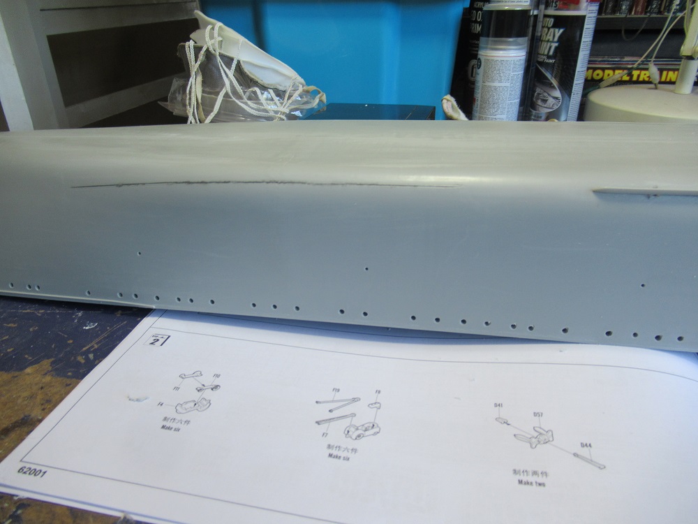

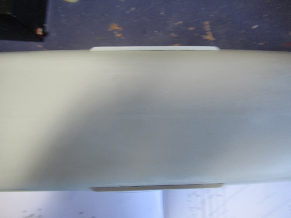

HI GUYS well im back on the hornet an no ive not done much today as got freinds comin so jen has called me downstairs to see them an not bein rude by stayin upstairs urg but at least ive fitted two parts an they are the rear bilge keels as there are 4 on the model but they are very awkward to fit even with the pins ive left on them as they must go on at a 45 deggree angle an the main front ones are to be curved so had to pack up now as they will take qiute a bit to fit but on the rear ones they went on fairly good as makers have put some marks on the hull but thats about all so ive have drilled out some over sized holes for the bilge keels pins to fit in the hull will fit the front ones tomorrow an now some pics
an here the small rear ones
chrisb
an here the front ones marked out in pencil on each side
AN HI Kevin on your battle wagon did you have any cut outs on the hull to make fitting the bilgle keels easyier ?
chrisb
Not cutouts, but just scribed lines for placement. I used masking tape to hold them in place at the correct angle until the dabs of CA glue dried completely, because they have a slight curve to them that the instructions don't really show.

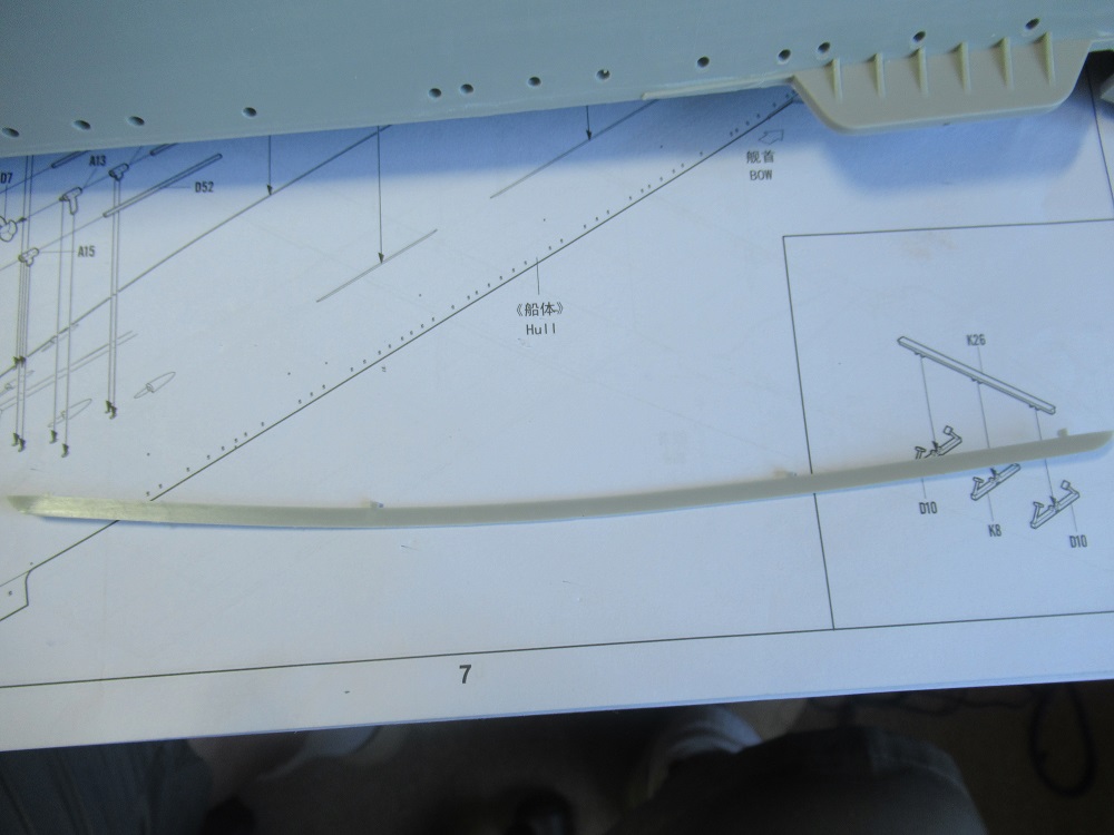

YES Kevin you are right there as ive also just got some scribe lines to fit the keels to but ive use the pins that the keels are fitted to the spruces an just marked them out with a pencil an then dilled holes in the hull as dont have to worry about them leakin as it wont be on the water but you would have thought they would have shown how much they curve so its just as well that ive done loads of big r/c scratchbiult hulls to know a genaeral idea of how these keels fit on the hull phew an glad you got your fitted ok an did you have 4 like my ship or just one big one ? on each side ?

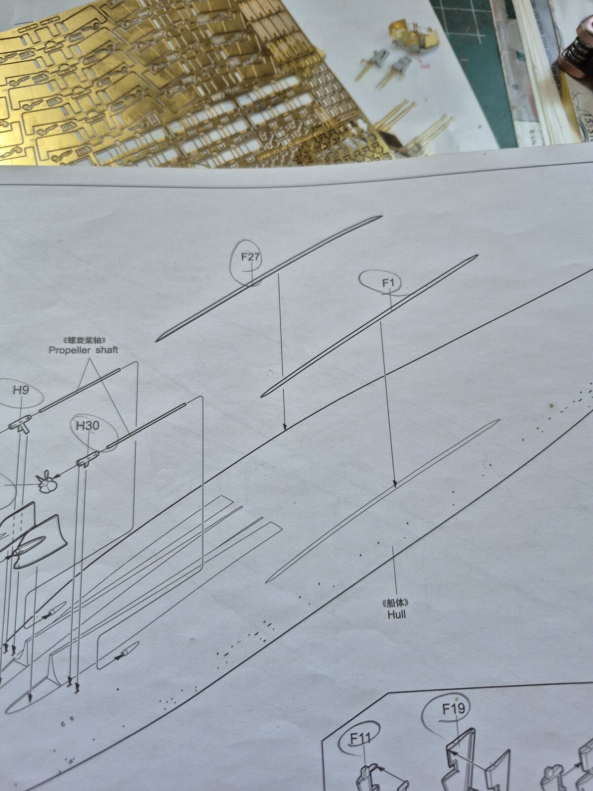

OH MY Garwd Kevin sorry for askin you that as i dint notice on your plan that you do just have one big one each side god it must be the heat as its bloomin hot here today an makin me slow thinkin lol an think these instrucktions are not that good what is your opinion ? as on mine it doesnt show where parts are suppoce to fit an it should do for the money we paid for these kits AARCHHH
chrisb
chrisb
Yes, I'm finding the instructions are a little vague in some areas. This is only my fourth Trumpeter kit. I also built a 1/35 locomotive and two 1/16 armour kits of theirs. I remember I found the locomotive instructions not so straightforward as well.
It's most likely my inexperience with the subject matters. I've built armour kits almost exclusively since returning to the hobby.
YES Kevin im finding it hard to understand where some parts fit on my horrnet as im used to big 10ft plans of my r/c scratch built ships where i had a true scale plans so to come down to these vauge instructions is a bit of a problem for me but hopefully we both will be able to build our models to be proud of

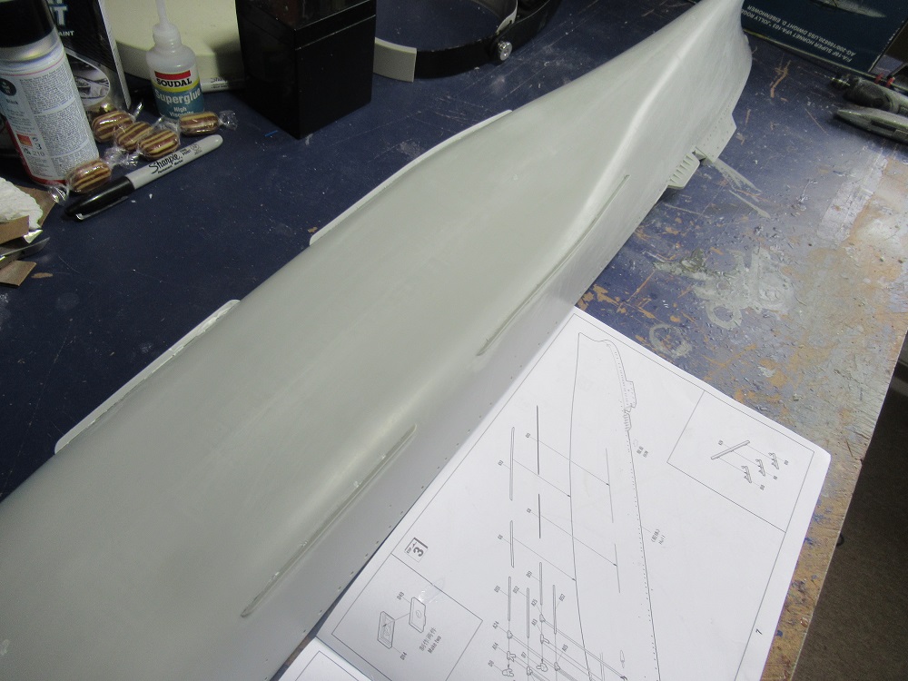

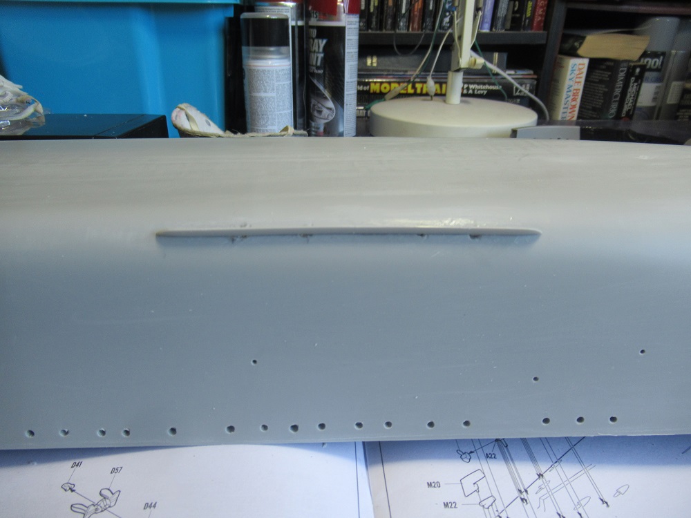

HI GUYS wel the build is still goin an over the last couple of days ive drilled out the pin holes to hold the big front bilgle keel in place an here a pic an it was a very awkward part to fit due to the curve of it against the hull on both sides
an a side view shot to show off the curve in the keel an god it was a job to fit in place as it kept tryin to twist around flat but i think i have got it reasonably right

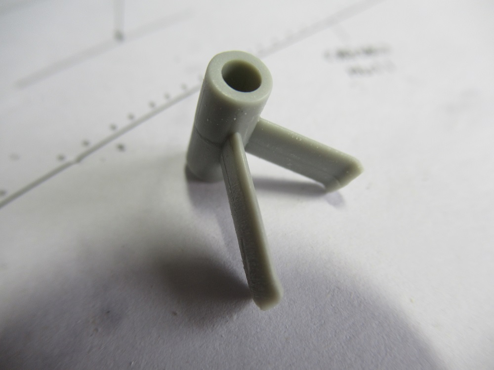

Next job was fit the A frames to hold the prop shafts steady an here is a big A frame what fits near the prop an bu gum they were made of very hard plastic as it took me all my time to cut them off the sprues
