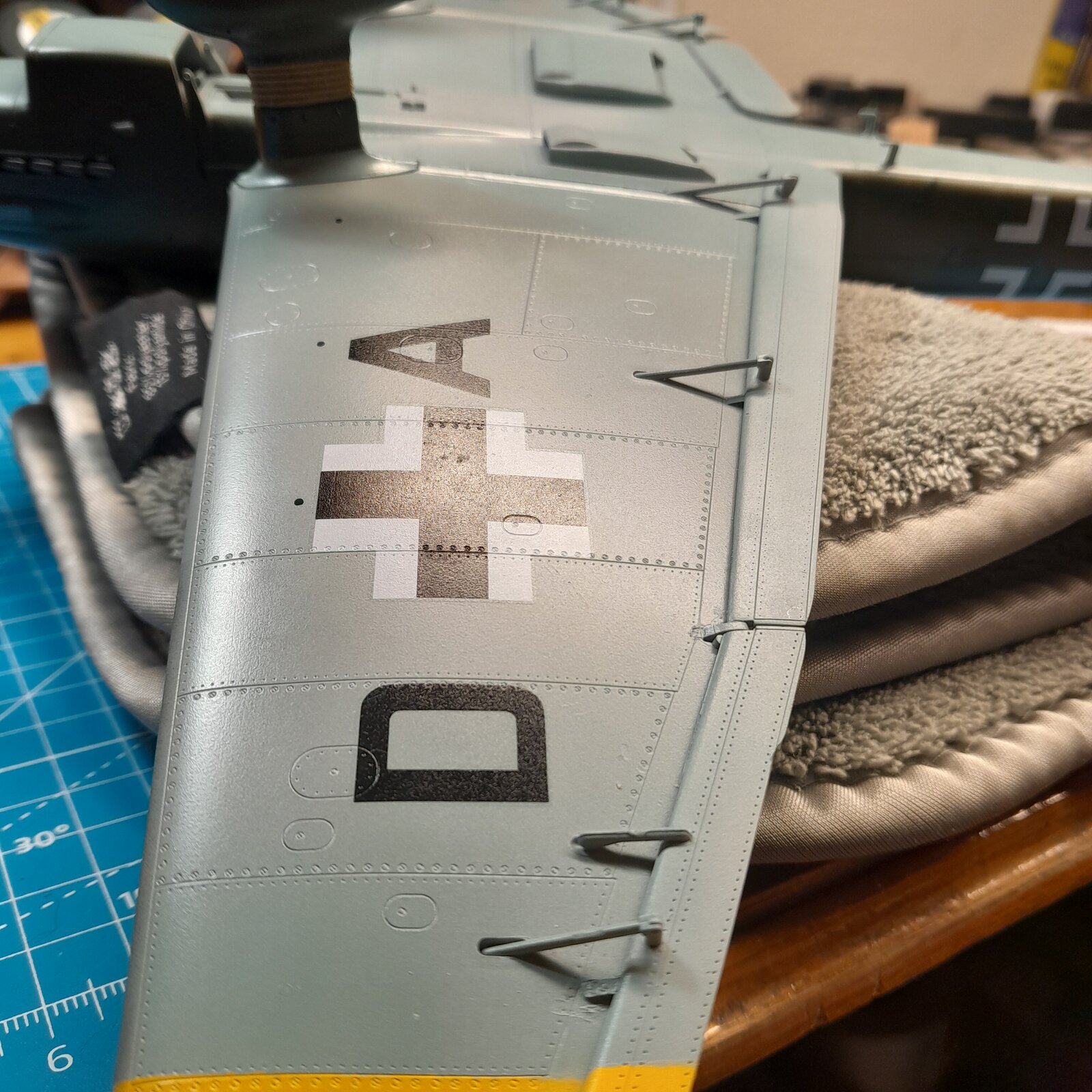

This is my second Trumpeter 132nd airplane. I thought it was just me at first then I realized. That ain't so. These details are thin. Is it just me? Or do you have to be just super careful, super perfect placement and everything has to be going absolutely perfectly so that you don't mess up that decal when you lay it down. I'm here to tell you I grabbed a few decals and crumpled them up. They were either folded over in half or a piece broke or it tore. Is it just me? I also have to say. If you do manage to get one on they lay down really good but to get to that point is a p i m a

I agree with Boatman. I've seen also. I just don't think I have that level of dedication but Barry's work is impressive. Maybe if I had the stencils I would probably give it a go. But like everything else you get better with experience. In one day of working with those stupid decals, I found ways of dealing with it. I have a really fluffy paintbrush probably used for mascara Maybe but it's really soft and holds a lot of water. So I get it wet and hold it above the decal and the water gets underneath and you can move around and position the decal with a toothpick with a blob of blue tack on the end
Now that I've worked with these Trumpeter decals for a few days you get used to them. You learn tricks I guess because I have to admit as thin as these are and easy to mess up they do lay down beautifully. Like you painted it on.
