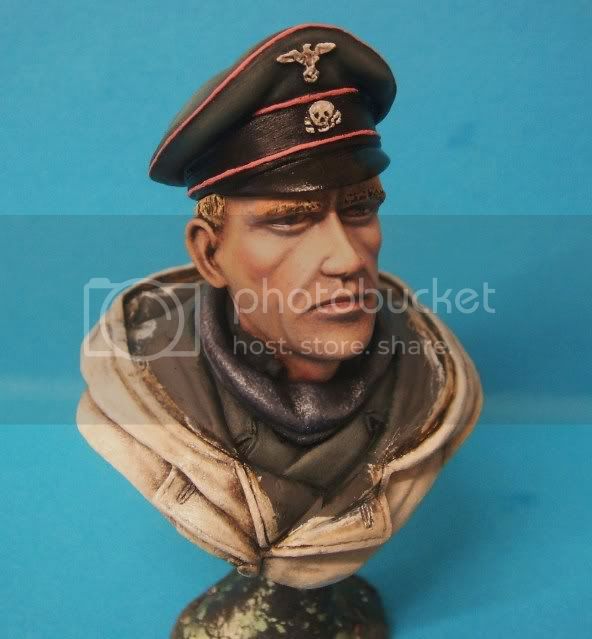

This fella kept looking at me from the end of the bench ...so I thought I'd get the brushes going on him again ,think I'll finish him up while painting the 109 this week .
I pretty much finished the face ,then painted in the hair and eyebrows .Then concentrated on the cap ,I done the pink piping (Waffen SS commander ) then the cap badges were painted in with greys and highlighted with touches of white .The peak was given a gloss coat ,still need to add some highlights to the Black felt band .Also the throat mic has been base coated . I put a white basecoat on the winter parka too ,so I'll get it painted tomorrow :)
Thanks for looking.
Chris.

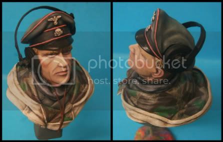

Just a quick update on this fella
I set the head in place for the pic otherwise you'd be looking at ...err...well ...a coat really
I've started work on the reversible Parka ,in this case the white is on the outside ,still need another sitting at it .His commanders jacket has been painted in too ,again I want to add a few more highlights in there ,and lastly the scarf which is still a bit damp so it looks shiney .Once the White has dried I can paint in the camo on the inside of the hood .....Im off to put some headphones together now
Thanks for looking.
Chris.

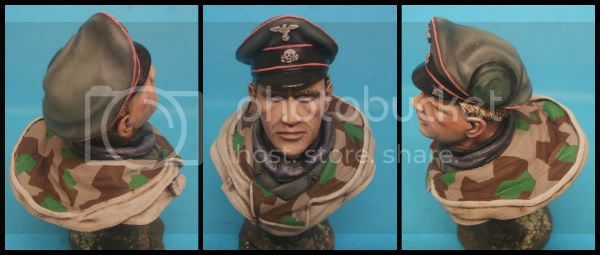

Hi folks :)
I layed up the splinter camo on the inside of the hood ,still needs some touching up then the rain marks will be added before hitting it with some oils . I have used Vallejo's Panzer Aces splinter camo colours for the base colours . I think the addition of the camo completely changes the look of the bust ....
Working on the headphones at the minute too ???
Thanks for looking.
Chris.

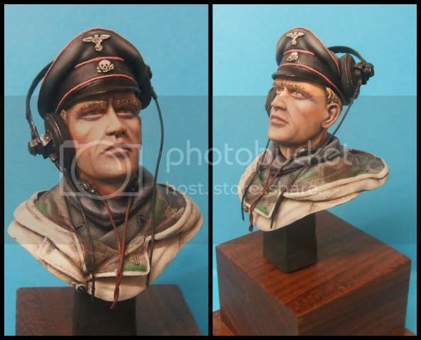

Hi folks ,
Well ,I think the next update will be the last one for this chap .
I've finished up the camo ,then done the wiring for the throat mic .After that i basecoated the headphones and fitted them ,they still need detailing ,chipping etc but they are very fragile so I thought I'd finish them once in place .I then need to add the wiring for the headphones ,paint in the underside of the bust & stand ,then mount it on a wooden plinth .
Thanks for looking.
Chris.

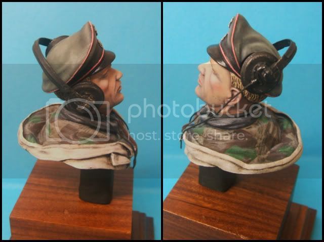

He is now finished and mounted on a plinth ,just letting it dry tonight so final pics tomorrow ;)
Chris.

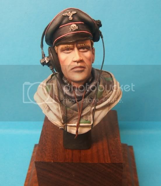

Hi folks , :)
Well its been a while coming ,but im calling this one done . I need to get a name plate for the plinth ,but apart from that he is finished . :)
Thanks to all that followed along ,and Thank you for all the great comments along the way . ;)
Thanks for looking.
Chris.
As I already told you - Great Work. You really do have some great skills to envy ;)
