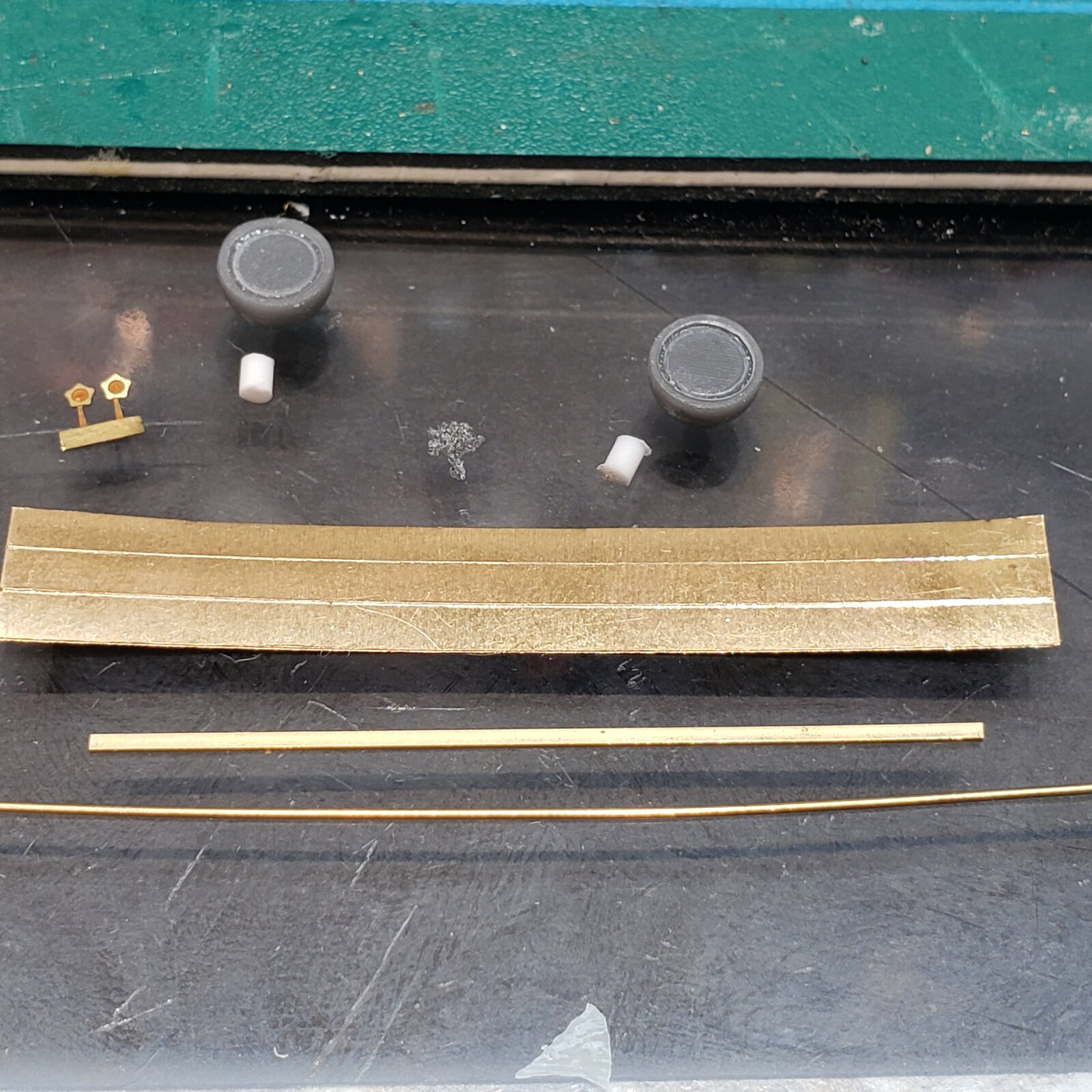

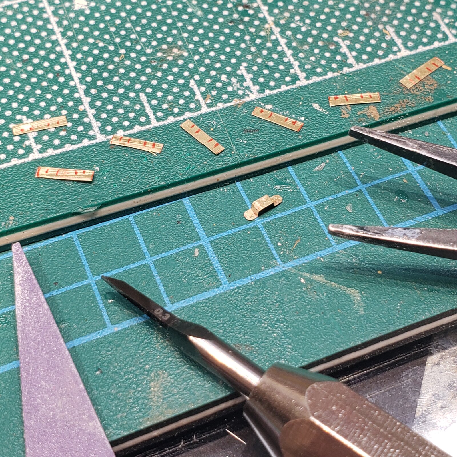

Another prototype: need 6 of these selected from this batch for the rear, 4 from another batch for the front section. Cut from my roll of .1mm brass. Rounded up the dimensions to closest mm. (So slightly larger)

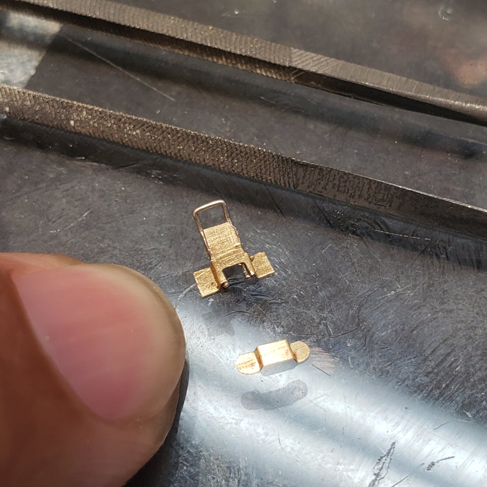

added details

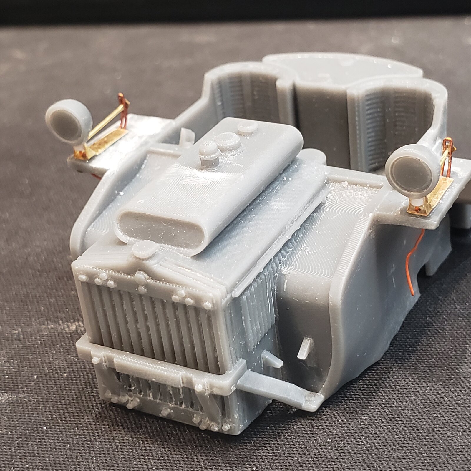

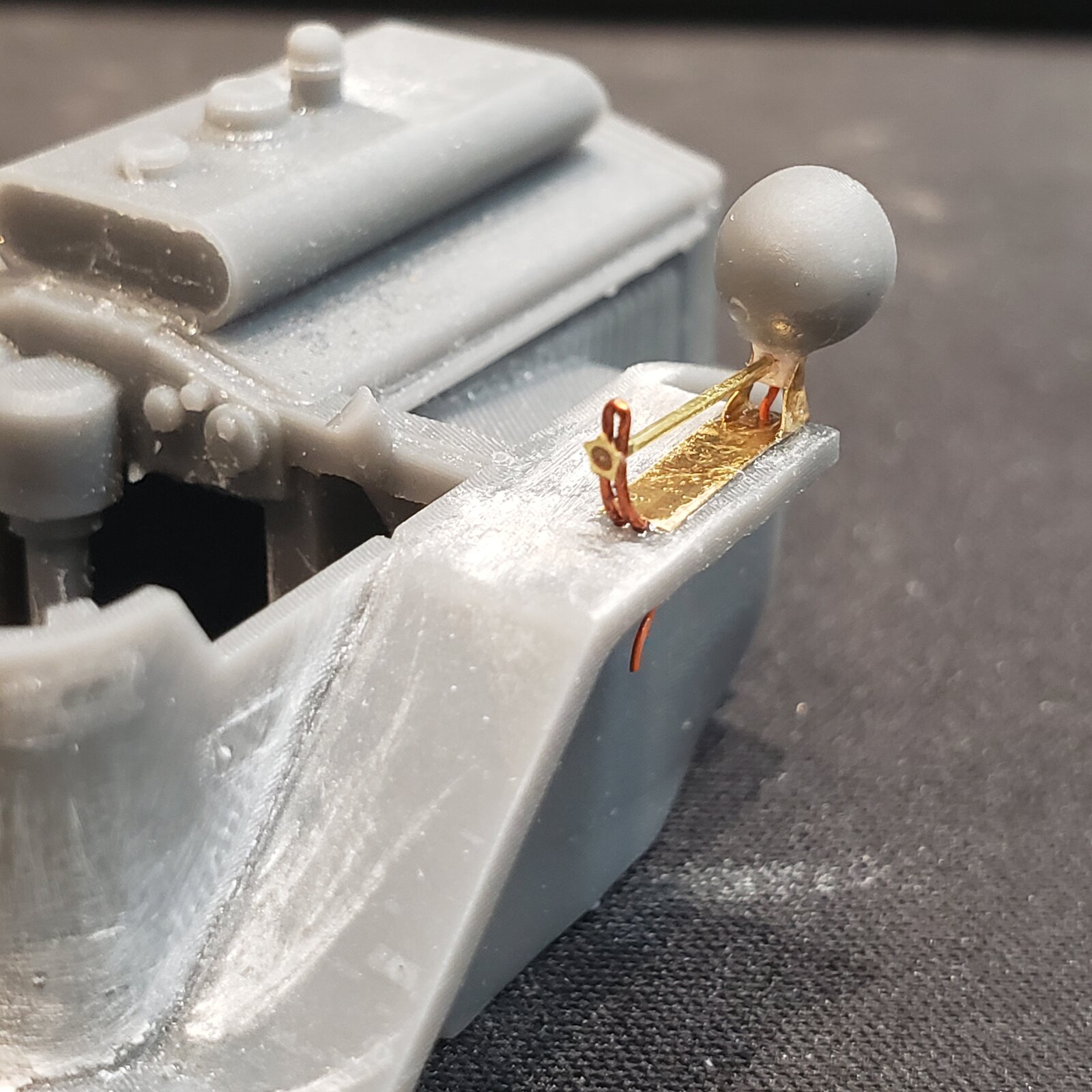

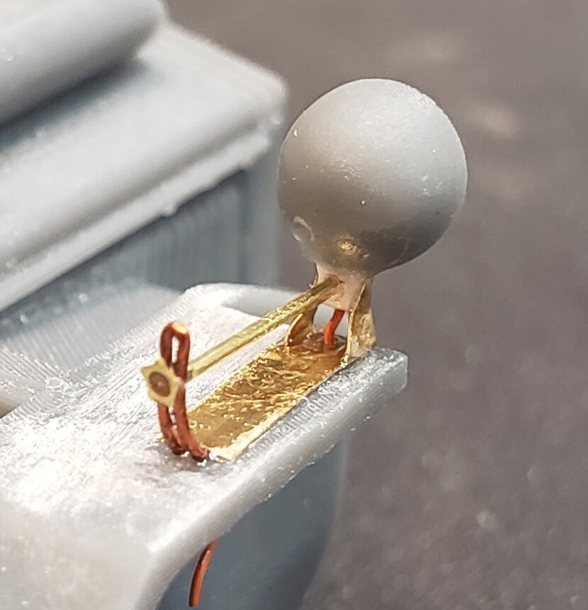

Some prep work on the adjustable headlamps.
Hope to turn this stuff into a reasonable facsimile of the real thing.

One thing your photos have me wondering is how much of those print lines will be visible after painting. I think I'd give a few parts of the model a quick coat to see if they can be seen through it or not, and if they are, sand them down where I can.
print lines
Ya, they look like fingerprints, zoomed in like this. Wondering the same thing... now that I've removed the blobs that were supposed to be detail, it will make sanding easier. But I don't want to remove what little actual surface detail is left.
My experience with partial and full resin kits somewhat prepared me for 3Dprint, but there still is a learning curve.
All in all, going with a less expensive €79 vs €150, but not cheap kit (before shipping and any duty), means a lot more work just to bring it up to snuff, plus the scratch detailing.
I justified the expense as providing a base vehicle (not available elsewhere) to build upon, so that was kind of expected...
However, being my first 3Dprint full model, I was taken aback by how much prep and fussing was required just to get it to the assembly stage.
With my limited experience with this type of kit, I don't know if the complexity of the subject was a stretch for the manufacturer, or just that their quality is comparatively poor...
Am I enjoying the build? Absolutely.
Am I impressed with the kit? Not so much.

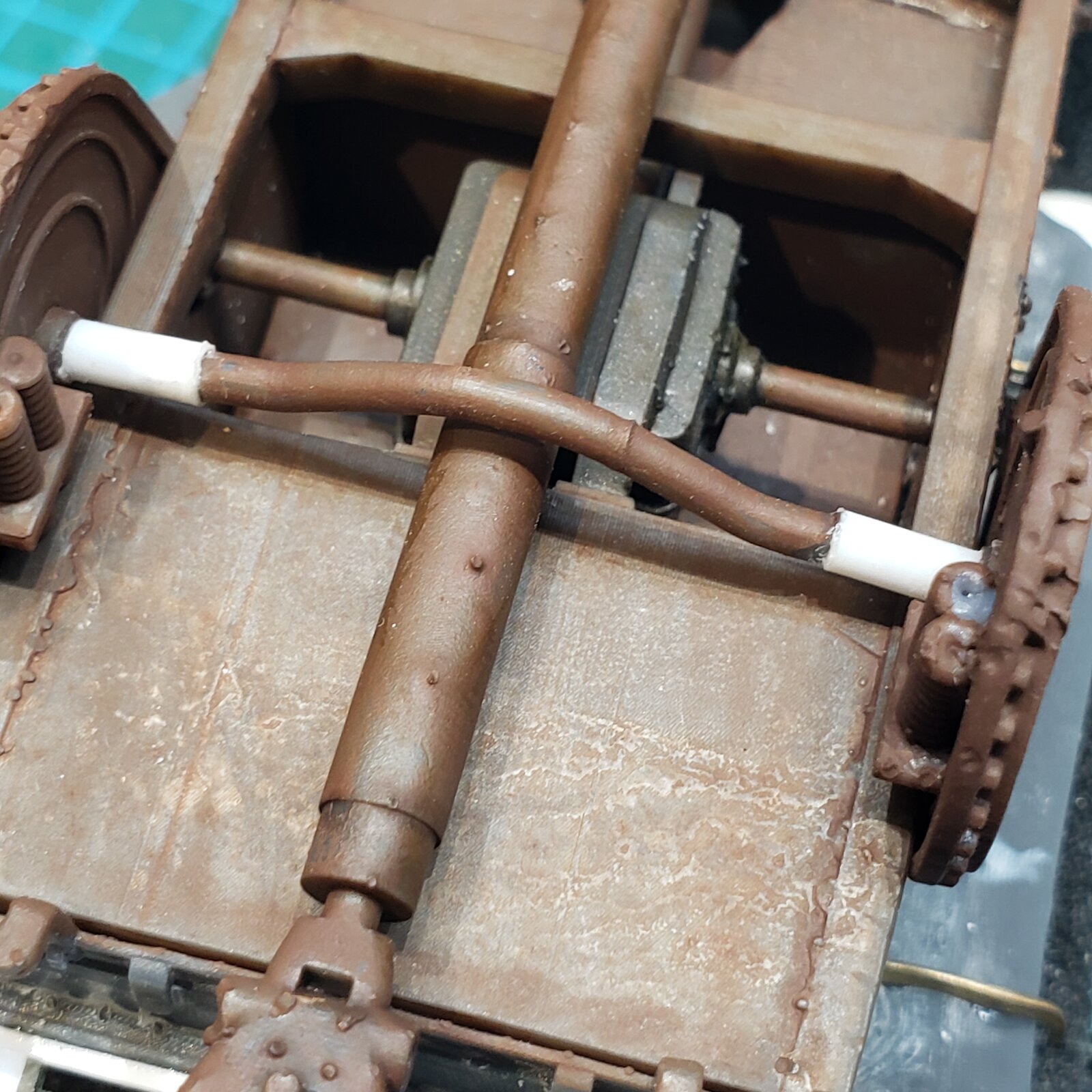

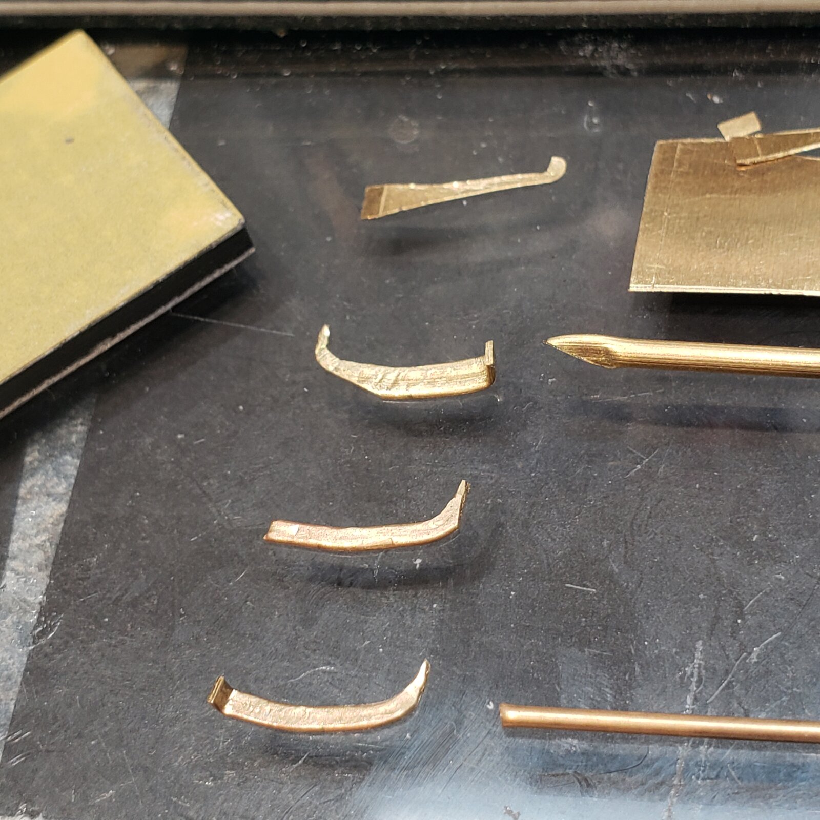

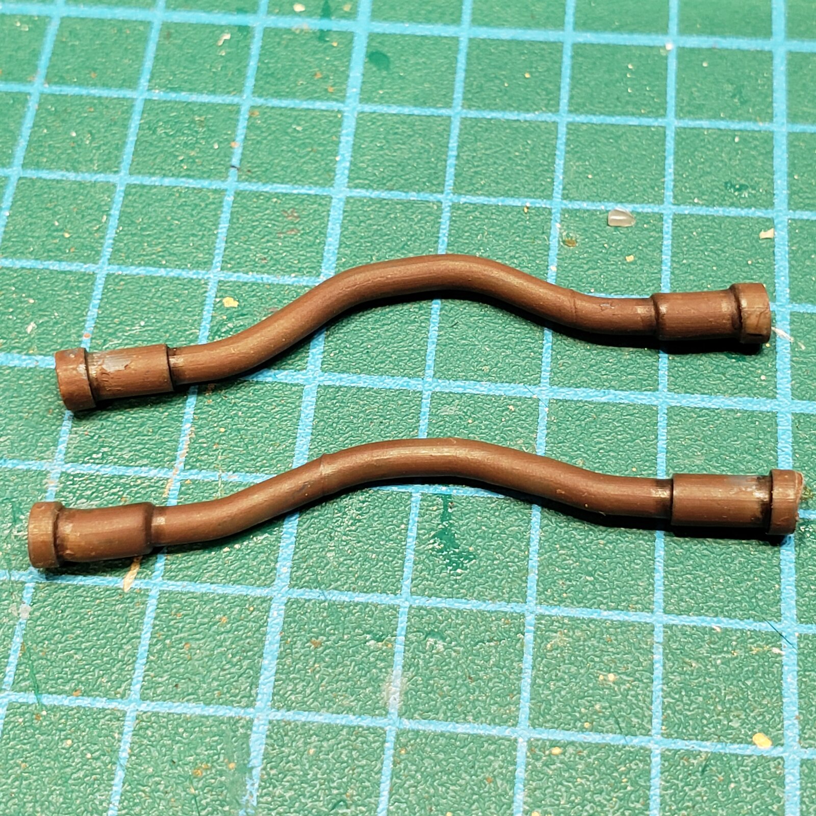

Yet more prototyping, this time for the fender strut/ supports.
First, cutting brass sheet, works okay, but getting the exact shape difficult, and I'll need 4.
Second, (not shown) trying to bend copper, then brass wire/rods: flattening and bending didn't work so great... the solid core makes difficult bending and flattening.
Third, medium size, hollow brass tube, easier to bend, good shape, can be sanded and shaped
Fourth, same as third, but smaller gauge tubing
Fifth, same as fourth, but bent and then hammered on my small hobby vise/ anvil: success! Now to make three more.
Unlike the cut version, with the tube version I can check the angle against the fender and adjust the bend. :cool:

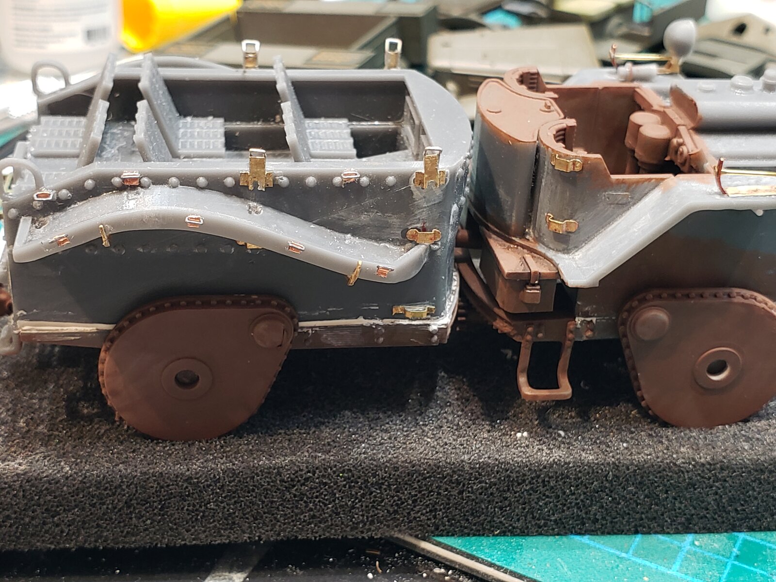

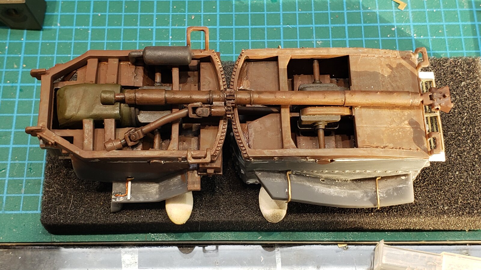

The front and back sections are joined rather tenuously by a drive shaft between the two axles, and that long shaft that drives the steering gears that rotate the the front and back sections counter directions via those teeth...
I had visions of the thing folding/ breaking in the middle so I put small brass rod through section frames directly above the steering gears.
The foam pad and makeup applicators do a good job of leveling and supporting while I work on the undercarriage.
Still have to complete the muffler, and add the 4 wheel gears that the wheels will be attached to.
You can see the fender supports, flat brass in the back, polystyrene rod in the front, as well as two rectangular holes in the back fender that the tarp posts would fit through on both sides.
I'll have to add all my little brass brackets, then prime the top and paint before adding the wheels.
complicated, and probably somewhat fragile, way of steering a vehicle
Yes, and when you think that the front and rear sections can rotate through that center axis so that the left wheel us higher or lower than the right (and it that might be shifted in a turn), it is a wonder that the design is for a 'heavy' tractor!
The centre column has the hitch on the end, so it is taking the brunt of the forces...
