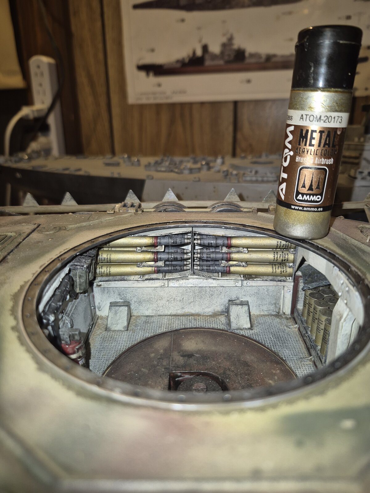

This is probably the best I've done, looks good enough for me.
I used this brass paint, then washes with some Vallejo dark browns. Took a scrap of sponge very lightly dabbed the brown color on some more. Drybrushed lightly with some off white and very little silver.
