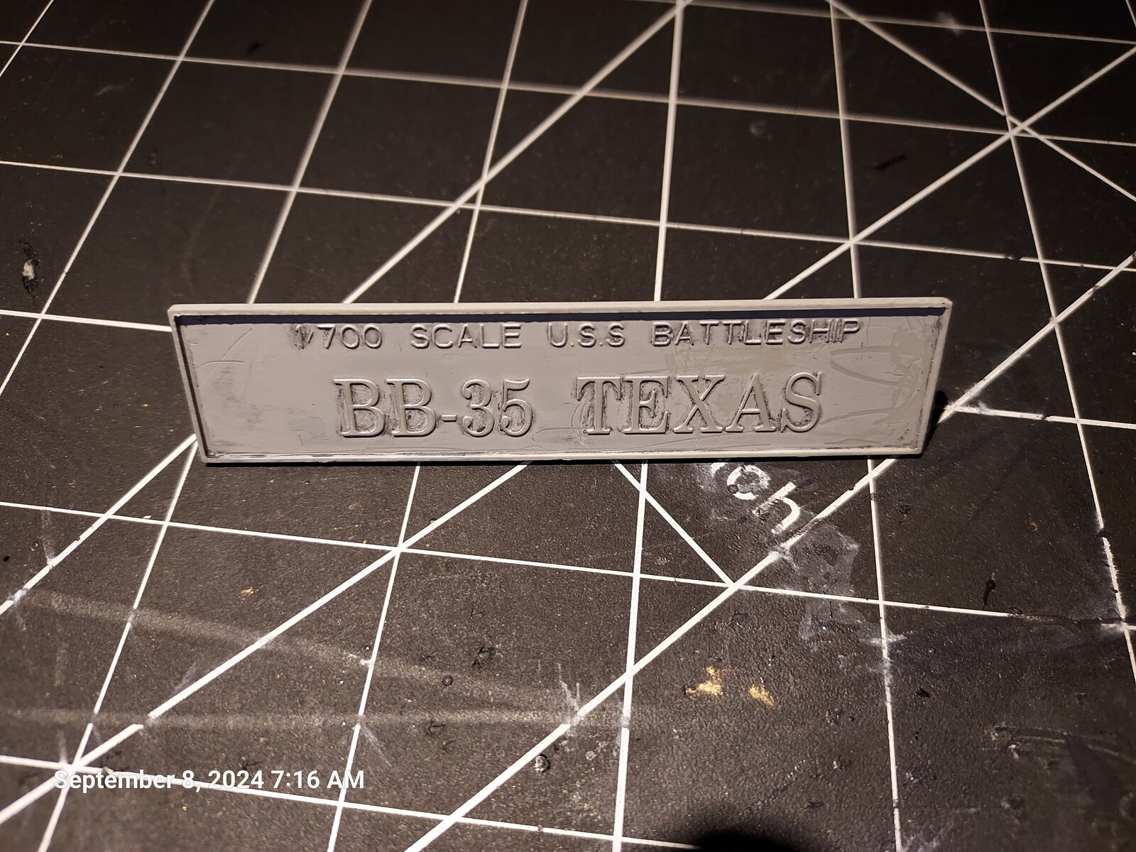

I was having a hard time painting some raised lettering. Had to repaint the whole base color again 2x because i ran my brush off the letter.
Then i found this tip
Do you have a tip to make it easier, share it please.
sadly it does not work as well as i expected.
I just learned something but i am not sure what that is yet. After i painted over the last failure now the letters show up better.
So is the paint translucent or what, i dont quite understand yet, but i love the look on the letters that are effected.
finally back to bare plastic, i will start over again

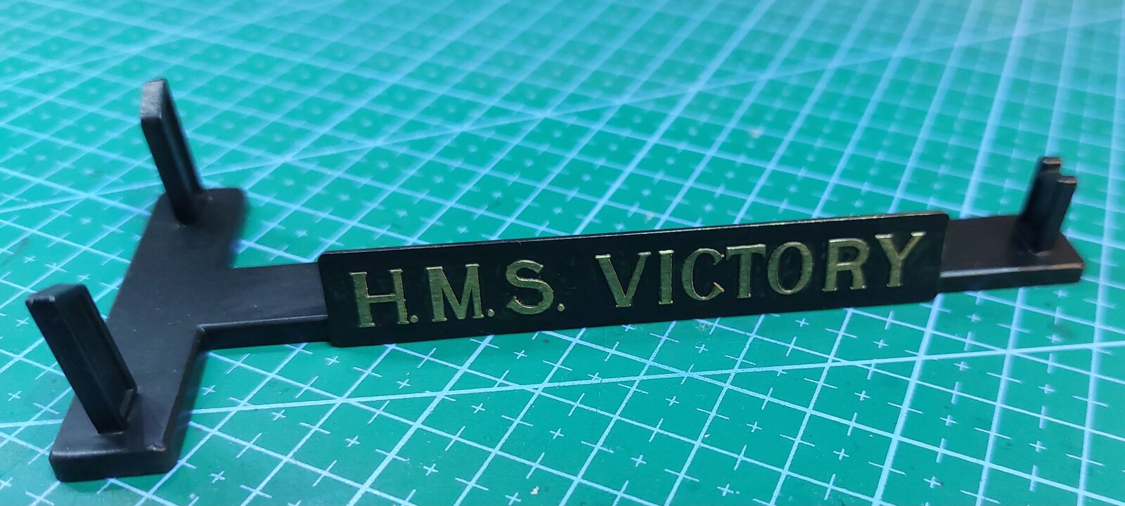

When I did the victory stand I sprayed the base gloss black, then dry brushed gold over the letter's. Then mixed up a watery black gloss to kinda flow between the letter's. After 2 of the watery coats it looked OK. Just my way of doing it, probably loads of better ways. Pantherman

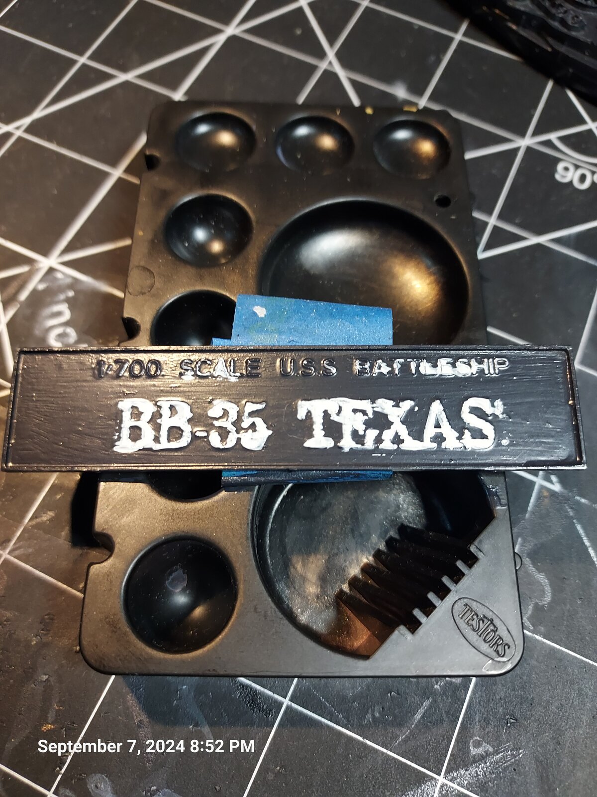

well i sat and thought about this last night. Thought i would attack it from and old school perspective.
We used to use rubber stamps so i setup a test by outlining the part and filling in the middle with paint on paper. Then placing the part face down and pressing.
However the edge is slightly deeper than the lettering so none of the letters got any paint on them. Something else the MFG should have considered. So i may sand down edges on my next try.

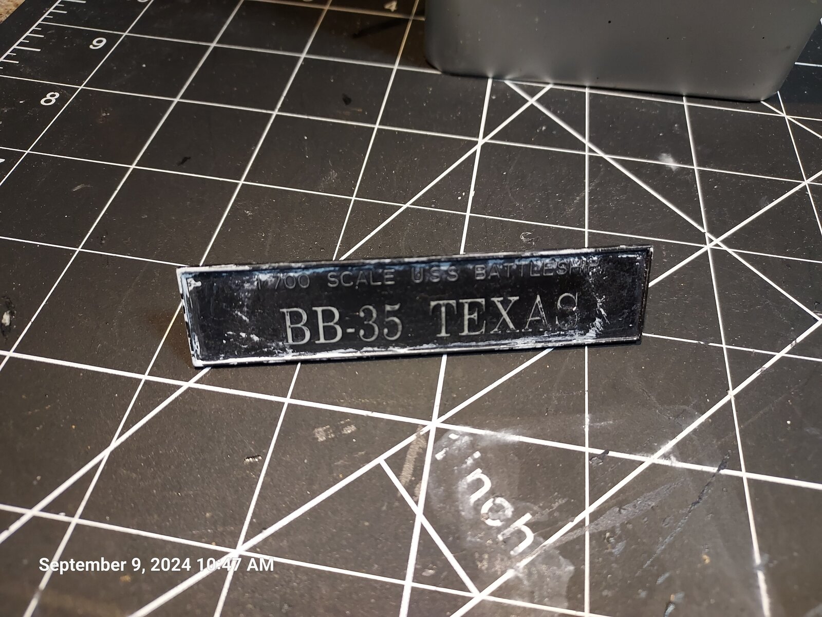

But for now its soaking in alchohol as i tried the wash deal and ruined it. Even with a coat of laquer clear over base color it could not be saved.
I will try again but at the moment i am fairly discouraged.

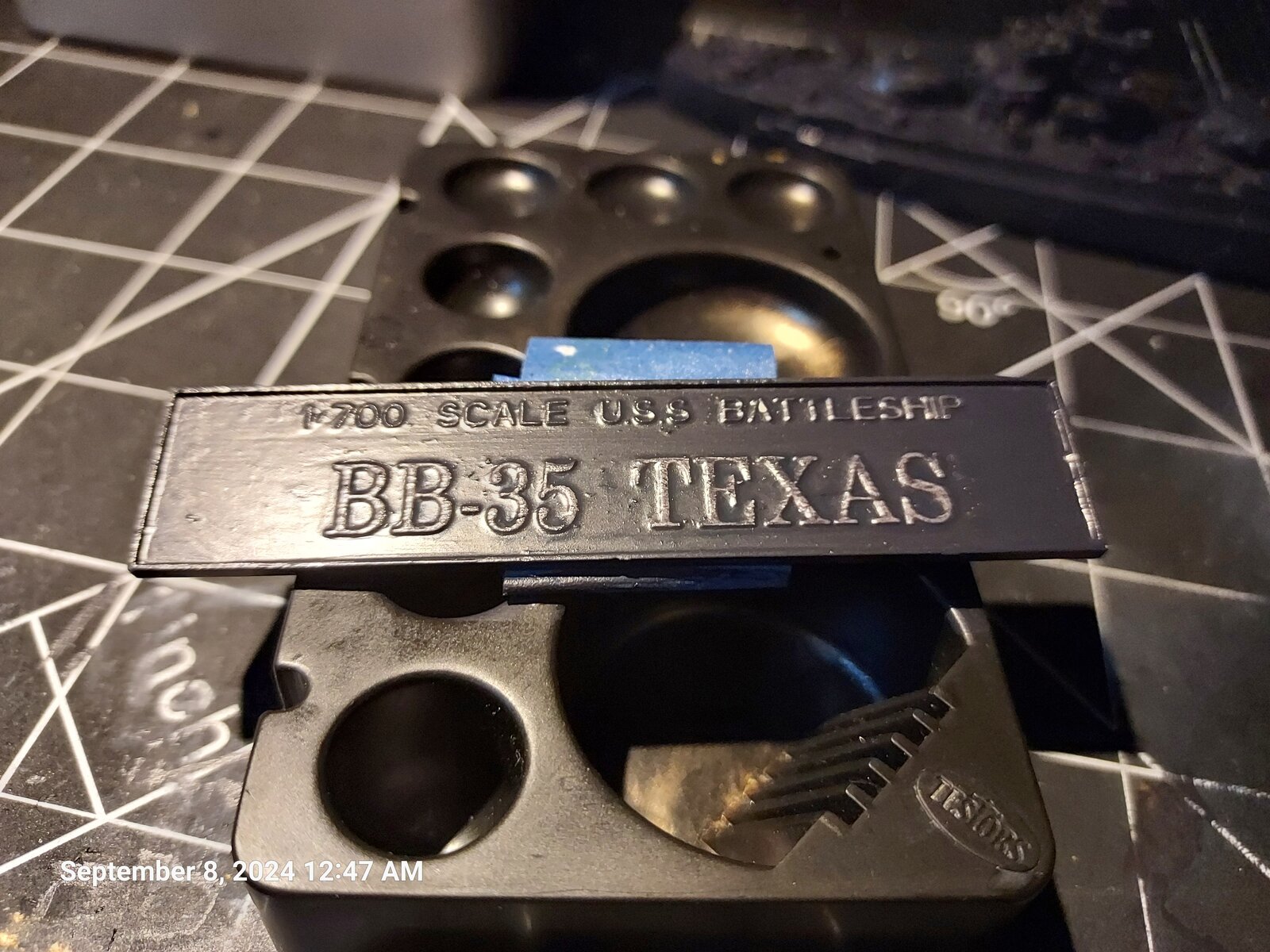

I am going to try the chipping effect. I have black primer on it, then ill spray the front with gold paint, then hairspray, then black over that. Hopefully i can be precise enough with my water brush to remove the black to show gold under it. If this does not work i will take it down to bare plastic again and make myself a custom print roller and roll it over the letters. :)
And if that does not work ill try the mask, as it should be here by then. :)

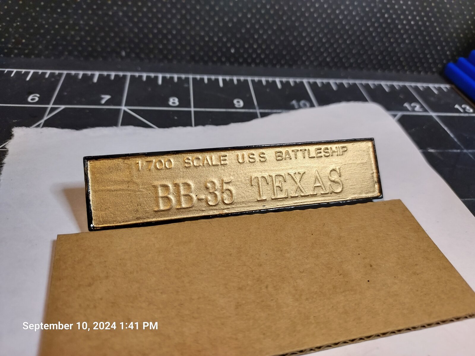

i decided this morning that i like the solid gold front and so even though i had wanted more detailed lettering, i have reached a point where i can live with it.
Now on to pirate ship building, parlay
Dry-brushing is a technique where you dip your brush in paint, then you draw it across a piece of paper towel, or some other material, to remove as much of the paint as possible, leaving just a small amount. Then you drag the brush over the surface, just enough to hit the raised relief, in this case, lettering, and deposit a little bit of paint on it. It's a common technique for weathering, to replicate dust accumulated on a surface, for example, or for things like smoke staining (eg, exhaust, smoke staining around a gun muzzle, etc).
On that plaque, you could also paint your brightest metal color to pick up the raised lettering, then use darker shades of the color, very thin, almost a wash or a glaze, and flow it over the background. You achieve the look of a brass or bronze plaque that's exposed to the weather, but the raised lettering remains bright.
