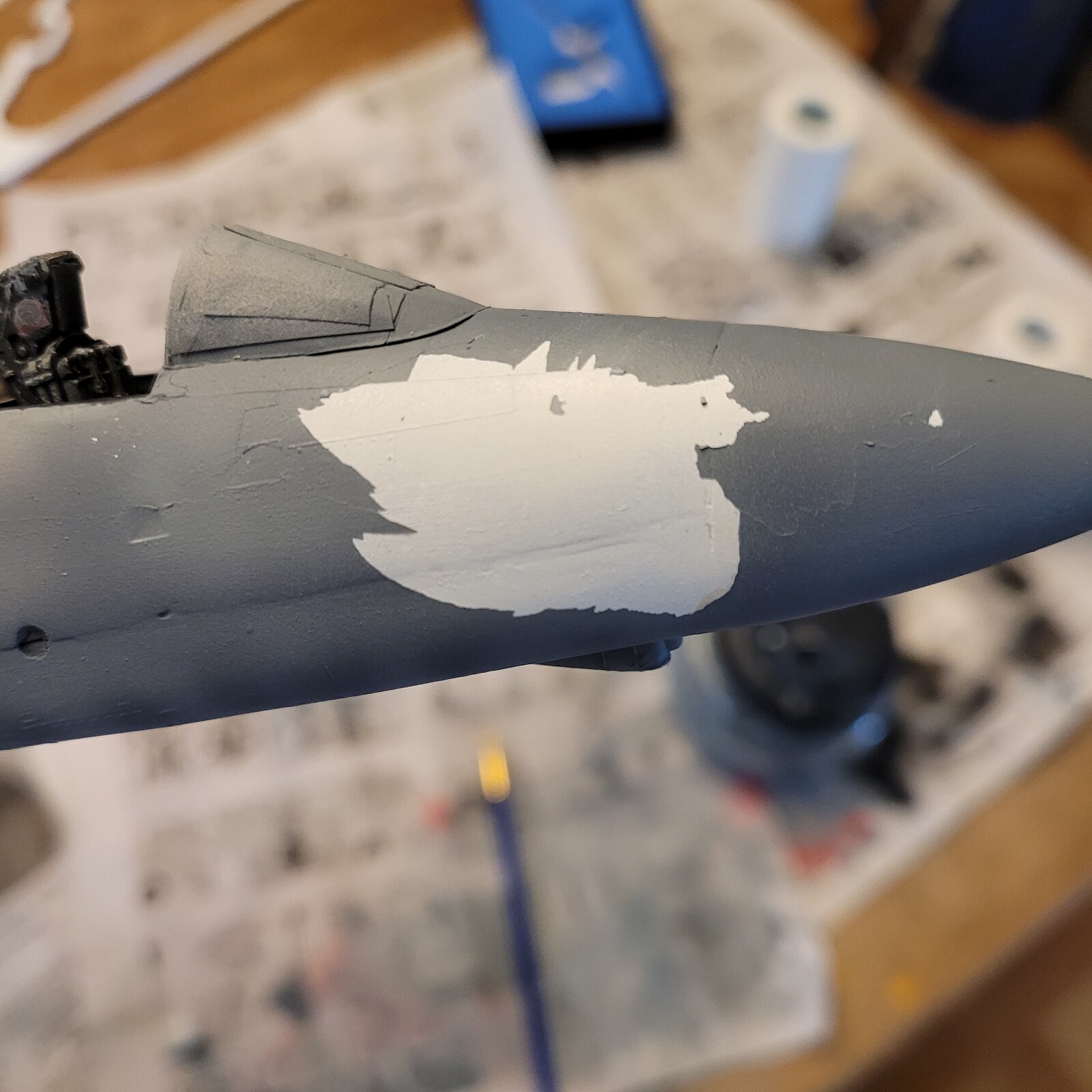

Low tack masking tape pulling off paint.
lacrosse dad
Active Member
Oct 16, 2024
116
Alright, as a rookie I've done this twice now. Model in question is the terrible F-14A from Revell. Brother asked me to build one for him. Using Mission models white primer and Vallejo model air paints. First time I thought I didn't wait long enough for masking but 14ish hours later using what I thought was less tacky tape the same thing happened, tape removed paint all the way to plastic....what am I missing. Disclaimer, I do not wash parts before painting....go
I'm not a fan of Vallejo Model Air paints, either. Though others are. I'd rather use an enamel or even a lacquer for an application like this one.
I found that Mission Models paint scrubbed off the model when I applied a wash (of acrylic paint plus water) over it. Somebody then told me that some people like it for this, whereas I decided to not use it again …
For the overall base coat, I prefer Tamiya or Mr. Aqueous acrylics, because they adhere well and cover well.
I've never really had a problem with paint peeling off but I most of the time use tamiya rattle can primer without washing the sprues, if that stuff fisheyes on the first bit I prime I will wash them
What are you missing? Lacquer primer and paint.
I don't know a lot about the different types of paint as of yet, nor have I tried to shoot them, but my workspace is pretty enclosed and not at a position to use anything but acrylics yet.
Understood. Then you may just need to do the best you can with making sure you are laying the acrylic down on a clean surface and then letting it fully cure before taping.
I'm assuming you are using masking tape meant for this type of thing. Does not have to be the expensive tamiya brand, many have luck with yellow "Frogtape" that you can get at Lowes or Home Depot.
One thing useful for masking tape (sometimes) is pressing it against your forehead for a second before putting on the model. That tiny layer of oil helps reduce the tack, but not too much.
Another thing, you should allow the paint to dry for a while, say 24h, before putting tape on top. Even though it feels dry to your finger, it might not be fully cured.
I'm a strong proponent of washing the parts of the model before assembly/painting. Mold release does not play well with acrylic paints.
Also, even the supposedly "fast drying" acrylics need time to cure, even Tamiya and Gunze. I use Vallejo almost exclusively, and allow their primers to cure 24 hours before overpainting or masking. Same with the top coats. You can accelerate curing with mild heat—I borrow our heated, forced air food dehydrator if I'm in a hurry.
Reducing the stickiness of masking tapes is best accomplished by applying them to a clean surface like a glass or hard plastic cutting board, press down firmly, then remove and apply to model. Skin oil does not play well with paint coatings.
