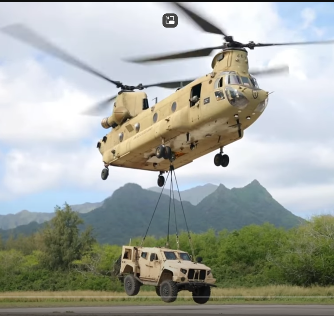

I still don't understand the hot water thing. These have a LOT of curve. What I want to know is what if I swapped the rotors front to back and flipped them upside down... Maybe that would work? As you can see the curve is huge! I lost it, but I had a picture of chinook blades that were bent even further down at the tips.
I don't understand what you don't understand .
Submerge them in boiling water .
at a minimum of 195F they will become quite compliant .
Cooled , the plastic will remain in the new configuration .

Flipping them may be the best way to go. Wait until you have your kit before putting too much more thought into it. Don't do anything with boiling water. Boiling is WAY too hot for plastic anyway.
Study your instructions and wait for your kit.

I'm kind of in your boat... Flipping them and not using boiling water...
To reshape thermoplastics they need to be at what's called the glass transition temperature ( Tg )
the Tg for the polystyrene used in these kits is 212F ( 100 C ) ,, coincidently the same temp as boiling water .
Those blades are so thin they won't need to much time in the boiling water .
15 , 20 seconds ?
You can't overheat them since the boiling water will never go above the 212 , but I'm sure you know that .
Wear Gloves , ;)

The only reason I don't want to do the hot water thing is because I don't know where to begin. Flipping the blades upside down might make them have too much curve along the length of the blades. Also, I'm afraid of not getting them all the same curve which leaves me putting the blade on the counter with a flat brick on top of them all at the same time. I have been putting a great deal of time in this, like Ten hours a day, and I understand both sides now.
It took time but now I see Eagle 1 saying to just flip the blades over and that is easy for me to understand. It might take me a week to understand the hot water thing fully but I might start boiling water. All in all I'm scared of ruining the blades and having to buy another kit that costs $112.00 because I was doing something I don't fully understand.
Pretty sure you won't be able to just flip the blades over due to the architecture of those parts .
Maybe not
Maybe so .

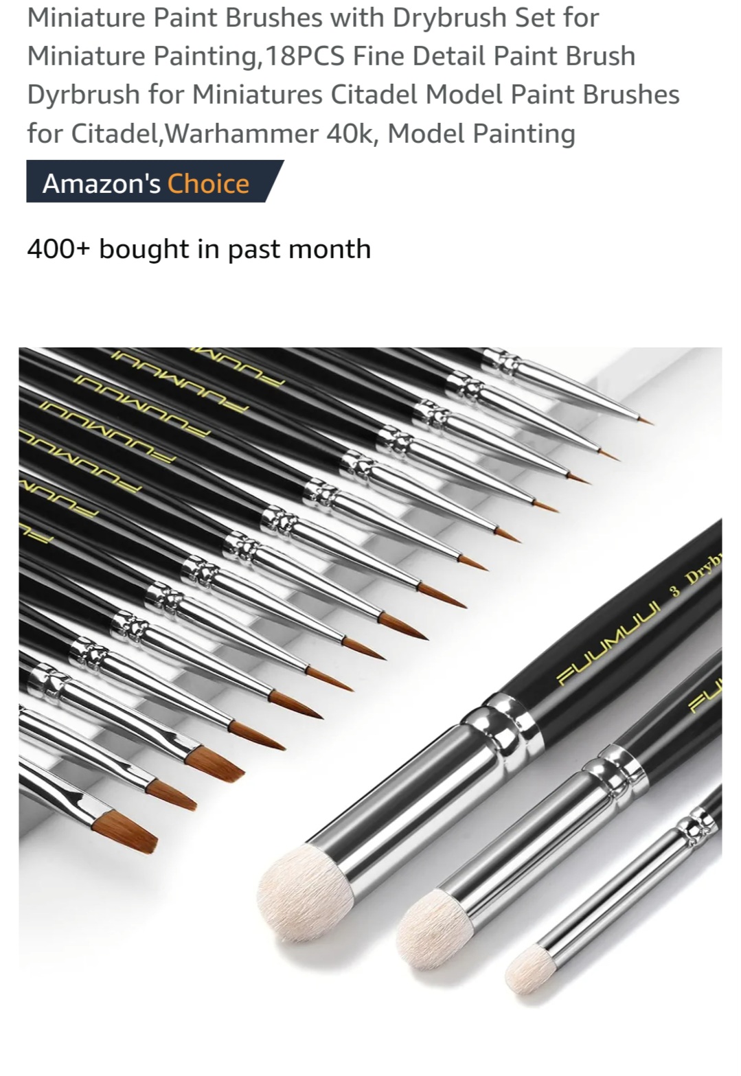

Okay I think I will have to wait till I get the model Chinook to see if can fit the pedals on. I'm getting over being sick and my caregiver might take me to Walmart where I can buy a fan brush.
fan brush paint brush.
They're expensive but if I remember right they won't leave brush marks. Anyone try painting big parts with These? This one was $12.00 and is no sale for $6.
