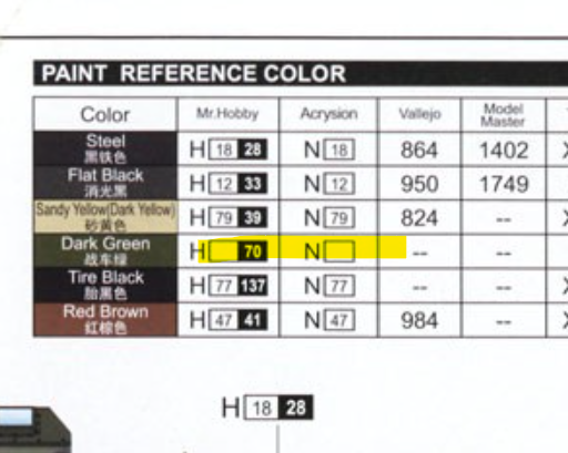

Where would I be getting accurate spray paint colors. I'm trying to come close to the real helicopter colors and very accurate with the JLTV. There's a paint color matching thing for the JLTV but it is too small for me to read.
Where do you find painting instructions? Is there a place online that has them?
EDIT:: JLTV-GP M1278 tactical vehicle. <--- has the images that are too small..
https://www.1999.co.jp/eng/10888610
Has full instructions , just click on those pages for full screen size .

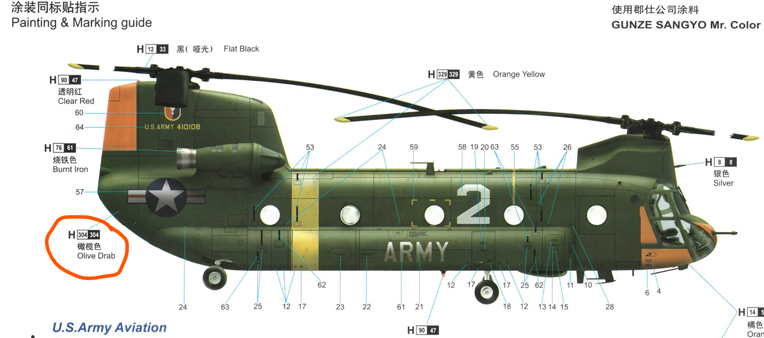

WOW!!! COOL! but it has an error or something one of the colors is missing I highlighted it in yellow highlighter
WOW!!! actual instruction kit for the Chinook is AMAZING@ I understand everything so far. I downloaded the PDF and I LOVE IT! After watching the video of people assembling the Chinook (CH-47A) I think I will have no problem assembling it. I bought it yesterday and it seems like a week has passed. I'm really happy with you guys on here!!! Timely responses for me, the noob that I am.... I see it all coming together!!! My dreams are coming true!

OH NO!!!! I thought that the ARMY helicopter version had brown on it for the main base color but In the instructions I downloaded from your link it's dark flat green! Olive Drab faded is more brown than green. Hopefully I can use the brown on the JLTV or something. I bought the closest thing I could get on the https://www.scalehobbyist.com/ and it looks like Medium olive green is as close as I can get to the picture I attached.

OH NO!!! there's no guide for painting the bottom!

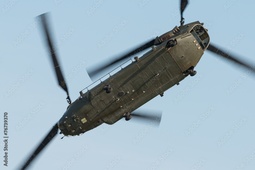

Thats fine to use Faded Olive Drab. I wouldn't worry about it. Look at the photo of real Chinook chopper.

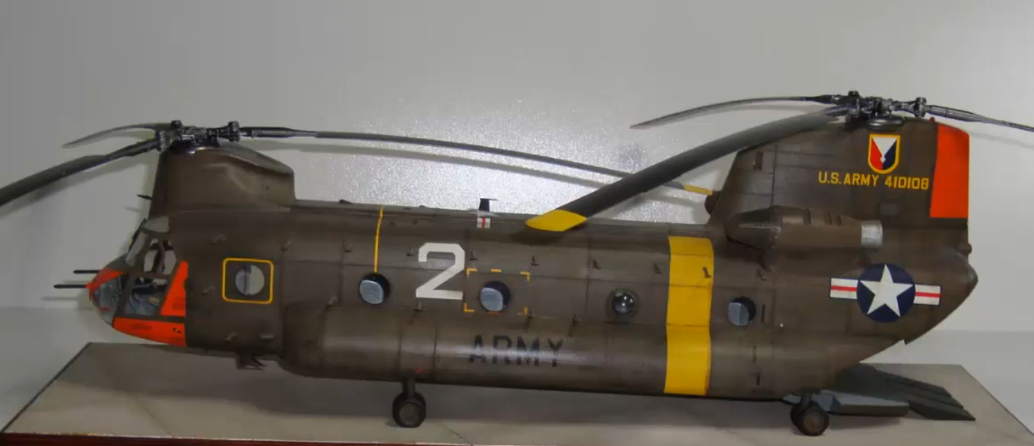

Is there a way to straighten the rotors? As you can see in this picture it looks like the rotors are drooping a lot. I want it to look like it is in flight carrying the JLTV.
EDIT:: Maybe flip the rotors over? Anybody tried that yet?
Dip them boiling water and you can bend them .
They'll remain in that new shape once cooled .
They'll cool pretty quick but you can run them under tap water to speed it up .

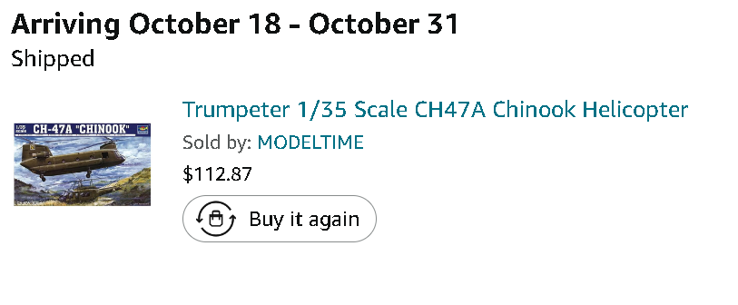

WOW! I was worried about it not looking like it was in flight. I can't wait for all my mail. Like I said before, I ran out of money buying paint and brushes. "Ran out of quarters for the shipping machine." I can't believe how inexpensive paints are.
CH-47A Chinook Helicopter

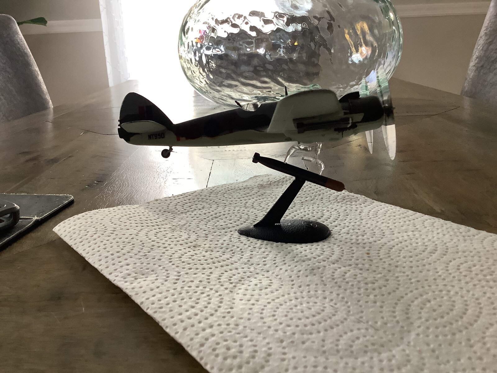

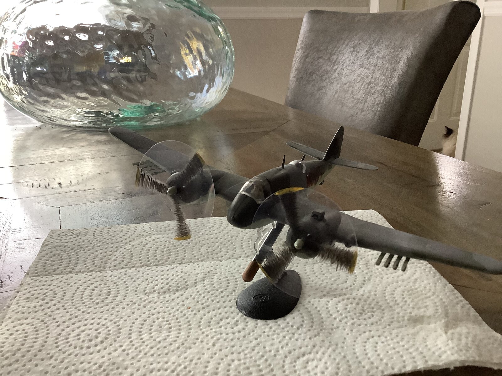

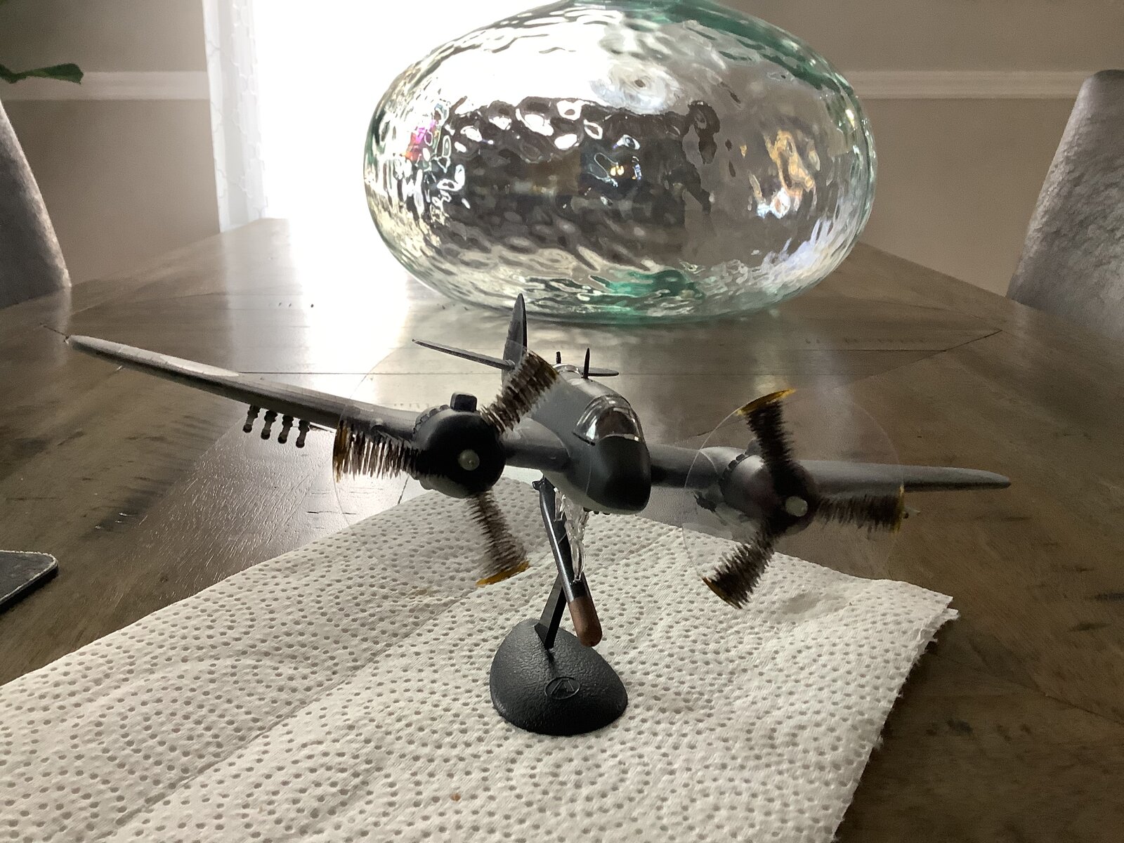

Here's how I did my Beaufighter as "in flight" ….
Vintage 1/72 scale Airfix kit; included stand. I added clear part from my scrap sprue stash. I wanted to display it as on final approach with torpedoe released. Pretty cool, huh?
It took a lot of thinking to get what I wanted.

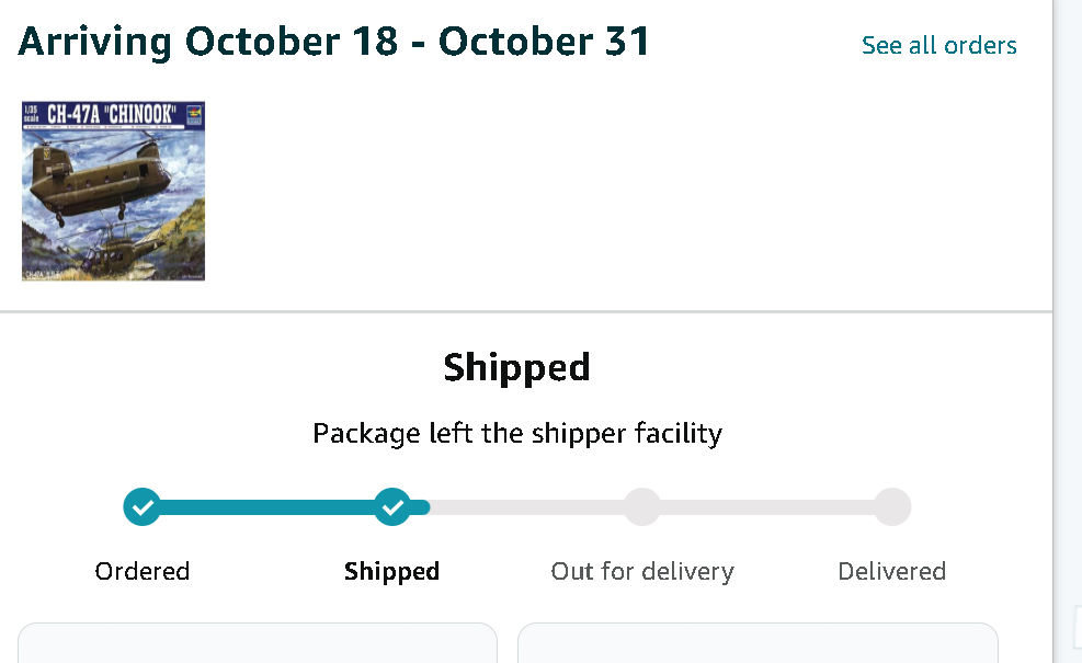

Thanks for the invisible propeller technique. The Chinook rotor blades only spin at like 250 RPM though and I love the blades in the kit. Like a still shot from a camera on a sports activity setting that catches a runner and makes him look like he is not moving. I think you mean Diorama because I went to suspend the JLTV from the Chinook as like a display? I THINK my paints will arrive before the model.
still waiting... might be a long wait but that's okay I can memorize the information in areas like WIKIPEDIA, ARMY lectures, YouTube and more just plain research.
