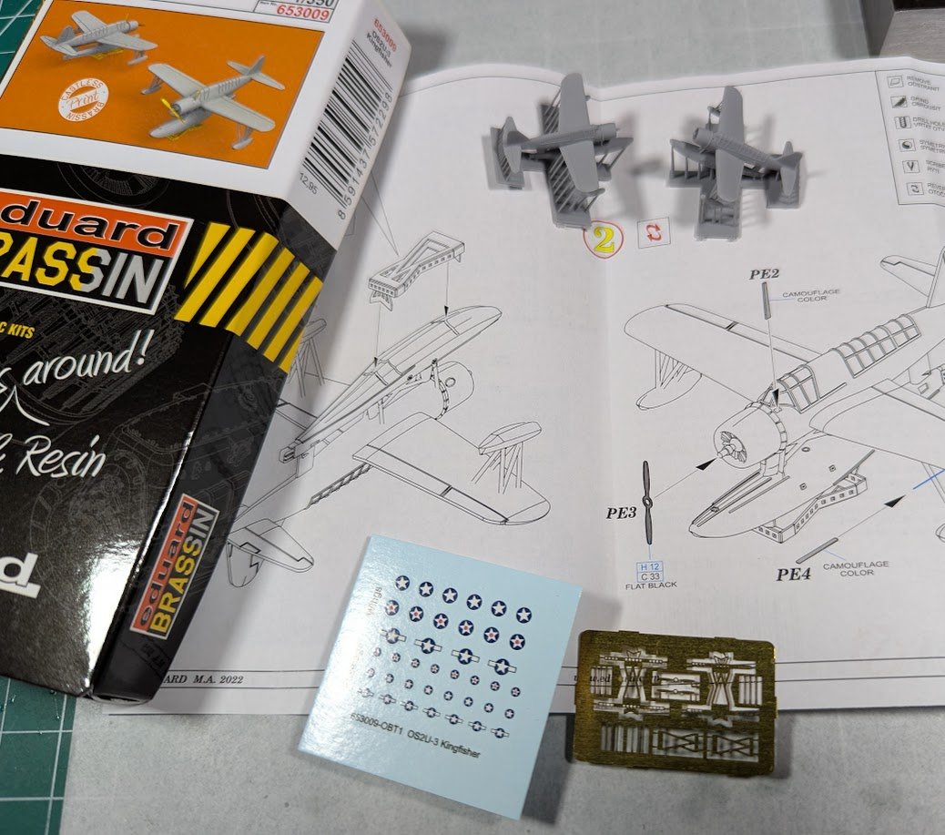

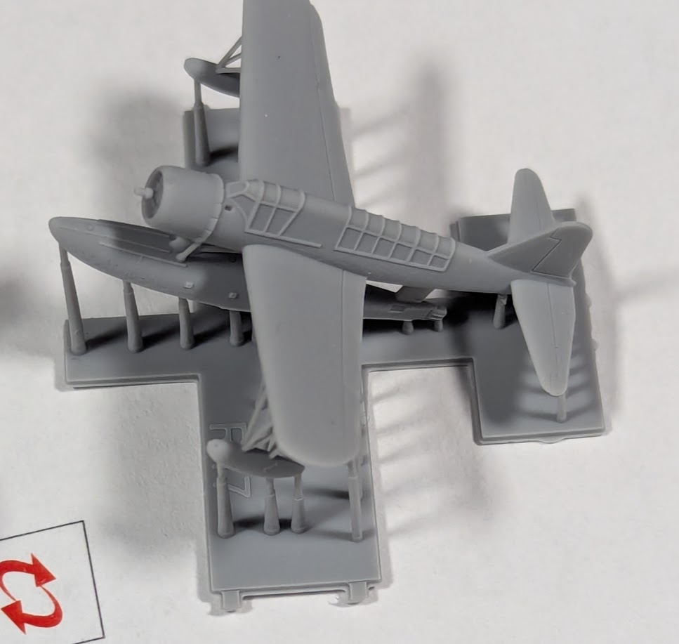

The Kingfishers came in, more PE and plenty of stickers, but the detail is really good.

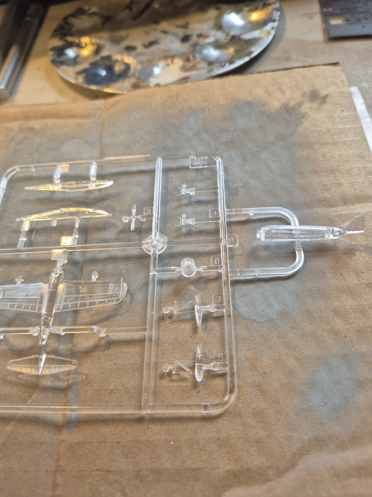

Just for general knowledge, Trumpeter's 1/200 Kingfishers in the IOWA kit are on clear sprues.
The Trumpeter 1/350th kit was the same. Mine was an older (BB-35) but I think they do that as a regular practice.
The argument in favor is it makes the canopies look better. But there are many arguments against. Mine fit VERY poorly. Clear plastic is hard to cut/cast/glue/manage in general, at least IMO. The clear part ended up fogged anyway, gray or silver paint would look better.
I thought I'd do well making them, aircraft are my main subject of modeling. But they came out REALLY bad.
I could claim they did not fit right, I could claim the casting was jacked up, I could claim there were not enough stickers. All of those claims would be right. But in the end I am the one who painted 1943 fighter (3-color) paint on them, which is wrong.
I'll show the old ones I ruined next to one of the new ones when I finish one.
That's because of the glue, right? Would that be CA , or Testors tube glue......or both?
I haven't messed around with clear parts since my thing has been armour. Would Elmer's white glue work without fogging I wonder.
I'll accept all the mistakes but...
Mine was 1/350th, so 1/200th might be different. The fit was not good enough for the top/bottom halves to fit and hold with benign adhesives. I tried white (PVA?) initially and a huge gap showed, so I went to the modern ultra-thin with the same result. So I escalated the affair and used CA. That held, but obviously fogged the "glass". To be honest the canopy bit looked okay that way, but the bad fit and wrong paint and incomplete decals killed the overall thing.
Well I'm glad @Edbert went into a bit more info about the clear plastic aircrafts...lol. I didn't want to come across as knocking the wind out of your sails. Clear plastic has always been an issue, hard to cast for tight fits and clean up if there is any flash. And forget about cutting wings to fold etc. I understand why Trumpeter went the cost effective route in clear instead of plastic birds with a small clear canopy.

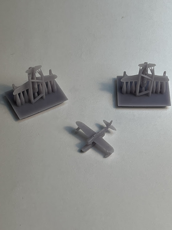

I prefer the YZM Models for 3D printed aircraft where high detail is wanted. There are some in 1/200 on eBay if you're interested.
1/200 OS2U Kingfisher
I got a long way to go before I get to the aircraft on this build, I appreciate you guys schooling me on this.
I really like the one you posted a link to that has the open canopy and pilot figure. I was thinking of getting some figures to crew this ship, so those planes would fit in nicely.

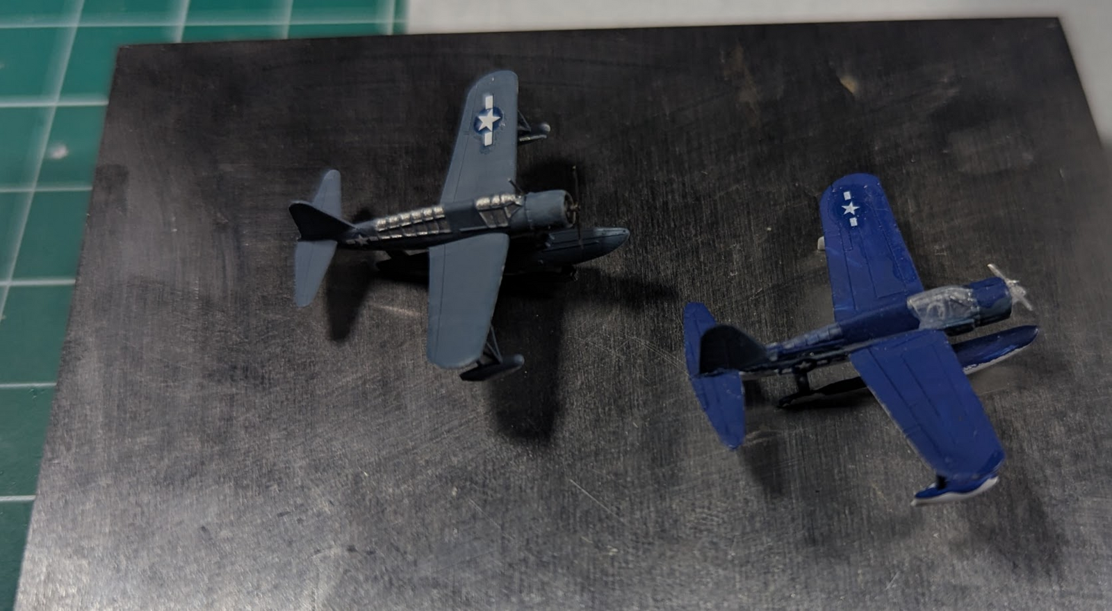

Just poppin in here to show the juice was worth the squeeze.
If by squeeze you mean effort. I think the silver (plain old XF-16) looks better as a canopy. I'll admit that the one on the right is not finished, I gave up on that, and the color being inaccurate was the final straw or kicker.
If you include cost in the squeeze calculations, maybe not, YMMV!

That silver canopy does look quite good. I may have to try using silver on the 1/700 stuff I am working on
Also, great color for the Sea Blue on that new one

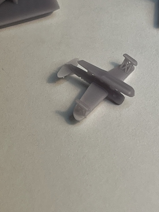

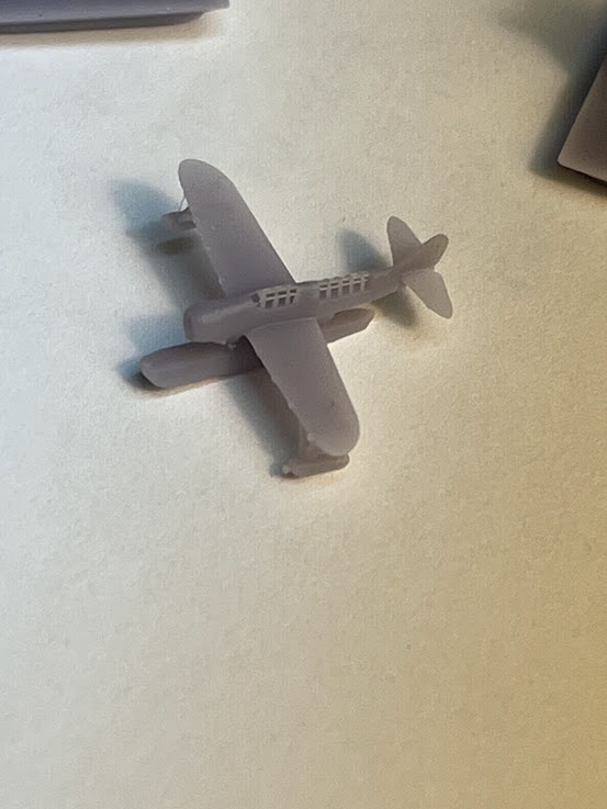

I never understood why the Trumpeter Kingfishers looked like they had flat fuselages and grossly out of scale wings. I have replaced them with aftermarket on every kit I built that had them. They are the same on this 1/700 Texas. I have some old resin one's I am using that look much better.
... nice!
Have been wondering about that as well... don't have a printer, but our public library has a bunch I could use for the cost of the material.
I'd have to figure out if the printer is good enough for 1:35 scale parts.
If they are FDM printers, then its limited on the how well they will print surfaces and fine detail, especially at small scales. I just bought a SLS resin printer a few months ago and I'm blown away on how fine of detail it will do. I just printed a bunch of deadeyes and blocks for a sailing ship project that are 1/8" in diameter and are nearly perfect. I do 3D modeling and printing for my job, so its all second nature to me.

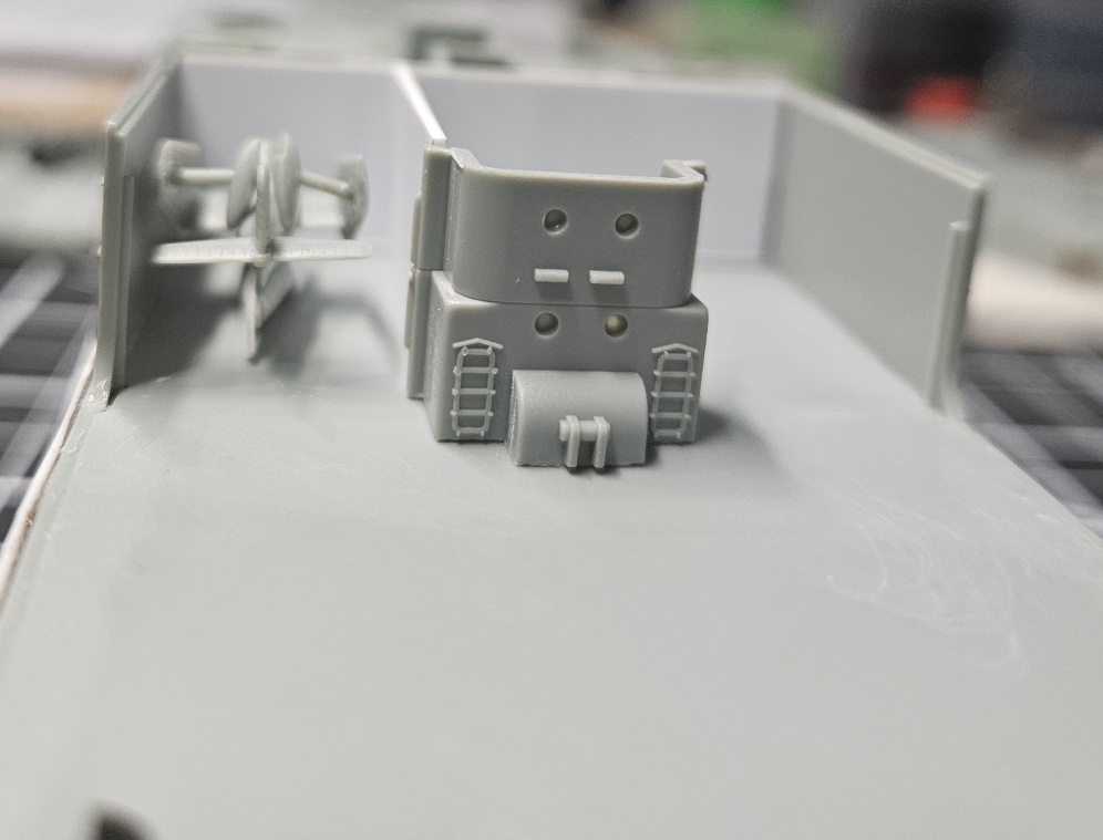

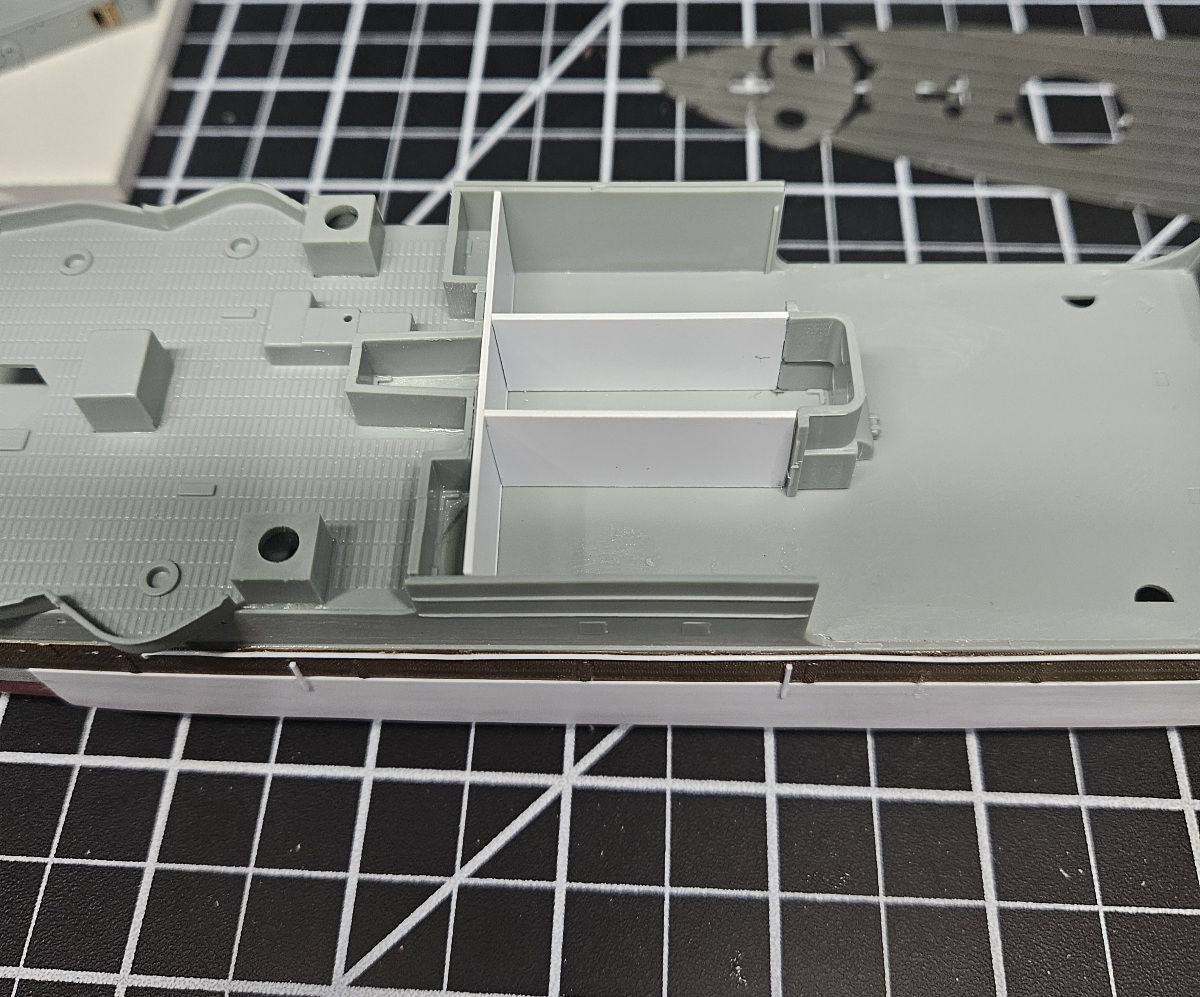

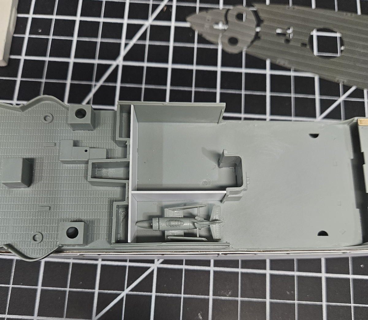

So it's been a bit since I was able to get back to the bench after being under the weather for a few weeks. I have to wait for my resupply of CA glue from Poland that's enroute as we speak for the finer photo etch details going in place, so it's back to the hangar bays to get it all modified to have open Bay doors and some SC 1 Seahawks, displayed.
There is no real clear photos or plans I can find on these bays, so I have to take much artistic license about the approach and details I add to this. I've had to modify the depth of the bays by shortening the kit parts, but luckily I have spares of these parts to play around with before I cut and fit the actual parts.
So there is two bays, and what I envision in my mind was that there is a workshop between them. I will open lead between watertight doors that might be seen from the hangar deck. I've also used the kit provided seaplane to mock up for the two that will be in stowed configuration and one on catapult ready to go.
Anyway, here's the measuring up and mock up of the bays walls before I get them fitted and detailed up. I may have bitten off more than I can chew going this route with the bays open, but fingers crossed.
