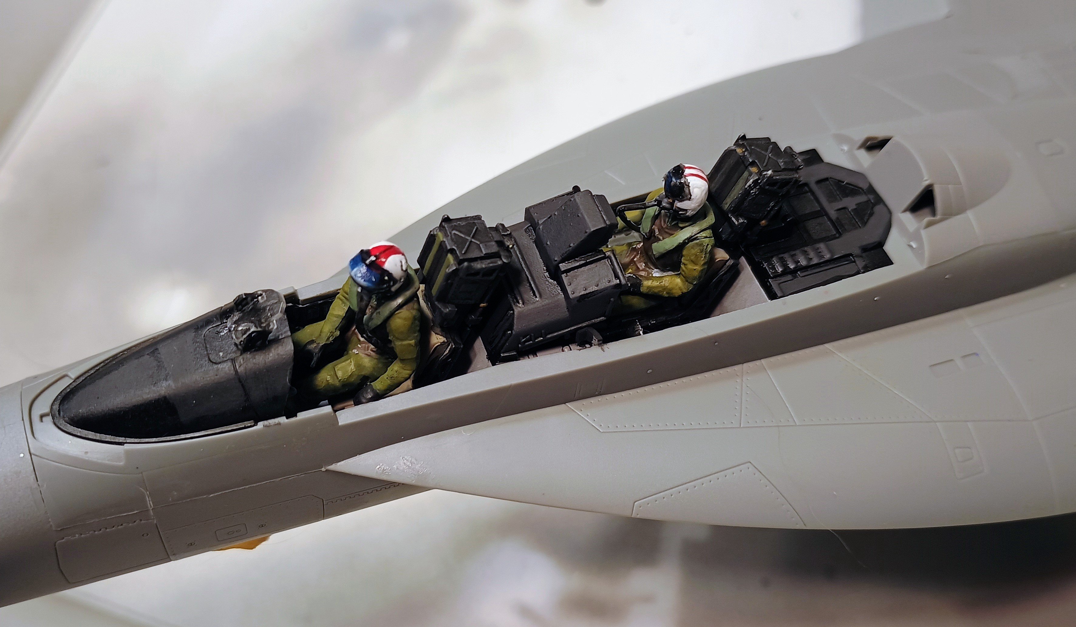

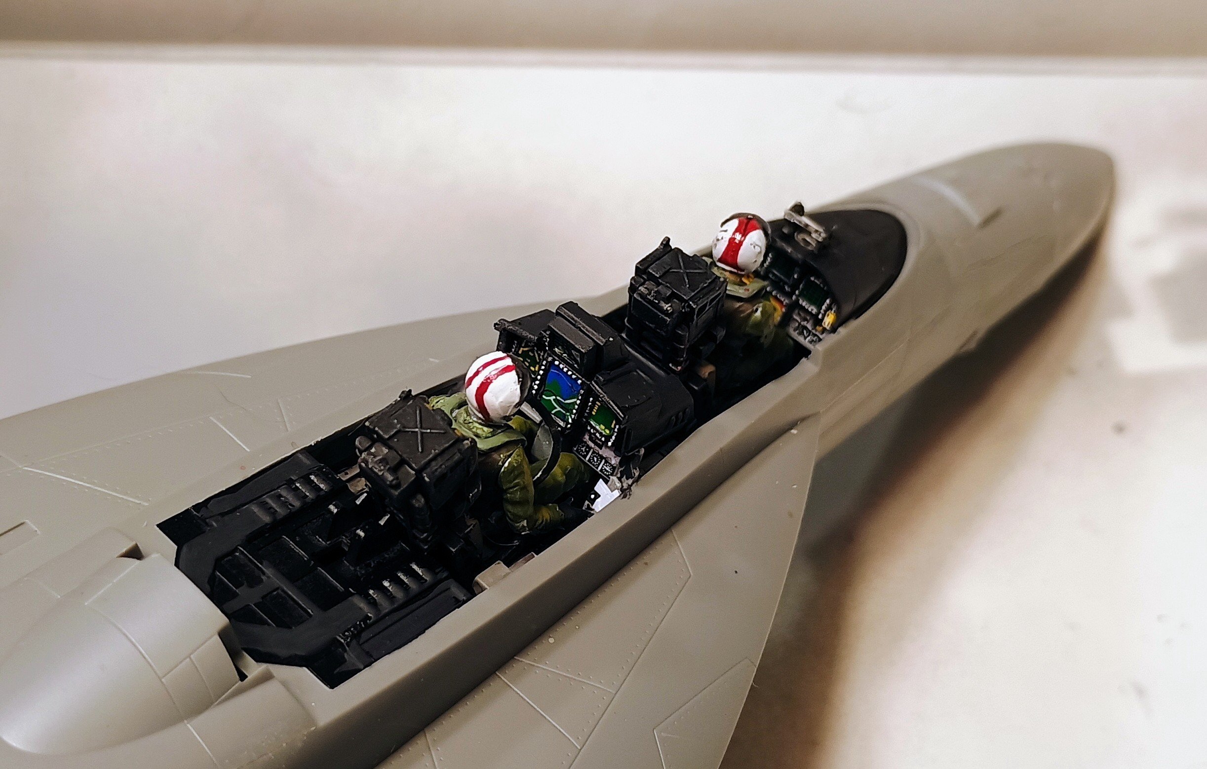

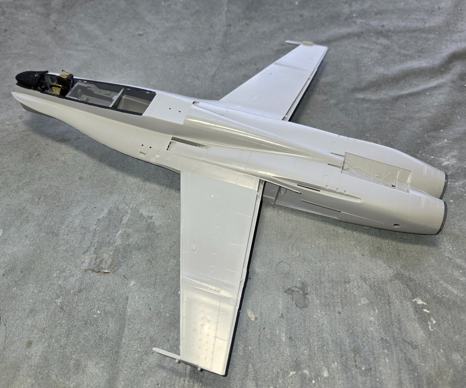

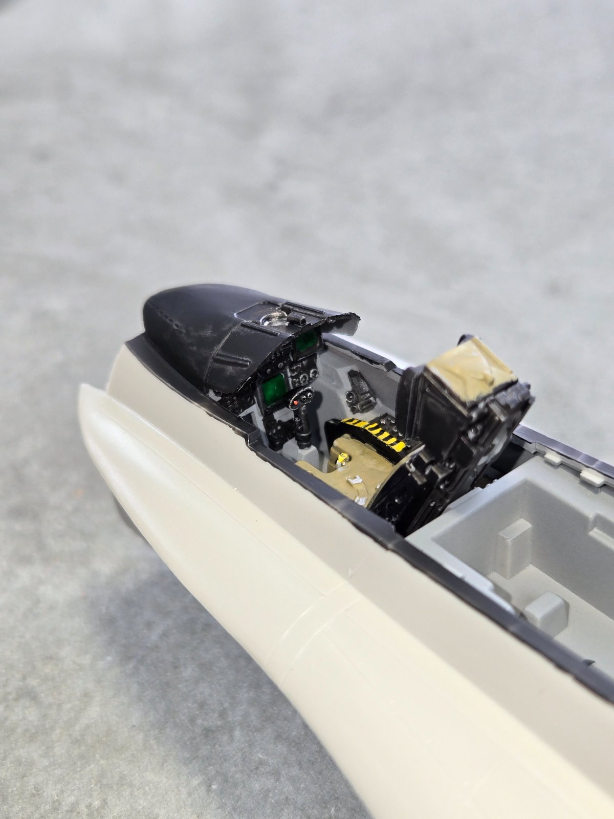

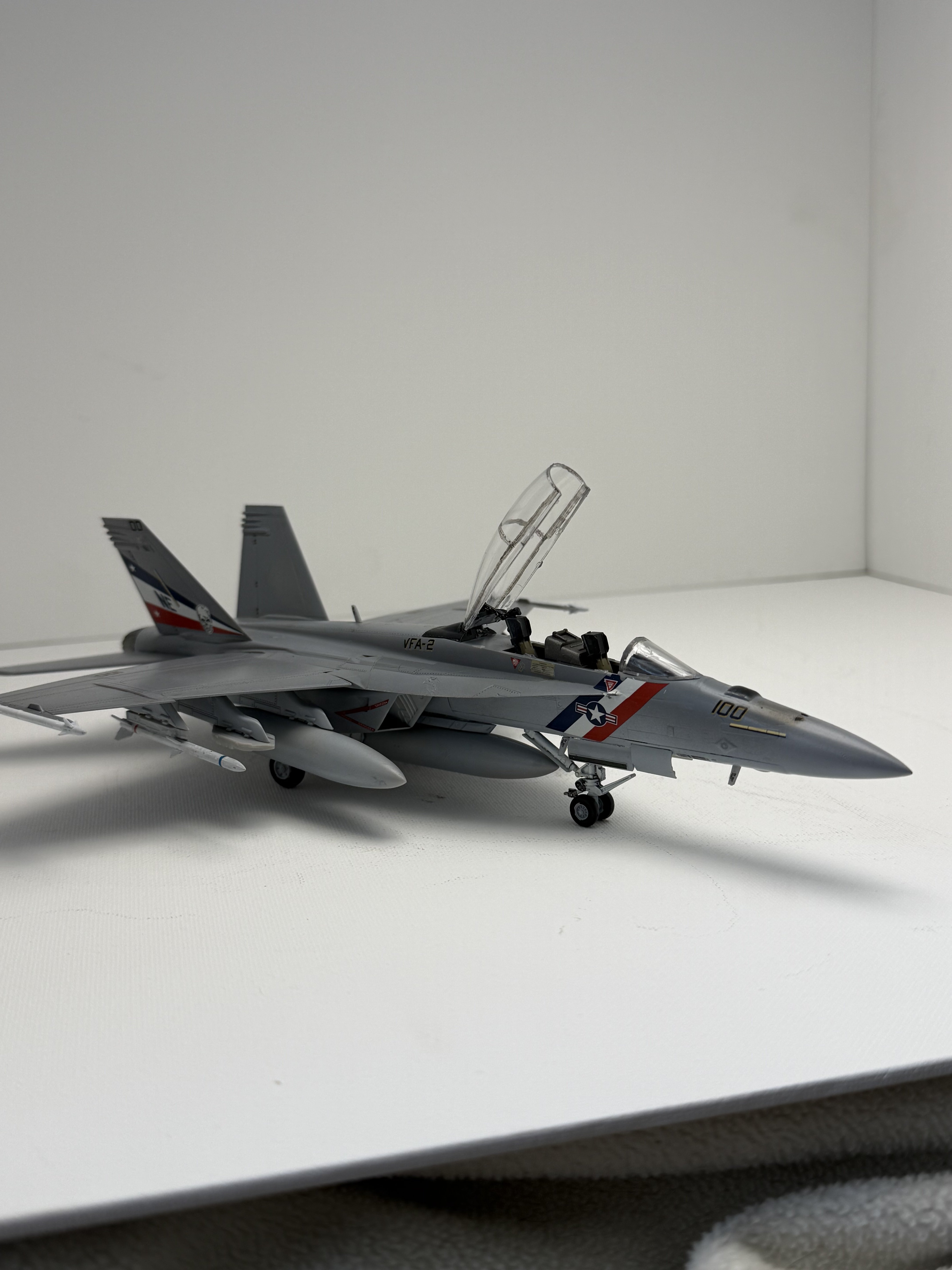

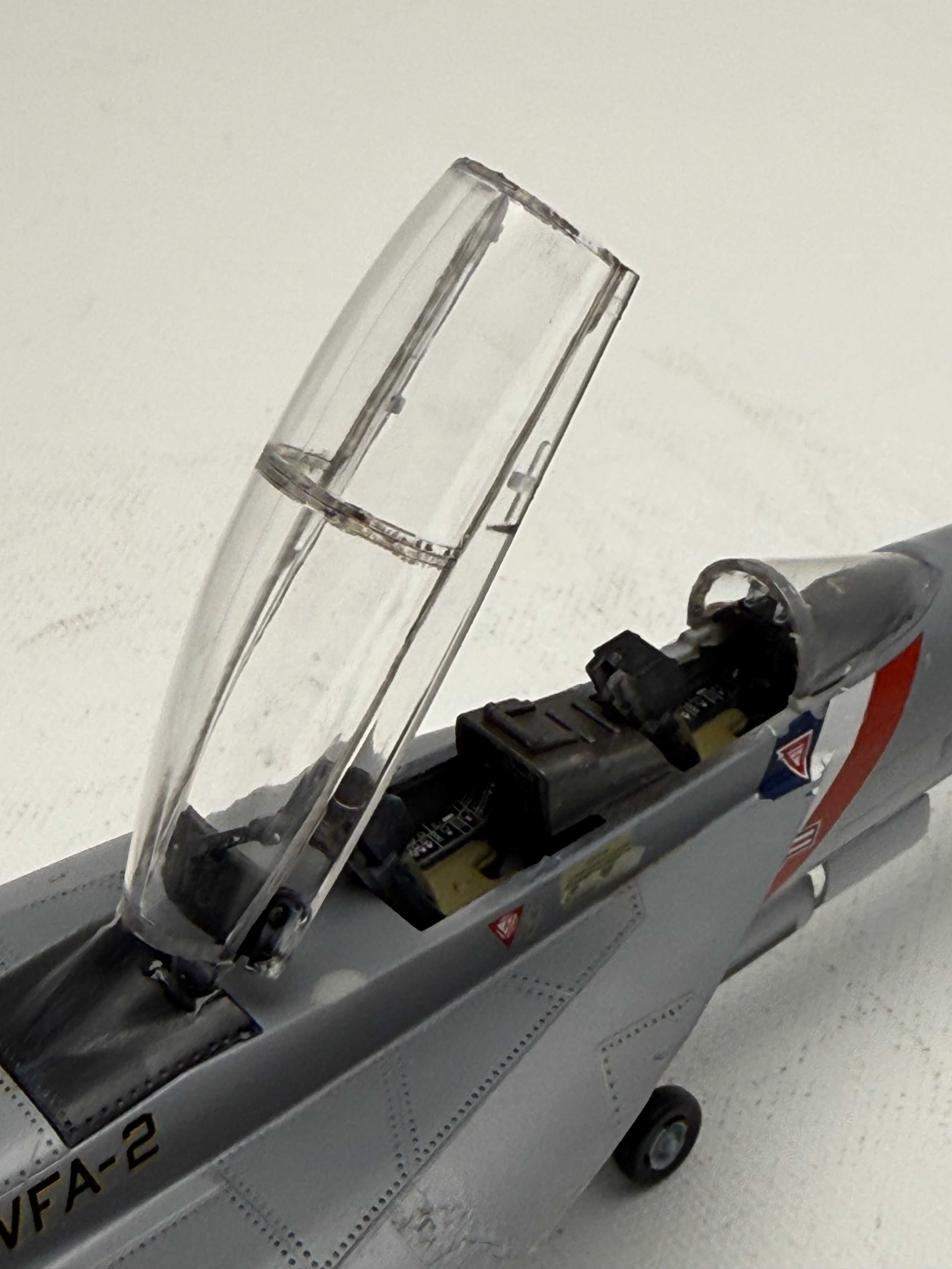

I've finally gotten started on my contribution to the group build. It's going to be an F-18C, so that explains the empty rear cockpit.

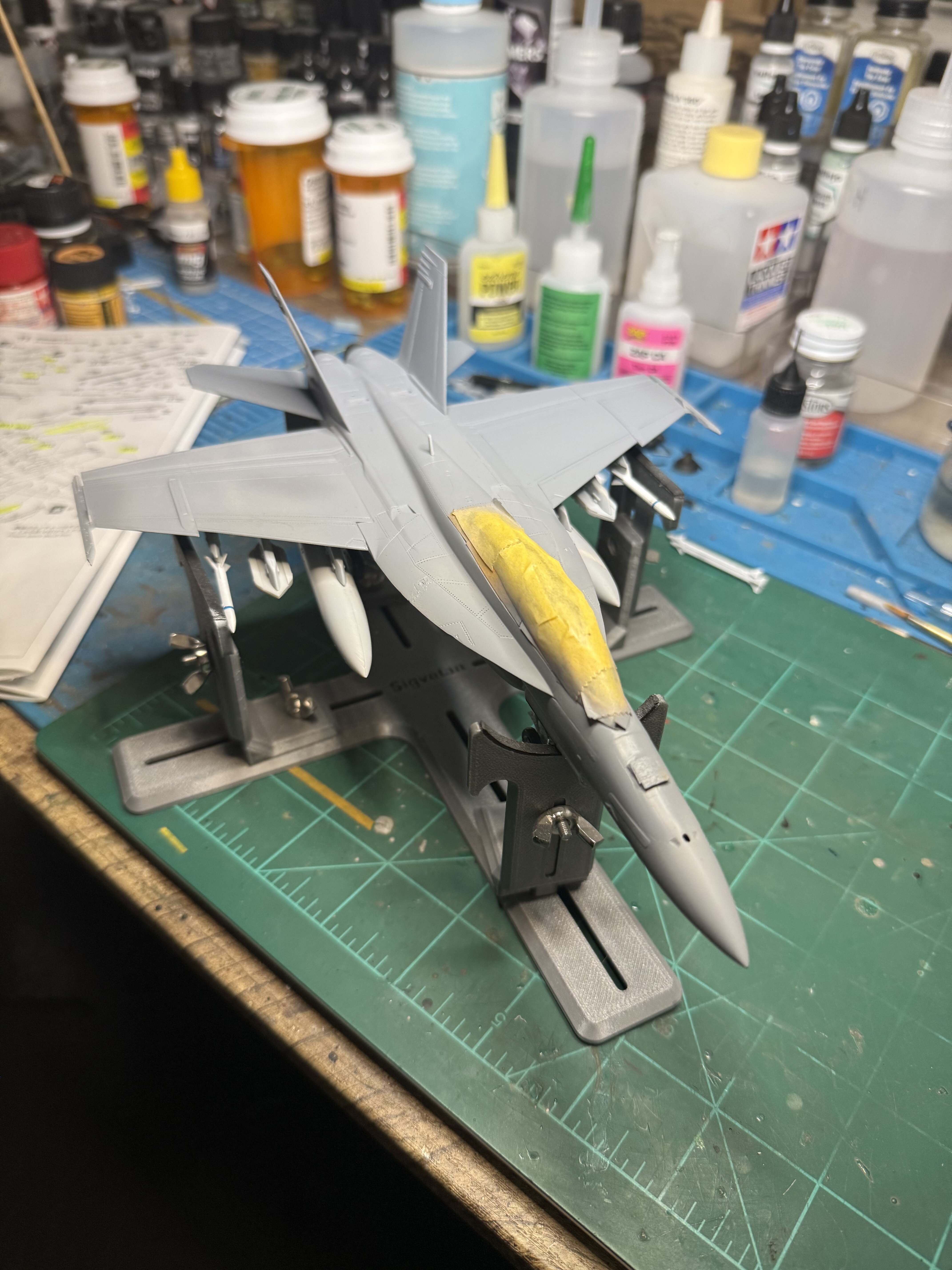

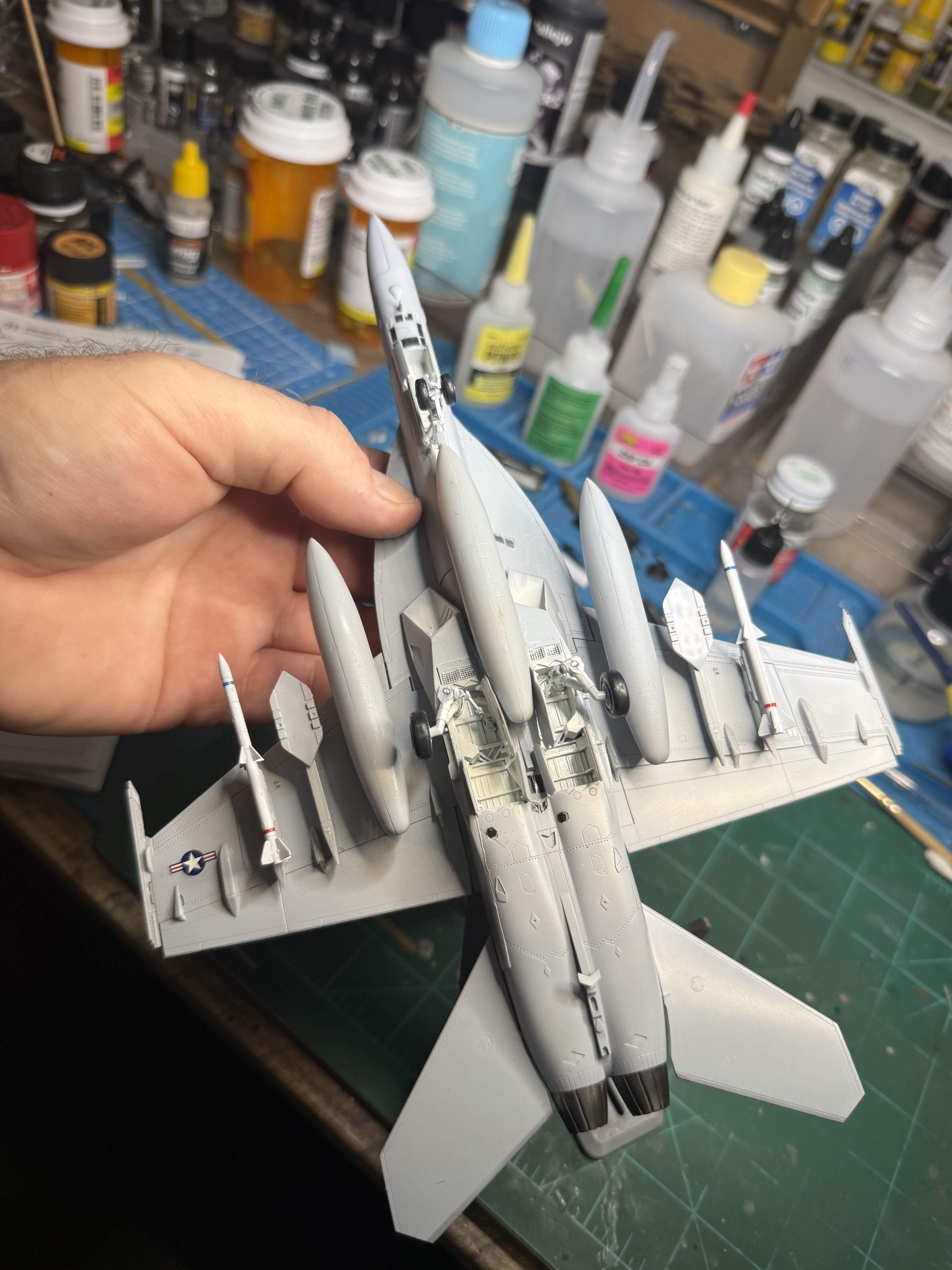

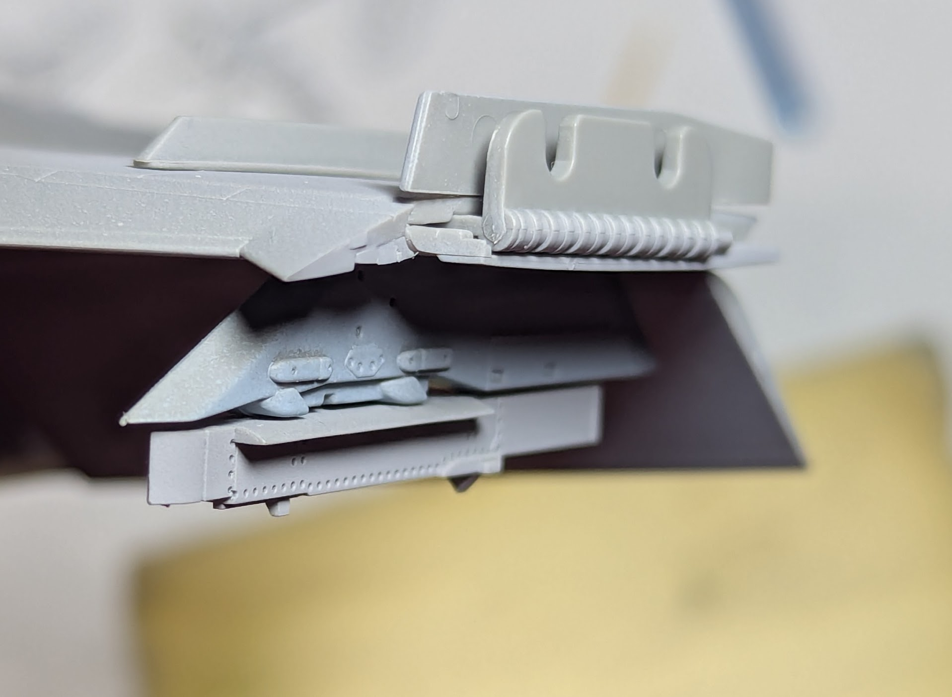

Still prepping for primer, decided to attach some of the pylons, the outer ones could be painted without obstruction. I am seeing a small gap between the main pylon and the intermediate part (do not know the correct term) that fits between it and the AGM.

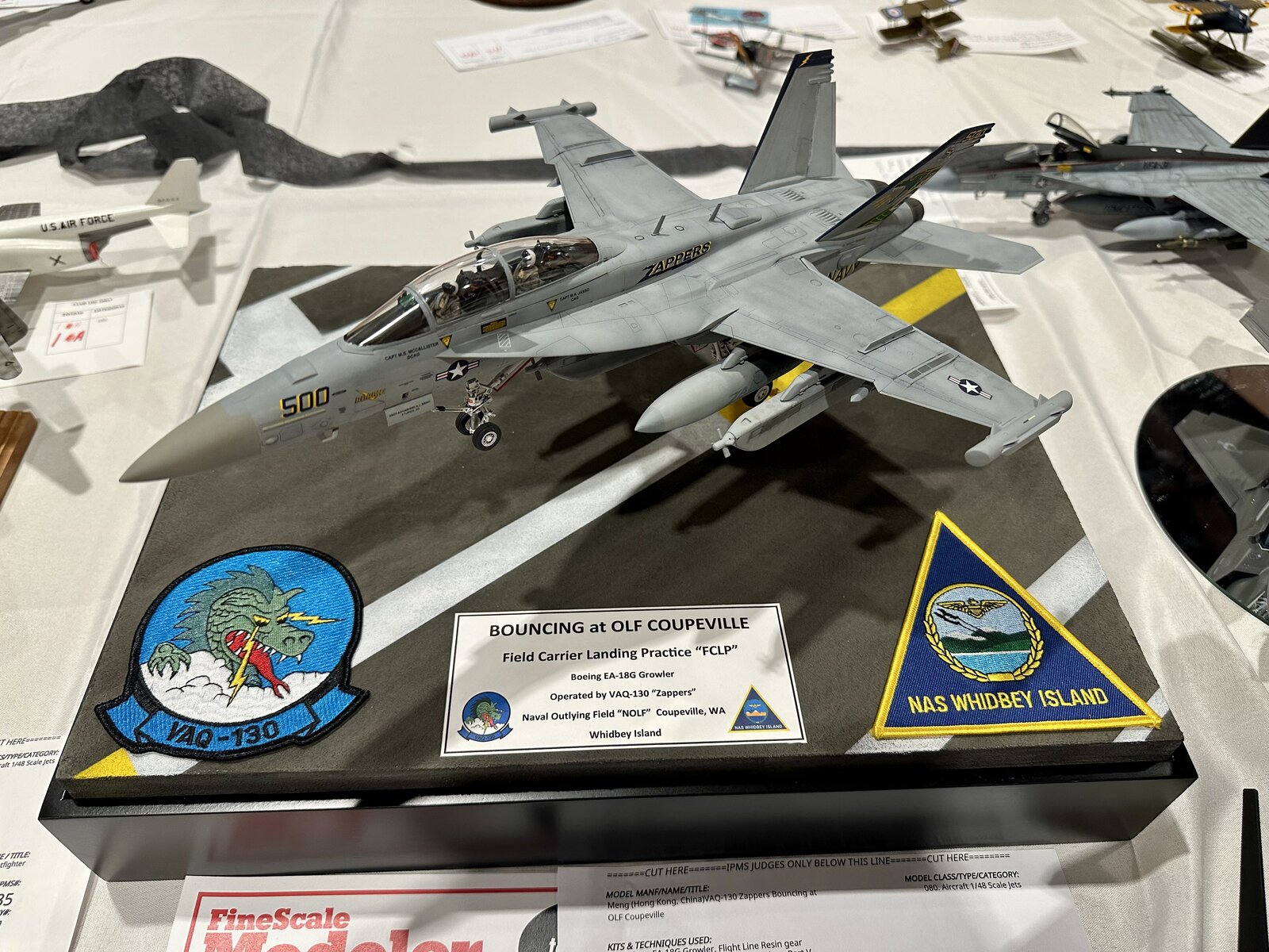

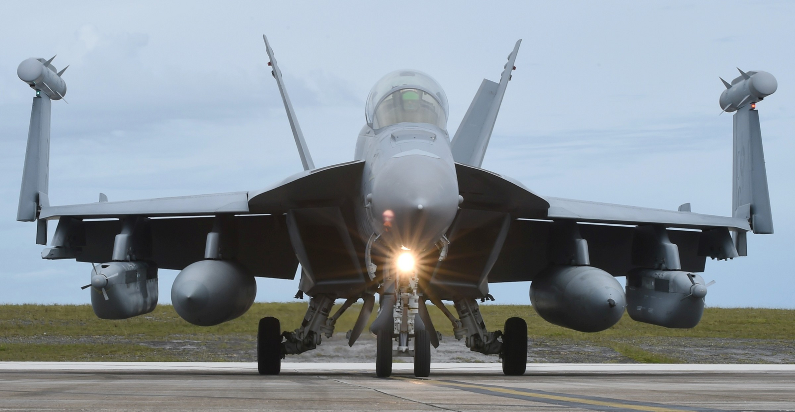

In trying to see if this is normal/expected I found this picture...
I do see a gap there, on the starboard wing. Interestingly there's not the intermediate pylon on the port side, also interesting is the rudder position mismatch.
last week when looking for some ref pics of take-off positions, I came across this discussion...
https://aviation.stackexchange.com/...flected-in-opposing-directions-during-takeoff
Rudder Toe-In
The particular effect you are referencing is called rudder toe-in. At slower speeds, particularly during high angles of attack, the stabilators may not provide sufficient nose authority to crisply rotate the nose. The massive wing area of the Rhino tends to block the airflow over the stabs. To remedy this problem the Rhino's rudders will automatically bias to the inside and create a downward force, which pitches the nose upwards. While the rudder is toed-in, the pilot can still use the rudders to yaw the aircraft. The FCS selectively moves the rudder position to generate the yawing motion, even while retaining the fared-in position.
Take-off and Landing
During takeoff the rudder will remain in the toe-in position for a fixed 10 seconds after it detects weight off the wheels. This prevents the aircraft from accidentally faring the rudders (and losing nose authority) during one of the most critical phases of flight (AoA probe failures will actually cause the rudders to automatically fare, and this problem is removed by a fixed timing.) During the landing portion of flight, the rudders will also be fared in to give the aircraft more nose authority, and this is handled automatically by the FCS once the pilot commands the aircraft into landing mode by placing the flaps switch out of up auto.

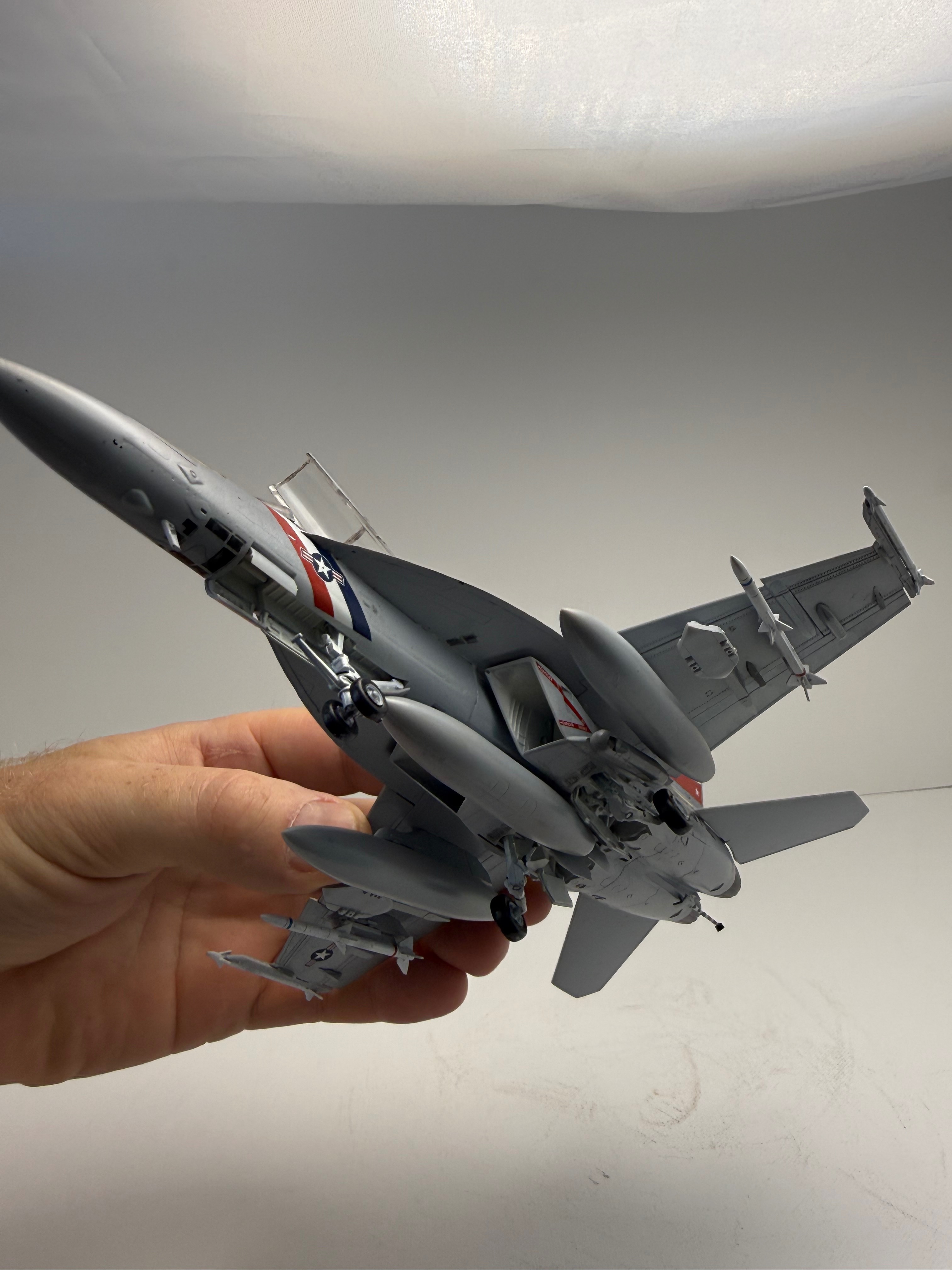

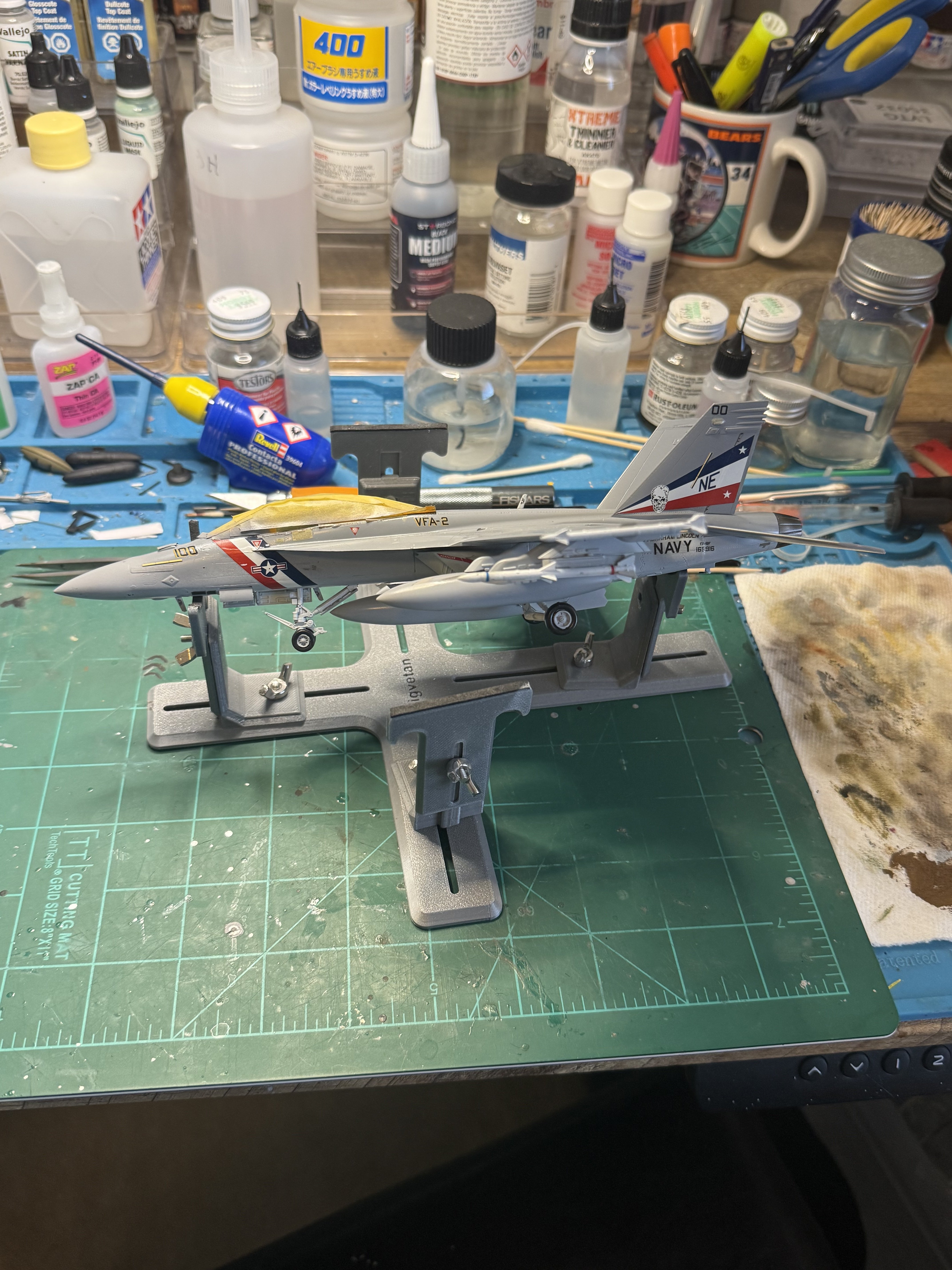

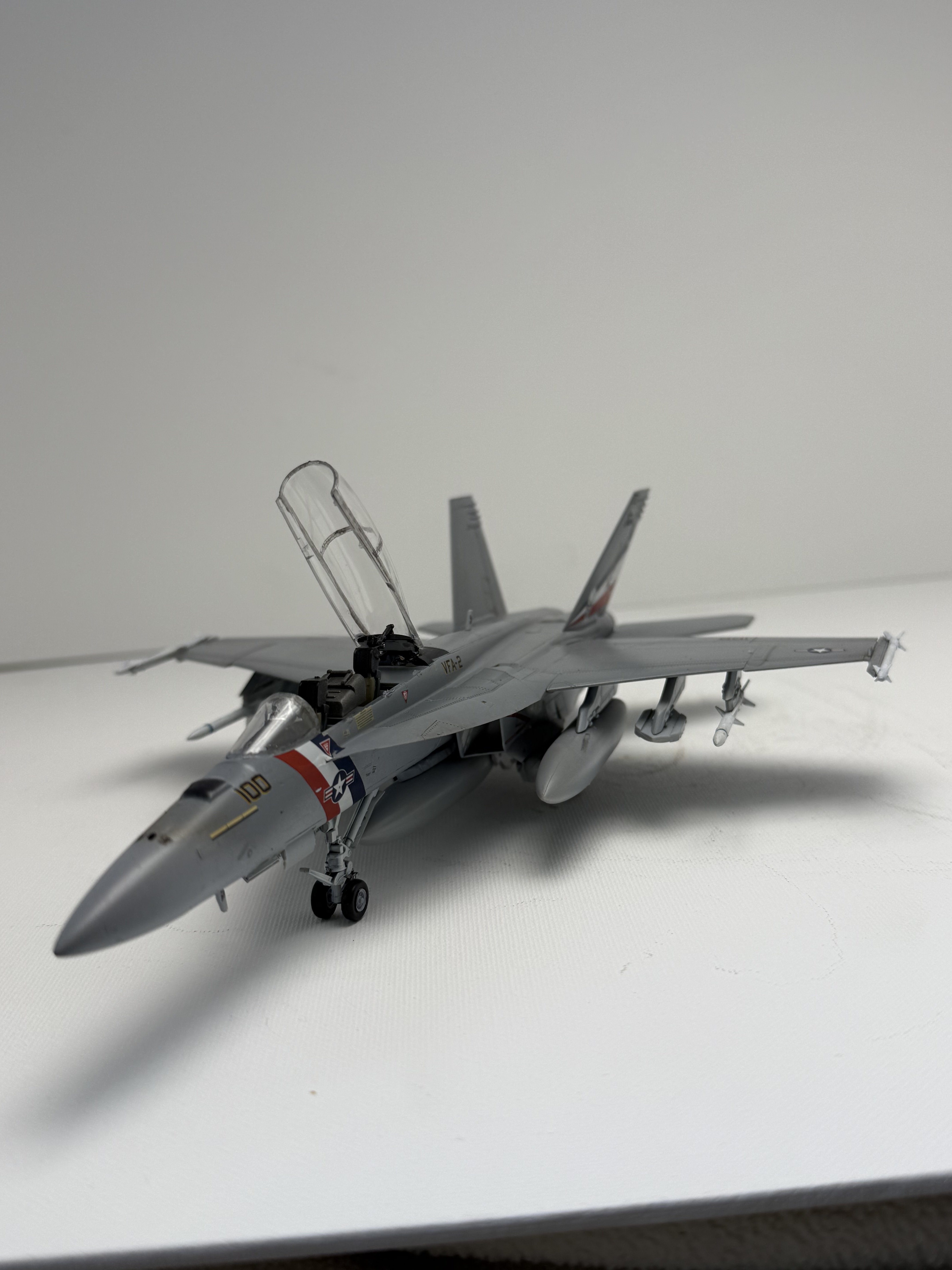

Anyway, here's where I am on my build. Need to let it sit a day, varnish and then finish decals.

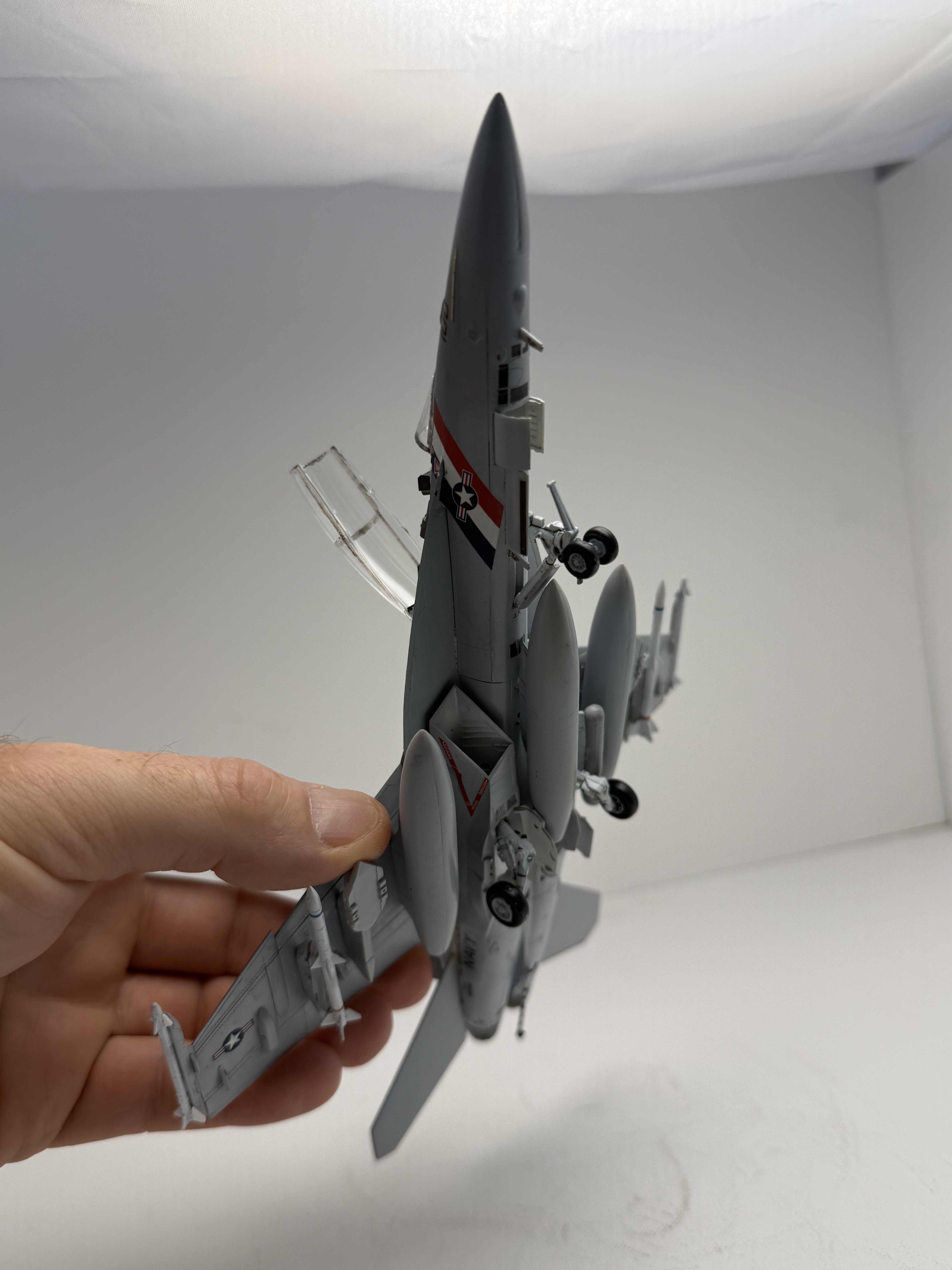

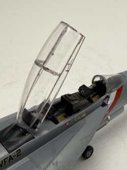

Apparently my pics didnt load! Let's try again.

HI Edbert great looking S-HORNET there an i see you have the wings folded up did you fit in the wings a hinge so they can be up or down ?

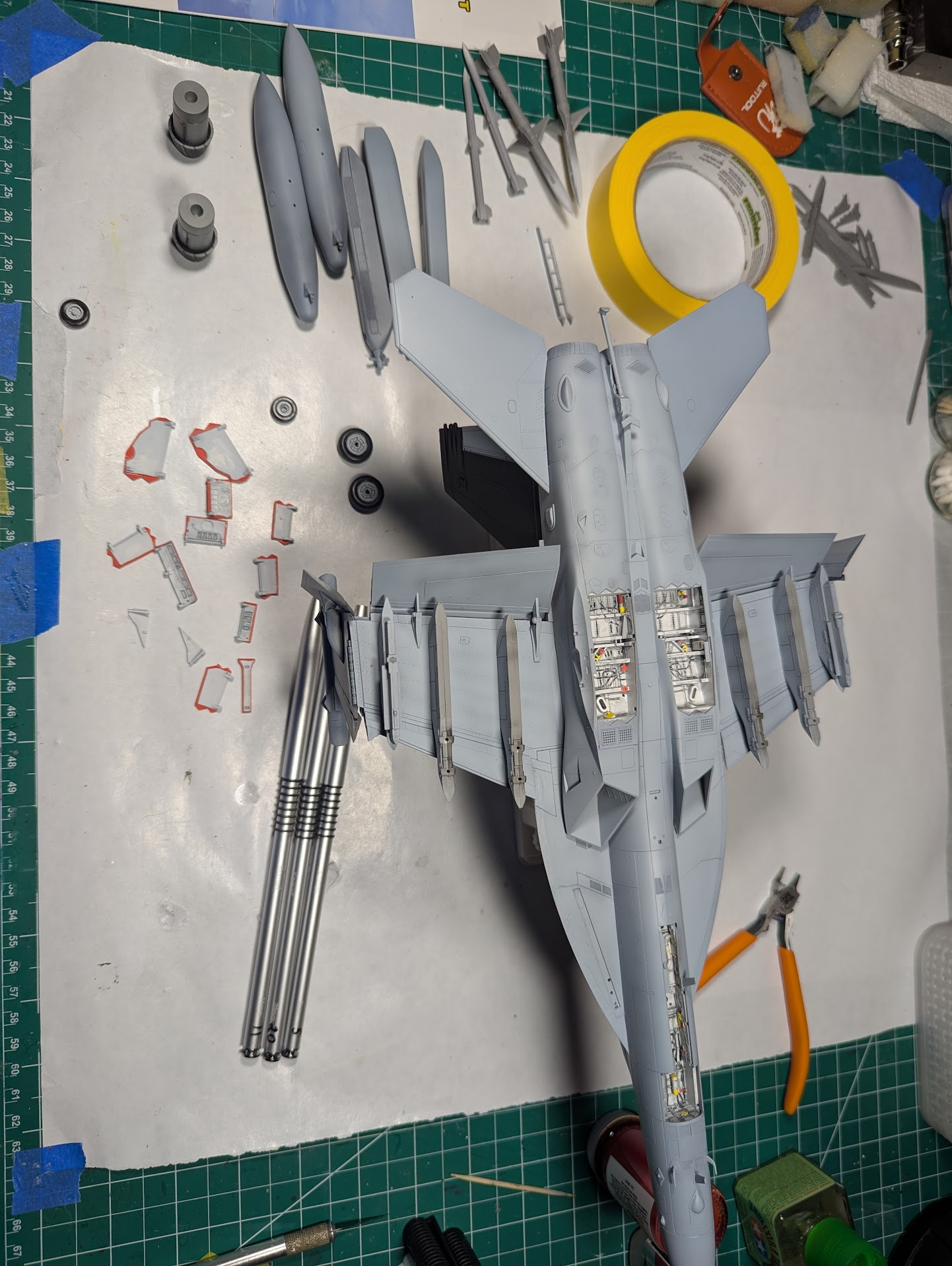

AN Dan sorry i may have this wrong but are you referring to the undercart covers edges ? as on my models i use a red permant ink marker
chrisb
Chris, yes I am referring to the leading edges of the wheel bay doors that he has laid out on the upper right side of the model in the photo.
I used the hinge that came with the kit, the offer one for each position but no movement.
Those wheel wells look great !
Thanks, I sort of made up my own use of red/yellow/silver/black since they did not match any of my references exactly.
How many applications did you apply to the edges? It doesn't get any darker?
That is two coats, AK paint markers, I did not see it darken with the 2nd, will try a 3rd, but might have to whip out the detail brush and some enamel.
I see what Chris said about ink marker, do you mean a sharpie? I've heard they bleed, is there another type?
WELL I THINK i got that wrong the red maker is a permenant paint marker not ink sorry about that but it looks like a pen

Regarding the "hinge"...
HI Edbert yes on my big 1/32 superhornet it had the same type of real hinge as on the real plane but i treid to fit it in to the model but they were not very strong an they would not allow the hinge to work up an down so i cut that part out of the wing an fitted in a real brass hinge an they worked very good so nice to have the options of the wings up an down an i left a little slack in the nav light wireing so the wires dint break when moving the wings up an down as i like to see the models in different poses
