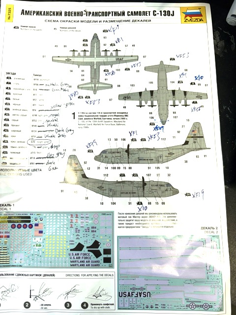

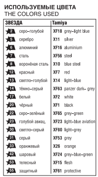

I have the 1/72 Zvezfda C-130J kit. They have their own paint colors noted on instructions but have a Zvezda to Tamiya conversion chart.
It has many errors in terms of what they call the Tamiya colors.
Going by the chart, they say to do a two part scheme, hard lined, with most of it shown as XF53 Neutral Grey (medium grey), and the randome XF19 Sky Grey, and the partial upper wing areas XF80 Royal Grey.
Sky Grey and Royal Grey are virtually the same, Sky is just hair darker.
Online, on multiple sites, I see it should maybe be monochromatic gunship grey. XF53 is close but lighter. I do have a spray can of Tamiya AS-27 gunship grey 2.

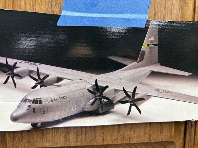

Any thoughts on which is correct? Do I need "gunship grey 1" if Tamiya makes it? Do they really have the light grey on the wing tops? Note their own box art does not show this two color wing top and it would be a pain to do well with the long thin decals there also.

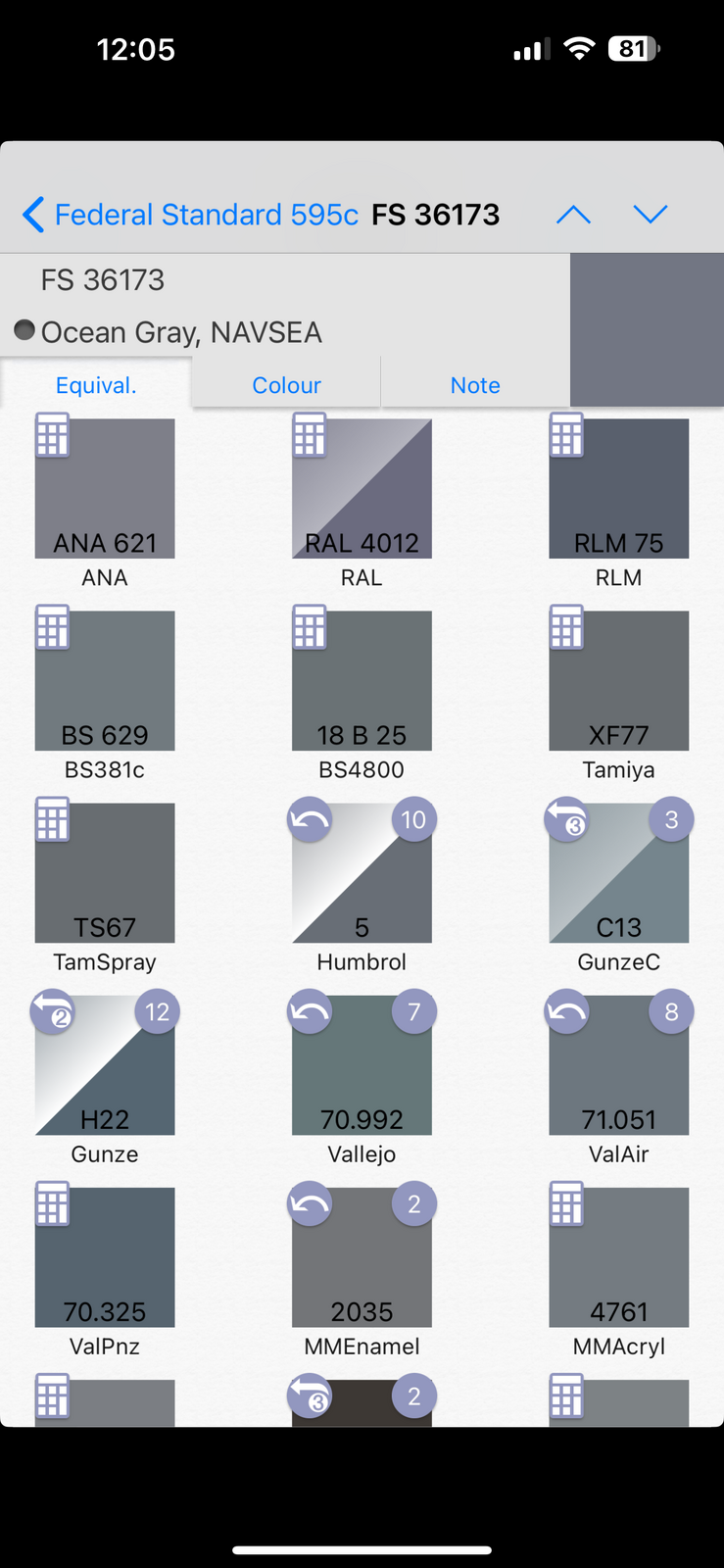

Interestingly, Imodel Kit app says FS 36173 is called "Ocean Grey (NAVSEA)"not "AMC Proud Grey" or "Battle Grey".
WTH?
I thought using an FS paint type meant it was pretty standard naming.

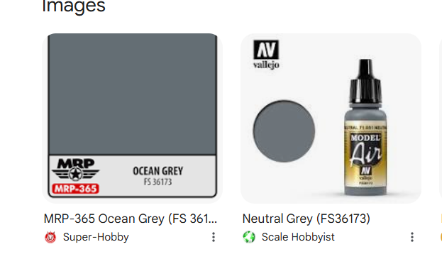

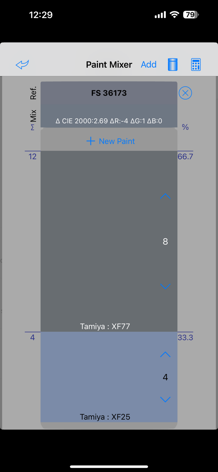

This mix looks close
My understanding of ImodelKit app is in the mixer you want the RGB values as close to zero as possible. This is -4, 1, 0. Is that how it works?
To make matters worse, some digitally rendered colors never seem to match the actual paint color as well. I always to to find a picture of the bottle if it has a color top like Tamiya, or more of a color swatch style than some RGB render
That being said, FS 36173 is the "federal standard" color
What name it goes go can vary by manufacturer, but should be pretty close if they are any good
For example, MRP calls it Ocean Grey while Vallejo Model calls it Neutral grey. There are lots of other colors called Ocean Grey, but not all are a match to the FS number
In this case despite having different names, I think the MRP and Vallejo both seem to match as they are both trying to represent that FS color
WTH?

Zvezda does use an interesting system...
Edit: Those colors are from their SU-57 kit.
WTH?
The info at Imodel is correct. One caveat though, FS colors do not have any names officially assigned to them. Don't get me started about the stupid names used by Mig, AK and AMMO. Some matches are:
Gunze Aqueous 53 Neutral Grey and 331 RAF Dark Sea Grey
Vallejo Model Color 70.992 or Model Air 71.051 Neutral Grey
