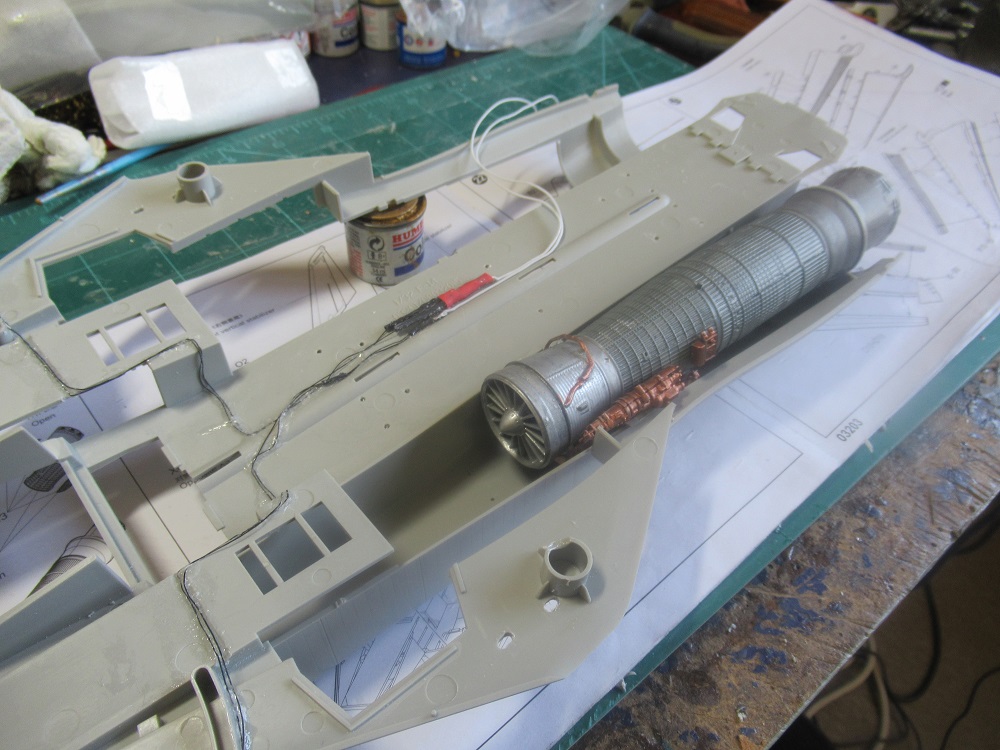

Any concern about heat, from the electronics?

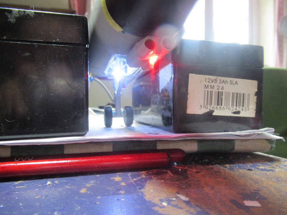

HI Edbert well its only a 12v eletrical system an ive been wirein up my planes an ships for yrs an never had any problems as resistors in the leds wirein circut keeps the power low an these lights in the planes are either worked from a 12v batt or how ive got the planes set up at the moment they are workin an takin power from a mains powerd 12v adaptor an they all work tickecy boo

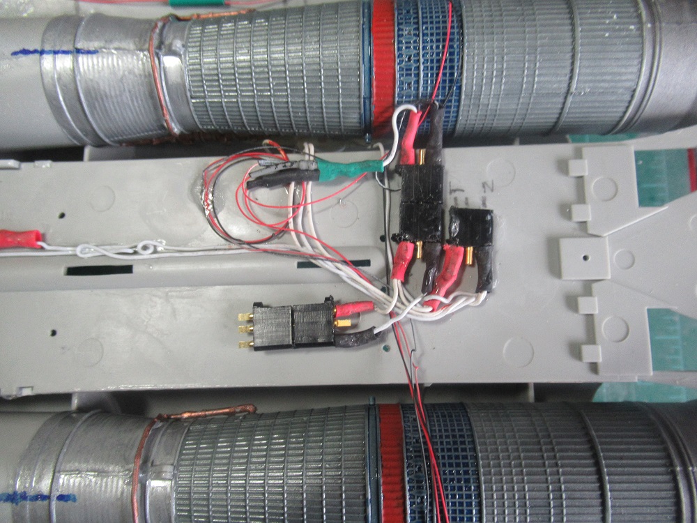

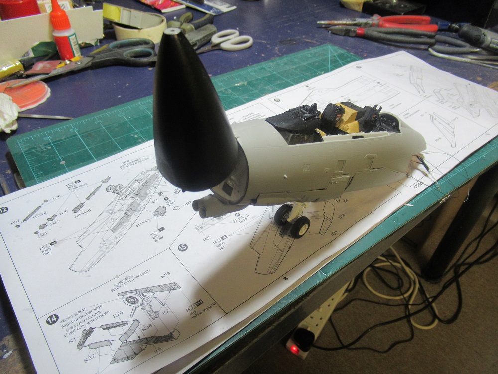

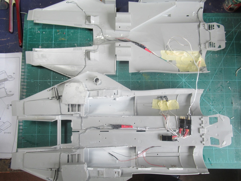

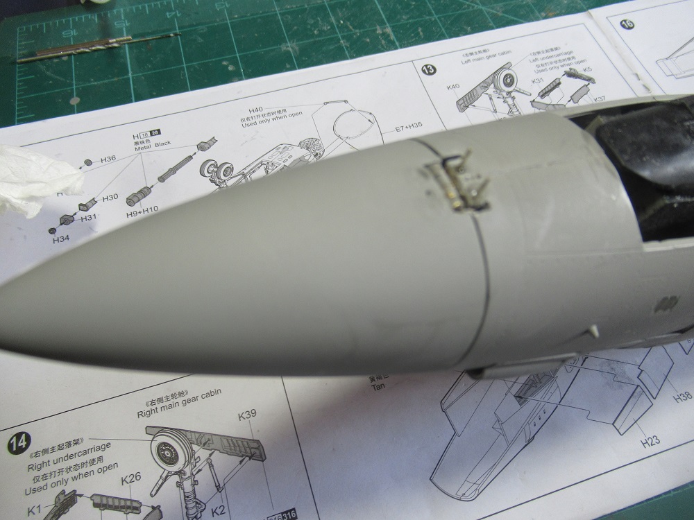

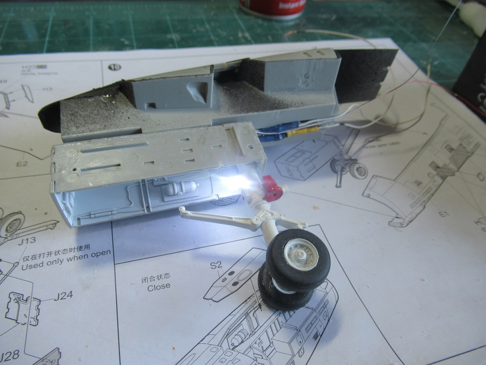

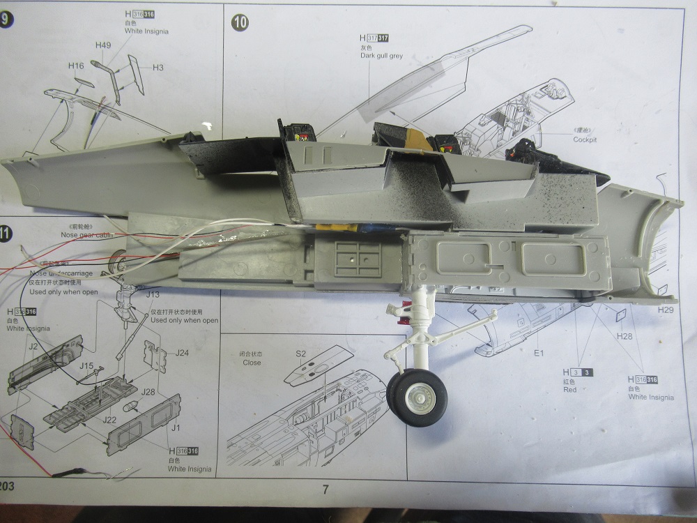

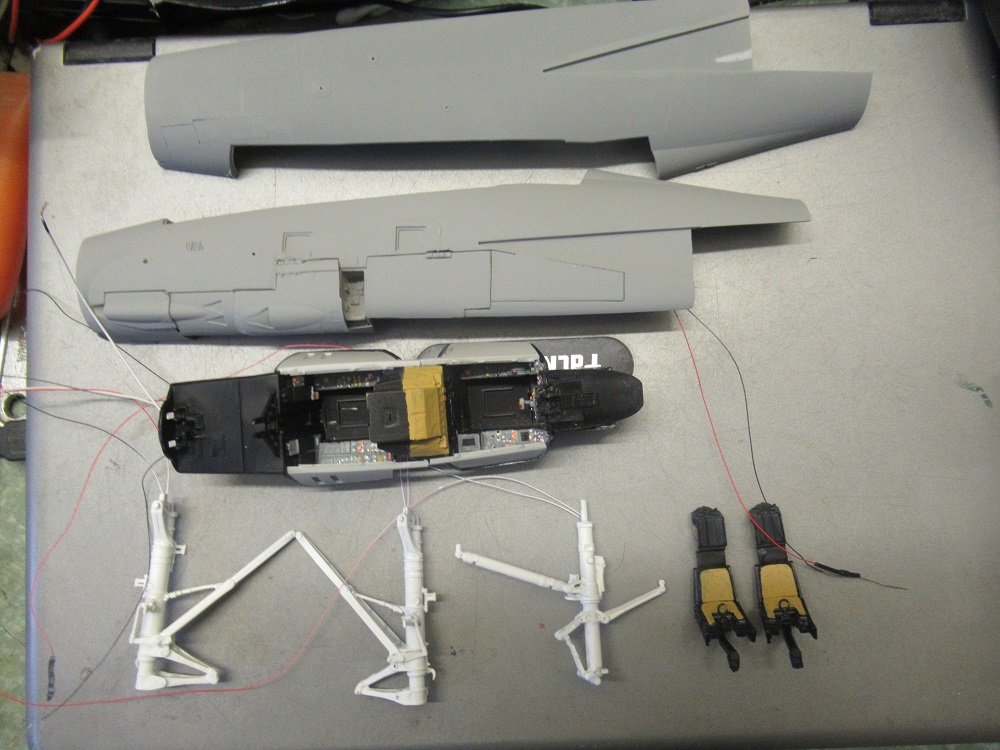

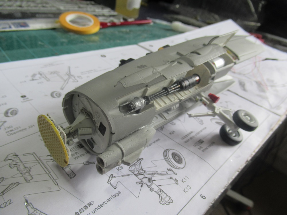

G/M ALL well time for 10 more pics of this tomcat build an here ive just pluged in the nose eletric plug to the main fusealarge plug to take power to the nose lights

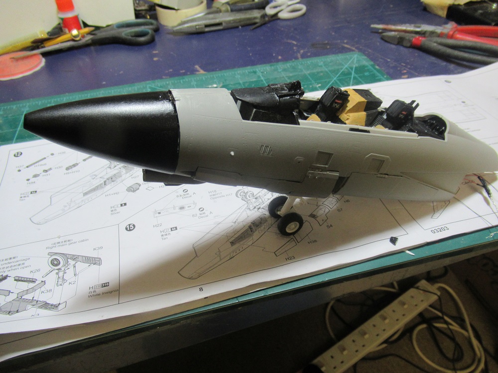

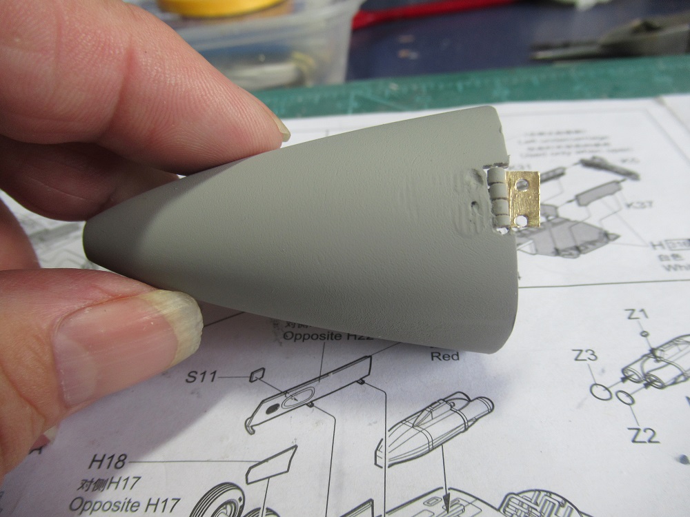

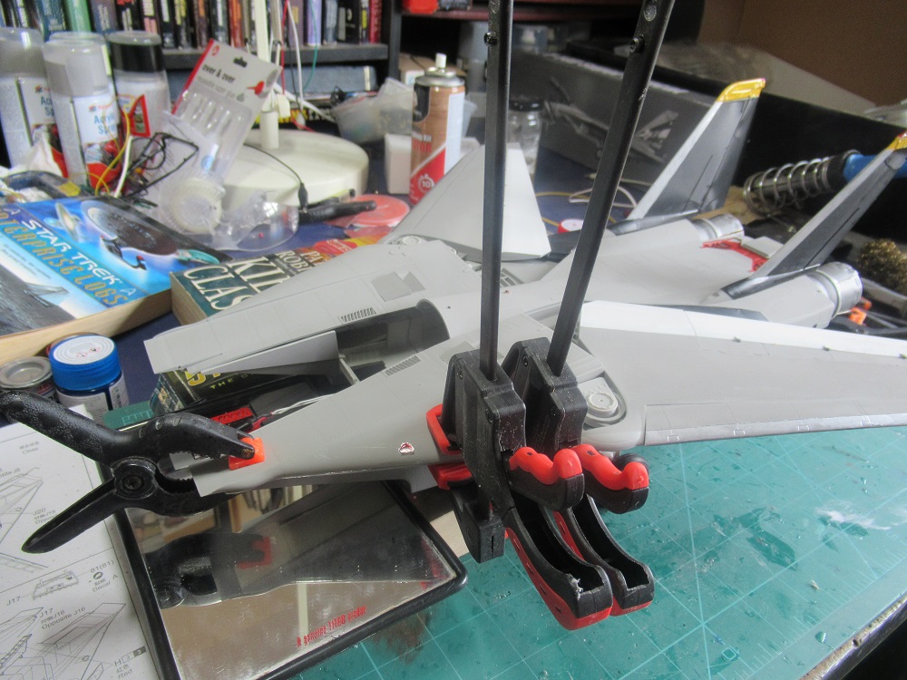

Now to slide the nose section into the main fusealarge an glue but had trouble on the top of the fusealarge as when the nose section slid in there was still a 2mm gap that had to be filled an its like this on all these kits as ive seen my freind build one an he had the same problem but easy fix with a bit of 2mm thick plasticard glued an slid into the slot an then sanded down an here on the under side the bottom panel was not a great fit but pulled it down an glued it to a nice smooth fit
SO now ive repeared that jiont an now its been sprayed over it now looks good ana shot here of the eltrics takin power to the nose lights

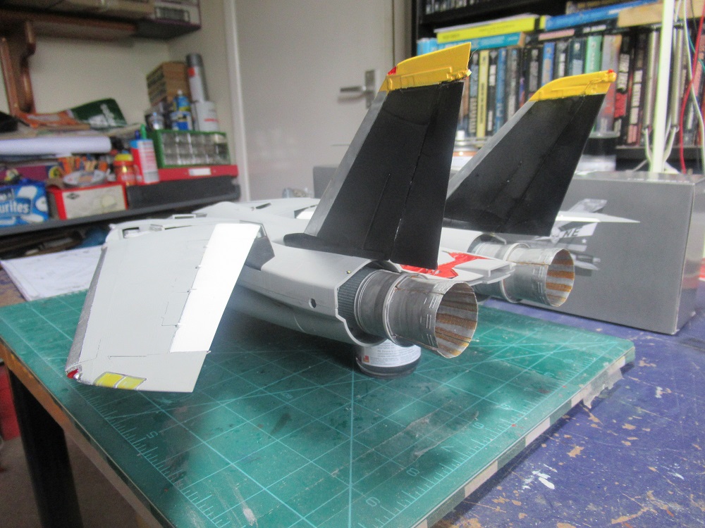

an the nose is now fitted on after a bit of hassle but nothing i could not sort out an now she' lookin a mean machine
HI Litlemarten no power source is not through the wheels but just a simple MALE micro mini eletric plug FROM THE POWER SOURCE thats JUST PLUGS INTO the female sockect is fitted flush in the lower back fusealarge that just plugs into it so very easy to do hows that sir i know its tiny but if you look at the rear of the plane right near the big N for NAVY DECAL AT THE BOTTOM you can see the mini female eletric plug socket

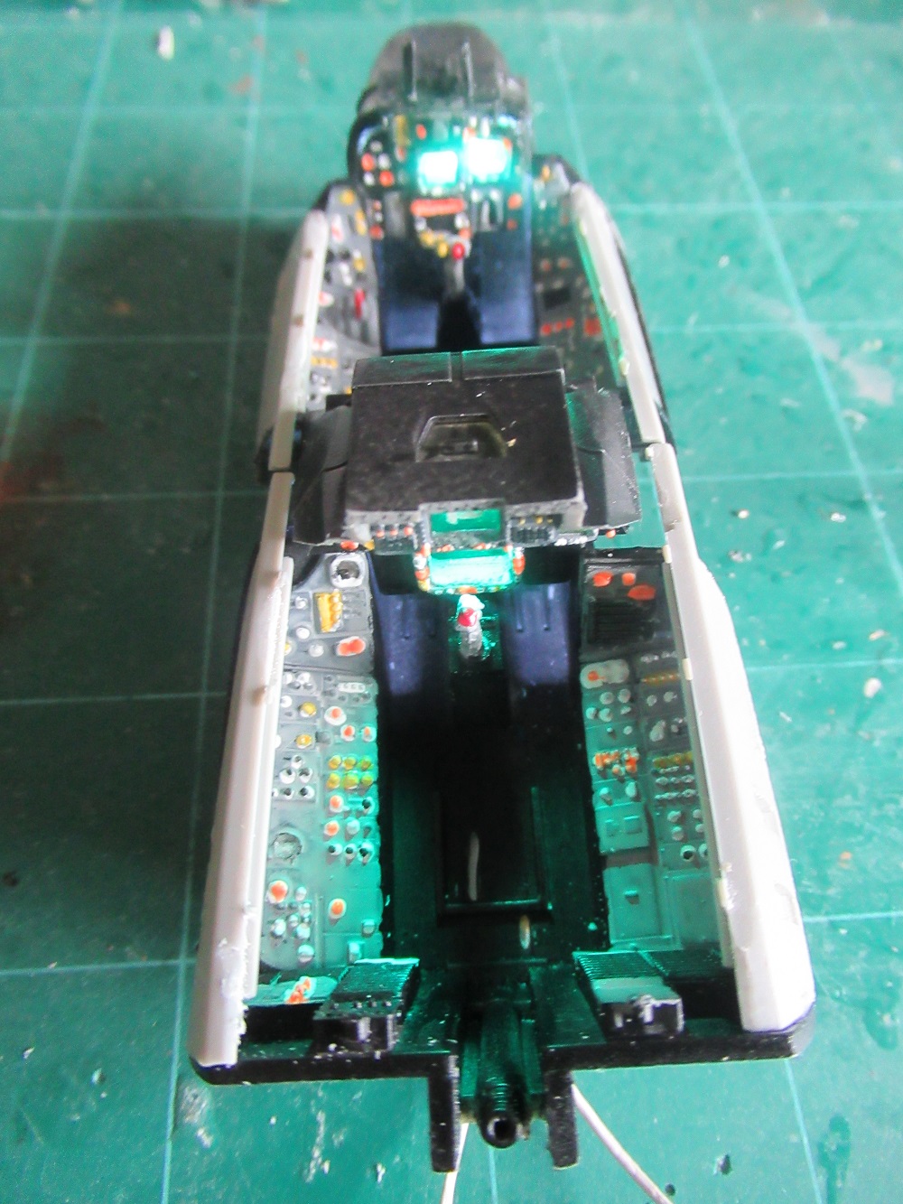

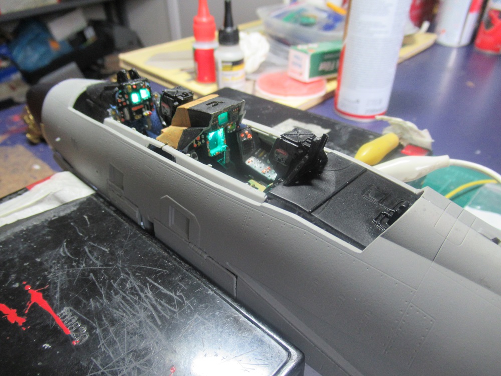

HI GUYS yes i know that the pic above is the finished model but i just posted that to answer Littlmartens question an few more of the build ok an building the big phenix missles an fitting on the big jolly roger decals an they kept breakin but not splinterin so i was lucky to get them on ok an shot of the lit up cockpit vid screens
WELL thats the lot of the pics of the fininshed build guys hope you like an it took me 6 months to build an light up

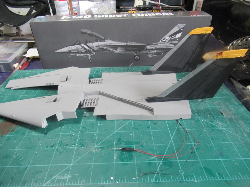

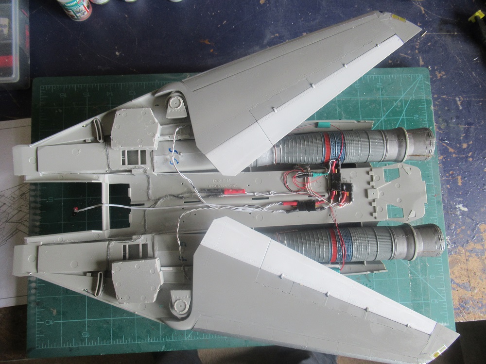

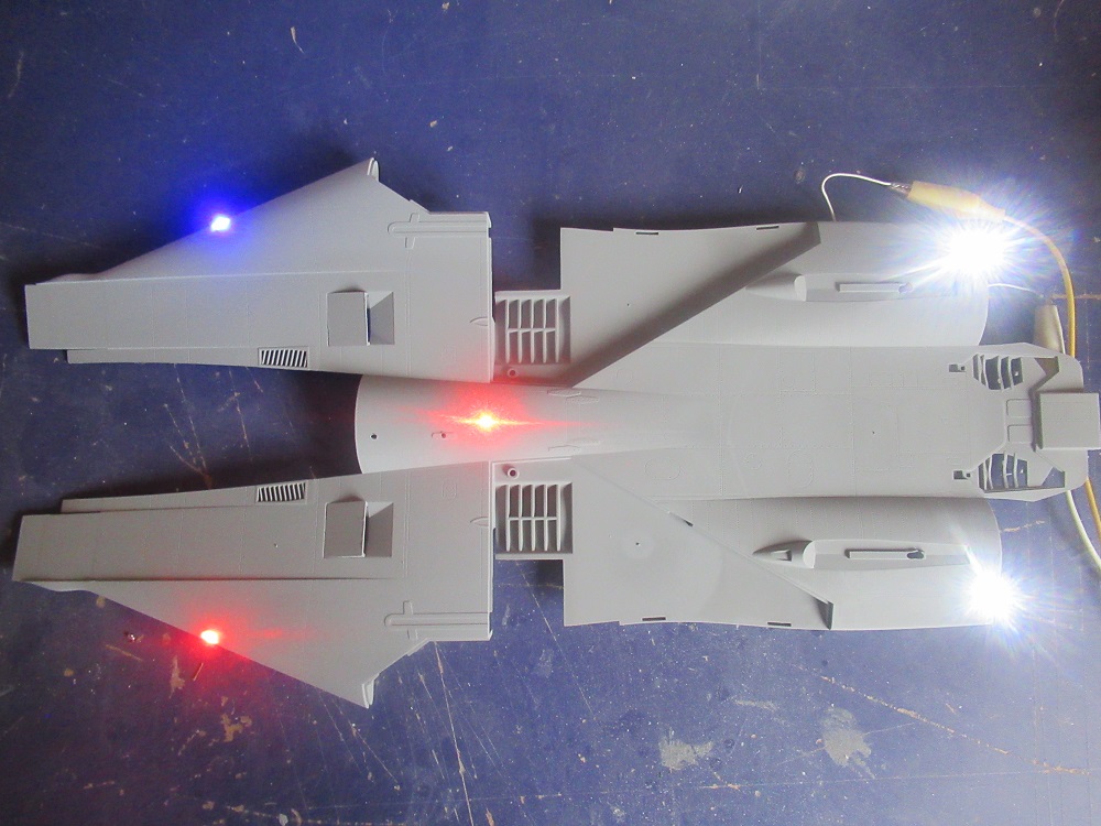

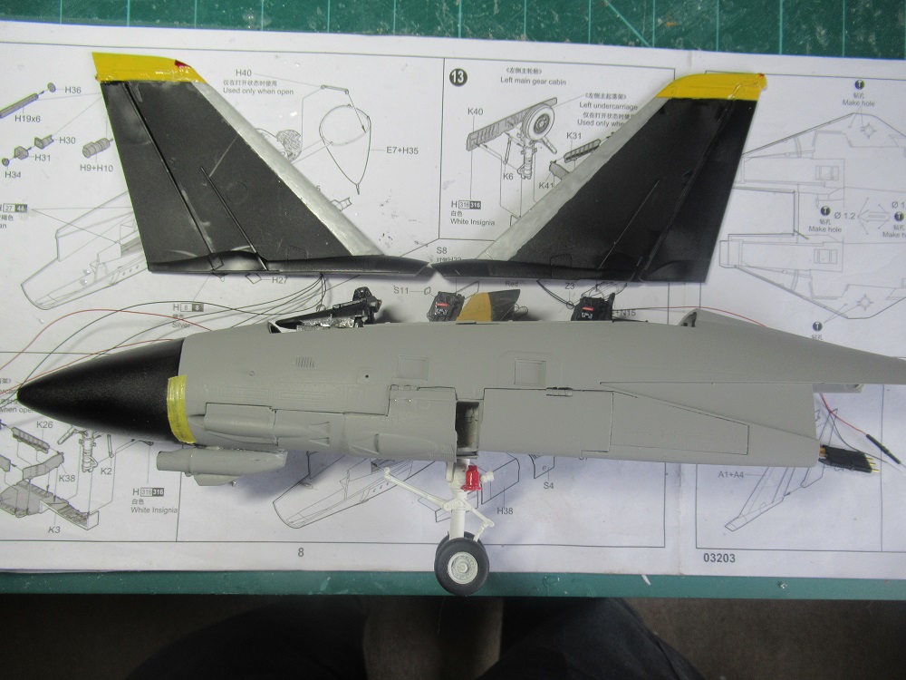

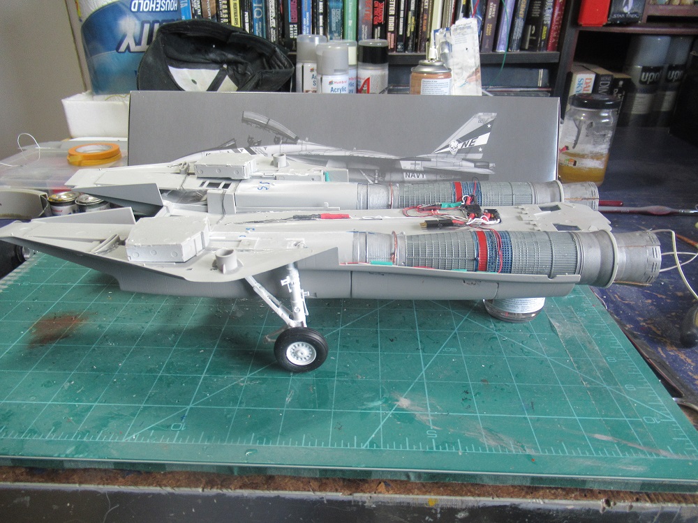

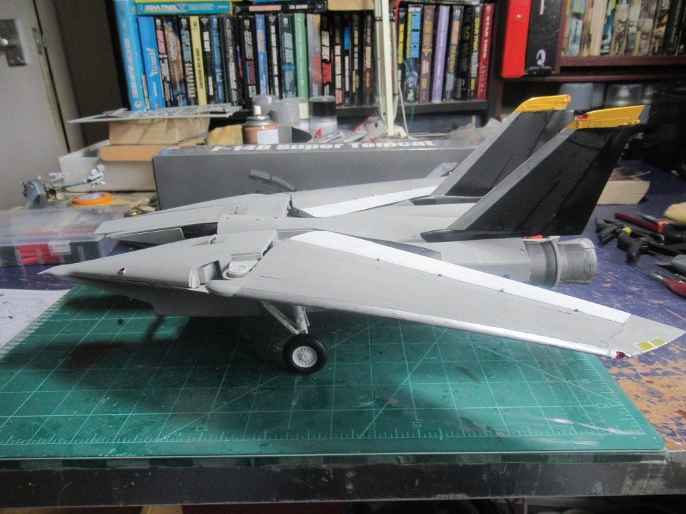

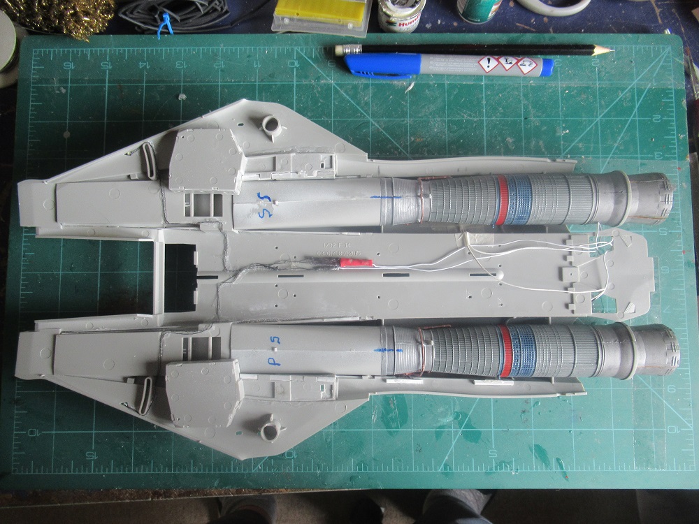

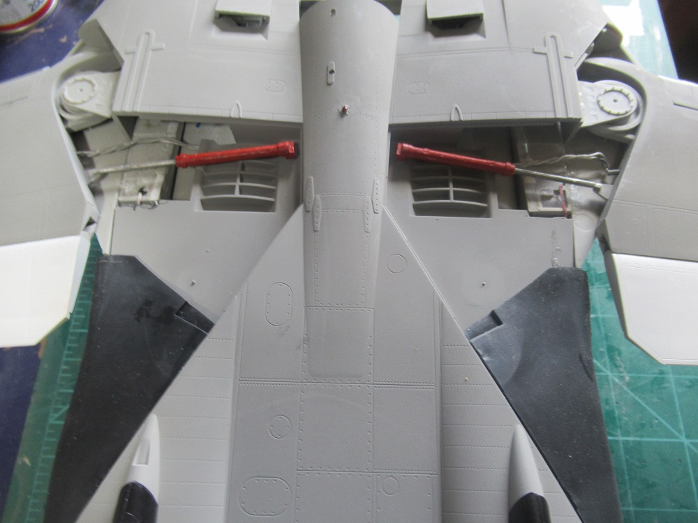

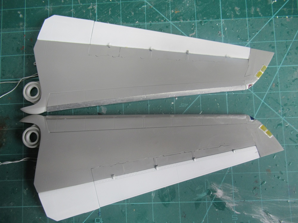

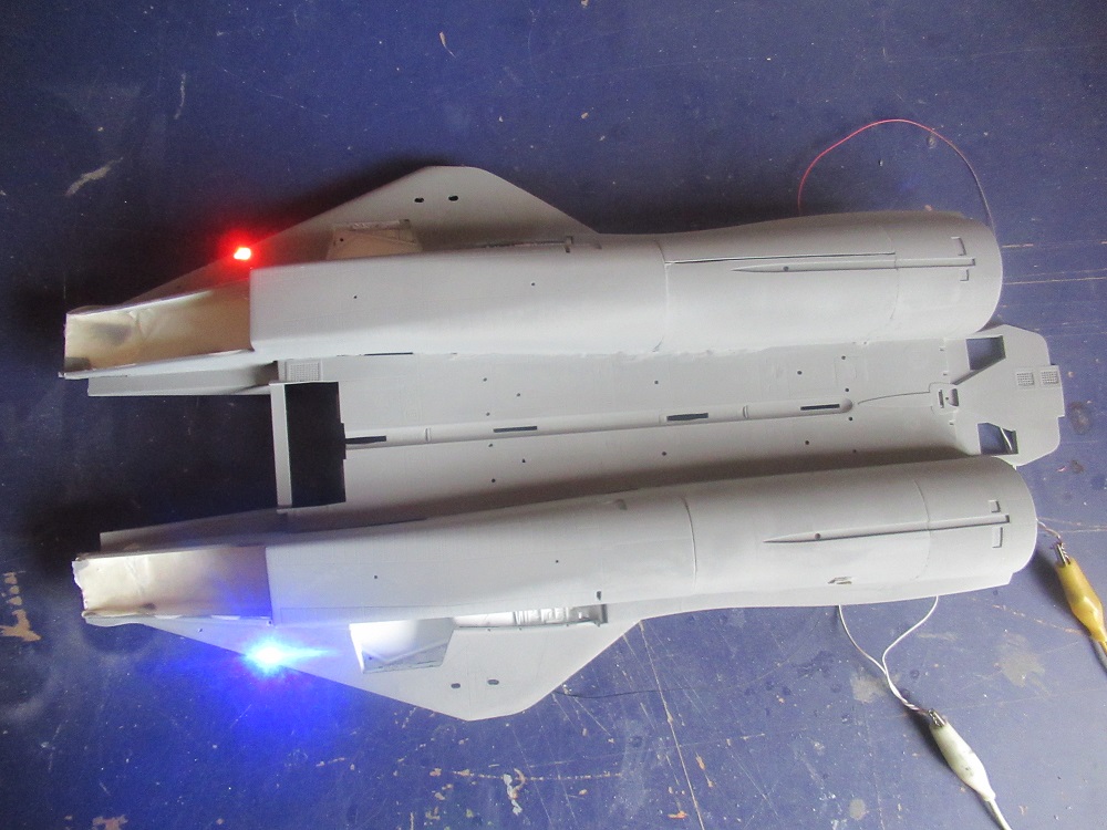

HI I HOPE IVE EXSPLANED FITTING THE LIGHT A BIT BETTER IN THIS TOMCAT BUILD BUT ALL YOU HAVE TO DO IS FIT THE 2MM LED GREEN FOR STARBOAD AN RED FOR PORT WING AN JUST MAKE SURE THE WINGS WILL MEET UP OK IF YOU HAVE AN TROUBLE DOIN THIS THEN D/M ME AN I WILL HAVE A LOOK SEE AT YOUR PROBLEM AN SORRY I THOUGHT I SHEW MORE ON THE WIREIN IN THE HORNET BUT GEUSS I WAS WRONG SO HAVE A LOOK THROUGH THIS TOMCAT BUILD
HI Edbert sorry to take so long to answer your qeustion but no no problems about heat from the eletronincs as the plane is only lit up for 15 mins at a time as she is on a timer 15mins on then 30 mins off to allow anything to cool off before the timer switches the lights back on as never had any probs with any of my models
I think this is the hardest part right? Getting an LED (2 actually) into the top of the vertical stabs, there's usually zero room inside of those, maybe 1/32 is better but not much. Do you have to use a dremel as a router to cut a channel?
HI Edbert yes i do use a dremel an a router fitted in an quite easy to do all thats reqired is to make sure that the plastic does not get hot an melt so a little at a time an yes 1/32 scale are best but ive made several 1/48th scale planes lit up to an even some 1/144 scale tomcats an super hornets light up on my big USS NIMITZ its just a matter of piatiene an not hurry doin it an two 1/144 scale hawkeyes an they had tiny motors in the engines to turn the props an lights in them an they looked an worked brilliantly an here are some 1/144 scale planes lit up an enginges goin on my big carrier so size dont really matter unless its a miniture plane then it does
