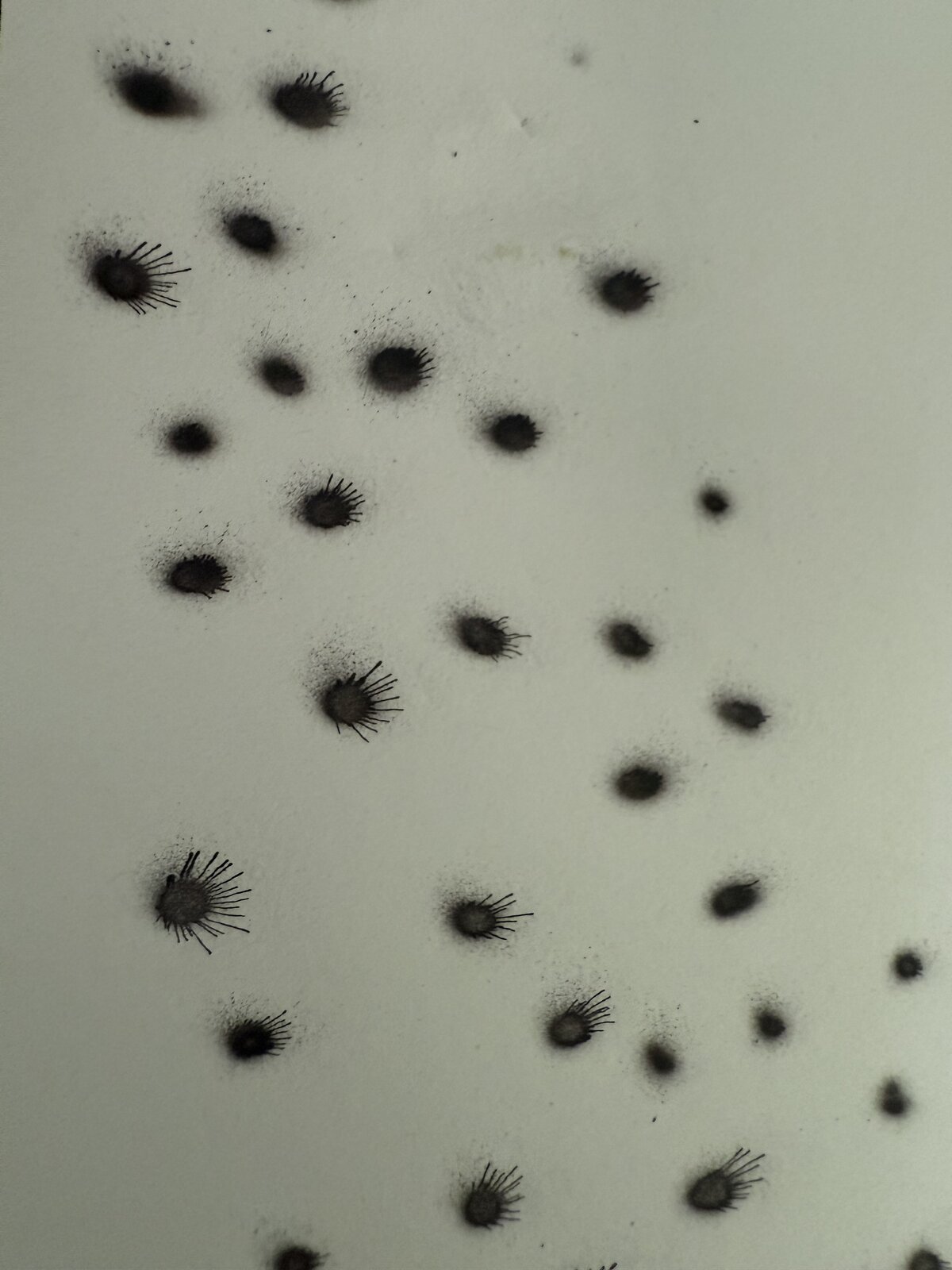

Hi! I'm new here and recently returned to model aircraft building after a thirty-year hiatus. I'm also learning to use an airbrush. I'm on my second kit with an airbrush and things were going fine until I tried doing some basic detail work (mottling pattern on the side of a 1/48 WW2 fighter). I keep getting spidering/splattering on the paint. I understand this can be a problem when the paint is too thin or the air pressure isn't correct. But it seems to happen no matter what I do with the paint, including not thinning it at all, or increasing/decreasing the air pressure. The picture shows the problem. I'm using a Gaahleri 98D with a .38 needle and used 15psi with maybe 30% thinner. Tip of the brush was held maybe half a centimeter from the paper and the spots depicted are 2-3mm across. I'm also using an entry-level Gaahleri Serenair mini compressor. I've tried using minimal paint flow with a very light touch and it's not helping. I thought at first it was the result of moisture in the line but it's also occurring with a dry airbrush I've just started up. I was previously able to get runs of relatively clean mottle patterns before moisture started building up, but now I can't seem to do it at all without the spidering. I've tried taking the airbrush apart and cleaning it and have checked everything is properly tightened.
I'm at a loss for ideas at this point and at a standstill. I'm in a very humid area so I don't know if that has anything to do with. I looked at some videos on YouTube but all the basic fixes they mentioned don't seem to work. I'm guessing it's some form of user error as I'm still trying to get the airbrushing thing figured out.
I could really use some help. Thanks in advance!
If you suspect moisture is the problem, then I have to ask: do you have a moisture trap between the compressor and the airbrush? They usually look like a glass jar hanging from a metal fixture that the air line comes out of.
before going into more detailed trouble shooting ,
carefully examine the very tip of the needle , under bright light and magnifier , to ensure it isn't bent . It doesn't take much of a little hook on the end .
what does this mean ? : occurring with a dry airbrush I've just started up
usually the opposite . The paint is too viscous and starts building up on the needle and it's pushed out in drops when it reaches critical mass . Especially with lower air pressure .

It's probably a decent compressor , it's just that tanked compressors are much better at controlling moisture in the line since it precipitates out in the tank .
A tankless operating in a high humidity environment will pump all that moisture to the airbrush .
Did you examine the needle ?
A deformed needle can cause the droplet formation .
If everything on the mechanical end is good then addressing the moisture issue would be next .
You have a moisture trap of some sorts ?
The small , inline traps can't handle the amount of moisture developed from high humidity intake air from a tankless compressor .
If you run the AB while empty will it spit water ?
I did examine the needle and it is indeed bent slightly at the tip. Could that be the cause of the issue? I have ordered a replacement needle.

You might be able to straighten the bent tip .
I have done that in the past , and even filed a hook-like bend off with a small file .
It depends .
and yes , that bend will wreck the airflow and prevent proper atomization .

I'm not convinced yet that it's a moisture problem .
Needs to be verified .
You need to verify there are no mechanical issues -- like the right tip and needle combo with no signs of damage ,then we need to see how much water the thing will spray out after running for a while , with no paint in the cup .

This could be a compound problem with condensate in the air supply exacerbated by the damaged needle -- or moisture only -- or we are going to need to get into exactly what you're spraying mix-wise and air pressure .
When you start out with a cold compressor is this splattering an immediate issue or does it take a minute or 2 or 3 to develop ?

So previously, I was able to do detail work for a while using a cold compressor and it would work fine at first (my inexperience at detail work with an airbrush and paint/thinner mixtures not withstanding). Then after 10-15 minutes I'd start to get spattering and I assumed this was the result of condensation. Then two days ago I started getting the spattering right off the bat and got really confused about the whole thing.
I just used the airbrush and tried running air through it with no paint. It's pretty humid here today and it did indeed start spitting water every couple of minutes. This was without the little filter I got attached. So condensation is indeed building up in the line.
I also took my jeweler's file and attempted to fix the needle tip. I'm sure it's not a perfect job but I was able to take the bend off the tip. After running air through the brush, I painted a number of small dots and didn't get any spidering. Seems like the bent tip was causing an issue.
Sounds like you're right on a compound problem?
As far as what I'm spraying, I use a mix of Tamiya, Vallejo, and Ammo Mig acrylics. I thin it with Tamiya X-20A. Given the issues I've had with moisture and the high humidity here, I've been using maybe 30-40% thinner at most, and often way less than that.
