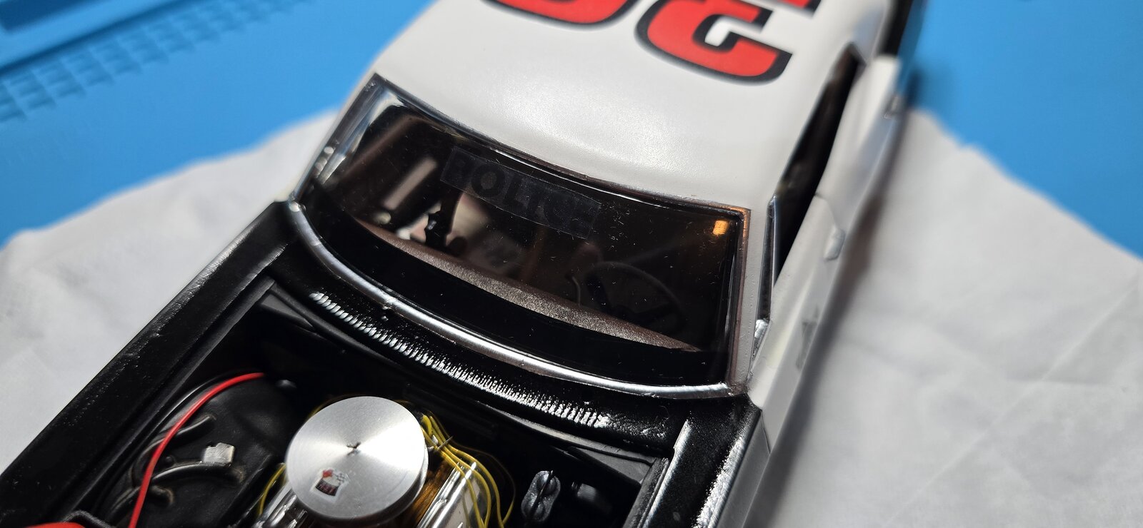

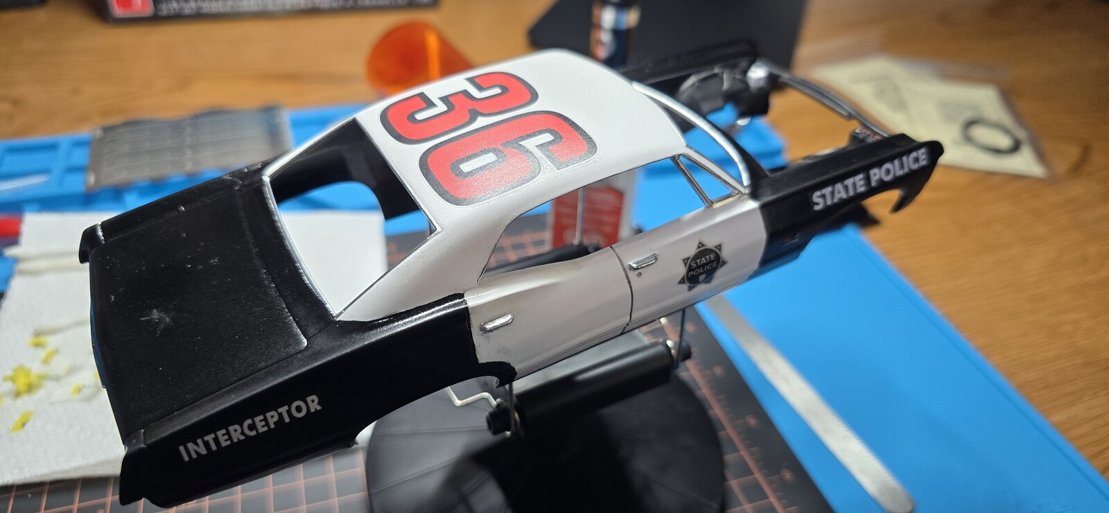

Howdy mjensen, I have been using BMF for about a year, I'm certainly no expert but I have learned a few things.
The tools required; toothpick, sanded to a fine point on one side and rounded flat edge on the other, tight/pointed cotton buds. Pointed toothpick end should be pulled along edges/details backwards, or sharp point can tear BMF. Gentle pressure, working into details works best.
New blades are a must, and as you cut the shapes you need, the blade will dull, (rather quickly depending on the blade manufacturer). I have changed blades several times, depending on how much BMF I use and how much trimming is required.
There are numerous YT videos out there, watch a few and experiment, find what works best for you.
One of the videos I watched, recommended cutting a shape larger than the window, applying it to the entire area then cutting the inside out and trimming to fit. I find by cutting in strips, or smaller shapes closer to the shapes I need for the trim/edging/etc., I can control it better, place it closer to the edges of the work area (often requiring less cutting) and adjusting as needed.
I have found using the entire blade (in my case an Xacto blade, lying parallel on the cut helps the cuts from getting "jagged" or torn edges.
I also found, steadying your hand along as you go to be helpful. I purchased a rod/ball hand steadier on Amazon, but by using my fingers as a guide to making the cuts, they got straighter and cleaner. This works for straight runs, but for curved runs, lift the blade to allow contouring. Wobbly edges will happen, especially after multiple cups of coffee. :cool:
When removing the foil from the sheet, (the edges are often non-stick, don't use those on your work), peel slowly, moving the tweezers closer to the area being removed to reduce the "curling" of the strips. A long strip, pulled from one end can tear, or worse, curl up onto itself and stick to itself, think a long piece of tape that rolls into itself and is now a tangle sticky mess, lol.
I once tried masking to the edge of the BMF, in a hope it would allow removal of the mask to reveal a cleaner line, it didn't work. But it may assist in cutting cleaner edges.
Measure 3 times, and measure again, oversize can be trimmed, too small requires more BMF to cover.
Any smaller gaps or areas that you missed, can be hidden by Molotow (either pen or paint applied by toothpick or small brush). *By small I mean 1 or 2 mm, anything larger will stick out.
Be patient, it may take several tries, you may have to start over, and if you get frustrated, take a break and come back to it.
Hope this was helpful.

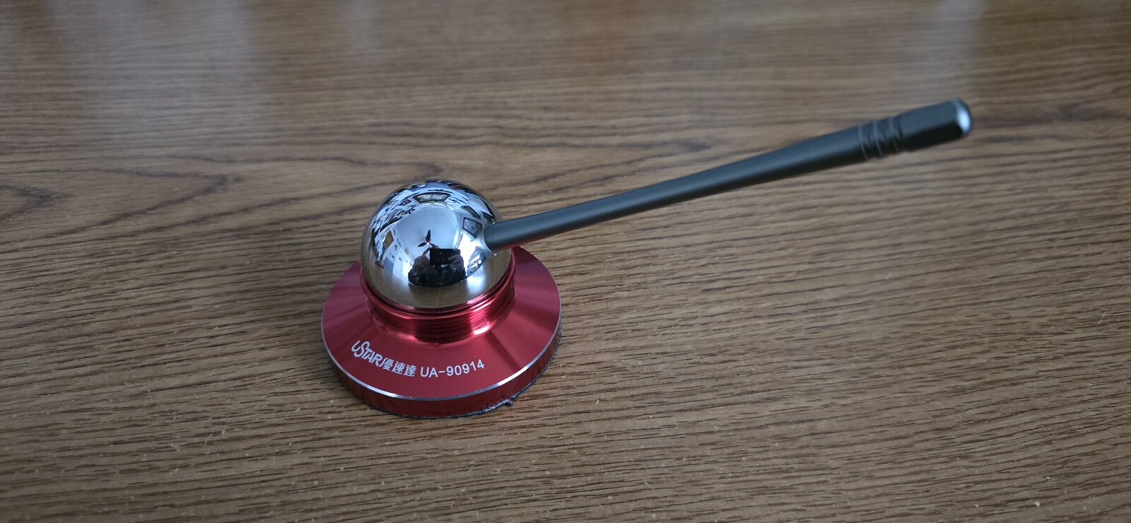

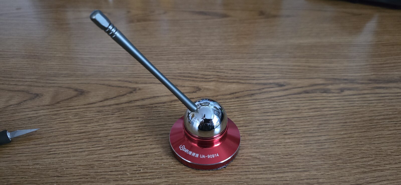

When you say, "rod/ball" hand steadier, I'm thinking you're referring to a mahl stick....is that correct?

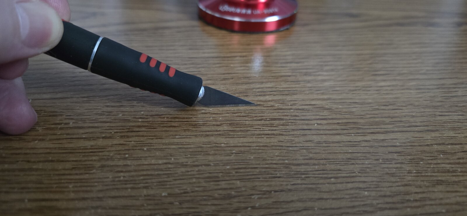

When you say you're using the entire blade laying parallel to the cut I'm trying to visualize that. What I came up with is that, instead of using just the tip of the blade held at about a 60° angle, like I normally do, I might want to try bringing the angle down to as close to zero as I can get and still have pressure on the point rather than the heel...?? Does that sound about right?
Not sure what a mahl-stick is, but I was referring to what I picked up on Amazon. It's a ball and rod, seated in a mount. It's very well machined and the ball sits in the socket with almost a suction seal, freely rotating and moving while maintaining a steady base.
It sounded like a good idea, and it does steady one's hand. The problem is it doesn't make straight lines. See photos below. If the correct term for it is mahl-stick, I learned something new. :cool:
In a nutshell yes, my idea behind this was with the blade angled "down" onto the edge, you'd get a sharper edge. Typically, using an Xacto, I tend to use only the point (holding it at a 80-90 degree angle, when holding it "lower" at say, a 30 degree, more blade is in contact, giving you a straighter, cleaner edge. This seemed to work for me on my latest build (the photo I shared in my previous post) my previous attempts tended to have a more "wobbled" cut, as I was using only the tip of the blade. By hold the blade at the angled picture (see photo below) I was able to get a cleaner, straighter line. Of course this only works on straight lines, but I was able to get a clean curved cut on the top of windshield trim, which is a gentle curve. My latest build was the best BMF application I've ever had, see photo below.
