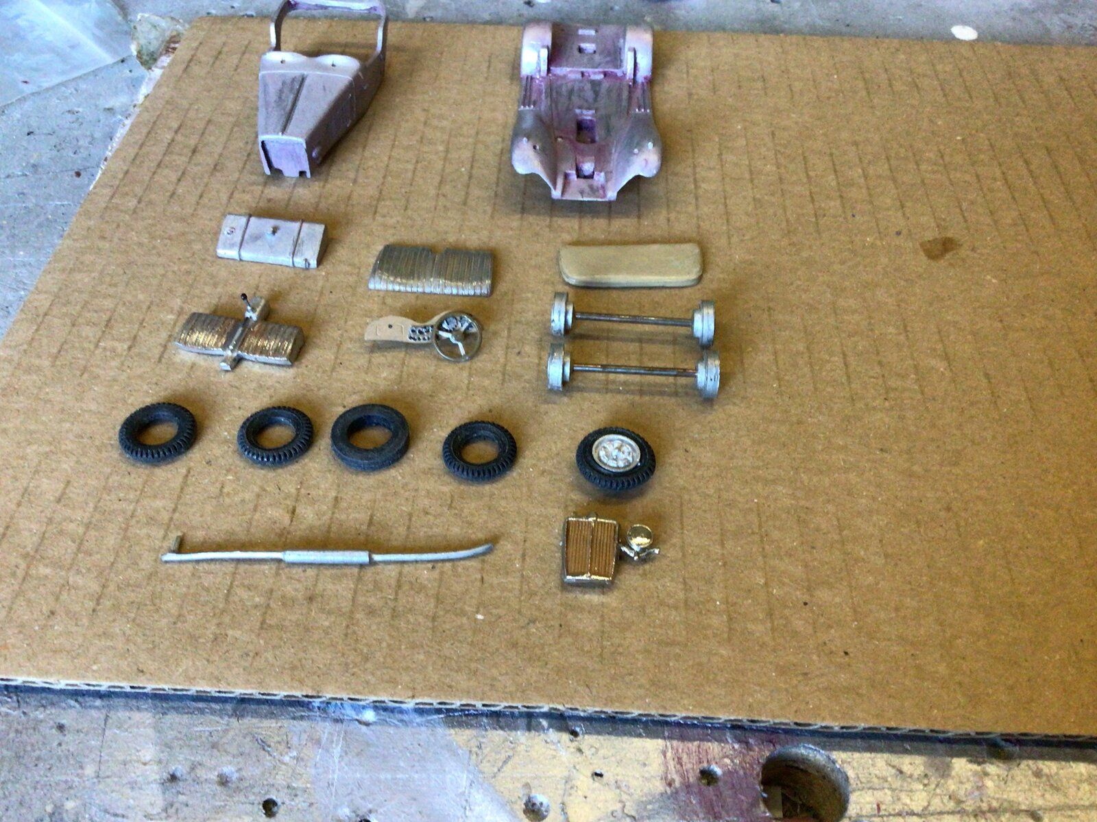

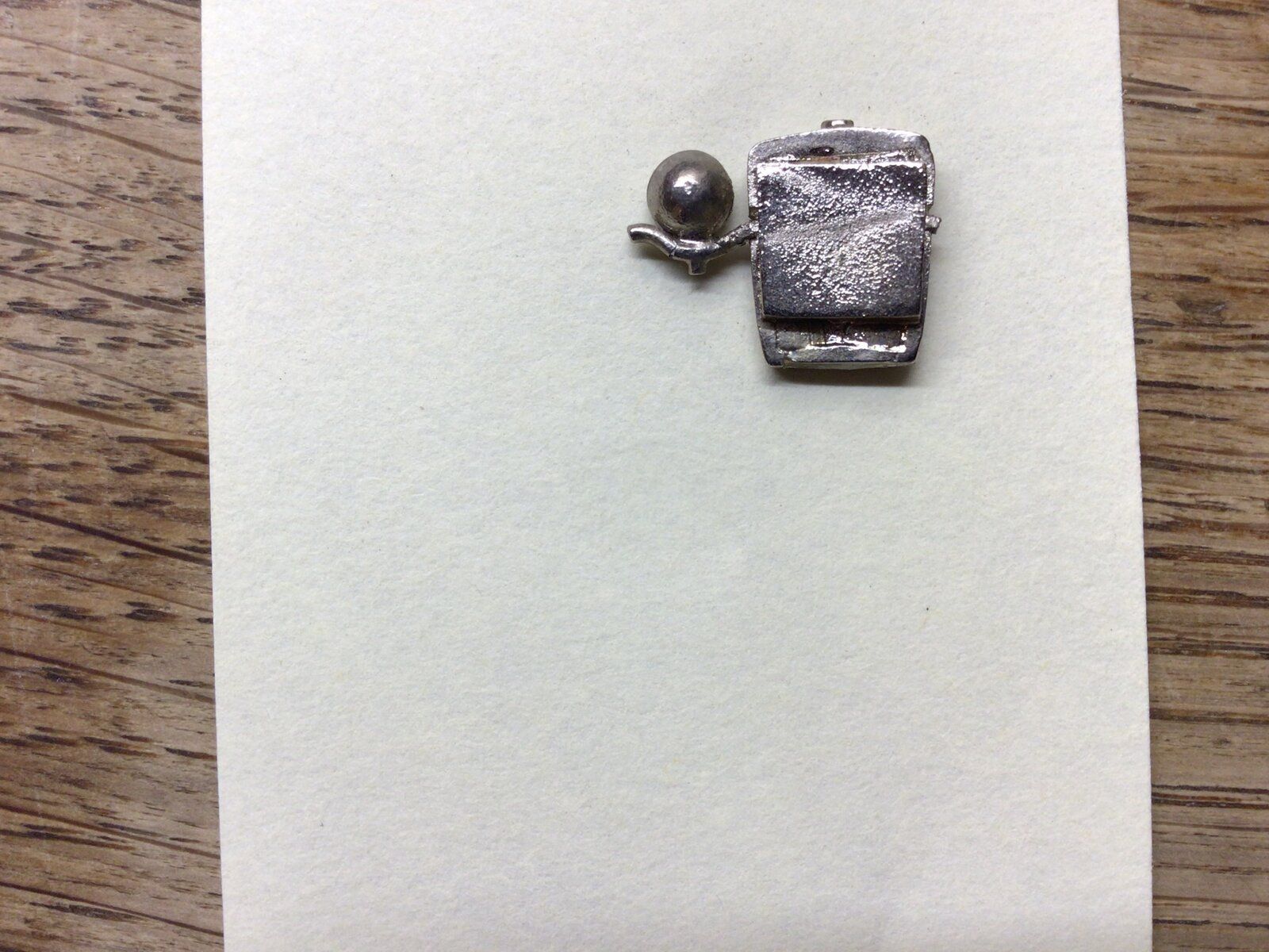

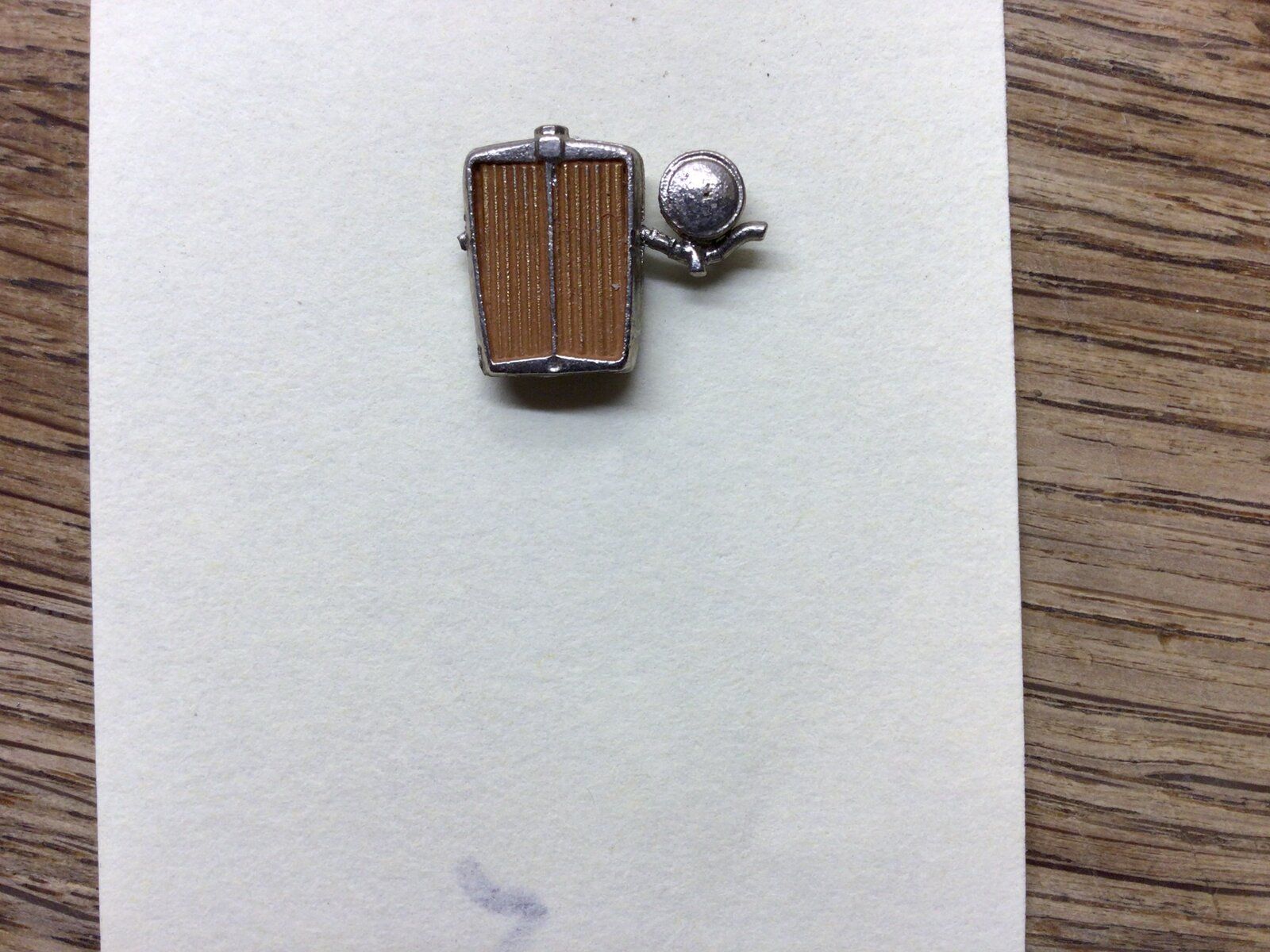

I need help with a 1/43 model I am trying to repair. It is an MGTD sports car in white metal and dates from the 1950s or earlier. The radiator grille moulding has the headlights attached to each side. However one headlight is missing. Any ideas on how to make / replace missing headlight?

You won't be able to make a direct copy of the whole headlight since you need a flipped version for the other side, but you could at least mold up the headlight by itself and maybe use some brass/copper rod for the part it sits on

You just need to cast one headlamp assembly -- then cut it apart from the mount so you can reverse the orientation since the inboard section of the mount is slightly different .
