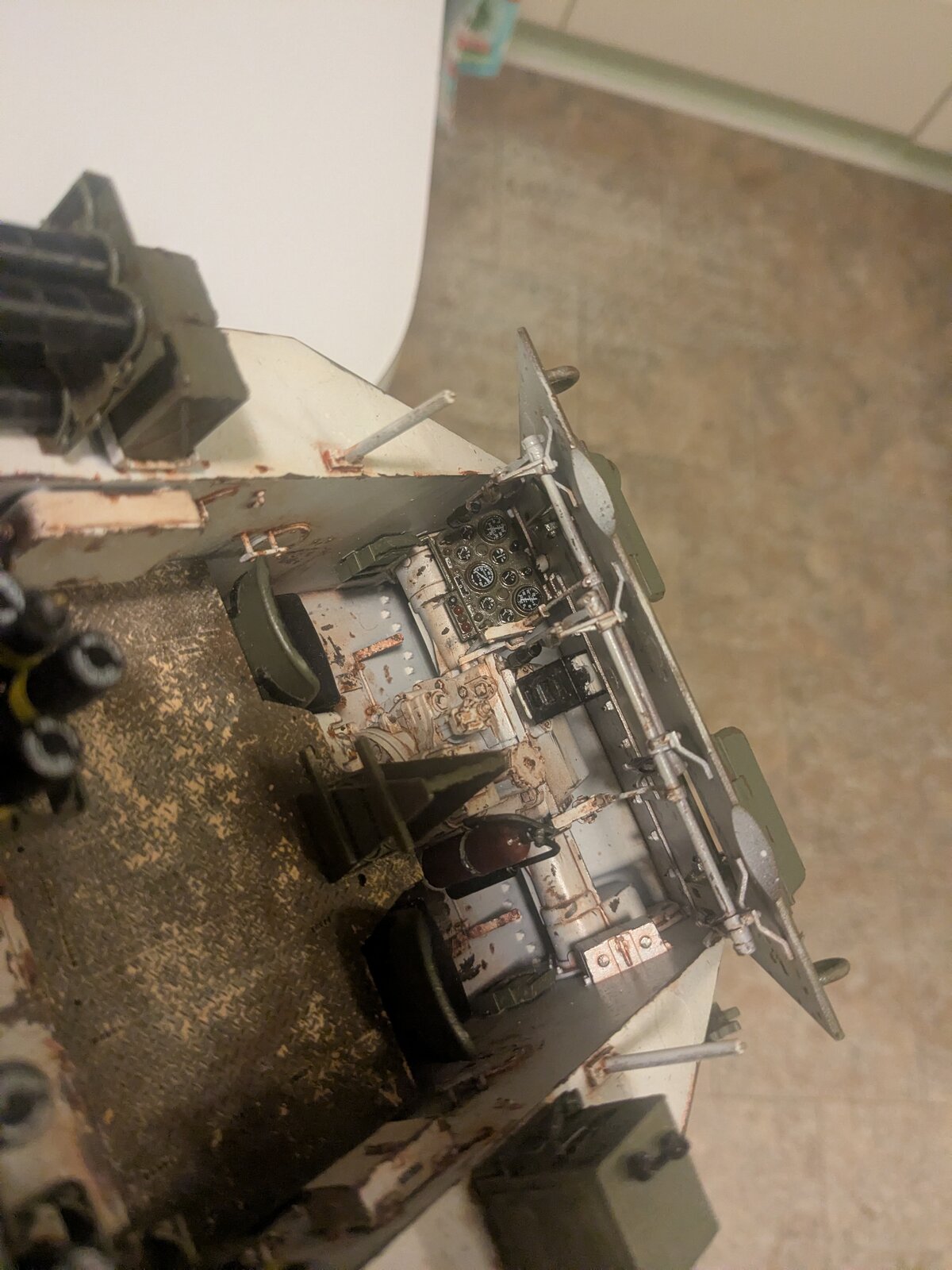

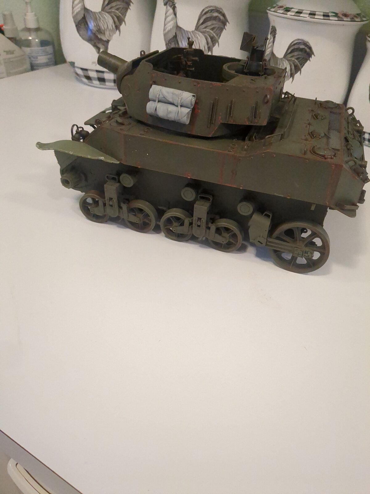

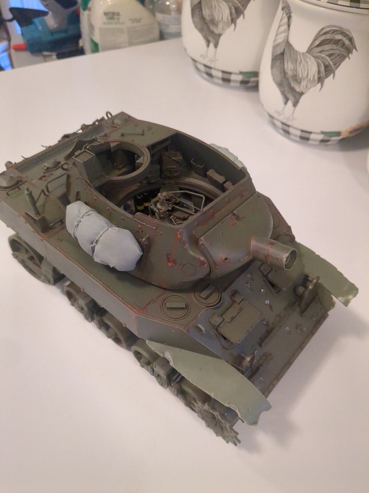

The paintwork is very good, but I maintain that there is far too much chipped and scuffed paint — these vehicles were not that old when they were in use. Dirt, yes, because even though the soldiers would probably try to wipe their boots before getting in, they would inevitably carry some (or a lot, if they were in a hurry) inside. But the chipped paint and rust make it look like this vehicle has been in use for a decade with no maintenance whatsoever.
People forget that the French received a lot of war war 2 vehicles and used them for a very long time. That particular vehicle could have literally been used for over 10 years even being handed over or tasked to Vietnamese forces at some point.
I think it's probable but this is sorta meant as a fantasy build and I'm also using it to test a few different things. Like the chipping with medium. This is the first time I have tried that. Will never do again.
To me heavy chipping doas not happen on most modern armor but ww2, Korea, Vietnam are about the only wars they would... Environments and length of wars with a lot of use allow this. As you said for most part would not be that heavy though. This vehicles circumstances though would be most likely to produce those results ... Ww2 use... Given to French... Indochina war... Given to south Vietnamese forces ... That's a pretty long road.
... not to mention super humid subtropical/tropical conditions!

That's part of reason it is heavy.... I can see using it in particular situations but overall I won't be using it on a model like I did here again. To me it's to uncontrollable the chipping effect. I will use my normal teqnuiqe instead.
I could see it used on the roadwheels and lower running gear and being fine. Could also see it being used on knocked out or graveyard armor. Perhaps also in the situation where I'm using it here with a vehicle that's been literally passed through different services, countries so on.

Got it and it looks good! I think that's a more realistic approach and similar to what I have been trying to achieve.

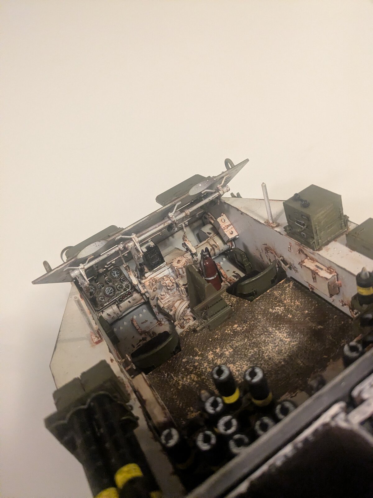

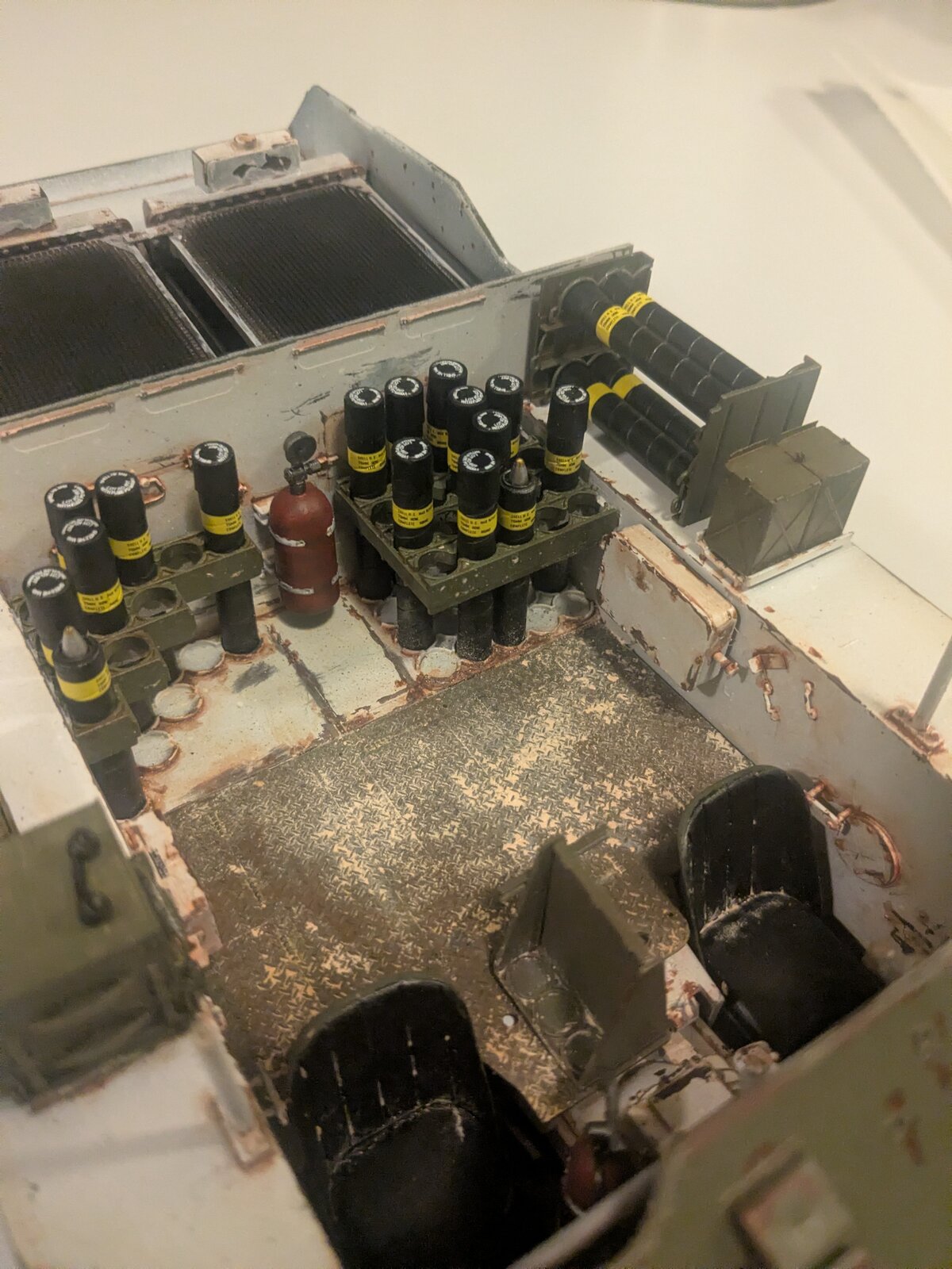

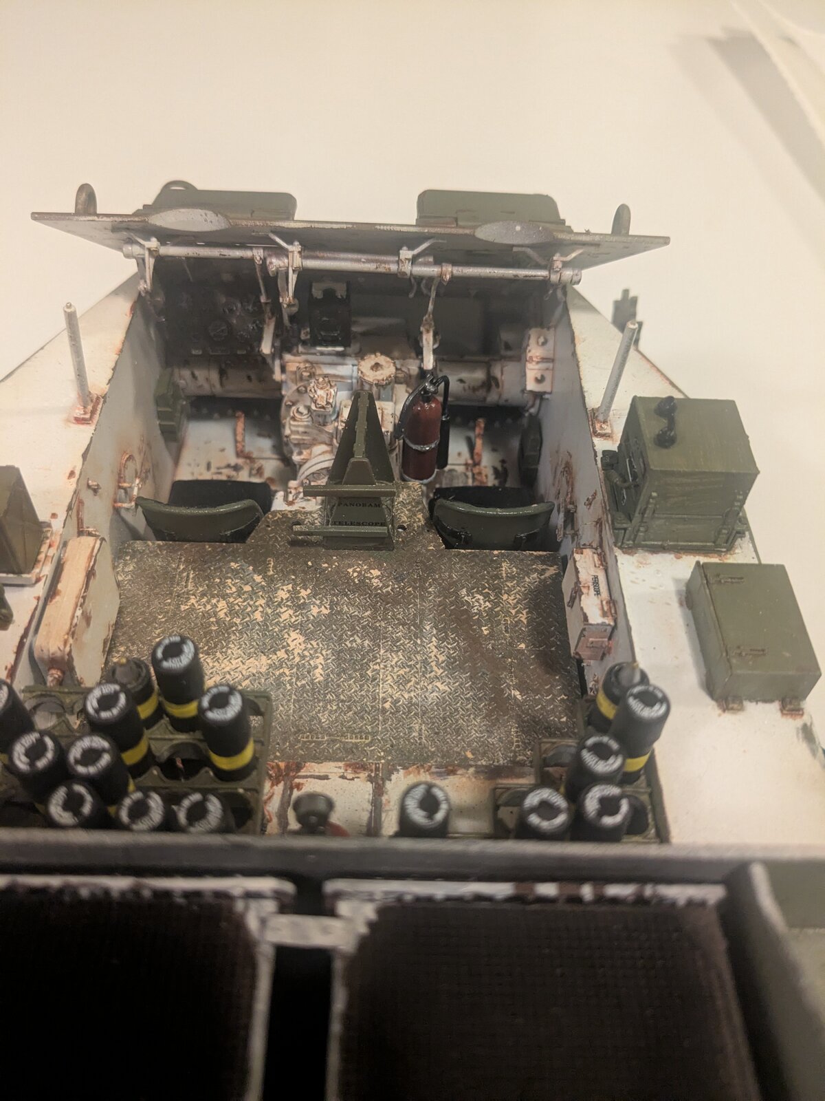

Very nice weathering! For the diamond plate floors, you paint green, then wash brown, then dry brush dark and then add sandy pigments?
Basically yes... Leave pigment for. Mininute then blast with water

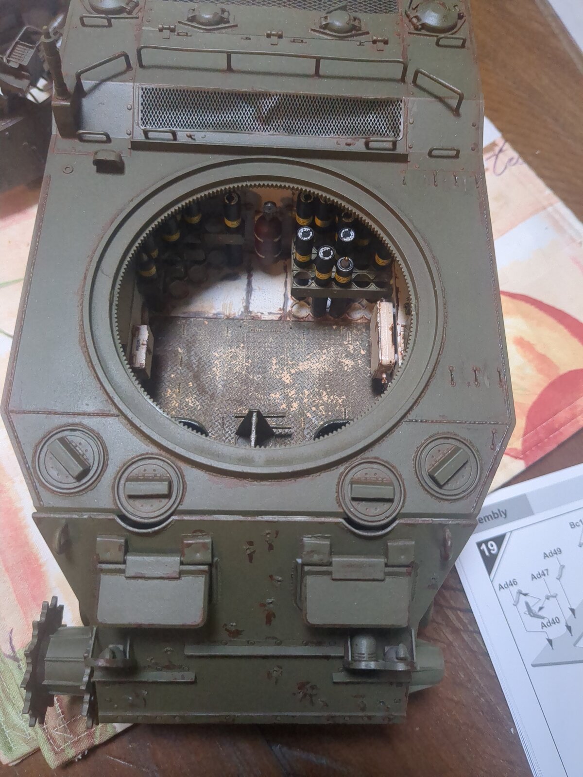

About to button it up.... As stated before is a vehicle used through war war 2 then handed to the French who used it for the entirety of the frnh Indochina war, 10 years of straight use and multiple trips across the alt water. It is in use hence the unfill shell loadout.
Going to take break on this one for a Bit. I have a new project coming today I will start messing with. One that I have been waiting on for a While.
