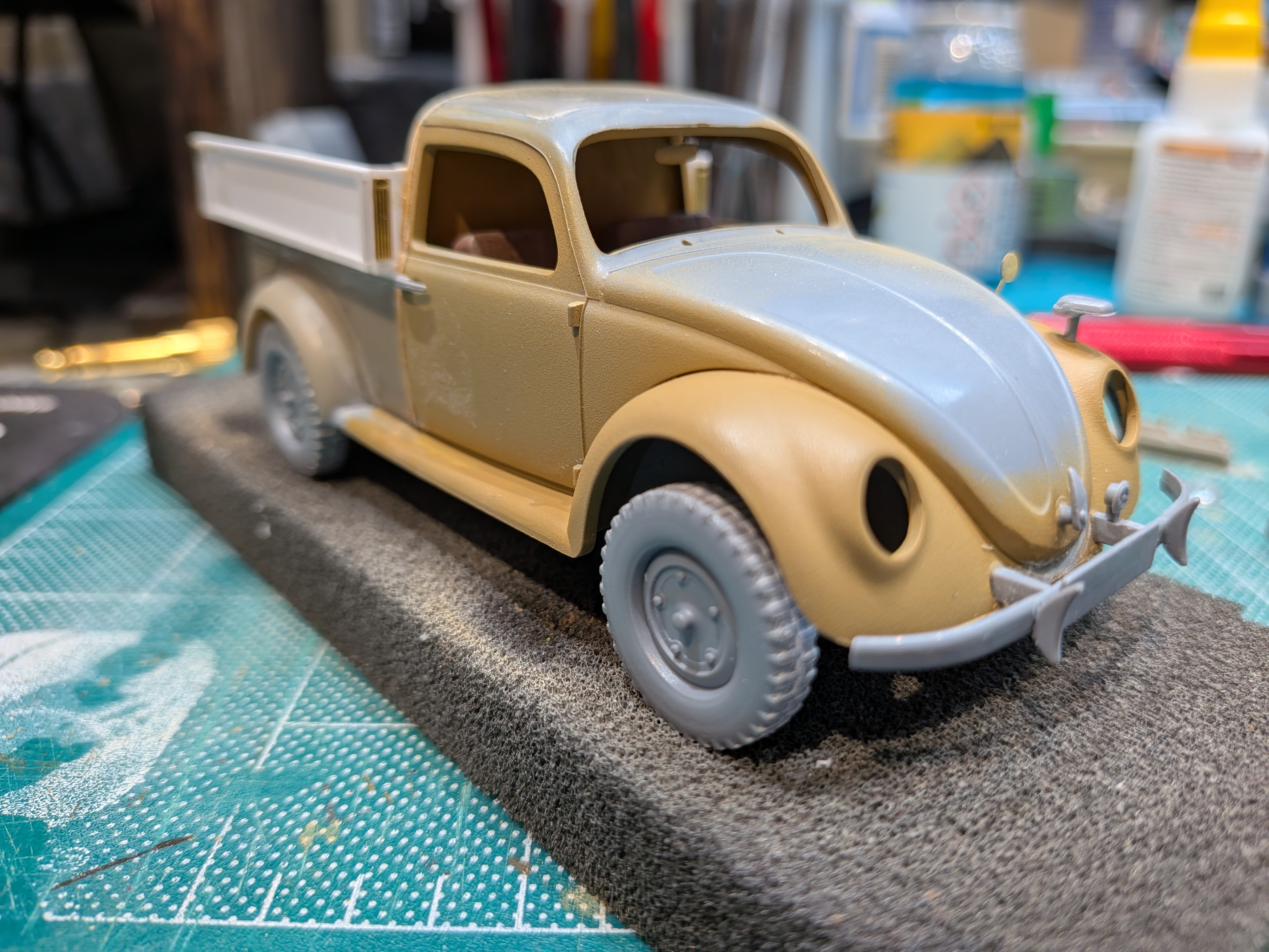

VW Typ 825 Pick Up 2026-01

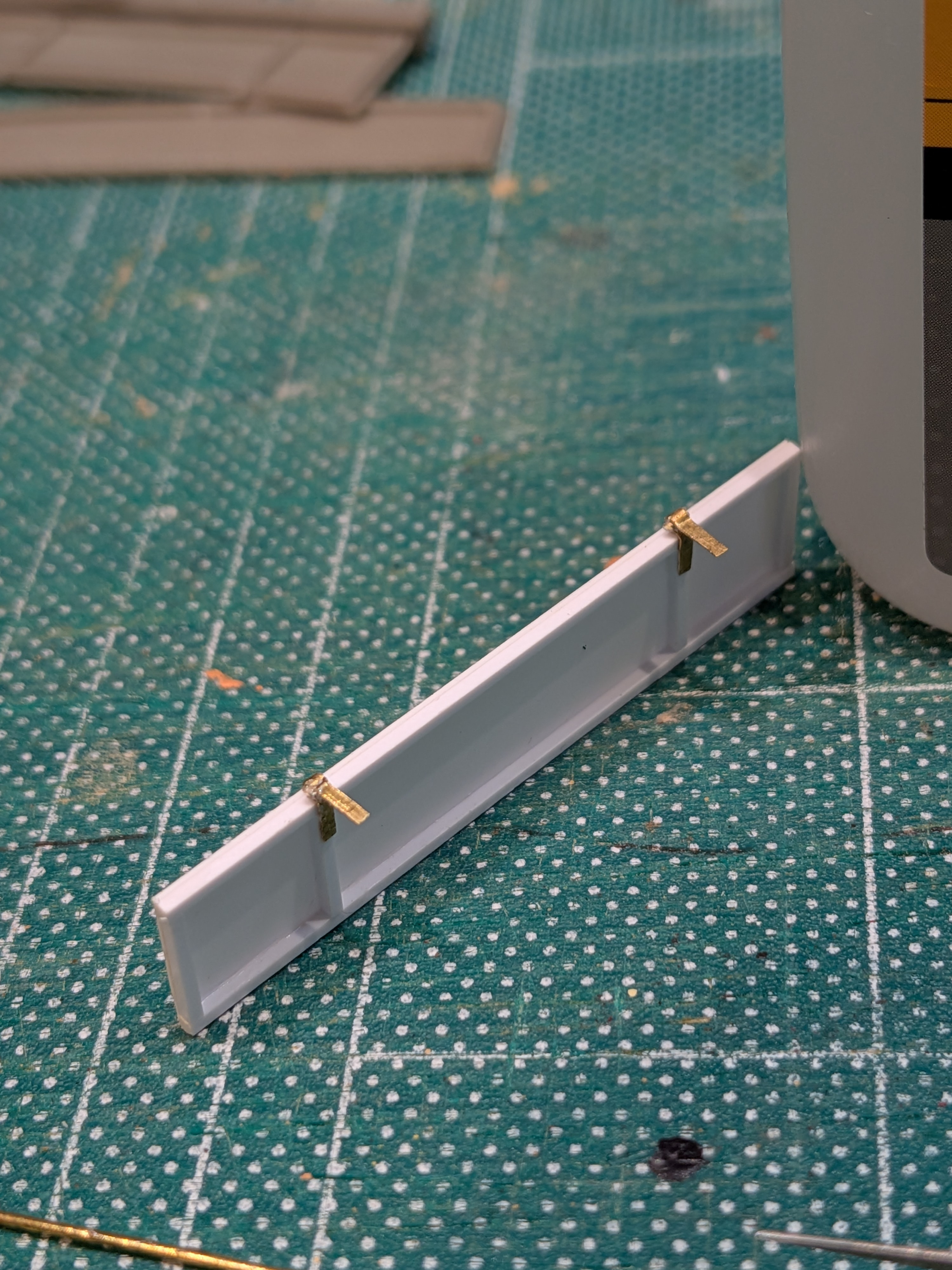

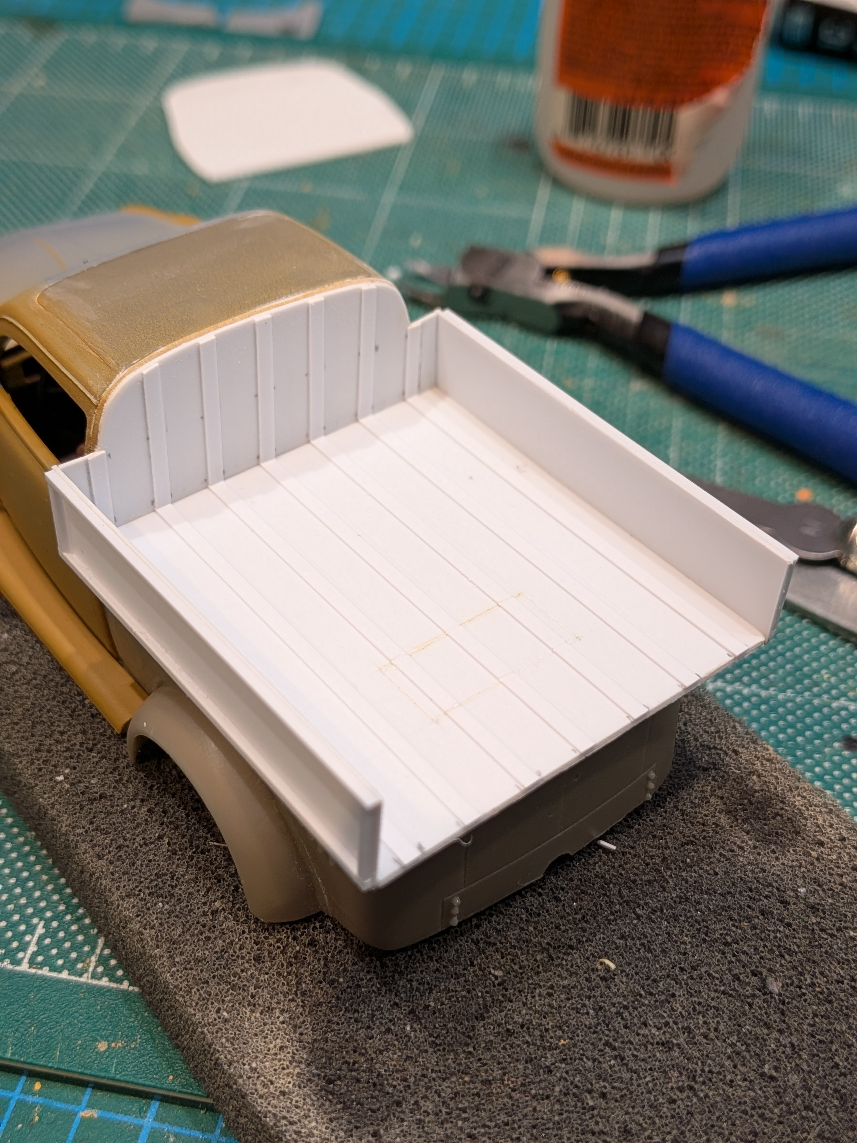

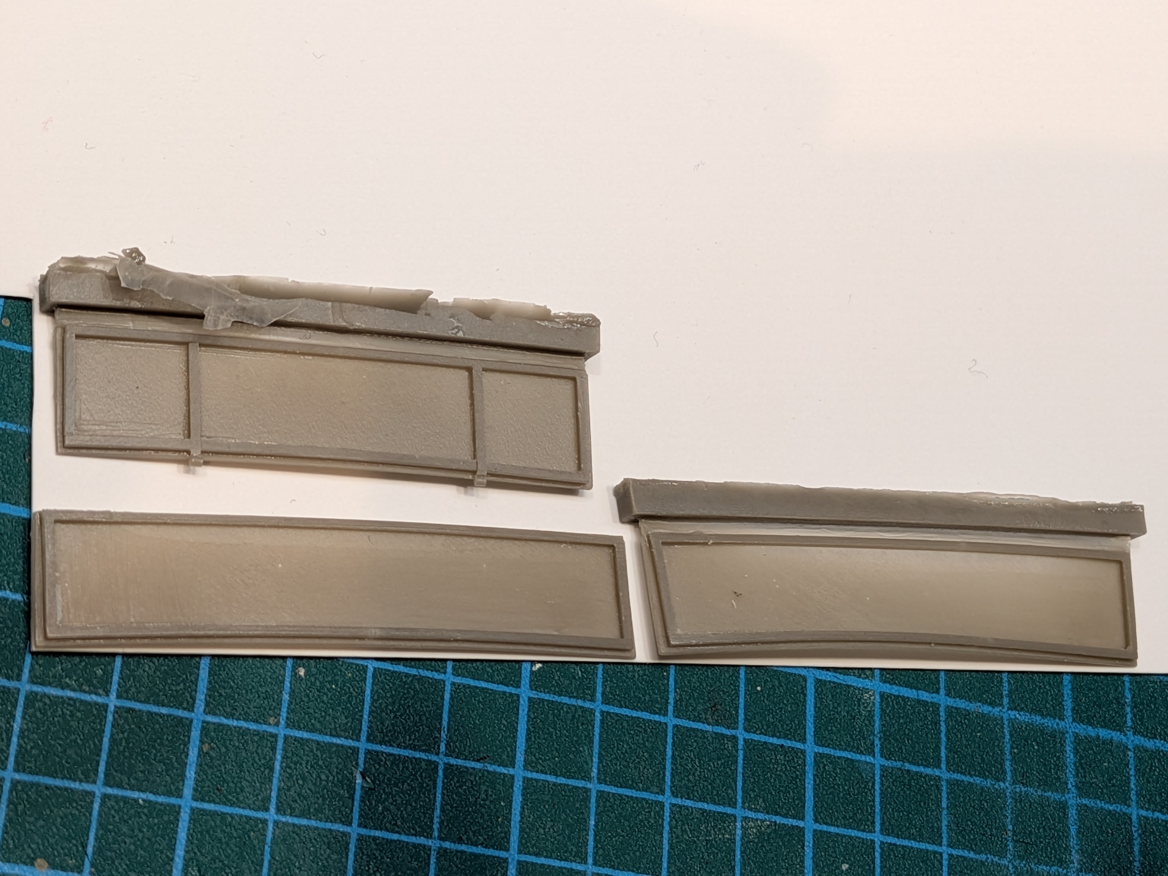

Here is why I need to make my own box: I could flatten bowed resin pieces, but making them true rectangles is something else.
At least I can use some basic dimensions for my Evergreen.

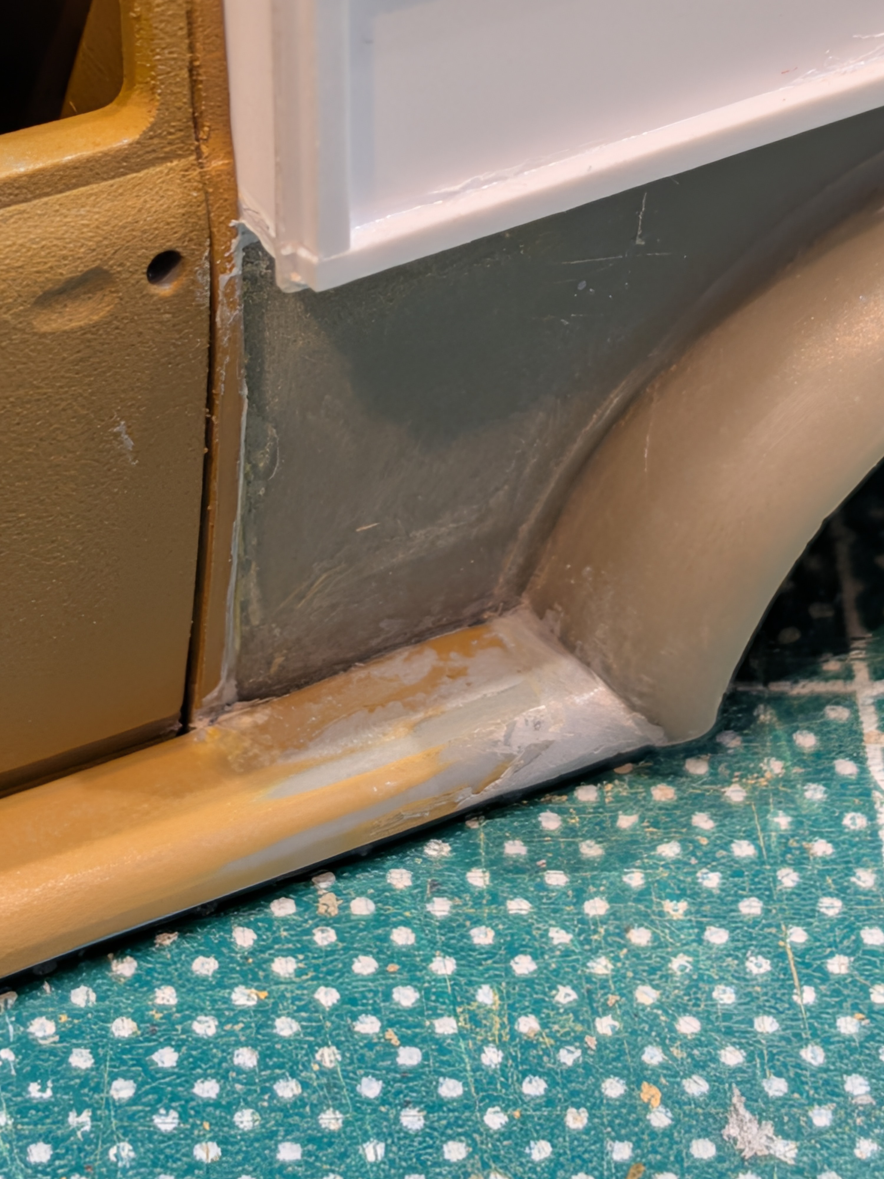

Yes BarlyBop that's the way to go! I've scratch built various Pick-up beds from plastic sheet, using square section evergreen inside the corners to strengthen the joint!

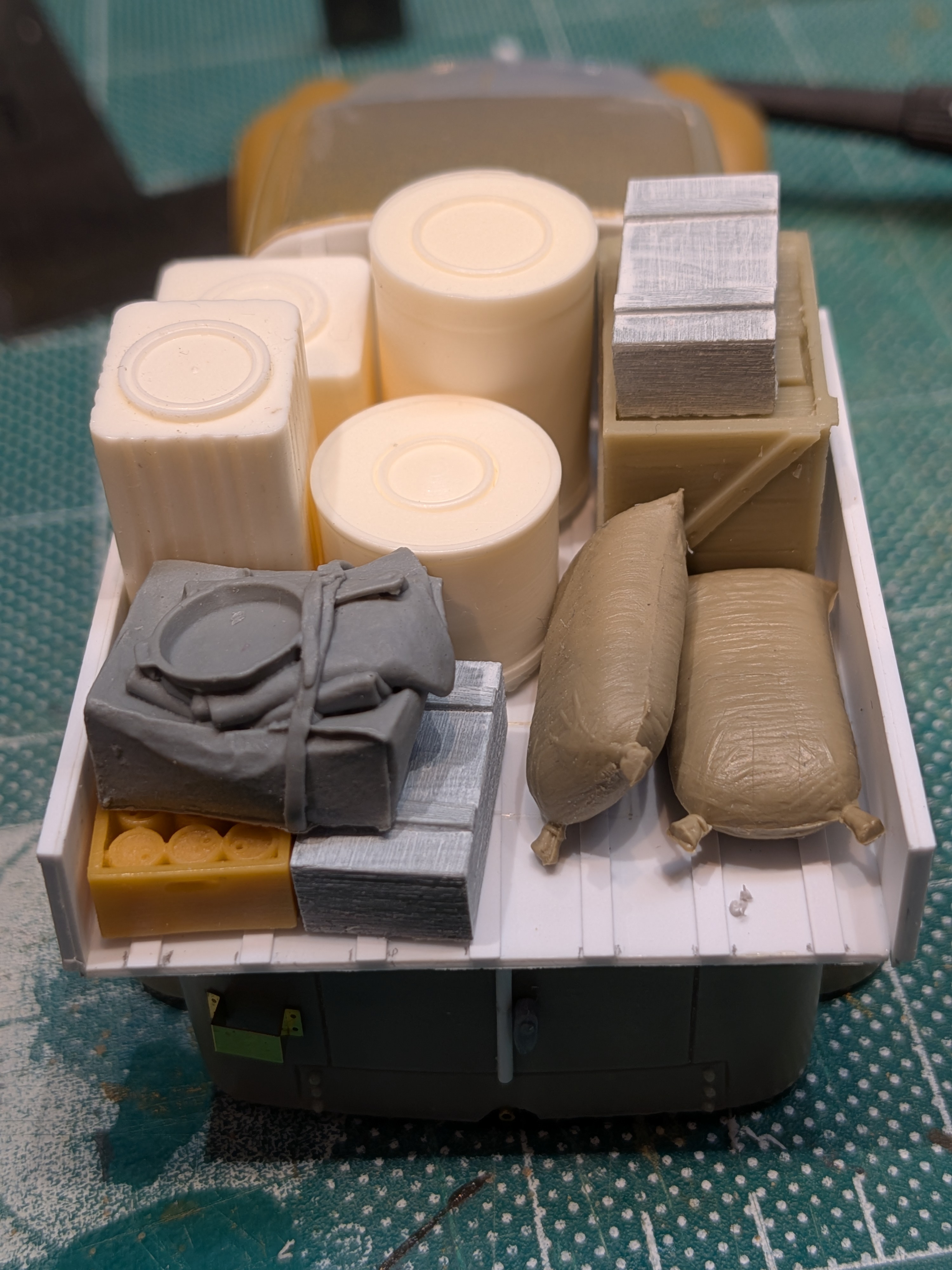

Bed is coming along... There are a few body gaps that will need filling, and still the rear gate to build - it will be open.
As a runabout in some rear position like an airfield, I'm thinking about loading it with crates and German food containers from the tickle trunk.
Yeah … those are pretty much beyond saving. Somebody didn't take shrinkage into account, let alone uneven shrinkage. Making your own is the only way to go there. Luckily these are simple shapes, just some plastic card and strip like you used and it'll be less work than trying to straighten the resin bits.
Trying out some provision type items that might be mostly kitchen bound...

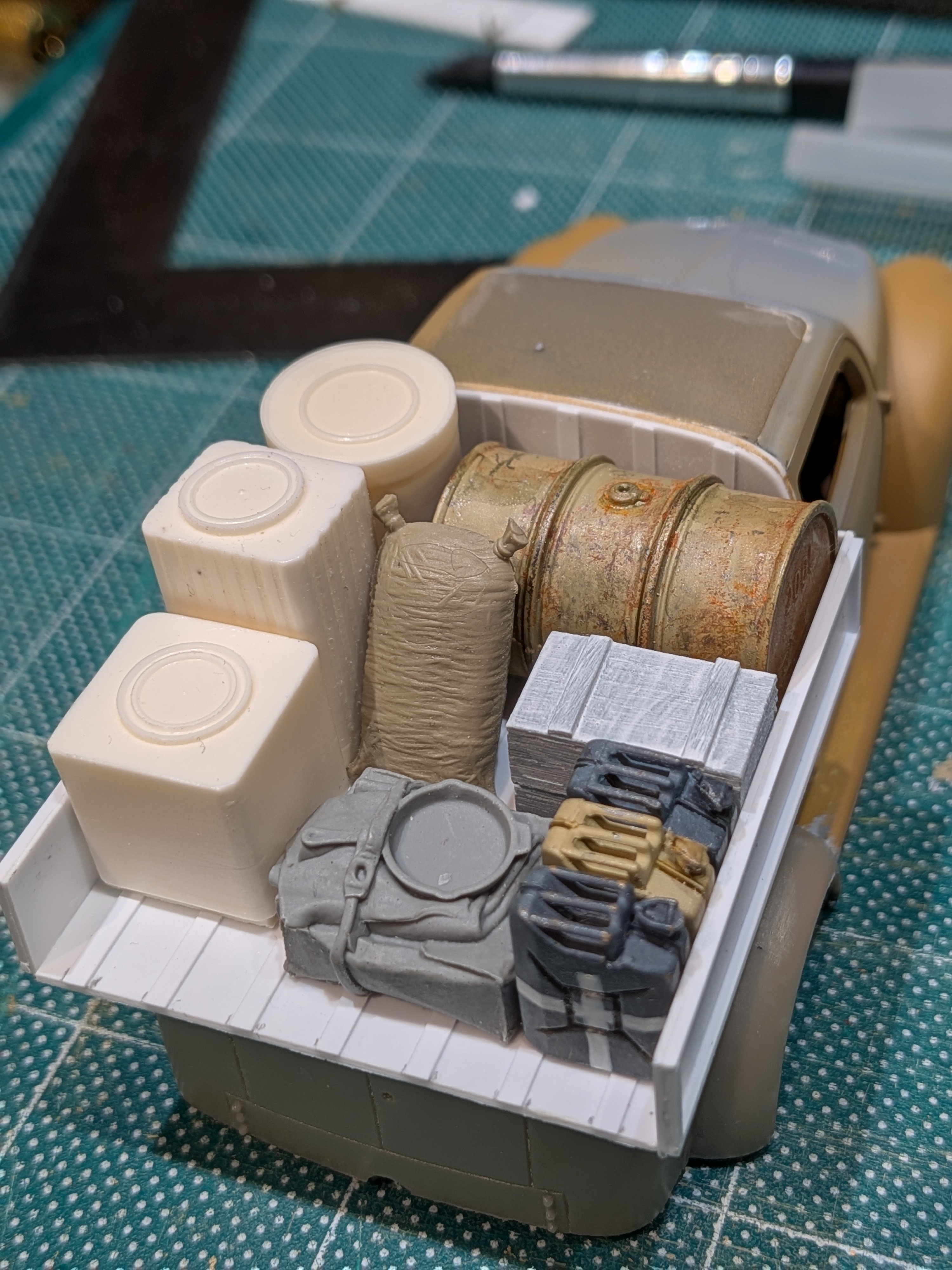

2.5 litre engine to carry
Haha... Jury still out on whether the fuel drum remains... Then again, the rest could be relatively light.

It also goes on to assert its rated capacity as
The Type 825 was built on the Type 82 Kübelwagen chassis, which had a rated payload of roughly 990 lbs (450 kg).
A full drum might be close to half that weight?... So not out of the question.
I wouldn't want to be hauling that up or down any significant slope in a hurry, but on an airfield that may not be an issue.

A payload under 1000# seems pointless ina. Military application.
They're 200-litre drums that typically weigh in the order of 10 kg or so, and petrol (gasoline) has a specific gravity of about 0.75, so a full drum would weigh around 160 kg. That would rise to 210 kg if it's full of water, but I'm not sure why it would be, given that you wouldn't want to use a container that used to hold petroleum products for water.

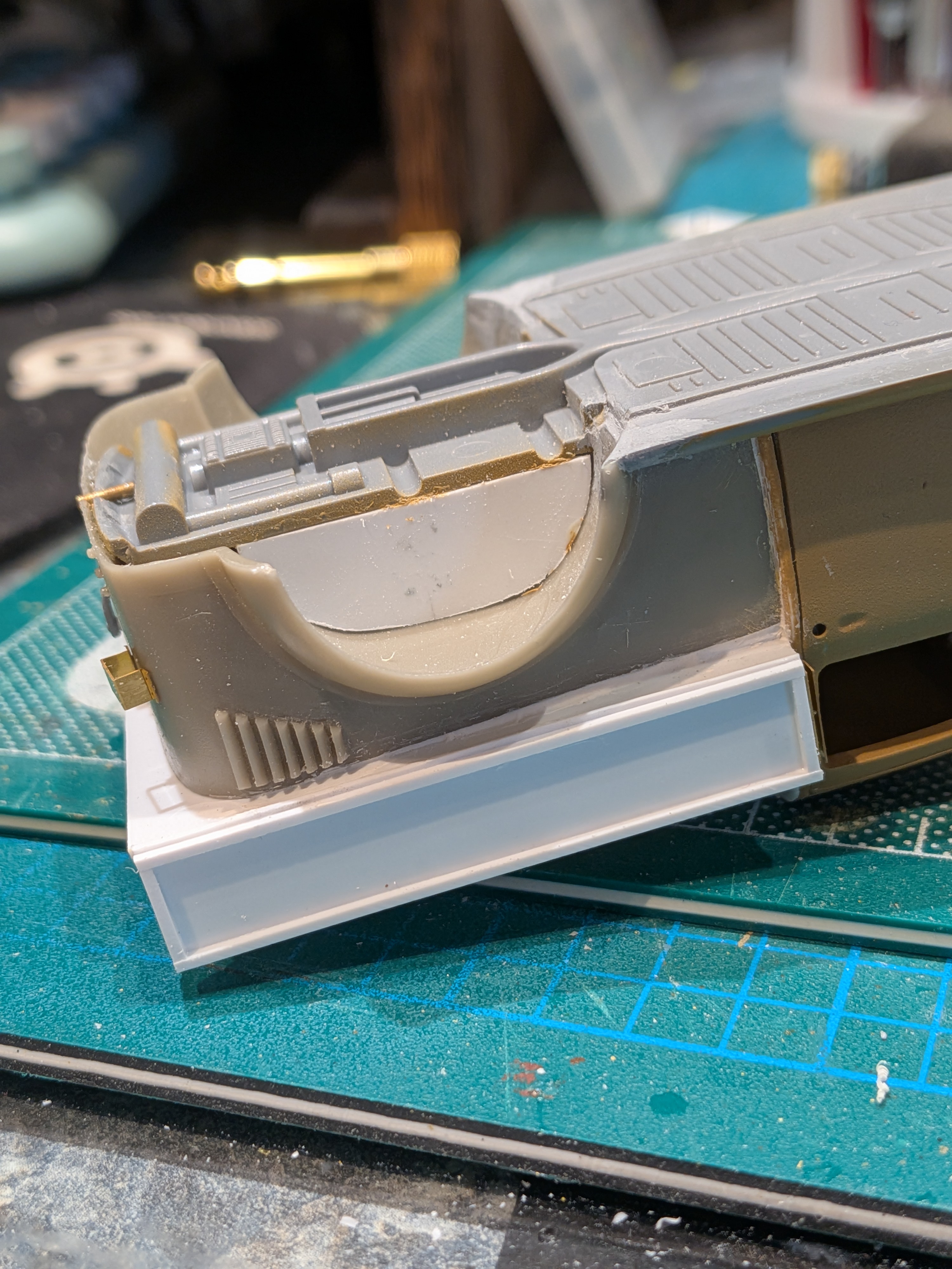

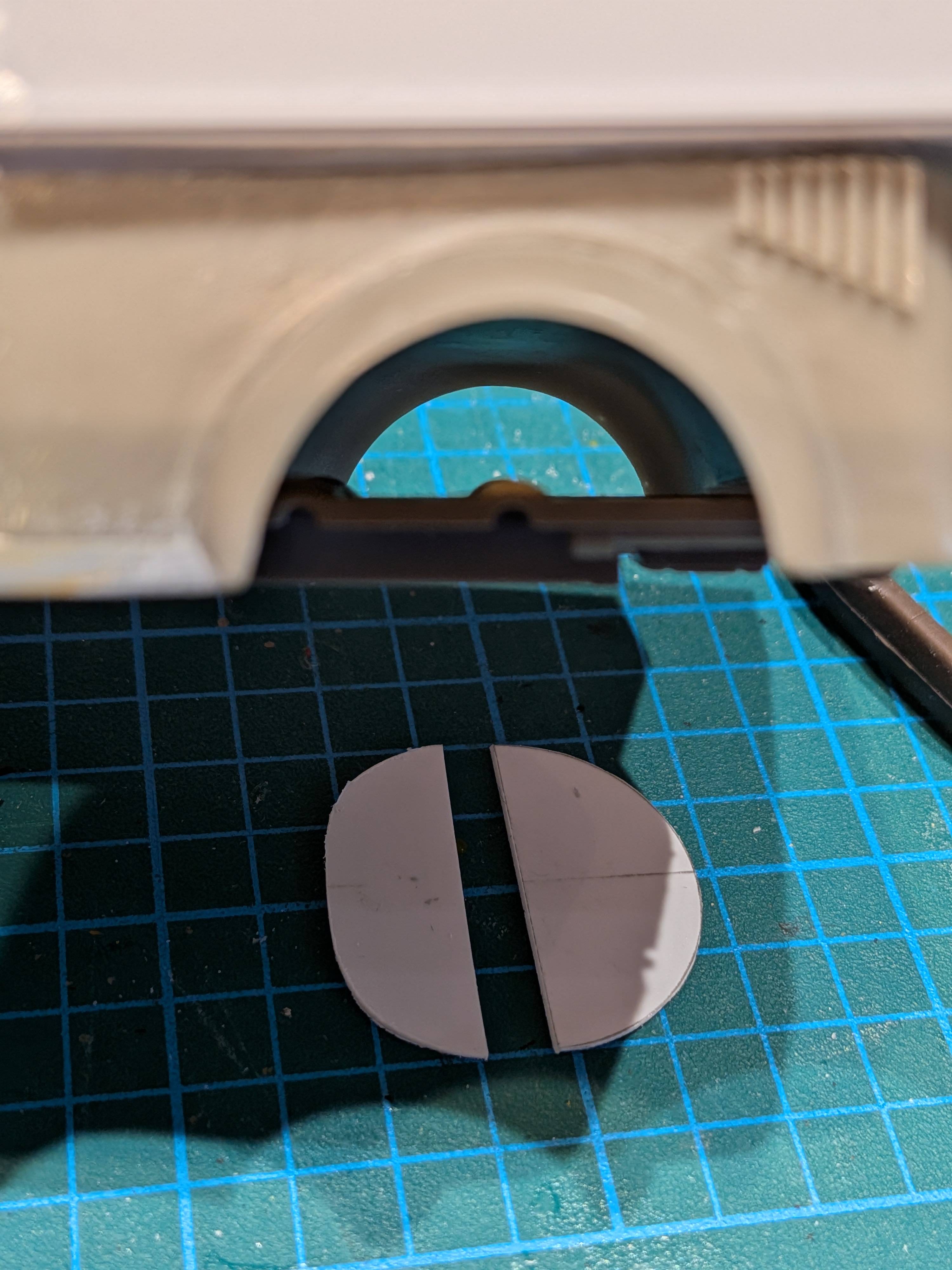

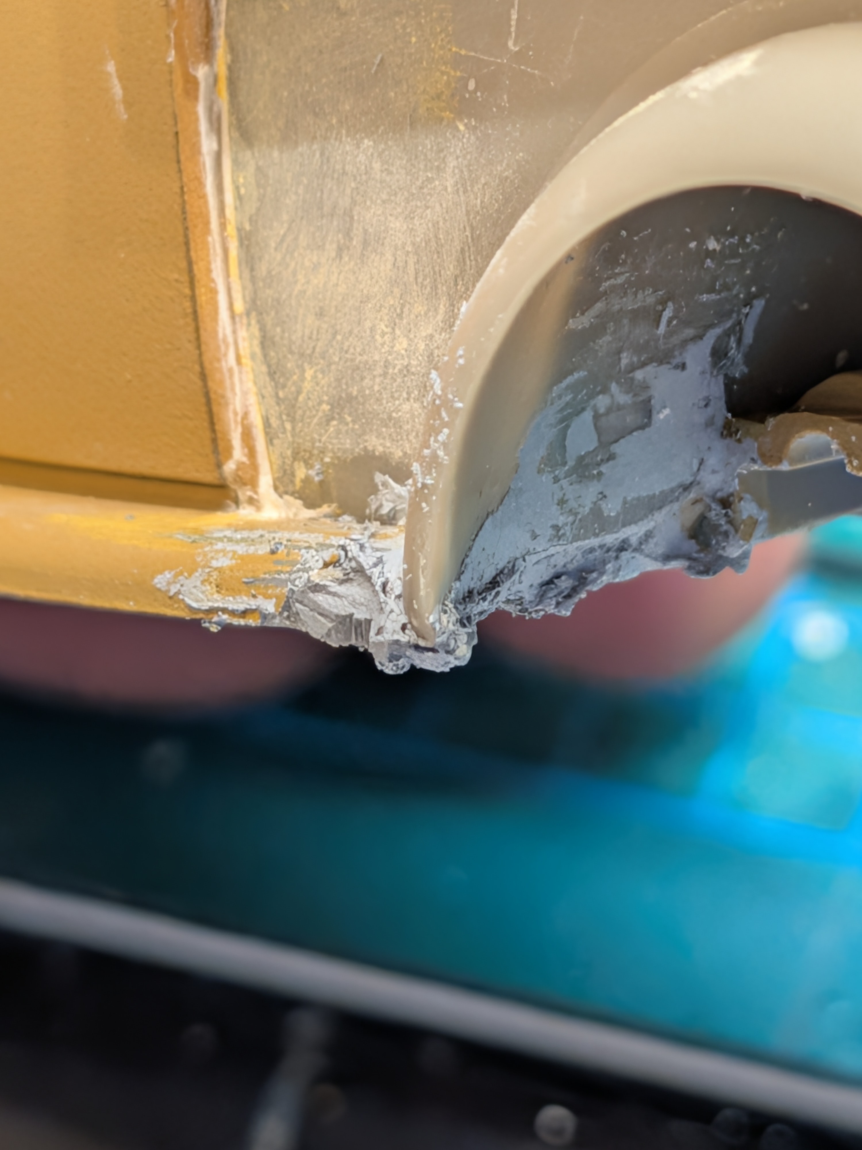

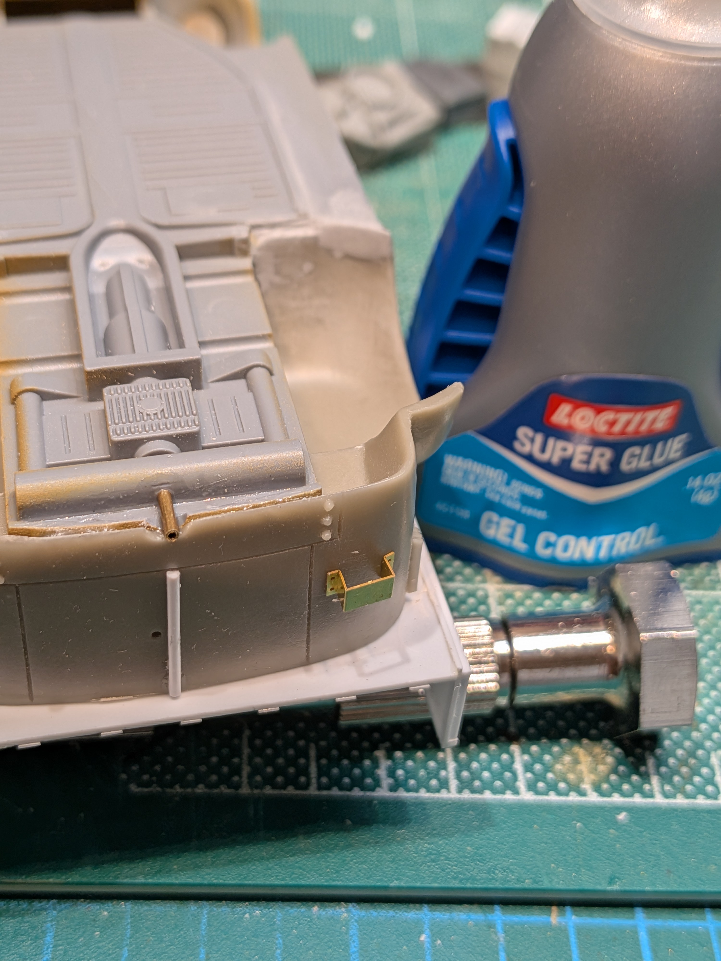

So the engine compartment is quite open to the rear wheel wells, basically you can see right through as there is no engine provided.
... So I decided to block it up...
Circle template to cut basic shape, then careful filing and sanding until the styrene half moon fits.
A bead of glue and some paint will fill tiny gaps.
